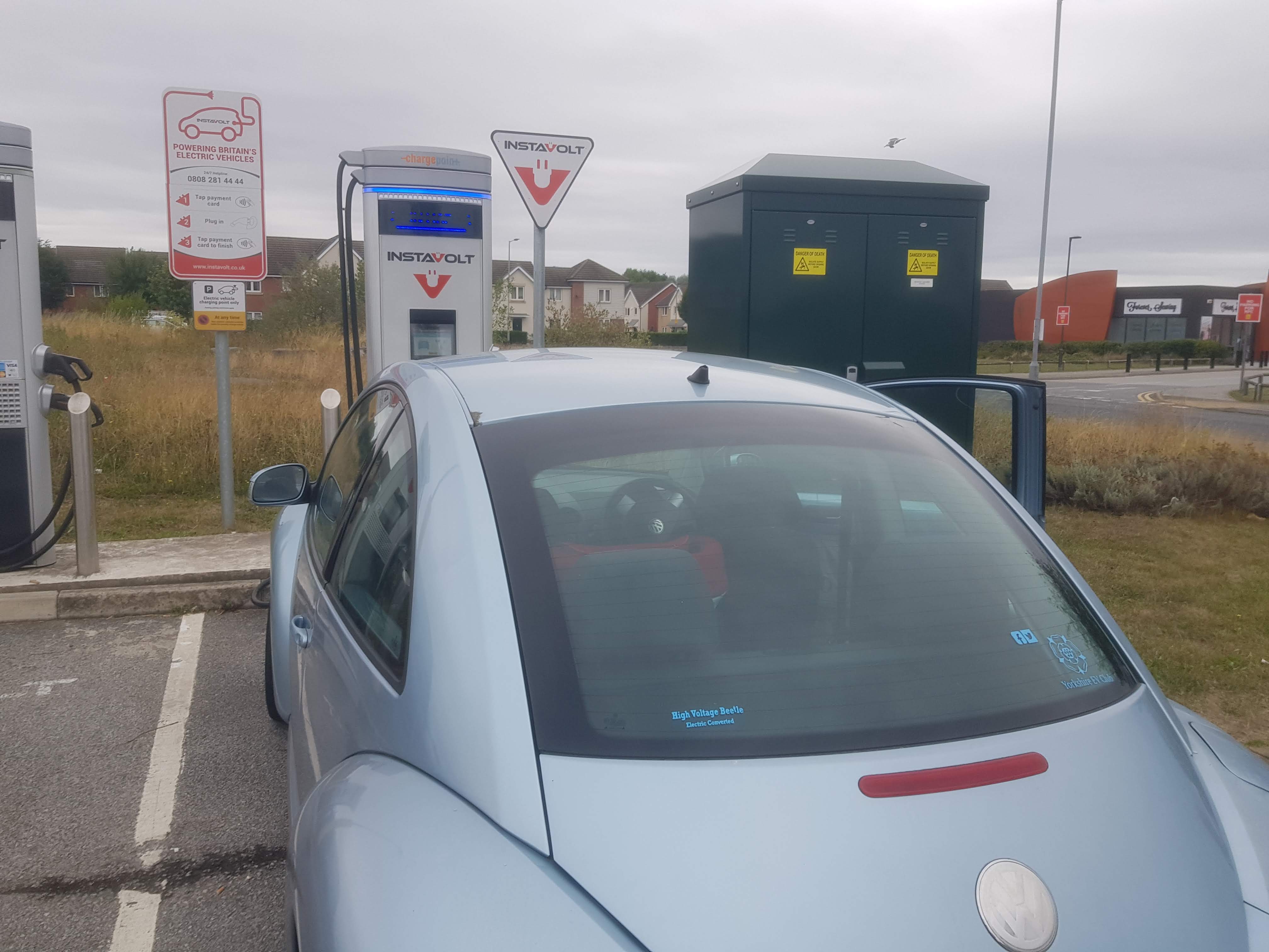

What speed of charging did you see? The Leaf motor would be a great upgrade if you can fit it in.Bigpie wrote: ↑Tue Aug 16, 2022 5:21 pm Did a longer trip today and got a charge on chademo
Did some motorway miles and while the car was mostly ok, it was obviously lacking in umph. Would cruise happily at 60 but maintaining 70 up hill wasn't so effortless.
Mart.y hit me with a well timed PM offering a leaf motor so an upgrade is in order. Going to be a tight squeeze.

I've not gone over 50 amps yet, the unit was reporting it could do 120 amps. Need to harness my inner Damien and just open up the taps and see what happens

Remind me please how you achieved the charging? ATM all I have is an Outlander PHEV 3kW charger.
- Posts: 1845
- Has thanked: 89 times
- Been thanked: 481 times
Re: VW - Beetle 2003
Chademo controlled by an Arduino Due and a shield I've bodged up. My AC is the Outlander charger.

I have a Chademo charging socket, a Due and several shields.
Now I'm very interested, any plans or a how too?
- Posts: 1845
I'll put together a wiki/video asap. My shield design needs some changes too, but I'll publish when done.

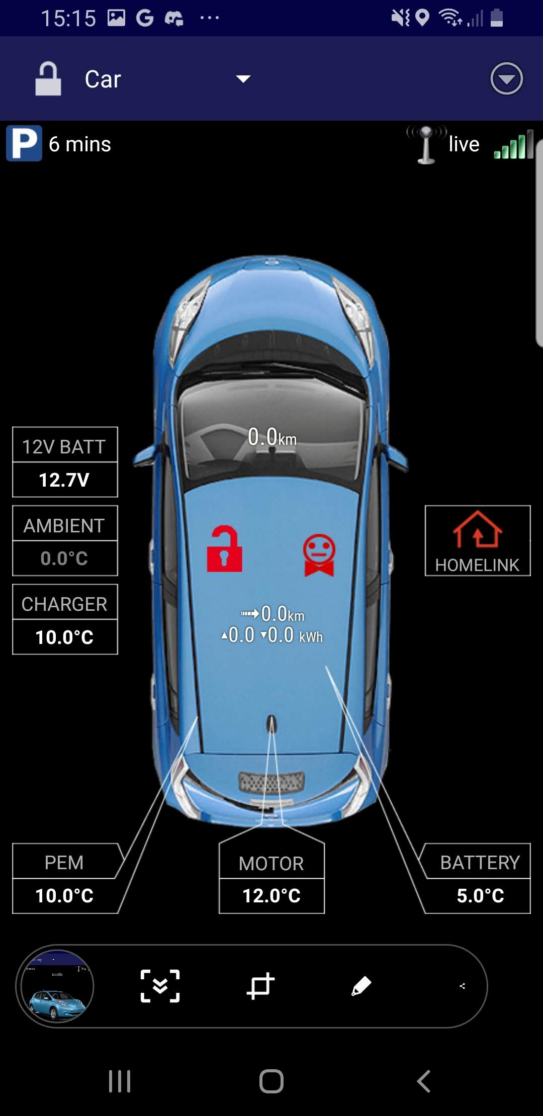

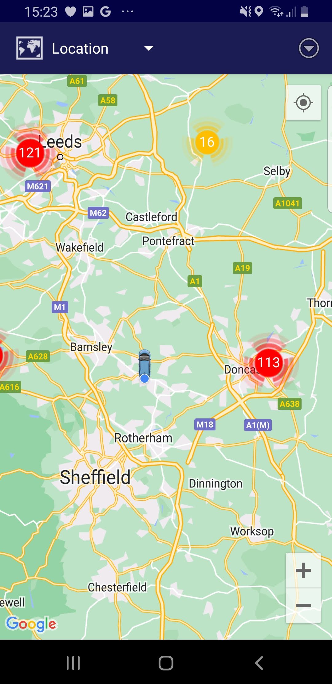

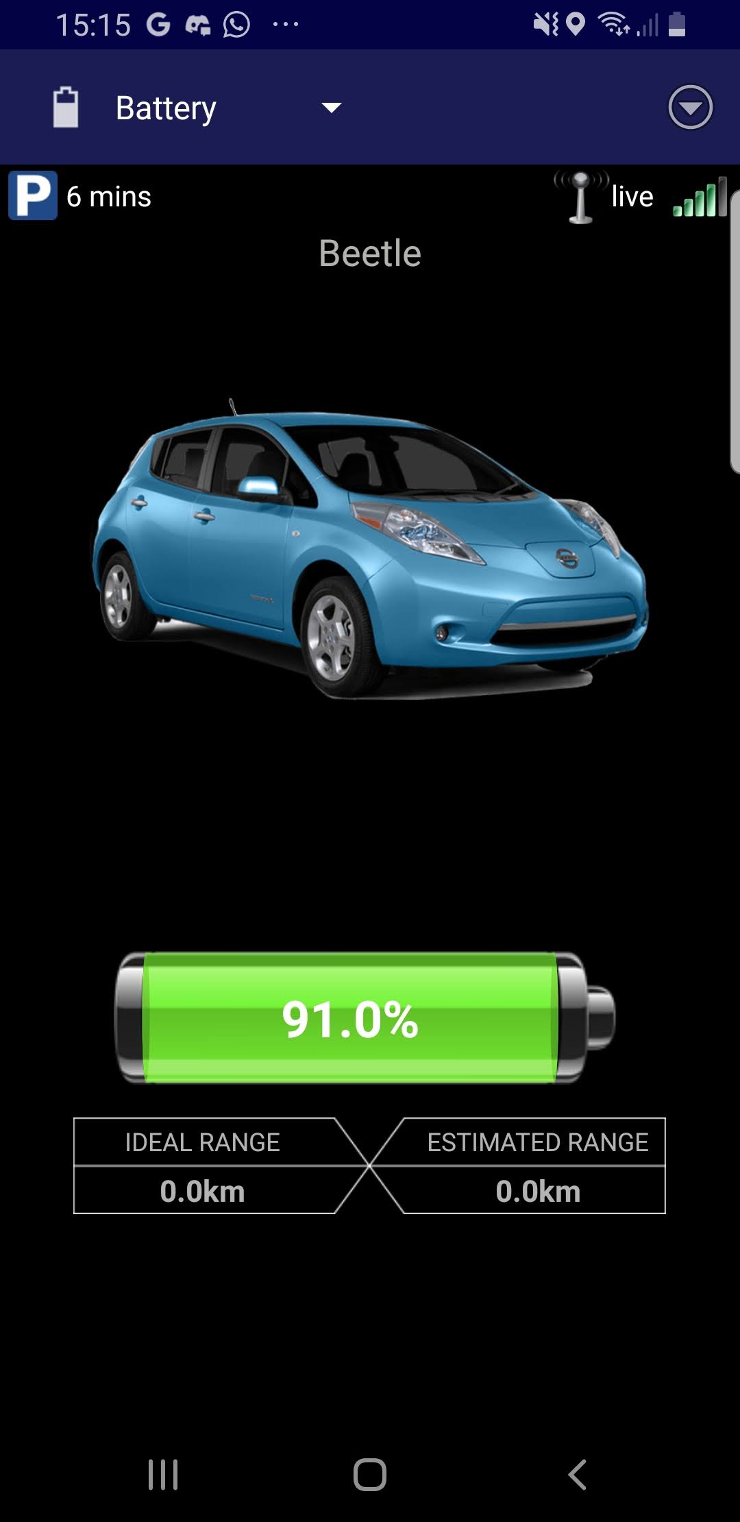

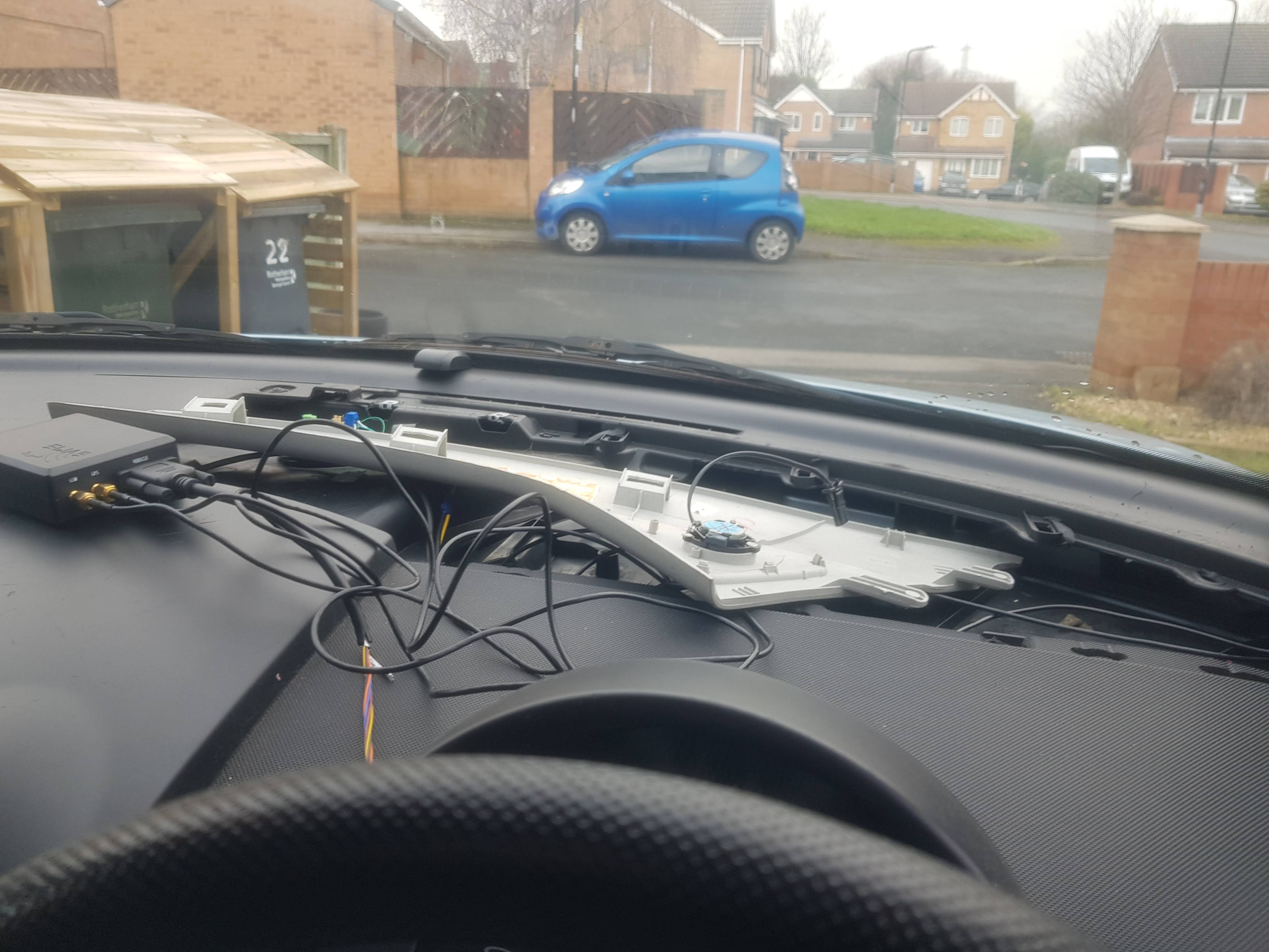

I recently picked up some OVMS hardware for cheap second hand. So I've been coding it to support my specific setup.
Still got a few messages to code in and to update my SimpBMS to support charger control over canbus so I can control charging from the app.
It has a cool map too that has real time position and there's charging locations on it.
It has some general IO pins, so hopefully I can use them to implement pre-heating of the cabin and maybe even unlocking/locking the doors if I can be bothered.
