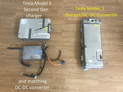

So the two of you who actually have read this entire thread, may recall that I started out with a Tesla Model S charger. Yes I installed a EVBMW.com open source DIY circuit board in it, somehow removed the OEM million pin connector off the original board and resoldered it to the new board. To this day I have no idea how I pulled that off, and would not attempt it today, and even got it working.
So why did I not install that 35 pound beast in the truck? Why did I decide not to use it? Well, when I bought it I thought Tesla is Best? I also thought it would be a hoot to pull up in my beater to a Tesla charging station and shock them pretentious owners by charging my truck at "THEIR" stations. Well, little did I know that's not how it works and you can't charge with a Tesla charger at a Tesla station without the Tesla. Also the charger is really three charge modules in parallel in one box and that's great if you are in Europe and have 3 phase power in your home, but here in the States we do not, we have Single Phase and if anyone thinks we have more we can thumb wrestle.
So I went out and bought a Chevy 1st gen charger, and a 2nd gen charger, and a Tesla Model 3 charger and a BMW 530e charger.

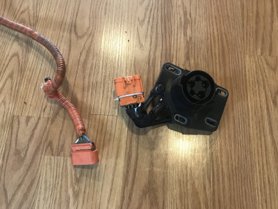

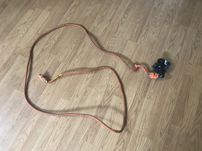

So I am using the widely popular in EV Conversions 1st gen Chevy Volt Charger and it works great. It speaks CAN and that is documented and supported. It also charges the regular car battery in addition to the big high voltage traction battery pack. It's younger brother the 2nd gen Chevy Volt charger speaks PWM and though folks have got it working on their test benches I have yet to come across people running them in their vehicles successfully, please correct me if I am wrong.
I bought the Tesla Model 3 combo unit because it is two things in one: it is a charger and a DC-DC converter in one box, and that means less cooling hoses to plumb, and less engine bay clutter. It may even have built in EVSE chargebility in it I don't know. I am slowly trying to build up the courage to use it.
IMG_1883 labeled.jpg (43.21 KiB) Viewed 31535 times
The BMW 530e charger was designed by aliens and they sent us the instructions on how to use it via a balloon but we decided to shoot it down!
