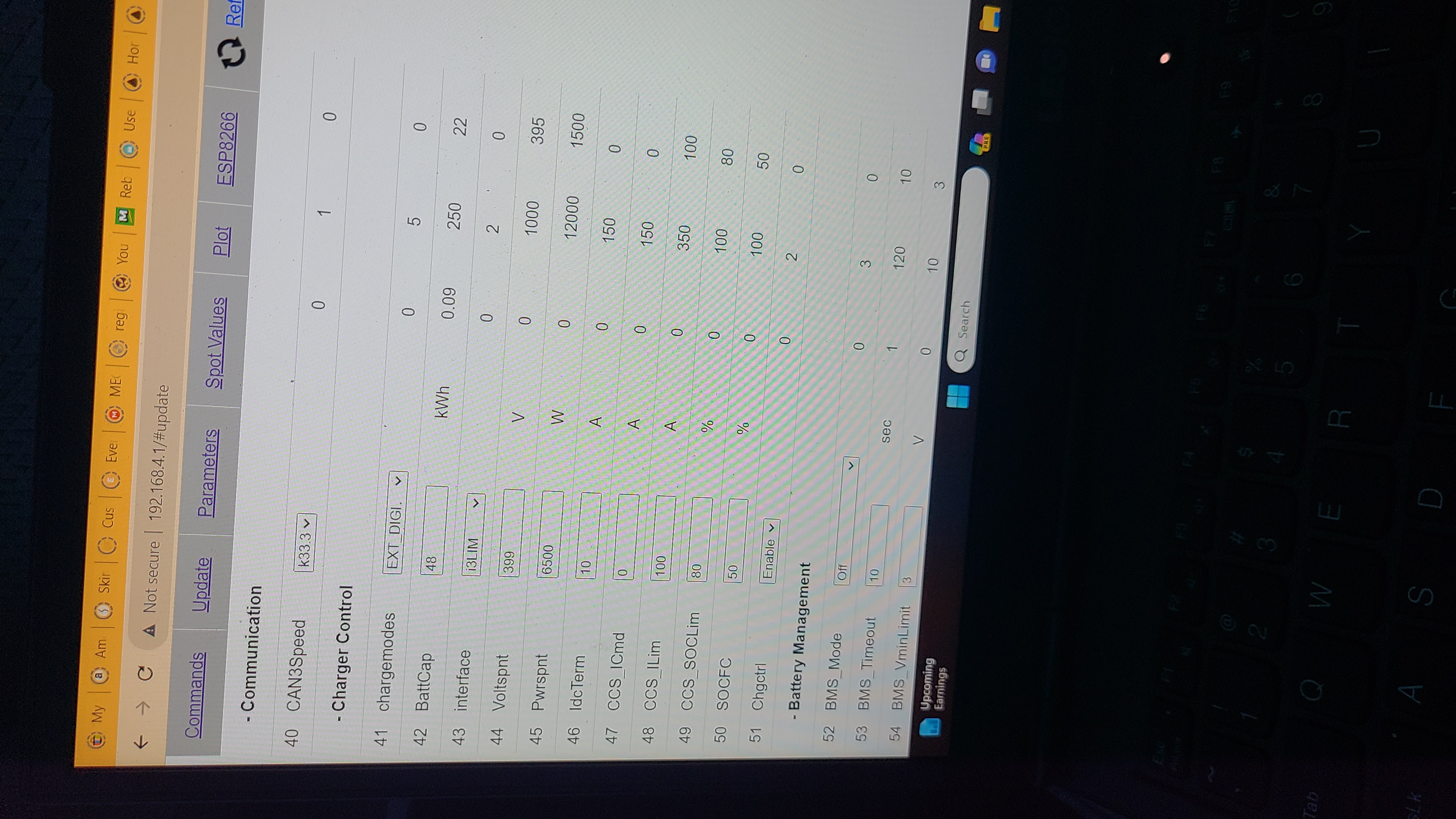

Possible it could simply be the setting choices I need to select in the Zombieverter setup. Details for these settings are scarce.
Or maybe I just need to know if or where I need to connect the 2nd and 3rd sensor wires from the ISA shunt.
1. Has anyone been successful with CCS1?
2. I need to connect udc2 and udc3 to something even if I can't access the main contractors?
3. I may have wrong choices selected in Zombieverter for example charge mode=Ext Can, interface =i3 LIM?

Did you check the Zombie reported being in Charge Mode when you plugged in to charge?
Your charge interface says unused so it is not checking any BMW I3 info for going into charge mode.

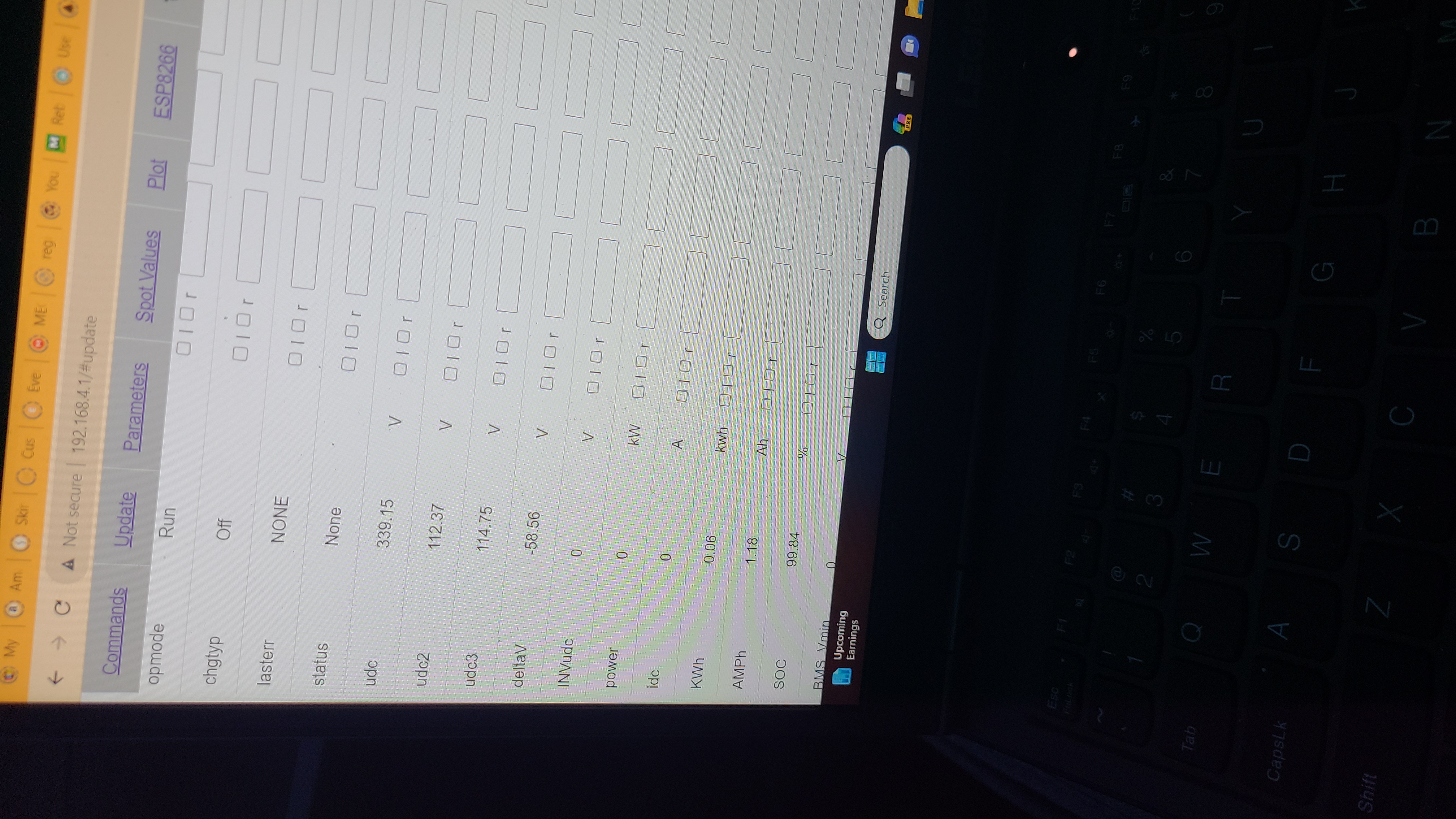

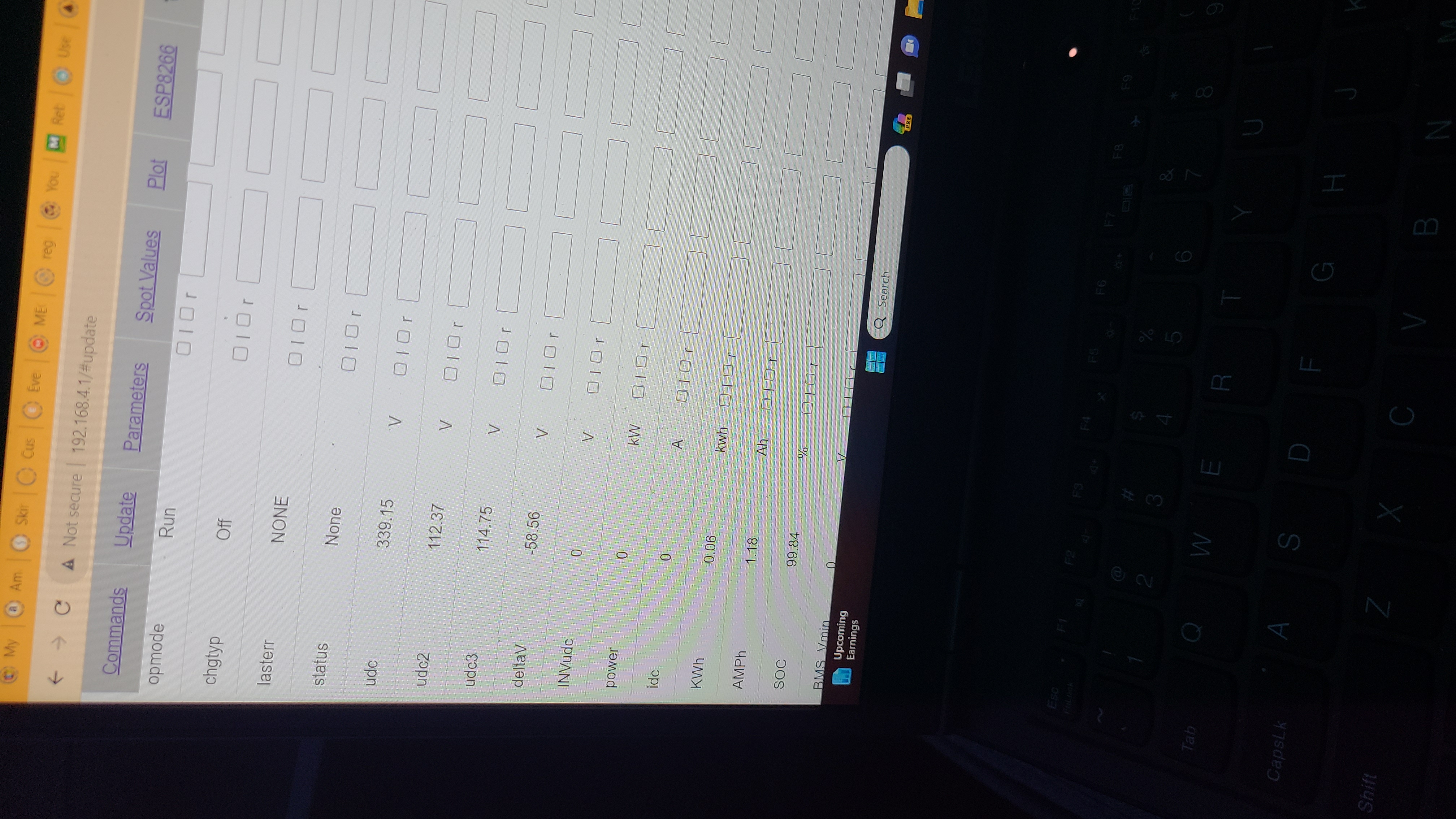

Post by Shockazulu1 »
tom91 wrote: Wed Dec 06, 2023 7:35 pm Did you check the Zombie reported being in Charge Mode when you plugged in to charge?

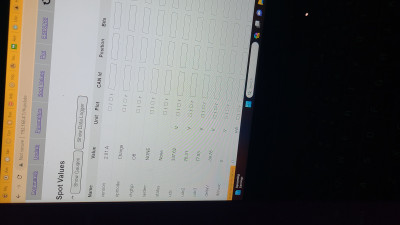

It says
Opmode=run
Chgtyp=off

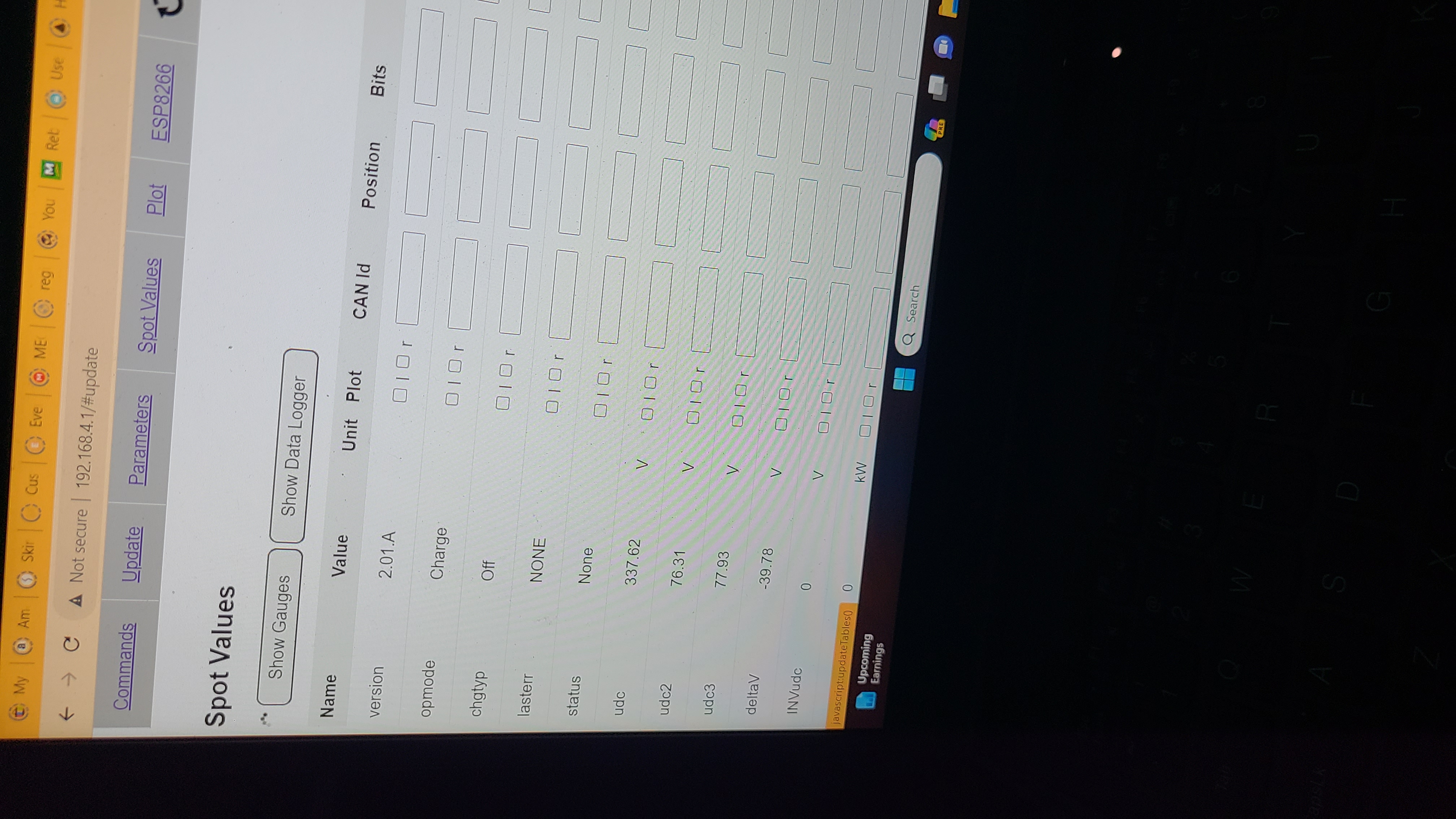

I got something to change.
By switching t15stat to off=I got opmode to switch to charge.
This is basically like turning the ignition switch to off.
Moving forward.
Now after switching off T15stat zombieverter opmode changes from Run to Charge.
I took another canbus log and it appears to still be stopping at the same place.
Savvycan file attached.

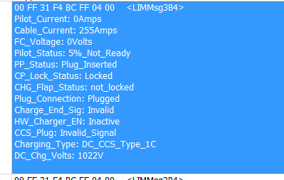

Okay I found the problem, it checks what charger is connected.
It only continues when in message 0x3B4 charging type [byte 6] is equal to 0x09 or otherwise known as DC_CCS_Type_2
Can someone in create a "clean" compile of the STM32_VCU with line 629 in i3LIM.ccp changing:
            if(ChargeType==0x09) lim_stateCnt++;
to
            if(ChargeType==0x04 || ChargeType==0x28|| ChargeType==0x09) lim_stateCnt++;

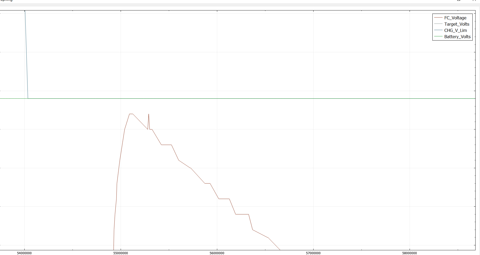

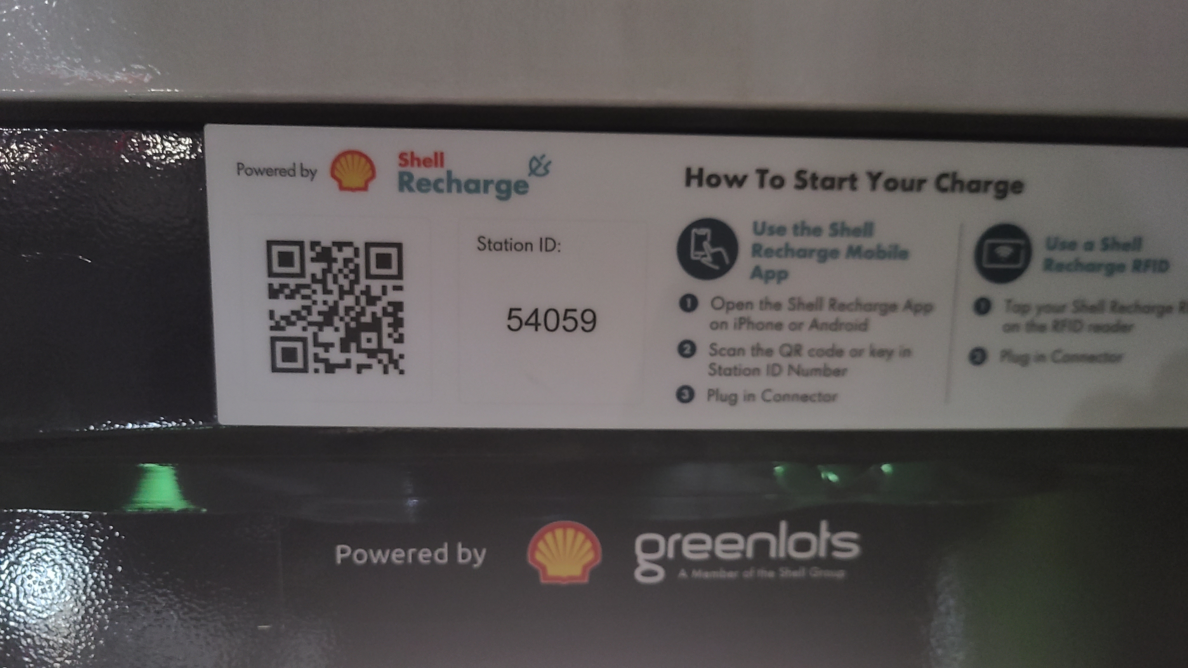

I have spent a few days testing many different CCS1 chargers in my area.
Tested 6 different versions of chargers, works on 5 of them and 1 faults out in state 4.
After the failure at the one failed charger, had Precharge error and would need to run a contactor check before being able to charge at any of the previously tested chargers.
It gets to "2FA Target Charge PH: Subpoena" but doesn't advance to "3E9 Contactor Con: Close"
I am attaching Savvycan Log here.
shell fail state 4.csv

Shockazulu1
Posts: 56
Joined: Mon Jul 03, 2023 2:04 pm
Location: Iowa USA
Has thanked: 91 times
Been thanked: 6 times
Shockazulu1 wrote: Sun Dec 10, 2023 3:23 am I have spent a few days testing many different CCS1 chargers in my area.

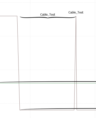

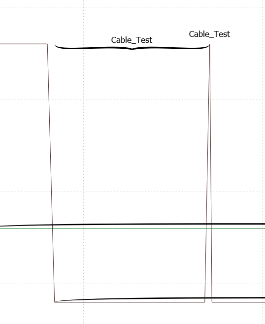

I have a couple theories what is causing the problem with the one difficult charger.
1. The contractor voltage goes up to 330 volts than gradually drops to 80 volts before it fails but the battery is at 350 volts, the contractors don't close because the voltage never has a chance to match.
2. Possibly this charger wants to perform another weld test at this stage. But the only way I can do a weld test is to turn off the charger option for i3. This could be just a problem with the interface for the Zombieverter.

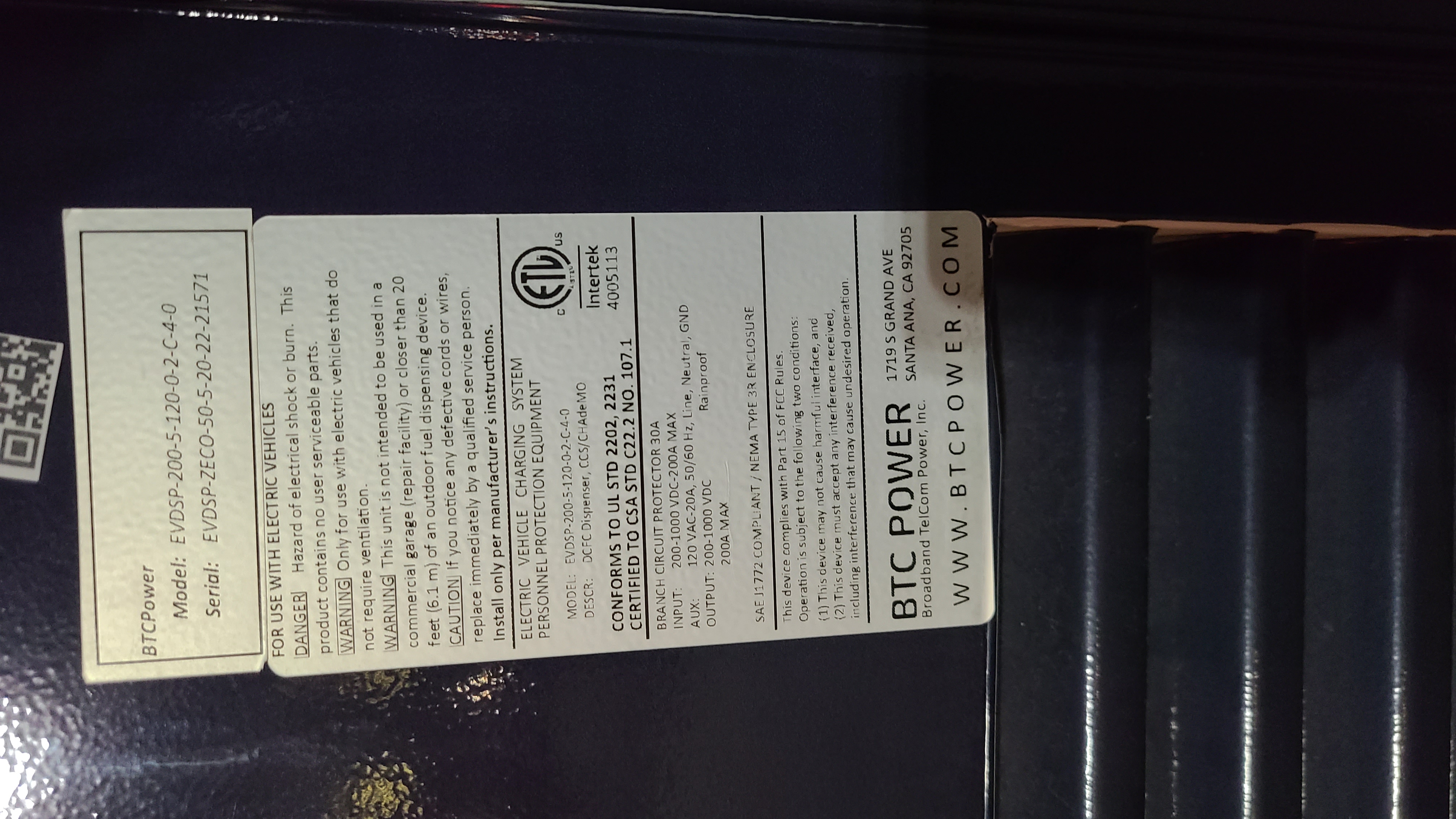

Posts: 2962
Has thanked: 328 times
Been thanked: 847 times
Shockazulu1 wrote: Sun Dec 10, 2023 6:01 pm 1. The contractor voltage goes up to 330 volts than gradually drops to 80 volts before it fails but the battery is at 350 volts, the contractors don't close because the voltage never has a chance to match.
You are wrong, the BMS voltage is listed as 338V during precharge, the Charge port gets upto 330V so it should be trying to go into charge. this should not be the issue.
Unless the charger does not like waiting while the code waits for the voltage to be under 20V difference for 2 seconds.
I also see the target phase blip to Cable test for one message in the log, which seems incorrect.

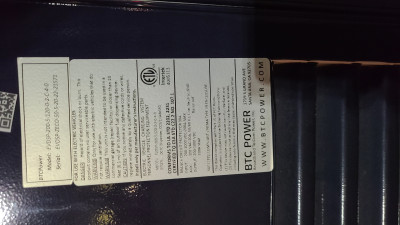

Can you provide a full log from beginning?
Also please provide details of the charger, best be a picture of the name plate on the charger with specs.
Photos of charger info and savvycan log attached.
Failed at state 4.
greenlots failed state 4.csv
(2.46 MiB) Downloaded 1040 times

The log indeed looks like the charger does not want to wait at the requested voltage. It ramps up to it then immediately hits it and stops providing any power to keep it there and thus is just lets its output caps discharge. Very strange compared to any other chargers I have seen.
Question woud be if reducing the software requirement to see the voltage stable above a 20V delta to the requested voltage, will make this charger work.

tom91 wrote: Mon Dec 11, 2023 1:25 am The log indeed looks like the charger does not want to wait at the requested voltage. It ramps up to it then immediately hits it and stops providing any power to keep it there and thus is just lets its output caps discharge. Very strange compared to any other chargers I have seen.
I'm willing to try it.
