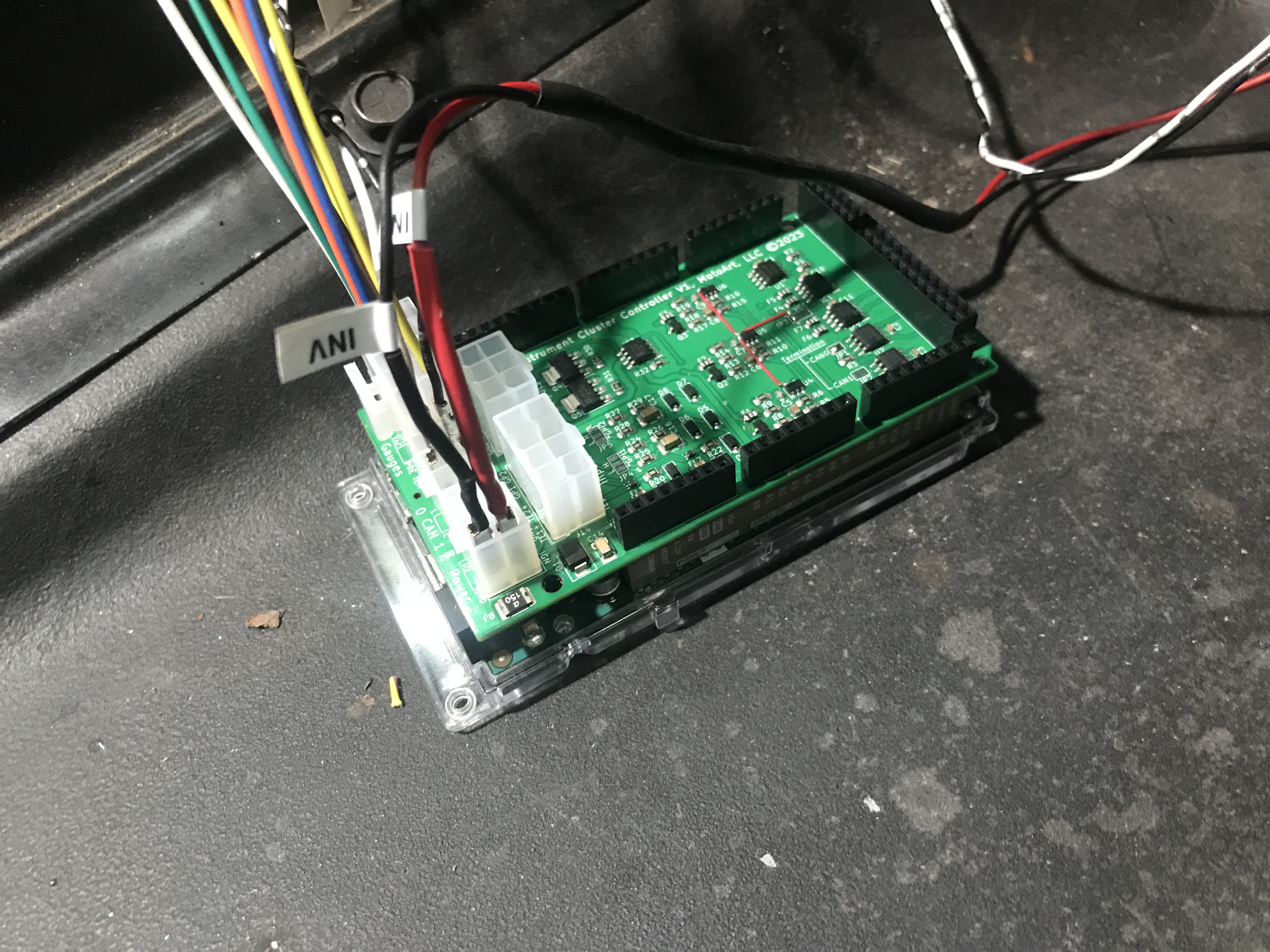

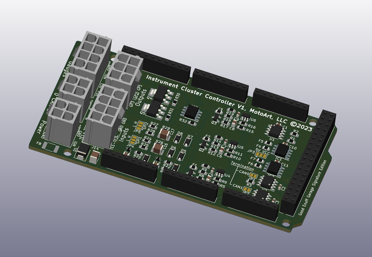

Artur introduces the MotoArt Instrument Cluster Controller shield for the Arduino Due, we hope this can serve as a universal controller for OEM gauges in "classic" vehicles like mine (and I use that term loosely, aka old, rat rods, lol)

Wonderful, thank you for your interest, we are editing a full length video and hope to have it up soon, in the meantime here is the final short teaser clip on the extra features and additional things this shield can do
- Gregski
- Posts: 2873
- Has thanked: 530 times
- Been thanked: 1189 times
Re: [DRIVING]1971 GMCe Lexus GS450H BMW 530e Tesla Model S powered Electruck
custom shield for the Arduino Due to run your OEM(ish) gauges in an EV Conversion just dropped
more info will be provided on arturk's GitHub soon:

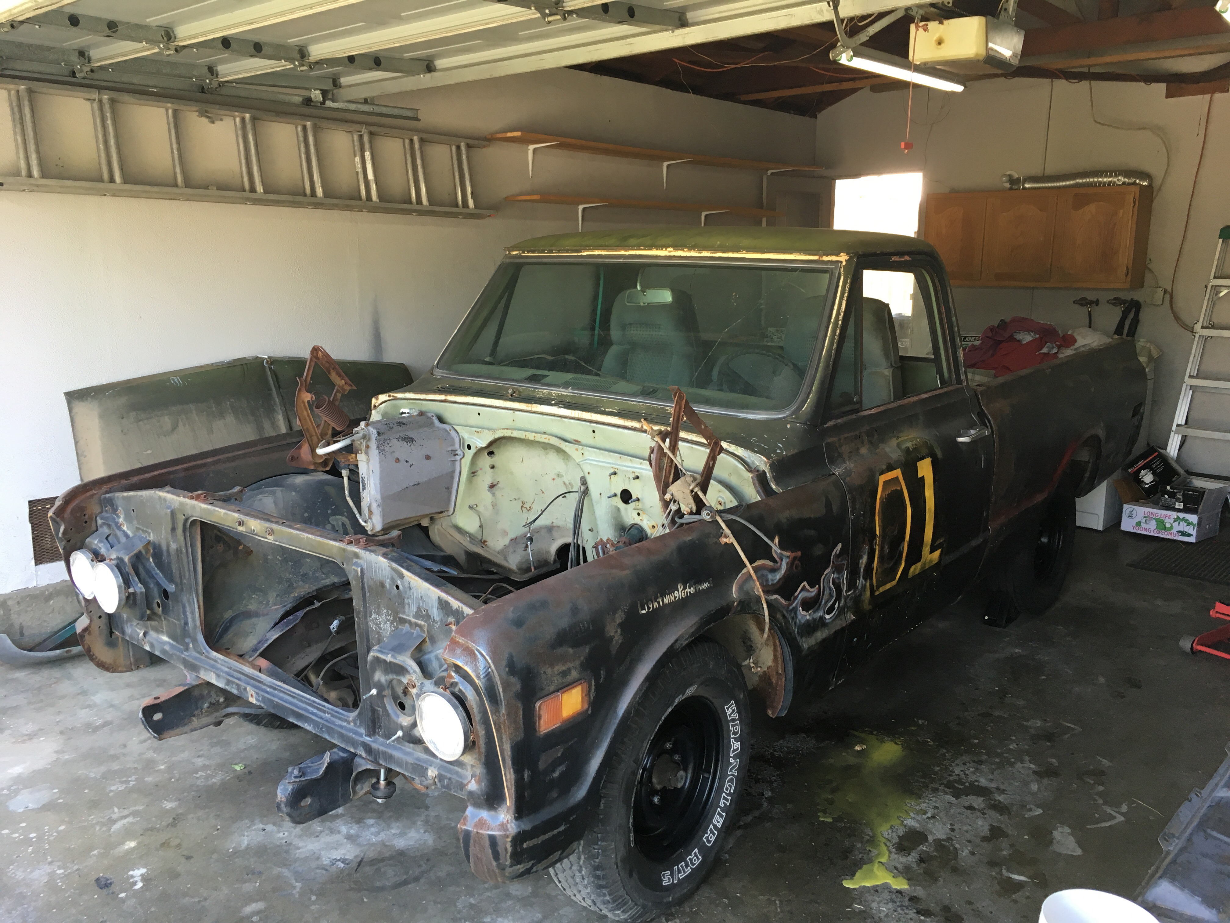

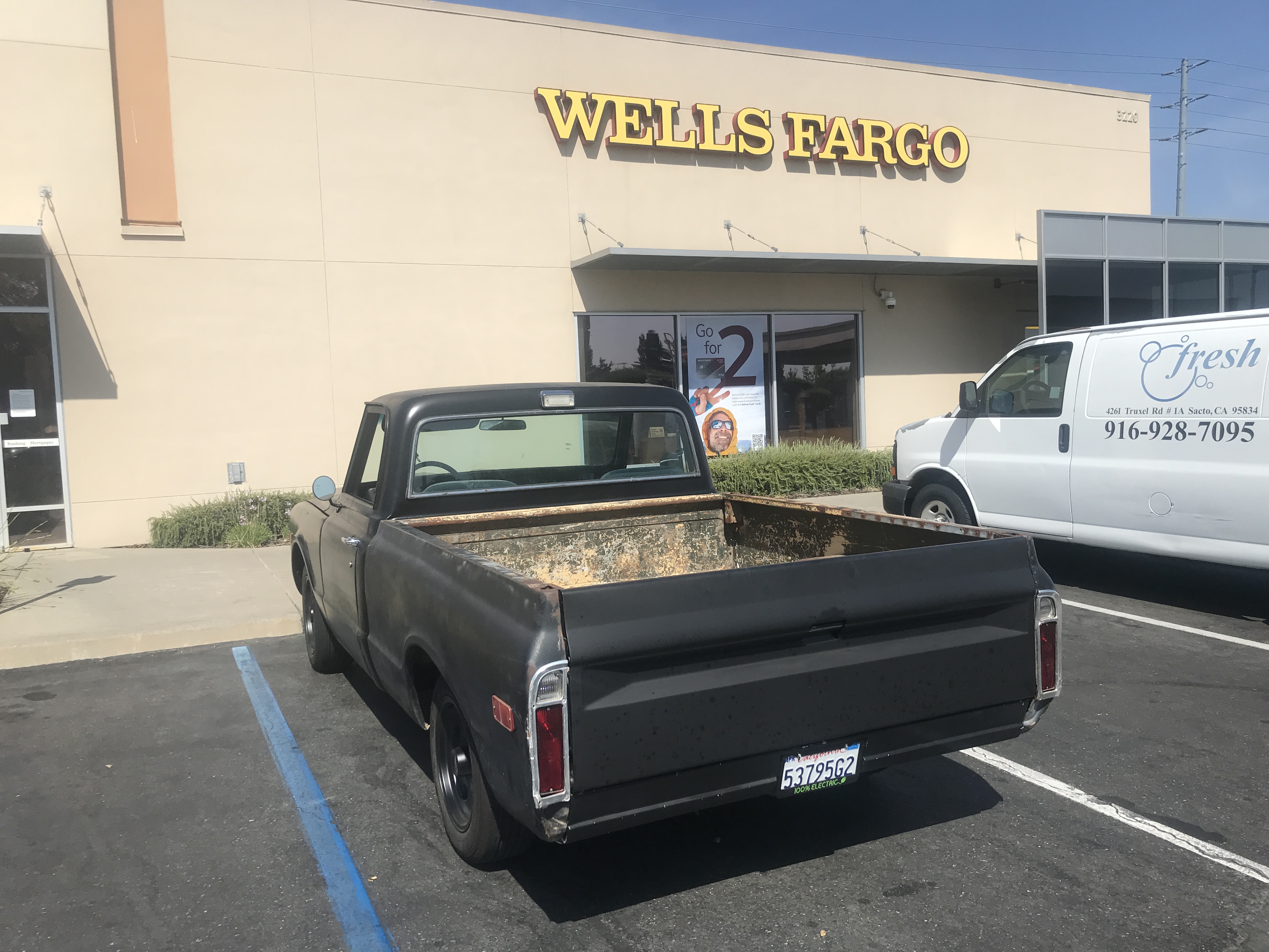

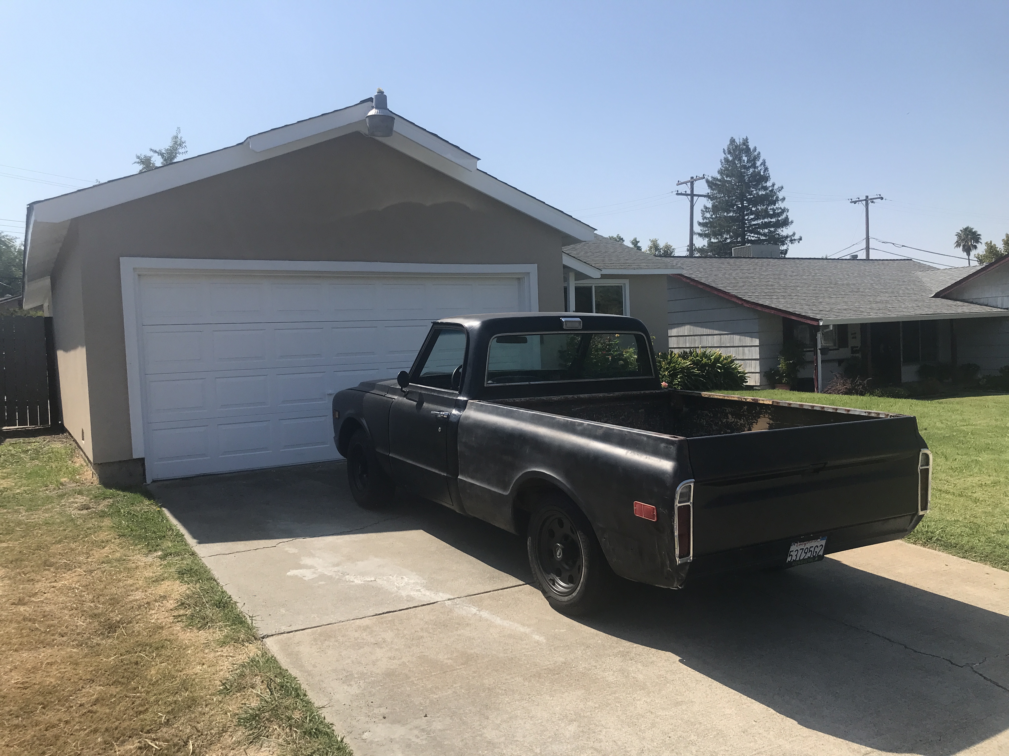

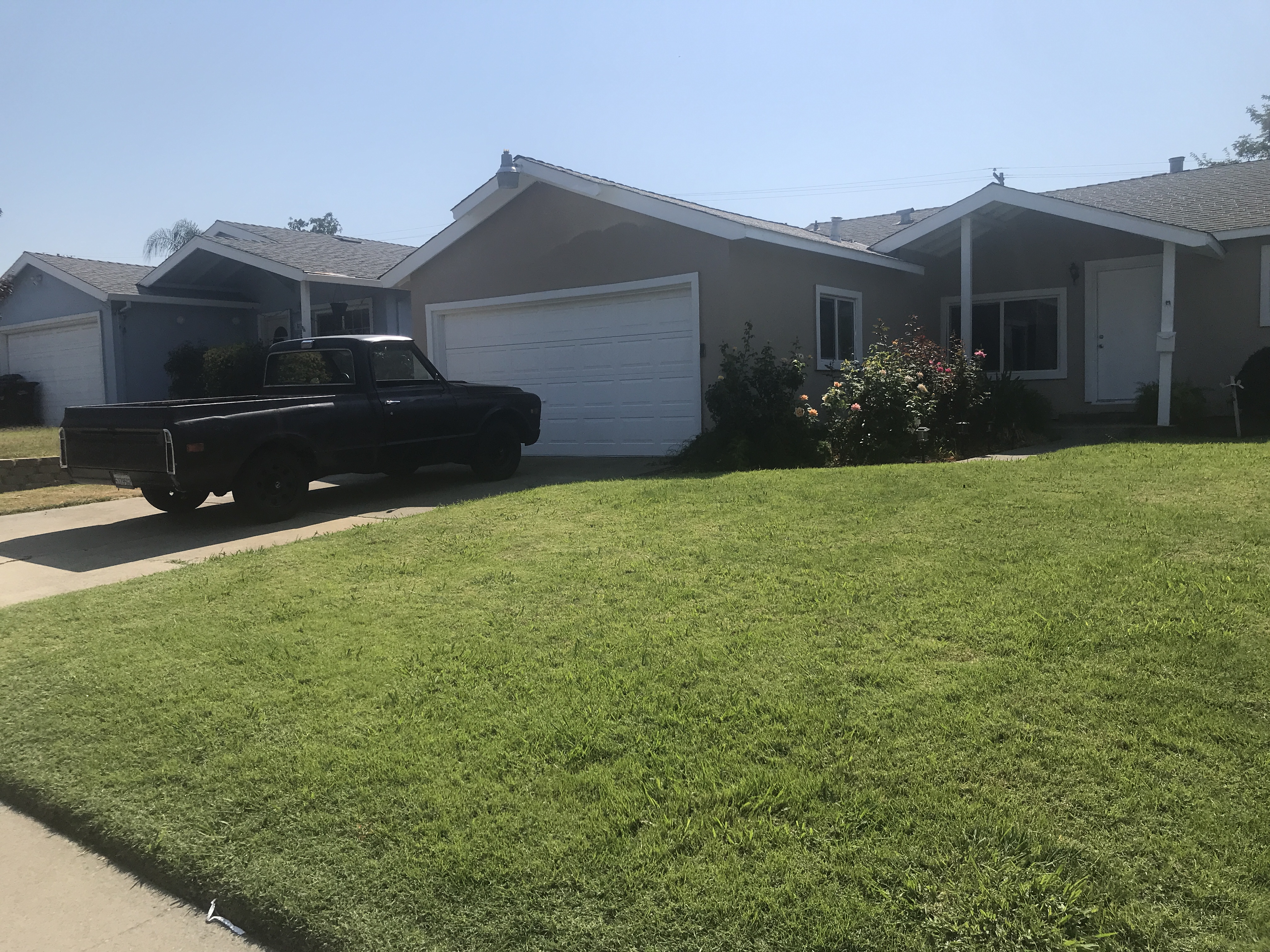

So I bought this truck back in 2017 as a Mom & Son project to force myself to spend more time with my newly retired mother. [that's a big lie] the truck was a total POS and her house was closer to the seller's place than my house, so I two wheel UHAUL car trailered it there instead ! but it's the thought that counts
we did wrench on it together and took a ton of pics which then I lost when my SSD failed literally as I was backing stuff up to the Google
Destination: Mom's House, where it all begin
Distance: 13 miles
Terrain: Streets (no freeway)
and here she is back where it all begin: (yup took mum around the block in this one, like I have done in all my prior builds)
have fun with all your projects you all, be silly with it, enjoy it !!!

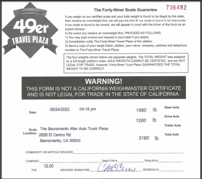

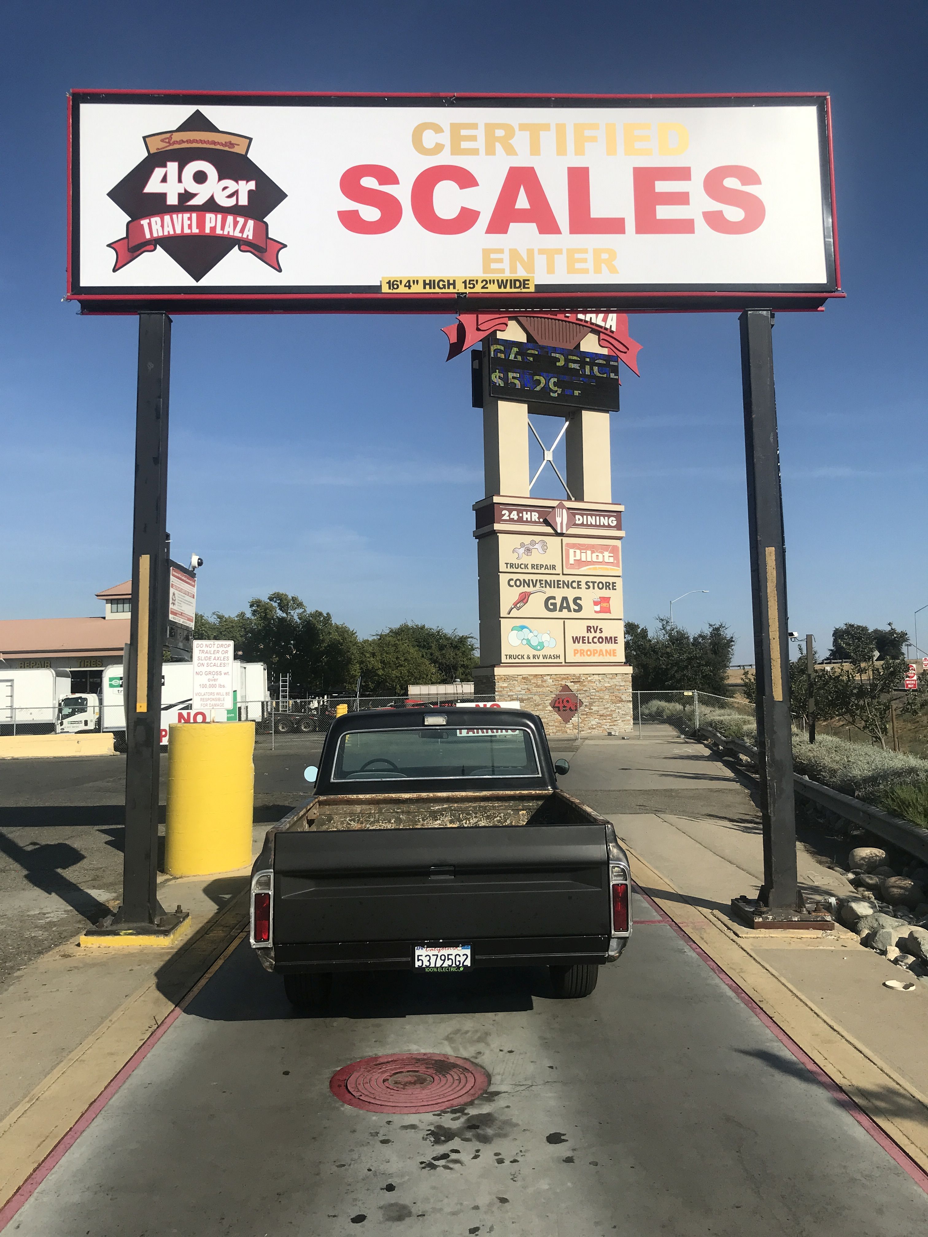

POST EV CONVERSION VEHICLE WEIGHT
* with only one of three 180 lb battery packs
here she is lighter than an albino color blind flea with an eating disorder, minus the door glass
Front: 1,880 lbs
Rear: 1,280 lbs
TOTAL: 3,160 lbs
Front: 1,880 lbs
Rear: 1,280 lbs
TOTAL: 3,160 lbs

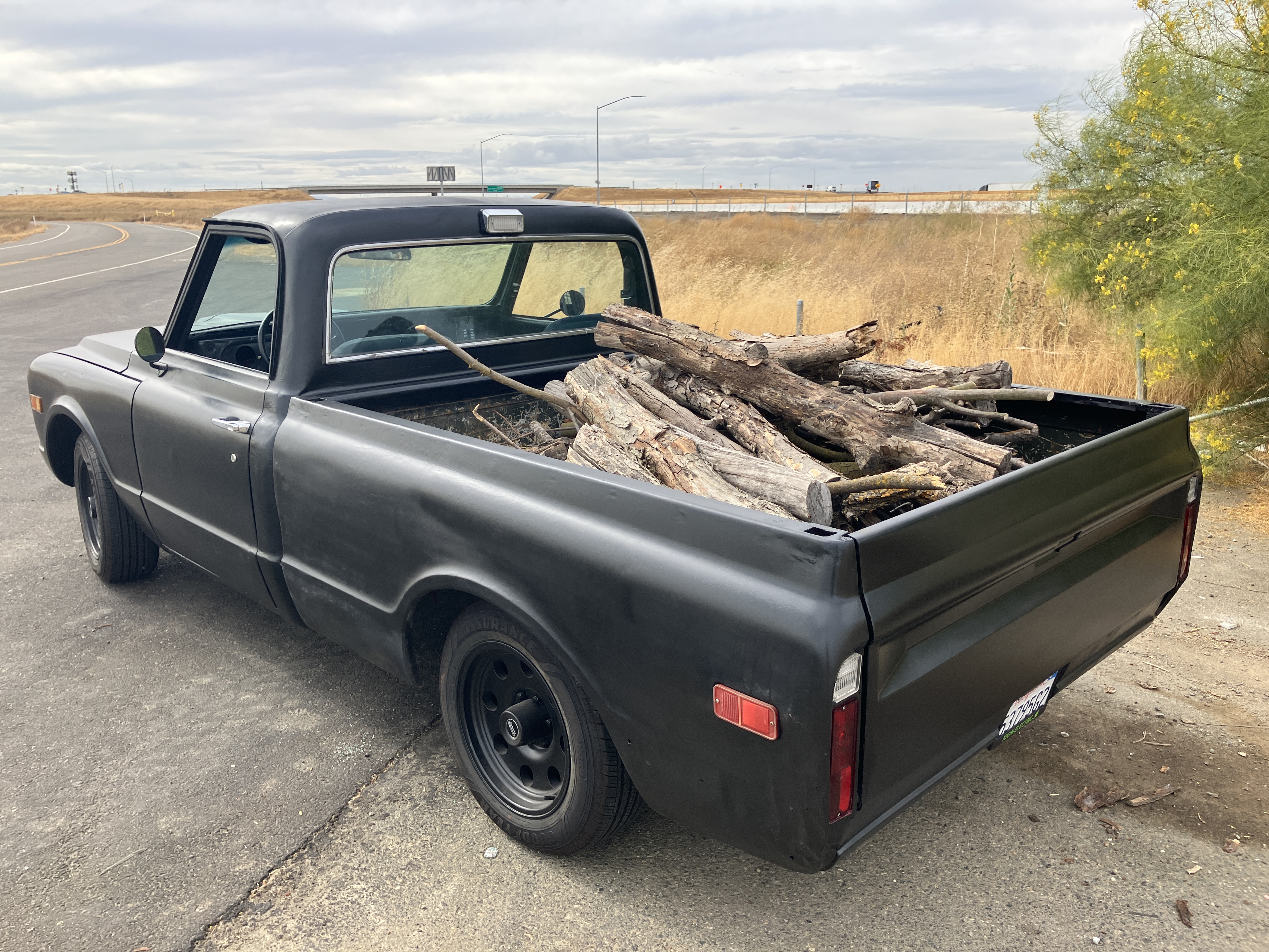

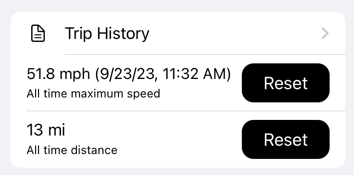

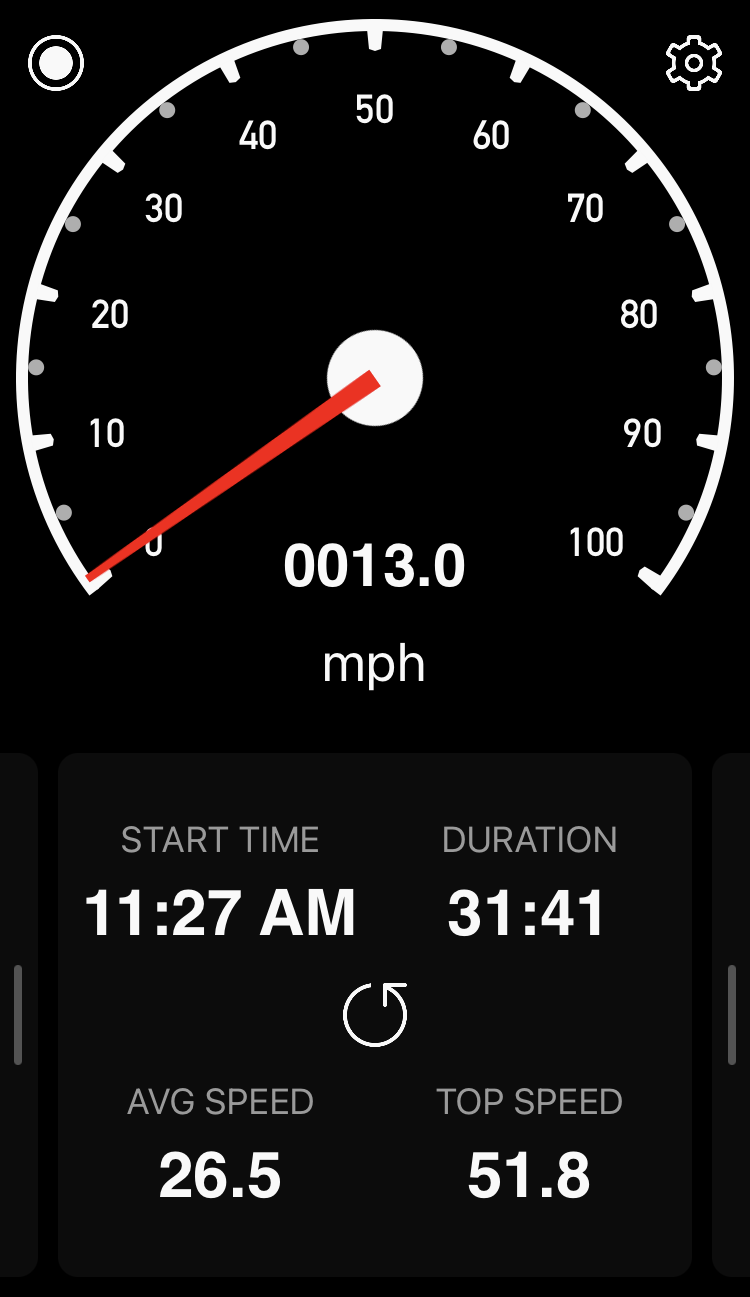

TOP SPEED TEST #2
Still Powered by MG2 Only
88.9 MPH
Explanations Not Excuses:
88.9 MPH
- I don't have BMS so I am only charging to 90% capacity
- I have to drive out to the test site and that depletes my battery a bit already
- No windows in my doors yet, and I can feel the gushes of wind
- 3.73 stock rear differential gears, and I know nothing about differential gears

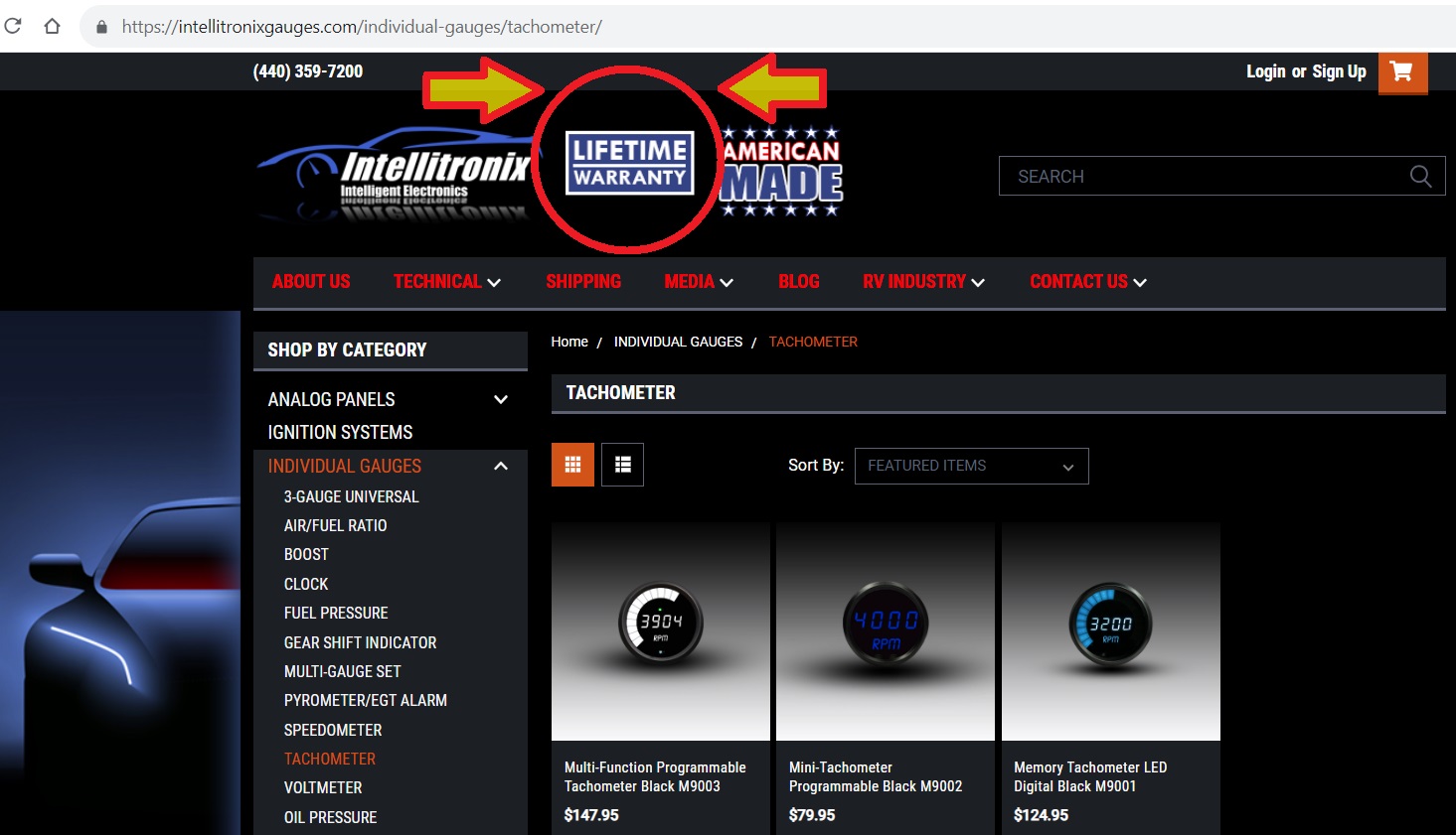

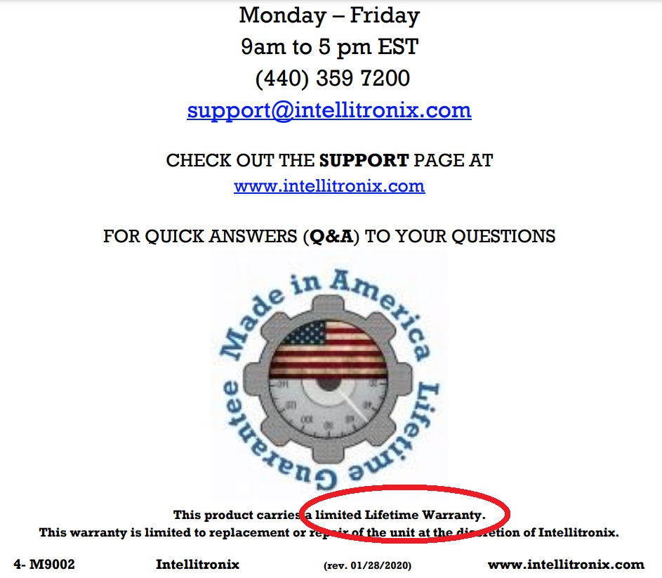

Lifetime Warranty, we shall see about that, ha ha
two tachs, two speedos, one volt gauge and one oil pressure gauge of for warranty repairs

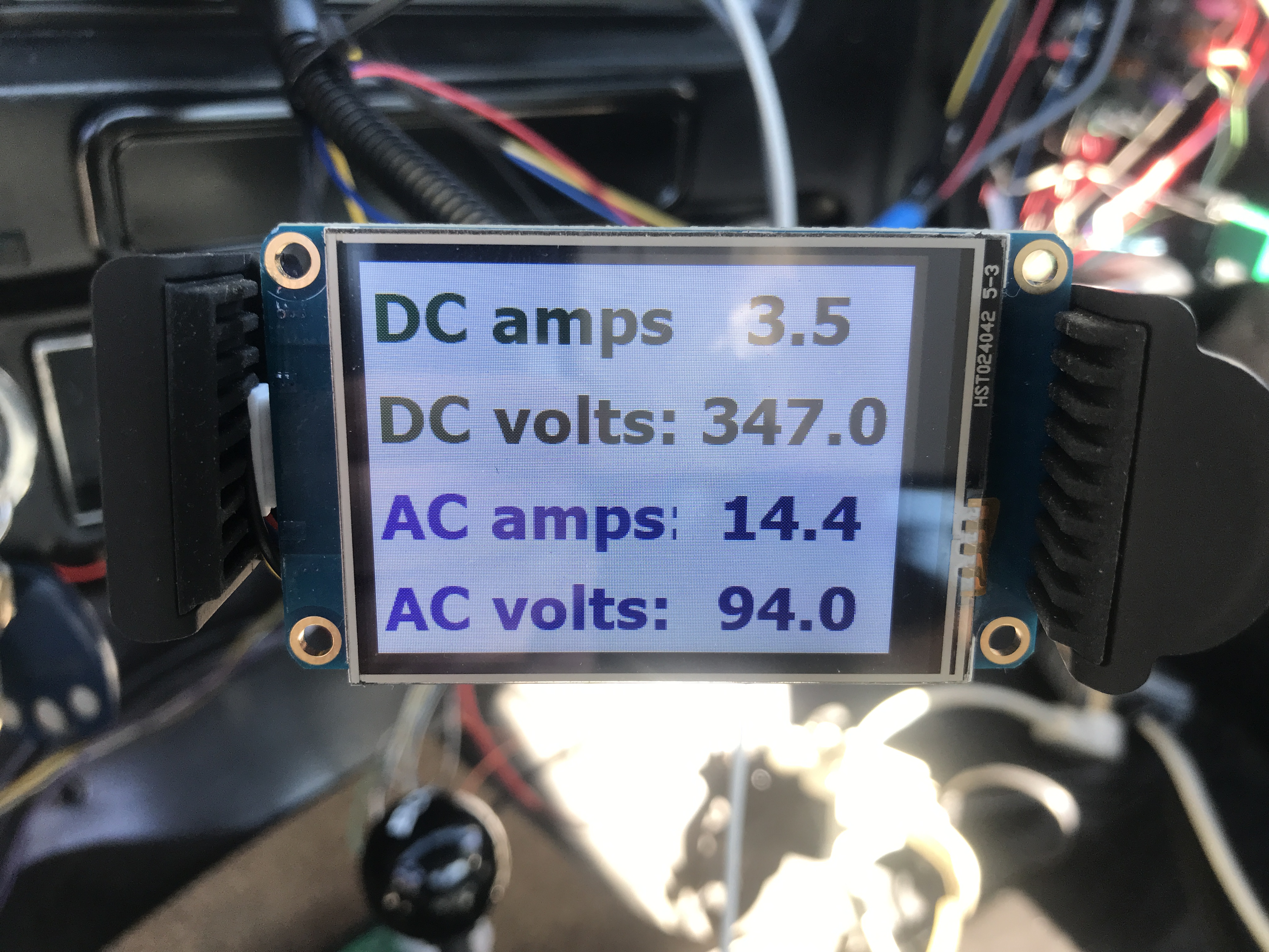

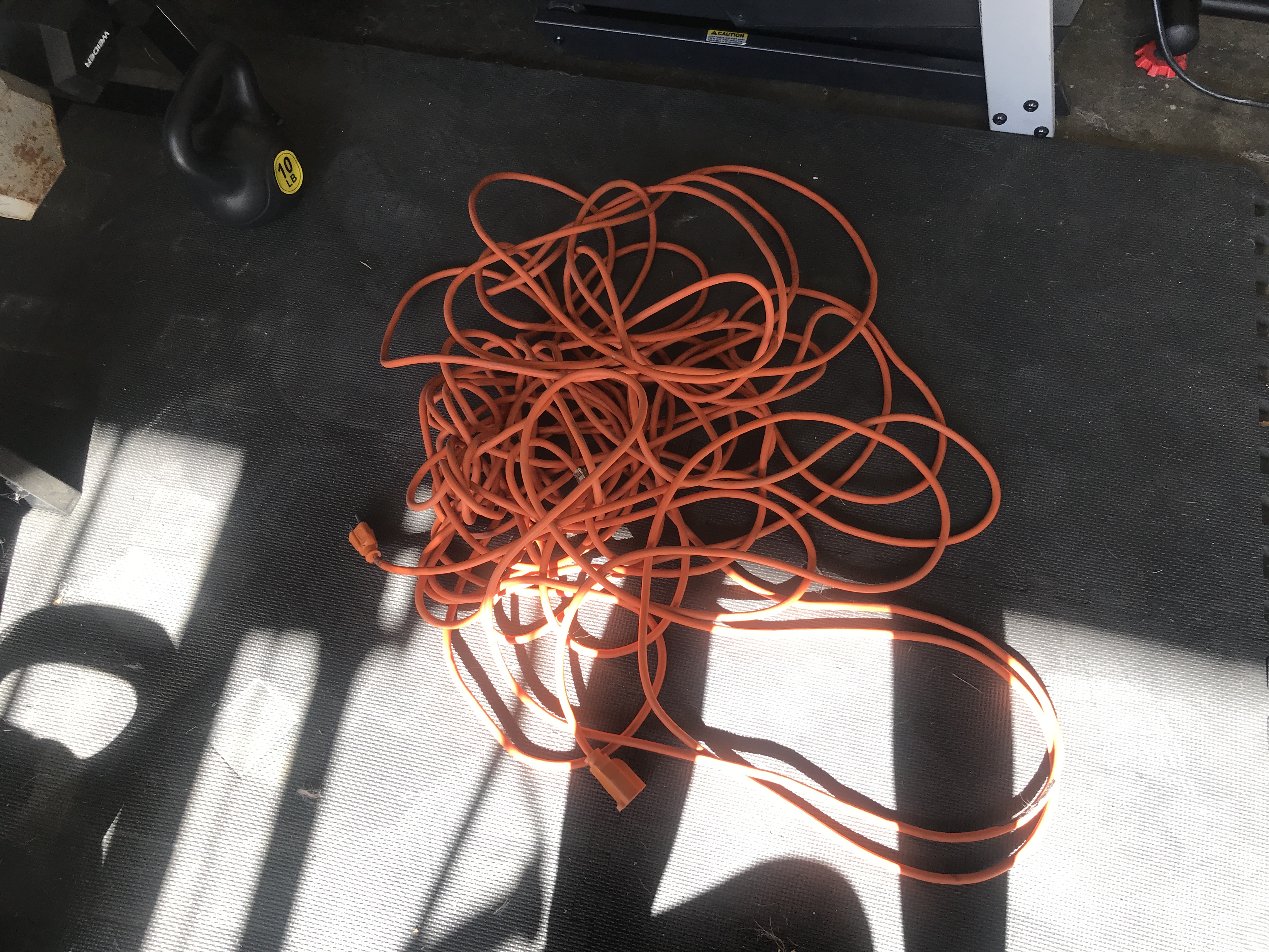

EV Charging Lessons Learned
Stay away from long extensions cords.
So drove Black Sunshine to my mates house and he offered me the world's longest extension cord so that I could charge, and this is what we saw on the Charge-O-Meter 3000
we was pulling 14 amps on a 15 amp circuit at only 90 volts, no bueno
and this is after we replaced it with a 20 footer

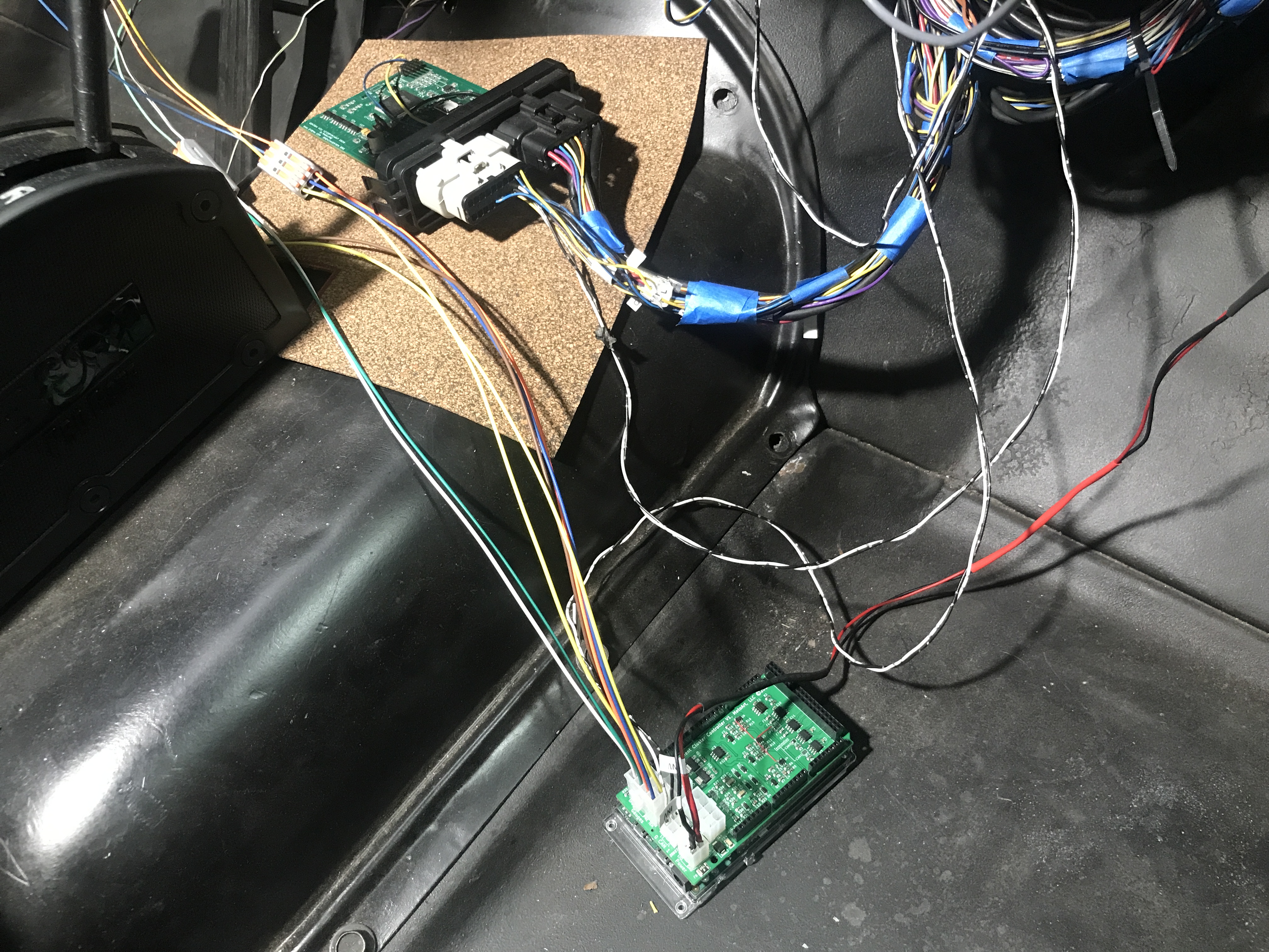

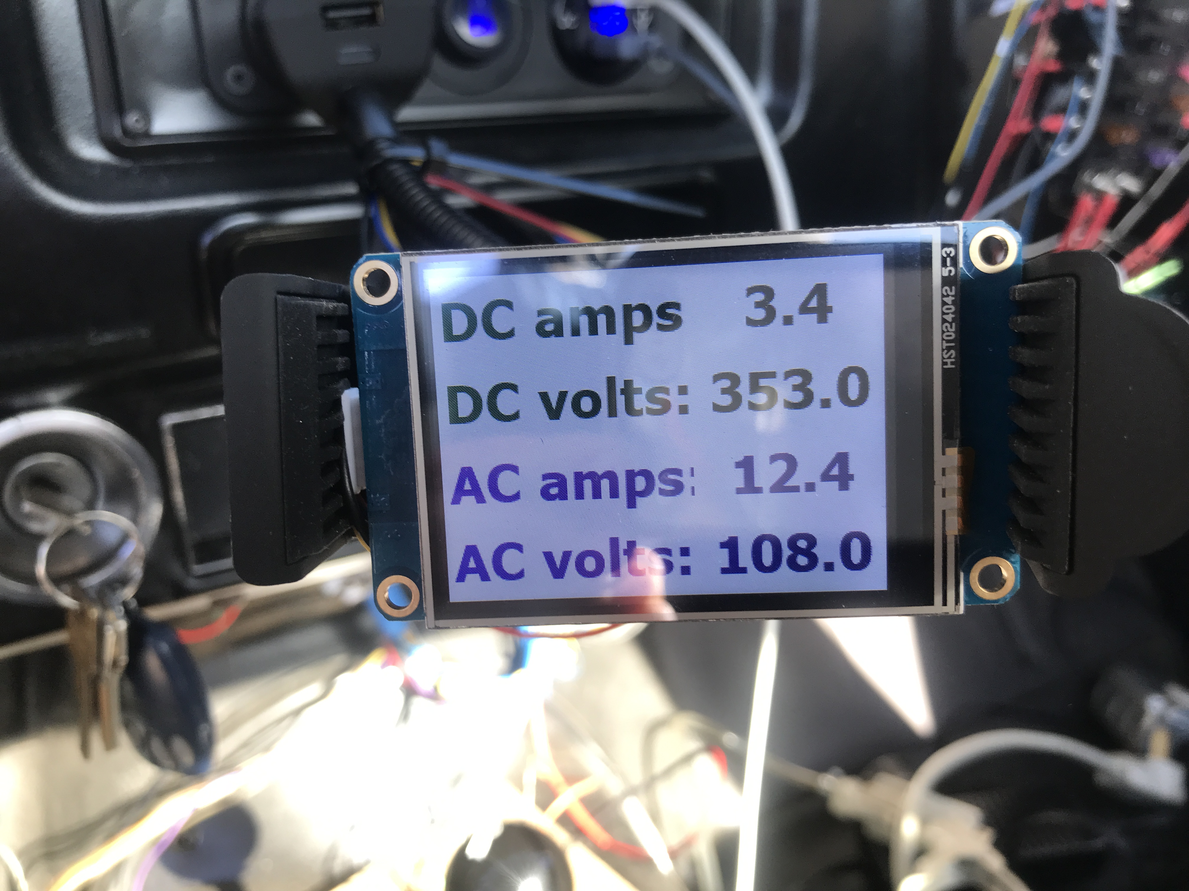

so let's start off with a little background, I am still using the older hardware sometimes referred to as Ver 2, basically the predecessor to the ZombieVerter, and don't get me wrong I like it, I mean I love it. However I found myself battling over do I try and make it do everything, ie one black box solution, or do I use multiple task specific boards/controllers instead
What I quickly learned while attempting to have the VCU display information to my little 2.4" Nextion display is that the VCU can't keep up, nor should it have to, it's friggen busy controlling your car, ha ha. Without geeking out too much the code that runs on it has better things to do and it needs to do them super fast, for example every 10 milliseconds [that's programmer talk for: "100 times a second"] that's friggen fast, and here I am trying to interrupt that process just to see what amps I am pulling as I drive to Starbucks
There are also hardware limitations, the VCU only has one PWM connector/pin. This is used to manage the speed of the Lexus transmission electric oil pump speed, as it should be, after all it is a Lexus GS450h VCU not a Do Everything VCU, so it can't also manage the Tesla water pump
So somethings it can't do, due to software or processing and others it can't do due to hardware limitations, but guess what it can do charging. It can do charging because charging is mutually exclusive from driving, in other words you don't charge when you drive, and you don't drive when you charge. But should it do the charging and can it do EVSE charging / charging at Public Stations? I don't know, this battle continues to take place in my noggin, but that's ok now that things are working this is a good problem to have.
and so this is where we are at, I have a working VCU that controls my vehicle when I drive, and it controls my 1st gen Chevy Volt charger when I [ahem] don't drive, ha ha
- Posts: 3660
- Has thanked: 145 times
- Been thanked: 368 times
Ok you are correct vcu shouldnt operate driving functions when charging. That should save some bandwith.
You may also try using watchdog in case VCU gets overloaded often...
