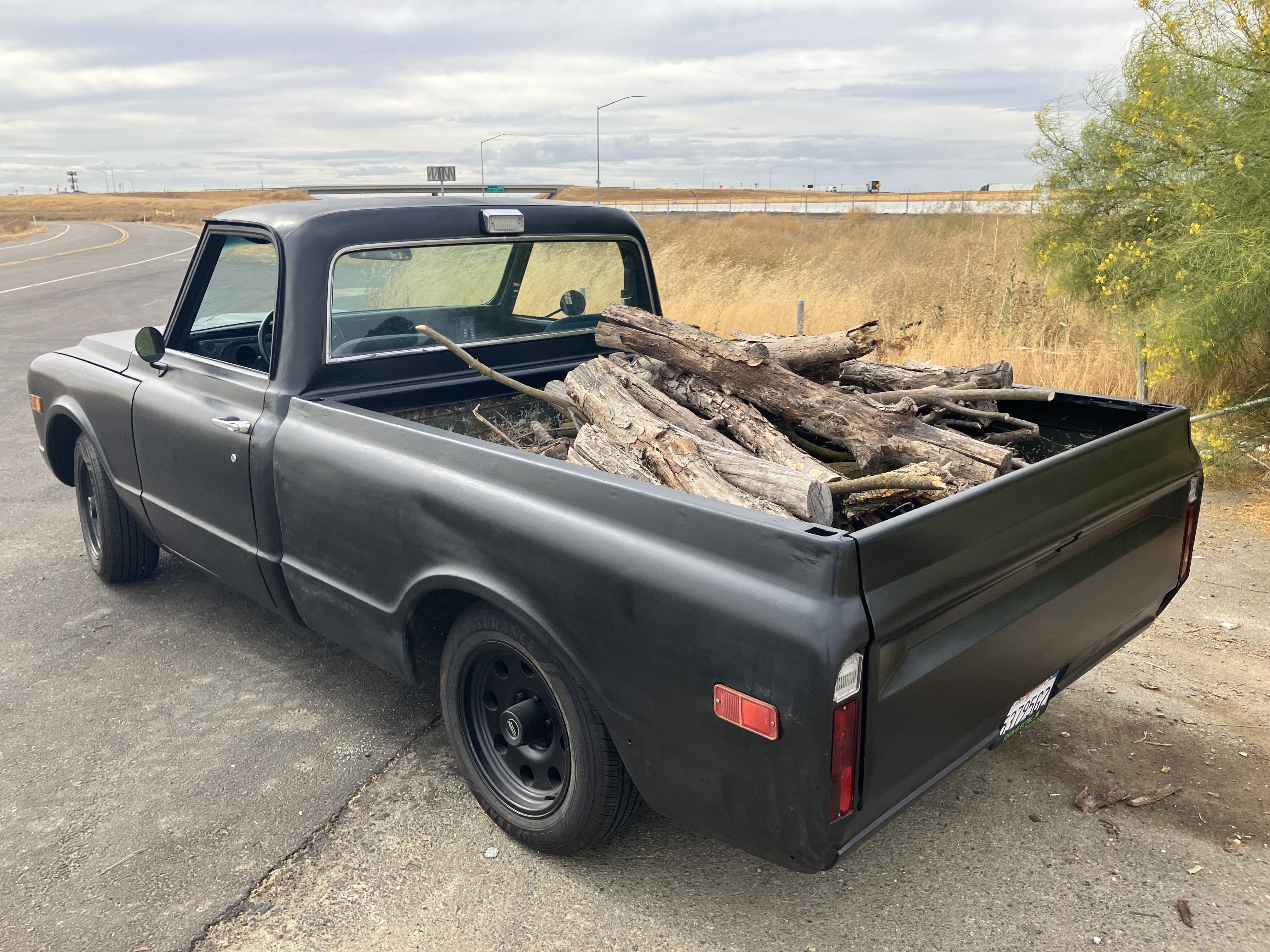

So I bought this truck back in 2017 as a Mom & Son project to force myself to spend more time with my newly retired mother. [that's a big lie] the truck was a total POS and her house was closer to the seller's place than my house, so I two wheel UHAUL car trailered it there instead ! but it's the thought that counts
we did wrench on it together and took a ton of pics which then I lost when my SSD failed literally as I was backing stuff up to the Google
Destination: Mom's House, where it all begin
Distance: 13 miles
Terrain: Streets (no freeway)
and here she is back where it all begin: (yup took mum around the block in this one, like I have done in all my prior builds)
have fun with all your projects you all, be silly with it, enjoy it !!!

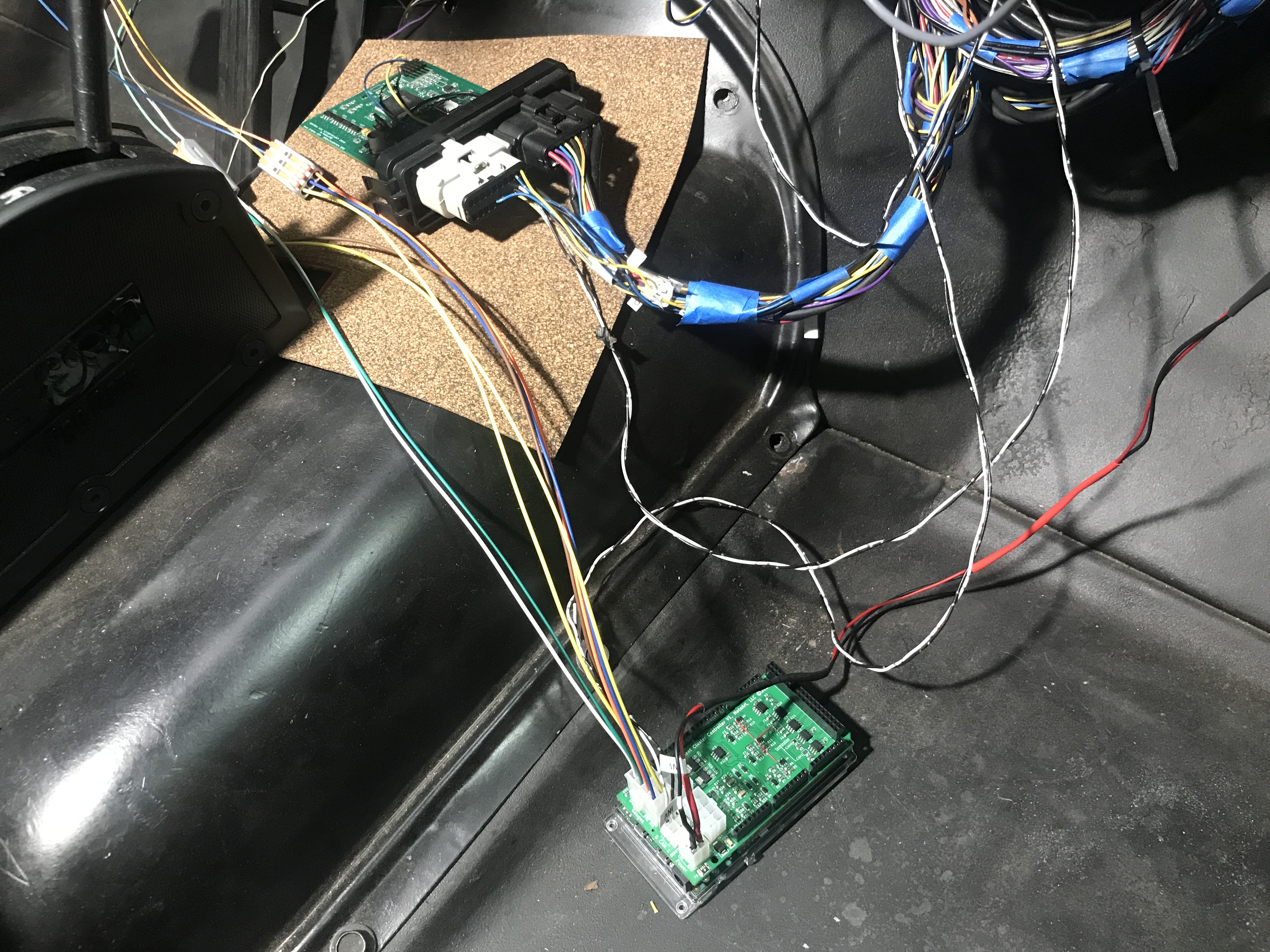

... so after 1 month of driving my newly converted truck to electric it's time to share what I have learned so far
Gregski
Posts: 3164
Has thanked: 633 times
Been thanked: 1610 times
Re: [DRIVING]1971 GMCe Lexus GS450H BMW 530e Tesla Model S powered Electruck
Post by Gregski »
so let's start off with a little background, I am still using the older hardware sometimes referred to as Ver 2, basically the predecessor to the ZombieVerter, and don't get me wrong I like it, I mean I love it. However I found myself battling over do I try and make it do everything, ie one black box solution, or do I use multiple task specific boards/controllers instead
What I quickly learned while attempting to have the VCU display information to my little 2.4" Nextion display is that the VCU can't keep up, nor should it have to, it's friggen busy controlling your car, ha ha. Without geeking out too much the code that runs on it has better things to do and it needs to do them super fast, for example every 10 milliseconds [that's programmer talk for: "100 times a second"] that's friggen fast, and here I am trying to interrupt that process just to see what amps I am pulling as I drive to Starbucks
There are also hardware limitations, the VCU only has one PWM connector/pin. This is used to manage the speed of the Lexus transmission electric oil pump speed, as it should be, after all it is a Lexus GS450h VCU not a Do Everything VCU, so it can't also manage the Tesla water pump
So somethings it can't do, due to software or processing and others it can't do due to hardware limitations, but guess what it can do charging. It can do charging because charging is mutually exclusive from driving, in other words you don't charge when you drive, and you don't drive when you charge. But should it do the charging and can it do EVSE charging / charging at Public Stations? I don't know, this battle continues to take place in my noggin, but that's ok now that things are working this is a good problem to have.
and so this is where we are at, I have a working VCU that controls my vehicle when I drive, and it controls my 1st gen Chevy Volt charger when I [ahem] don't drive, ha ha
Posts: 3796
Been thanked: 413 times
Ok you are correct vcu shouldnt operate driving functions when charging. That should save some bandwith.
You may also try using watchdog in case VCU gets overloaded often...
