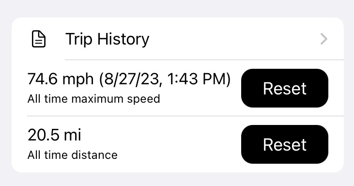

so got some numbers for you all after the first attempt at a Range Test, I say first attempt cause I did do some dumb things like try to get it up to 75 miles an hour for no reason on streets not freeways
so I ran out of juice after only 20.5 miles, but before you take that to the bank, we were NOT fully charged to begin with (maybe only up to 370 volts I forget, and fully charged is 398) and I only have one of the two battery packs that I own installed at the minute

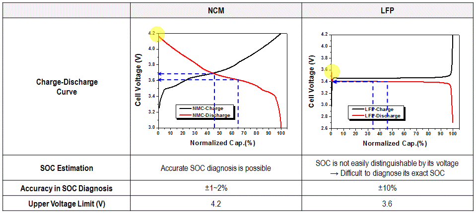

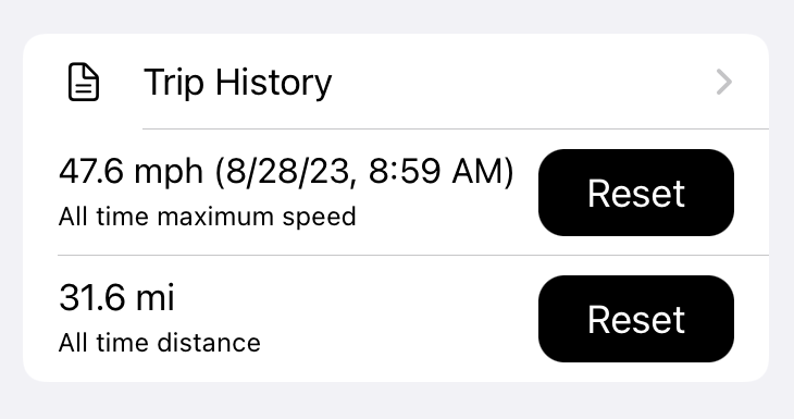

Range Test #2 - just over 30 miles
this time I charged up to 389 volts, still not even 90% but we nearly hit the coveted 3.5 miles per killer watt, so this was all city streets and residential, no freeway driving, but no babying it either, and no hyeprmiling or any of that Prius jazz, ha ha
interesting observation, seems like the volts drop very steadily as you drive until they hit 300, then you best get home right quick cause from 300 down to 270 and kaput goes by in a blink of an eye seems like
marcexec
Posts: 239
Location: Dublin, Ireland
Has thanked: 1044 times
Been thanked: 111 times
Post by marcexec »
There's very little capacity at those low voltages:
source
I would avoid discharge below 3.30V/cell, it gets you very little benefit for a lot more wear / reduced cycles, same on the top above 4.10V.

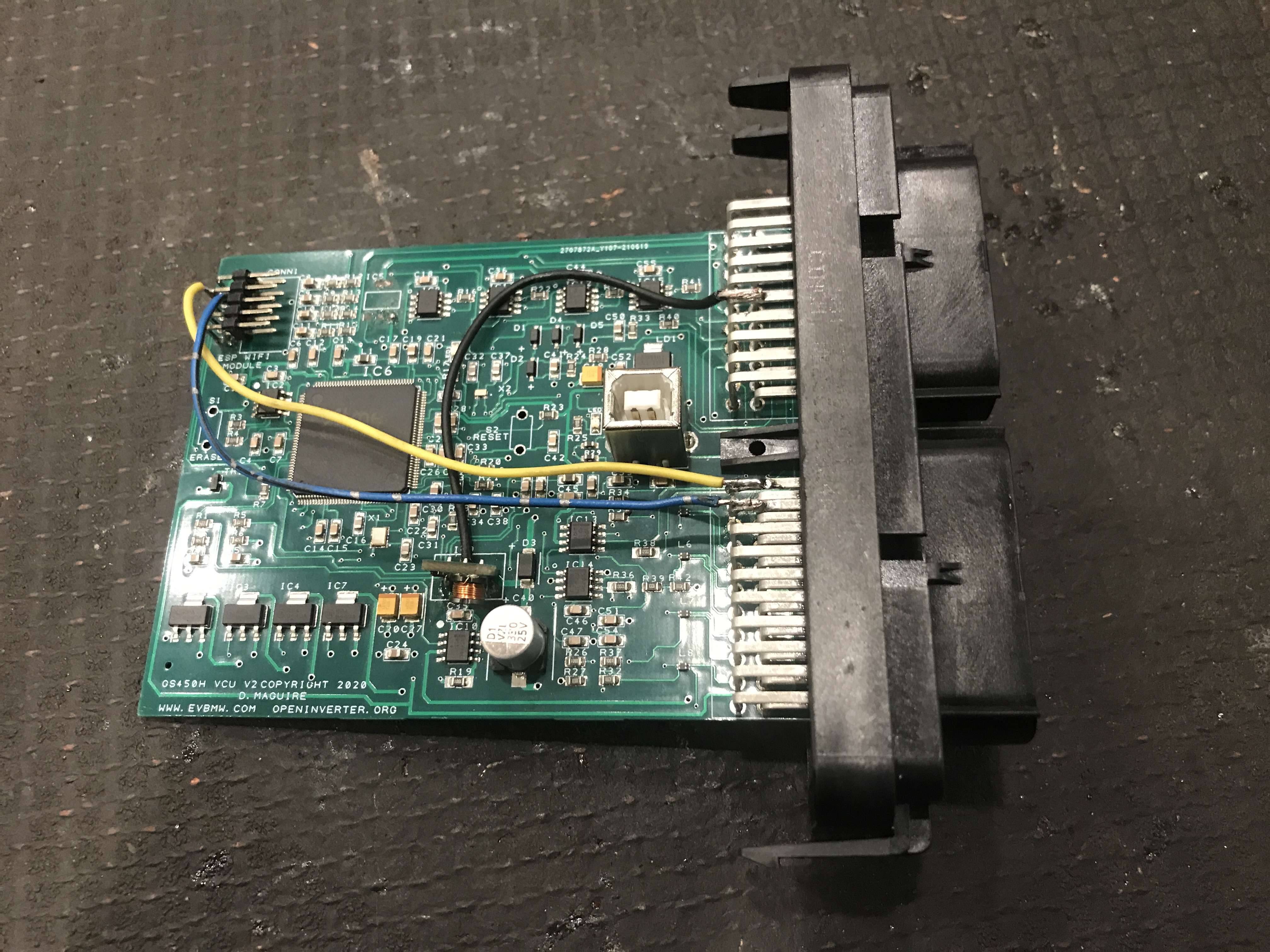

attempted a little silliness today to see if we could pipe out the data to the Nextion display actually using a couple non implemented connector pins
a little hack-a-thon on pins #9 and #10 of the A Connector
Gregski
Posts: 3164
Has thanked: 635 times
Been thanked: 1610 times
Post by Gregski »
then it was time to link the RX / TX pins from the WiFi UEXT 10 pin connector to those on the A Connector
and we can still plug in the little red rascal if we want to
