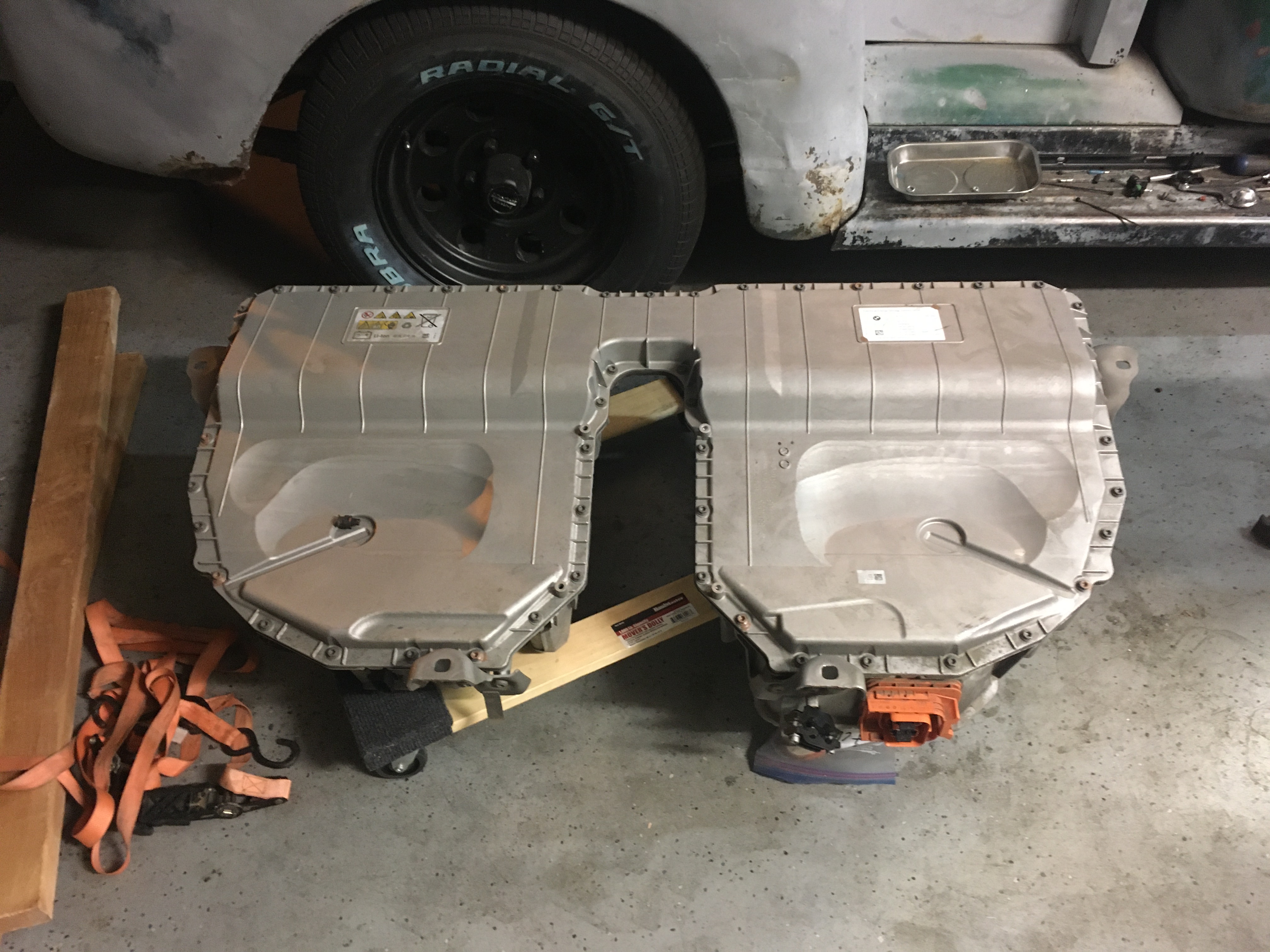

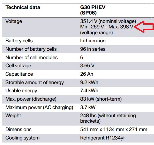

Alright, I've waited forever to do this so today we are going to do some unofficial RANGE TESTS, meaning I still have not fully charged this 9.1 kW (killer whale) battery pack to 100% capacity which the specs claim to be 398 vultures, maybe some day I will comprehend how to charge a 351 volt battery back to 398 volts, to me it's like pouring 6 gallons worth of water into a 5 gallon bucket [but then again a "12 volt" car battery can read 13.5 volts so what do I know]

Post by RetroZero »
Think of nominal battery voltage - 351v, as being the in-between of max and min operation voltages

Post by Gregski »
RetroZero wrote: Sun Aug 27, 2023 7:35 pm Think of nominal battery voltage - 351v, as being the in-between of max and min operation voltages
luv that explanation, makes sense to this brain, thank you

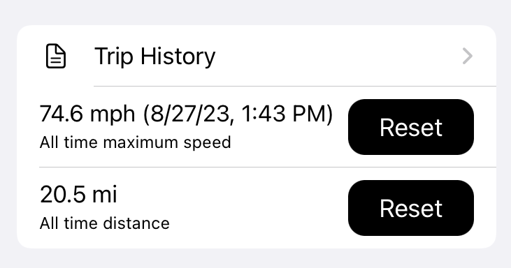

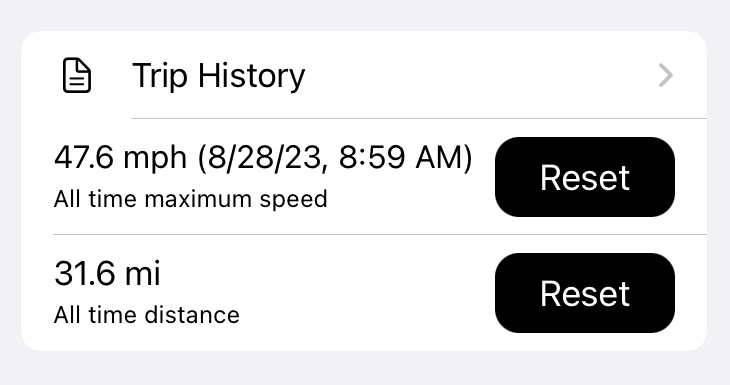

so got some numbers for you all after the first attempt at a Range Test, I say first attempt cause I did do some dumb things like try to get it up to 75 miles an hour for no reason on streets not freeways
so I ran out of juice after only 20.5 miles, but before you take that to the bank, we were NOT fully charged to begin with (maybe only up to 370 volts I forget, and fully charged is 398) and I only have one of the two battery packs that I own installed at the minute

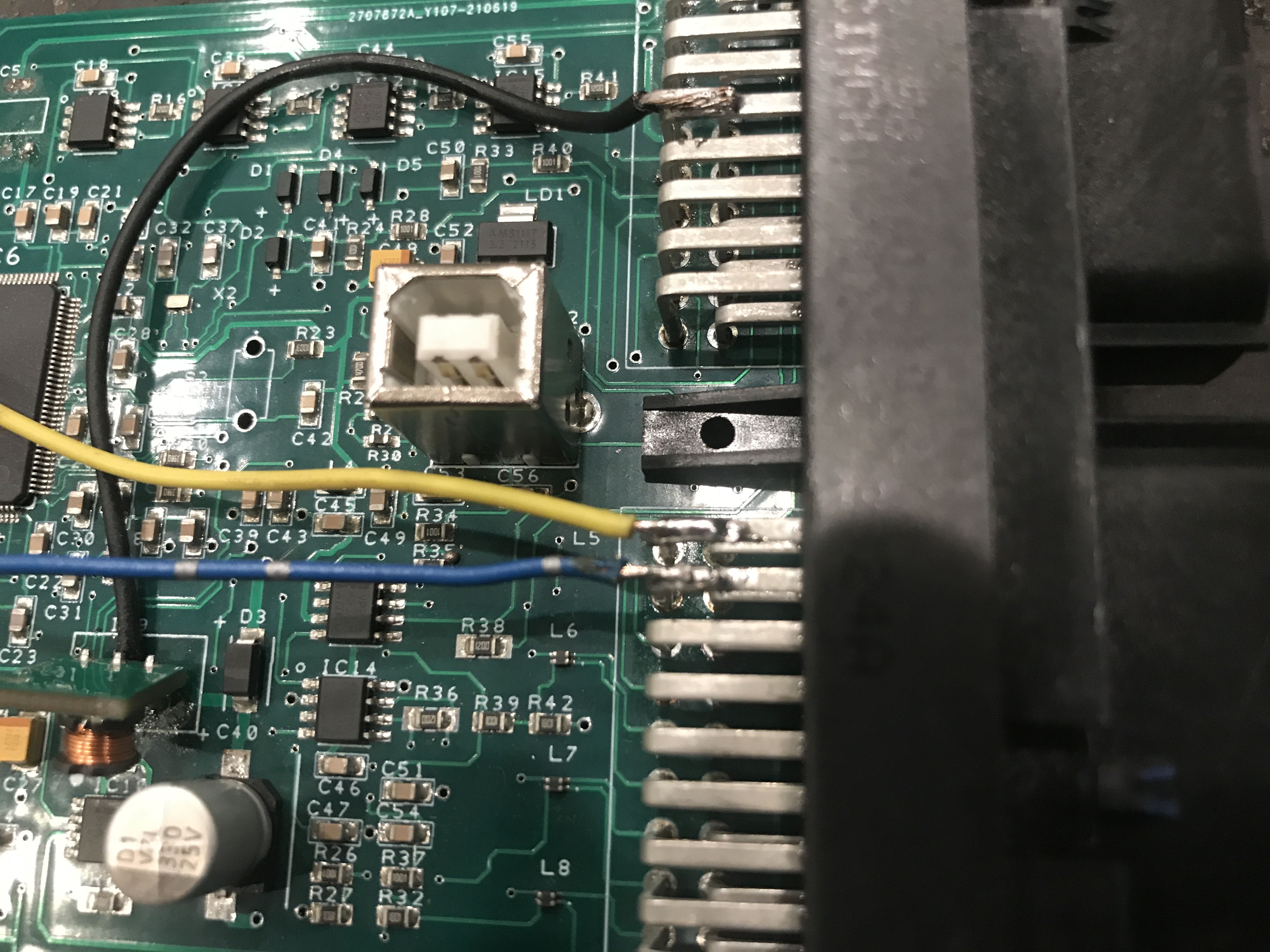

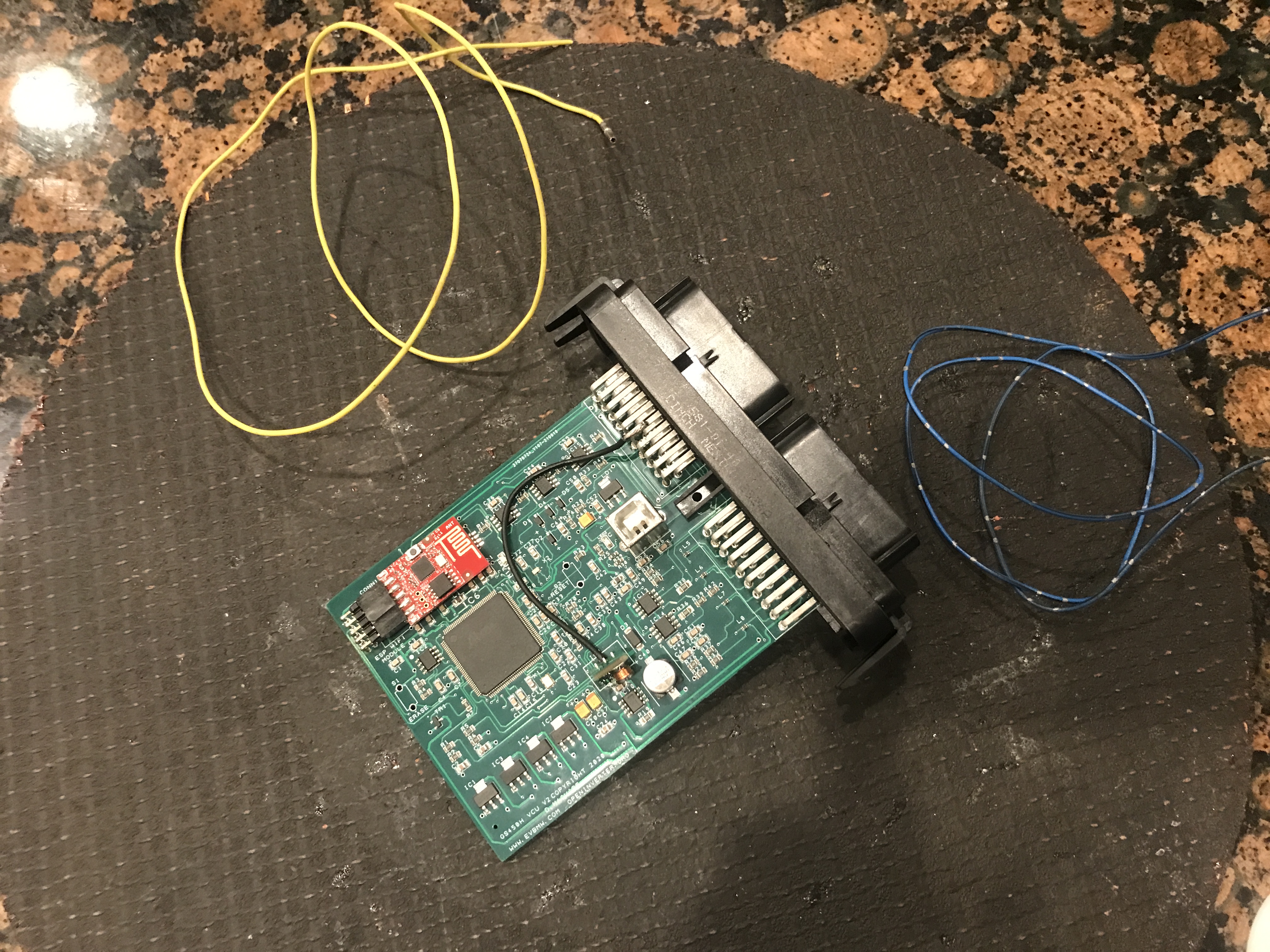

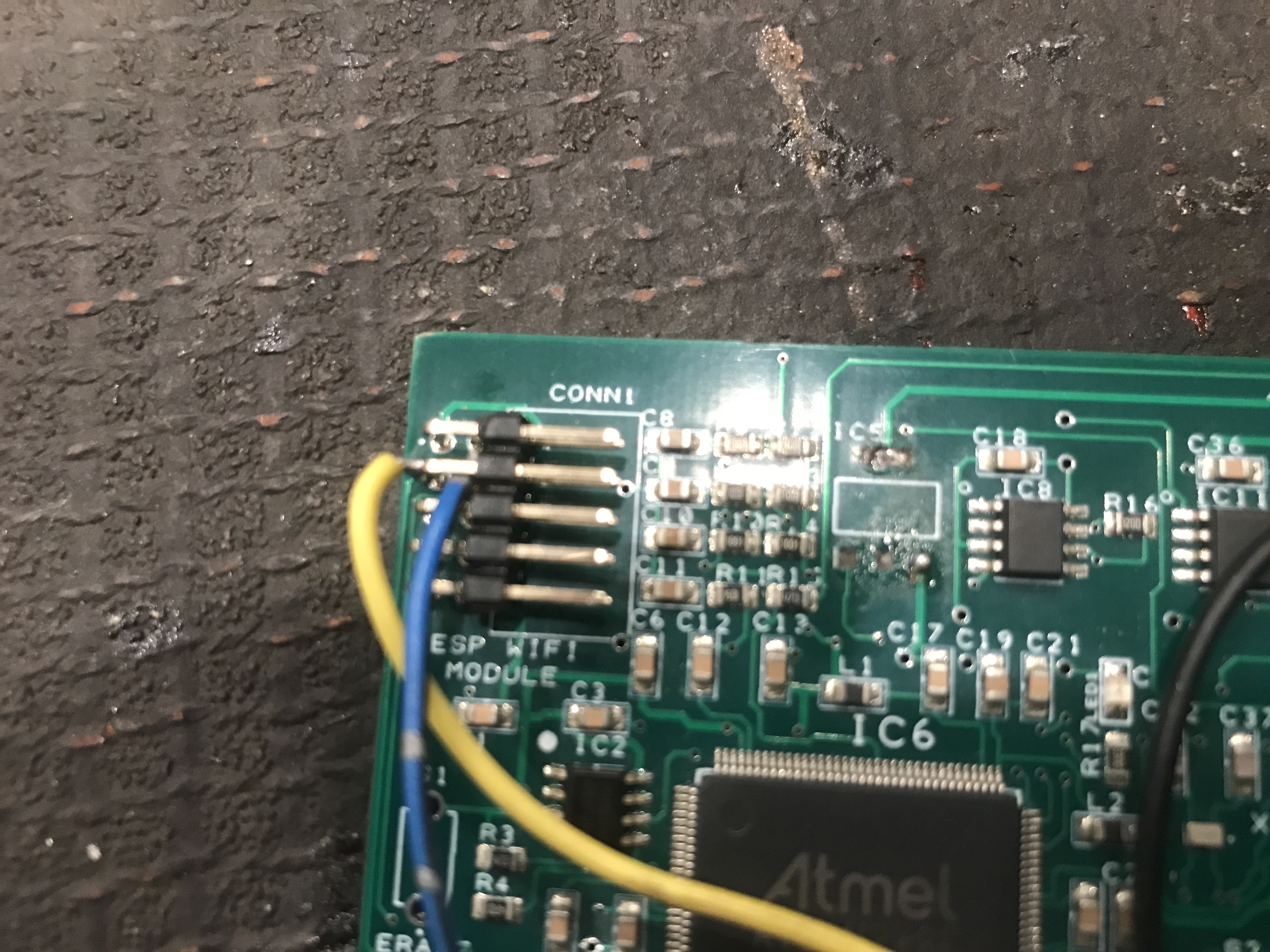

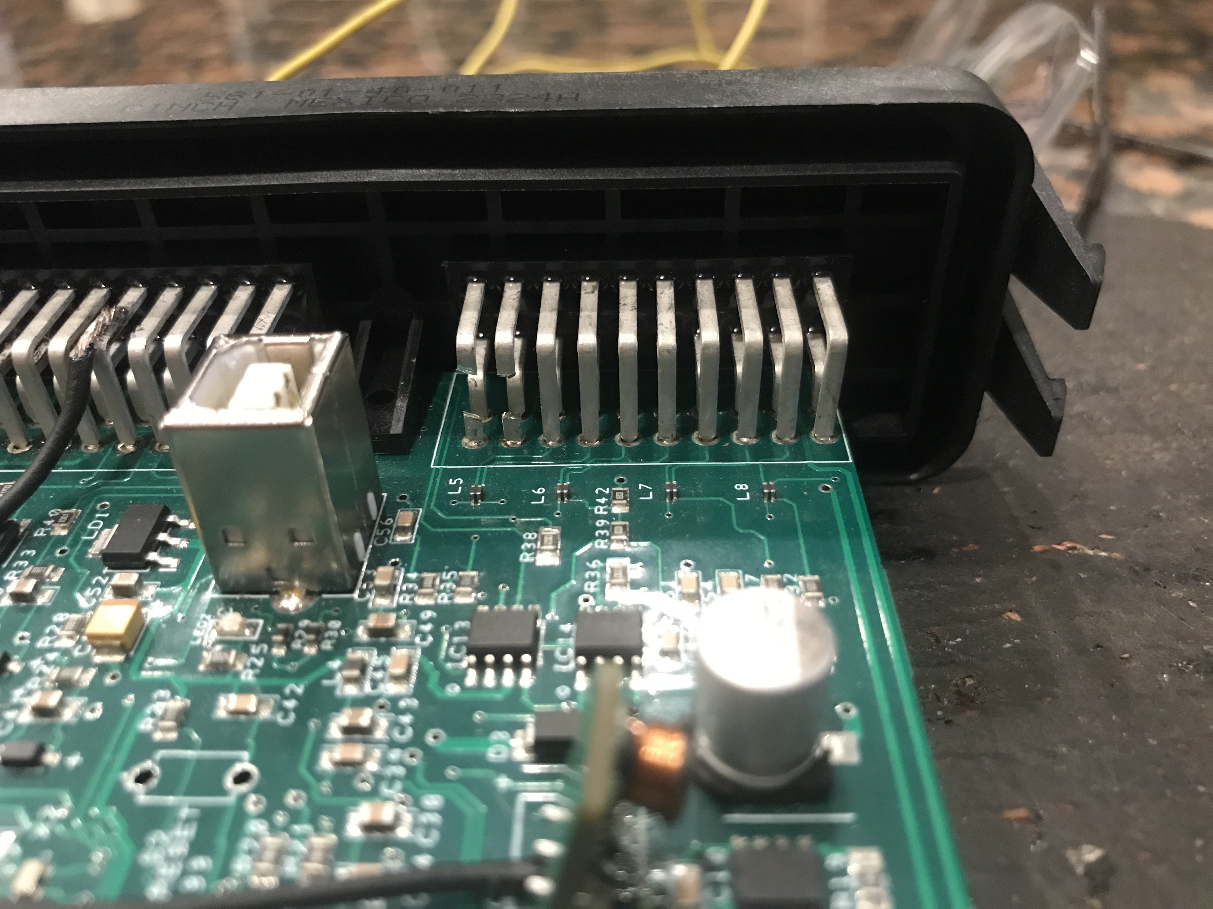

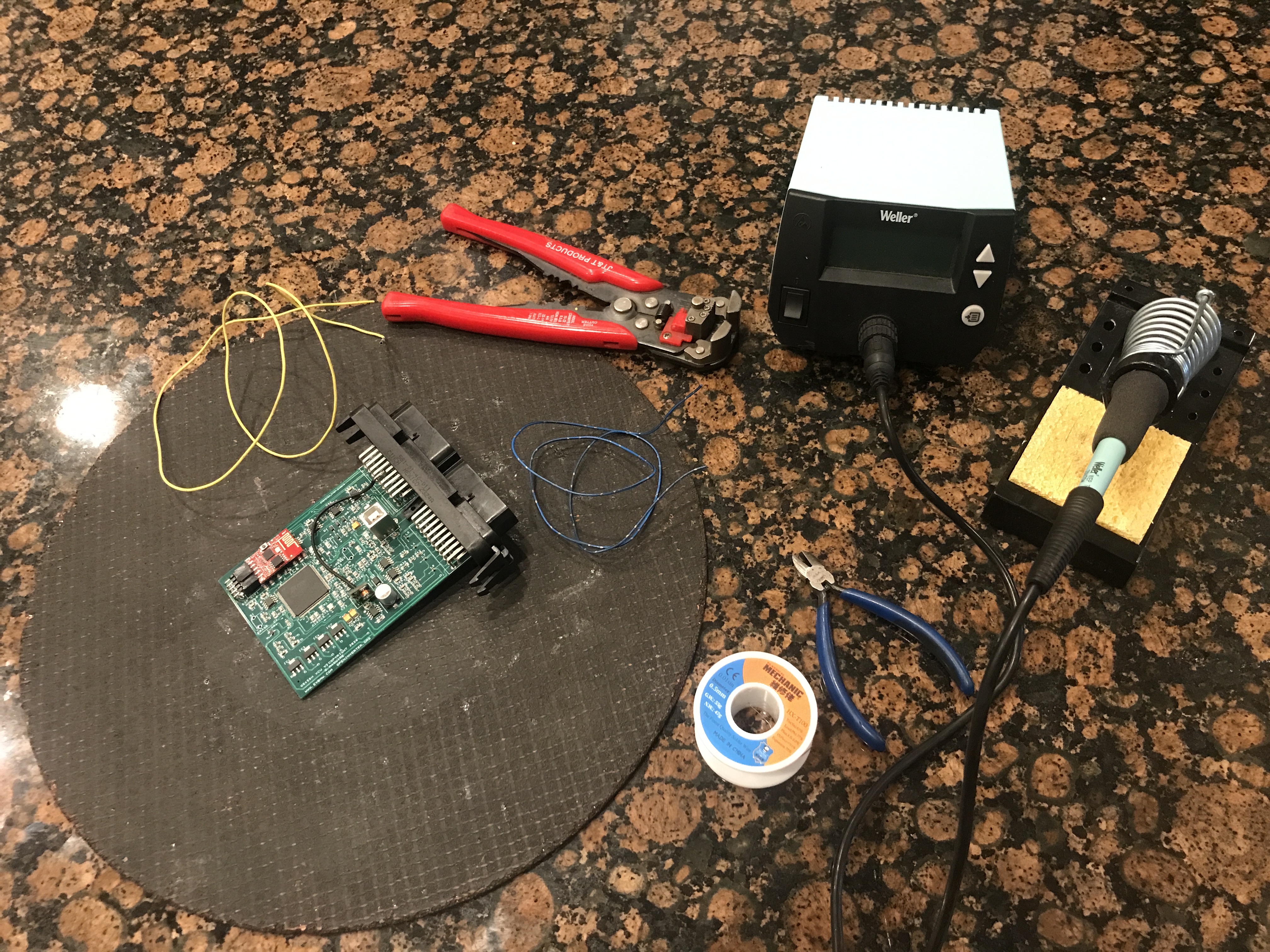

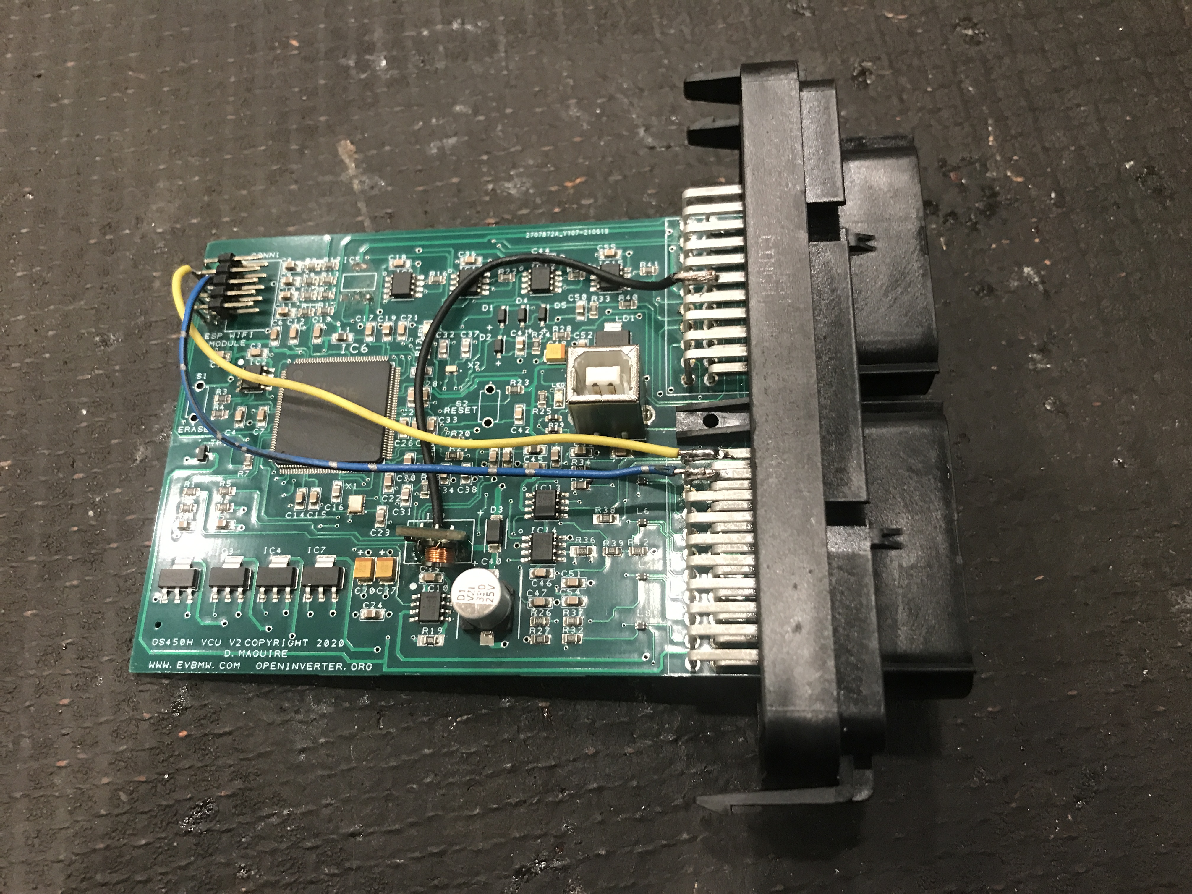

attempted a little silliness today to see if we could pipe out the data to the Nextion display actually using a couple non implemented connector pins
a little hack-a-thon on pins #9 and #10 of the A Connector
Gregski
Posts: 2720
Has thanked: 499 times
Been thanked: 945 times
Post by Gregski »

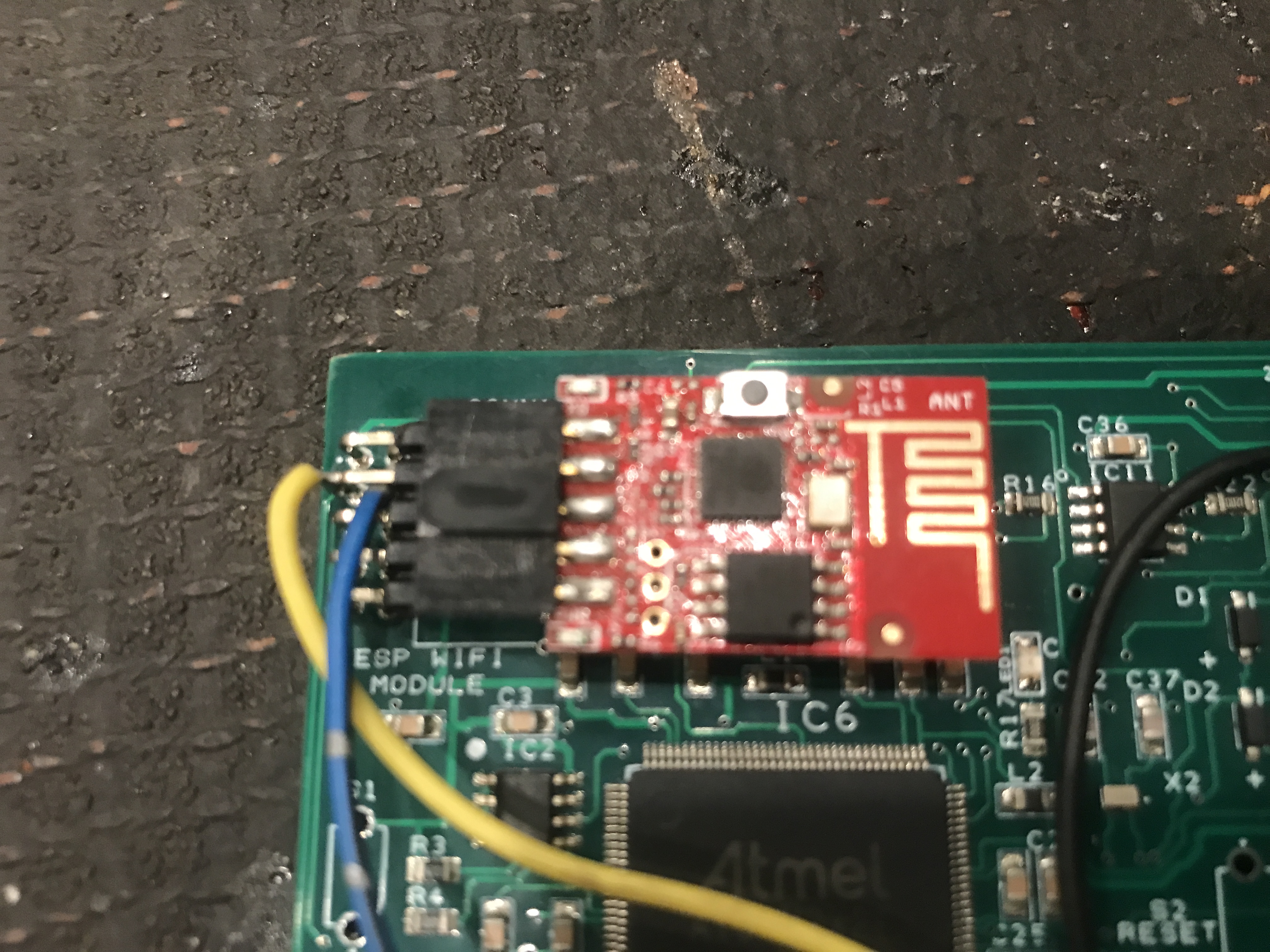

then it was time to link the RX / TX pins from the WiFi UEXT 10 pin connector to those on the A Connector
and we can still plug in the little red rascal if we want to

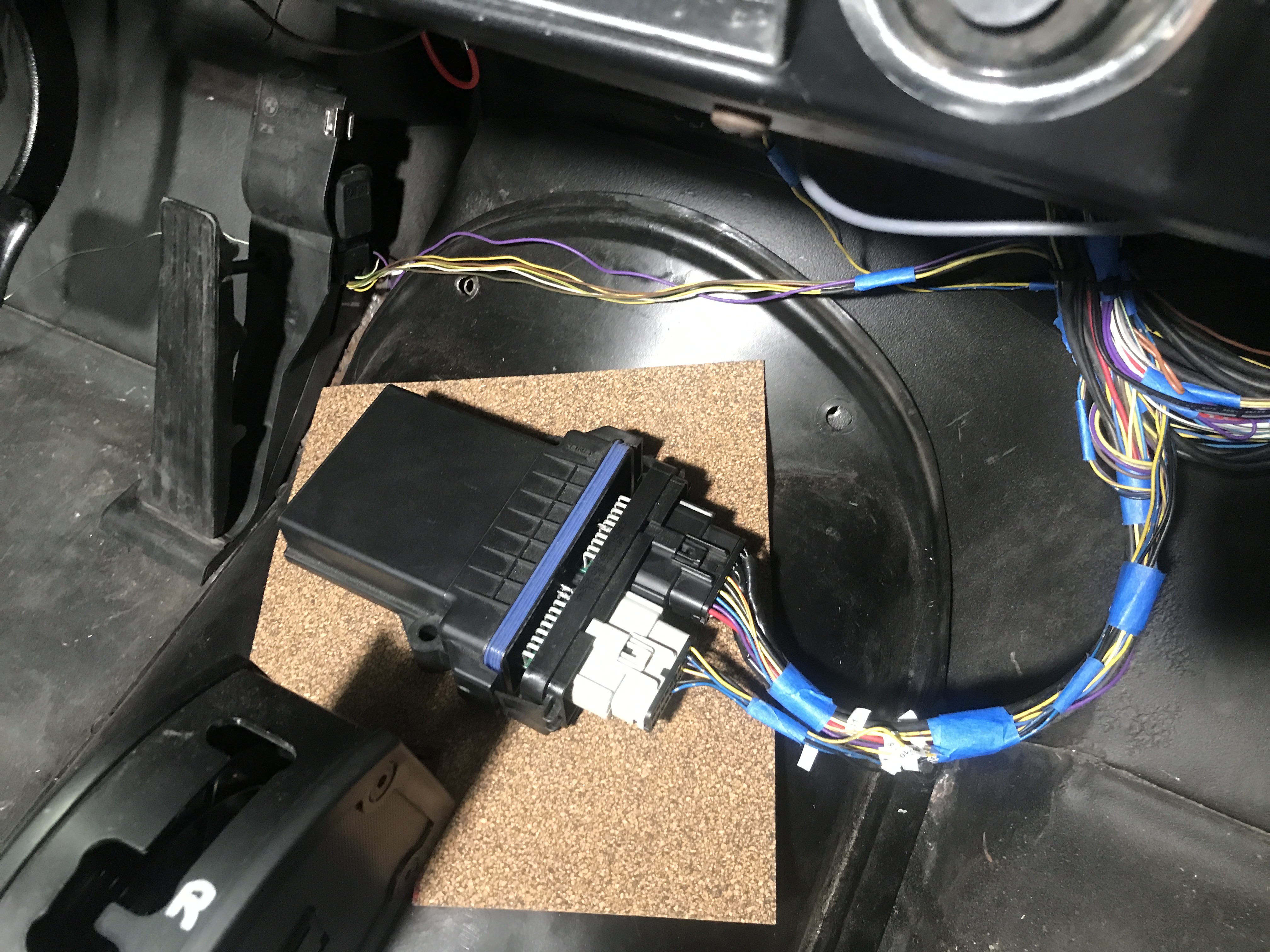

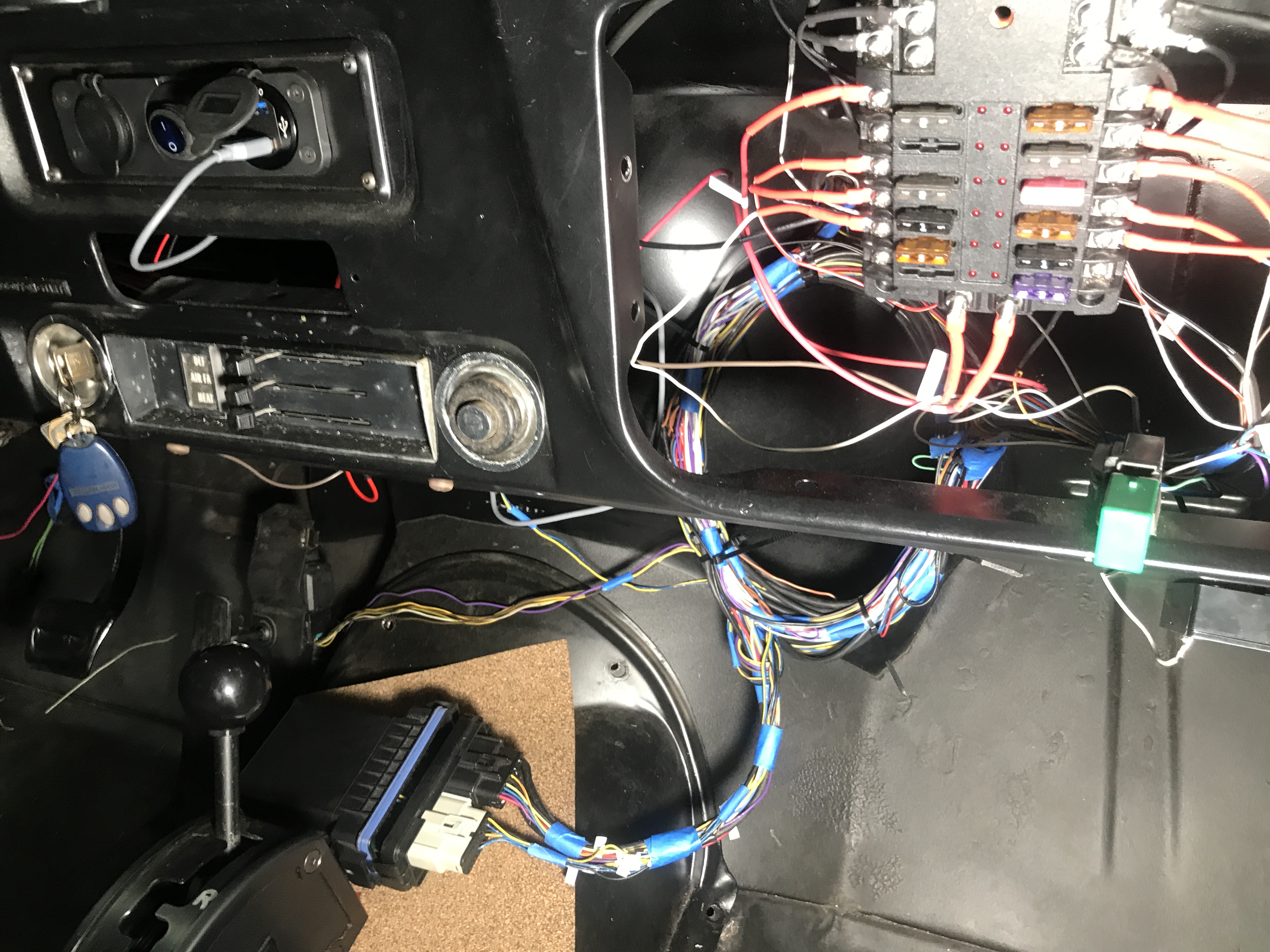

then I decided to thin out MY own harness, lol I'm a simple man and over the last two years I learned that repurposing pins on this VCU aint that easy, for instance I wanted a second PWM pin, no dice, I wanted I2C, no dice, plus I have a 1971 pickup so less means more
it aint there yet, but it's getting there, I still keep having reservations about shortening all the wires, so I just keep looping them still, but eventually I will cut them down to size, except for the synchronous serial bus ones them I will leave alone

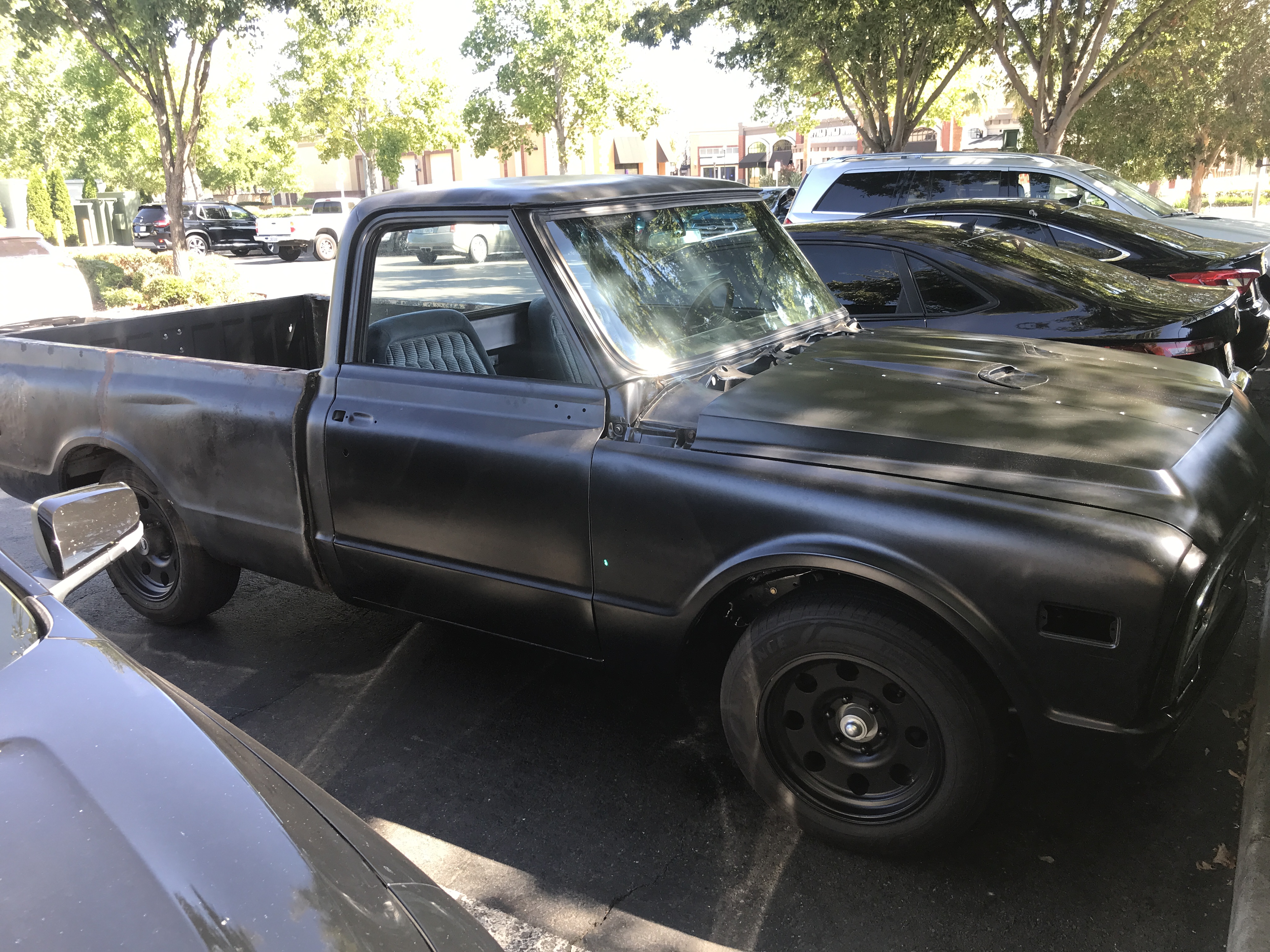

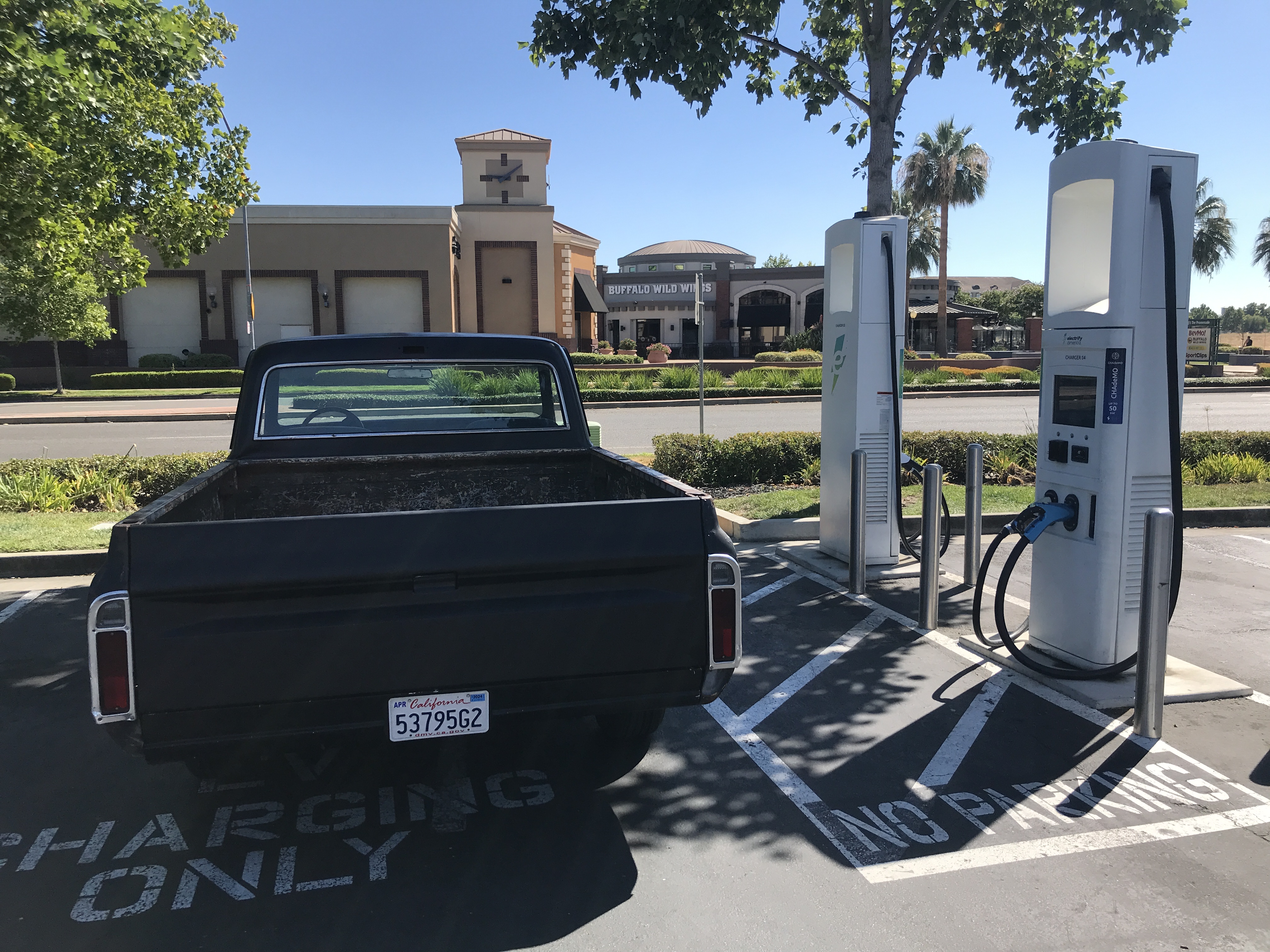

just visited a charging station for funsies, you should have seen the face of the guy charging next to me as I pulled up with this beater, unfortunately J1772 standard charging is not implemented on Dusty just yet
Distance: 2.8 miles away from my house
Posts: 3563
Has thanked: 134 times
Been thanked: 335 times
Gregski wrote: Wed Aug 30, 2023 7:19 pm just visited a charging station for funsies, you should have seen the face of the guy charging next to me as I pulled up with this beater, unfortunately J1772 standard charging is not implemented on Dusty just yet
Hah! What is priceless is some Tesla driver walks up to me charging on L2 EVSE and demands from me to move. Of course then i tell them this is an EV. You should see the face... "Oh really....?" My next question with an innocent face is: "Dont you have tesla charging station nearby...?"
