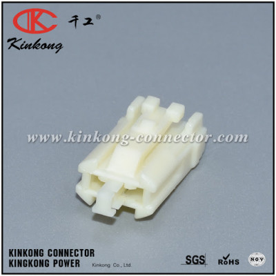

Ah but you mean for the HV DC bus? I meant the little 12V input.

It's not exactly an expensive connector to replace, I'd just buy a matching plug and socket.

My first thought exactlySciroccoEV wrote: ↑Fri May 01, 2020 6:57 pm It's not exactly an expensive connector to replace, I'd just buy a matching plug and socket.
Anyway I've got number 11717 on my connector, so google shows it correctly: 90980-11717

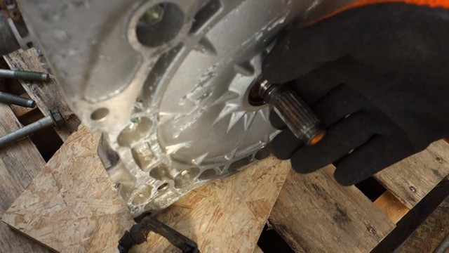

I might have to go locking up a planet gear set whilst I await 'the cure'. Will post in the transaxle post as I go....

"the cure" is a simple chunk of metal produced with the lathe. All you need is do some measurements maybe with a micrometer, and a good lathe operator. Unfortunately, I went by the way of MGR, and have got no free money to purchase prius gearabox to disassmle it. Yet I've got micrometer and a good lathe operator=)

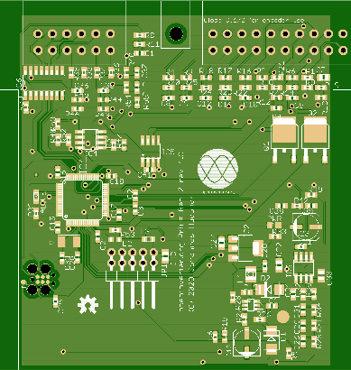

Order at JLCPCB placed
I have made some small changes: solder jumpers for optional encoder pull-up resistors (thanks Damien) and corrected inverter fault detection.
EDIT: and I created a logo

I'm trying to describe the current state of affairs for the Prius boards to some others on the DIY EV forums. But I'm not sure I understand everything that's been done.
I think what Johannes has done here is create an add-on board for his Open Inverter control board, with some Prius-specific stuff to re-use that inverter. Upgrades over Damien's Gen2 Blue-Pill based board are:
- No Blue Pill, which was a kind of downgrade.
- Current sensing using onboard sensors (Damien's board needs some add-on circuitry to work properly with this).
Damien has recently incorporated twinning the power inverter outputs for MG1 and MG2, or re-using one of them as a charger. I don't think this Gen 2 board from Johannes will do that?
What I'm aiming at is, development is proceeding at a good pace, what might happen next? Integrated charger would be nice, as would boost-converter control. One of the limits of the budget EV scene is that there's not budget (or room) to get a full OEM EV's worth of cells, but 200v-ish is a more attainable target. Another limit is perhaps speed or performance. So, the boost converter would be something nice to have control over. In terms of planning a build, I'm guessing people could start shopping for inverters, but maybe hold off on buying control hardware? Would these be on other add-on boards or tertiary boards if they were developed in the future?
- Been thanked: 1918 times
Haha, no matter what brilliant things you do, it's always the stupid things that stick
Thanks for putting it out there.MattsAwesomeStuff wrote: ↑Wed May 06, 2020 5:15 am I'm trying to describe the current state of affairs for the Prius boards to some others on the DIY EV forums. But I'm not sure I understand everything that's been done.
That was the original plan but now it has become a bespoke SMD board for the Prius that will live in its own enclosure and connect to the Prius inverter via a 12-pole cable.MattsAwesomeStuff wrote: ↑Wed May 06, 2020 5:15 am I think what Johannes has done here is create an add-on board for his Open Inverter control board, with some Prius-specific stuff to re-use that inverter.
Yes, and:MattsAwesomeStuff wrote: ↑Wed May 06, 2020 5:15 am Upgrades over Damien's Gen2 Blue-Pill based board are:
- Resolver excitation
- Control of buck converter while NOT running in drive mode, i.e. just for charging
Using as charger: see above. Twinning outputs: by default no, you could however route the PWM control signals to both inverters and thereby parallel them. You could however not run two motors independently as there is only one control core.MattsAwesomeStuff wrote: ↑Wed May 06, 2020 5:15 am Damien has recently incorporated twinning the power inverter outputs for MG1 and MG2, or re-using one of them as a charger. I don't think this Gen 2 board from Johannes will do that?
Boosting while driving is indeed not gonna happen with this controller, as the buck/boost PWM channel does not run off an independent hardware timer. Since the boost converter only sports 20kW and it is easier to just use field weakening, I would not consider this option necessary.MattsAwesomeStuff wrote: ↑Wed May 06, 2020 5:15 am What I'm aiming at is, development is proceeding at a good pace, what might happen next? Integrated charger would be nice, as would boost-converter control. One of the limits of the budget EV scene is that there's not budget (or room) to get a full OEM EV's worth of cells, but 200v-ish is a more attainable target. Another limit is perhaps speed or performance. So, the boost converter would be something nice to have control over. In terms of planning a build, I'm guessing people could start shopping for inverters, but maybe hold off on buying control hardware? Would these be on other add-on boards or tertiary boards if they were developed in the future?
