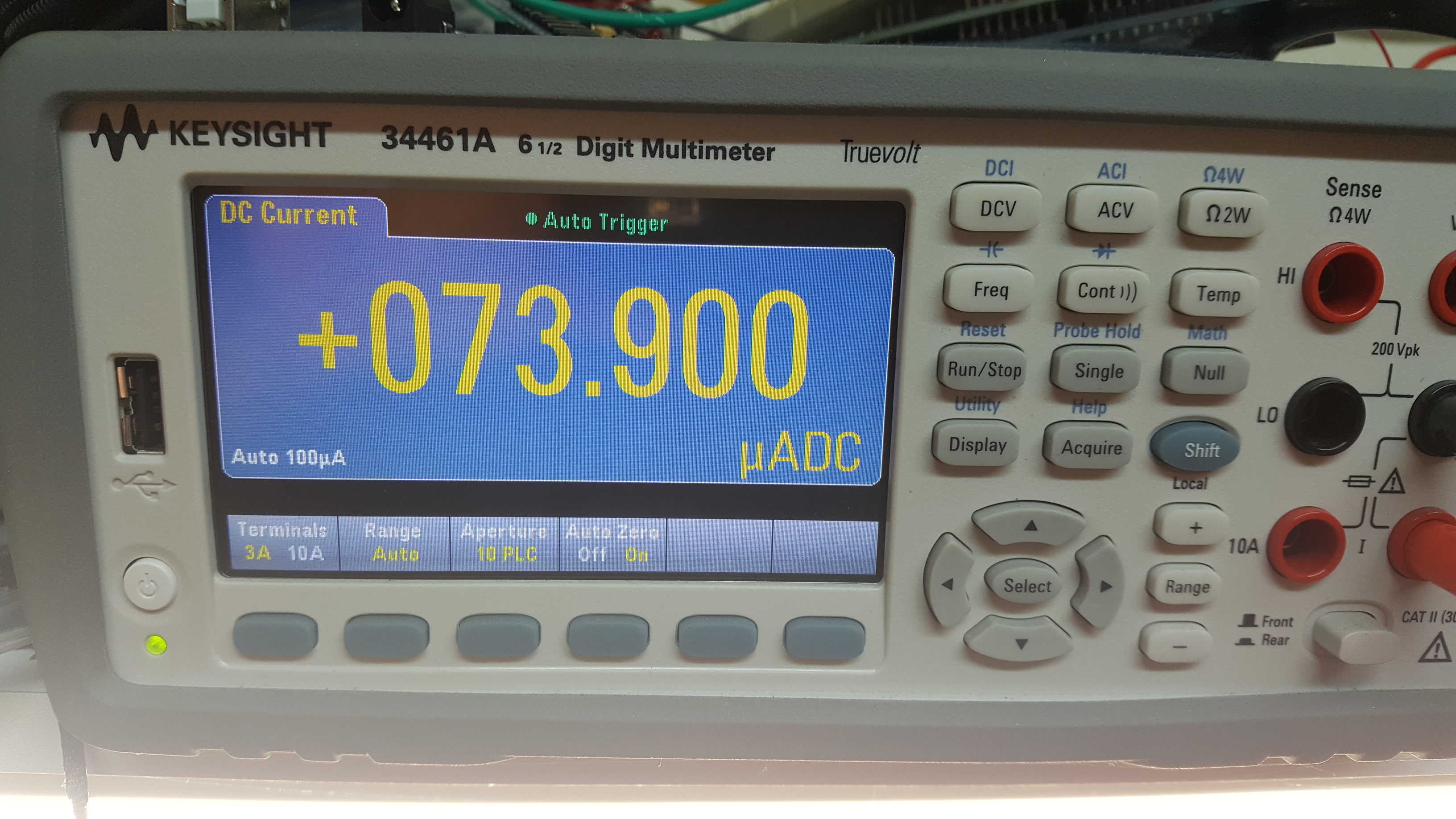

How to tell a good bms from a bad, Lesson 1: A good bms draws f%^k all current from its attached battery when in sleep mode:)

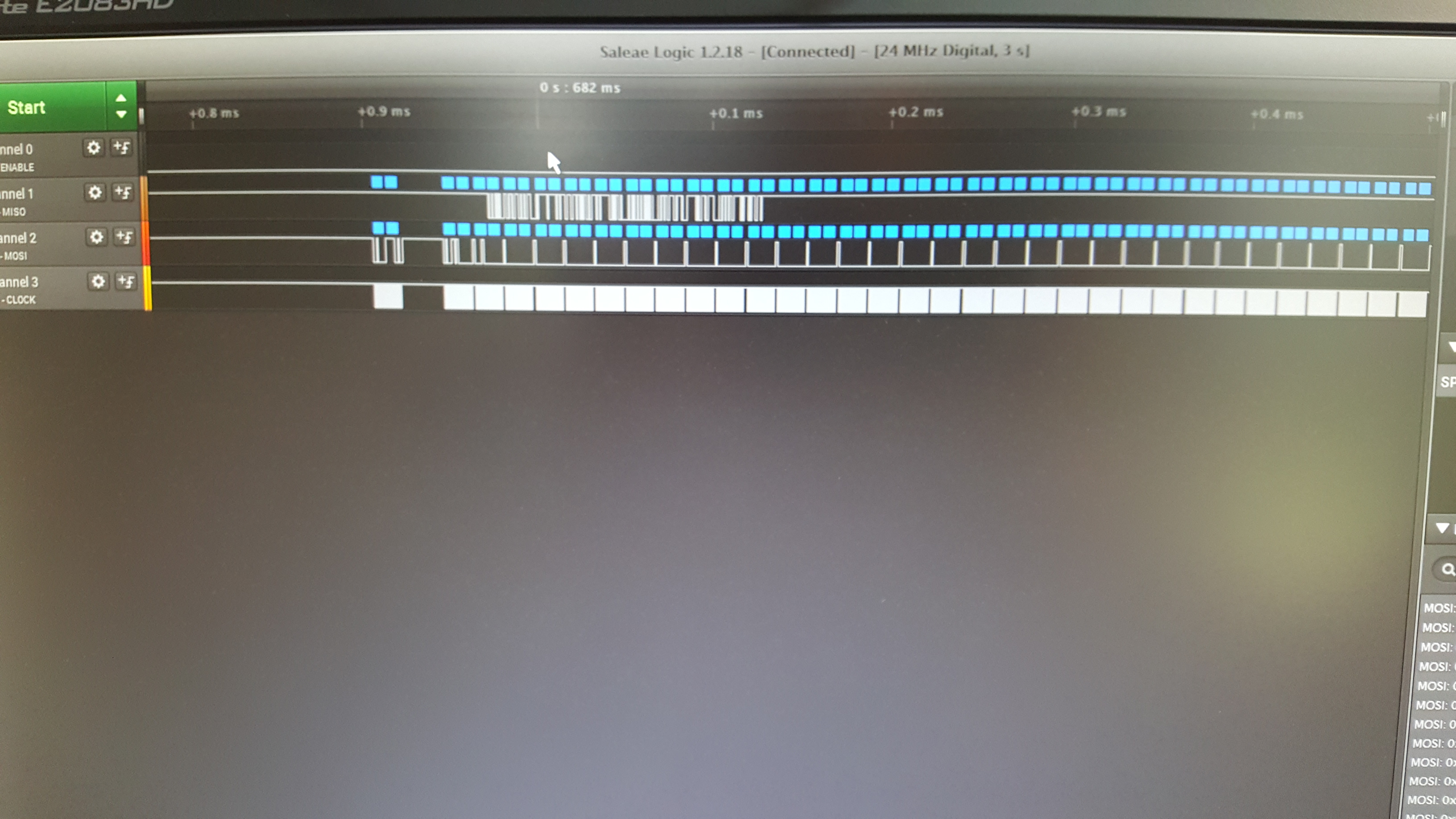

Can you export raw hex data of the SPI bus? Then I would not mind having a look at it, I would suspect quite some likeness to the standard linear chip protocol.
- Posts: 4000
- Been thanked: 1115 times

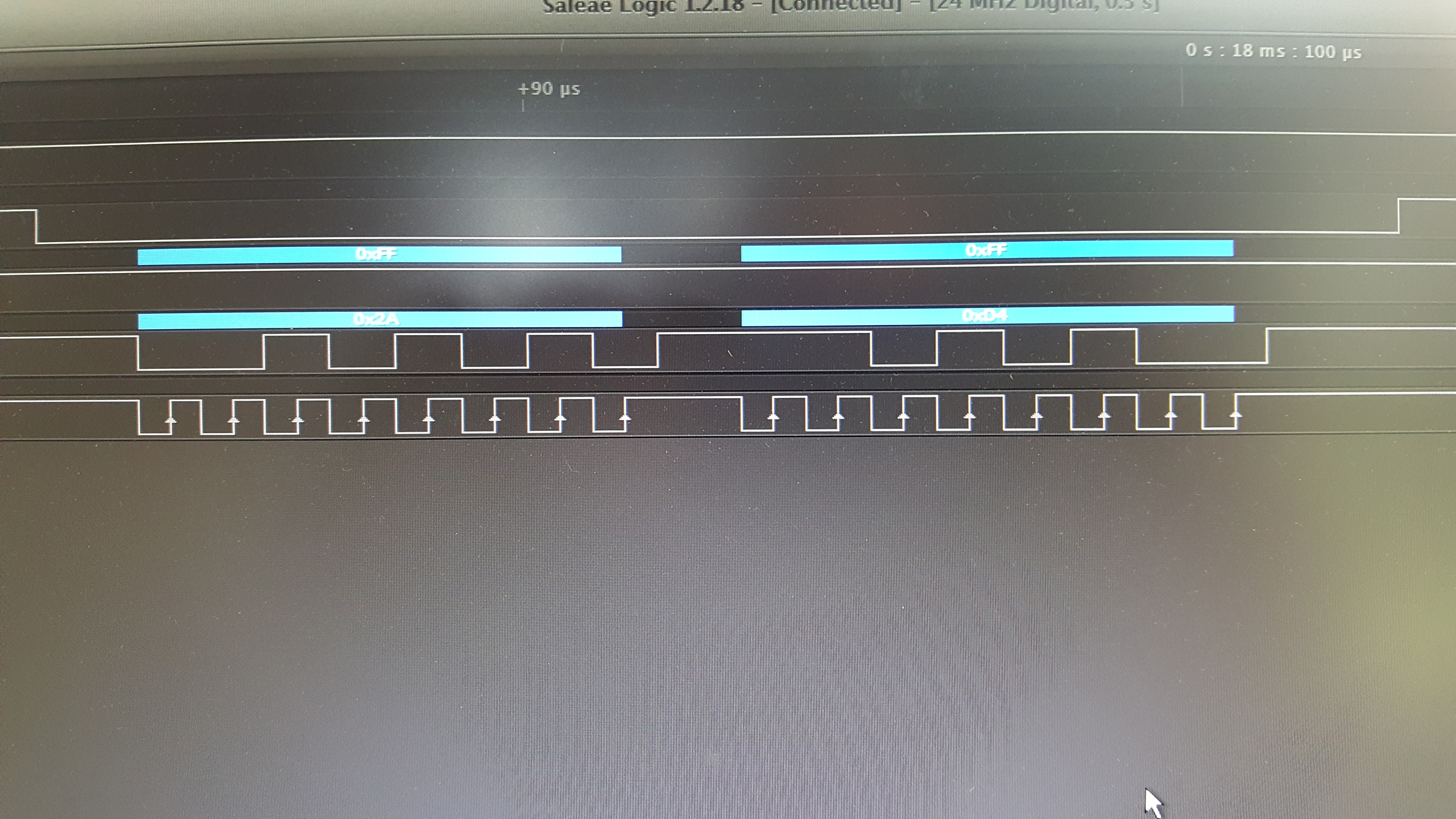

Re: Tesla Model 3 Battery Hacking
Attached capture from Salae logic analyser. Can be viewed with free software : https://www.saleae.com/downloads/
Few points to note : The spi runs with Cpol=1 and Cpha=1. The capture starts with the hv controller powered down and powers on after about 0.5sec. One slave connected with all 25 cells attached.
Ignore my last. I am a clown. Attached capture as before but with correct spi decode pin assignments.
- 1slave_correct_spi.zip
- (443.34 KiB) Downloaded 475 times

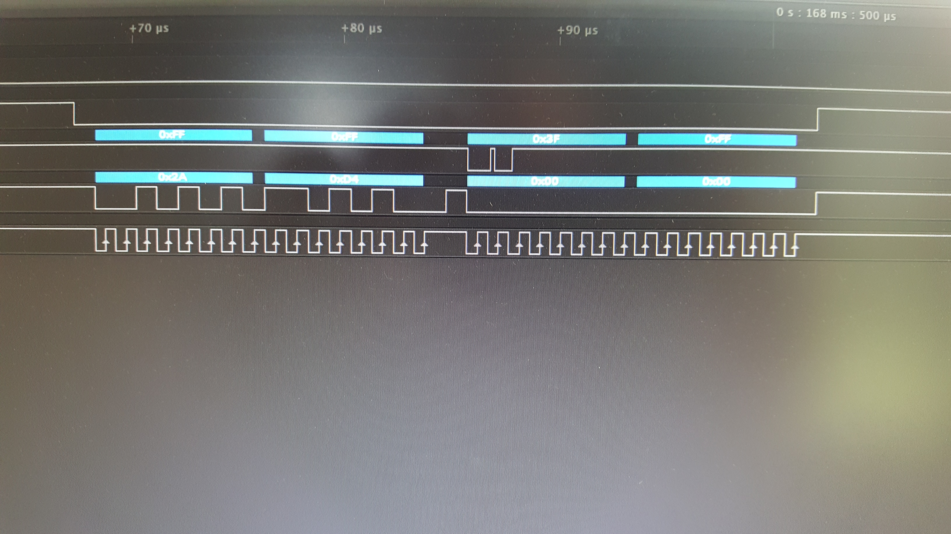

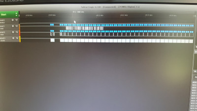

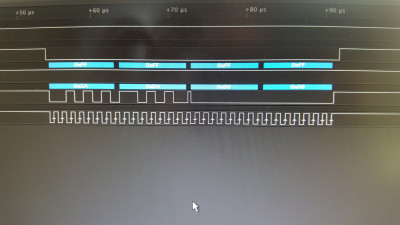

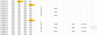

So a few observations from looking at the logic analyser data.
1)Looks like all transactions ar 16bit
2)Seems the controller spits out 0x2ad4 to wake the salves from sleep and get them to respond.
3)Slave responde with : 0x0fff
4)Master sends : 0x4e53 , 0x2500

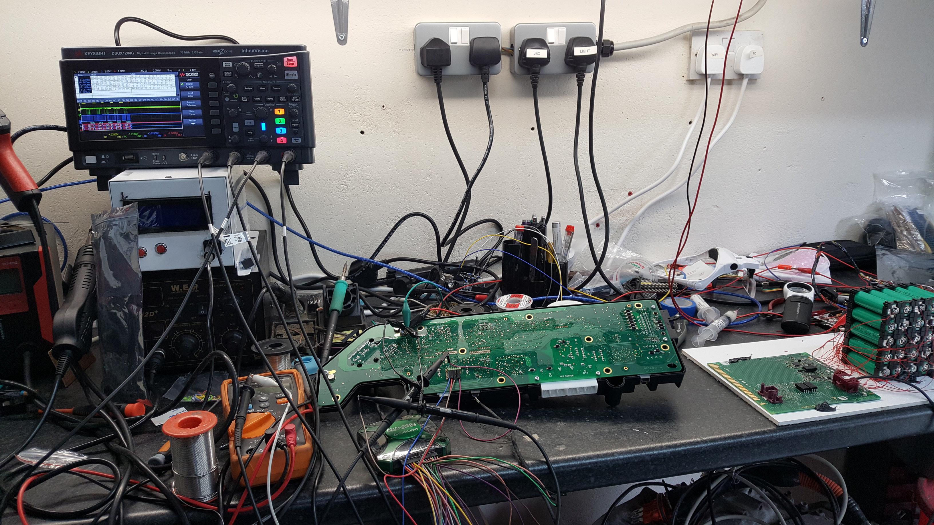

5)Slave then sends an 18 byte response.

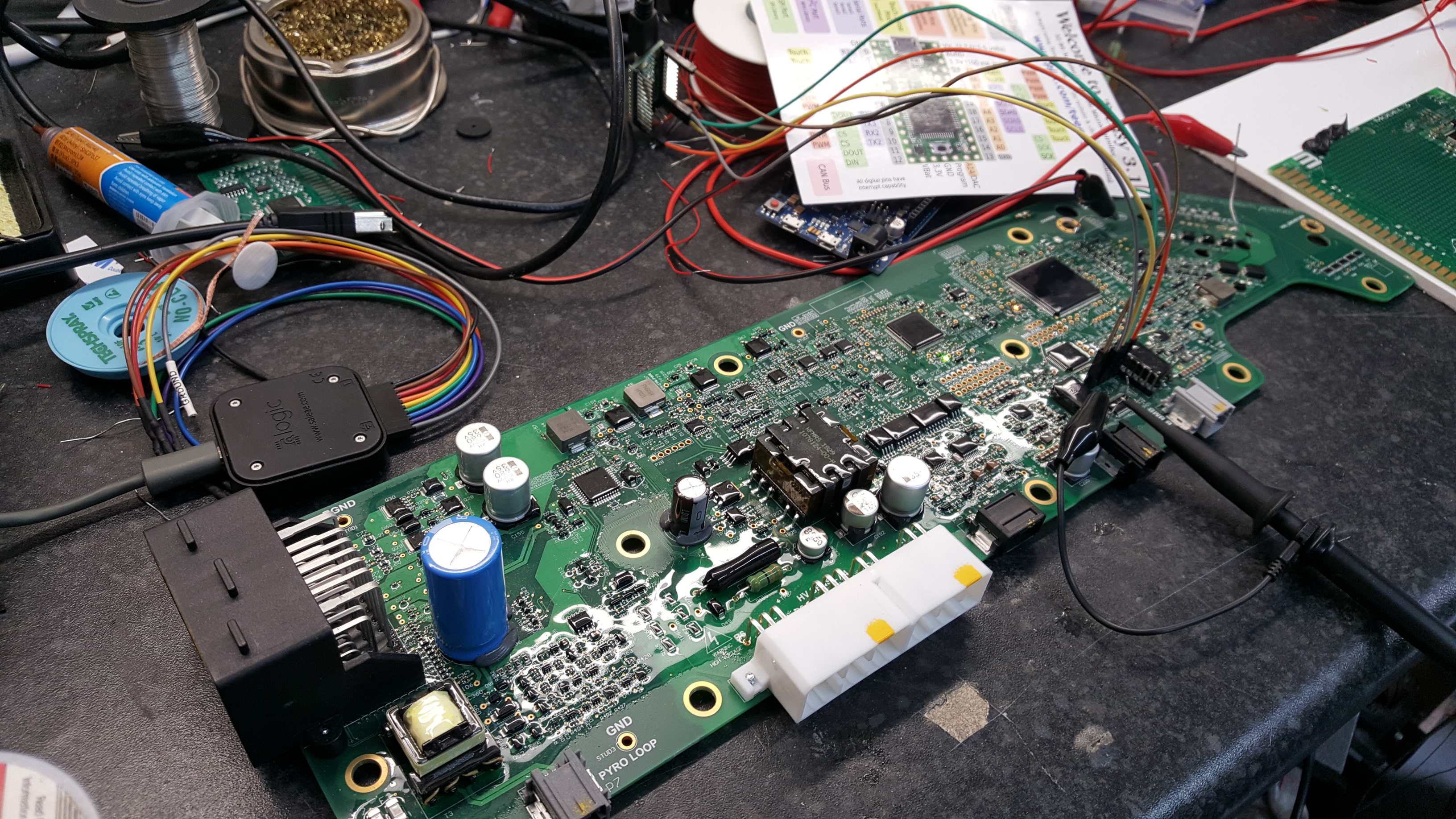

I have 2 hv controllers. One (mine) I have cut the tracks from Batman (Elon equivalent to the LTC6820) to the stupid NXP micro. This allows us to send isospi with our own device (arduino due) using the Tesla spec that the slaves will recognise. On the 2nd hv controller I can spy on the spi with the salae and watch the results over can to correlate what changes on the spi when I mess with the cell voltages and how that corresponds to the real life data sent out over can. Yeah, another Tour De Force:)

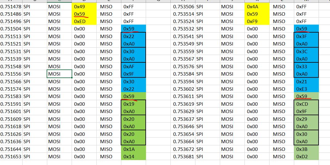

So it turns out some way this works seems like:
2nd from last byte is echoed before the slave data.
It seems the the byte before it indicates some form of register or something.
Since there are two connected IC's We are are seeing the first IC and then IC2 send the same info, always 9 bytes per IC for a full response, the rest if buffered with 0xFF due to no other IC's/slaves present.
Seeing that I am seeing alot of values of around 0x9FCD - 0xA033 ish and then usually reported in sets of 3 (which is the way the LTC6813 usually reponds).

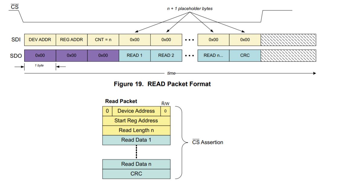

I get a wierd feeling Tesla is doing something along the lines of what the old chips used to do for comms.
Model S and other variants used this chip from TI with SPI translated on to canbus.
https://www.ti.com/lit/ds/symlink/bq76p ... BQ76PL536A
But then not using the fields as defined here but different and getting all ICs to respond in a burst. I have seen 3 byte commands and 4 byte commands in the capture.

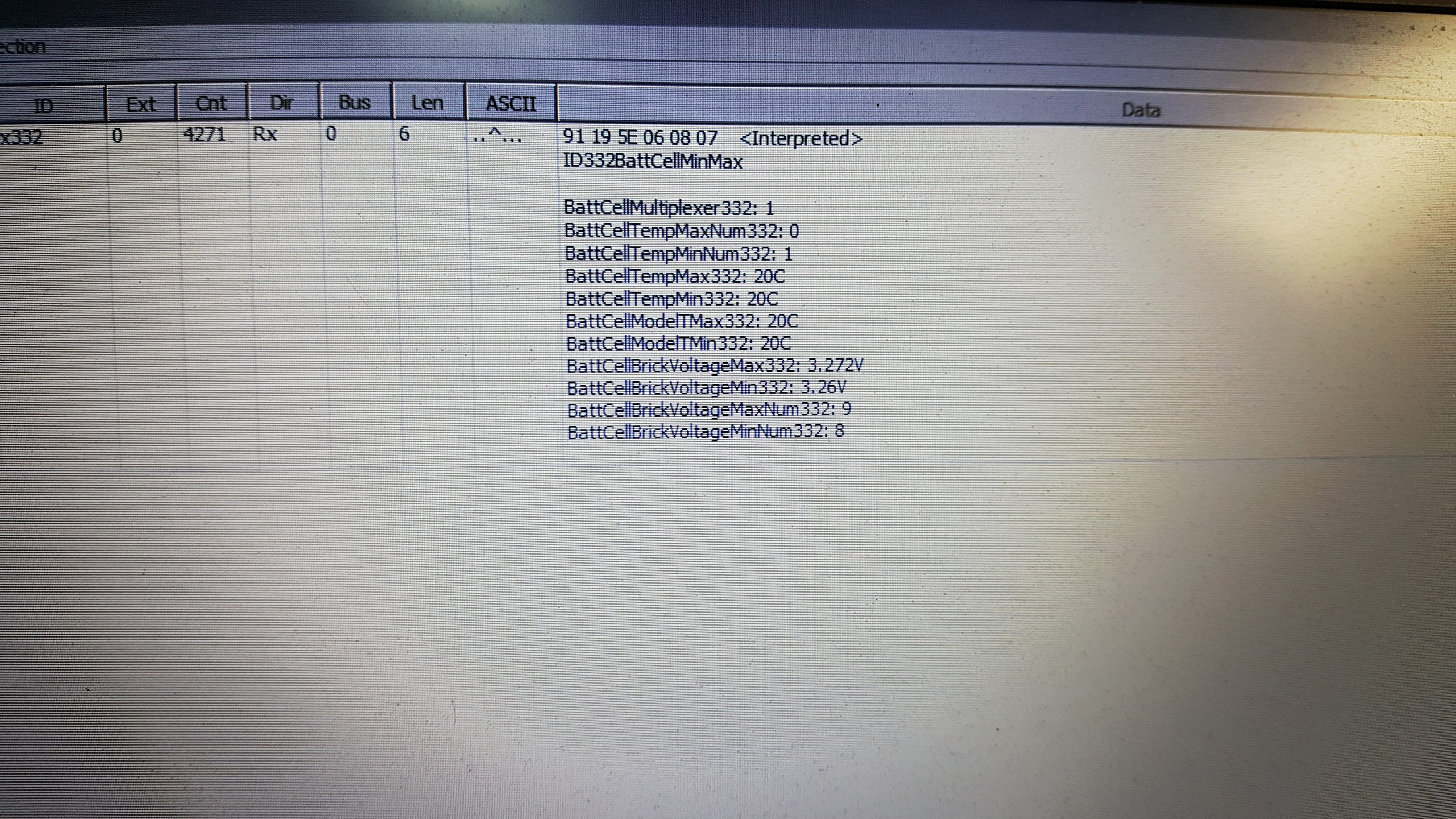

Total of 6 captures now up on the repo with log detailing the events and pictures of received can data on 0x332 just after the log.

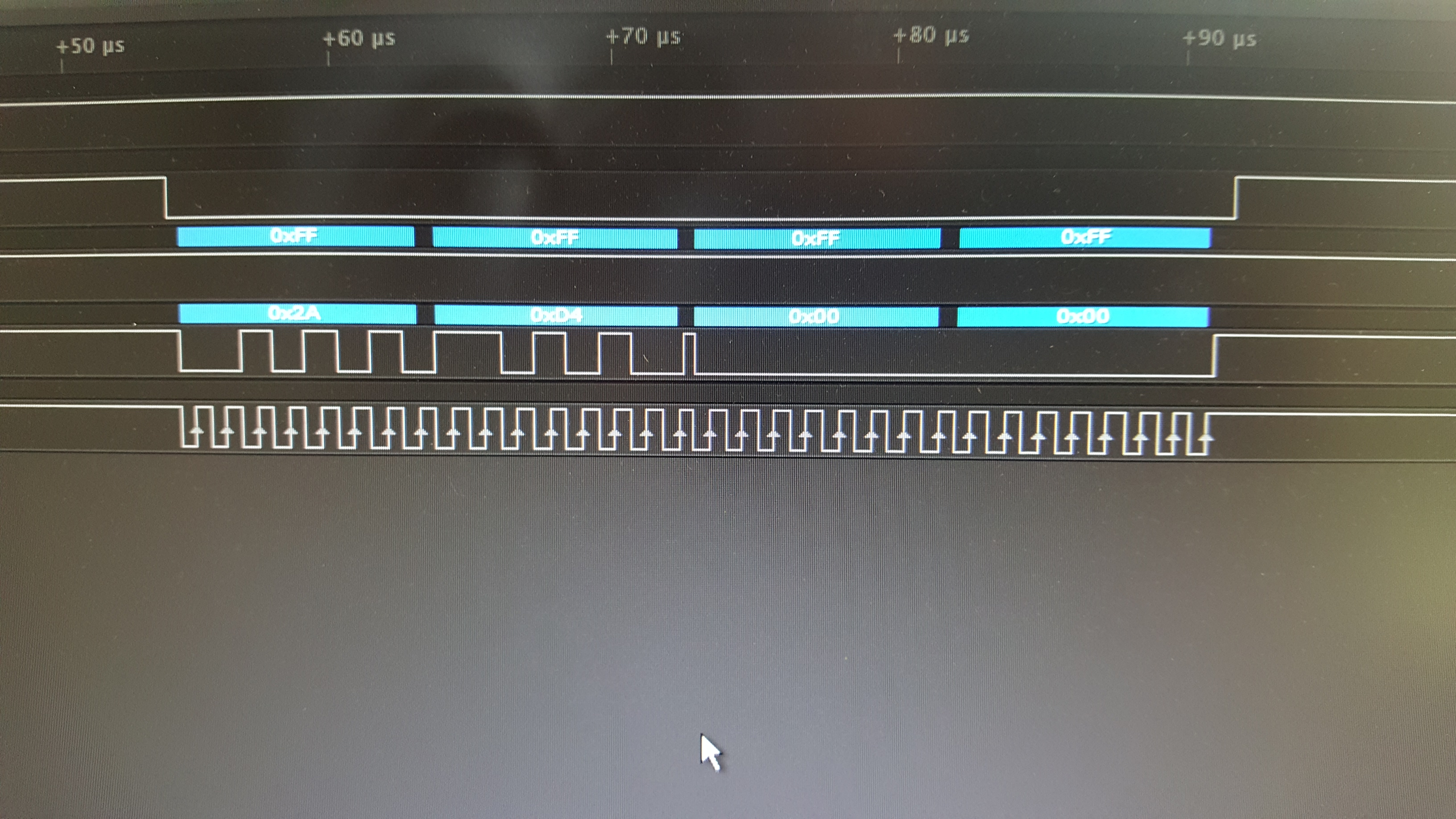

Musk Vs Arduino.
Tried sending 0x2ad4 to the slave via spi on a due. Of course it didnt do anything. Seems the due will break the transaction into bytes whereas Elon uses words. Might be time for an stm32 here unless anyone knows better?
How are you sending it? How about sending it as 0x2A and then 0xD4?Jack Bauer wrote: ↑Tue Aug 04, 2020 11:28 am Musk Vs Arduino.
Tried that. Every option I have tried with arduino breaks spi transactions into bytes. Even this results in two bytes:
receive1 = SPI.transfer16(send1); // do a transfer

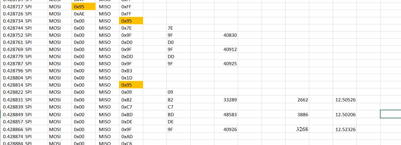

Capture two data analysed
so you can see quite well that numbers for some reason line up very very well.
I will try documenting some more, specially the requests as i notice they vary slightly.
Okay so my findings are:
Need a few captures of "dry starts" So first time powering on 12V to see if any initialisation takes place.
So the format for request is:
Byte 1: Requested Register
Byte 2: Counter (same as response leading byte of each slave)
Byte 3: Checksum (Needs confirmation)
I am working on breaking down the registers, got all the voltage registers Identified also got an incline to where the temperatures are hiding.
So currently looks like the requests are structured as follows:
Damien, mind requesting out of the blue some of these after sending the wake up? Just to see how the slave responds.
Example would be:
Attached my analysis spreadsheet, found another command that has no repsonse so migh be an init.
Request Len Info
0x47 9 Cells 1, 2, 3
0x48 9 Cells 4, 5, 6
0x49 9 Cells 7, 8, 9
0x4A 9 Cells 10, 11, 12
0x4B 9 Cells 13, 14, 15
0x4C 7 ?
0x4D 9 Temps?
0x4E 9 ?
0x4F 7 ?
0x50 7 ?
