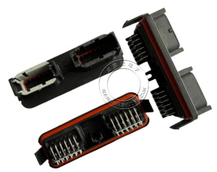

ZombieVerter enclosure kit links:
https://openinverter.org/wiki/ZombieVerter_VCU#The_enclosure_kit_links
Direct link:
https://www.aliexpress.us/item/2251832671457223.html?spm=a2g0s.9042311.0.0.39f24c4dWOmGPE
There are at least two disadvantages to this enclosure. There does not appear to be any documentation available for it (CAD, etc.), and the lid is grooved for a gasket, but no gasket is available.
I have one, it's nice enough, but I don't know if it's a compelling product.

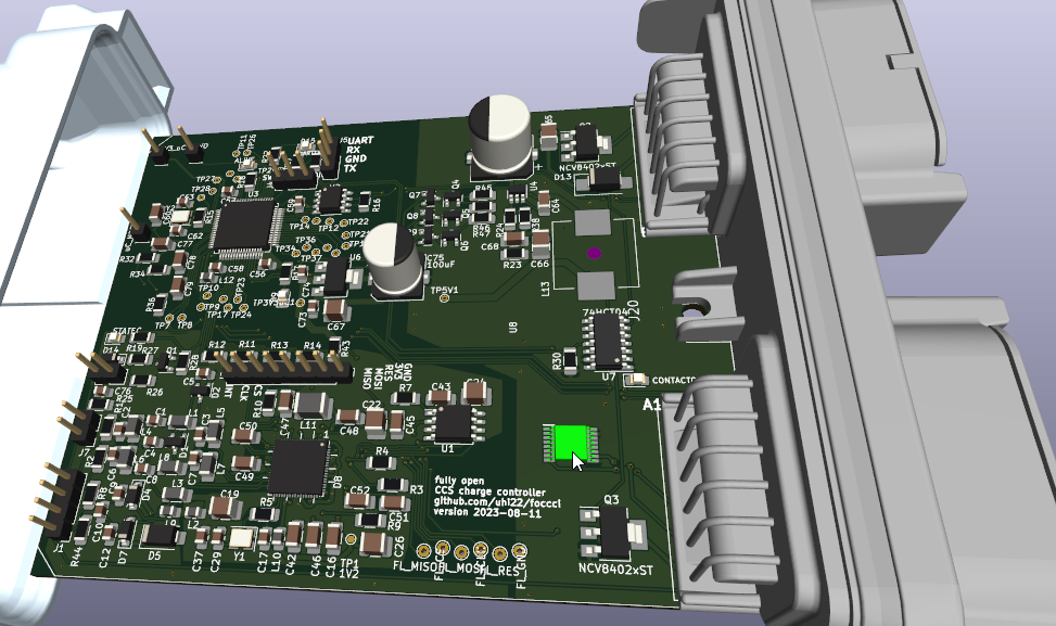

- uhi22
- Posts: 1244
- Has thanked: 245 times
- Been thanked: 684 times

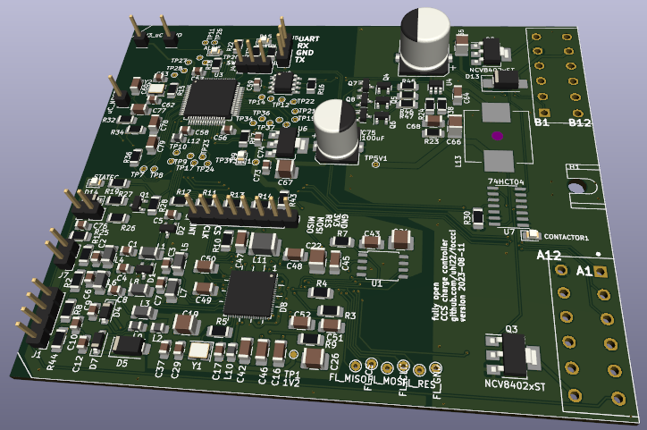

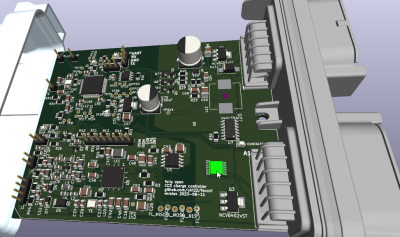

Re: Develop a QCA7000 board?
The next version will have the TE DEUTSCH DTM13 connector. I was also planning, that two connectors into two directions (one for 12V and CAN, the other for the charge port) is perfect, but not all functionality can be easily assigned to the one or the other direction. So I ended up in a "random" pin assignment, also driven by layout. Still some work to do, but at least all components fit. Added also discrete highside drivers for the RGB. The charge port lock motor driver is my biggest question mark, I have no idea about a small, cheap and available driver.
This is a draft: And this the connector, ~17 Euro on Aliexpress. The cable side connectors are reasonable priced (payed 18 Euros for 4 parts), the enclosure comes on top, did not yet find a good price.

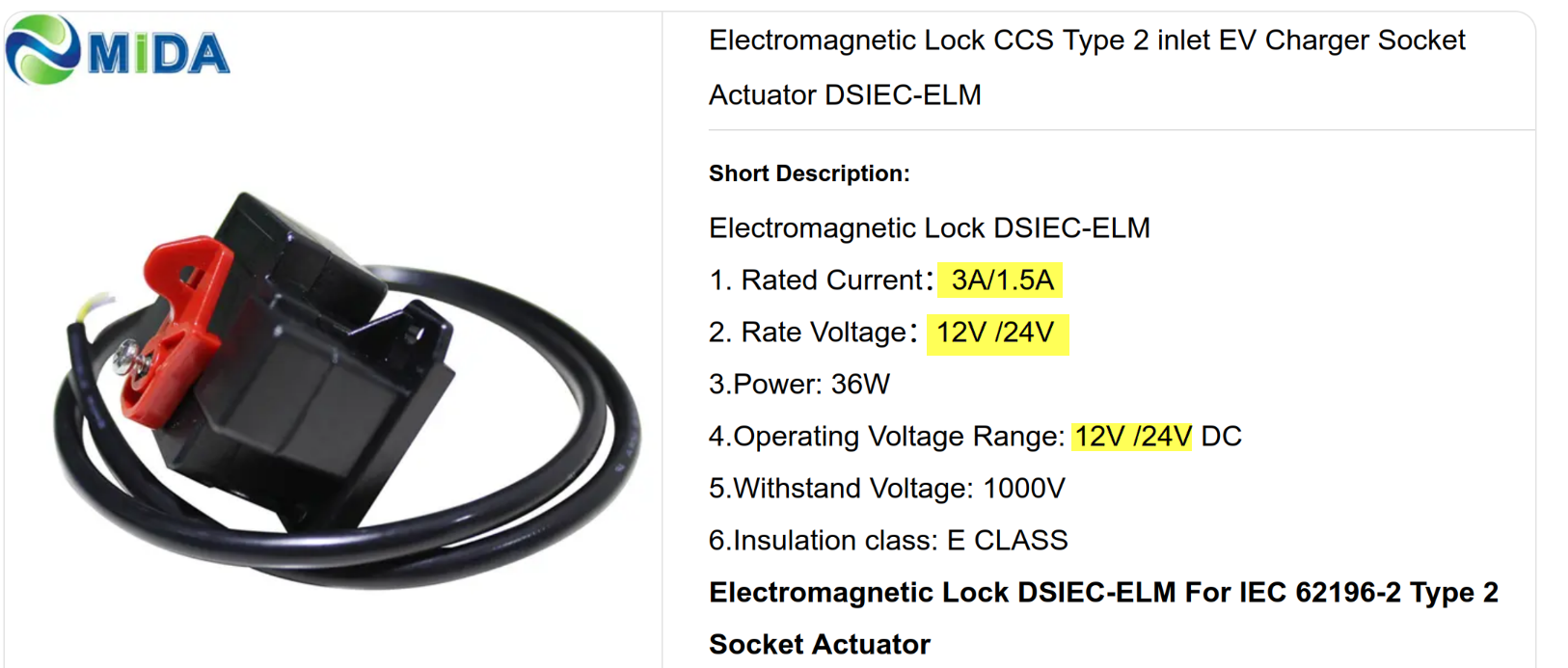

That web page has two different sets of specs!muehlpower wrote: ↑Fri Aug 11, 2023 2:05 pm The locking actuator is rated at 3A in 12V version!
https://www.evsegroup.com/electromagnet ... x-product/
Which to believe?

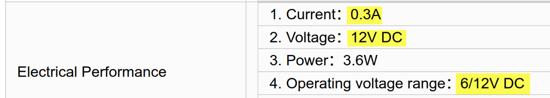

- asavage
- Posts: 385
- Has thanked: 369 times
- Been thanked: 119 times
The linked page above shows wildly disparate specs.muehlpower wrote: ↑Fri Aug 11, 2023 2:05 pm The locking actuator is rated at 3A in 12V version!
https://www.evsegroup.com/electromagnetic-lock-for-electric-vehicle-power-type-2-ev-charging-socket-actuator-wallbox-product/
This is a different unit, with more reasonable printed specs.muehlpower wrote: ↑Fri Aug 11, 2023 6:52 pm I installed this, it is specified as 3A / 36 W. Most sources say so. But maybe there are also differences, e.g. DC motor versus solenoid with peak and hold.
https://www.evsegroup.com/electromagnetic-lock-v4z-dsi-el-for-iec-62196-2-type-2-socket-actuator-product/
I mistrust suppliers who can't keep their specs straight (consistent) on a single web page. If they can't be bothered to fix their publc-facing documentation, what other corners have been cut? I will always pay more to a more professional vendor . . . even for the same product! Because they are providing better service overall, and not forcing me to guess, cross-check, and doubt.

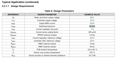

This sounds like the 6A peak of the DRV8874 should also cover this use case with the solenoid, as well as the motor variant. I will go with it for the next prototype. It is nice small. (Also found how to use the available 3D models of the components, so we have a nice overall picture now)
- asavage
- Posts: 385

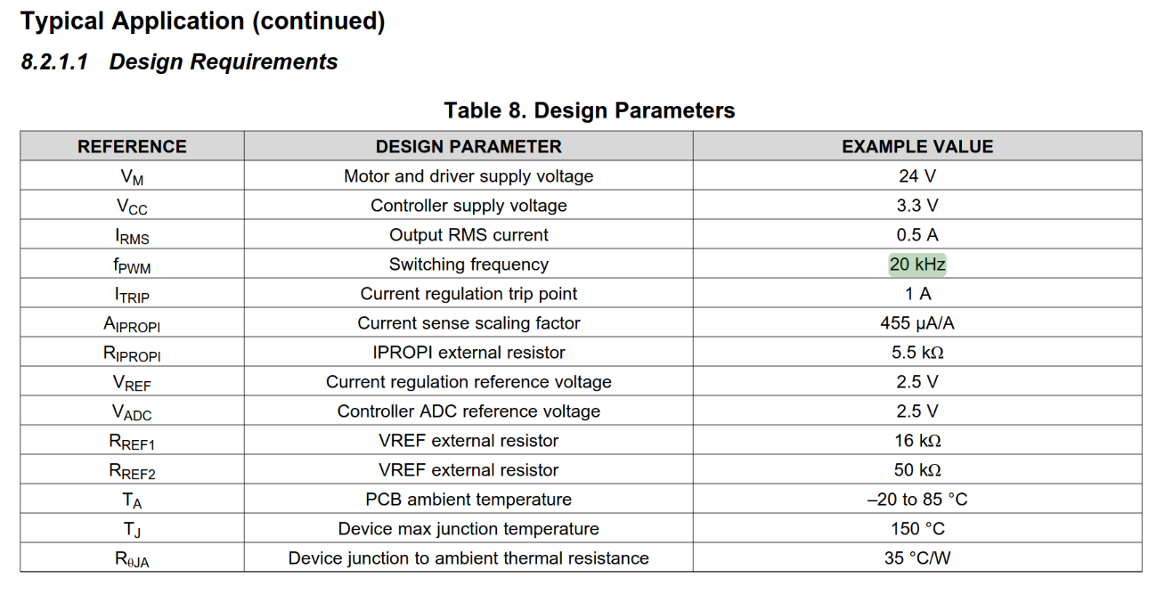

The DRV8874 looks good, good suggestion by muehlpower! I've had a read through the datasheet. They don't give many clues for choosing the local bulk capacitance value, other than "test your design and adjust accordingly", but others have questioned on the TI forum and gotten, somewhat begrudgingly, "2-4uf/w", and a warning not to exceed 4uf/w.
I like how the datasheet says to refer to a table in the datasheet for guidance . . . and then doesn't have that table
Is it worth your trouble to make it possible -- onboard or not -- to drive eg. 20mhz 20khz PWM on the EN/IN1 line? I don't want to enable scope creep -- well, maybe I do -- but having the option of toggling PMODE high and either generating PWM onboard or allowing it to be driven from an external source would make my life easier.
I'll need to drive that pesky Tesla solenoid via peak & hold somehow . . . maybe I should just install a BDC motor instead

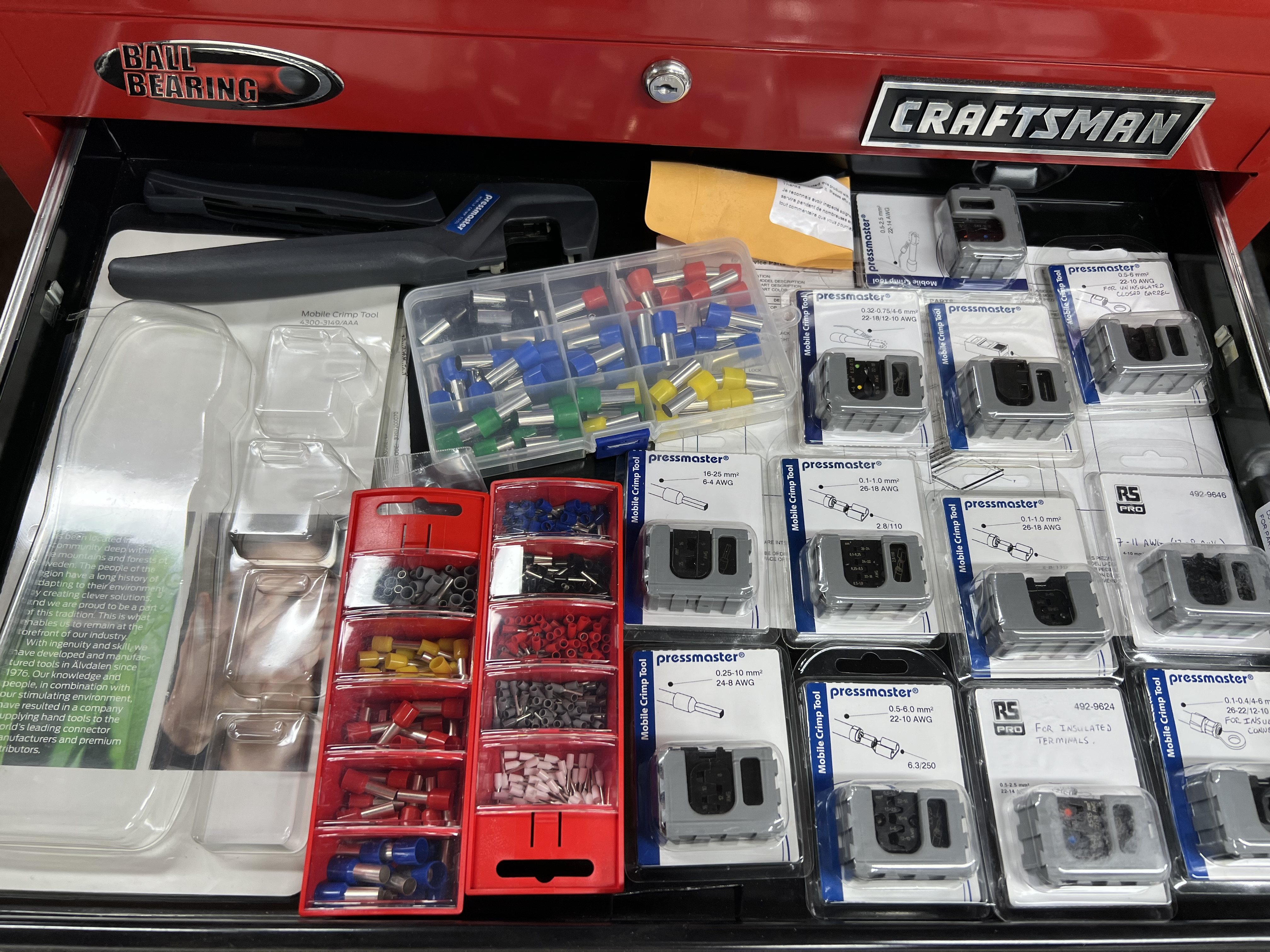

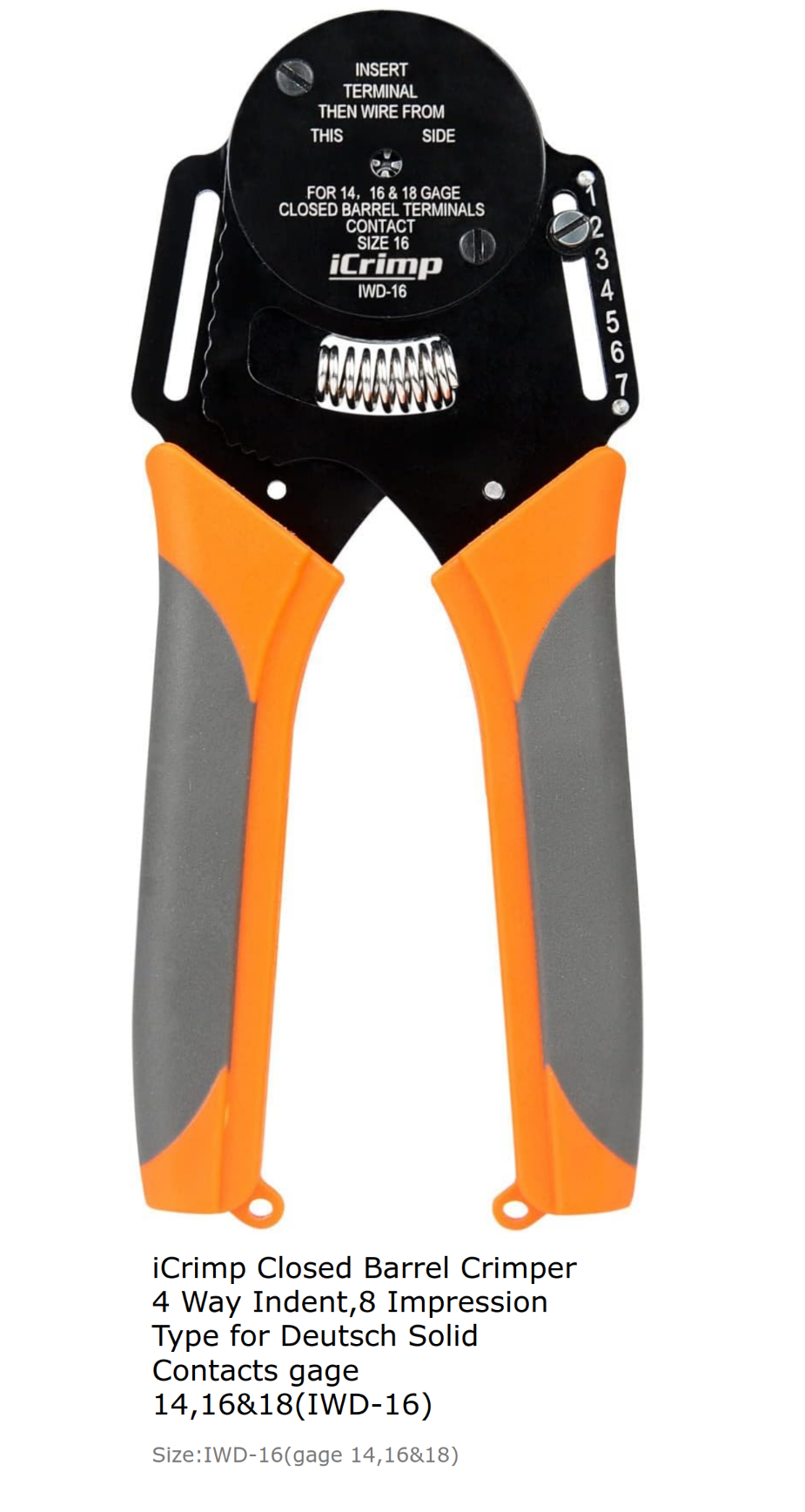

Sadly, my main terminal crimping system (Pressmaster MCT aka Waytek) has no dies for crimping Deutsch terminals.P.S.Mangelsdorf wrote: ↑Sun Aug 13, 2023 11:27 pm Just want to add that I full endorse using Deutsch type connectors whenever possible. If you get the right tool, the barrel type connector pins are super easy to crimp correctly. No silly tabs to fold over, just: wire in pin, pin in tool, squeeze, done.
Can you recommend a good quality crimping tool for Deutsch terminals? I usually like to buy top-tier tools, used. I think I'd like to spend no more than USD$200. I like to buy tools, but I do have to limit myself somehow.
I do not buy cheap tools: it only encourages them to make more cheap tools.
Honestly, this one (though fairly cheap) has worked amazing for me. I had also bought one from WireCare when I bought a bunch of Deutsch connectors, and I prefer this one.asavage wrote: ↑Mon Aug 14, 2023 4:32 am Collection_20230813.jpg
Just to note, there are two forms of Deutsch pins. The cheaper have the fold over tabs, the slightly more expensive are the barrel type that use this crimper. I whole-heartedly recommend the barrel type.
No image showed up for me in your post (maybe I have a blocker installed that catches it?) but I extracted Amazon's ASIN from the html, and came up with B07V1C6N2V.
https://www.amazon.com/IWISS-Crimper-Impression-Deutsch-Contacts/dp/B07V1C6N2V
I like the imprinted directions for use, handy for those of us who don't use it daily. I think of IWISS as the top tier of the bottom end of hand tools. I don't own any, but read generally good things about the brand in the reviews, whenever I'm tempted to buy one of their products.
For automotive use, 14/16/18 AWG (2.5/1.5/.75mm²) is about all I think I'd need, so it covers those. Thanks for the recommendation.

The 20mhz is a typo, right? The board will support PWM on both, the contactor outputs and the lock/unlock. I would start with something like 100Hz, because the contactor driver is quite slow, did not have a look to the DRVs speed, but now they both use the same timer of the STM, so they have the same cycle time. Any reason for much faster PWM?asavage wrote: ↑Sat Aug 12, 2023 2:57 am
Is it worth your trouble to make it possible -- onboard or not -- to drive eg. 20mhz PWM on the EN/IN1 line? I don't want to enable scope creep -- well, maybe I do -- but having the option of toggling PMODE high and either generating PWM onboard or allowing it to be driven from an external source would make my life easier.
I'll need to drive that pesky Tesla solenoid via peak & hold somehow . . . maybe I should just install a BDC motor instead![]()
- asavage
- Posts: 385
Ugh, yes mhz was a typo, Thanks.
That's good news, and I appreciate the info.
I dragged the 20khz figure from a sample application design exercise from the datasheet:
