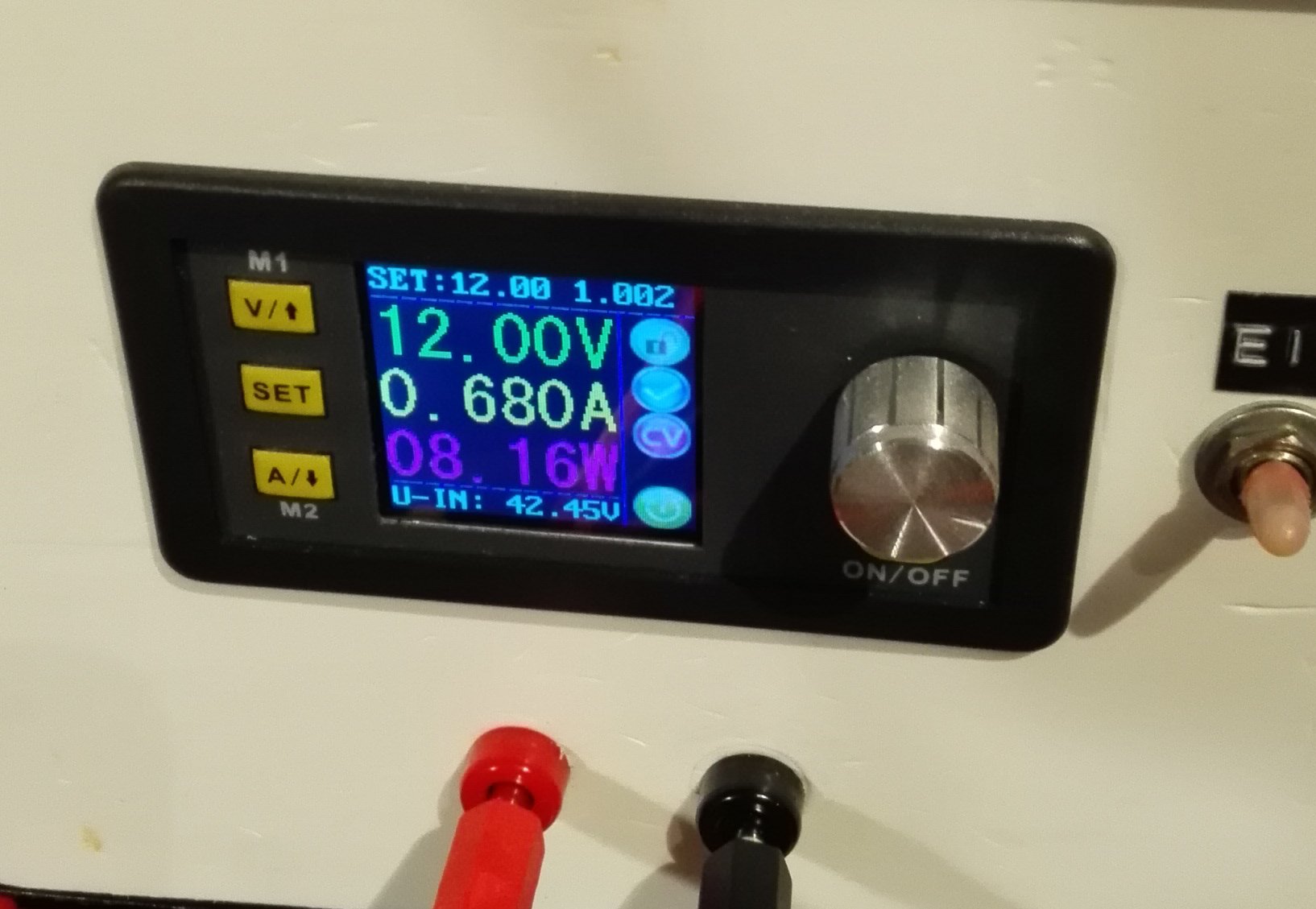

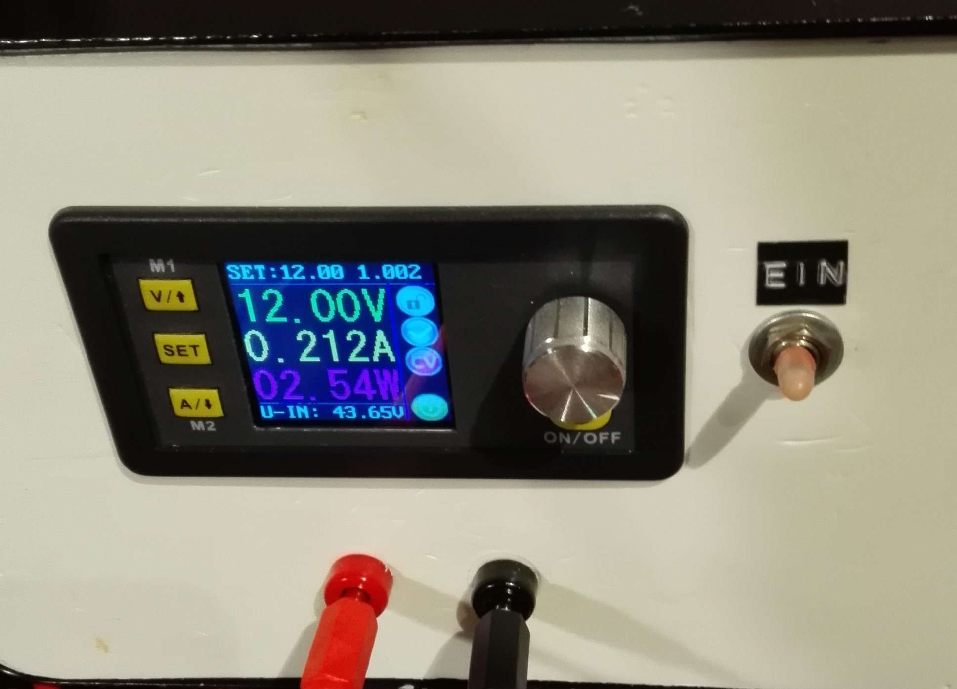

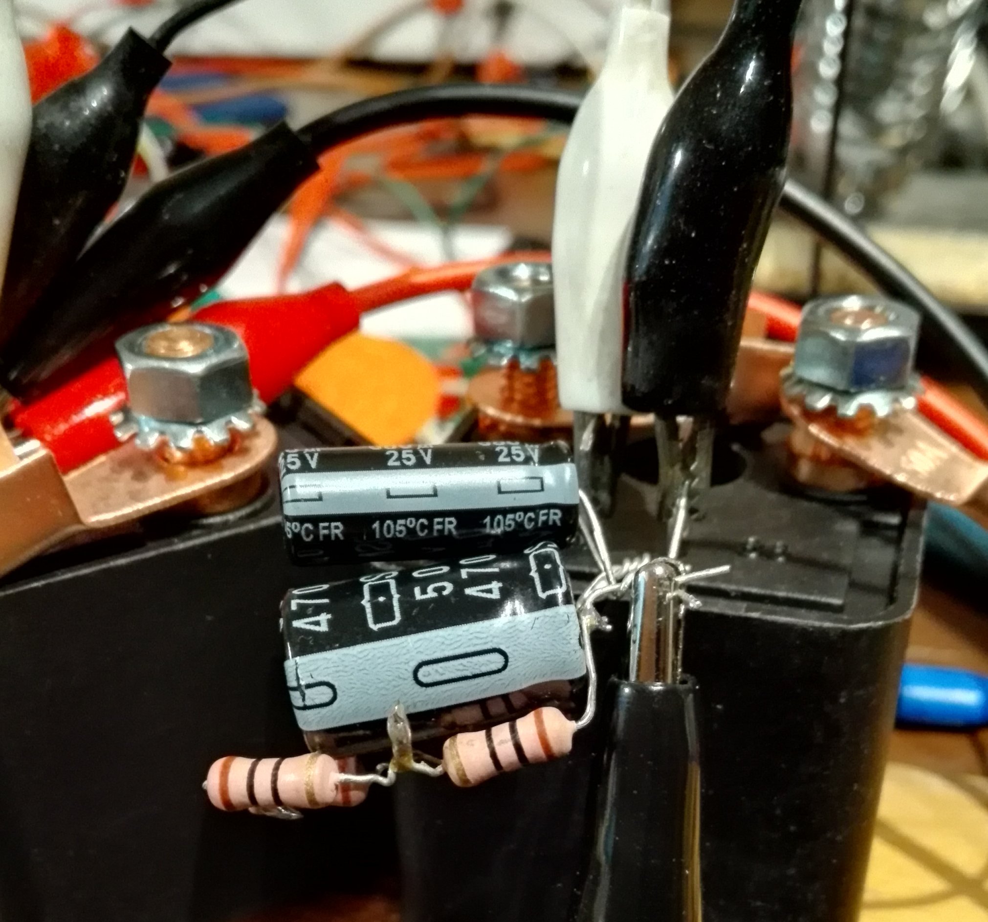

I bought some chunky relays as charge port contactors. As it is with chunky relays they take a lot of current into their coil to make contact. Two of these take in a hefty 8.2W. So at the risk of being told "but Johannes this was invented by Nicola Tesla in 1870" I want to propose my simple economizer: Just put some resistors in parallel to a capacitor in series with the relay coil.
In this particular case 1000µF (10V model is sufficient) in parallel with 40 Ohms. Cap takes long enough to charge to energize the coil and make contact, after that the coil voltage drops to 3.5V via the dropper resistors. The relay drops out at about 2.4V so enough margin.
Power consumption drops to 2.5W for both relays.

Yes the 4x10 Ohm 2W models get reasonably warm. You can touch them without burn marks ;)
