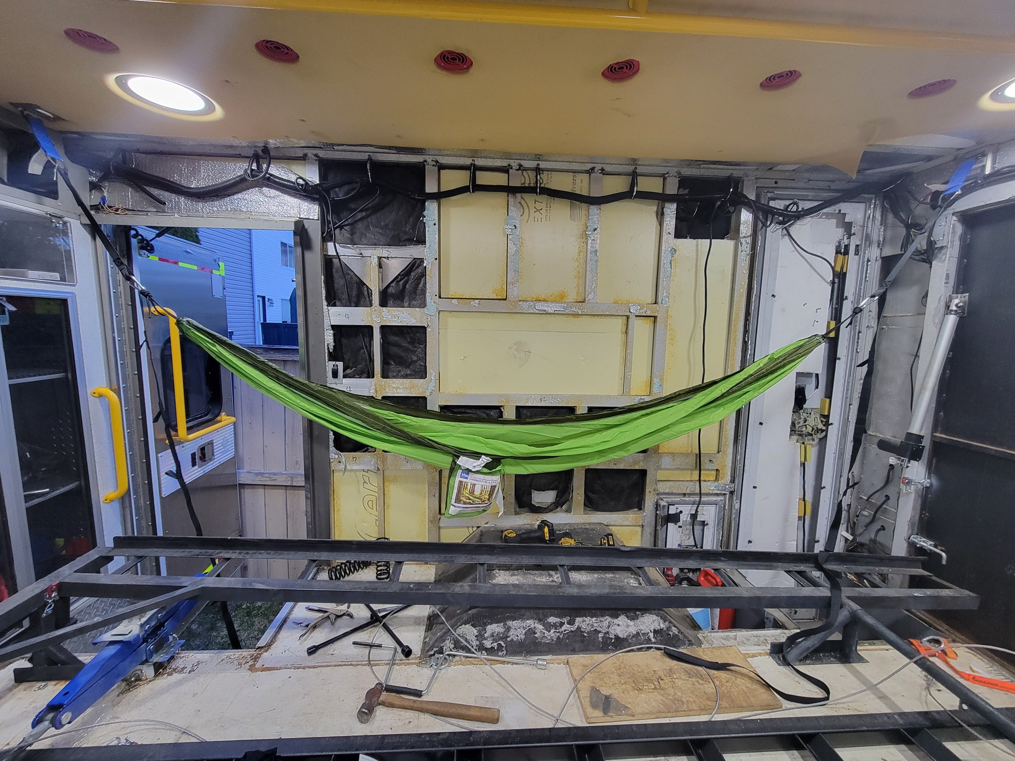

Its something like this on each side,
https://dccargo.com/products/e-track-ra ... 3253870786
and shoring braces like,
https://dccargo.com/collections/load-lo ... r-aluminum
Across from left to right. Then its plywood or some other lightweight but strong paneling to put something to sleep on above the shoring braces.

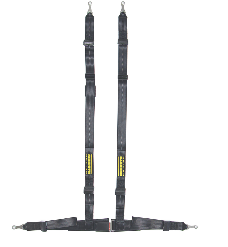

So my wife talked me out of the platform idea because she wants a hammock for the yard. I couldn't figure out a good way to span the back bay so I was about to buy some hinges and make a folding table that would work as a bed, but I guess the hammock is less work. I didn't realize you're supposed to lay in them diagonally though. Not sure that's going to work since it's necessarily so close to the wall. Feels comfortable enough to lay straight in it though...
Since I had already dug out the bits of e-track I saved, I just used them as anchor points for the hammock. Glad I kept the d-loops too because they are perfect for this. There's a line in the rule book that states the battery must be within the structure of the car (I heard elsewhere it was mostly there to make sure people don't put batteries in the side pods of a formula car without some kind of structure around them). I was a bit worried someone would complain about the battery being above the level of the chassis, so I built this just in case. Turns out finding a 6 point harness in town is a little less easy than I thought, but I found a place that could bring one in. It's HANS compatible if I ever want to do road racing or something. I do need to verify it's not REQUIRED that you use the harness with a HANS device though. Apparently some are like that. Need to phone the manufacturer on Monday. It also has to be a 6 point and not 5 because when I built the car, I welded two anchor points below the seat.
The 6pt: https://www.holley.com/products/safety_ ... /747007RQP And what I currently have: https://www.schrothracing.com/item/rallye-cross/ Yes it's only 4pt, but one of the shoulder belts has a section that stretches in a crash and lets your torso turn slightly, like a standard 3pt harness. It's also DOT legal and easy to use, which is why I bought it. I may stop driving the car on the street though, so at that point it wouldn't matter. Especially if I also need to add the roll cage to run in BC. Still haven't heard back from them. I got a heads up they were going to discuss it yesterday and haven't heard anything since, so I'm thinking it might not be good news.

6 point is definitely more comfortable, especially when you tighten it up.
Is this your only seatbelt? Do you need a DOT (not sure what Canada uses) seatbelt for driving on the street?
My caged car has the original seatbelts installed if I drive it on the street because my 6 point harness isn't DOT. You can find everything but availability / manufacturers who offered them was pretty limited last I looked 12 years ago or so. It's definitely nice to be able to drive on the street to check things before a race. Did I get all the air or of the brakes, coolant system running properly, etc.
Does your current harness have provisions for the anti-submarine straps? Some do, those might be easier to find. And if you're driving on the street you can leave those disconnected.

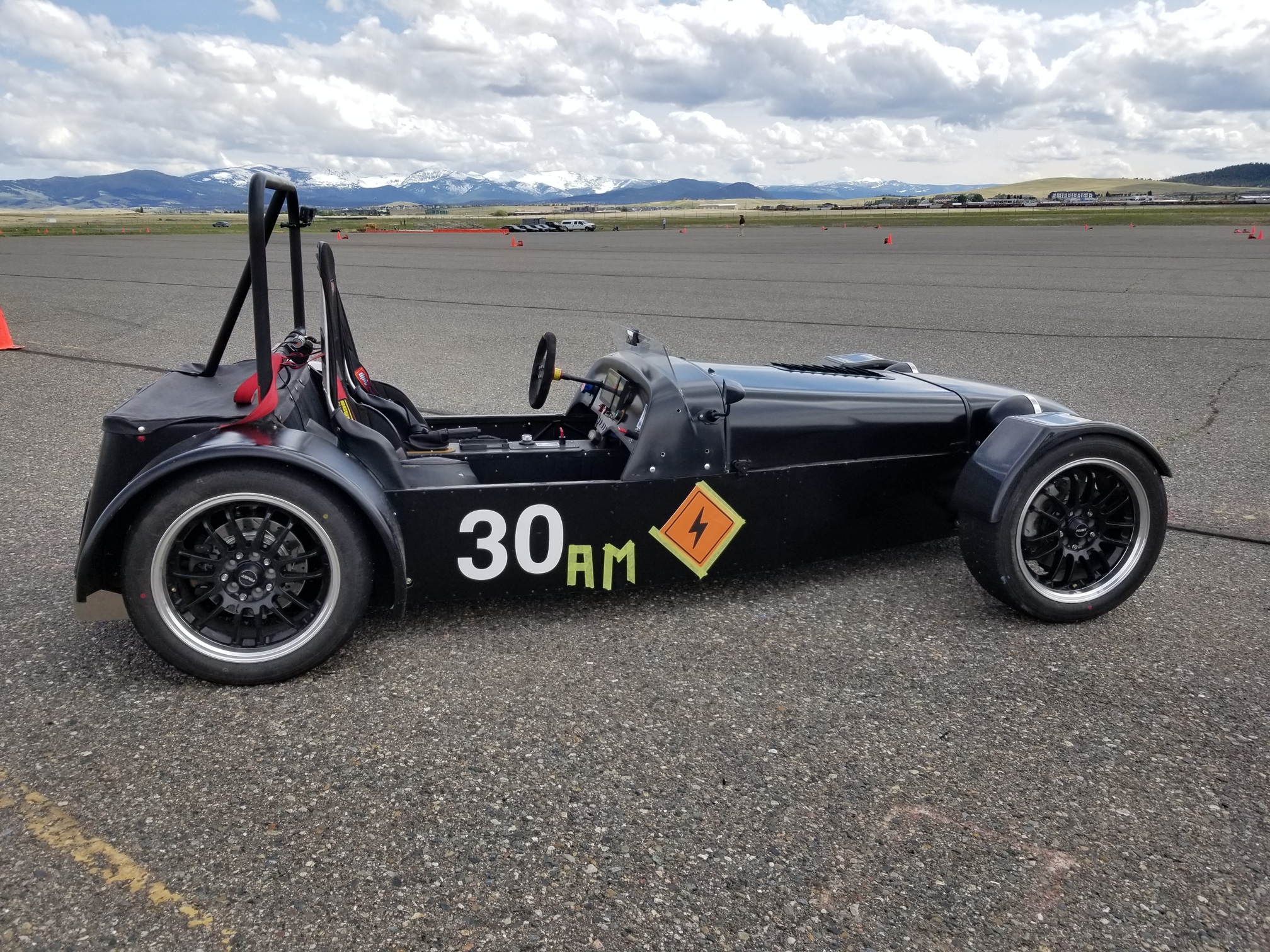

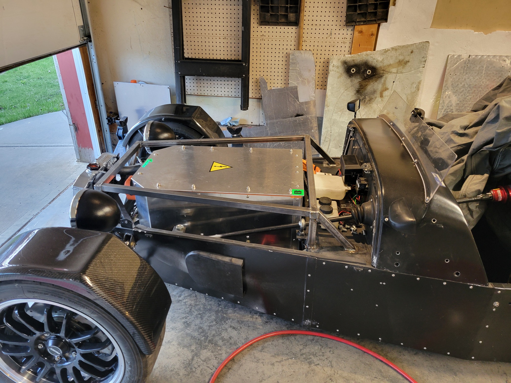

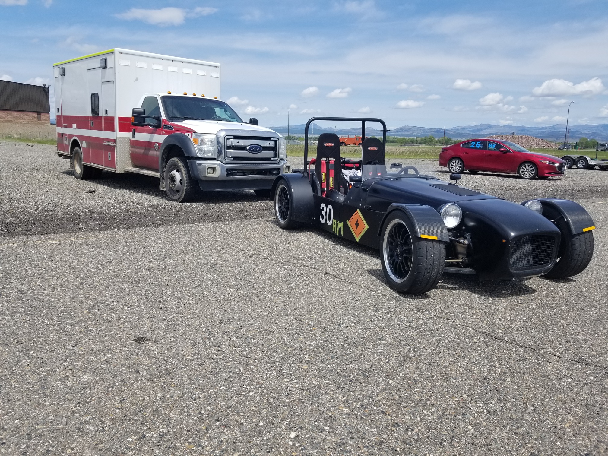

Just got back from an event in Montana. Had to move quickly to get ready and didn't have enough time to get everything 100%, but I made it work!
I found a 6pt harness locally that I was able to install. It's not DOT, but I'm leaning towards not driving the car on the street anymore anyways. Before I started this conversion, I asked my insurance company if there were any issues with it being converted and they said no. Two weeks ago I got the car appraised again since you have to do that after any substantial changes. The insurance company said "hold on, it's not powered by flammable liquid anymore? Now we won't cover any loss or damage". I called around a bit and got the same story from every other company. Hagerty told me they have an agreement with the province that restricts them from insuring EV conversions of any kind. Are you KIDDING ME?! I guess if I stop driving on the street, I can replace my tires with slicks and add some aerodynamics without worrying about range.

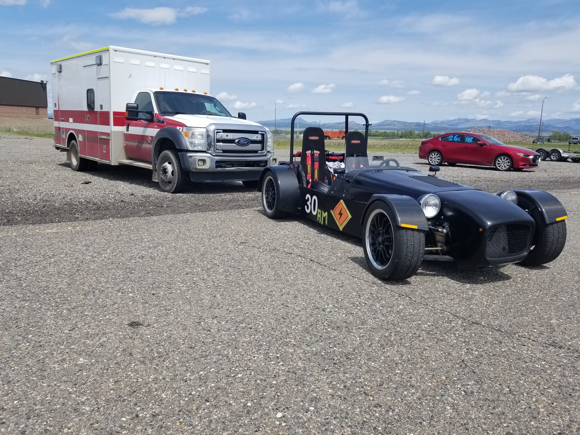

Anyway, back to the trip. The car did amazingly, drivetrain-wise. Drove nice and smooth. Everyone thought it was really cool, and most had never seen anything like it before. I was having a lot of trouble with losing the rear end going into corners. I kept adjusting the brake balance forward, but in small increments it wasn't doing much. Finally I made a big change (15 clicks instead of 2 at a time) and that finally got me into the right ballpark. I had expected to have to shift it forward a bit and started out maybe 5-10 clicks ahead of where it was with the bike engine, but obviously that was nowhere near enough.
I also had to turn regen way down. Right at the limit of braking, any amount of regen seemed to cause a rear wheel to lock up. I never really thought about it this way, but because it's an open differential I think the regen torque can get sent to one wheel and cause it to lock? Just like how one wheel will spin when accelerating. At least, that's my best guess about what's going on. Turning regen way down made the problem mostly go away, so I think I should try turning it off completely.
I wondered if there would be any trouble with cooling, but with the big radiator it was perfectly fine. The batteries stayed around 25c which wasn't too much above ambient temperature.
And speaking of temperature, the extra weight and improved balance helped me get the tires up to operating temperature, which is something that I had struggled with in the past. I was hoping that would happen!
This venue was pretty cool. It's also used as a police training track so they have a big skid pad and a small road course. My runs were 80-some seconds long, and we got 12 runs through the car. Each run used about 0.8kWh of energy. It would have been good to charge at lunch because the drop in power was noticeable, but I did manage to get through the day. There's probably 3 hours or so between morning and afternoon runs. I could probably get by with a 2000w inverter and 5kWh of storage in the ambulance, or a 2000w pure sine generator so I could charge anywhere on site.

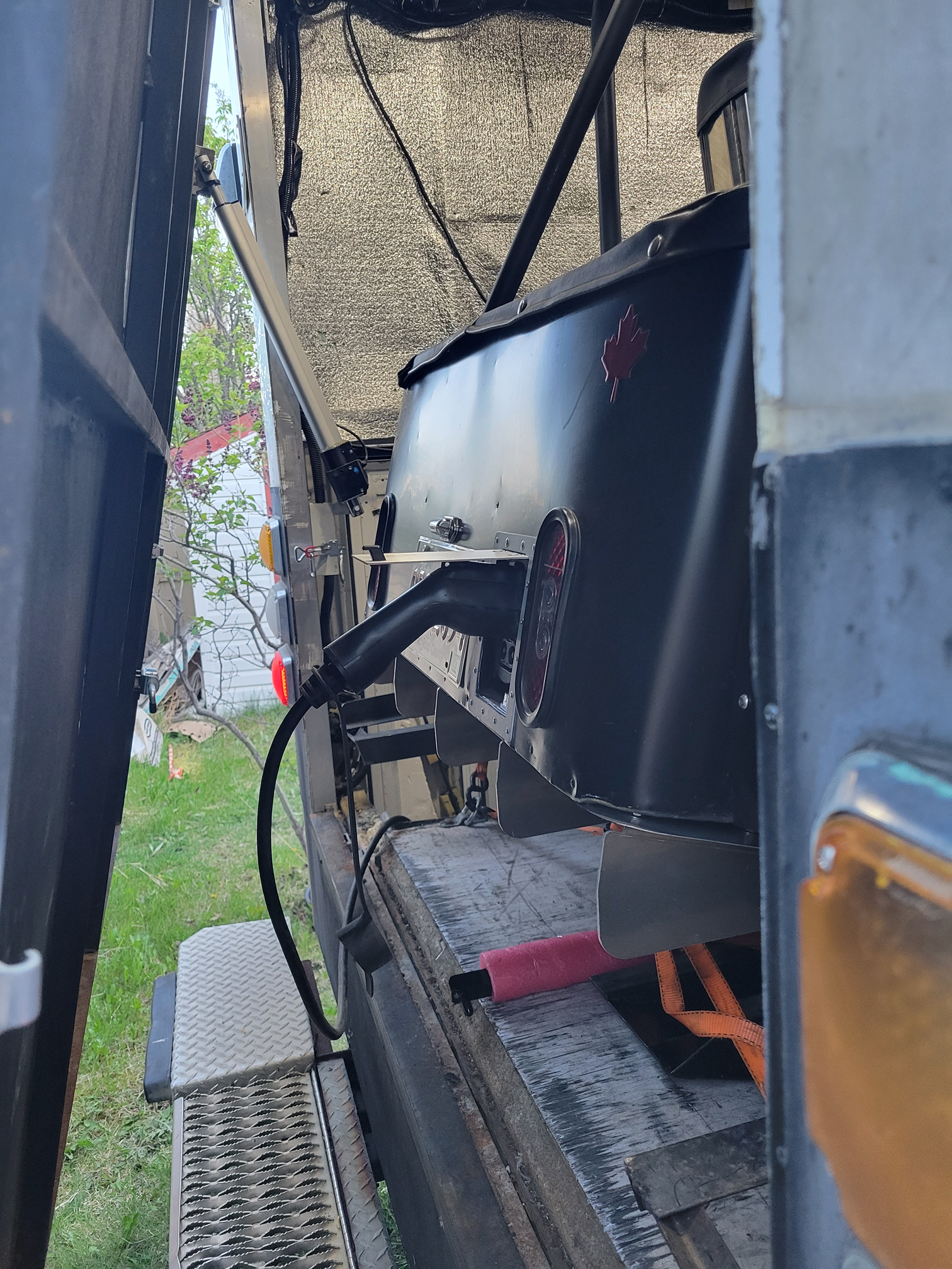

Also, one thing I did not consider when choosing the location for my new charge port, is that there isn't enough room to plug it in while it's in the ambulance. However, Foccci also isn't configured to shut off the EVSE when charging is finished, so I may reinstall the other charge port for L1/L2 charging. Oops. There was an event photographer there, so as soon as I can find their photos I will upload some of those too.

It's great you got to run it. The insurance side of things sucks.
Did you try raising the front end / lowering the rear? I'm guessing from your video, especially the end that your roll axis is off. Did you get to try the skidpad at all? I'm guessing the rear will let go first. You also need a bunch of extra rear roll axis bias because it's rwd. Are you able to throttle steer or does it just come right around?
Anti lift geometry / more of it very likely would help too but somewhat depends on what's going on.
It's looking like you have more front grip vs the rear as your main struggle after maybe too much rear braking. But if the roll axis favors one end too much this will also mess with your brake bias.
You may also find that a more progressive throttle ramp helps mid corner drivability. And if your throttle foot is bouncing during the video some more throttle smoothing would likely help too.
Regen is like slowing down with a parking brake in your case. You had a bike engine previously so not much decel as a comparison / reference.

Hmm, lots of different opinions on RC that I can find online. I don't seem to have recorded my reasoning in my design notes, but checking my CAD files it looks like I've got a front RC 3.7" off the ground and the rear is 4.7". I guess my CG has changed too, need to factor that in. I did have to raise the rear by about 1/8" because the rear springs were about to loosen at max droop. Had to go stiffer than originally intended due to the rear weight being slightly higher than expected. I did get better launches with softer rear springs but also bottomed out over certain bumps and dips in the road. So that could definitely be playing a part as well. I could get some helper springs and try lowering the rear a bit?
Didn't get to mess around outside of my 12 runs but during the long corners at the beginning of the course I did notice I could throttle steer reasonably well. Plenty of front grip, yeah, so that's why I'm thinking it's time for a sway bar. It was especially evident to me on the slalom section.
Hadn't thought about throttle smoothing.. Next time I should set it up to log potnom (among other things) so I can go back and see if I'm doing anything I shouldn't. I guess, as the day went on, my torque at higher speeds dropped along with my voltage so that could have somewhat masked any issues early on in the day.

How harsh is the bottoming you mention? When the suspension bottoms hard that bottomed spring rate goes infinite which can cause snap steer and other suspension gremlins. My suggestion would be to raise the rear 1/4 to 1/2 to make sure you have enough travel and raise the front 1/8 to 1/4 more than how much you raise the rear. Getting away from bottoming should help you see what the suspension is truly doing. And roll axis can vary a lot from expectations. I usually try to balance the vehicle without swaybars first then add the swaybars in and then balance them into the mix. You could maybe use swaybars to mask the issue but it's still there. You can chase suspension quirks that are masked under layers..
And for clarity adding swaybars may solve the bottoming and solve the issue. But if adjusting ride height isn't too much work it's worth trying. Swaybars will help slolom once you get things right. They also make the suspension stiffer so could make it snappier if they don't mask the issue(s) well. And you'll likely be able to lower it again but this should help you find it's balance.
Tire pressure could help some too, especially if it's bottoming.
You have some impressive cornering g's in the video, how does this compare to the bike engine?
I didn't mean you sounded rough on the throttle. Bumps look a bit harsh from the video. If you are bouncing it makes it very hard to be steady on the throttle.

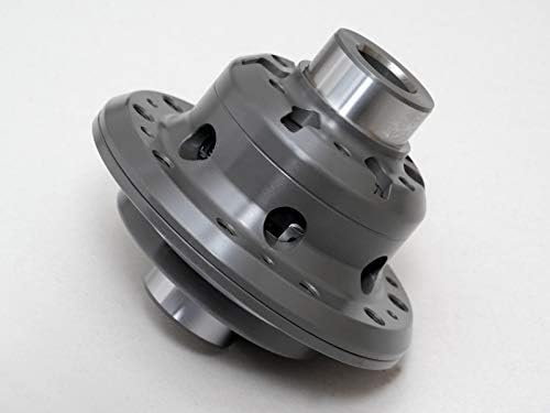

This makes a lot of sense. I have been researching lsd options, and the Nissan h233 has a clutch pack type, which means I can rebuild and adjust lockup/break away torque. Which for a daily driver, is going to be important.
From my understanding the nissmo diff is from quafie, meaning it’s an atb.

Limited slips come in different flavors. Moist people's focus is on acceleration but there is usually a decel aspect as well. You'll often see a 1.5 if it's a clutch pack style lsd. This is 100% limited slip forward and .5 (50%) in decel. They have different cams to give different % as well as different stack options.
Note that an open diff will drag the inside / unweighted tire on too much decel, you still have cornering grip on the weighted wheel. Adding limited slip in decel distributes the torque more between the 2 tires which can get you more decel grip but can trade it for cornering grip / grip snap. It can also try to force similar torque between the 2 wheels which can have a stabilizing effects up to a point.
It depends on what you're looking for but I'm not sure a limited slip will help with decel oversteer / skidding.

I have a theory about that too. When braking near the limit and the regen torque locks a wheel, it's going to be the wheel with less grip. In a straight line it might just be the one with less weight on it, and very likely the same one that would spin when accelerating in a straight line. The instant that wheel locks up, the regen torque has to go to the other wheel, adding to its net braking torque and possibly locking it as well. Maybe it wouldn't lock if you are already turning and there's a bunch of weight transfer already on that wheel? I wonder if I could somehow add wheel speed sensors that would alter the regen if a wheel stops?
Is the Nismo diff the only option for the Leaf reducer box? It's the only option I can find anyway. I think it would be fine for my application (at least from my other experiences with a torque sensing diff). Just have to actually get my hands on it.

Yes for sure, I’m just not familiar with the Quaife atb units with how they work/ behave. Are they just a worm gear set? Are they multiway? I wonder how locked down the nissmo units are, if we can adjust the breakaway?jrbe wrote: ↑Tue May 20, 2025 4:43 pm Limited slips come in different flavors. Moist people's focus is on acceleration but there is usually a decel aspect as well. You'll often see a 1.5 if it's a clutch pack style lsd. This is 100% limited slip forward and .5 (50%) in decel. They have different cams to give different % as well as different stack options.
Re: [Driving] Homebuilt Locost 7 - from Motorcycle engine to Leaf power!
Not sure you could adjust a helical diff at all, unless you got creative with shims maybe.
Doing some digging and apparently Cusco makes an LSD for the note e-power. Now the Nismo catalog seems to indicate the Nismo LSD is the same between the Note/Leaf and just the seals are different. I wonder if this Cusco would fit a Leaf reducer box? It's a clutch type, and they say it's a 1-way but the RS series also appears to have the ability to function as a 1, 1.5 or 2 way. Now since my motor is mounted backwards a 1-way would be more like a negative-1-way. The chart they have shows the 2-way configuration functioning the same in both directions but from the shape of the cross shaft I'm not so sure about that. At least it looks reversible from the exploded view.
Damn, that's kind of tempting. I can only find the Nismo on ebay for like $3k CAD, but the Cusco... https://atomic-shop.eu/products/cusco-l ... -note-he12

I don't know the fitment answer. Nissan may have used the same diff in the note/ leaf but a replacement diff may have clearance issues based on it's shape / size.
Most diffs won't be reversible but the cusco diff looks modular and may be able to be put together backwards. They will likely have at least a pin to prevent installing it backwards. It's definitely worth digging deeper into. You may also be able to buy the inner cross / cam to adjust the lockup profile - if they're willing to sell parts. But for the price you could buy a second unit and mix and match.
Helical diffs have different designs. From driving a few some do a little in decel and some seen to have no real effect in decel.

It's worth asking if there's something preventing the Cusco diff from fitting a Leaf transmission and if the internals could be reversed.

Update on the Cusco diff, I spoke with Cusco USA and they told me this diff only functions as a 1-way (no cams for 1.5- or 2-way). However, they did say they confirmed it will fit the Leaf reducer box (which I expected) and they think it should be fine to flip the internals so that it at least functions as a 1-way in the correct direction for my application. Should be getting a shipping quote soon and we'll see what that comes out to. I also want to do a bit more research to satisfy myself that a 1-way is worth the cost and effort.
Found a picture on the Japanese Amazon listing which might show the actual diff rather than a generic photo of a RWD diff. Also working on a front swaybar design. It's going to be a little tight fitting it around the rest of the suspension but I think I have a plan. I'm going to go with 3/4" OD tube and get several different wall thicknesses. Then two holes on the ends for the endlinks so I can make lots of adjustments to dial it in. That should be easy enough to achieve this season, then over winter I can look at adjusting my suspension geometry.
And I'm looking at trackside charging options. Looking at the timestamps from my videos I had almost 3 hours elapse between the end of my morning runs and the beginning of my afternoon runs. I used about 5kWh in the morning so if I can get most of that back into the battery in 3 hours that would be great. Getting a 240v system seems difficult/expensive, but even L1 charging at 1500w would be pretty helpful. I've been advised by Thunderstruck that I really do need a pure sine wave fed to my charger, so that rules out conventional generators and MSW inverters. Trying to see what I can find on the used market in terms of inverters and batteries, or a portable generator. Looks like I want something rated for at least 1800w continuous if charging at 120v.

Do you have room on the ambulance roof for solar? There are some cheaper inverters that should be able to give you the 220v like a Deye. You could add batteries to the system too.

Ah, admittedly I don't really understand how the OI charging works, but the rulebook also has a few things to say about charging - including something about using common charge ports with an EVSE and the BMS has to control charging and all that. I'll double check though, and maybe I can add some code to my Arduino that's already on the CAN. Thanks for the idea!
I do have room on the roof for solar, yeah. Eventually it would be awesome to have some panels on there charging a bank of batteries. Maybe like a 230v/50hz inverter if I can find one cheaper than a 240/60 unit? One with a 12v input might be handy because I could start with smaller batteries and supplement by running the engine if need be, but that's a lot of current - even for my dual alternators.
