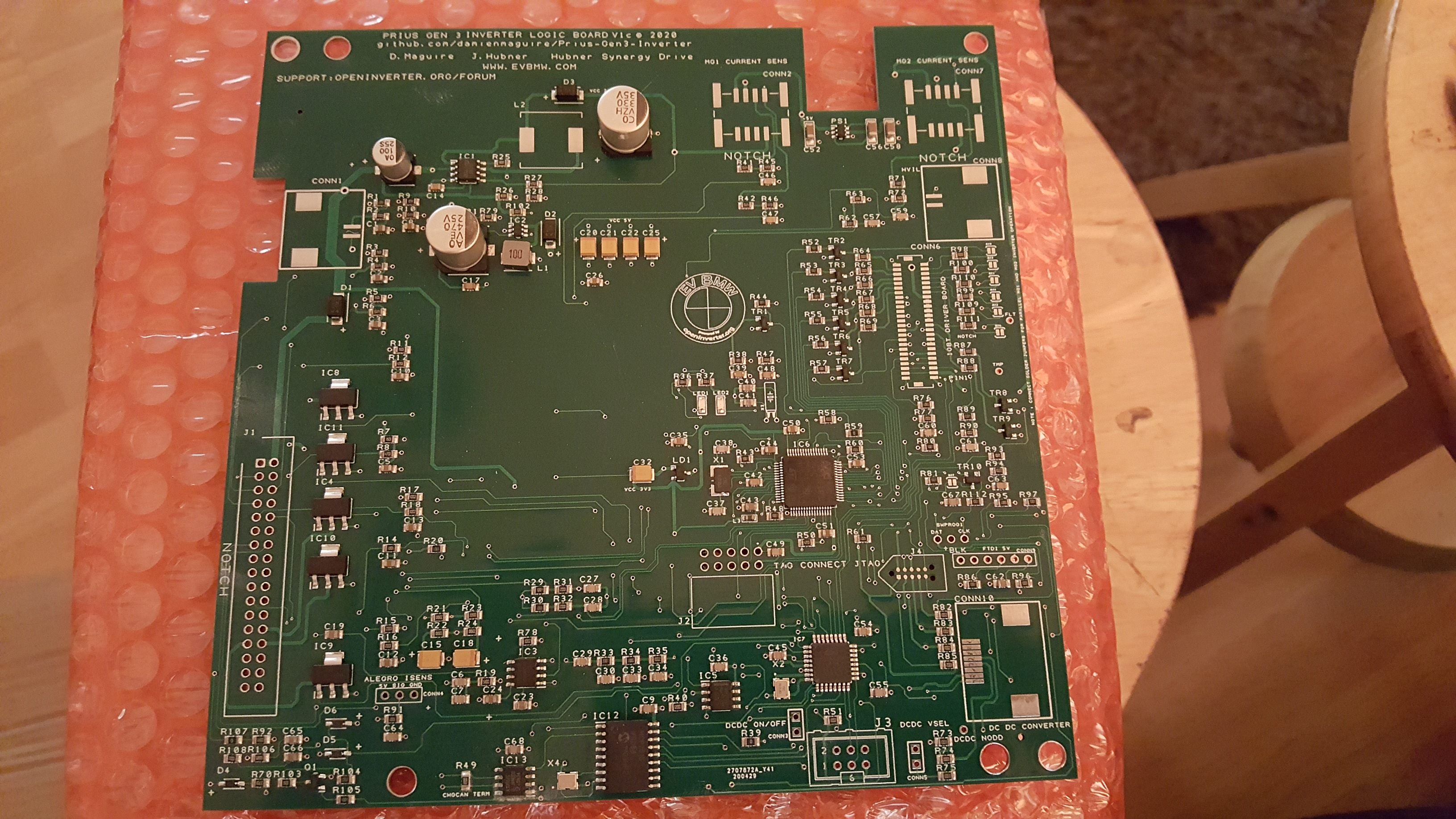

Well, decided f%&k it and have ten boards on the way from JLC. Added a few things like locking out the inverter when charging and solder jumpers to enable parallel MG1 and 2 operation. Once they come in I'll ship one to celeron55 for sw development. Naturally I'll be the guinea pig and install the first one in the E39 with the Siemens motor.

- Posts: 4006
- Been thanked: 1136 times
Re: Toyota Gen 3 inverter charger
New boards arrived from JLCPCB. Once I get back working I'll test and update the webshop and send a board to celeron55 and arber for beta testing the charger functions.
Ooh, this is looking awesome!Jack Bauer wrote: ↑Tue May 12, 2020 11:24 am New boards arrived from JLCPCB. Once I get back working I'll test and update the webshop and send a board to celeron55 and arber for beta testing the charger functions.
drop a line when they are on the webshop. will put in an order straight off.

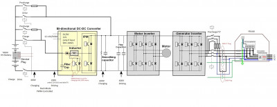

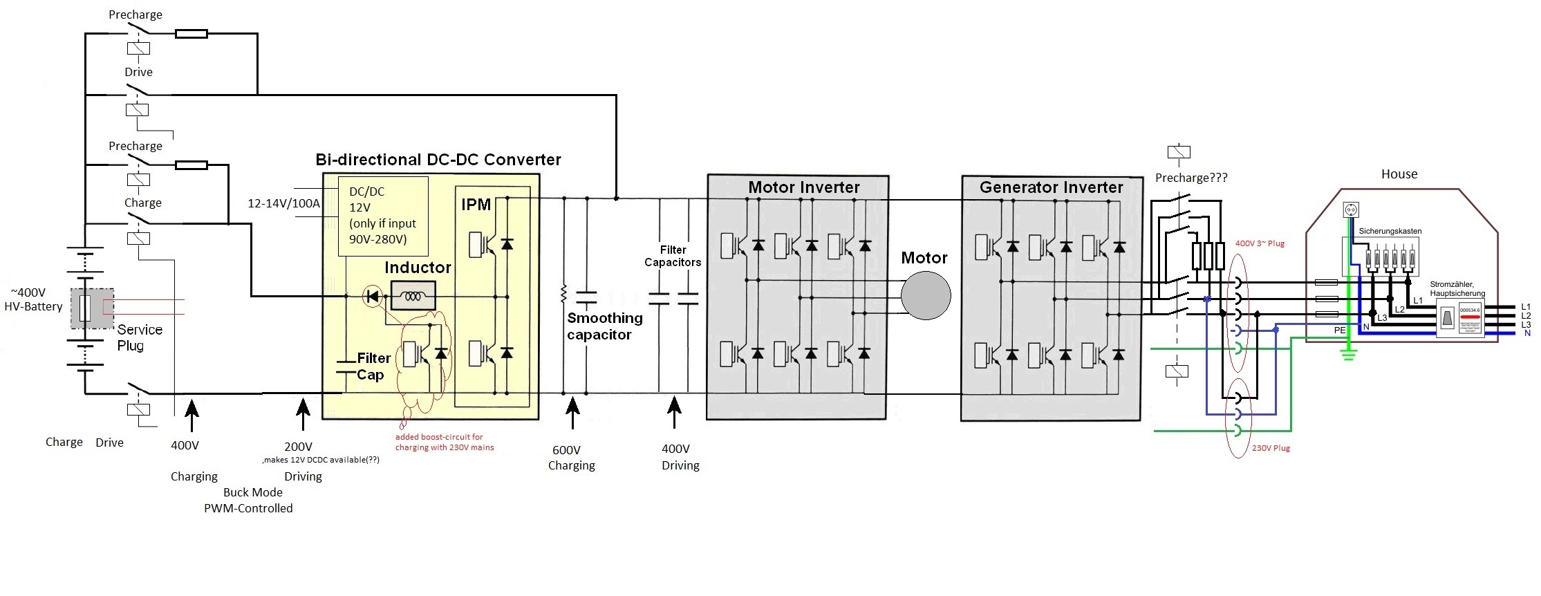

Hello, this is my first post here in this forum.
I'm from germany, so please excuse my bad english.
Since 9 years I drive an electric car (now an E-UP!) and since that time I'm dreaming of building/converting an EV.
I find the idea of reusing this cheap prius-device as a charger very good, and I will share my thoughts and ideas about this subject with you.
Although I'm an electrical engineer, this area is very new for me, but I think that I know the basics, maybe little more. A vew years ago I built a little powerstage for a small BLDC-Motor with Hall-Sensors, controlled by a Microchip dspic30f4012... but because lack of time I stopped this project.
But now, "corona" and my family give me time for playing around with this stuff again.
Since a few days I am tinkering with a Prius Gen3 Inverter and a Breakout-Board from Damien.
I have also the idea of using this inverter for high-power-3-phase-chargin in a converted car.
What about the Idea of switching the ~400V HV-Battery between the "low-side"-section of the Inverter while charging-sequence ...and "high-side"-section while driving?
And while driving, the buck converter could produce on the "low side"-section ~250V from the 400V traction-battery ("high-side"-section) for the 14V/100A DC/DC-Converter (12V-Bat-Charger).
Originaly as it is, charging could work with mains 400V 3~ AC, but with 230V ~ (L1,N, PE) it wouldn't work, because the "high-side"-rails have just 320V DC (lower than 400V traction-bat).
Therefore we need a boost-converter.
My idea is mounting a big diode and a switch-device (IGBT) between the big inductor and filter-capacitor on the low side.
Would it be possible (space, cooling?)? ...or maybe is it crazy and impossible?
Kind regards... Peter
Here is my idea in a circuit-diagram:

- Kevin Sharpe
- Posts: 1339
- Location: Ireland and US
- Been thanked: 10 times
How much AC power do you want? Maybe a Tesla PCS would be a better solution given it already has the bidirectional functionality;postmann2002 wrote: ↑Wed May 20, 2020 11:35 am Would it be possible (space, cooling?)? ...or maybe crazy and impossible?
viewtopic.php?f=10&t=171&p=11189#p11177
