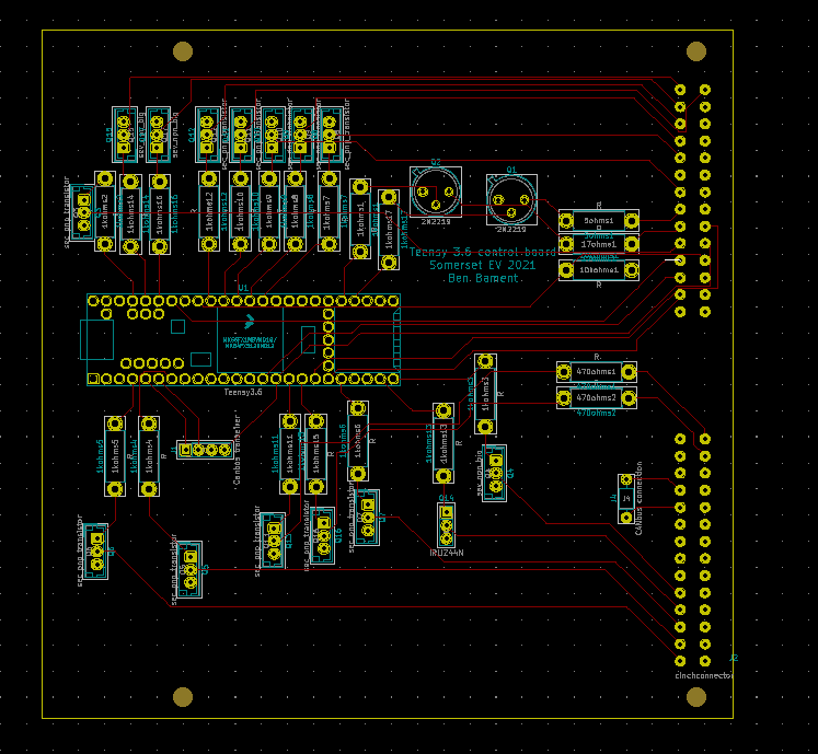

Finally getting some progress done on the PCB design front after flirting with the Zeva system. Decided against it in the end as its over £1,000 to buy the system and components are still hard to find if I was to get the boards made up. Will look into it again when components come back into supply.
I now have 3 additional power planes. Ground, 12v and 5v. Seems to make things allot cleaner.

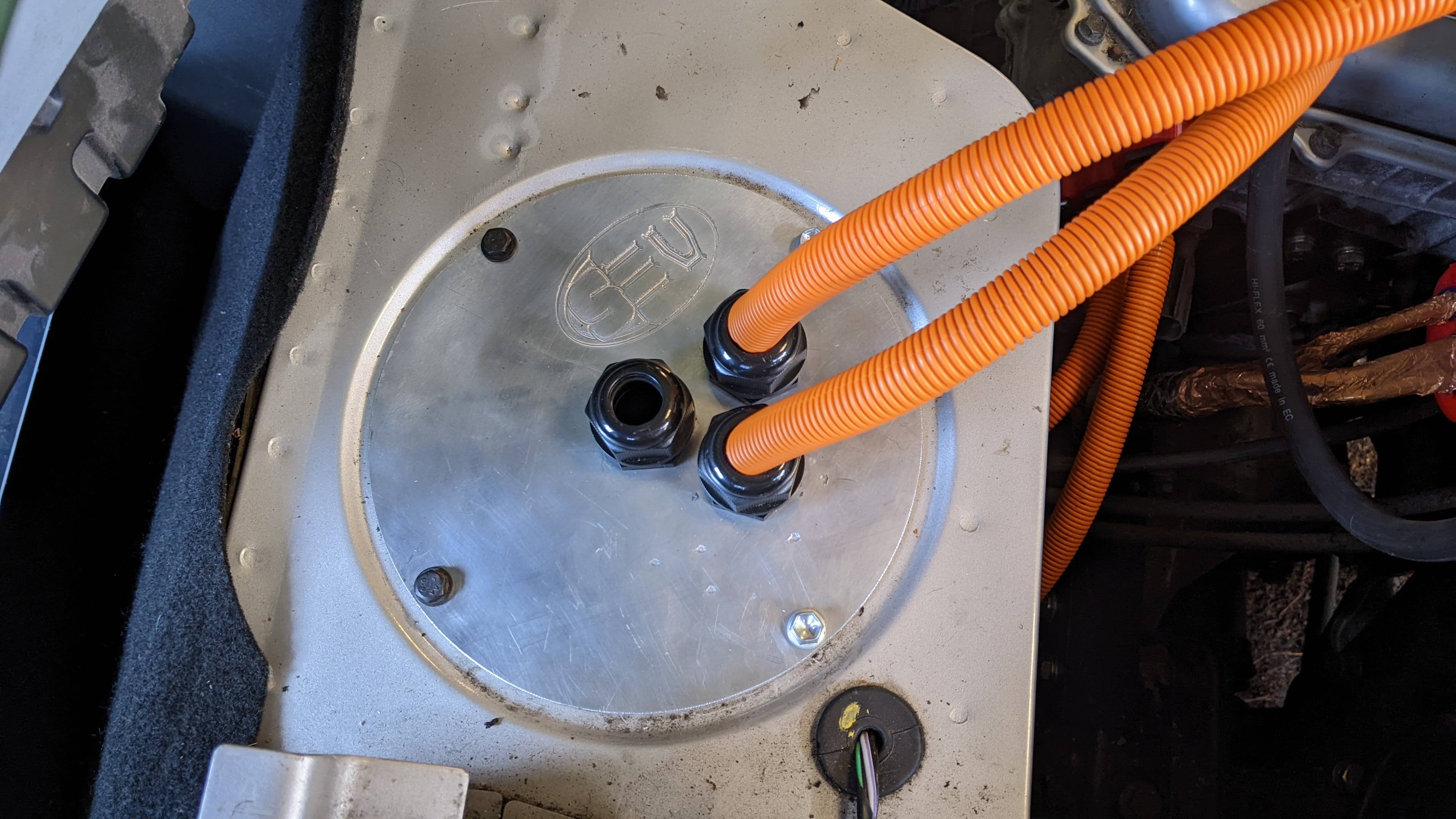

Physical work on the car has stopped now I have put the brakes back on. I'm currently painting and rewiring the two post car lift that I will use for the rest of the project. But before that gets installed I have to put the axle back on a front loader to move that out of the way, then clear out a ton of junk from the corner of the shed I want to use. The joy of farms!

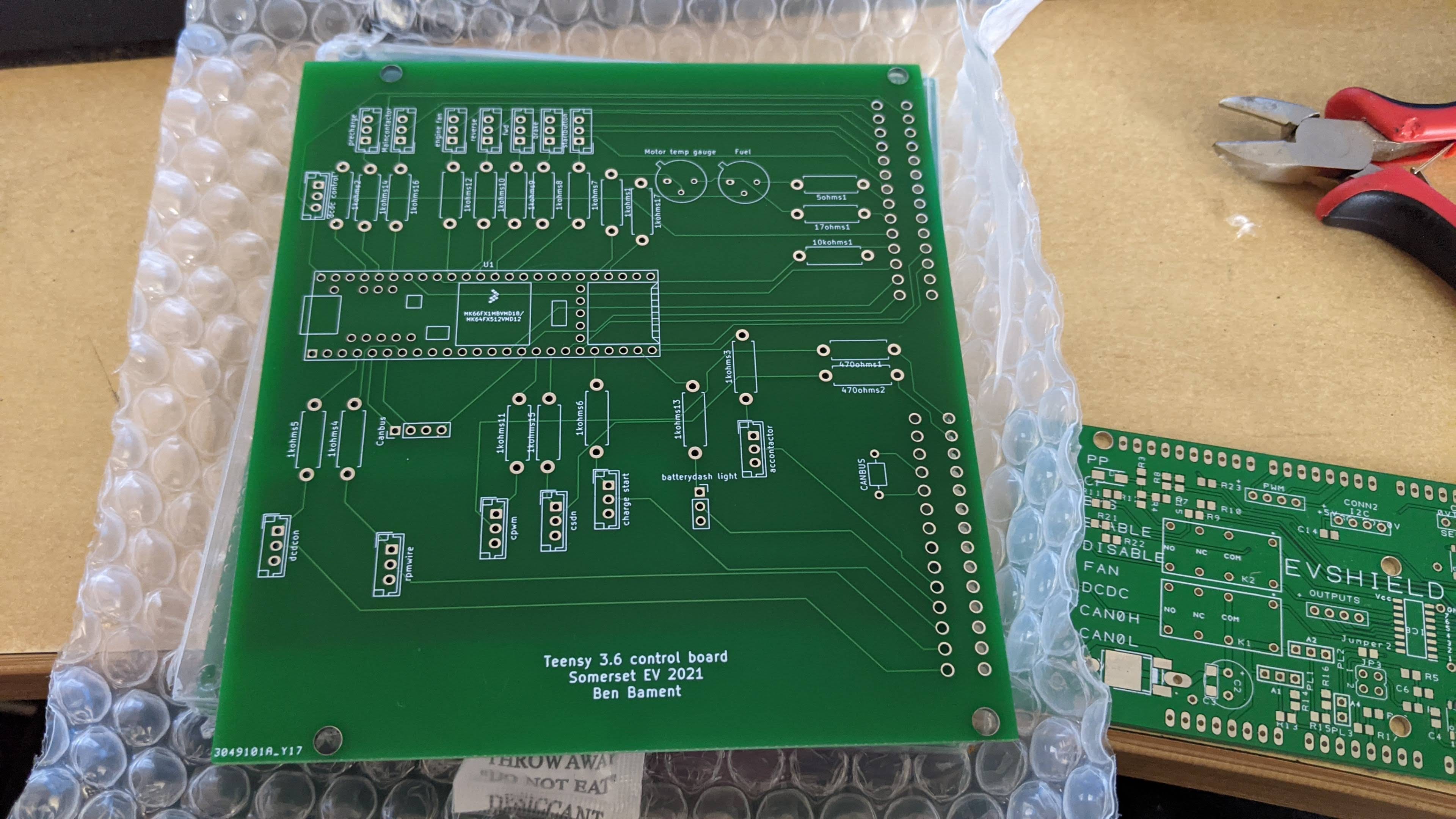

Got my order through from JLCpcb. The first pcbs I have designed! I think I might need to do a v1.1 and enlarge some of the traces. But I'll use one until it breaks and go from there. Arber's EV shield in the background as I was comparing the two.

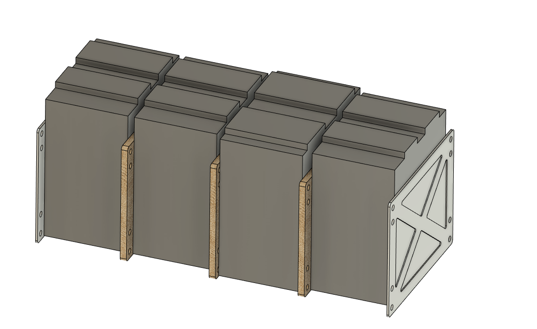

On the cell front I have designed some plates to help compress/contain the kokam cells, with plywood spacers between the modules. Sending the metal end plates off for plasma cutting this week and I will rout out the plywood myself on the CNC platform.

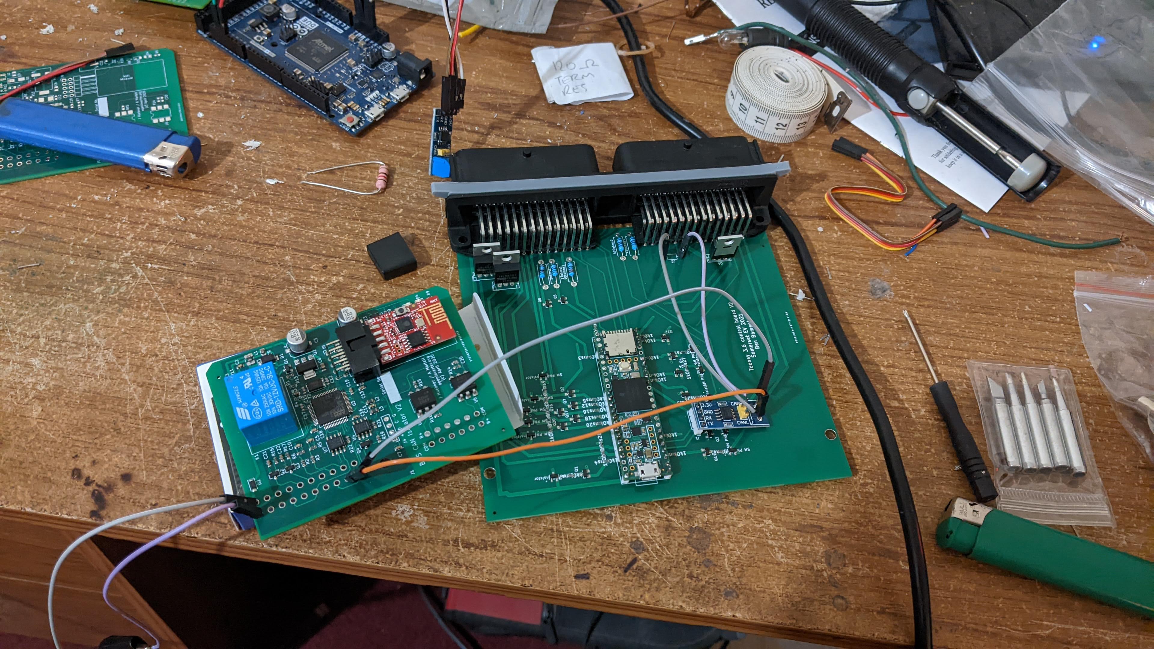

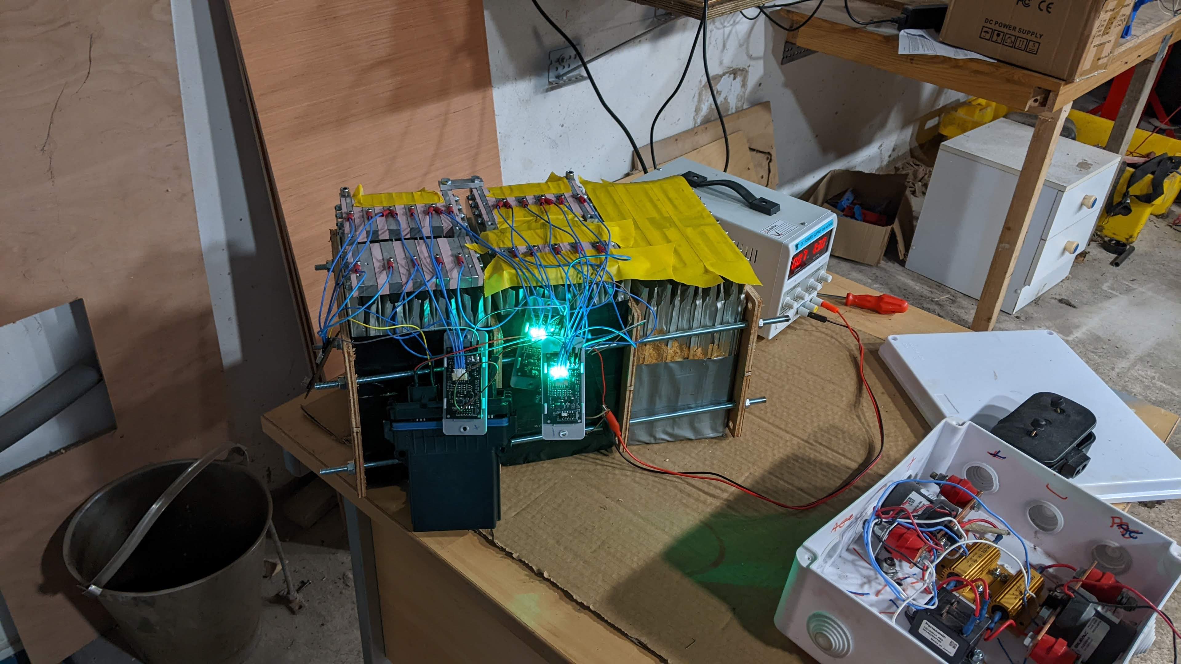

Finally have a complete OI BMS master module flashed and working. Using this I can get most of the rest of the programming done on my main VCU that will control most operations in the car.
Talking of VCU, I made a V2 of my control circuit, this time stepping up to surface mounted components and proper sizing of traces. Everything on it seems to be working so far. I have tested each aspect separately so I am hoping that I should be able to plug it into the car and be most of the way to it working.
Here it is hooked up to the BMS master module during some testing today. I also picked up some Tesla BMS slave boards last week. Those will be option 2 on the BMS front, but more likely end up in the next project. The idea for those is that they can be controlled with SIMP BMS or a variant of it for another cheap BMS option.

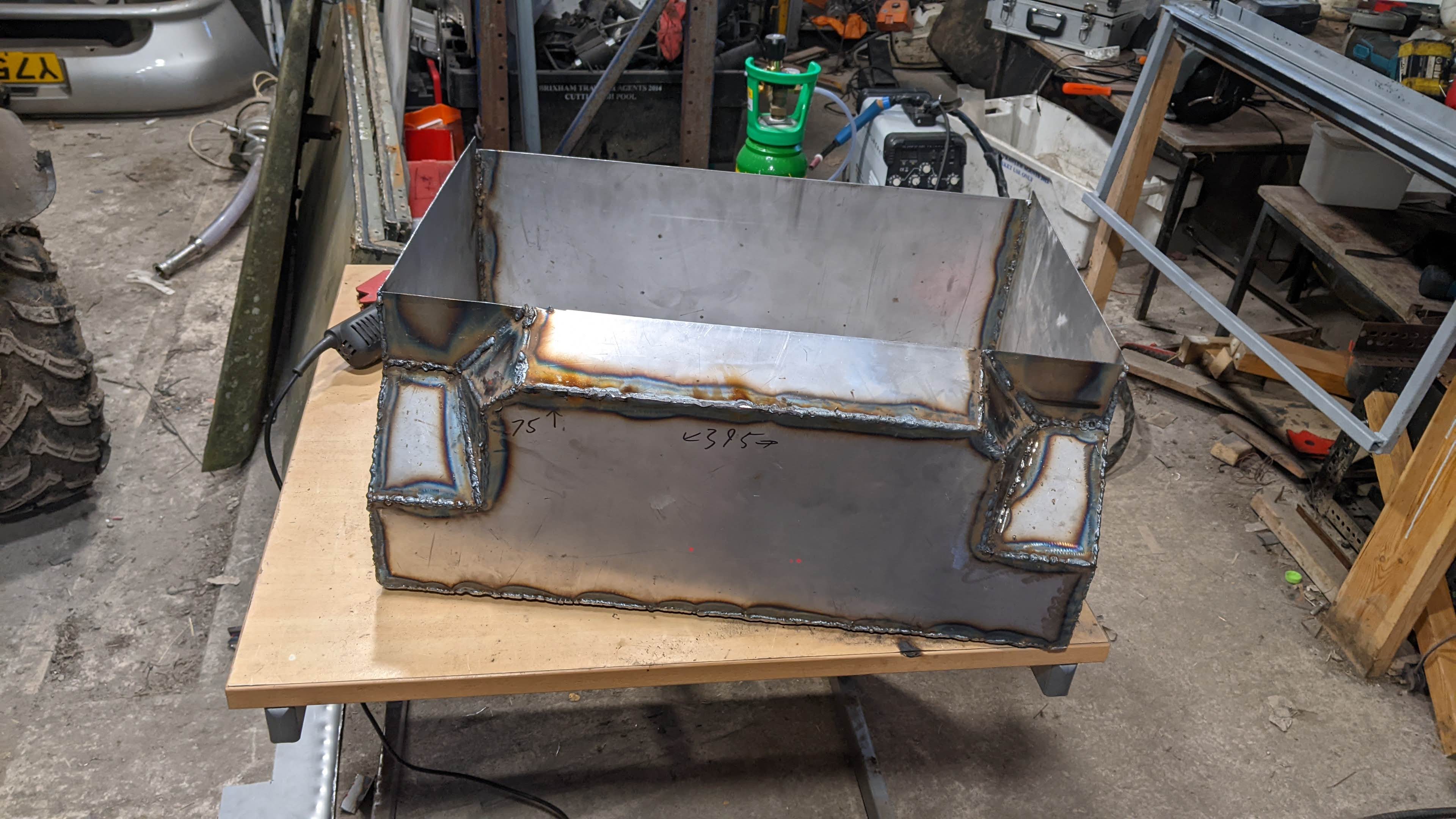

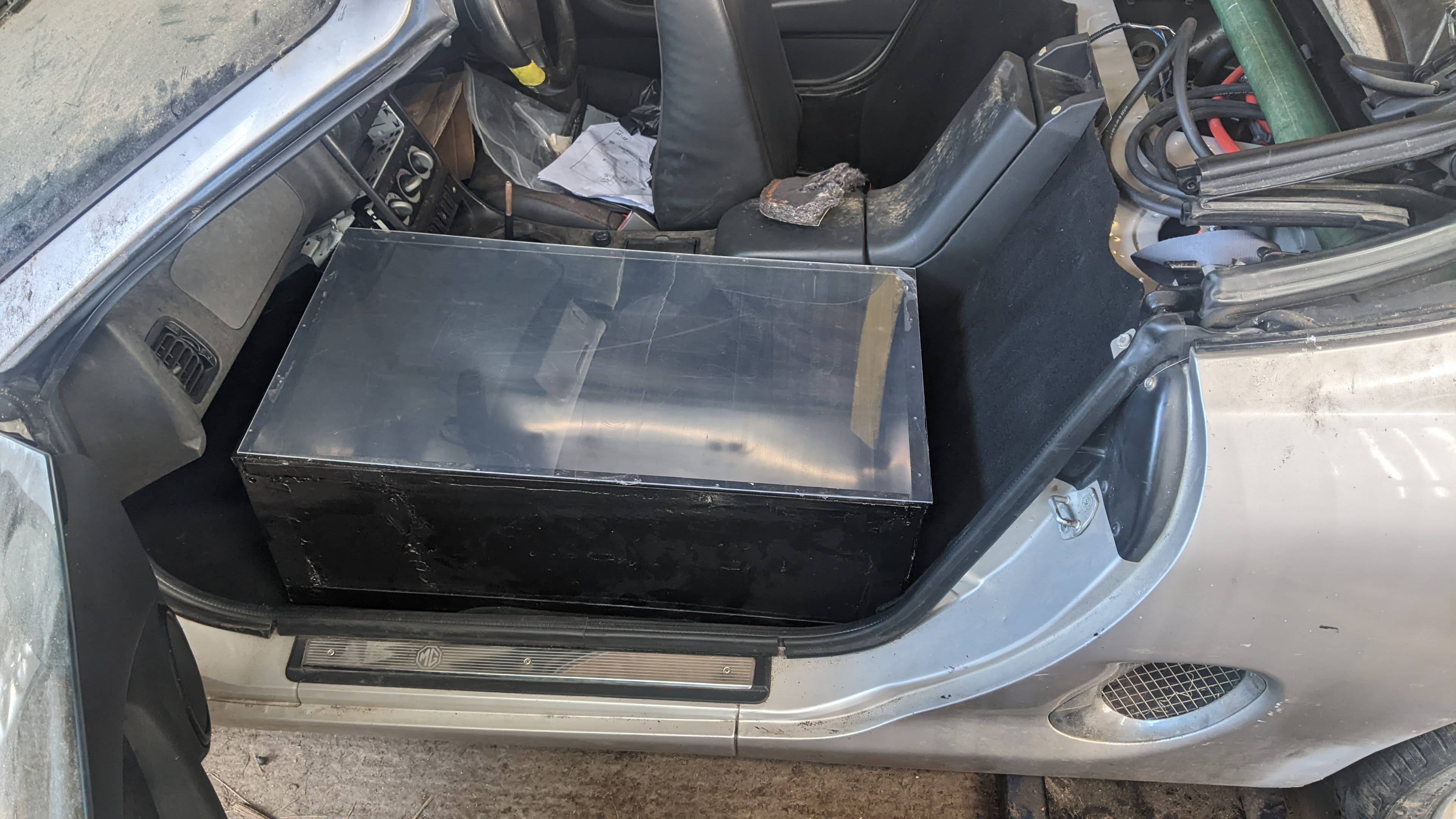

Got my car lift installed over Christmas, just waiting for it to get wired up in early March now.
In the meantime I have been fabricating my battery box and wishing I made more precise measurements. I think I can still fit all 80 cells in the front, but now I will need to have a second vertical layer in order to fit in the last 20 cells. This is the main box as it will go into the front subframe, the lid will be something even more intricate in order to house the second layer of cells.
Today I did the first proper testing of my cell compression/containment plates, along with running the OI BMS. Got 20 cells connected and voltage reading just fine. There is quite a bit different between the highest and lowest cell of 0.3v. So I left the BMS shunting the highest cells down to the average voltage. I think for the rest of the pack I will charge up cells individually. The plan is to assemble the whole 80s pack on the bench and then do a few charge/discharge cycle to find the dodgy cells. Considering getting a second prius inverter so I can test the charging side of that on the bench. Otherwise I am stuck charging the pack up 20 cells at a time at 5 amps.

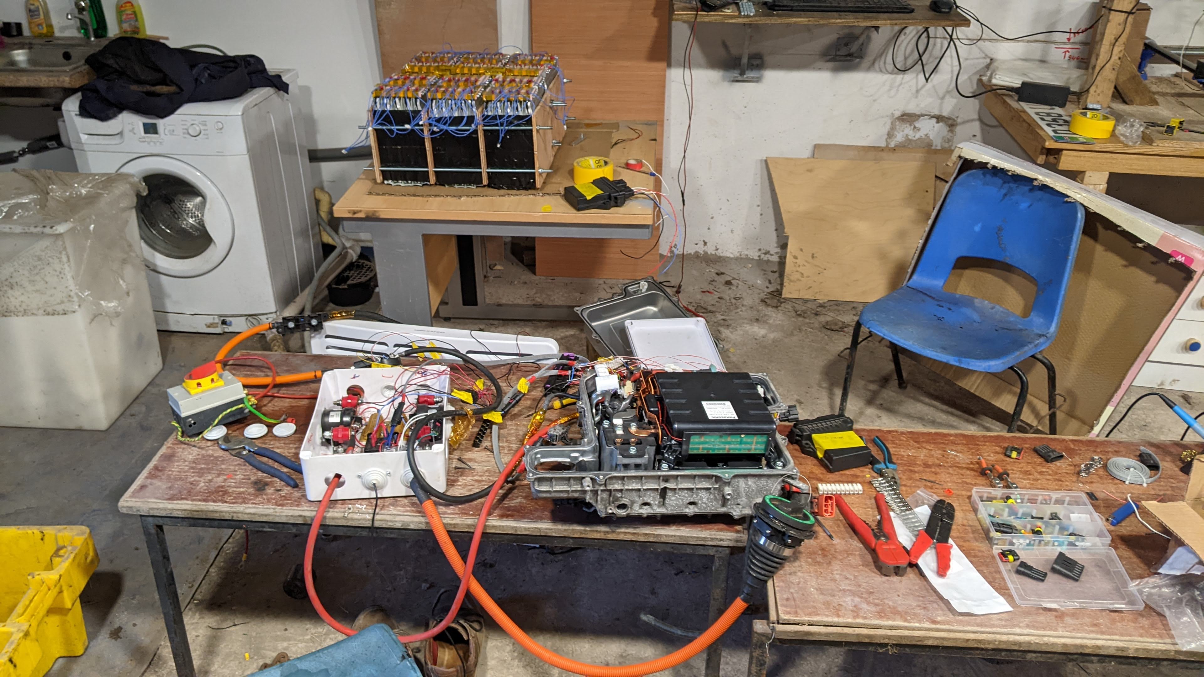

Setting up a final full scale bench test now. Mostly because the car lift still isn't wired up so I can't put the batteries in yet. But also because it's way easier to test everything out in the open.
Will have the 80s battery pack setup with OI BMS and ISA shunt, The prius gen 2 inverter with VCU, and my own VCU which controls charging and contactors, all communicating with CANBUS.
Hopefully when I am finished with this I will know that my VCU can handle contactor control, charging procedure and the difference between charging and normal driving. Also planning to give the battery a couple cycles of charge and discharge to verify all the cells are ok.
As a bonus I will probably also setup the Outlander Water heater as a drain, so I can figure out the control circuit needed for that.
Then it should be pretty quick to swap it all into the car.

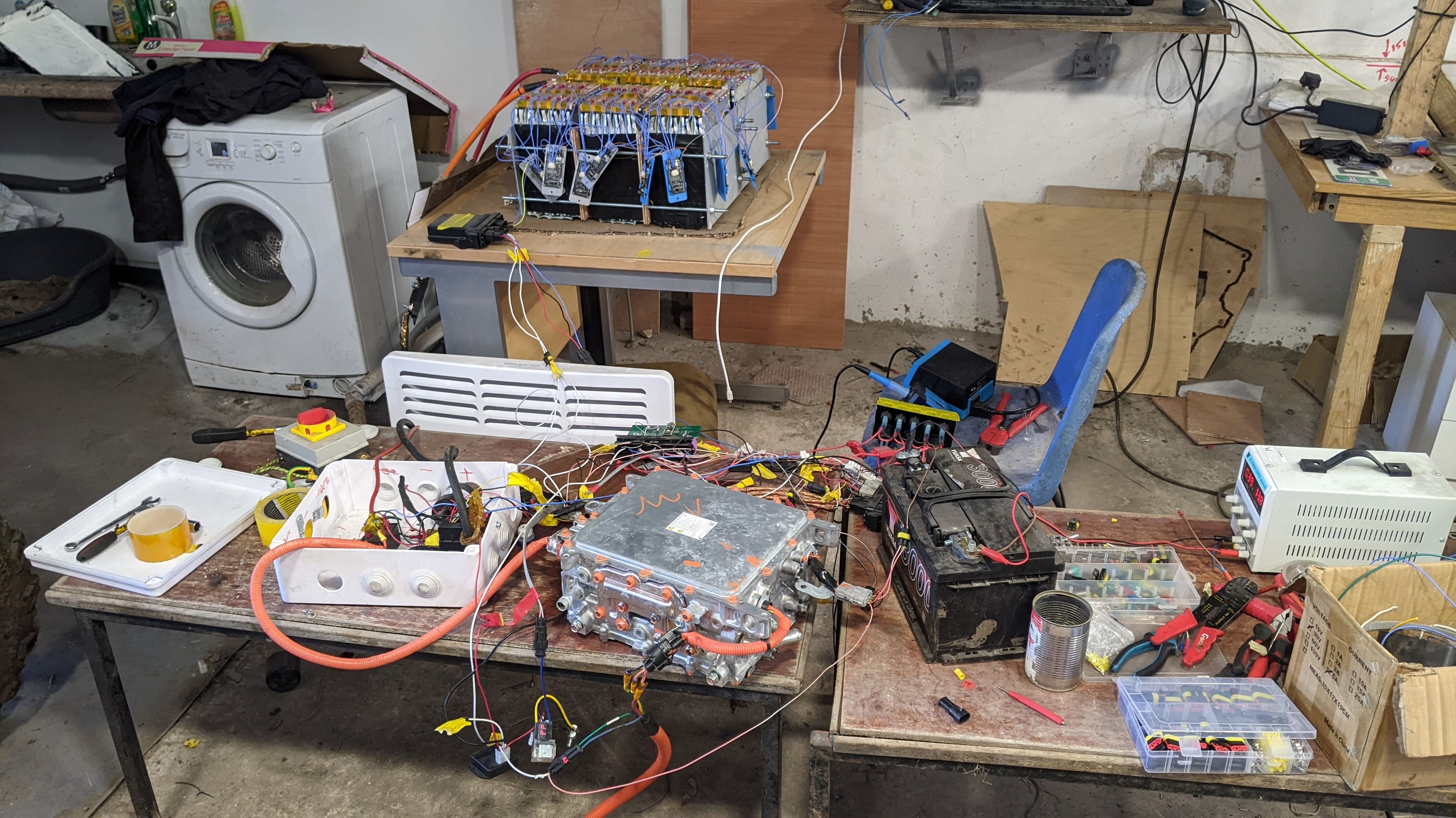

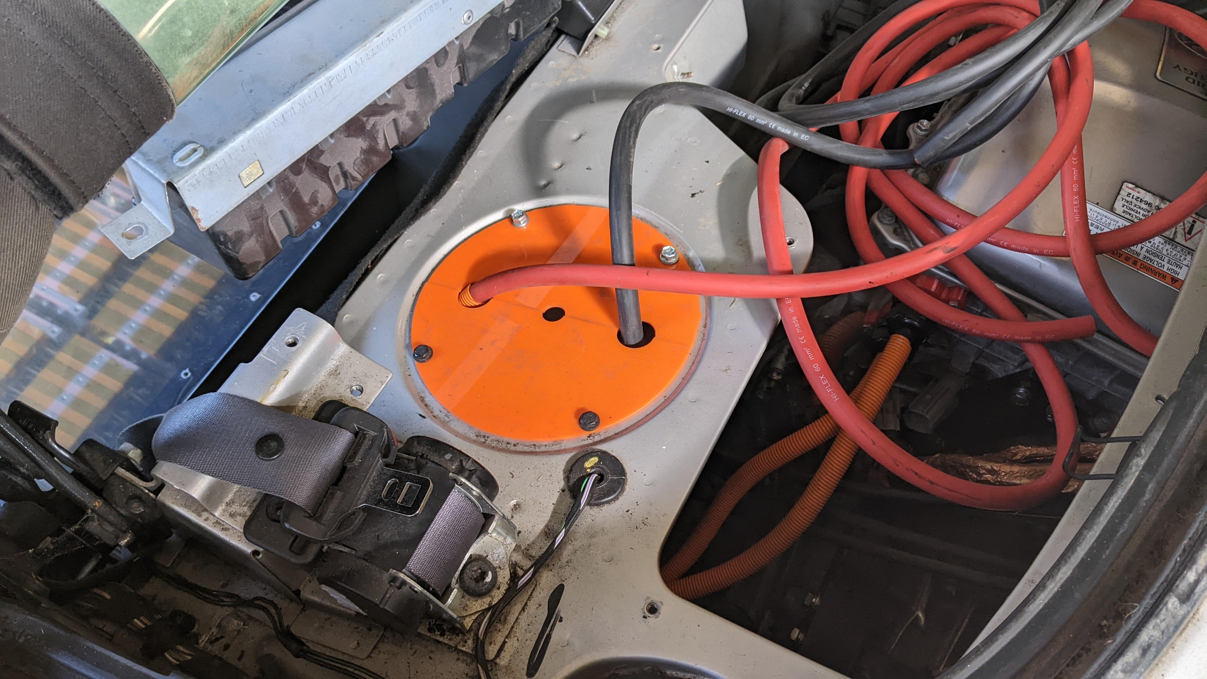

Bench testing is now pretty much complete. Ended up dropping the battery down to 60s to make installation into the car easier, also means I can charge to 100% as at 80s the Prius inverter couldn't reach max battery voltage through bucking mains AC.
I think a future upgrade will be an OEM charging system and possibly a new battery in a better form factor.
However all the canbus system is working, my VCU is working, contactors control is working, charging is working. Even the DC-Dc is working! The only thing left to test in the car is the dashboard control.
Still waiting on the car lift to be wired up, so while I wait for that I am going to start tidying up the wiring as best I can and start cleaning up the car itself.
Don't have much to show in terms of progress, but here is the DC-DC making a light come on!

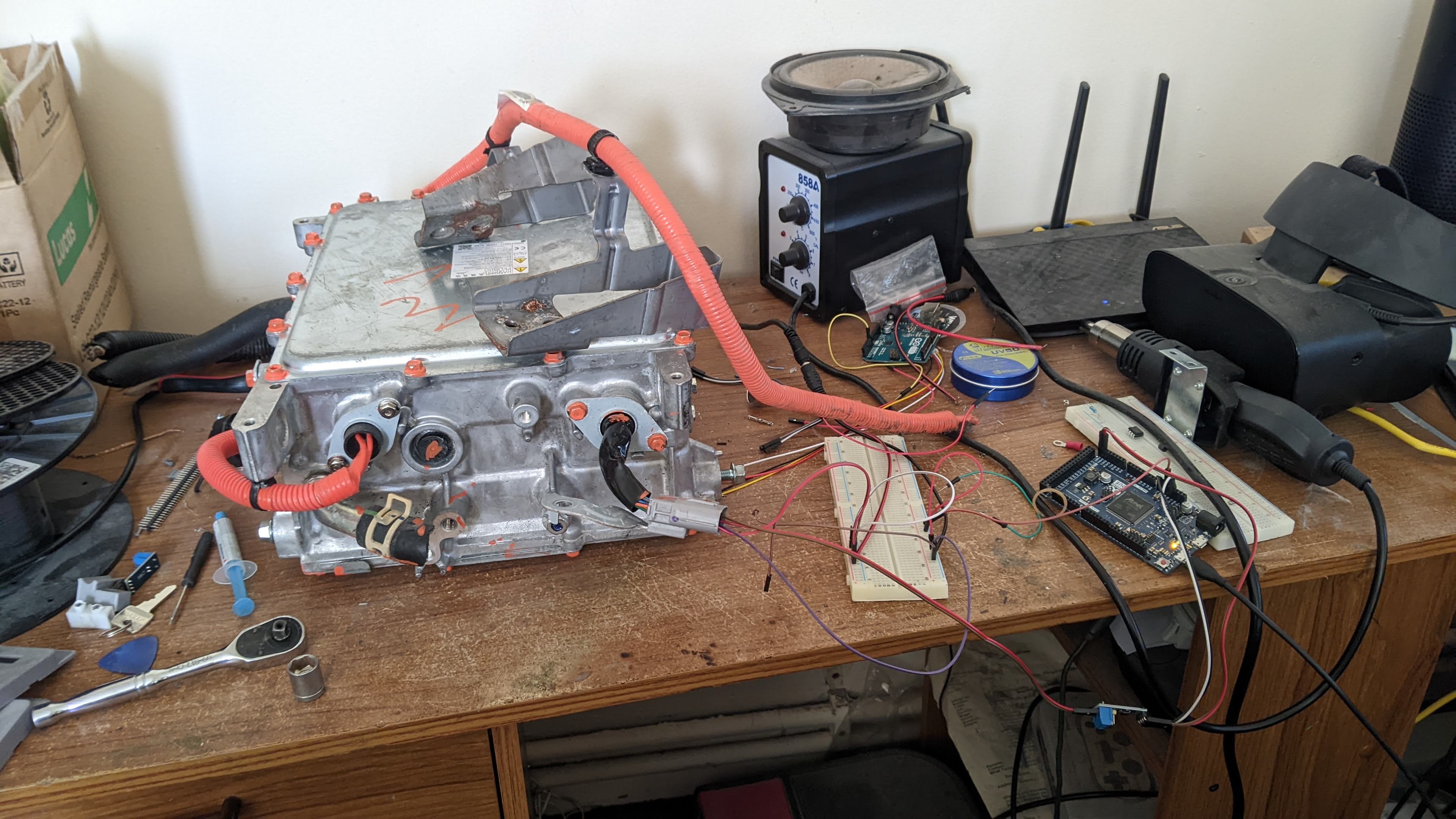

That little control board has been really handy! I used it when I was testing the motor to control the inverter VCU and inputs manually. This time I used it to separate out the inverter, inverter VCU, my VCU, contactors and BMS stuff. Quite helpful when you just want to update something on one of the VCUs without going through the whole start up process.

So a bit of a change in plans in the last week. Last week I killed my Teensy based VCU in a Prius charging test incident. I decided to ditch the Prius inverter for charging and picked up an Outlander Charger/DC-DC.
Got it talking on the bench and have updated the VCU code to run the Charger. I can reused some of the outputs originally meant for the Prius charging to work with the Outlander Charger. In a structural change I got a bit freaked out by the risk of requiring an IVA and by association an prohibitively expensive battery box test. I have cut the spare tyre compartment out in order to fit the battery box in the front of the car. I don't want to get all the way to getting an MOT, applying to change the log book, get someone come out and inspect it and then say I need an IVA.
I considered scrapping the project now so I could work on the tractor right away. But in the end I have decided to remove the passenger seat so I can bolt the battery box there. Then I can weld the spare tyre compartment back on and pretend that never happened.

Bench testing is now complete for a second time! Thanks to RStevens for the teensy 3.6, they are pretty hard to get hold of these days. So I was looking at a VCU redesign if I couldn't get one. Will try not to kill this one!
Outlander charger and dc-dc is really easy to use. Just needs canbus for the charging and a 12v activation signal plus 12v sense wire for the dc-dc. The new setup is allot more simple, way less contactors and control mechanisms needed compared to charging with the Prius inverter. But I do need to put the charger somewhere and hook it into the cooling loop.
I also have some spare inputs and outputs at 5v and 12v now.
Been building up the battery box for a second time this week, due to the new location and cell count. Took me a while to figure out how I would secure the pouch cells while keeping them isolated from the rest of the car. Quite hard to explain so I will just take some photos when it is done. I am hoping that the battery box will be ready in a couple more weeks, by which time the cells should be balanced enough to go in.

Things have changed quite a bit on this build in the last few weeks. BMS system is now changing to Tesla model S slave boards with SIMPBMS software on a teensy 3.2 with a bare bones pcb I designed. Just has power input, output for nextion display, Tesla boards and canbus transceiver. All through hole so no messing around trying to find connectors. Just waiting on the pcb from JLCpcb, in the mean time I can get the slave boards wired up.
The battery box is now installed, just balancing out the last module before I put that in. I am planning to have the junction box mounted above the battery box. I will have a mid pack fuse which will be mounted in the junction box, this will also act as a service switch for when I need to take it all part. Should hopefully be pretty easy to service and get into if needed. I have been messing around a little bit these last few weeks with my MPCNC platform. Trying some different fabrication methods other than the 3d printer which has a limited bed size.
Tried some acrylic which was left over from my first quad bike battery box to make up a replacement for the top of the fuel tank compartment. This is where the HV cables from battery to inverter will be routed. That was ok, but then I found a sheet of aluminium being thrown away at work. I've always wanted to see if I could cut aluminium in my MPCNC, but it's cheaper to get it laser cut than to buy the raw metal. Until you find raw metal for free! I think it turned out ok, even got some CNC silliness in there as well with some logo engraving.
I also got the insurance sorted. £540 for the year with 5,000 miles allowance. Starts 30th June so I have a deadline to aim for now!

I'm probably going to put the charger there now as it's the easiest place to put it without having to redo the rear setup. There is an Aussie MG F conversion with some cells in the compartment.
