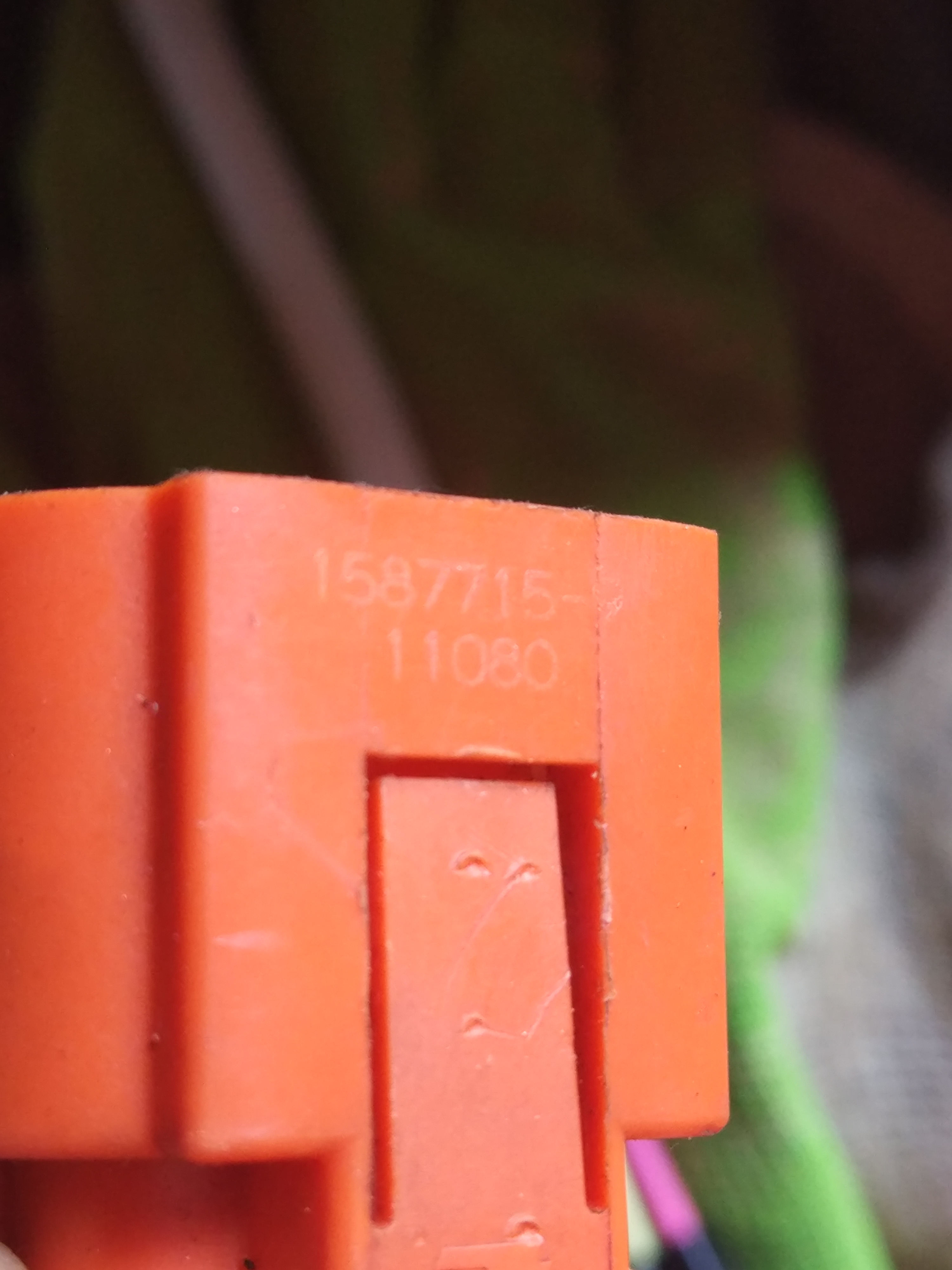

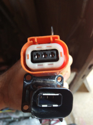

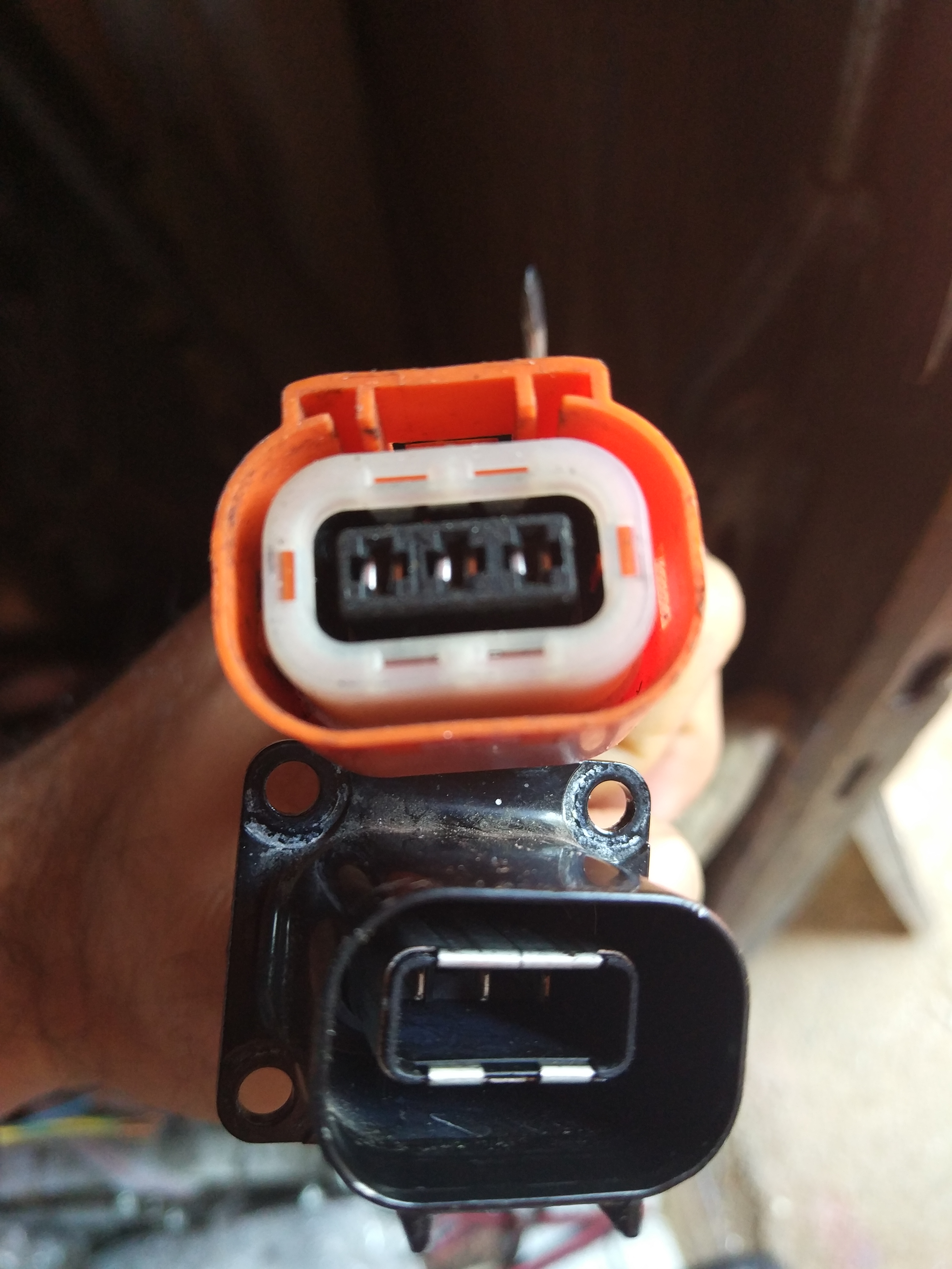

I went to search for Toyota 3PH connector from compressor, but i couldnt find any data. Then i tried to find the connector on the side of Volt inverter where i will connect compressor.
It seems like it is YHVA280-3PXM connector and can be get at Mouser. Contacts are 2.8mm AMP MCP female. I may yet pull this off without sacrificing cables and plugs. Datasheet of assembly is attached. It seems to be quite complicated assembly.
I also attach Mouser basket with P/Ns
