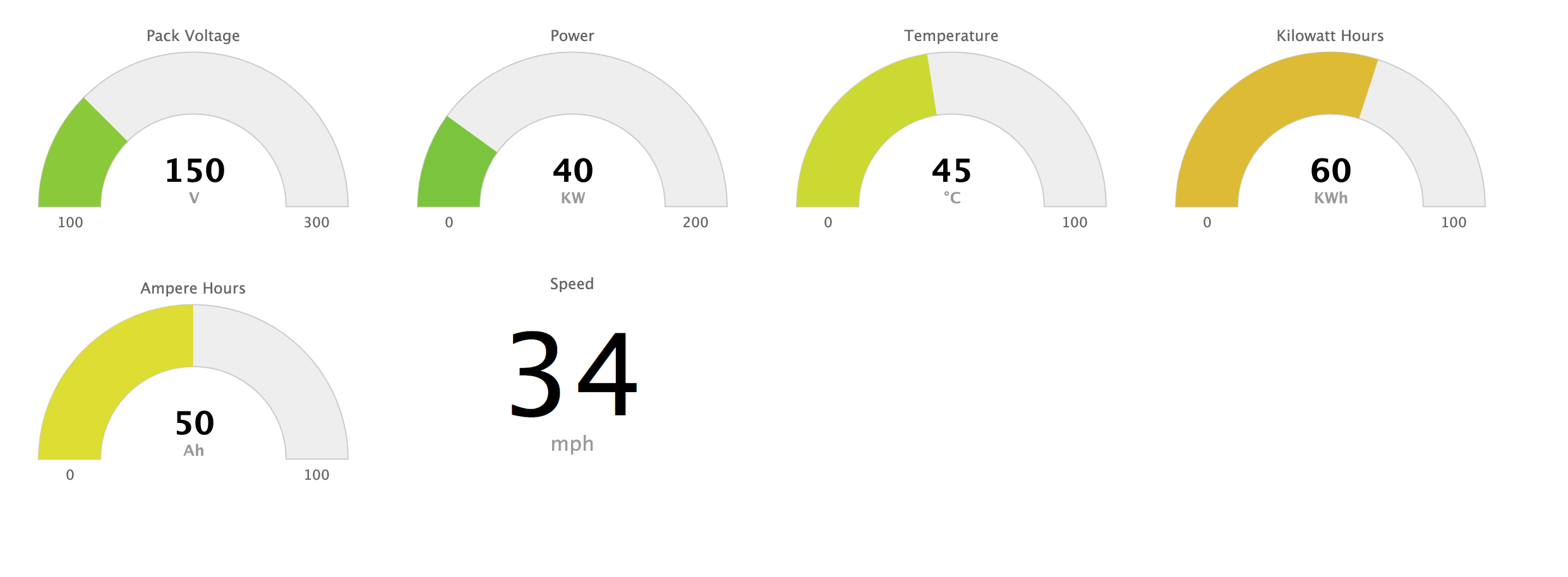

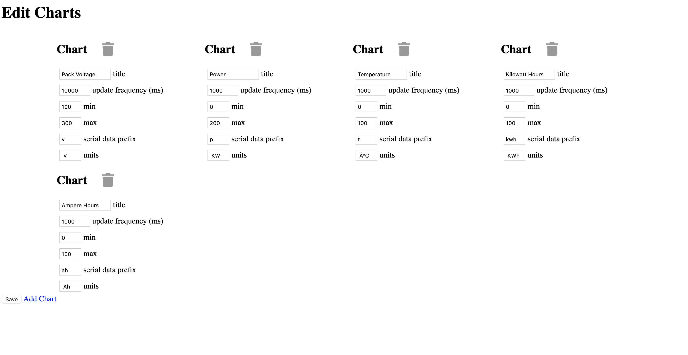

I've created a PR to add the edit chart page, still not 'pretty' but functional so the user can setup gauges without recompiling and flashing. Let me know how you get on with it.

Bigpie wrote: Tue Feb 18, 2020 12:09 pm I've created a PR to add the edit chart page, still not 'pretty' but functional so the user can setup gauges without recompiling and flashing. Let me know how you get on with it.
Looks nice, but dos not work for me..
I have changed the baud to 115200.
Have set up two gauges: Volt v and SOC s in setup.
Sending v306,s68* from both serial traffic generator (PC) and from BMS (Teensy3.2)
This is what I get on traffic generator:
<-v306,s68*
->adding: v306 v306#0D#0Aadding: s68 s68#0D#0A
The gauges are there, but no value.
If I go back to your previous version. is works
BTW the setup icon is a little hidden behind the gauge, in my phone.
Edit:
Sorry, it WORKS!
Stupid me, did not see you changed to : after prefix :D
Posts: 1884
Has thanked: 91 times
Been thanked: 517 times
Re: Universal WiFi Interface
: made it easier to split the string. Got some other changes I'd like to make, but after that. Open to suggestions.

Posts: 1884
I've pushed some changed to my repo. I've not done a PR to Damiens repo.
Changes:
- /admin page can now select to either join a network or create an AP
- The chart config page now has selectable display types of "Text" or "Gauge"
- The display page now requests all the data in a single request and no longer requests data again until the previous request has been returned.
Upcoming:
- Ability to write arbitrary commands out to serial from the edit page
- Ability to add buttons to write out specified commands to serial to the main page.
