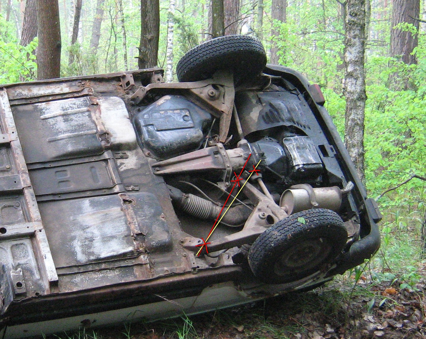

Keep in mind that that rubber bushing lives only because axis of trailing arm is close to point where axle goes into gearbox. If you replace gearbox with wider one, or install double wisbone suspension, that bushing will die instantly. Any change must be done with CV joint instalation.

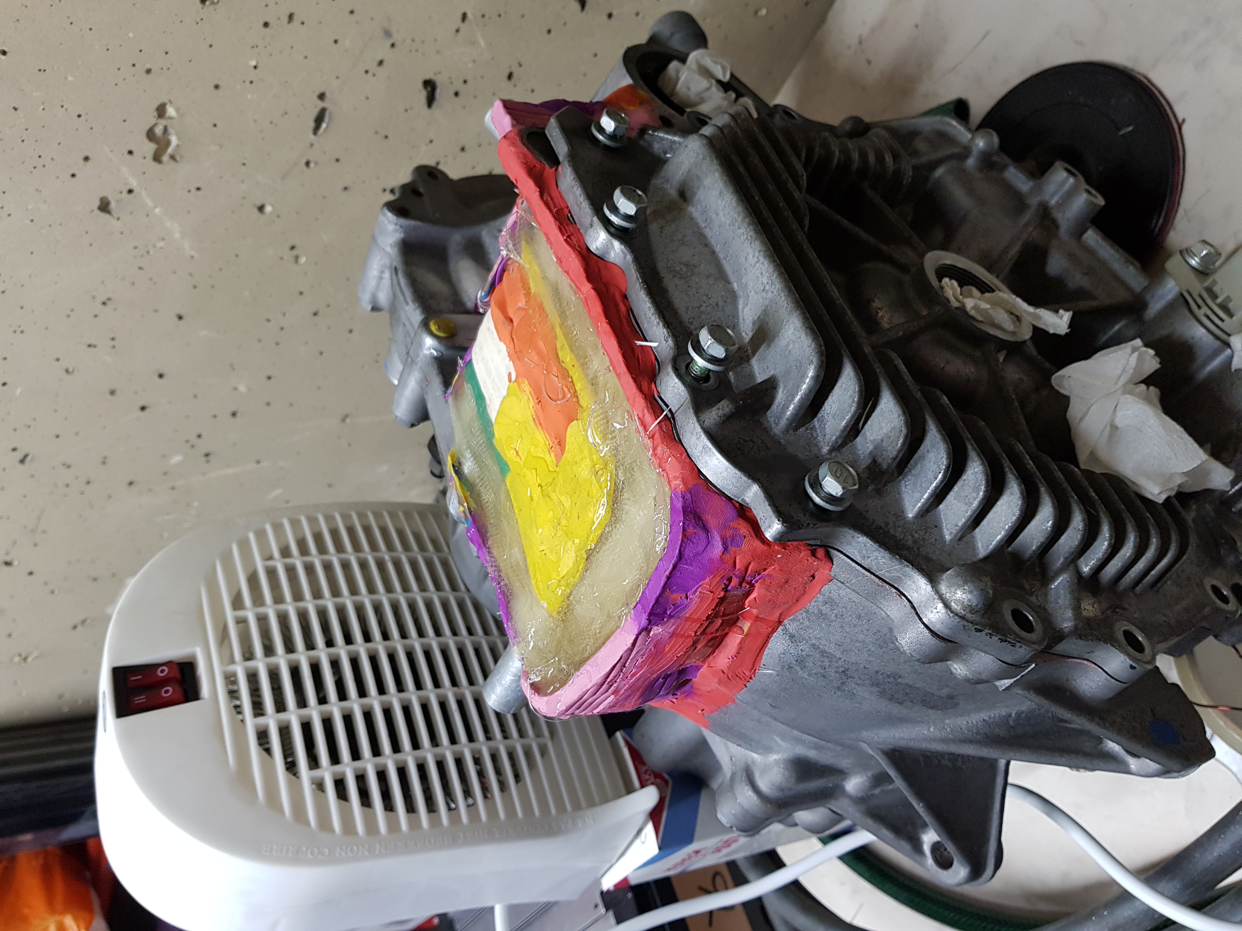

I think Toyota engineers are done it for uskonstantin8818 wrote: ↑Tue Apr 28, 2020 11:16 am I wonder if anyone have got access to infrared camera, to watch MGR running under load. I would like to see what spots are the most heated, to glue there a liquid heat exchanger of brass pipes![]()

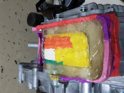

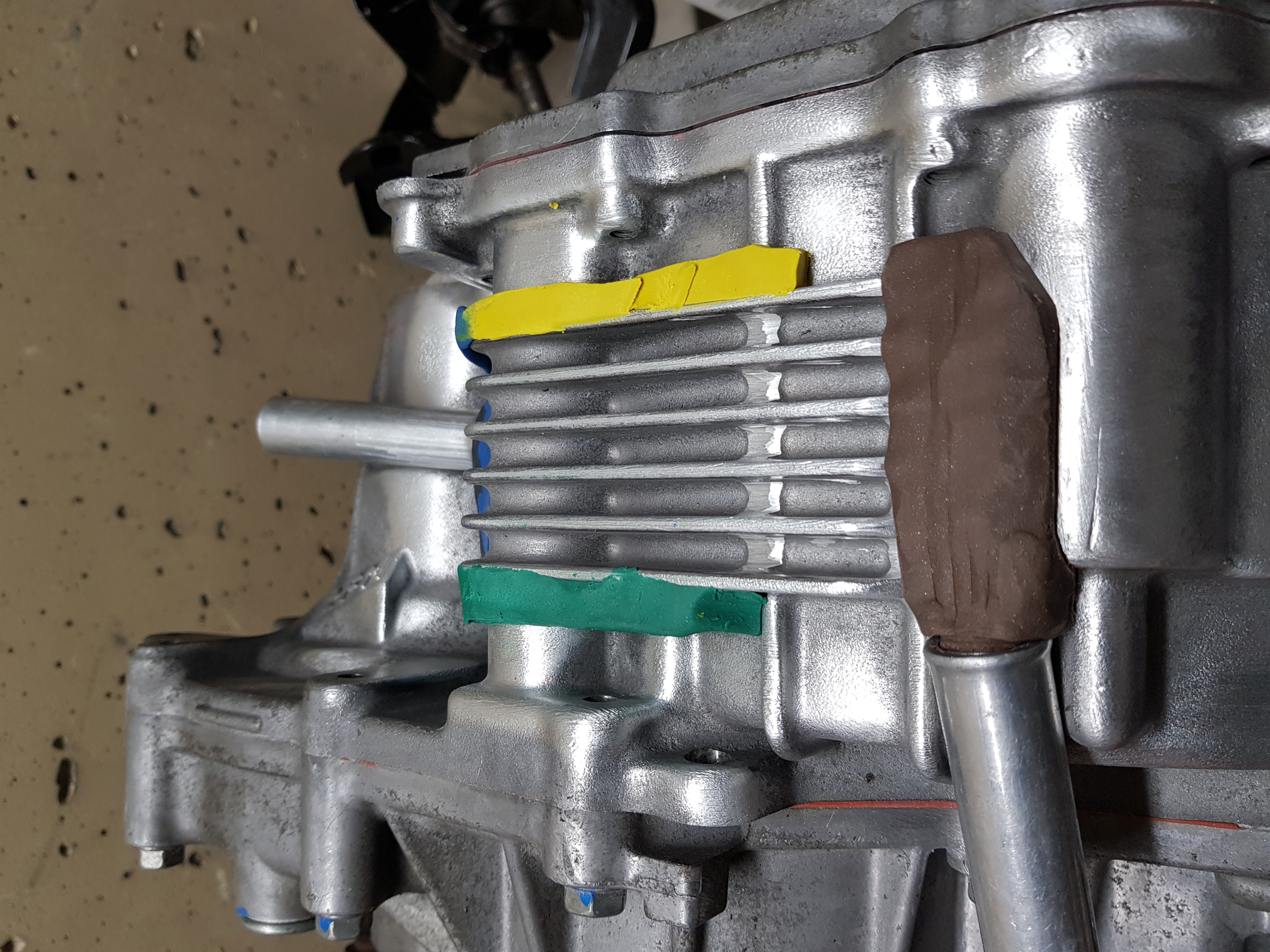

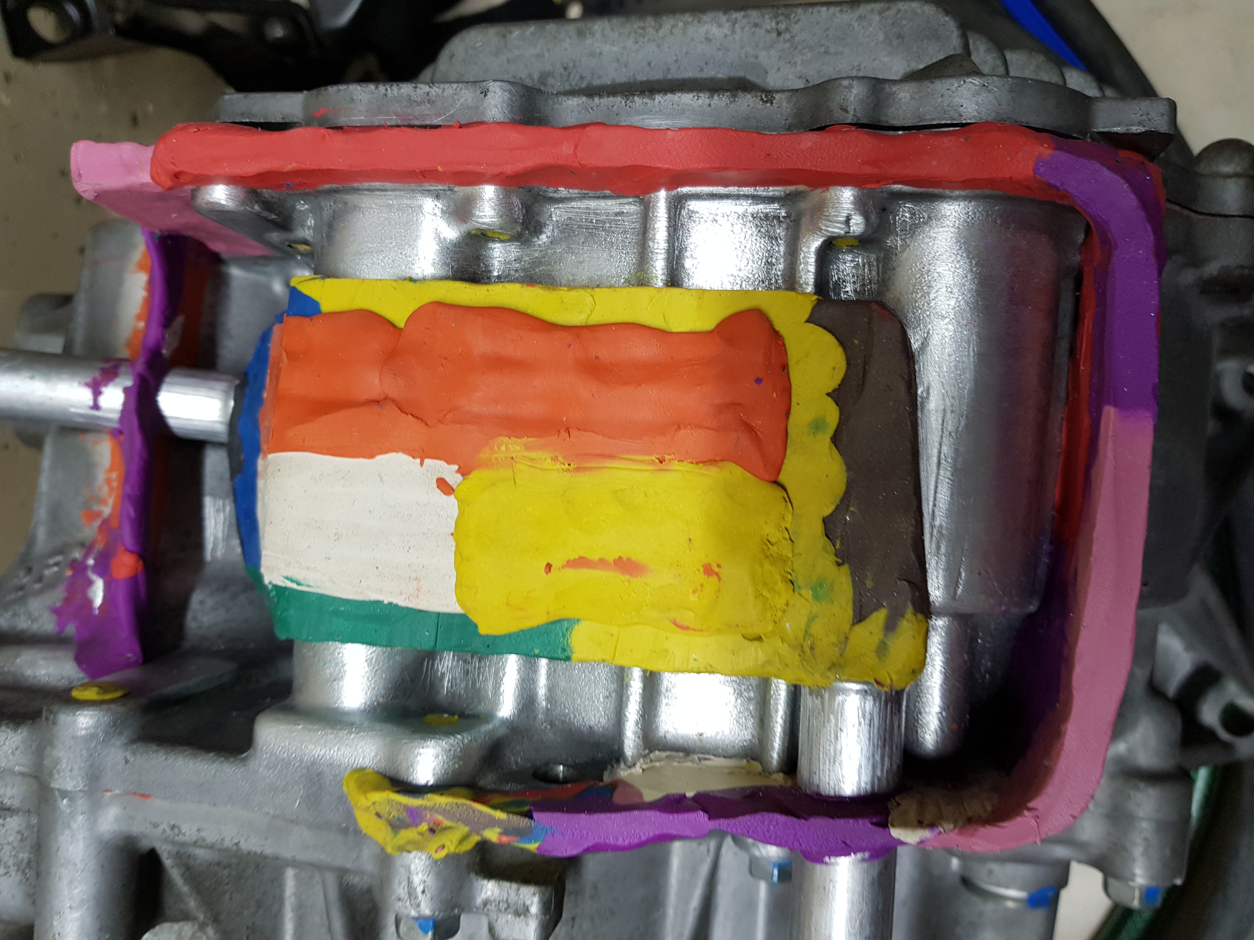

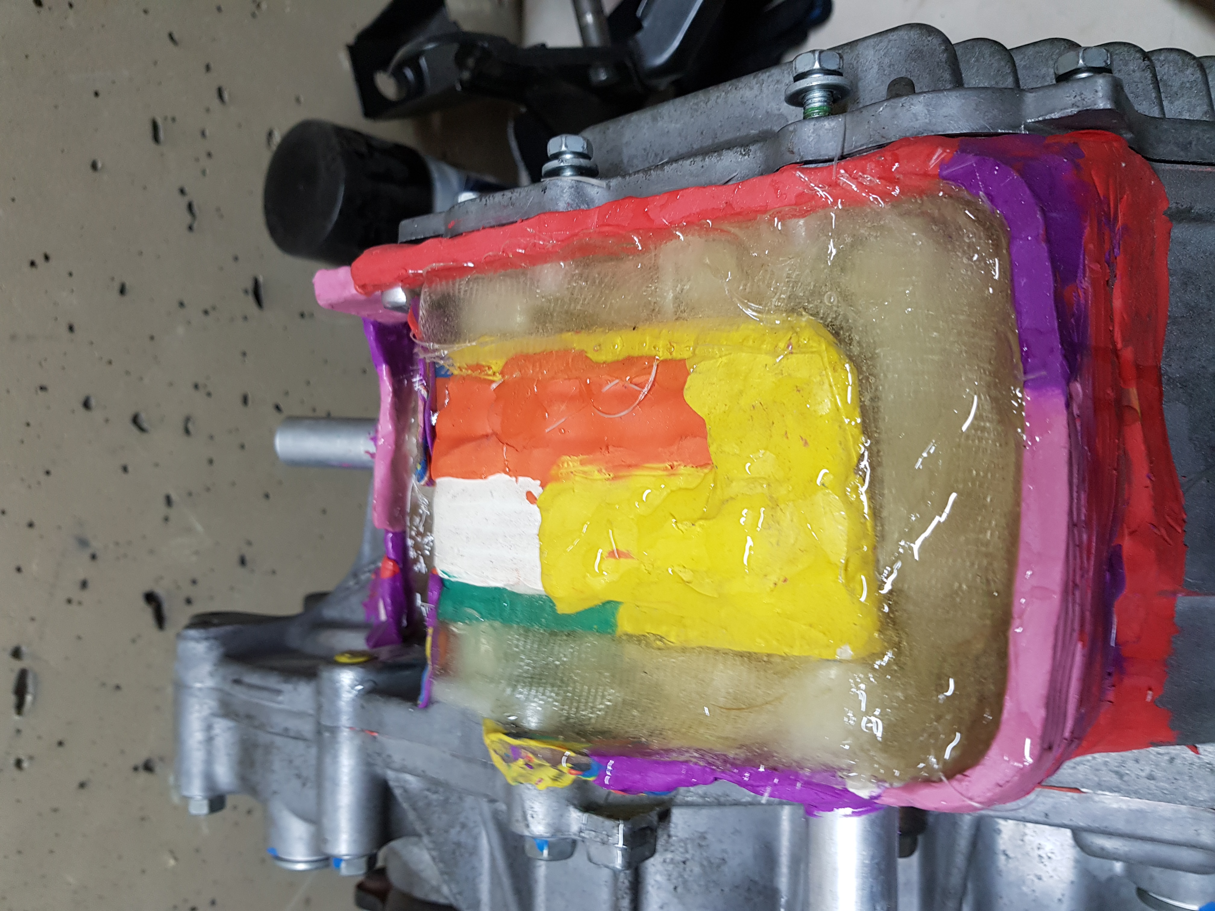

I think about additional cooling MGR and make heat absorber for a liquid cooling in bottom from fiberglass and epoxy. See a photos.
Material for a forming: Inlet/outlet tubes: Walls forming: Epoxying: After removing a forming and sanding, close by aluminum plate with a screws:
My project is Electro-Tigra https://electrotransport.ru/ussr/index. ... 5.0#topmsg

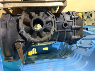

Hi, I’m new here and not quite ready to start my own thread. I have a 72 super beetle in pieces and I’m considering replacing the original traction system with an MGR. In the photo the gearbox is as close to its original position as the cardboard box will allow.
I’m wondering if one of you kind souls could run a tape measure over an MGR and tell me if it will fit running in it’s original direction? The axle centres are approx 250mm below the floor and 125mm in front of the firewall leaving around 355mm clearance to the front.
If it doesn’t fit (maybe with a slight tilt to the front?) I will look at the Outlander rear motor unless someone has cracked the addition of a cooling system and/or oil cooler/pump system to run the MGR in reverse.
Thanks in advance,
Chris
PS if I click on the image it turns the right way up! What am I doing wrong?
Thanks in advance,
Chris

Welcome! That photo actually helps me too, as my car is planned to be a '71 Squareback!
The axle c/l to top of MGR = 7" (180mm) and to the front edge of the mount casting 14" (355mm). Looks like it will fit just fine
If I find cooling is needed, I will just install a low pressure BOSCH (or similar) fuel pump to circulate the oil thru an external cooler. But, these motors will tolerate temps well over 150*C, so am hopeful that added measure will not be needed.
The one measurement I do not have is the flange-to-flange width of the stock VW transmission.
Time for ICE Melt

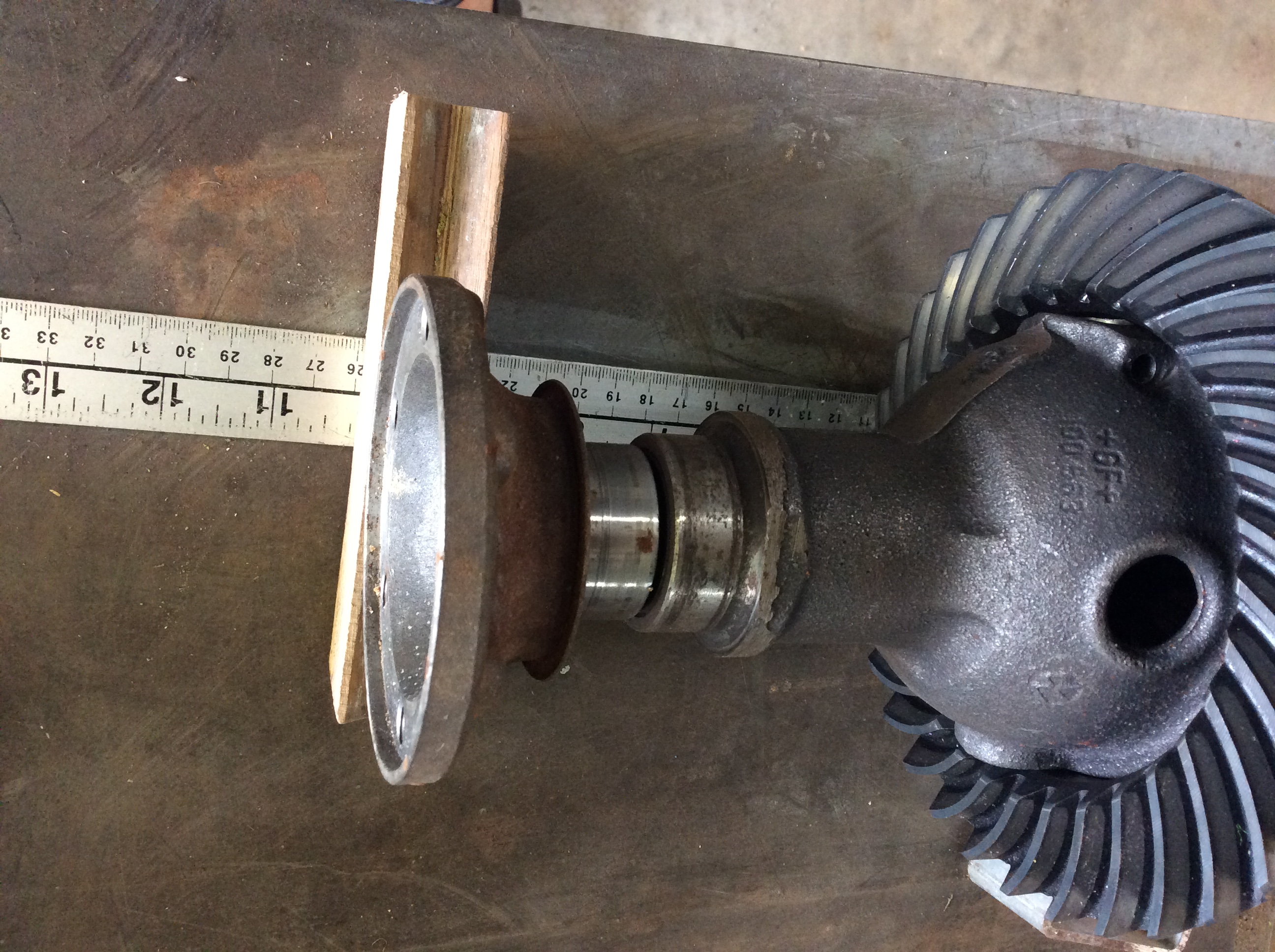

I managed to put together enough pieces from my diff jigsaw to get a pretty good idea of the distance between the flanges. It’s a 72 super beetle 112 2890 748 if that is the same as the square backs.
Looks like it’s about 258 overall but I can’t guarantee the accuracy as there may be spacers missing from the assembly.

Thanks Chris, that measurement is really helpful! The MGR is about 280, so shortening will be required

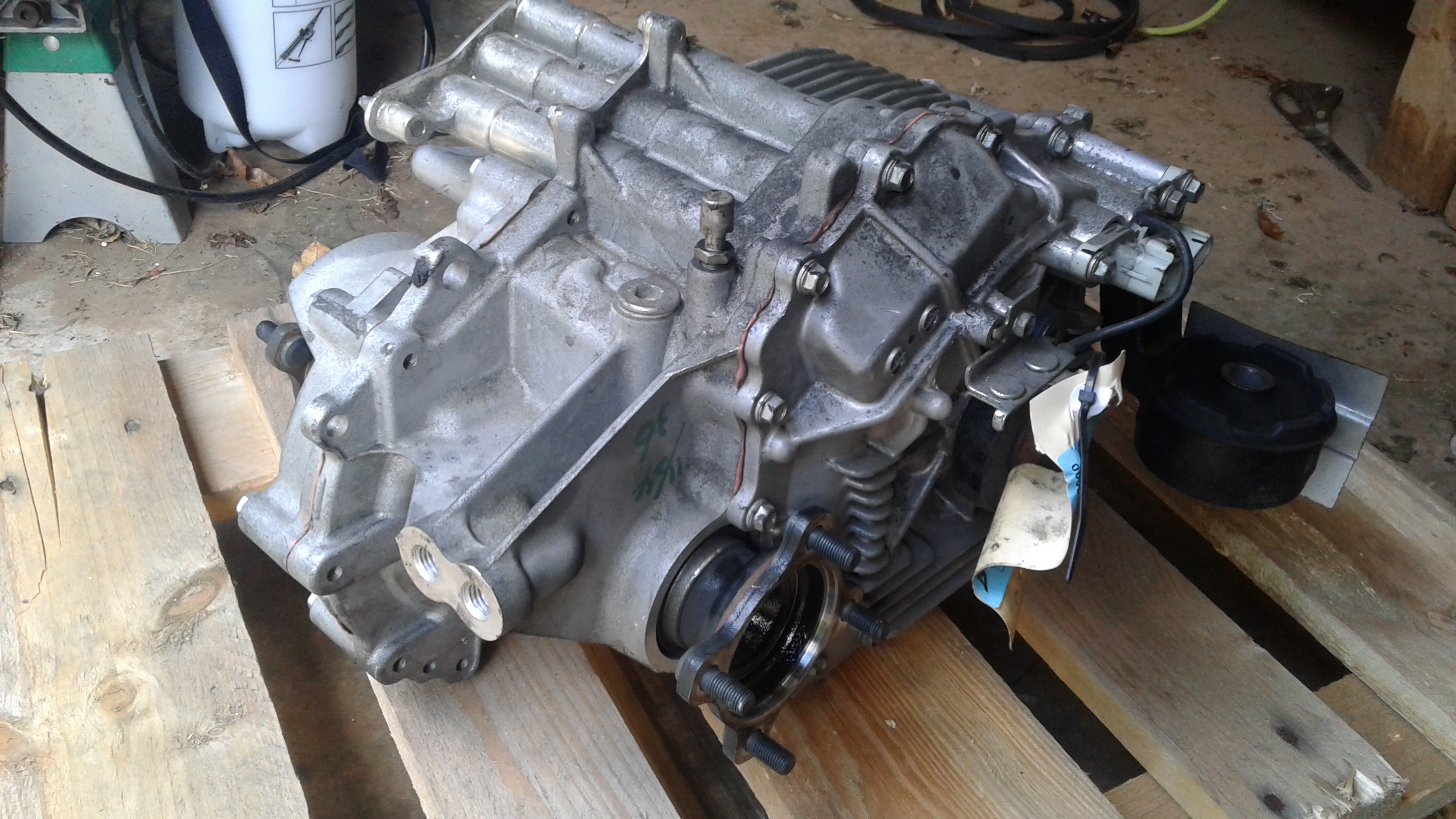

My MGR just arrived so, what do I do now?
I’m months away from dong anything practical with the electrical side of things but wondered if there is any way of checking this thing out with just the power that can be provided by a couple of 12v batteries?
Although I wasn’t really ready for this I figured that if the Blue yacht sets sail anytime soon the availability of MGRs could be rapidly diminished so I grabbed one of the two that were on offer DownUnder. Haven’t made any decision on the rest of the package but you have to start somewhere!
Chris
Chris
