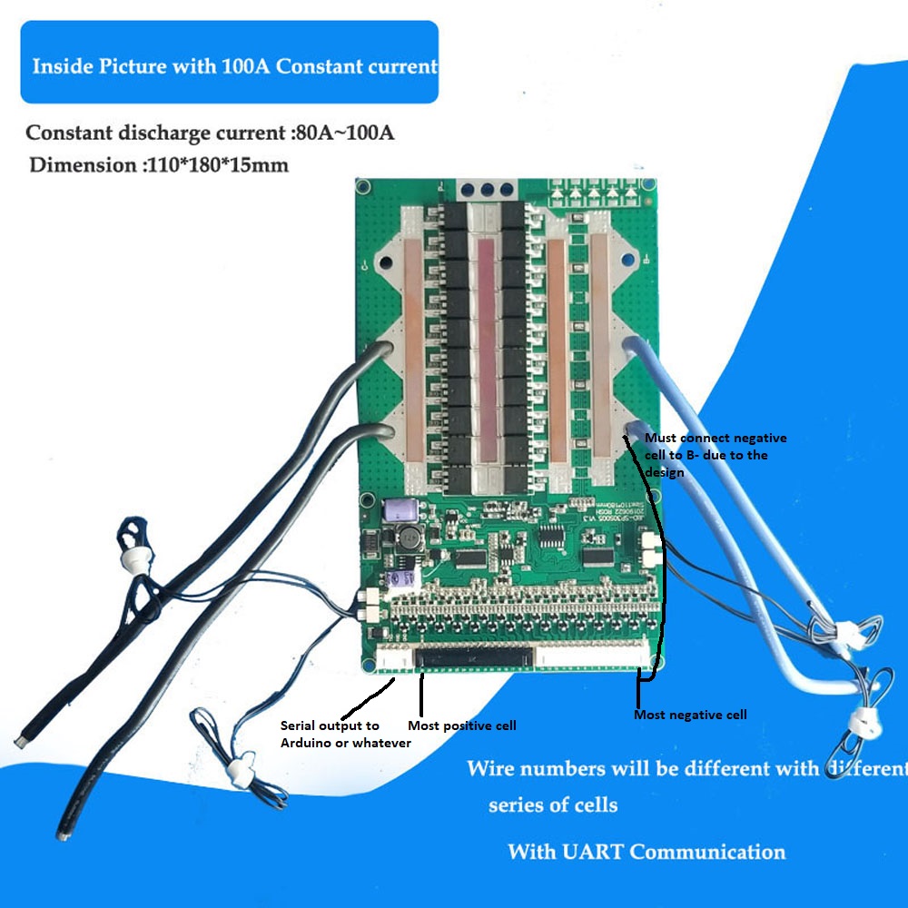

I suggest one of these: https://www.lithiumbatterypcb.com/produ ... pack-copy/
With a simple microcontroller (Arduino or similar) you can communicate with this BMS and obtain individual cell voltages in case of a single cell failing.
I can share some code if you like, the communication protocol should be the same as the 16s BMS which I have.
https://www.lithiumbatterypcb.com/smart ... -download/
I'm using 12 16s BMS modules from the same vendor in my Porsche conversion with a 96s2p system. So far they are working well, though I'm not driving yet.
-Isaac

Could you send me a picture to show the connection detail about the battery BMS please?

Here's a beautifully annotated image:
I'm in the north bay area, napa county. We could probably meet up and discuss this once the shelter in place orders are over (if they are ever over).
I can help you with hardware and software to communicate with the BMS.
What charger are you planning on using?
-Isaac

Leo Max wrote: Fri Apr 17, 2020 12:42 am I was thinking if I removed the circuit board. Find the connection point corresponding to each "S". Connected to the BMS of 23S. Then connect a 96V 20 amp charger.
Yup, that should work great!
Here's a good charger for 96v - it can output 25A at that voltage when fed from 240vac.
https://www.thunderstruck-ev.com/tsm250 ... basic.html
Thunderstruck Motors is just across the hill from me in Sonoma County.
