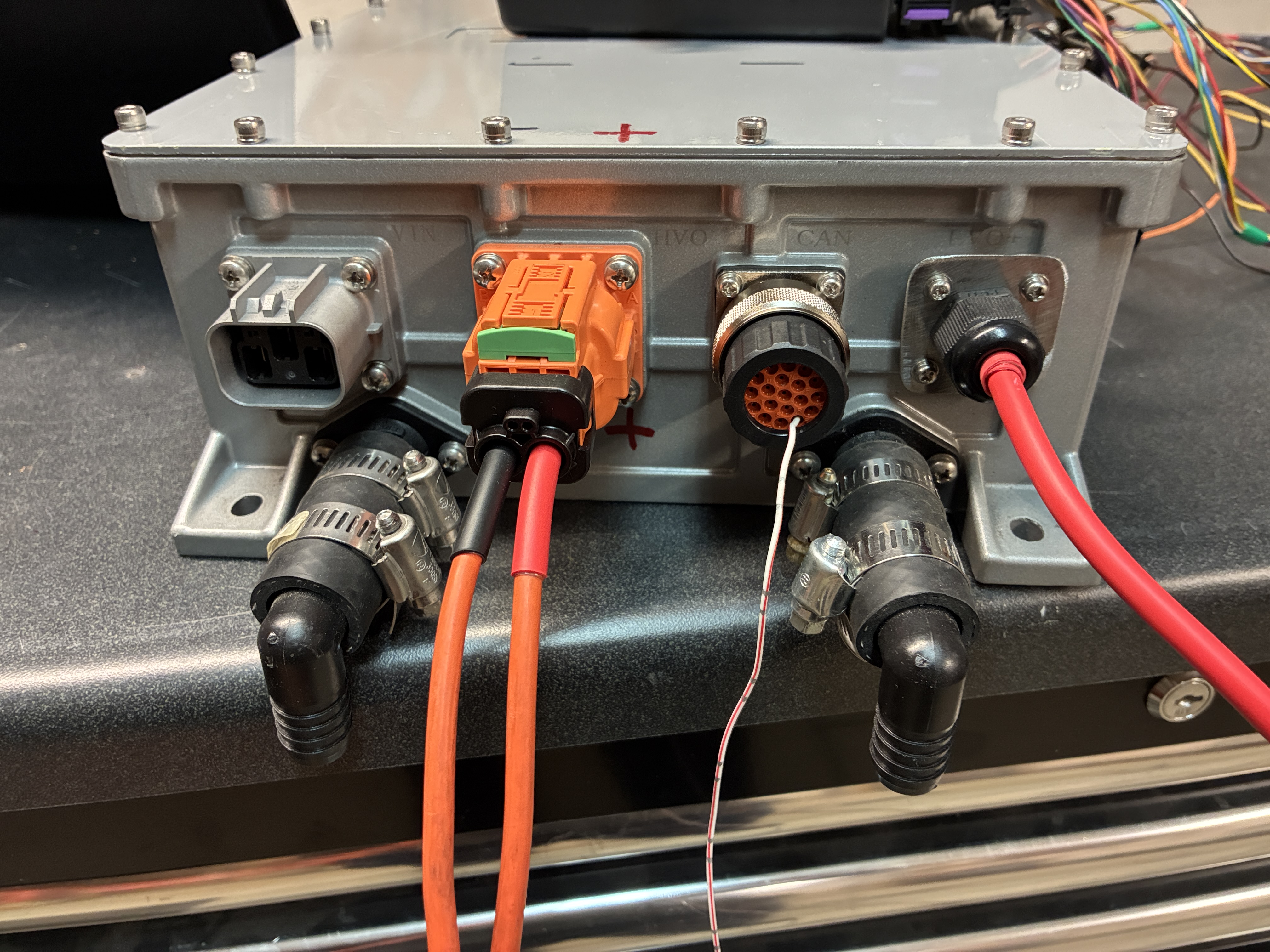

maybe we can start with the physical connection, how do you connect all these things?
Gregski
Posts: 3178
Has thanked: 635 times
Been thanked: 1627 times
Re: I just bought a Dilong aftermarket charger - Now What?
Post by Gregski »
nothing to it but to do it

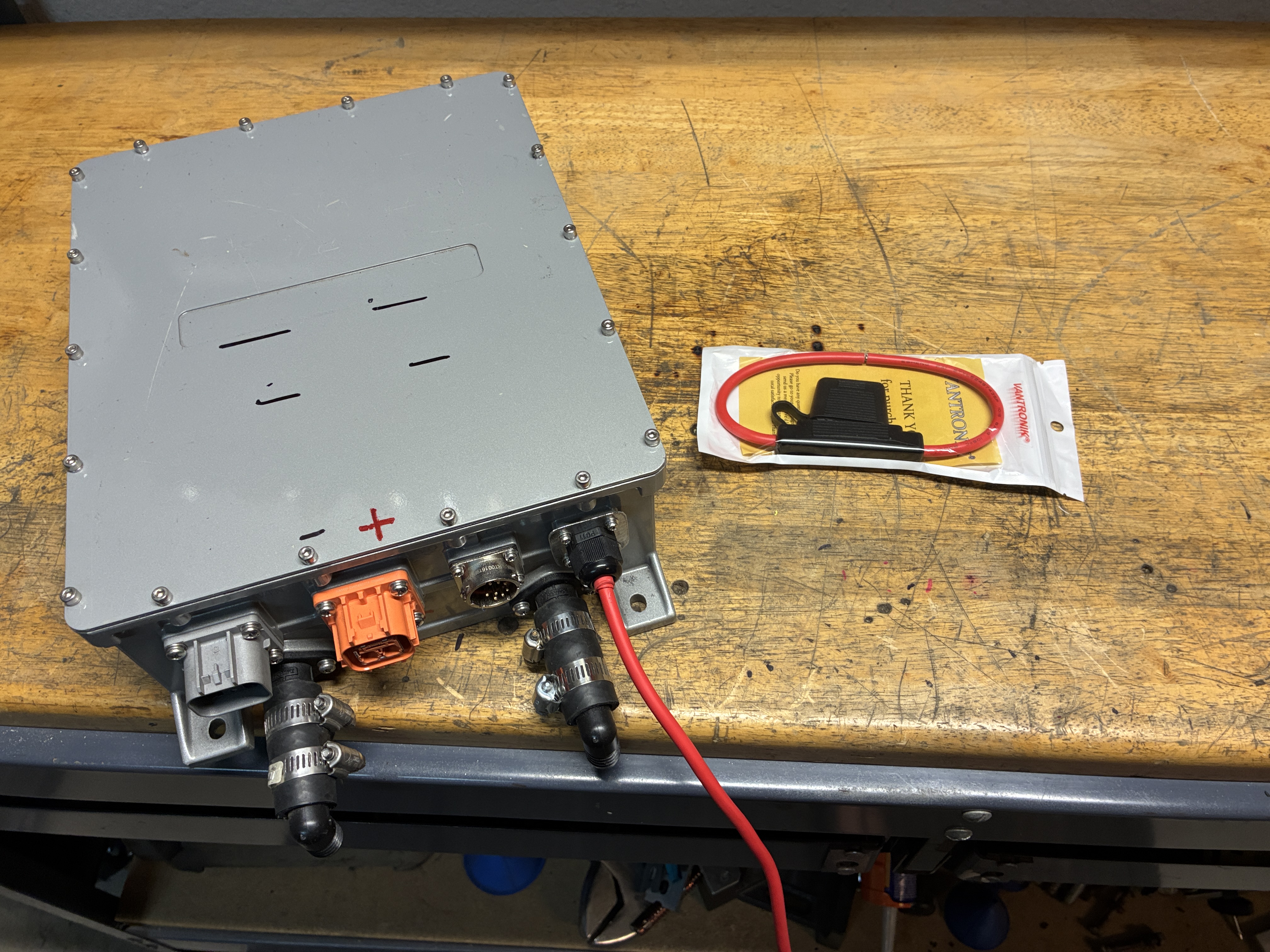

sorry folks I could not get myself to use that monstrosity so I made a simple hardwired connection

then I made the high voltage DC battery cable

Alternating Current AC Input Connector
for this one I will be using my Walmart receptacle (I know, it has to be good)
J1772 Receptacle Walmart.jpg (25.69 KiB) Viewed 357 times
if wiring an already attached J1772 receptacle on the other end, make sure to first slip on these end caps before crimping the pins on the wire
it appears they don't use the Control Pilot and Proximity Pilot signals ???

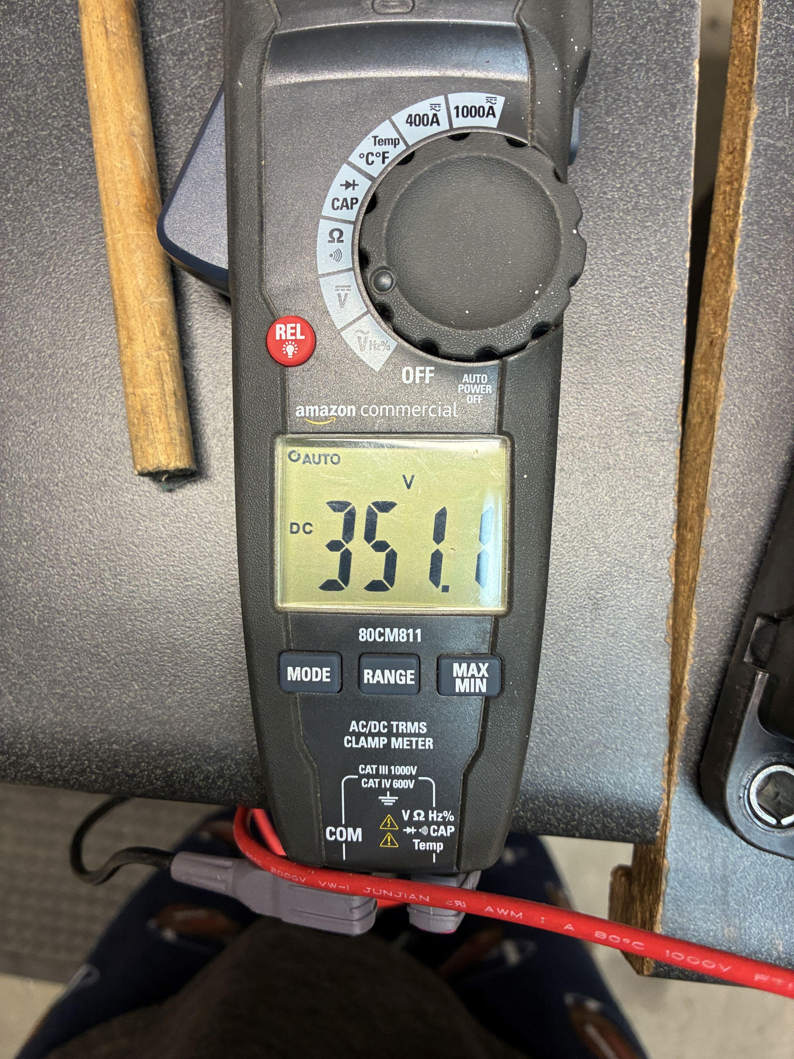

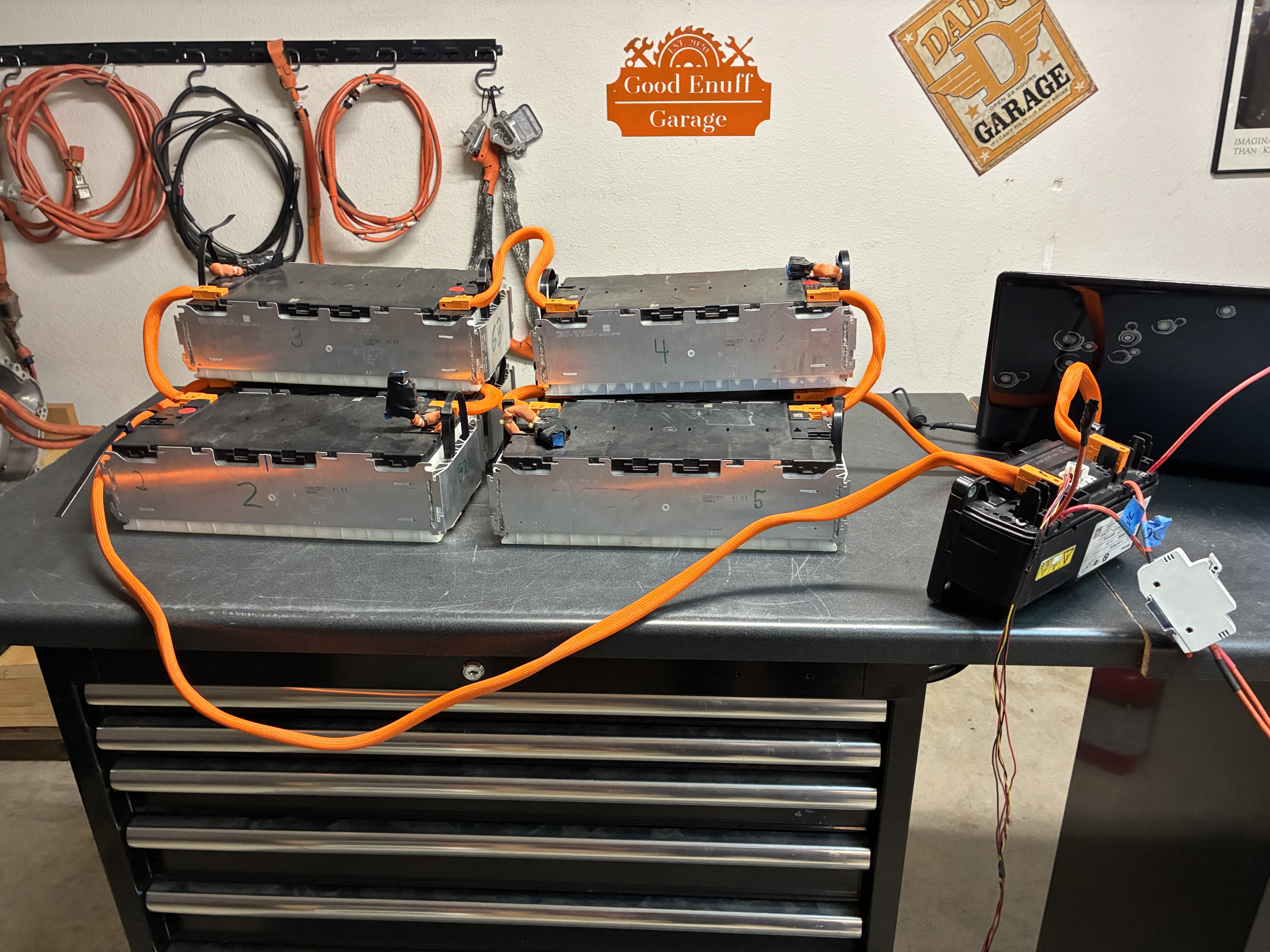

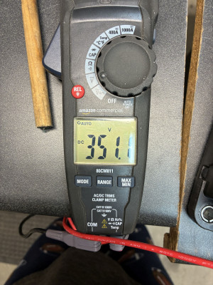

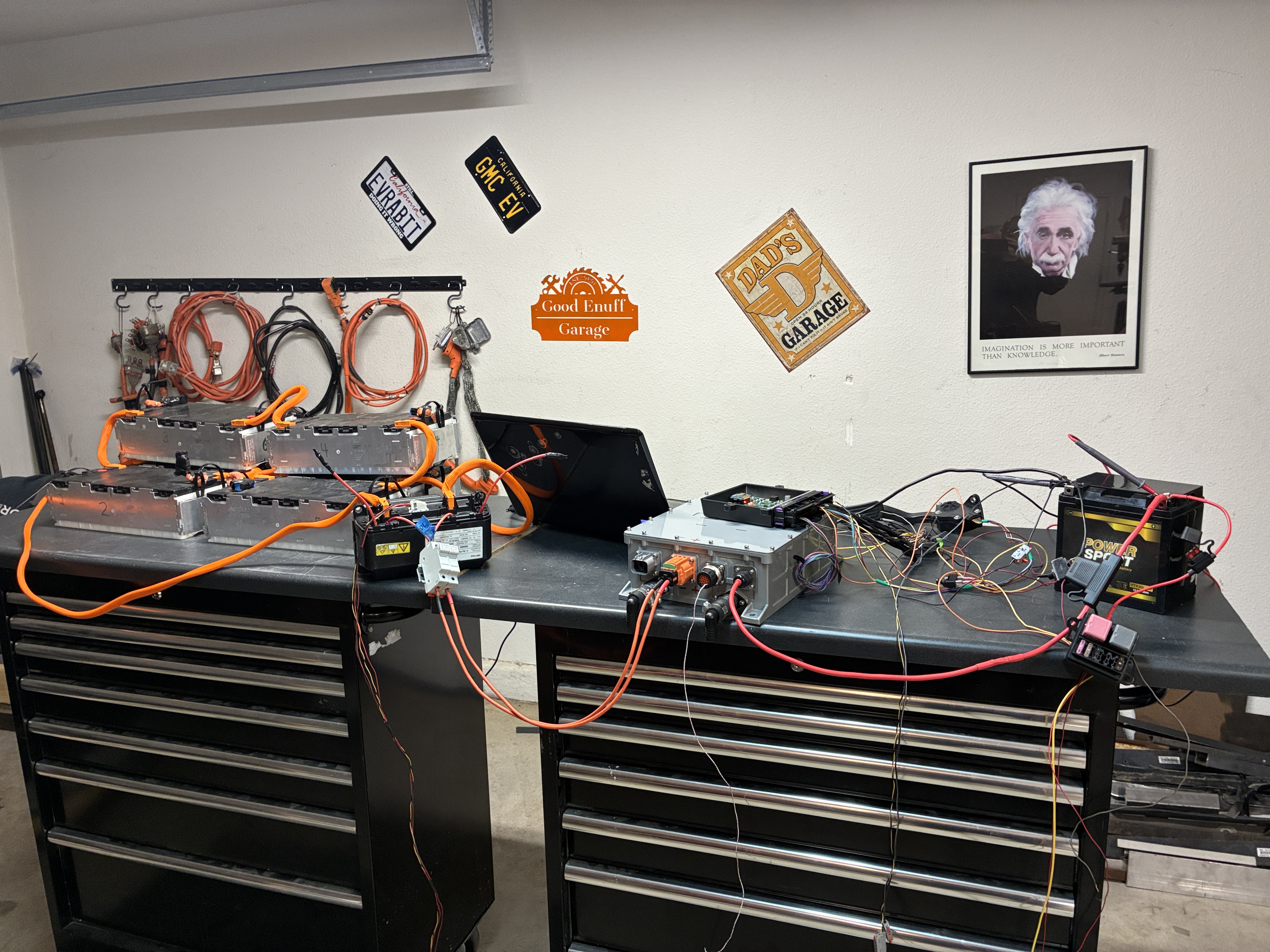

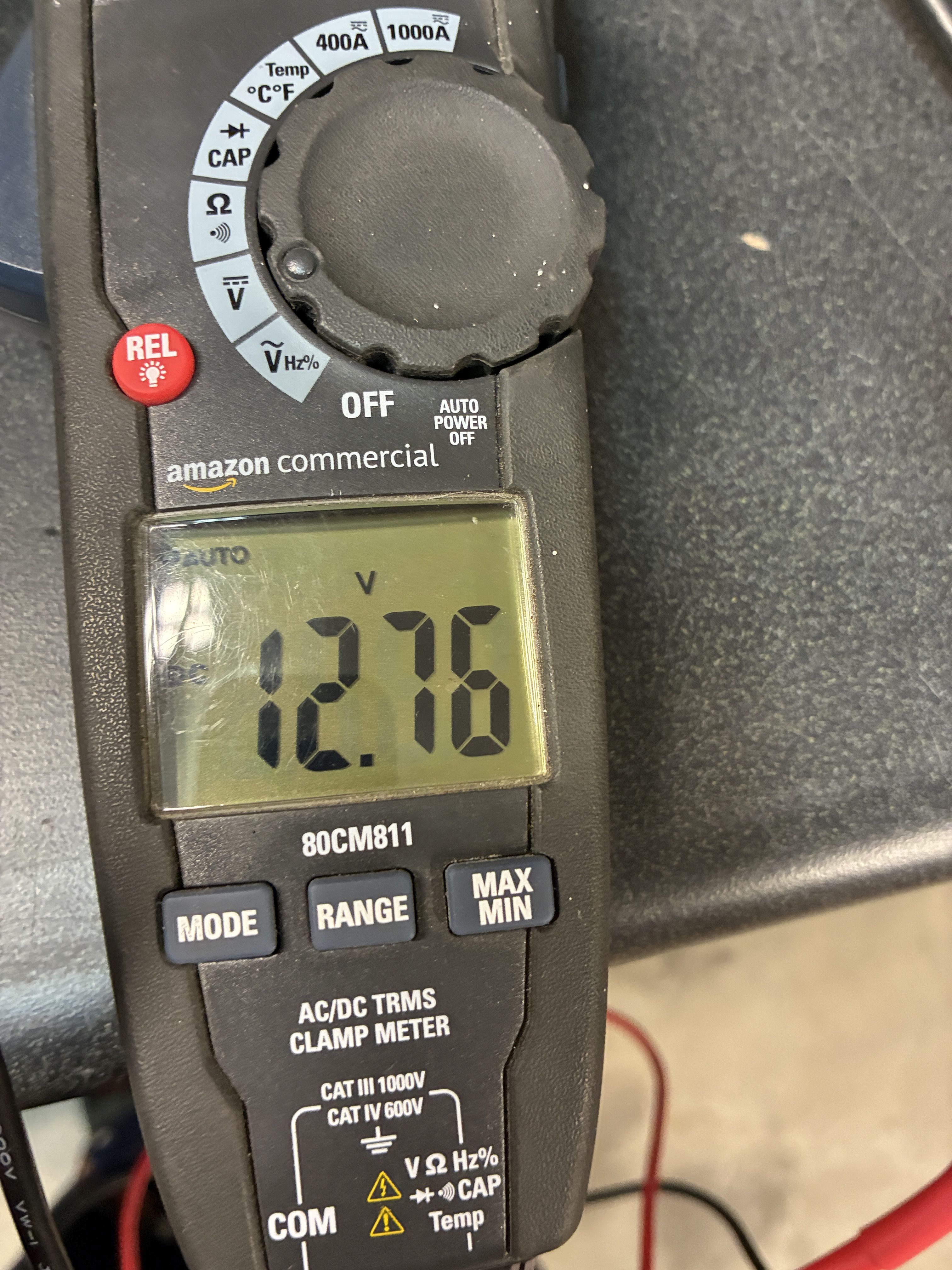

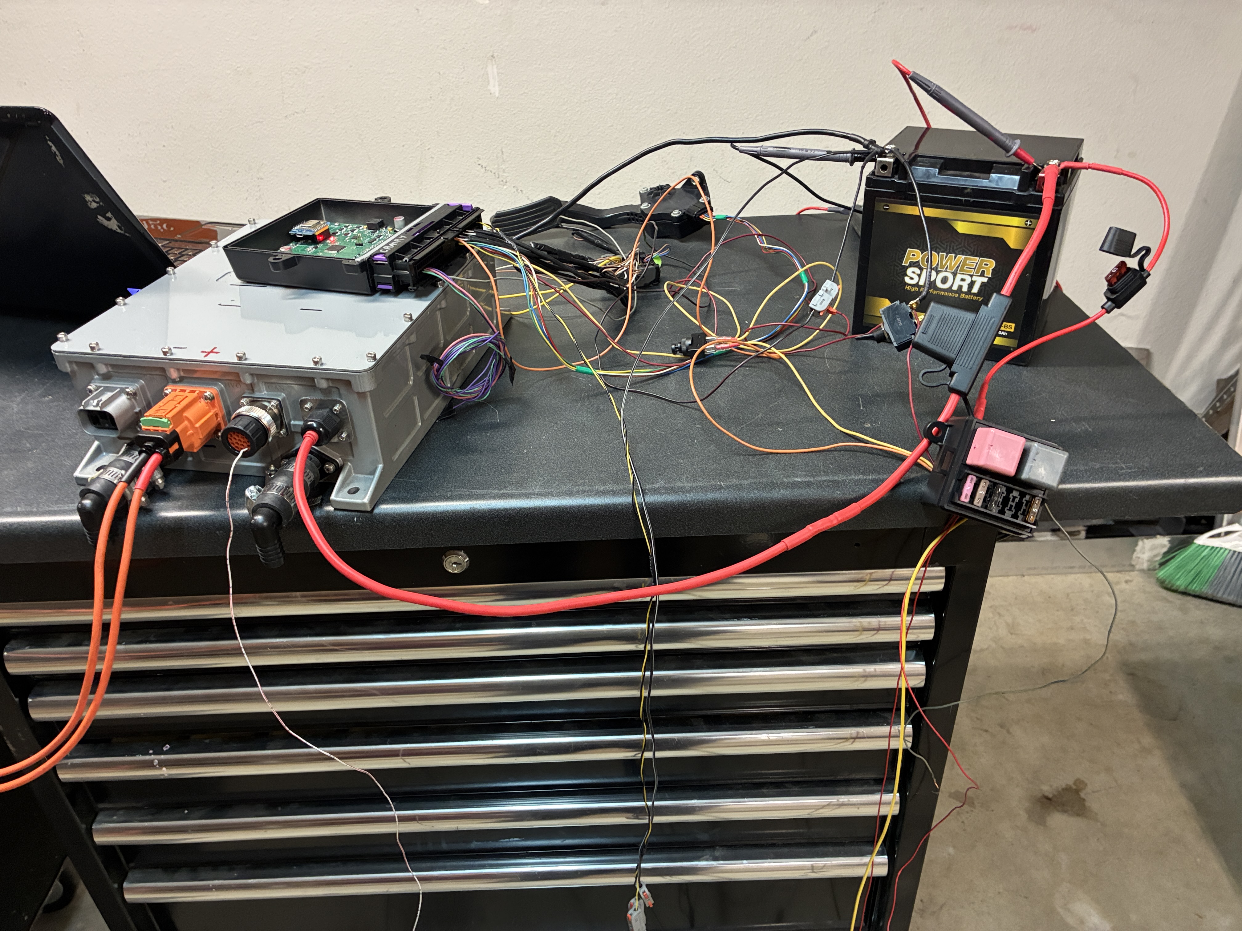

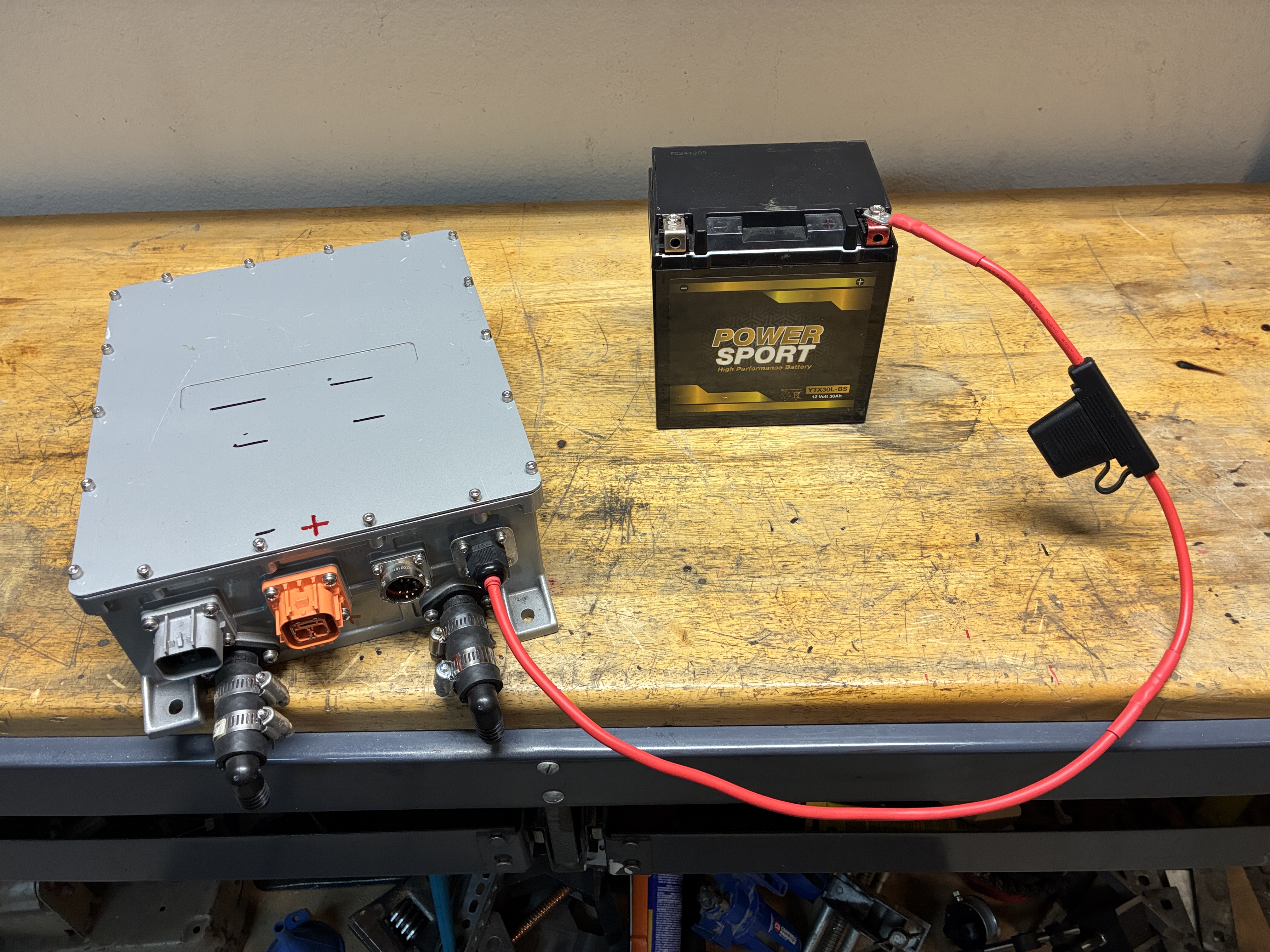

Post by Gregski »
for DC-DC converting you don't even need the Zombieverter VCU hooked up, the only reason it is there because it controls my BMW sBox ie opens and closes the contactors and the pre charge relay etc. to protect the capacitor in the charger
we started with a motorcycle battery at 12.76 volts
yeah you need more than one wire to activate the DC-DC converter and this is on the wrong pin anyway! (more on this later)
