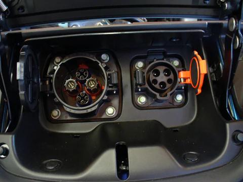

when searching for a charging receptacle I was surprised to find one at Walmart, so I had to order it
J1772 Receptacle Walmart.jpg (25.69 KiB) Viewed 219 times
I don't think this could have come with a shorter tail
[more detail here: I just bought a Dilong aftermarket charger - Now What? ]

Gregski wrote: Tue Apr 28, 2026 3:43 am when searching for a charging receptacle I was surprised to find one at Walmart, so I had to order it
You do realise that every Nissan Leaf in the scrap yard has that connector. Also if you go for the 2011 model the cable goes all the way to the boot (trunk for those across the pond)

Alibro wrote: Tue Apr 28, 2026 8:22 am You do realise that every Nissan Leaf in the scrap yard has that connector. Also if you go for the 2011 model the cable goes all the way to the boot (trunk for those across the pond)
Where?

Gregski wrote: Tue Apr 28, 2026 3:22 pm Where?
The other end goes to the charger in a 2011 Leaf

Alibro wrote: Tue Apr 28, 2026 9:41 pm PXL_20250514_193616702.jpg
are we talking about the same thing? I was thinking of that dreaded 15 piece low voltage DC single wire chrome connector?
oh and that Leaf charge receptacle has leads even shorter than the Walmart one

Gregski wrote: Tue Apr 28, 2026 9:44 pm are we talking about the same thing? I was thinking of that dreaded 15 piece low voltage DC single wire chrome connector?
Nah, I was talking about your wee short wire.
