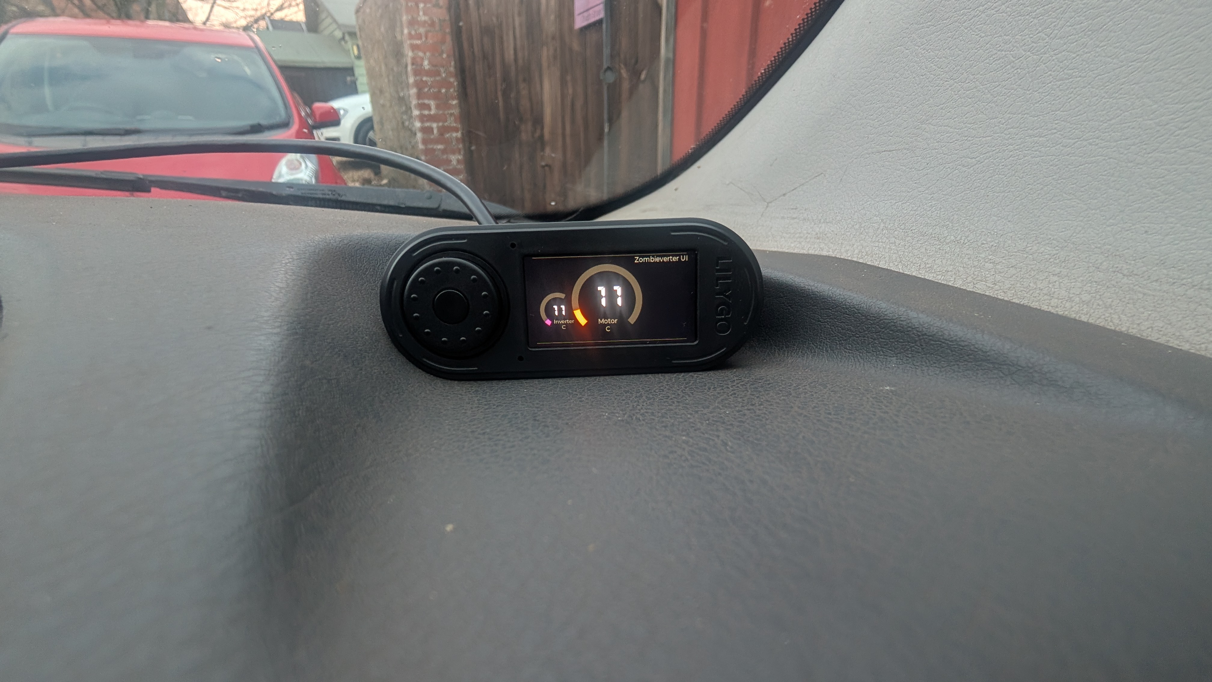

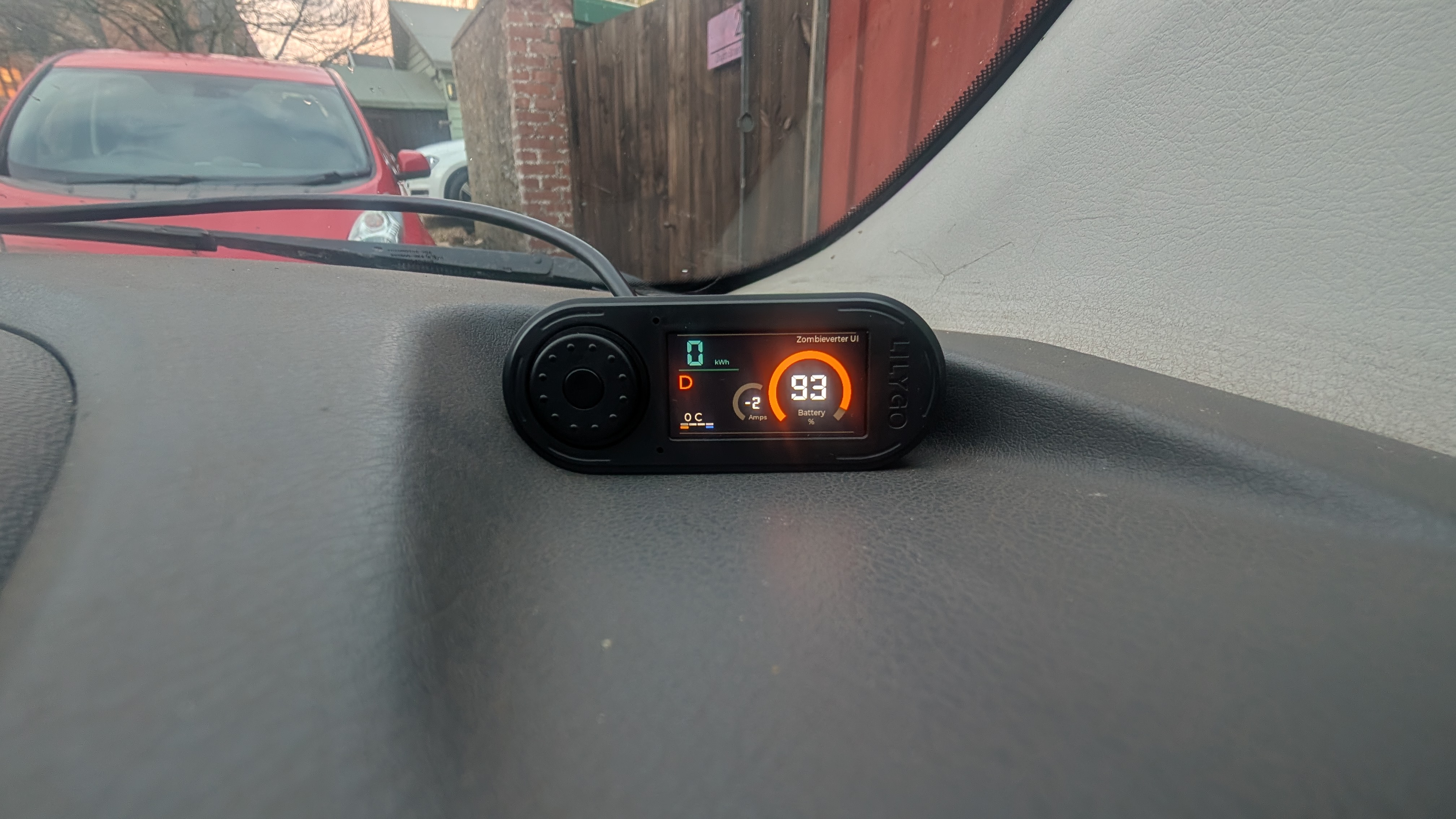

Re: ZombieVerter Display
Using Damien's linux command above with the attached files I get a partially working display, the only problem is a "No SPIFFS Files" error when I go to 192.168.4.1. I've got a params.json file from my ZV, attached below. Any advise on where I've gone wrong?esptool --chip esp32s3 --port /dev/ttyACM0 --baud 921600 --before default_reset --after hard_reset write_flash -z --flash_mode dio --flash_freq 80m --flash_size 16MB 0x0 ZombieVerterDisplay.ino.bootloader.bin 0x8000 ZombieVerterDisplay.ino.partitions.bin 0xE000 boot_app0.bin 0x10000 ZombieVerterDisplay.1_1_0.bin 0x910000 ZombieVerterDisplay.spiffs.bin
EDIT: I've just replaced the params file with the full version.

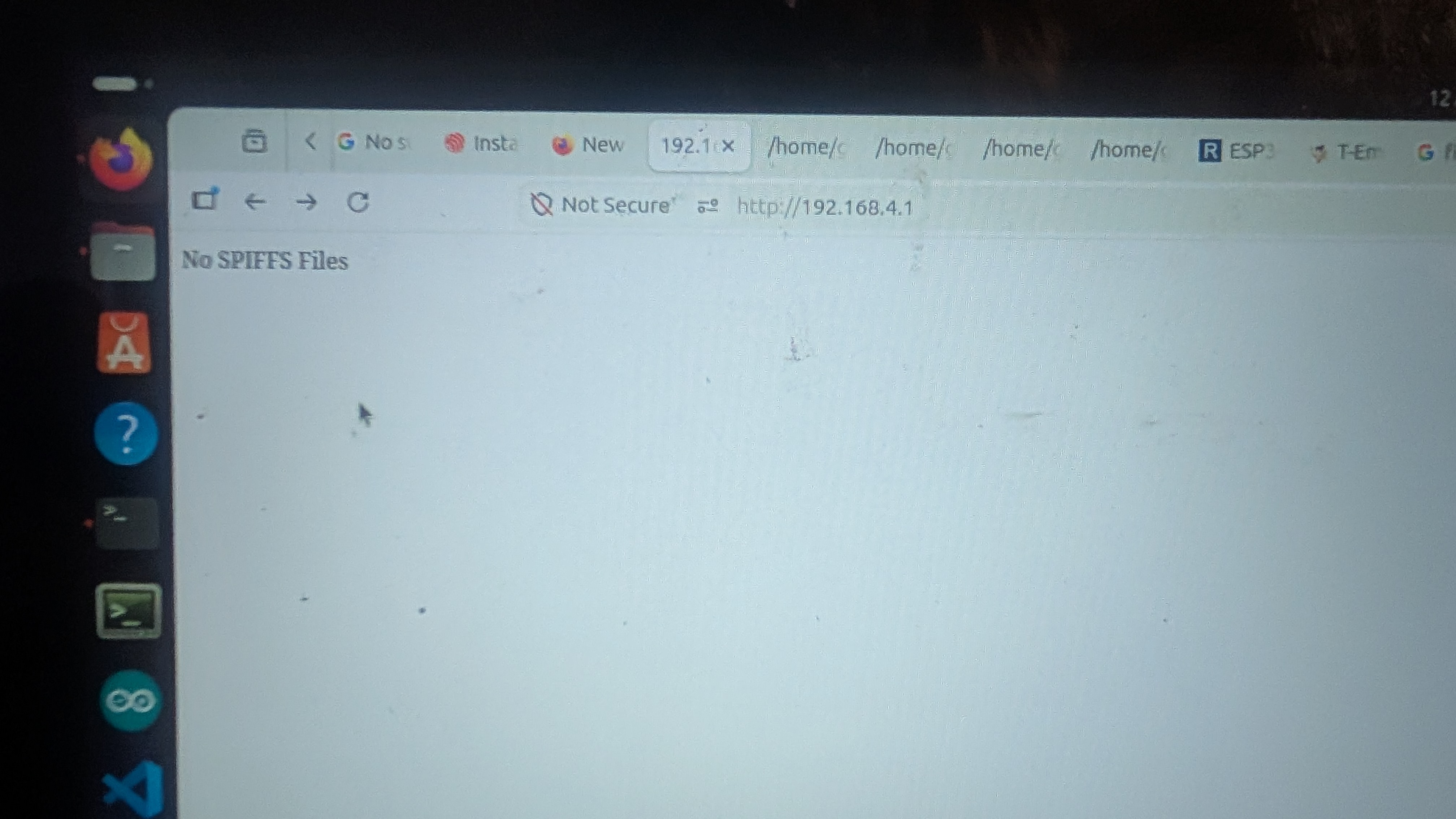

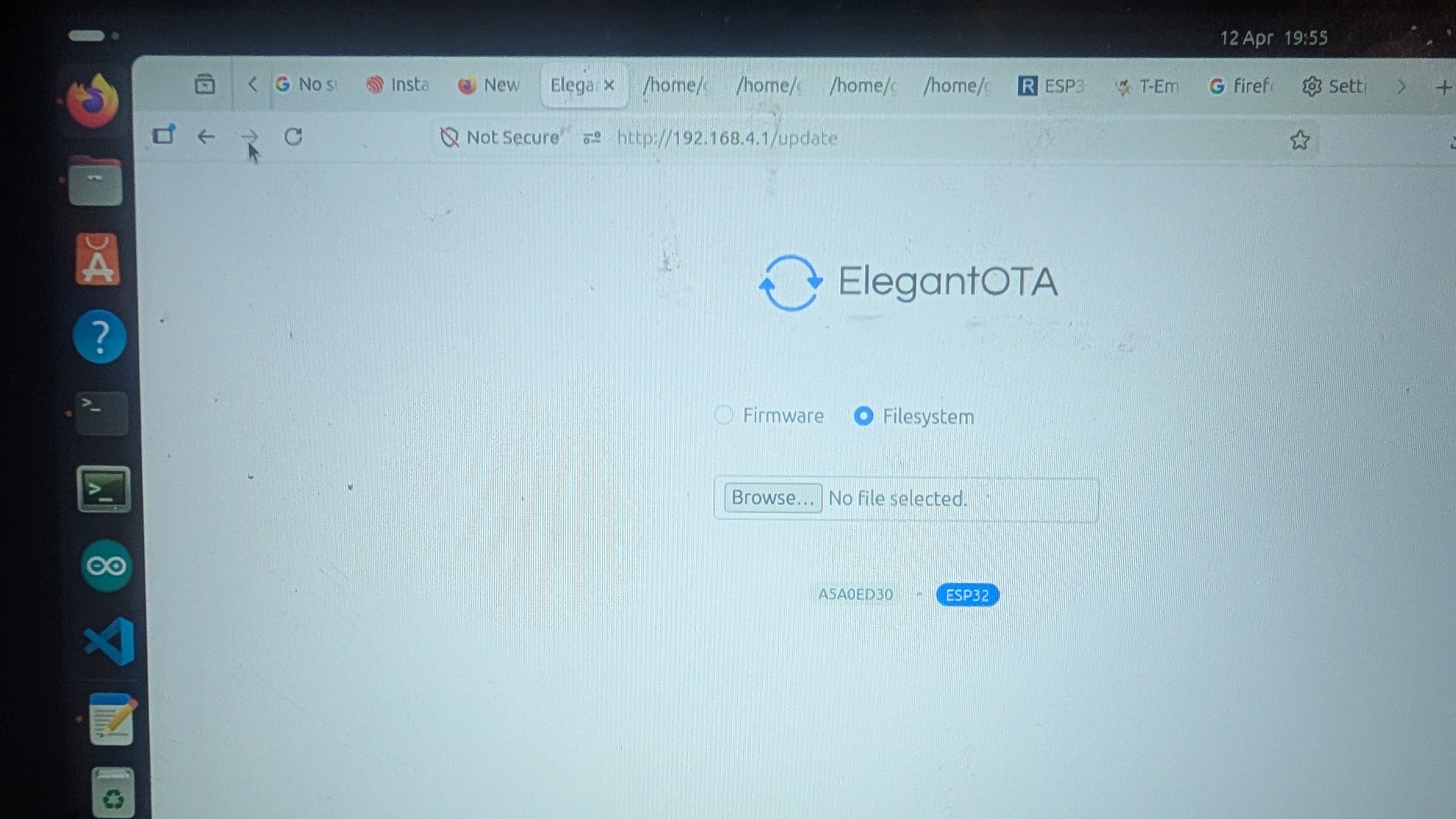

A bit more info, when I go to 192.168.4.1/update I can do OTA updates but none of the above files fix the "No SPIFFS Files" error. I had a look at the terminal output, shown below and noticed several warnings.
So I then tried this command from the terminal, no warnings but still the same error, "No SPIFFS Files".greg@HalfPint:~/Downloads$ esptool --chip esp32s3 --port /dev/ttyACM0 --baud 921600 --before default_reset --after hard_reset write_flash -z --flash_mode dio --flash_freq 80m --flash_size 16MB 0x0 ZombieVerterDisplay.ino.bootloader.bin 0x8000 ZombieVerterDisplay.ino.partitions.bin 0xE000 boot_app0.bin 0x10000 ZombieVerterDisplay.1_1_0.bin 0x910000 ZombieVerterDisplay.spiffs.bin
Warning: Deprecated: Option '--flash_mode' is deprecated. Use '--flash-mode' instead.
Warning: Deprecated: Option '--flash_freq' is deprecated. Use '--flash-freq' instead.
Warning: Deprecated: Option '--flash_size' is deprecated. Use '--flash-size' instead.
Warning: Deprecated: Choice 'default_reset' for option '--before' is deprecated. Use 'default-reset' instead.
Warning: Deprecated: Choice 'hard_reset' for option '--after' is deprecated. Use 'hard-reset' instead.
Warning: Deprecated: Command 'write_flash' is deprecated. Use 'write-flash' instead.

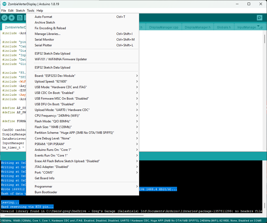

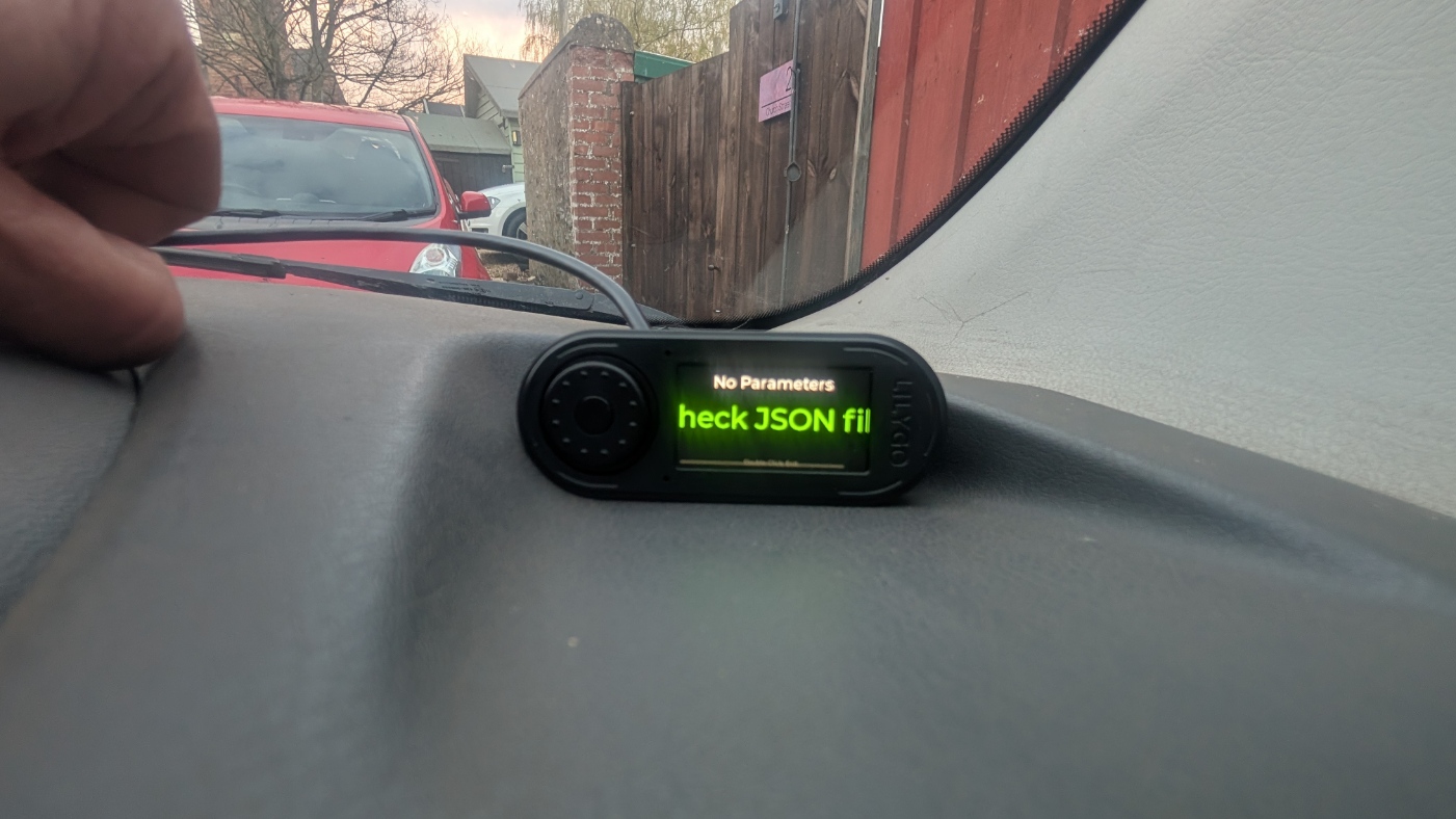

Still not working
Below is the serial monitor output.
I even tried compiling from source, it compiled but the display went into a constant reboot cycle.
I'm not sure what to do next?
When I go to settings I get the green screen of death! I'm getting data from the ZV and I can connect to the display and upload .bin files but I always end up with the no spiffs error.Failed to parse params.json: EmptyInput
Failed to load parameters
Loaded 0 parameters for settings screen
Loaded 0 spot parameters for spot params screen

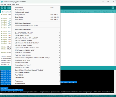

This is what I get when I try and build from source.
Compiles fine but then goes into a boot loop with this message repeating on the serial monitor.Sketch uses 1668941 bytes (53%) of program storage space. Maximum is 3145728 bytes.
Global variables use 101124 bytes (30%) of dynamic memory, leaving 226556 bytes for local variables. Maximum is 327680 bytes.
esptool.py v4.5.1
Serial port COM5
Try using https://esptool.spacehuhn.com/ to flash the attached full flash dump from my display at address 0x0

- GregFordyce
- Posts: 46
- Joined: Sun May 23, 2021 5:58 pm
- Has thanked: 43 times
- Been thanked: 28 times
I couldn't get the online tool to connect to my display but flashing it with my linux laptop, with the command below, worked a treat!
I've uploaded my params.json file and all is good.
Thanks!!!
greg@HalfPint:~/Downloads$ esptool --chip esp32s3 --port /dev/ttyACM0 --baud 921600 --before default-reset --after hard-reset write-flash -z --flash-mode dio --flash-freq 80m --flash-size 16MB 0x0 ZombieDisplayFull.bin
Thanks!!!
