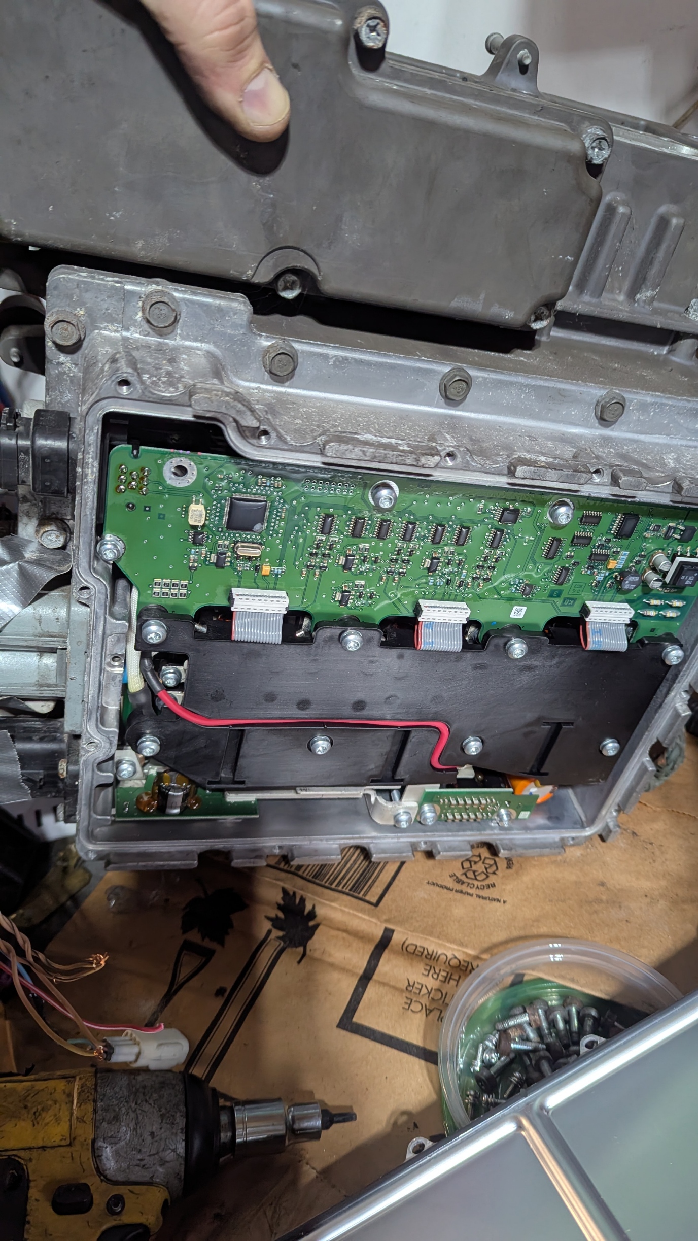

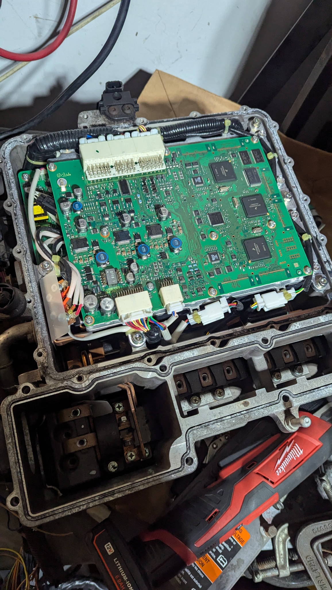

Yes! The Volt Inverter was my original plan, but I switched. The toyota inverters are very common in the junk yards around here, so I'm a little disappointed. Its not a huge deal, because I have all three inverters (Tahoe, Volt, and Prius) sitting around here.
The Tahoe and Volt Inverters are made by Hitachi. I was hoping that I could google some interface documentation on these inverters. The volt inverter is on Hitachi's web page. The tahoe and volt boards are very similar including the connectors. I beleive they're the same, but white instead of black. Using the new board with the Tahoe inverter would probably work with different connector locations and pinouts.
Regarding the volt boards... I actually priced having the Damien board mostly build by JLCPCB last year. I had to have 5 made and they came to about $400. I figured that I could make some of it back by selling the boards. Some of the parts are now obsolete, so I had to find some subs. I might try doing it again.
Here are some pics:
Here are some pics:

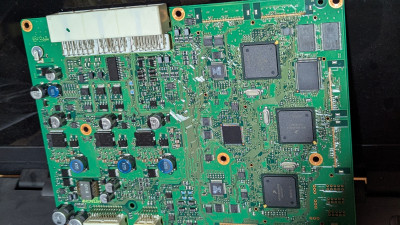

Here is a better photo of the Tahoe board. I would prefer not to open the volt inverter right now, but those are already on the internet.
Here are some of the parts
HITACHI board GD219561
MPC565MVR56
1MByte Flash
36Kbytes of Static RAM
ST M58BW0160
16MB Flash memory
25LC640:64K SPI Bus Serial EEPROM
CY7C1021CV26
IC SRAM 1MBIT PARALLEL 44SOJ
ADW71205YSTZ-ND
Complete monolithic resolver-to-digital converter (RDC)
TI 2444AQ: Advanced LinCMOS™ RAIL-TO-RAIL OUTPUT WIDE-INPUT-VOLTAGE OPERATIONAL AMPLIFIERS
ACPL-M46T:Automotive Intelligent Power Module with R2 Coupler™ Isolation and Small Outline
Altera ACEX EP1K10TI100-2N – 1K FPGA (56000 gates, 12288 bit memory
576 LE
66I/O
TQFP-100
72 Logic Array Blocks
SN74LVC245A Octal Bus Transceiver With 3-State Outputs
MC74HCT541A
Octal 3-State Non-Inverting Buffer/Line Driver/ Line Receiver With LSTTL-Compatible Inputs
LC245AQ:SN74LVC245A Octal Bus Transceiver With 3-State Outputs
APIC-S03 is a specific type of photoMOS relay, which is used in various circuits where reliable and fast switching of signals is required. Here are some common applications and circuits that might use the APIC-S03
