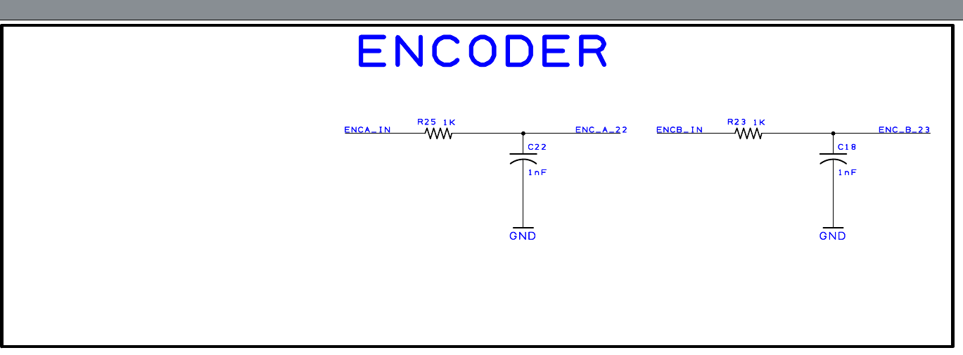

Hello Guys,
I recently got my self a Tesla SDU inverter and OI drop in board and it having some problem, here the list of question and problem that I have encountered.
1.) Is the OI drop in board for Tesla SDU can be program to drive PMSM with FoC
2.) I have tried using various kind of sensors, such single channel PWM encoder( not getting any response on graph) , sin cosine mlx90380( showing graph but missing 355- 2 degrees) , AB encoder. - no showing any on the angle graph.
3.) Power going to main or battery is always tripping as if it is deadshorted, but the on OI web interface shows negative values.
4.) Il 1 shows negative values even the inverter is on idle.
5.) Inverter always showing overcurrent if I adjust current limit to 20a.
Hope someone can help.
Best regards.
Iccie.

I would suggest you go and research the shit out of posts on this blog as this is something no one has tried yet....
1. FOC should load but you need to know which settings/inputs you need to select in the web interface so it doesnt trip I dont know about running PMSM with tesla board, i know i did it with gen2 OI board
https://openinverter.org/forum/viewtopi ... 888#p25888
2. Could be that your sensor is saturating the input. Maybe you need a divider to lower voltage to 1.66V
https://openinverter.org/forum/viewtopi ... 979#p16979
3. there are various settings to swap the order of inputs and you have to get them correct
4. ditto
5. Overcurrent level is meant to be sensed for protection only so at 400A or more. This is not so much active value, rather taken as protection from OC.
We cant hold your hand here... you will need to research the SDU development threads here where there were those milestones you need to solve.

you are pioneering here as the SDU board is meant to drive the SDU motor with direct sine control.
You might be able to run a sin/cos chip on the AB inputs.
AB encoders are not suitable for PMSM control.

so are you reading A and B encoder or Sin Cos return encoder. there is a difference in pulse return. do you have a scope?
Check the.schematic for.resolver i showed you...there is resistor.that should be removed i think...
Been thanked: 1913 times
Re: Openinverter drop in board for Tesla SDU
Normally there is but on the Tesla Board there isn't:
@iccie Please stop complaining on YT that you didn't get replies here. You got plenty

arber333 wrote: Tue Apr 07, 2026 5:22 am so are you reading A and B encoder or Sin Cos return encoder. there is a difference in pulse return. do you have a scope?
I have cheap mini handheld scope. But I am not sure how to. Use it,.
I have checked the resolver schematics, and tried to build on, but unfortunately some parts are not available locally, and may take some time to arrive.
Yes, I was able to get a signal from AB pin using mlx90380,
Originally I cannot get any reading on B pin ( I assume something messed up or grounded from voltage regulator) so I decided to direcly hook the sin and cosine output to c22 and c18 which leading to stm32 pins, directly bypassing the resistor from circuit, as expected it have bad judder without this resistors.
What I am planning to do is to install resistor directly to my encoder.
But problem still prevails, or atleast I am thinking it is a problem.
1.) The encoder gives twice (2x) 0-360degress on one single rotor turn.
2.) If I rotate the rotor in one direction I only get 0-360 climb but it doent do 0-360?
Are those two from above are normal? What should I do. ?
Best regards,
Iccie
Posts: 3795
Been thanked: 411 times
Ah your chip could be set to different pole setting. Leaf motor is 8-pole, 3-phase, 48-slot machine. Could be that you have a 4 pole count set in chip and ...
Or you have FOC set incorrectly?
Read the datasheet if there is a possibility to set pole count on resolver chip.

Post by iccie2 »
I was temporarily to fix the over current issue after playing with manual LD and lq then pinswap. The problem went back again after I fix the magnet and encoder. Not sure what happen, but the inverter is reading the correct encoder position. I was wondering if dead time has to do with it?
Some issues to fix;
1.) Minor erratic spike on encoder signal, planned to play with different resistoe value and placement.
2.) Current is detected as -8amps , I'm am not sure why.
Some questions neee to be answer,
1.) Is 360 degrees sensor reading while 180 degrees physical on rotor ok (2:1 ratio on sensor and actual) , if the motor is spinning? Could it affect efficient of the drive train? Can I see the code regarding sensor input?
2.) The power supply is not tripping anymore and the motor spins faster than before, but my current reading on OI is -8amp? What causes this?
3.) Do I still need to buy lcr meter to properly set the ld-lq?
Hope I can get some help.
