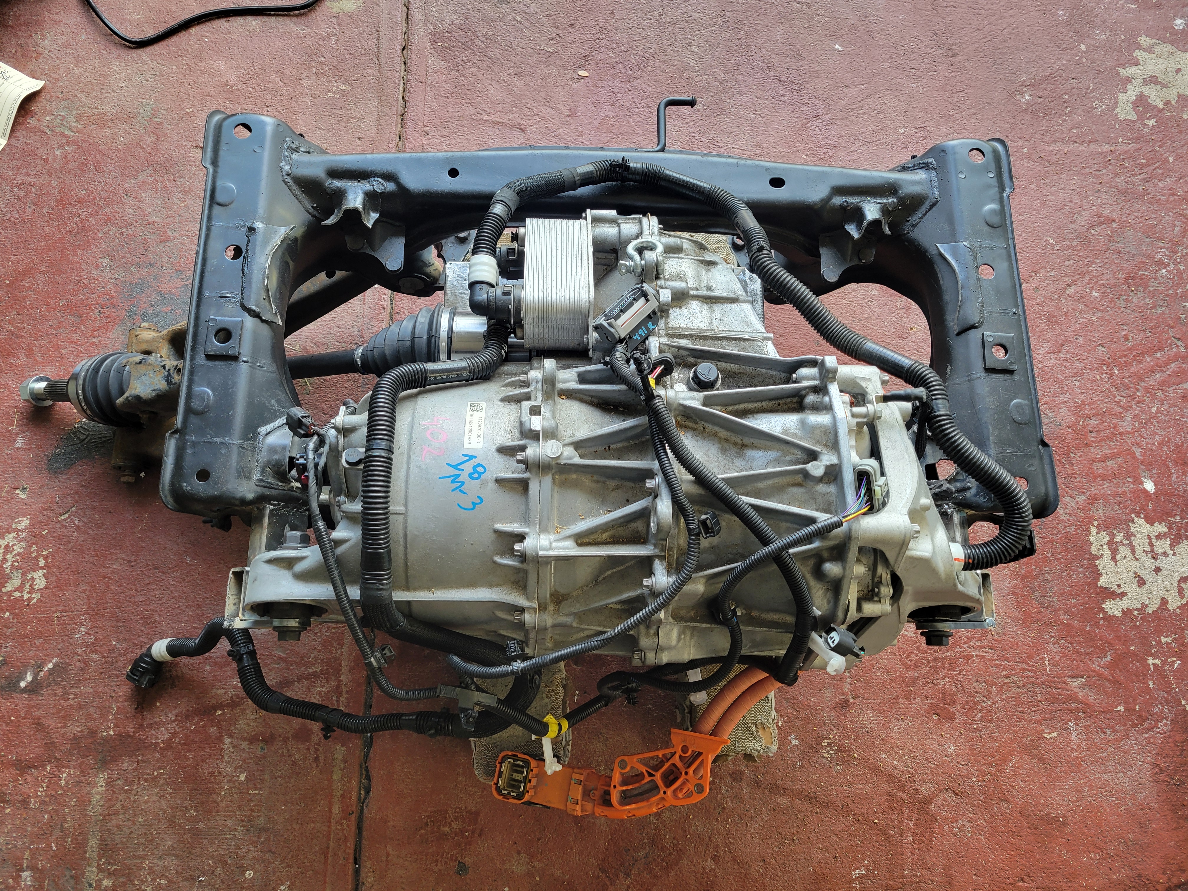

Model3 Drive unit in modified rear subframe:
initial CAD placement:
Frame minus motor in car:

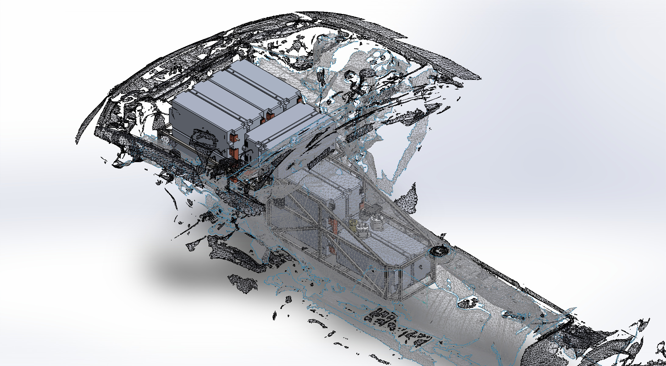

Thanks to Chris at Fellten for the file, I was able to use a 3d scan + my own measurements to tetris in the battery design
i have 3mm x 25mm flat copper bar to start building my busbars with, as well as the overall busbar designs which I will likely 3d print first to confirm fitment. I am looking into nickel plating options locally but may end up sending an order out to get the files i made done up by professionals lest I do something poorly or wrong.

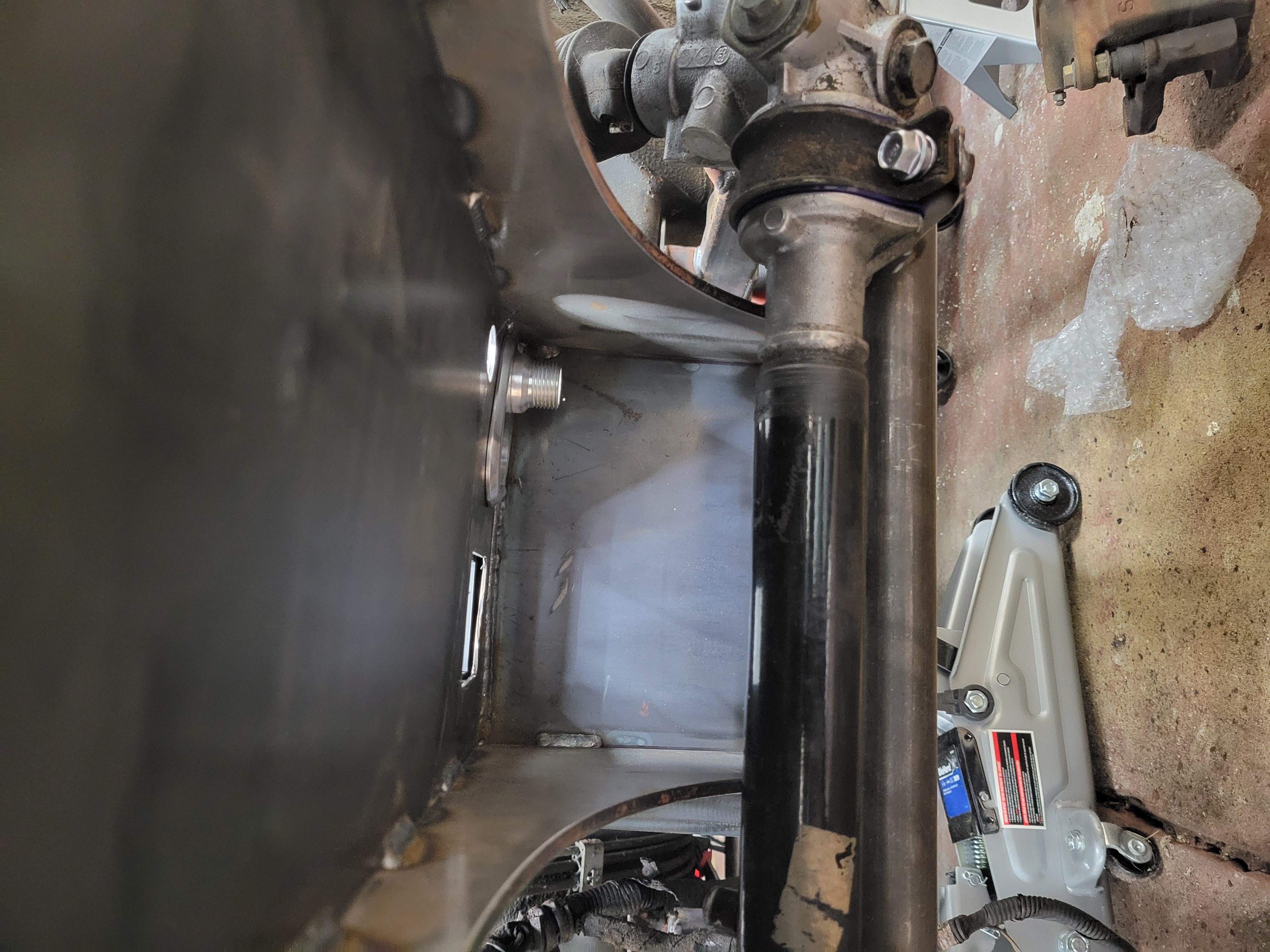

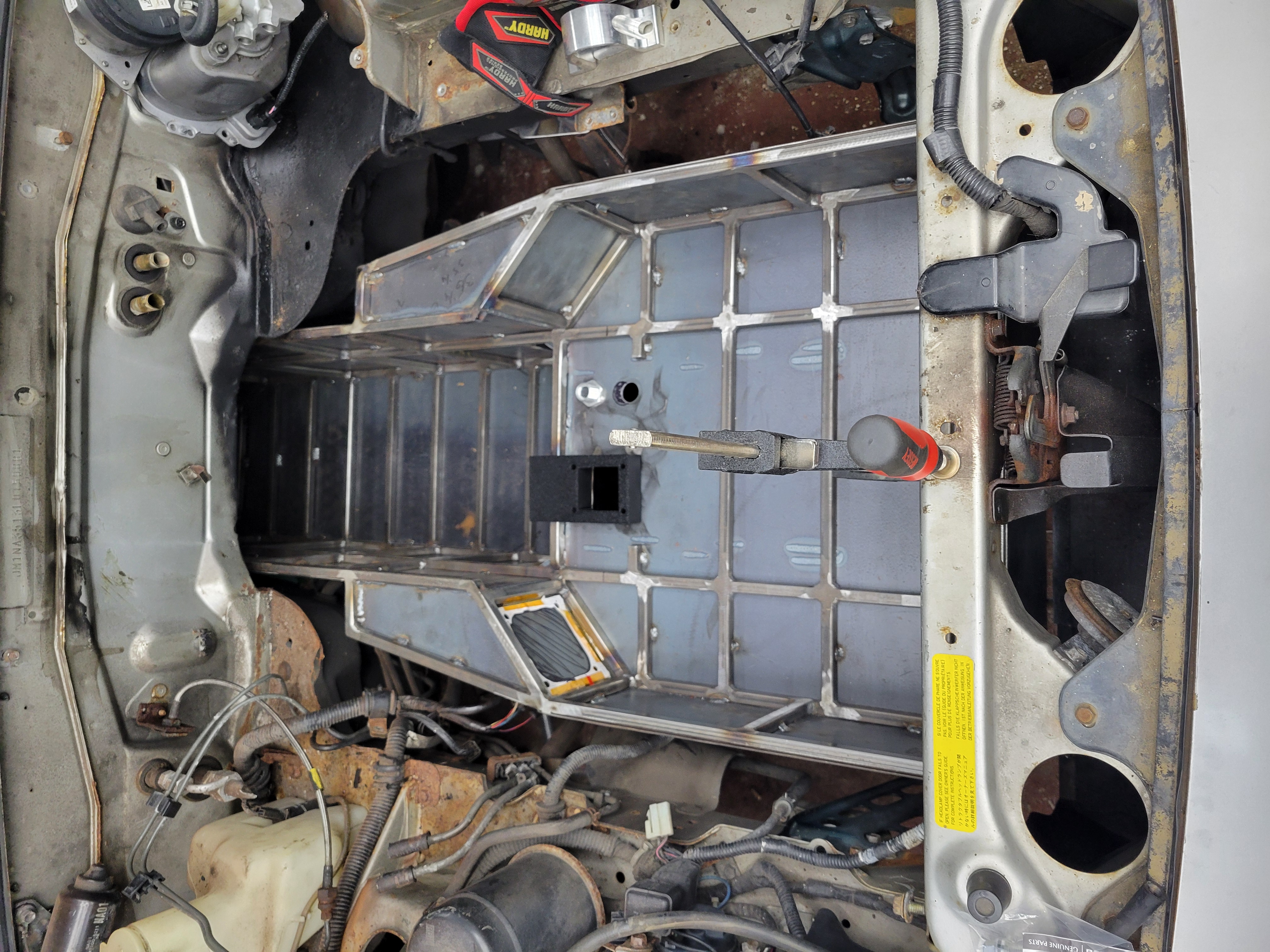

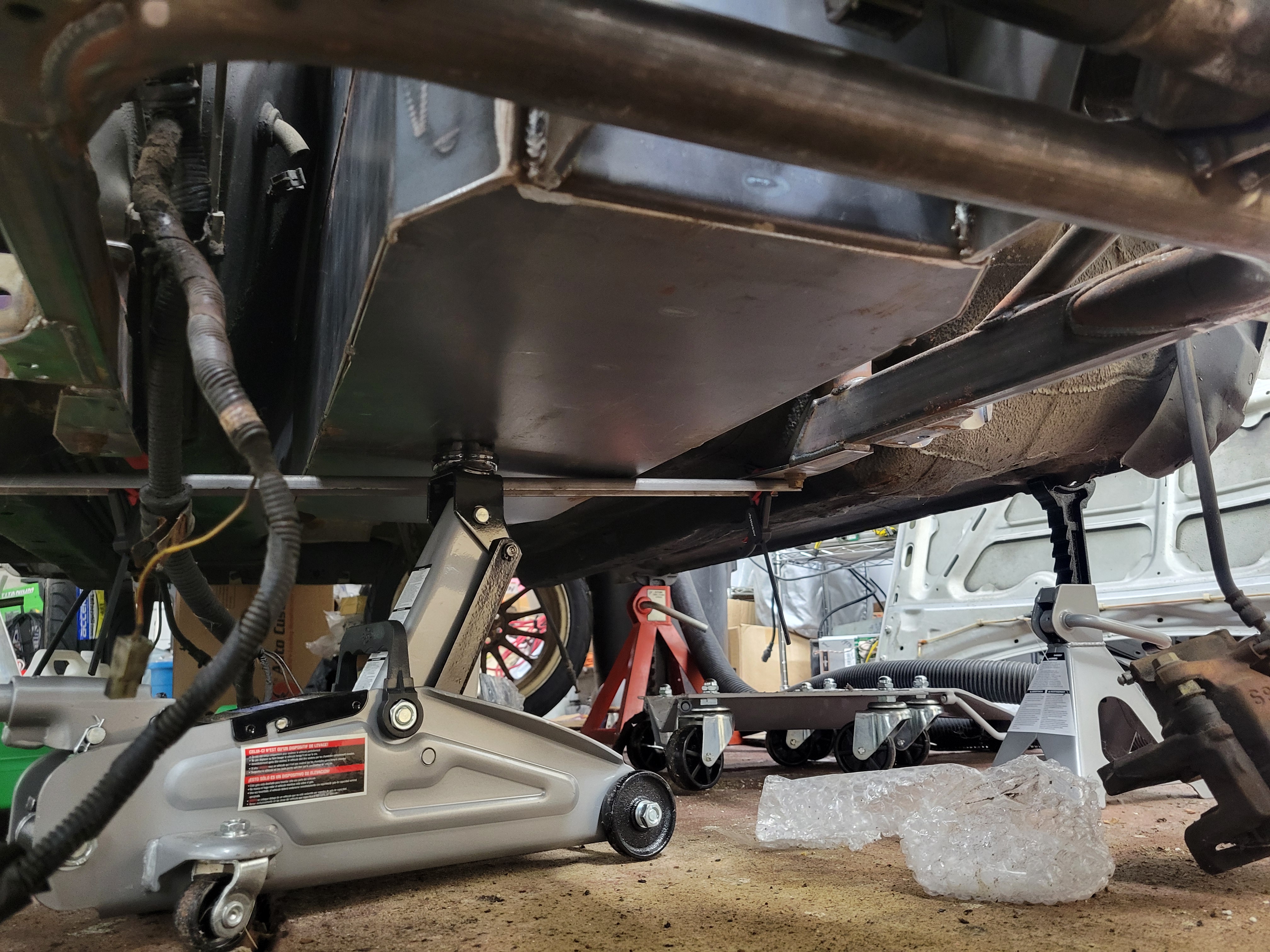

Some updates, slow going of course as this also turned into a restoration project. Kind of stuck on how best to secure the battery box to the frame. Thinking either multiple crossbar c channel or bolting everything to a 1/4" plate lasercut to fit
Battery box fitment
Battery box fitment
Battery box fitment
Battery box fitment
Battery box fitment
Battery box fitment
