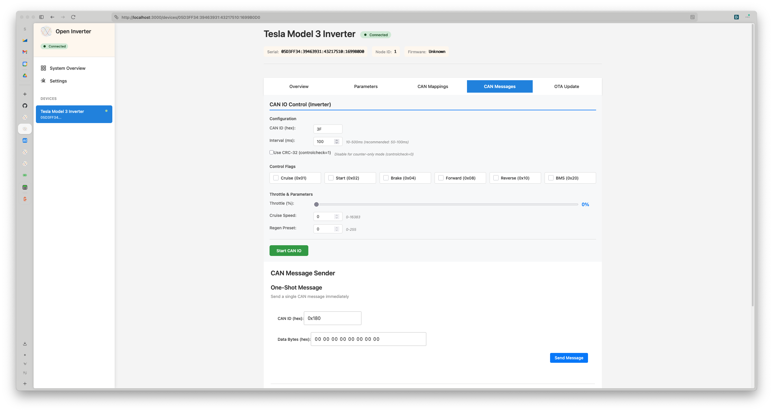

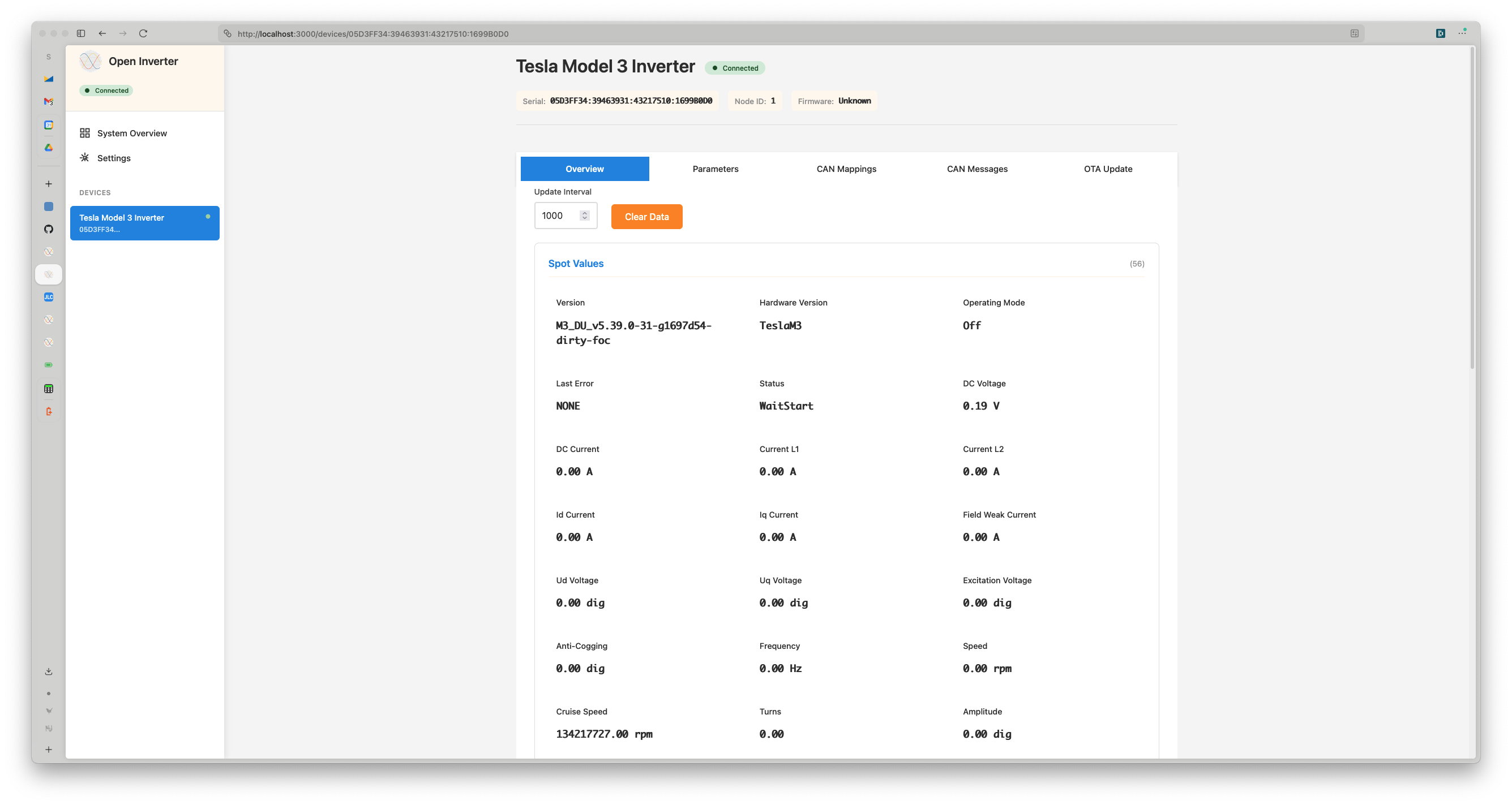

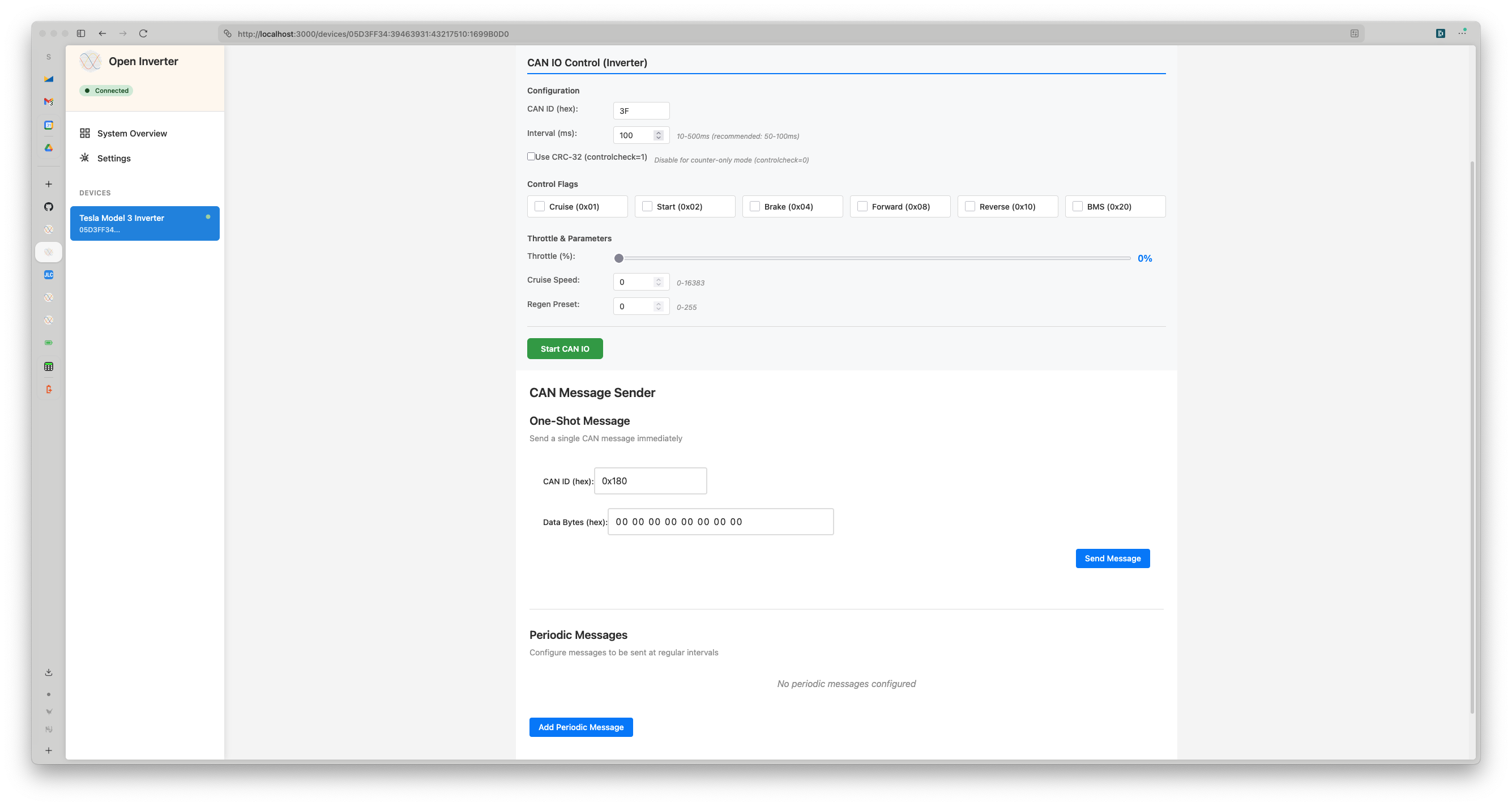

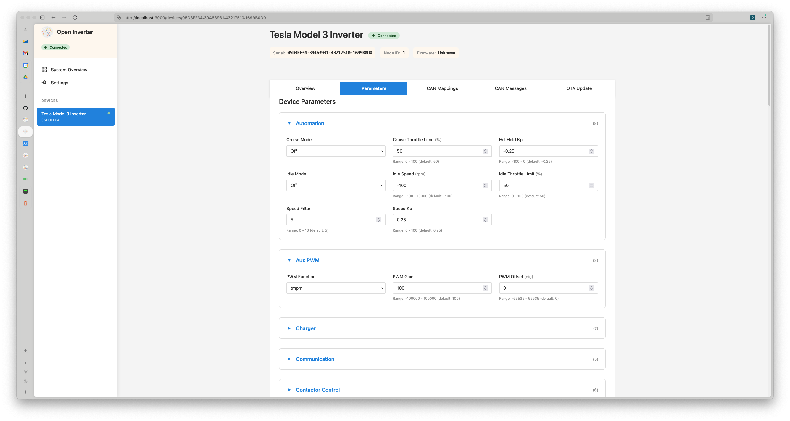

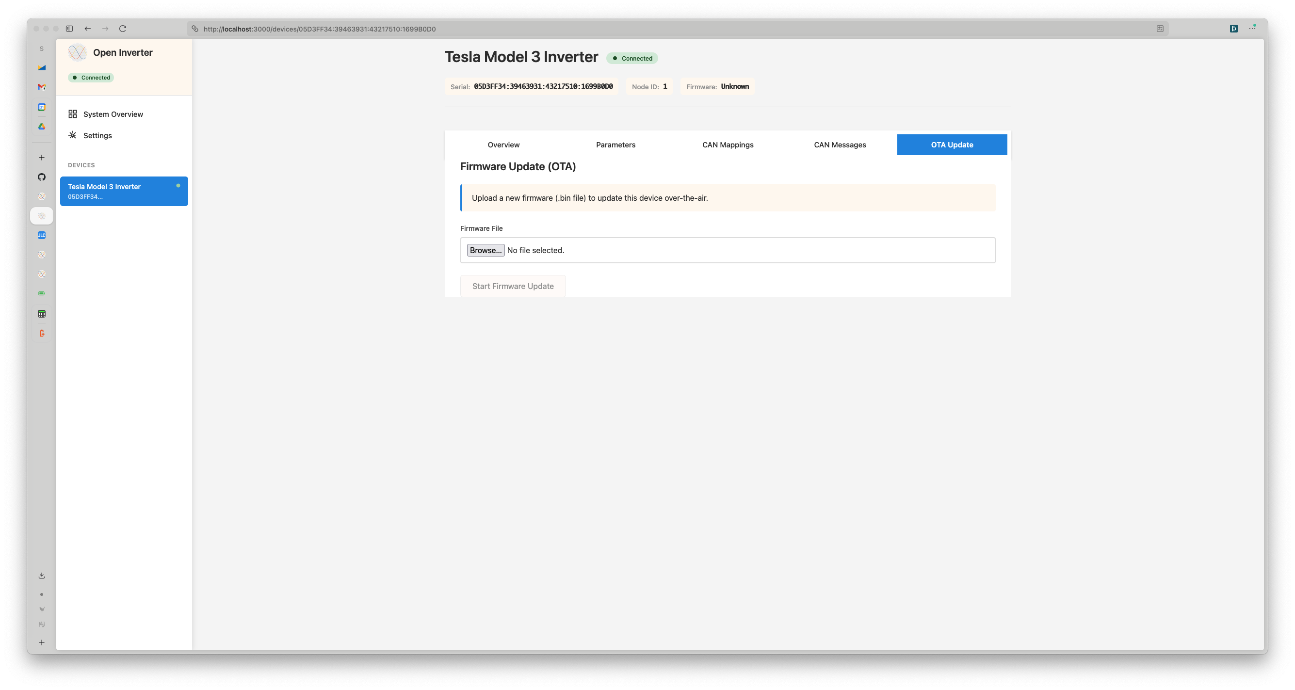

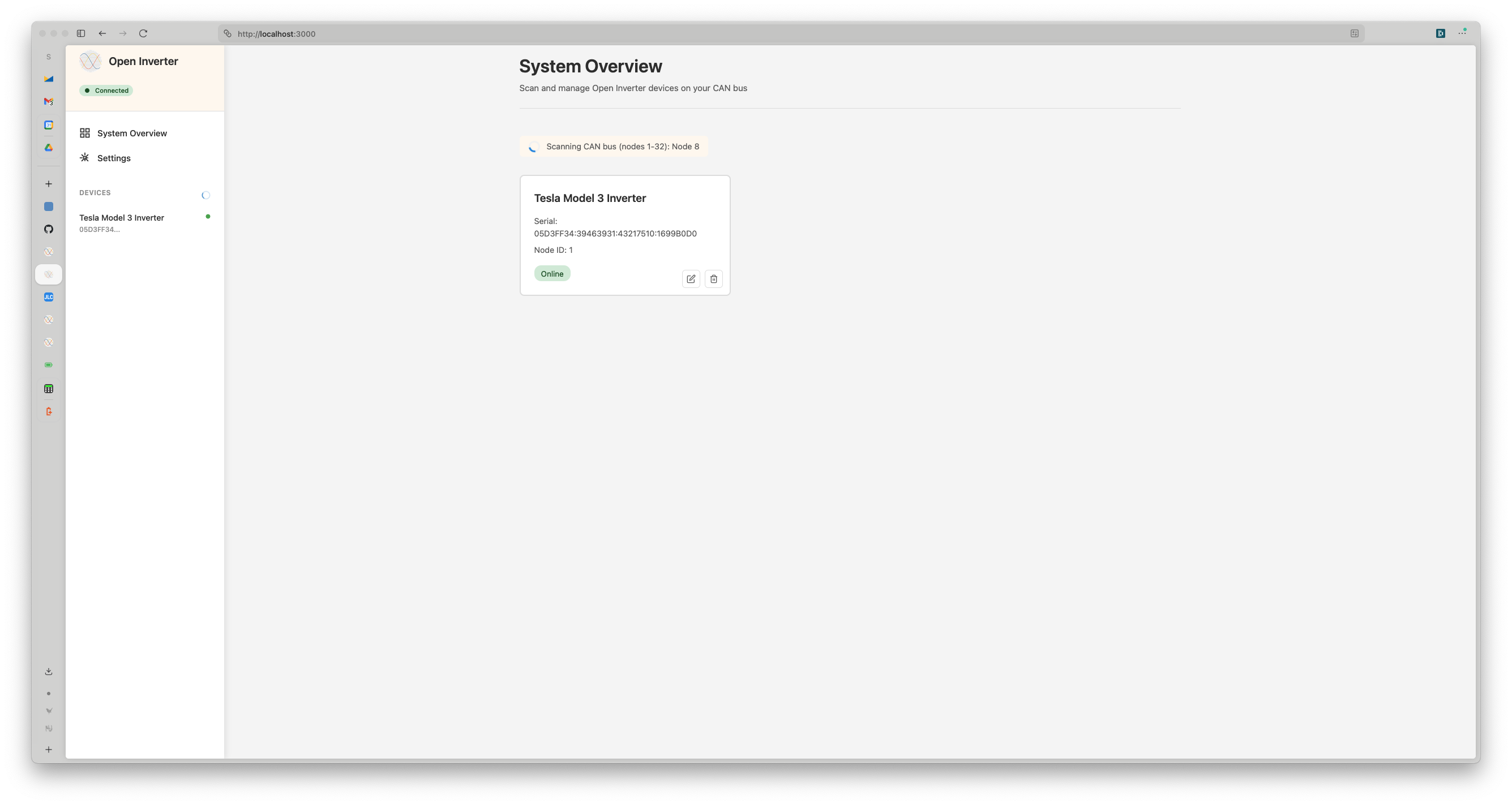

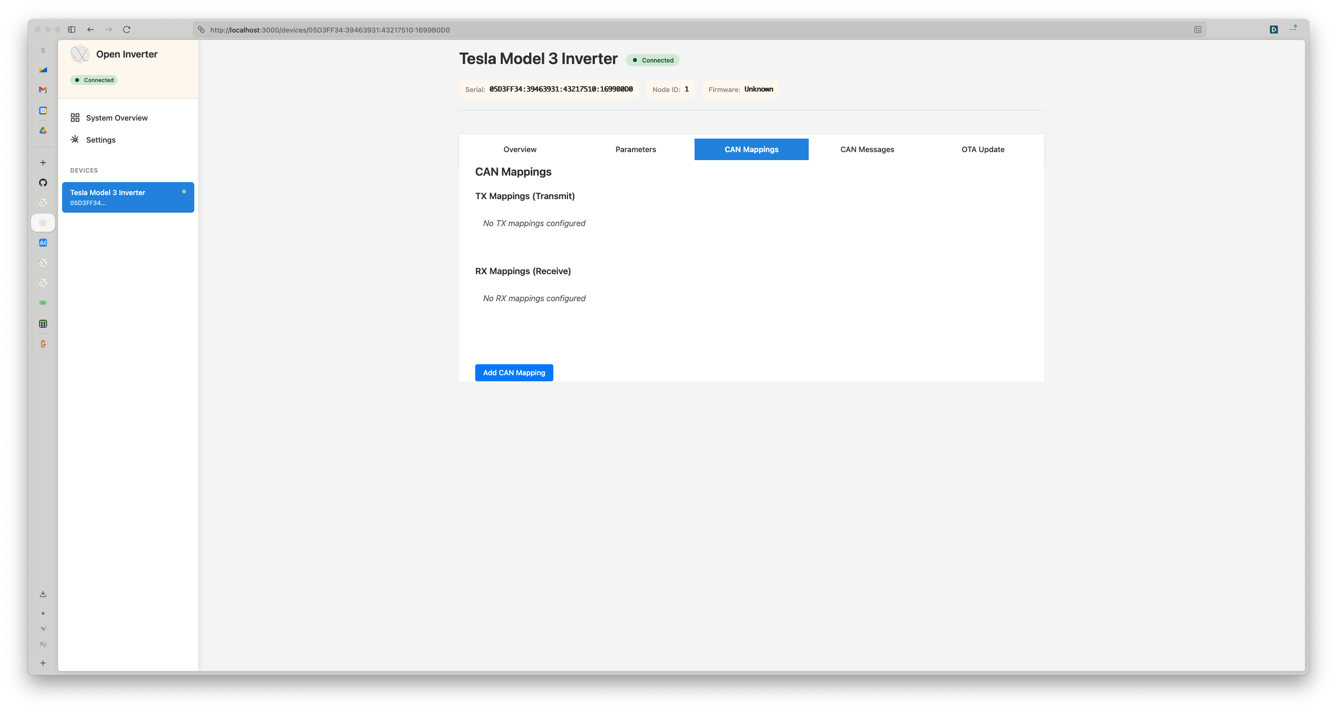

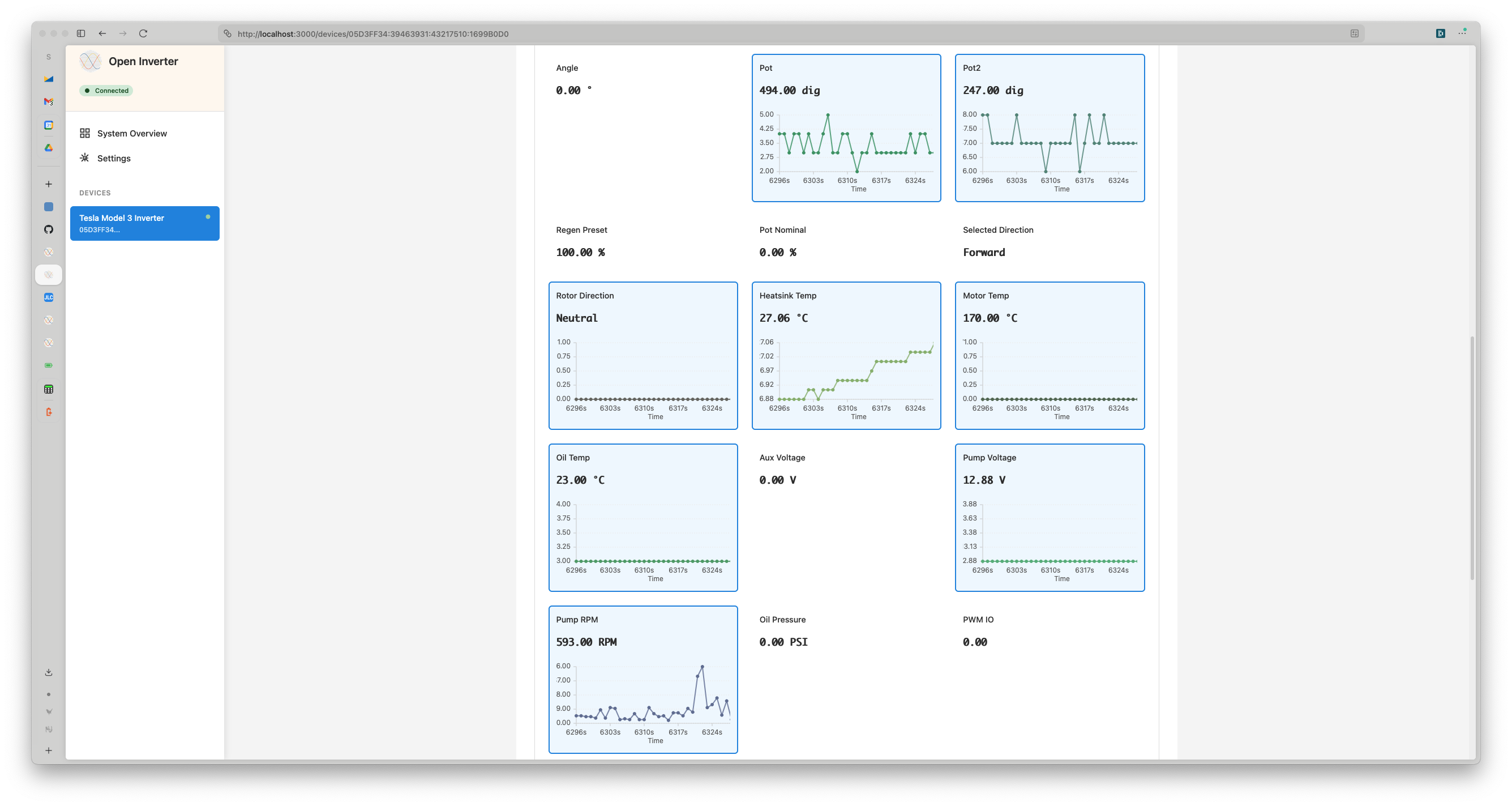

I *accidentally* created a fork of the esp32 web interface for Open Inverter. It started off with just the goal to improve the UI a bit, but I ended up expanding to a lot more than that as I thought out my user experience a bit more. Suddenly, I had a new project :oops:
This project was also an experiment for me to vibe code an app that had an existing embedded and web codebase. Apologies in advance if there are some nonsensical decisions in the code. I used Claude Code to build this out and only gave it some light guidance / guard rails.
Here's some of the notable changes:
  • You can now scan and discover nodes on the network + name them. Previously saved nodes are remembered for easier connection
  • Improved lifecycle management and communication detection to both the ESP32 as well as remote nodes
  • Responsive UI for different screen sizes including mobile
  • Internationalization - it uses Intlayer to support new languages for translations of the UI
  • Improved robustness of CAN traffic - it uses FreeRTOS threads and async message sending / reception
  • Basic UI for sending CAN messages + `canio` control messages - this UI still needs iterations
  • Expanded support for `libopeninv` commands (work in progress)
  • Individual charting of spot values
  • Named parameter keys - adding this in the firmware of the Openinverter Device will show more display friendly names for a parameter
  • Multiple client / web browser support (needs more testing)
You can view the code here: https://github.com/outlandnish/openinve ... -interface
This fork is designed more for system overview / basic logging and only supports communication over CAN. If you're doing logging for tuning motor control, you're still better off with the OpenInverter CAN tool or the original ESP32 web interface for now.
(Work in progress) - I've still got some UI work to re-visit now
Screenshots:

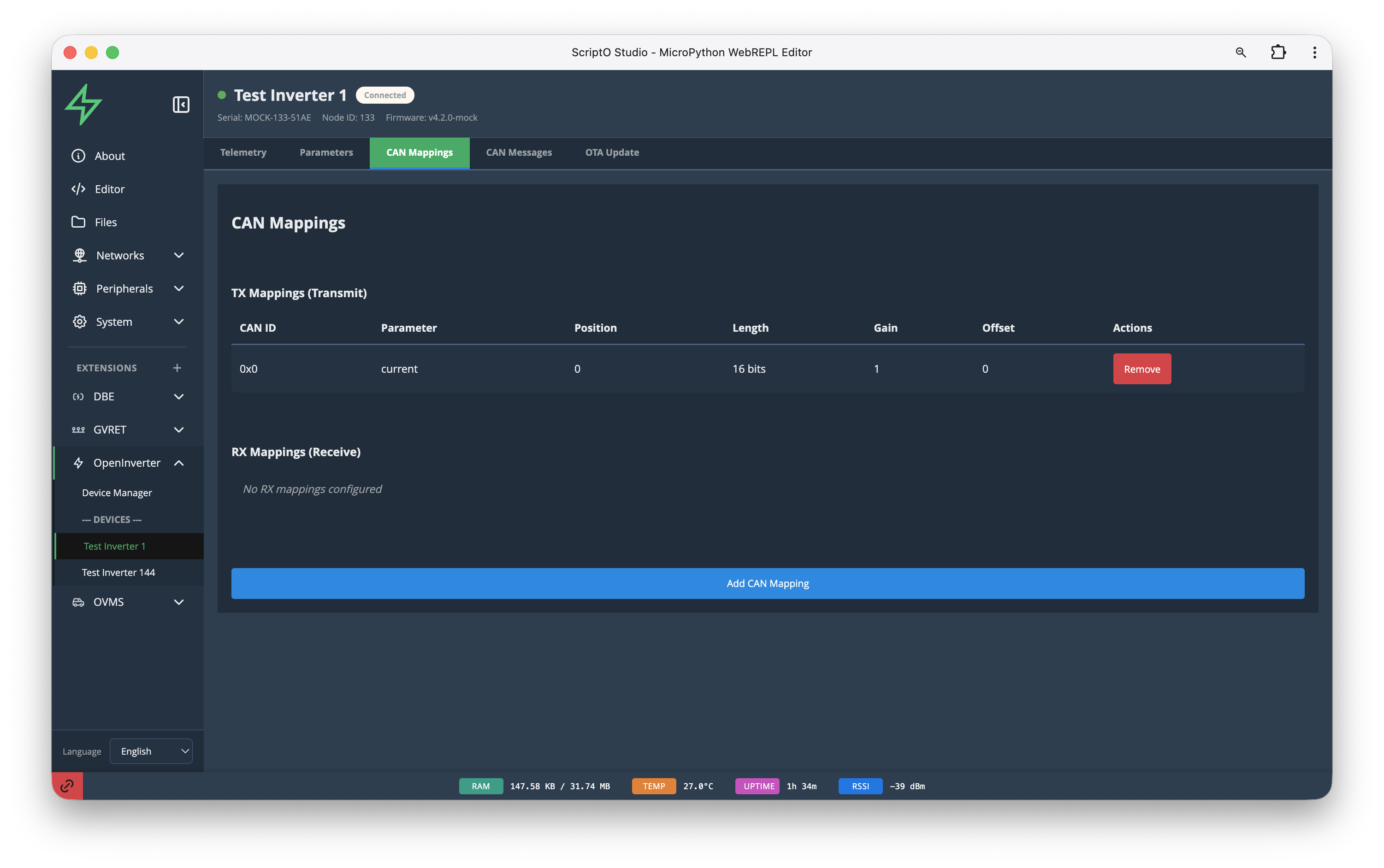

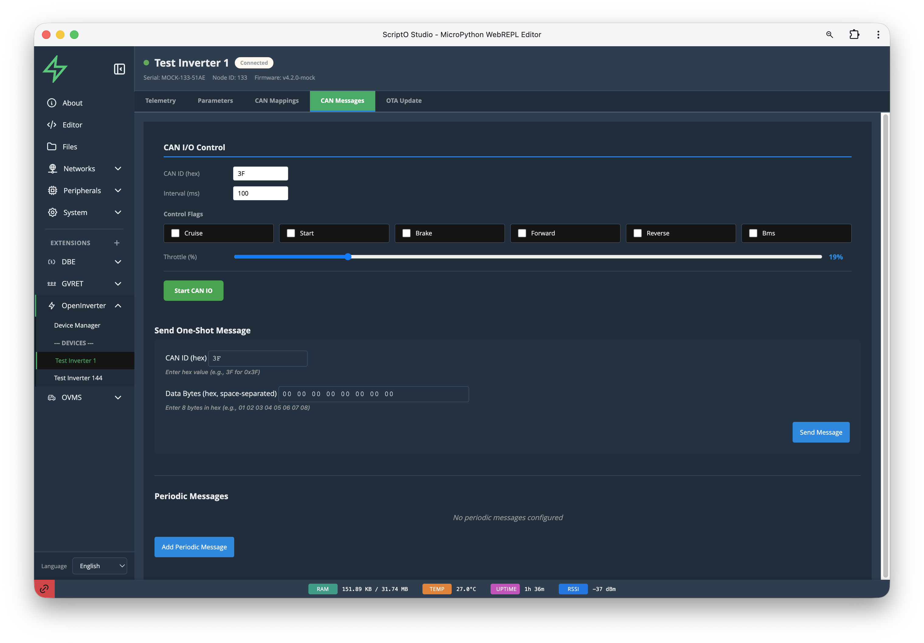

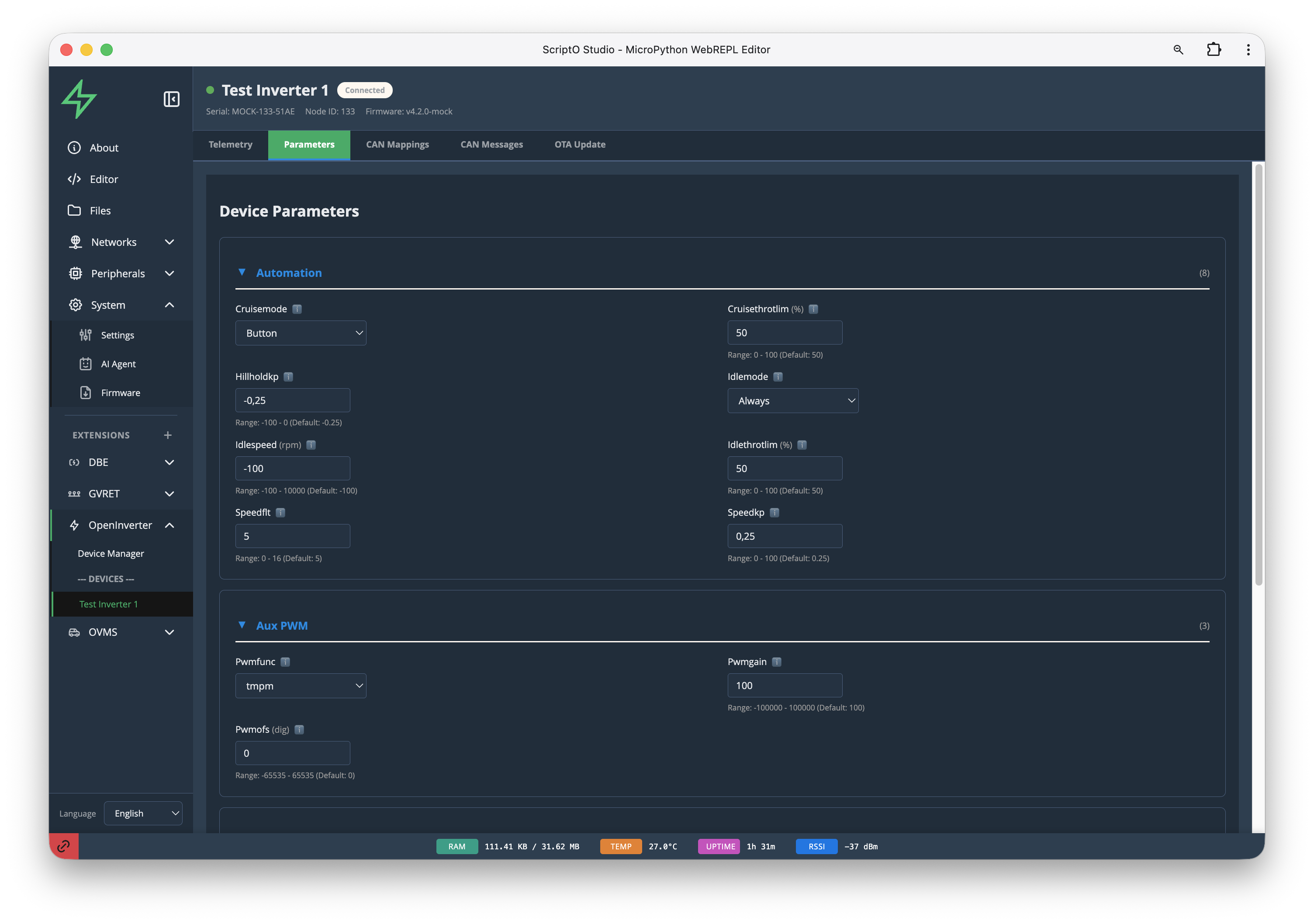

Hi @outlandnish,

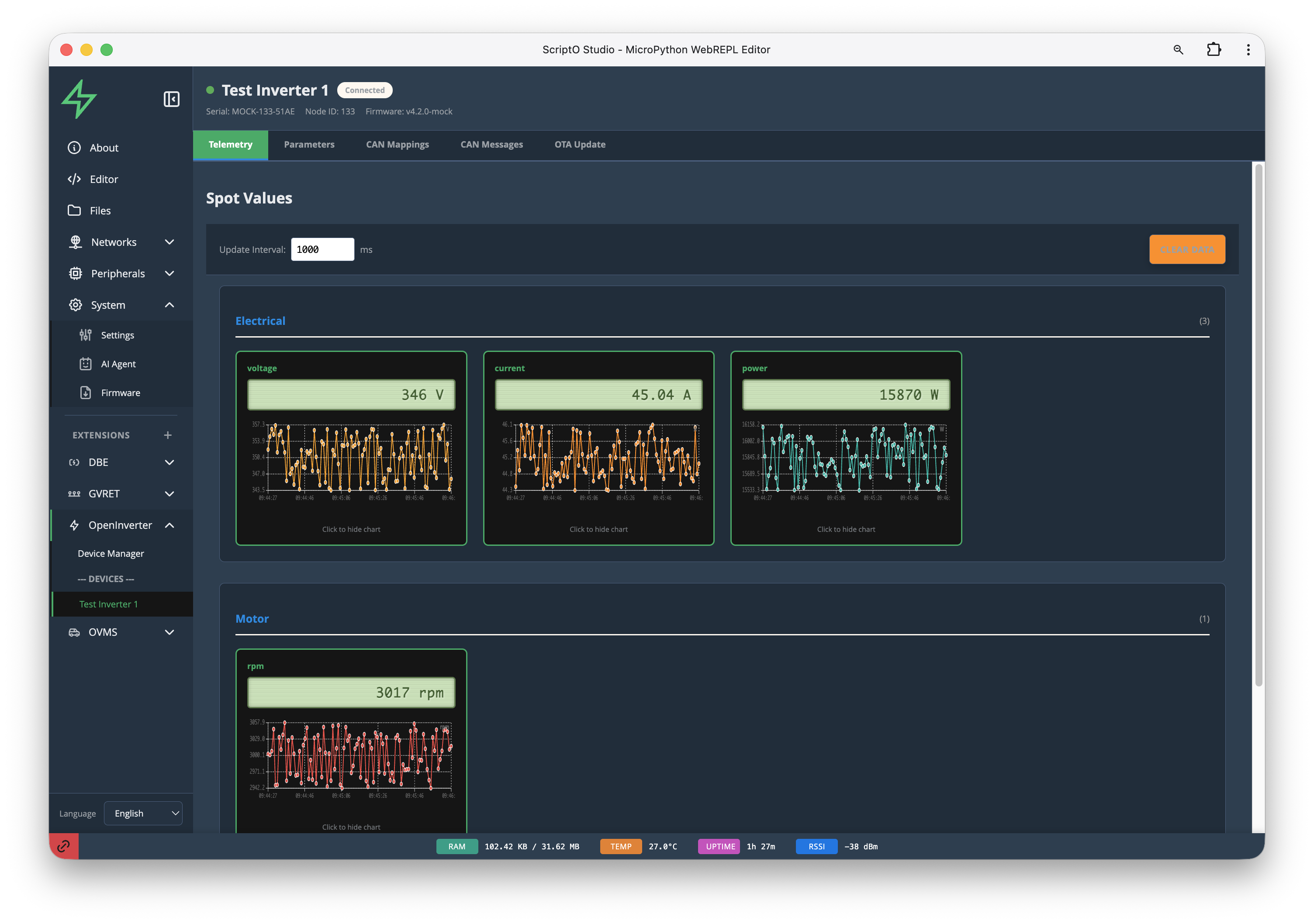

This is beautiful work, so much so I had to use your ideas in my own re-imagining of the use of the ESP32!
OI-Telemetry
OI-Telemetry
OI-Parameters
OI-Parameters
OI-CAN mappings
OI-CAN mappings
OI-CAN messages
OI-CAN messages

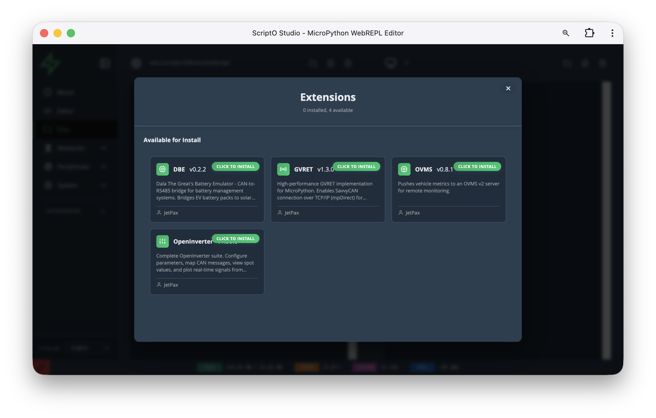

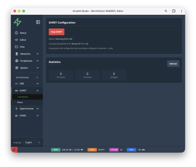

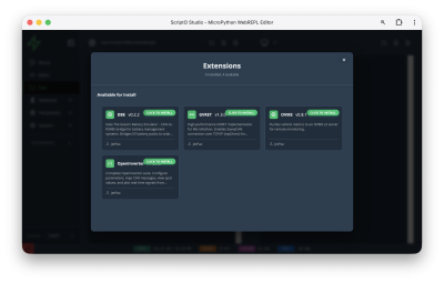

Based on that, I redesigned the system with the ESP32 becoming an 'Application Processor', running MicroPython, with some hardware accelerators to ensure that things like secure networking and CAN work at decent speed. This binary rarely gets changed, and running with a different application processor is just a question of using a different MicroPython port. ( I currently have ESP32-S3 and P4 running seamlessly).
That allows the user add any "Extensions" at run time, such as OI, GVRET (@uhi22), OVMS (@bigpie), Dana's Battery Emulator with the same binary and hardware platform, without compilation or flashing new firmware. Multiple simultaneous users of the CAN busses are managed by a CAN manager so that for example, OVMS can peacefully co-exist with OI ).
Extensions
Extensions

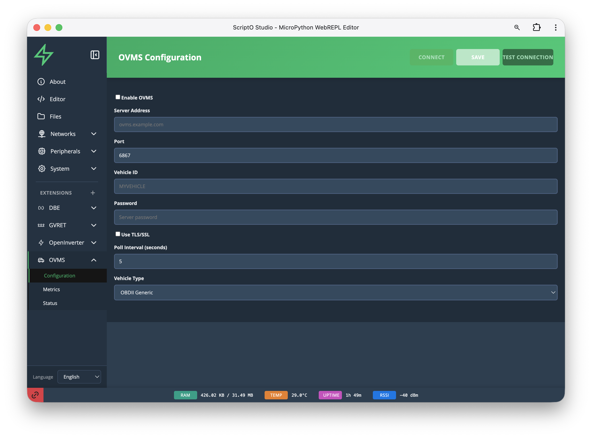

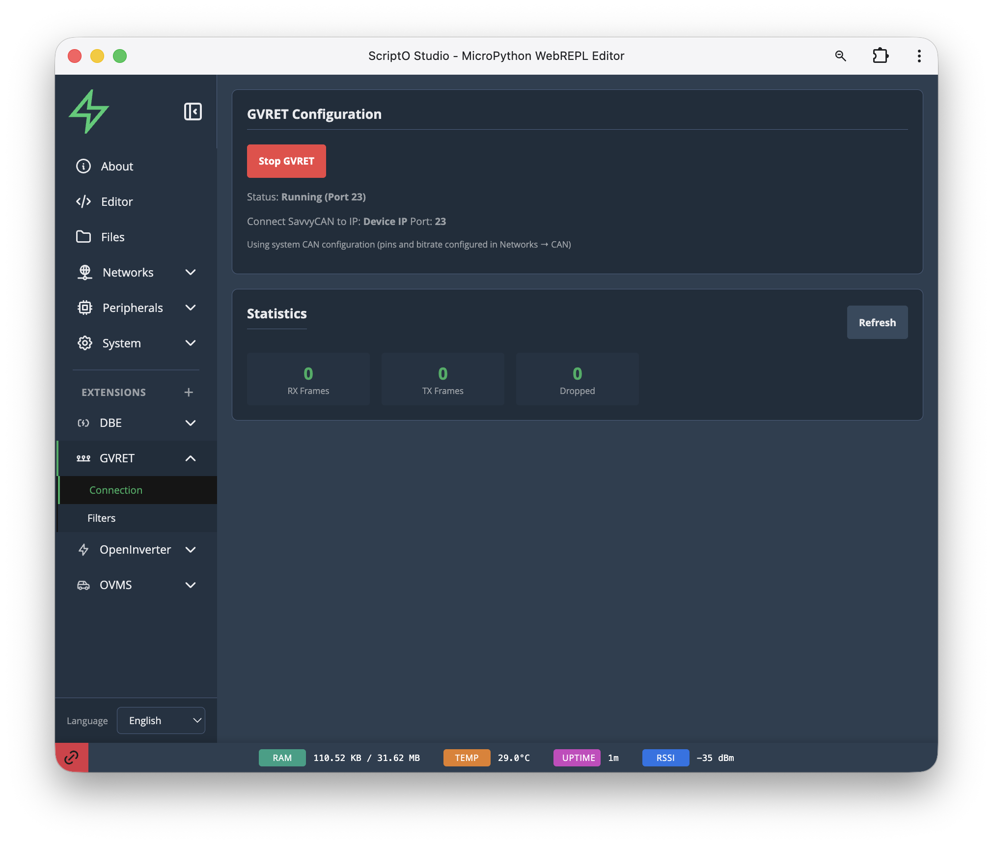

OpenInverter Web Interface becomes just another app loaded at run-time by a PWA that communicates with the 'App Processor' over wss:// ( I also created a new IANA websocket subprotocol to make this work efficiently ). The 'App' includes the device side Python code that communicates with OpenInverter devices over CAN (only) eg Zombieverter, Foccci etc., which is automatically installed on the device when the user installs the app.
eg
GVRET
GVRET
OVMS
OVMS
etc

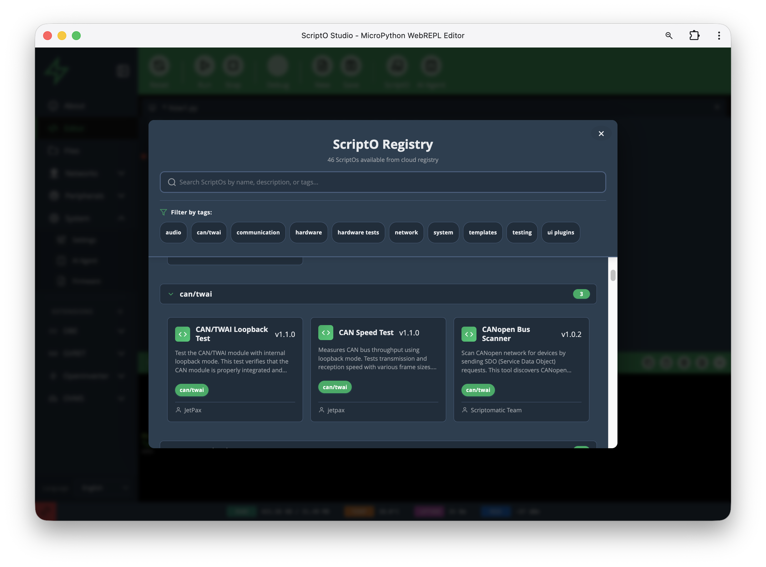

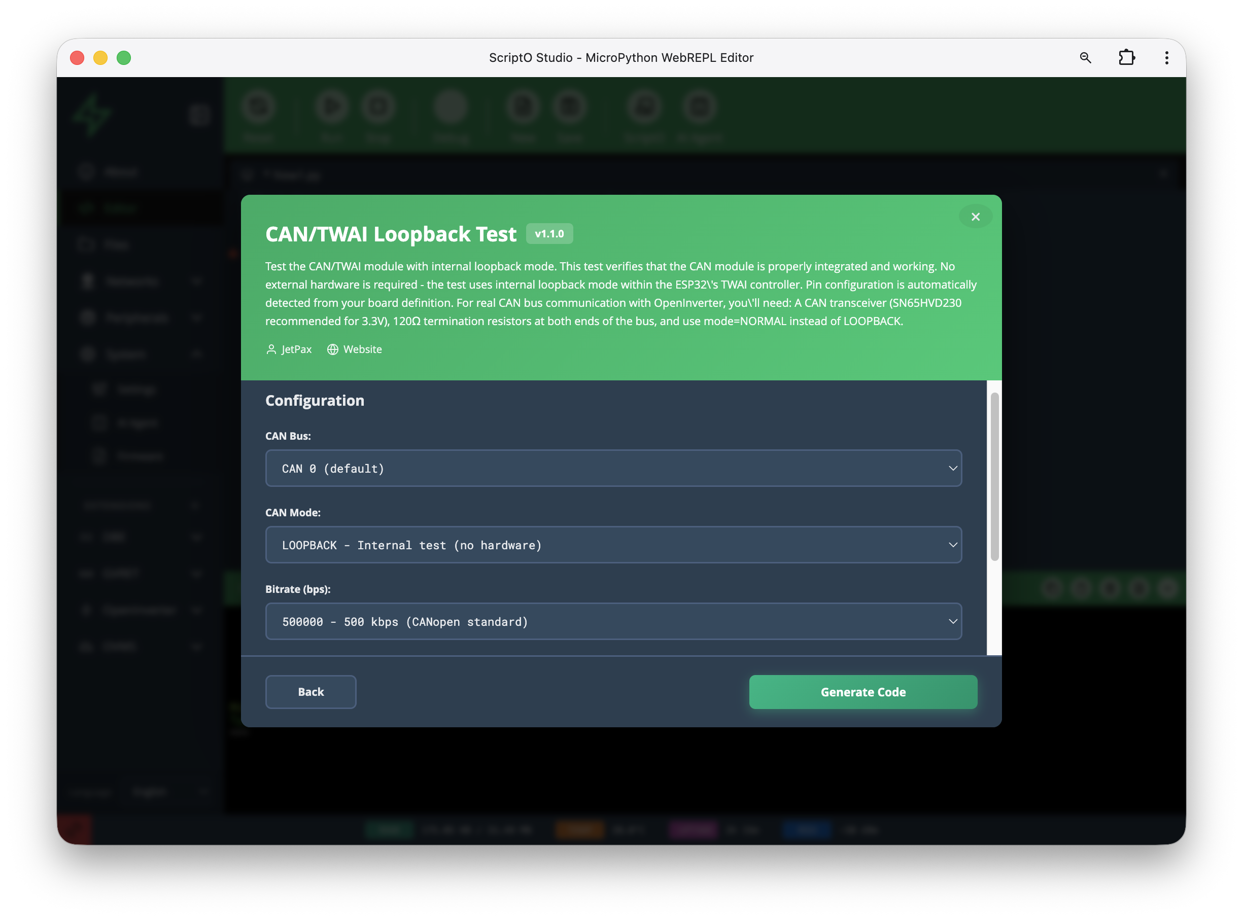

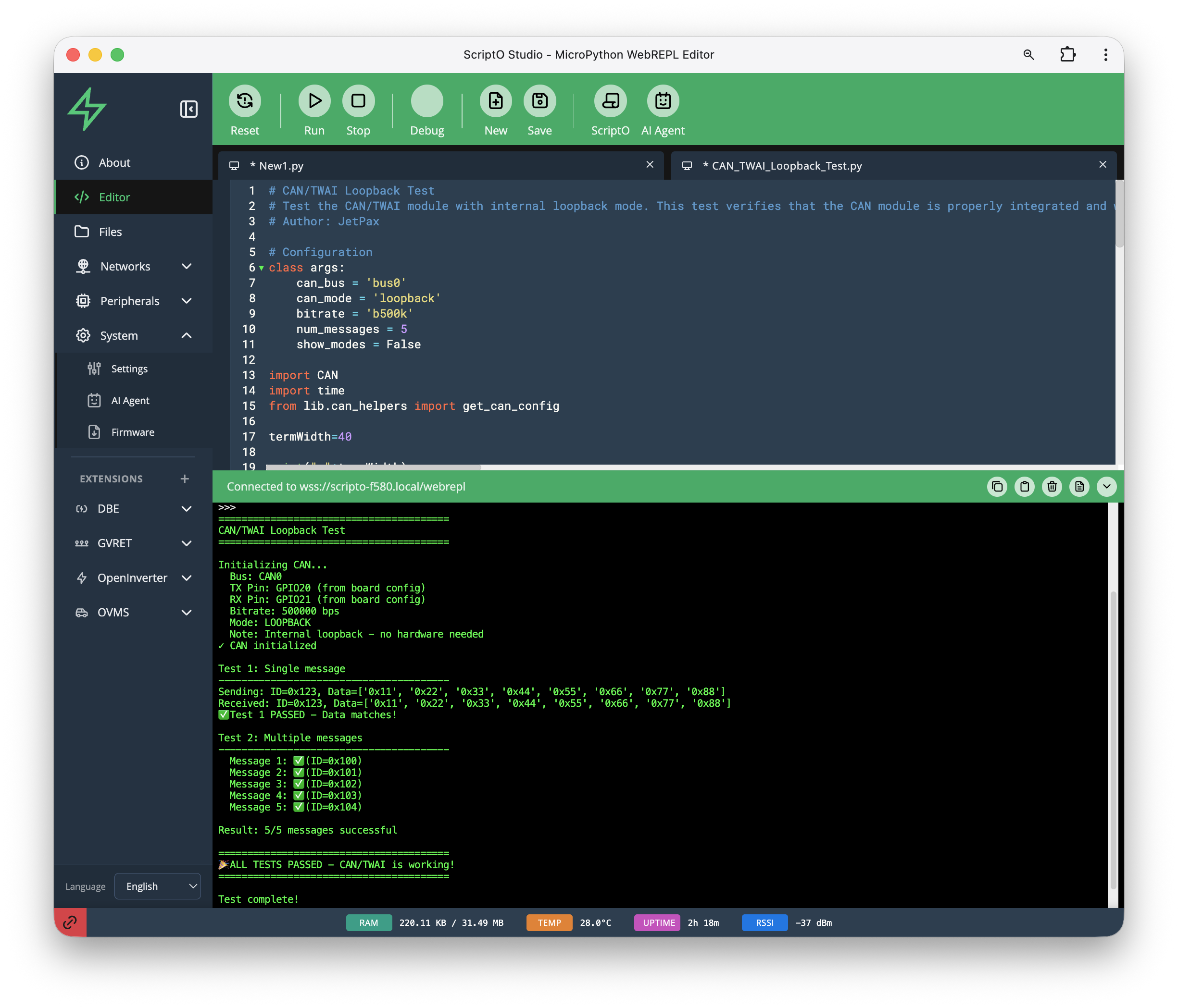

Also, once an app is loaded , users can add prewritten device scripts to make the app fit their particular application, using ScriptObjects for which I've created a registry. (The key idea here was borrowed from jczic's ESP32-MPY-Jama, although it is a completely different code base).
ScriptOs
ScriptOs
CAN Scripto Load
CAN Scripto Load
CAN Test ScriptO Run

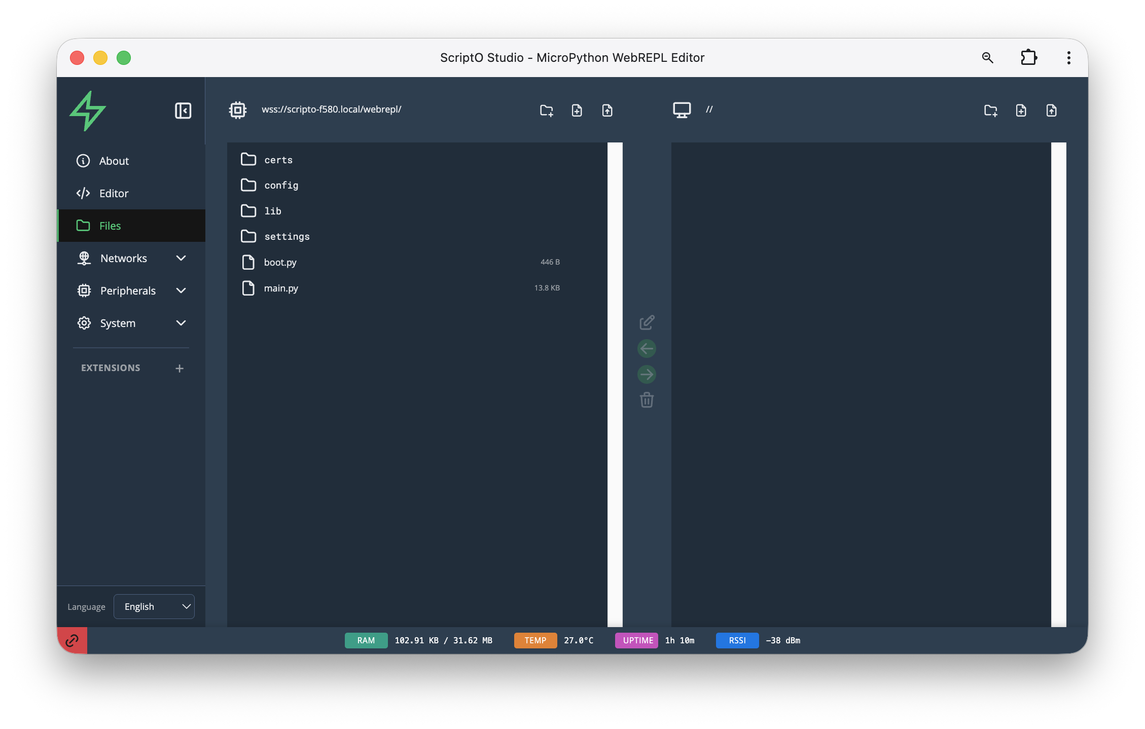

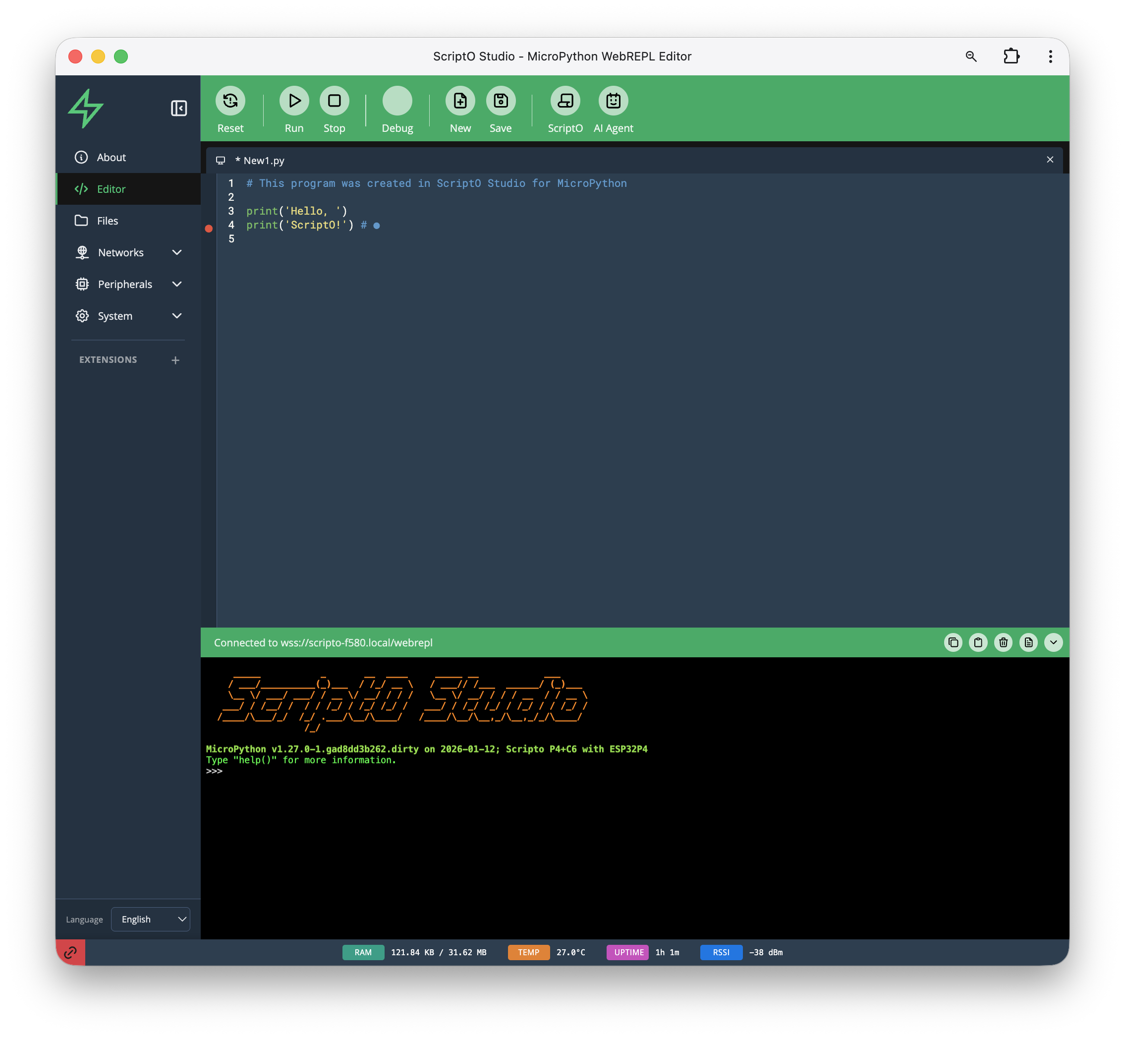

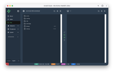

And finally, users can change that functionality using scripts, as the system has a built in editor/debugger and file manager.
File Manager
File Manager
Editor
Editor

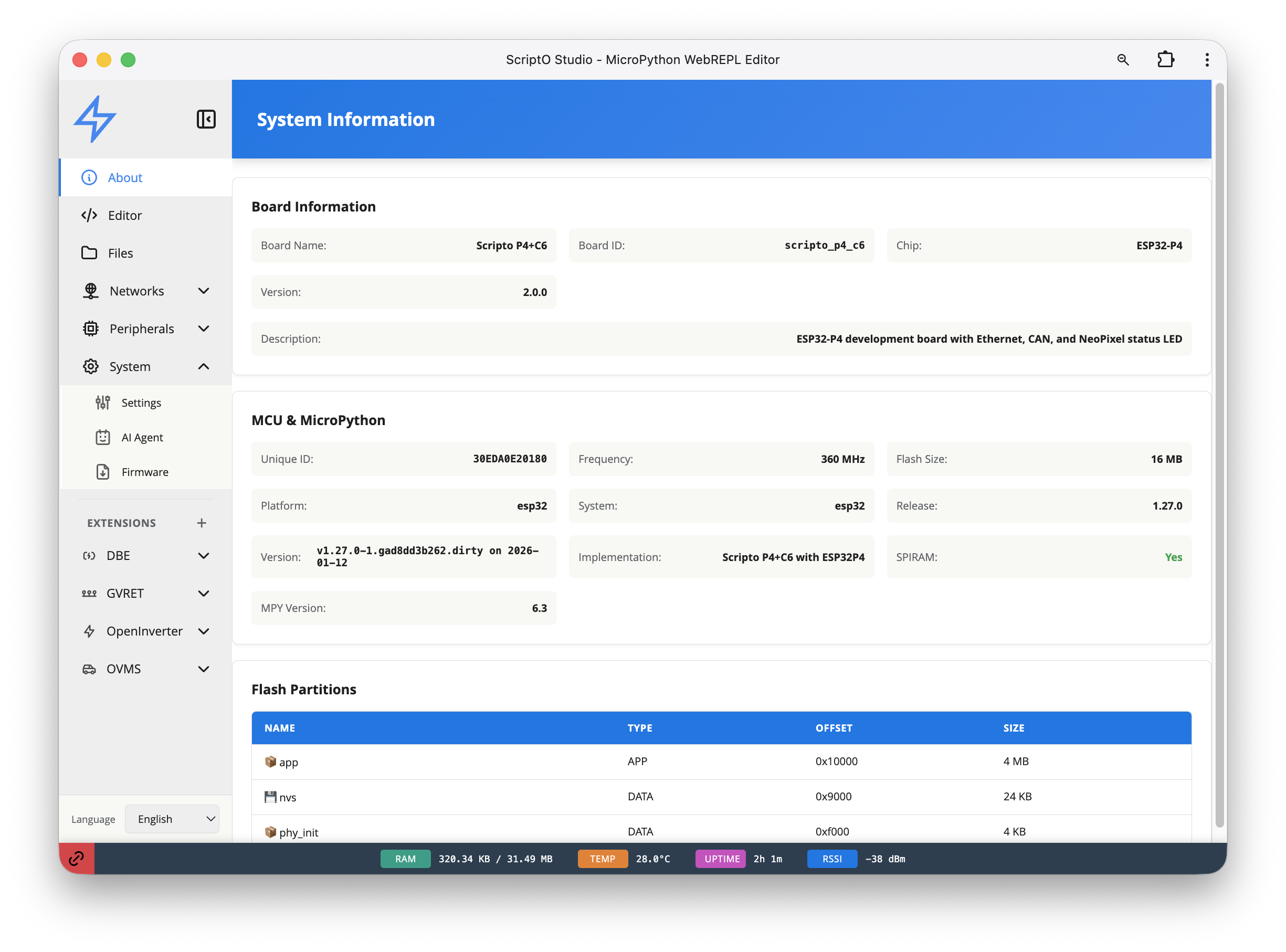

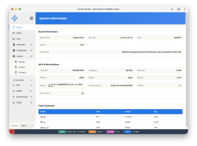

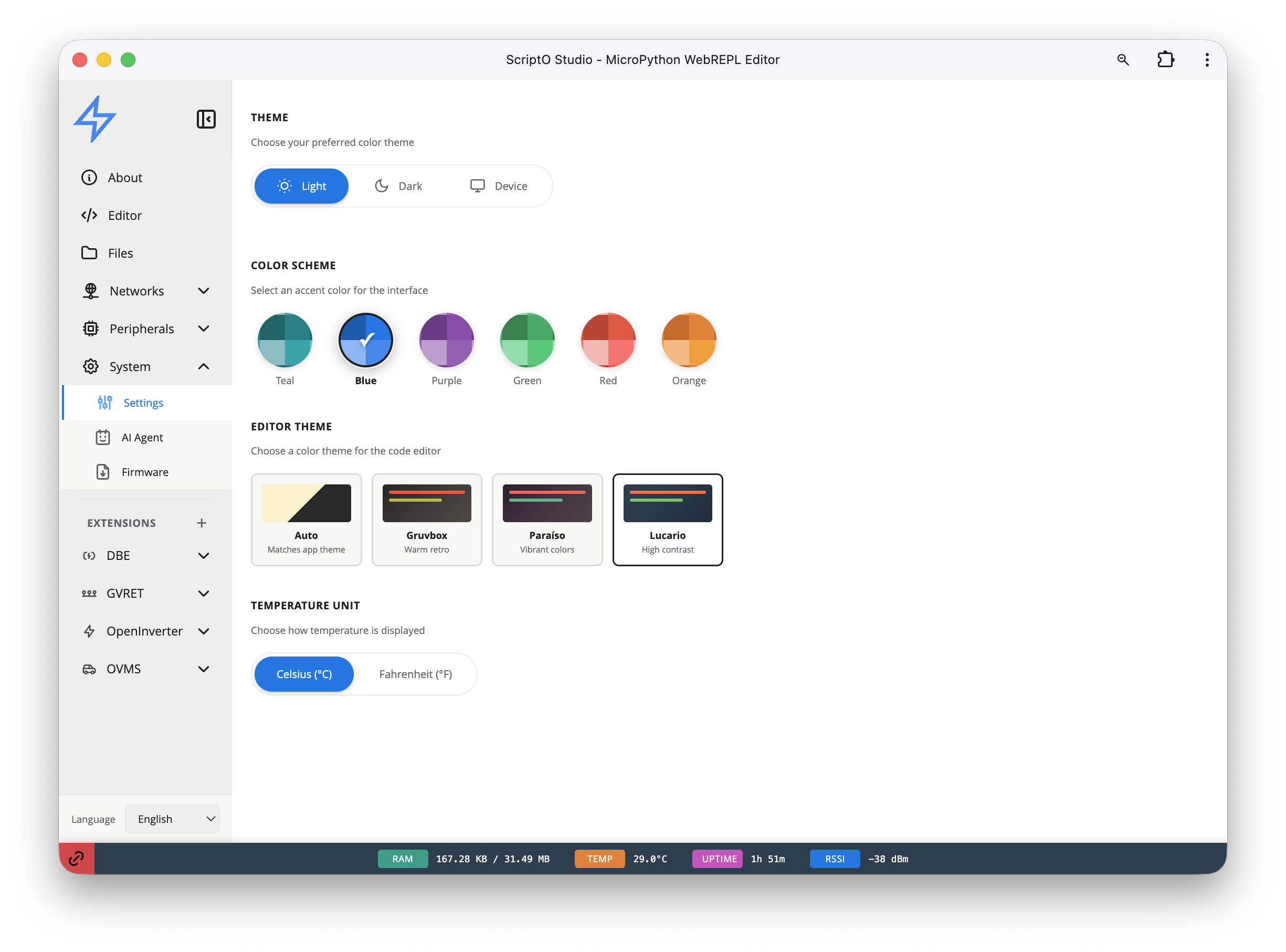

And if you don't like the colors
Theming
Theming
About
About

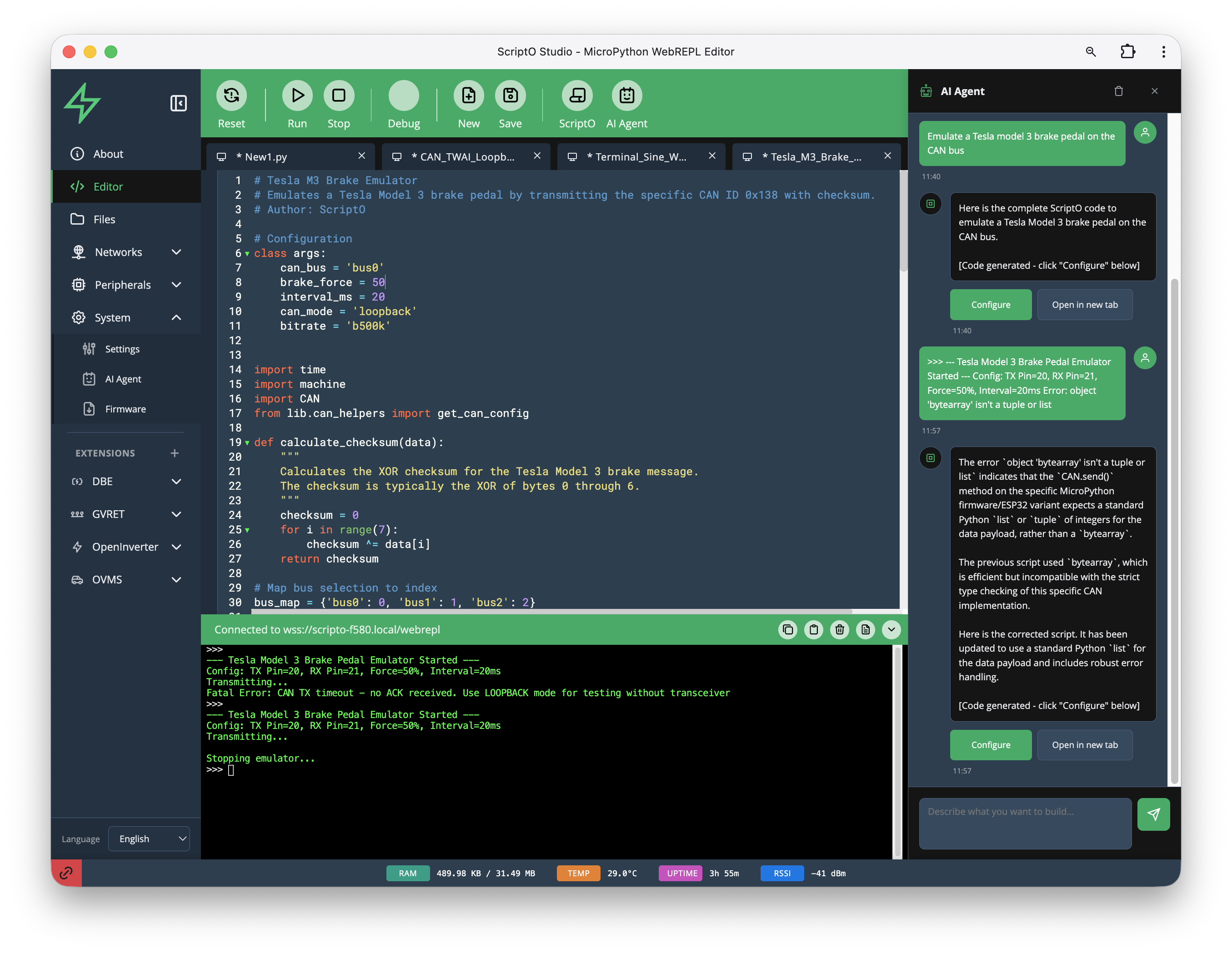

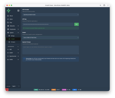

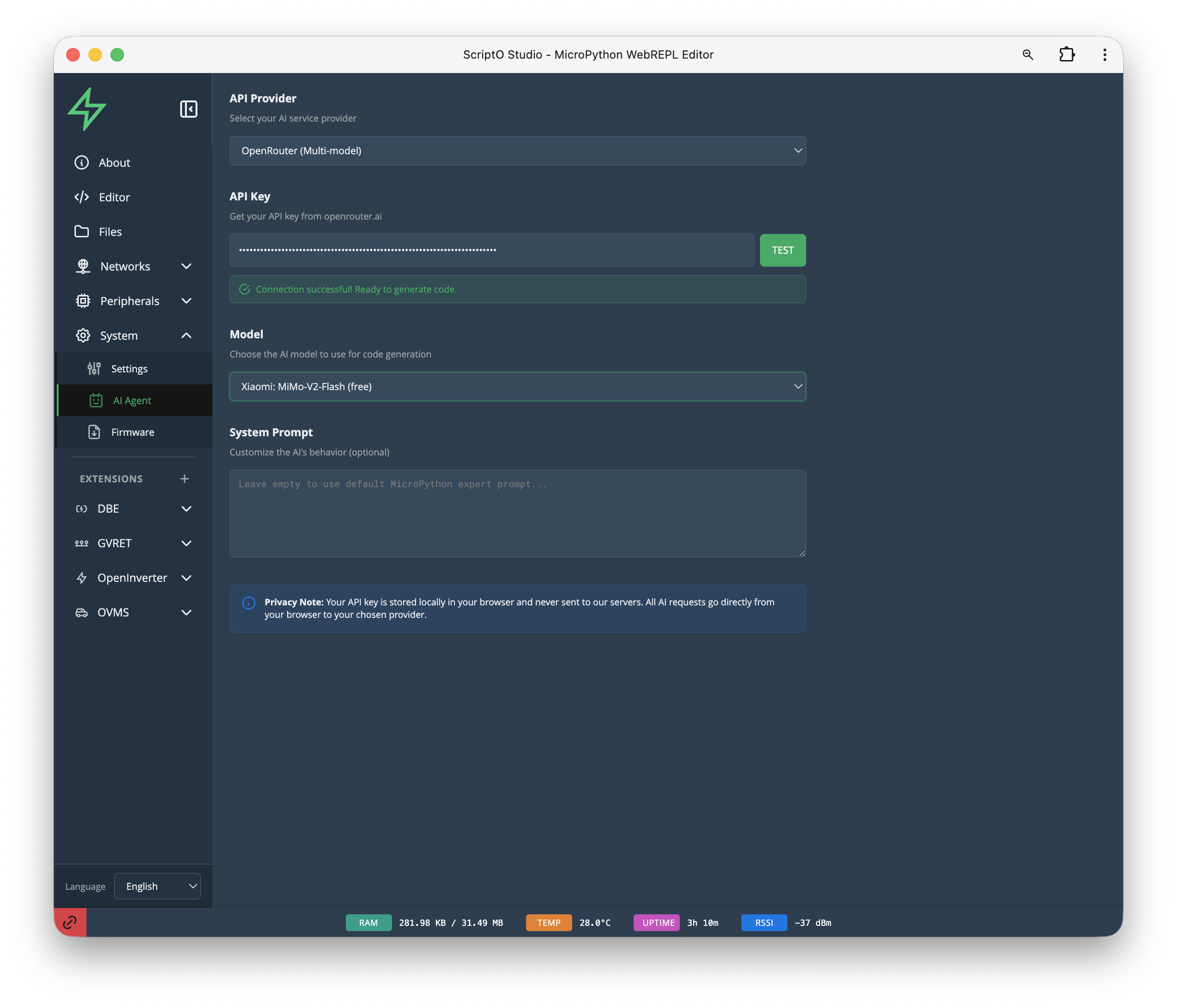

And one last thing, there's an integrated AI Assistant that can write the Scripts for you
Agent Setup
Agent Setup

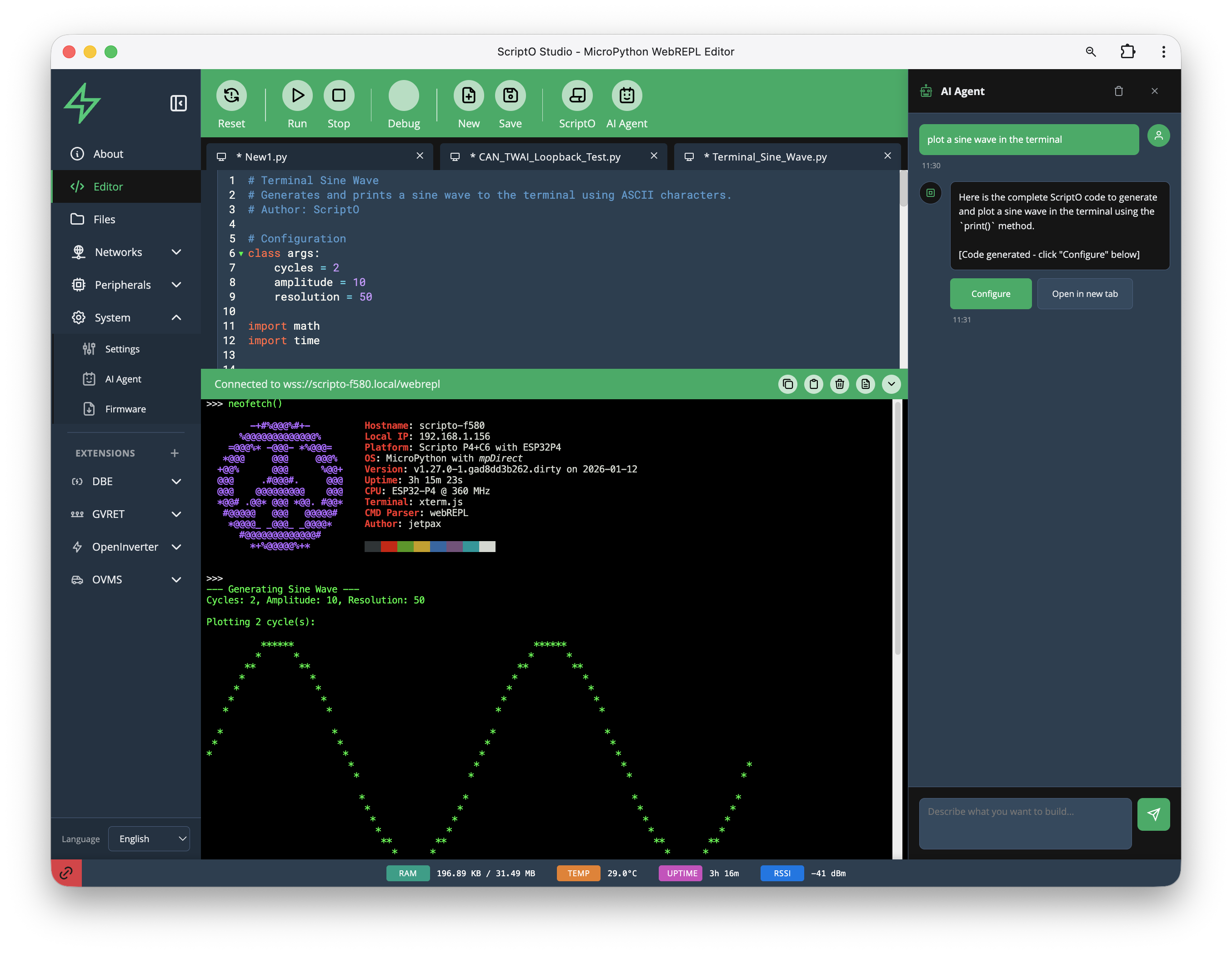

Agent code Test
Agent code Test
And of course its smart enough to know the CAN ID for a Tesla Model 3 brake, so you don't have to look all that up
Agent code Tesla
Agent code Tesla
