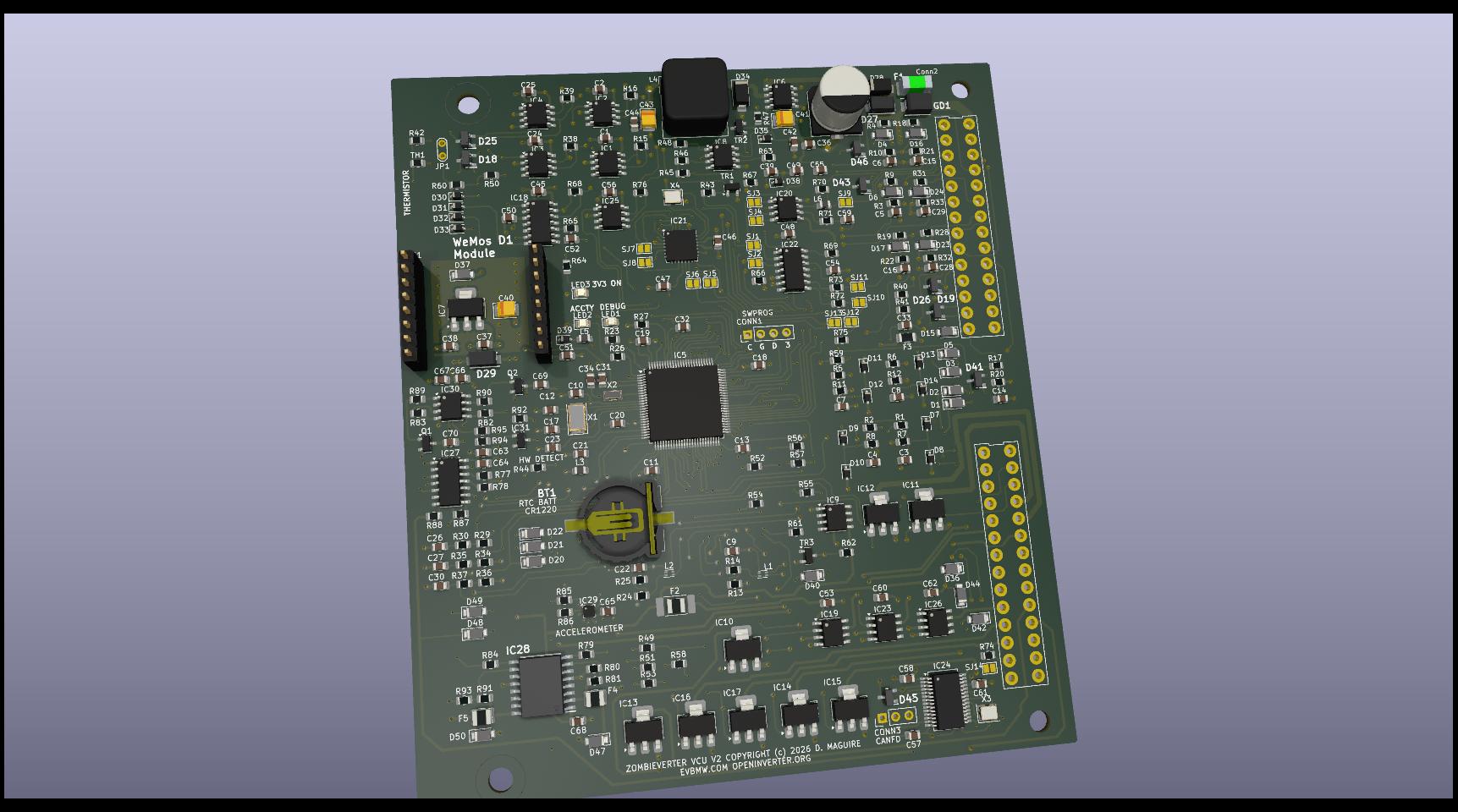

So after a long time here is the next hardware revision for the ZombieVerter VCU. Now before anyone gets too excited I want to make one point crystal clear : The existing hardware is NOT deprecated and will continue to be able to avail of future software releases that do not employ the added features of V1.2. If anyone needs this further clarified please let me know.
With the exception of the RS232 option V1.2 is fully pin compatible with existing hardware.
There will be no price changes.
Once verified, design files will be available via Patreon and the webshop.
Extra features of V1.2 will be utilised in future sw releases but as of now it will behave as V1.1 on current release software.
Prototypes will be ordered in the next few days and of course a boring and long video will be made explaining all.

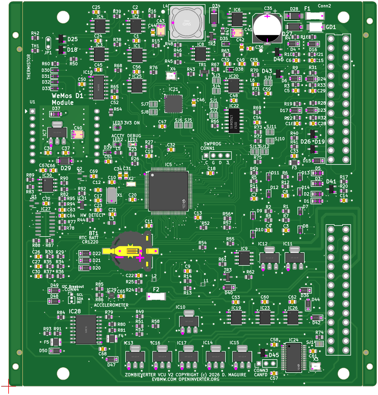

ZombieVerter VCU V1.2 Hardware Changes
- Sleep mode. Main 5V supply can be shutdown by the STM32.
- Wake via T15 , HVReq or CAN1
- All IO now have TVS protection.
- Main 12V supply also has a Gas Discharge arrestor.
- Supply outputs poly fuse protected.
- CAN1 Transciever changes to a TJA1043T to enable wake on can capability.
- DigiPots changed to a constant current driver that emulates a resistance range of approx 50 to 400 Ohms to ground. Inteded to drive analog fuel, temp gauges etc by emulating a resistance based sender.
- DAC amplifier changed to a TCA0372 witha gain of 4x providing approx 0-12V DC outputs at up to 1A per channel.
- Onboard KXTJ3-1057 three axis accelerometer.
- Onboard NTC temperature sensor.
- CAN-FD based on MCP251863T. Now 4 CAN channels.
- Real time clock with CR1220 backup battery. Runs in sleep mode.
- ESD protection on all CAN and LIN channels.
- Extra green LED for debug.
- Hardware detection resistor to enable firmware to detect V1.1 or V1.2 hardware.
- Now using Kicad 9 EDA.
- Switch to 6 layer PCB. 3V3 now on own layer.
- Only removal is RS232 from V1.1

Damien, I've been studying your schematic and I'm a little confused about the CAN1_WAKE_OUT signal. Probably I'm just confused but I'm not sure this will work the way you have IC18 wired. The TJA1043 spec and the AH1014 app note say that the INH output will have the following values in the two low-power states.
1. Standby Mode (EN=0, STBN=0) -> INH = High (VBAT)
2. Sleep Mode (EN=1, STBN=0) -> INH = Low (GND)
There are two things I wonder about.
1. INH stays high when the device is in the Active Mode (EN=1, STBN=1) so once powered, it will always keep your board alive.
2. If #1 is fixed and the 3.3V can go away then wouldn't the TJA1043 enter Standby mode instead of Sleep mode and still hold INH high?
Also in my general noob understanding of CAN and reading a note about ISO 11898-2 wakeup it takes two CAN bus packets to wake this transceiver up? I'm interested in waking up a system based on the 0x679 packet sent by the Leaf OBC when a charger is plugged in. Would this work for that?

From various reverse-engineered components not precisely sticking to standards I think you're better off on the Nissan Forum (https://openinverter.org/forum/viewforum.php?f=4) for this bit - as this thread is on the updated hardware.danjulio wrote: ↑Fri Feb 13, 2026 5:06 am Also in my general noob understanding of CAN and reading a note about ISO 11898-2 wakeup it takes two CAN bus packets to wake this transceiver up? I'm interested in waking up a system based on the 0x679 packet sent by the Leaf OBC when a charger is plugged in. Would this work for that?

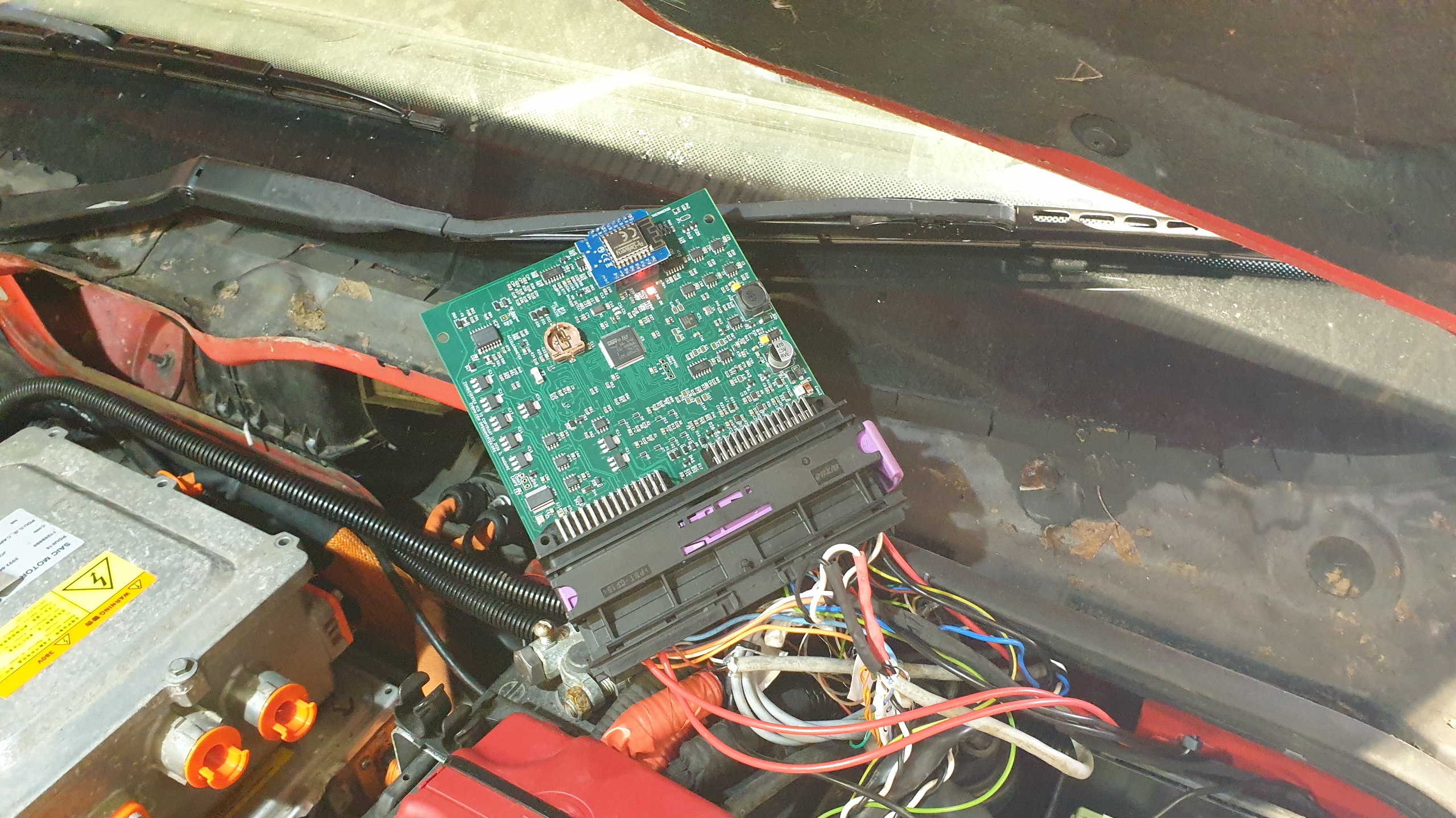

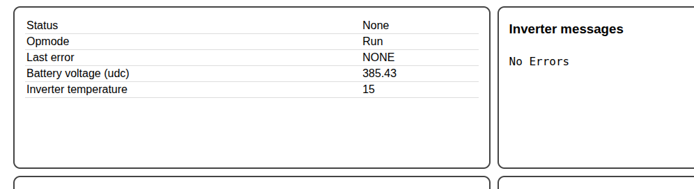

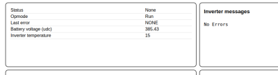

Prototype V1.2 boards arrived. Initial tests in the Red Arrow are looking good. Core functions working as well as basic wakeup. More testing to follow.

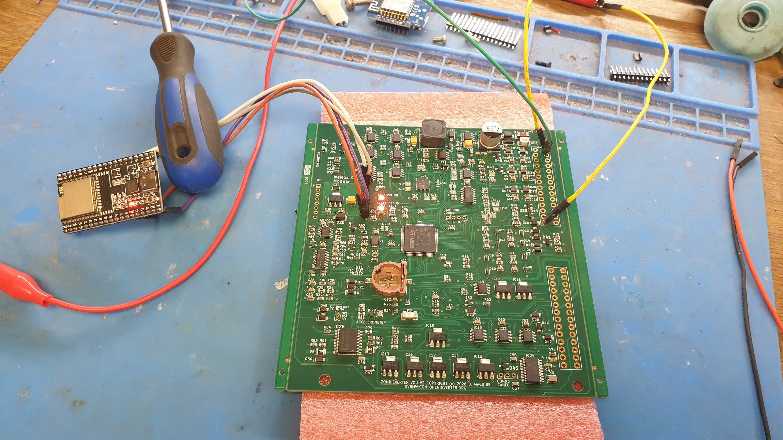

So just an update. Testing is going well. One problem is the ESP8266 wifi modules are proving no longer capable of dealing with the amount of data (JSON) going to an from zombie so an update to an ESP32 based module will be required.
Good news is there is a drop in ESP32 based version of the Wemos module I use : https://www.aliexpress.com/item/1005006026692511.html
Have some on the way and will test and then supply these with present and future orders.
Design files will be available once a few changes are made and tested so please be patient.
