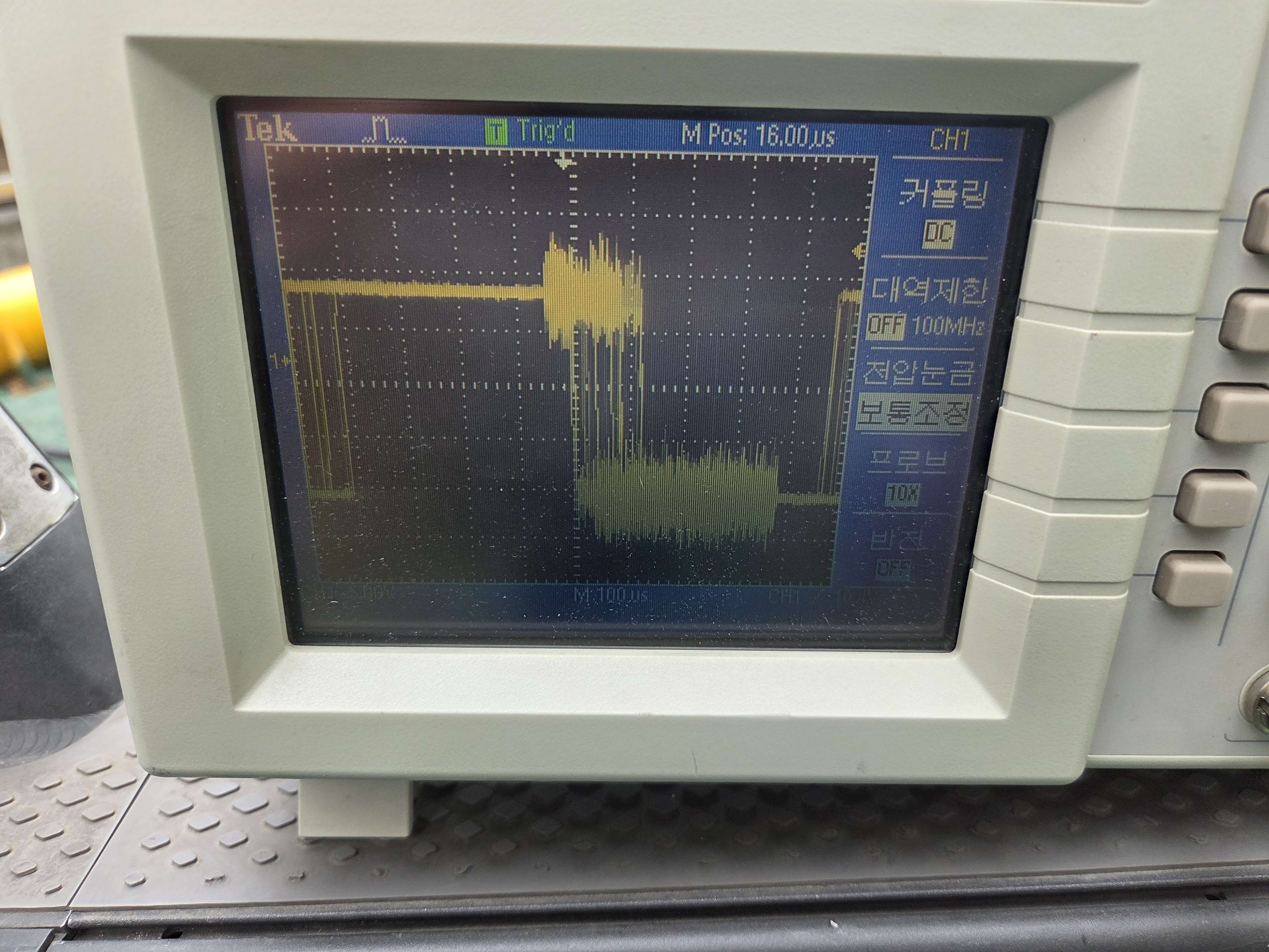

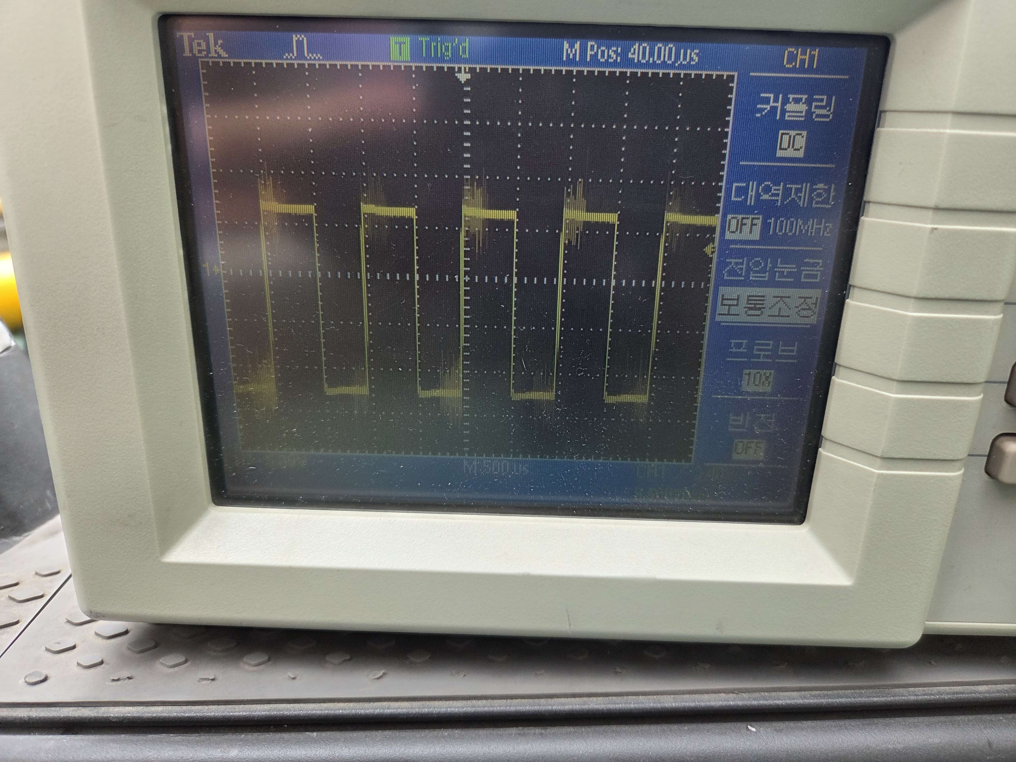

I have borrowed an osiloscope, and have tried quite some chargers(10 different brands), and i have managed to get all working.
I had to make a switch so i can switch the 1.3k resistance on and off the line.(many of them required it to go thru the states.)
Also, i have found a charger with PLC in it. So well, I guess it ain't forcing cars to require PLC comm to charge...yet

Re: Comm Required on some public slow chargers?
Does it apply 5% PWM together with the PLC? And does it fall back to higher PWM afterwards?
It always stays at 50%ish PWM and continues to stay like that with PLC.(Haven't got the foccci yet so no proper comm yet..)
- uhi22
- Posts: 1244
- Has thanked: 244 times
- Been thanked: 684 times
This looks like out of spec. For starting the high level communication with the car, the charger shall apply 5% PWM, and only then the car shall send the slac request. With 50% PWM the car shall use classic low level comm only.
