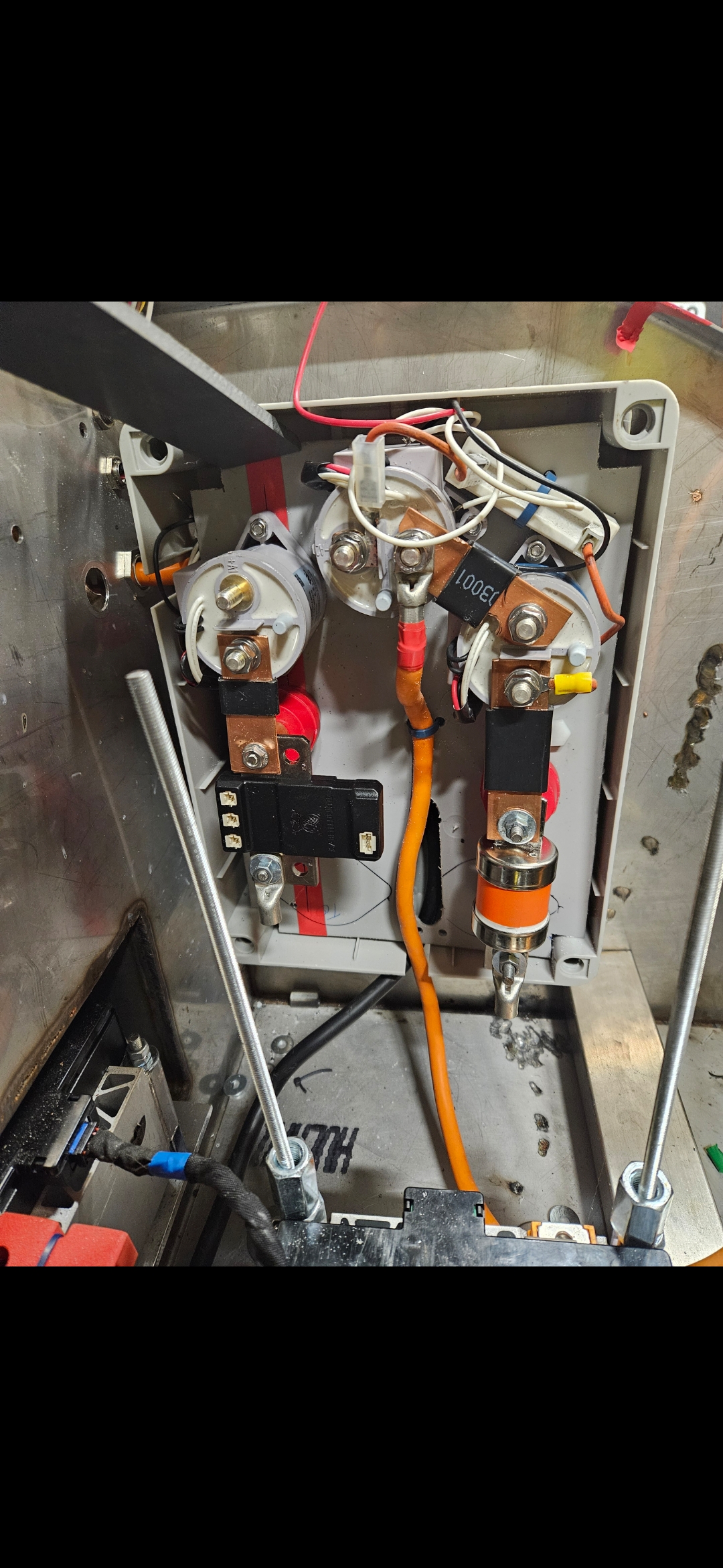

Progress is slow.
I have built the HV Junction box but I am still having issues with the pre charge circuit on my Zombie,
Does anyone know if its possible to command this LS output to activate a test to see if the precharge circuit is functioning
The shunt has been wired up since this photo was taken

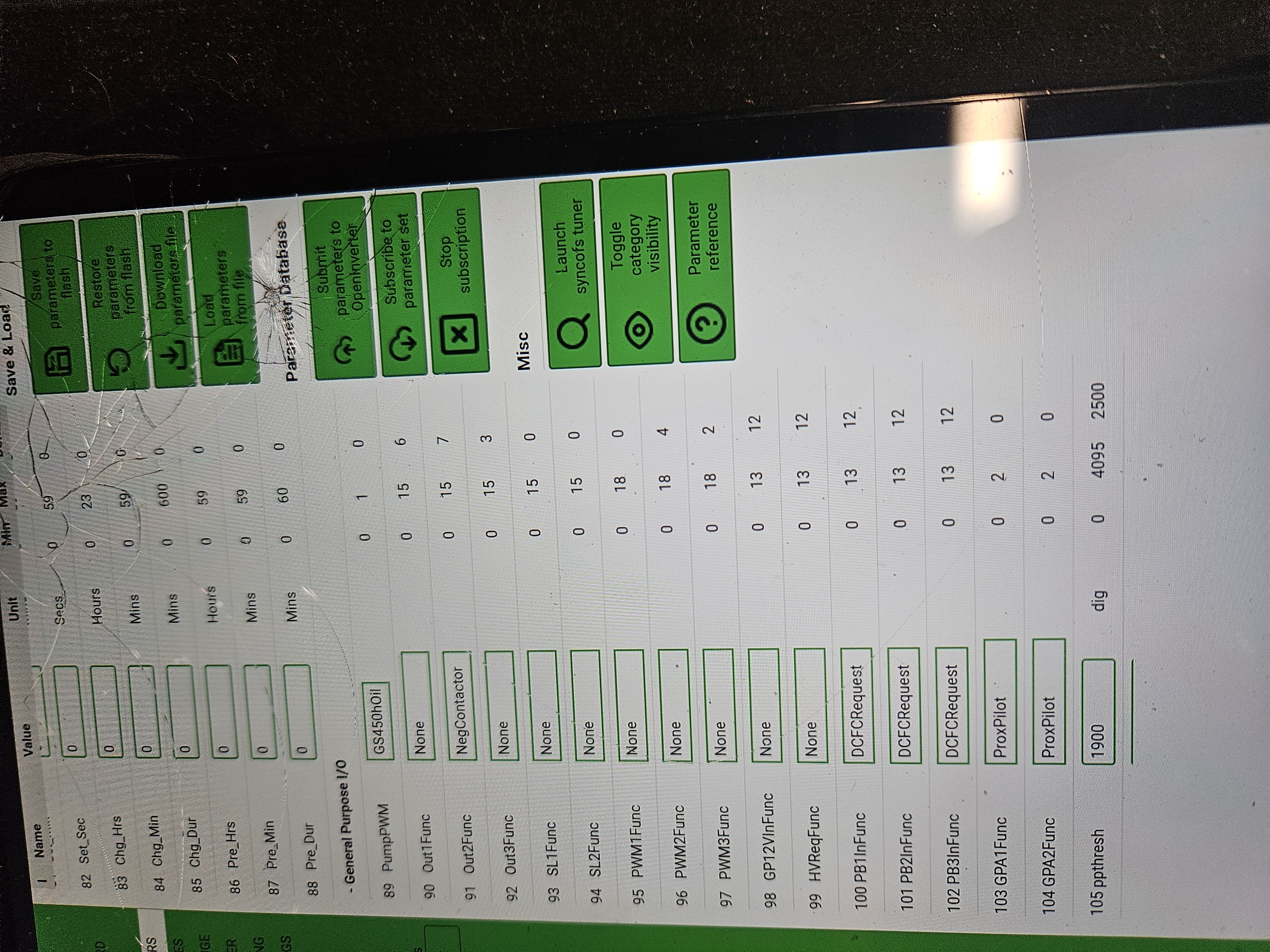

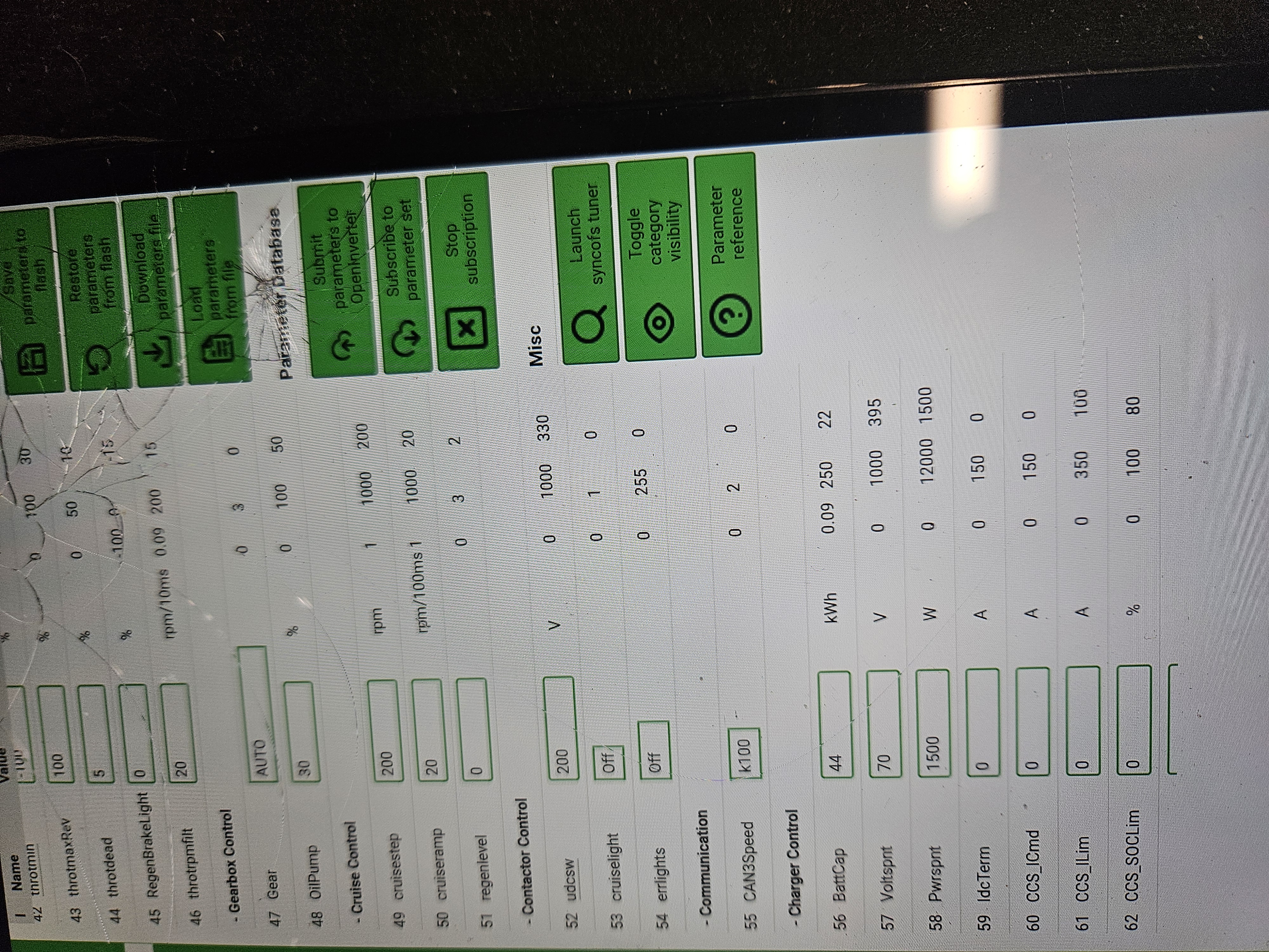

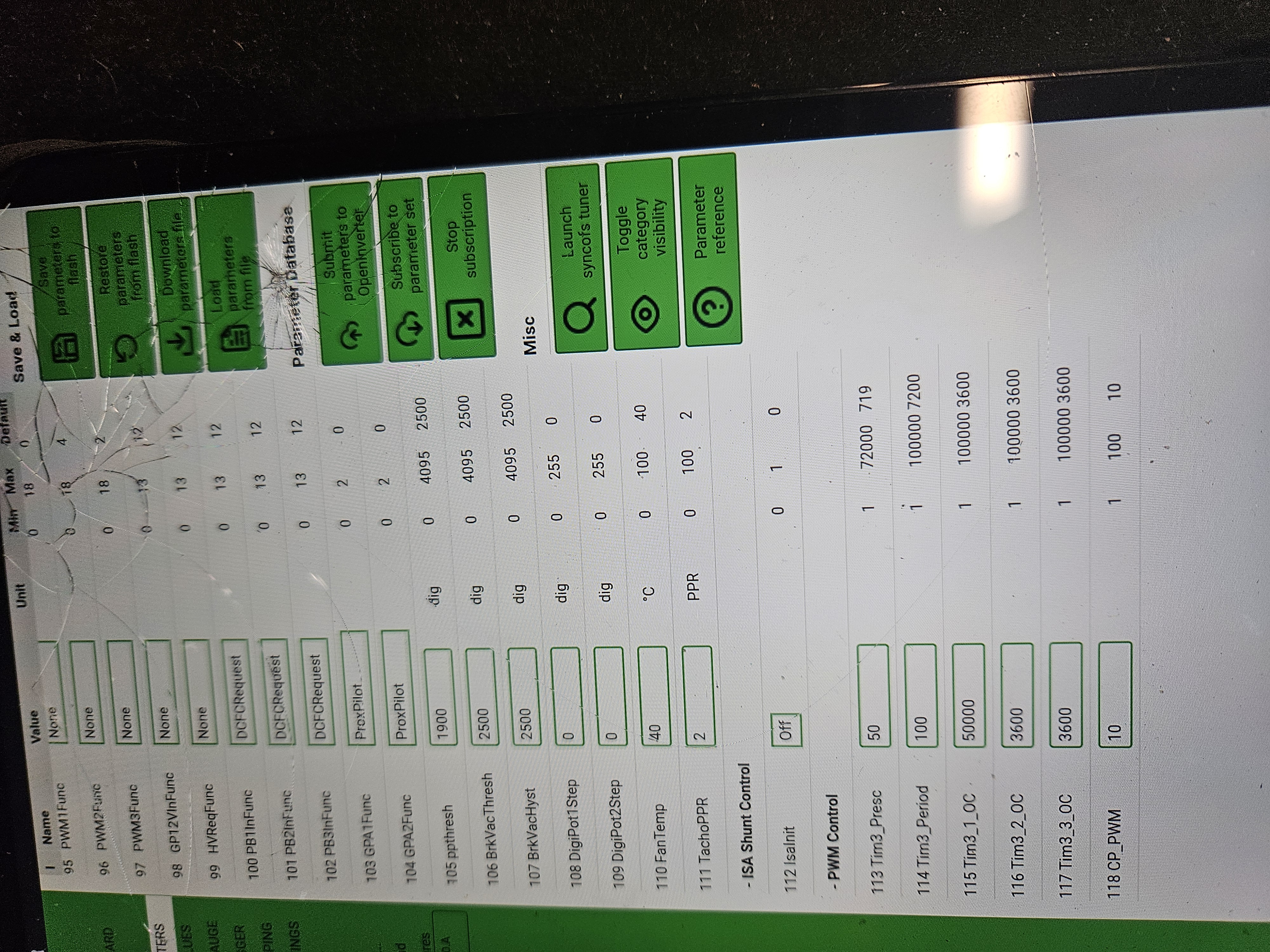

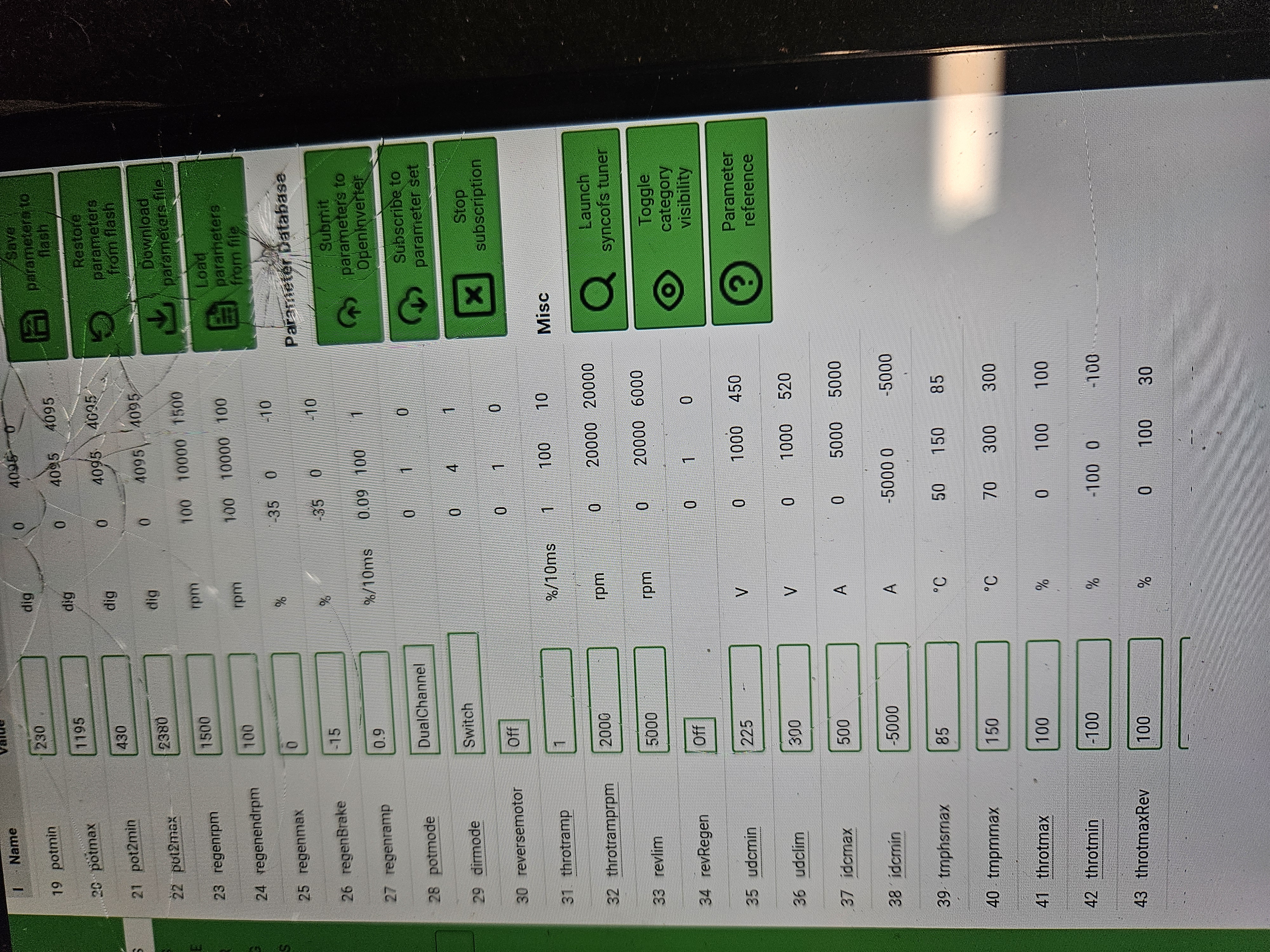

Re: [ WIP ]Bmw e39 + GS450h

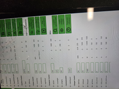

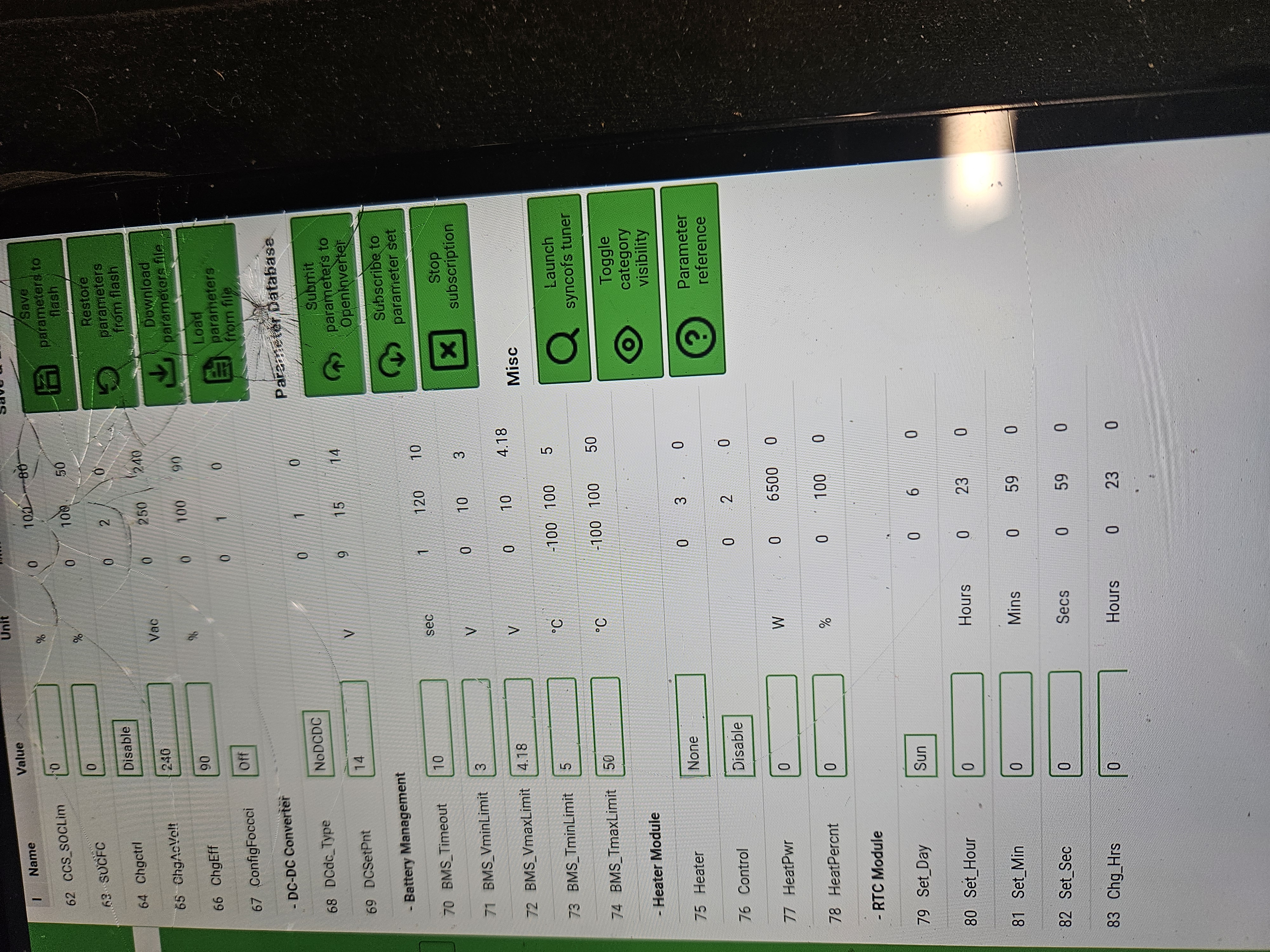

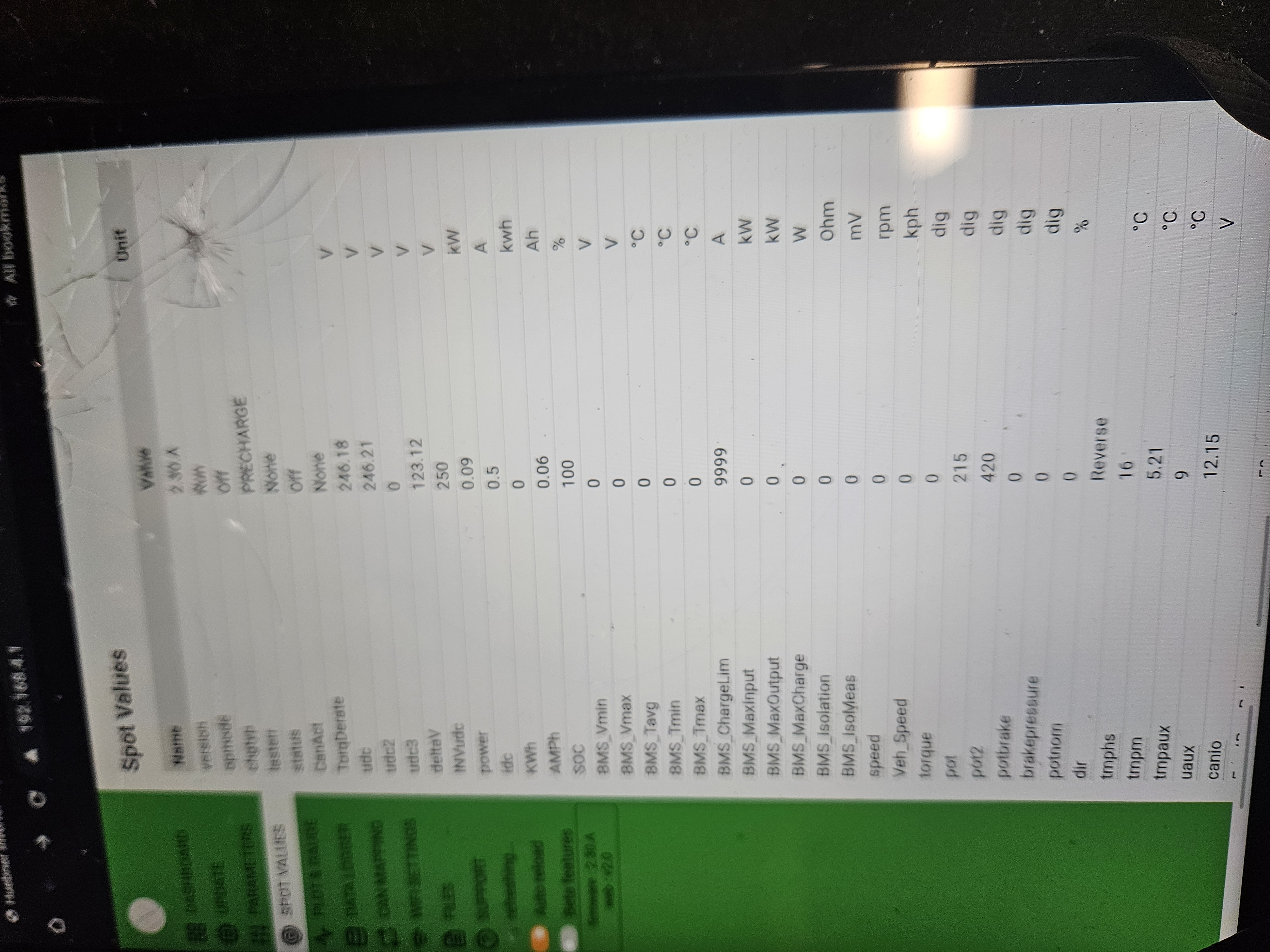

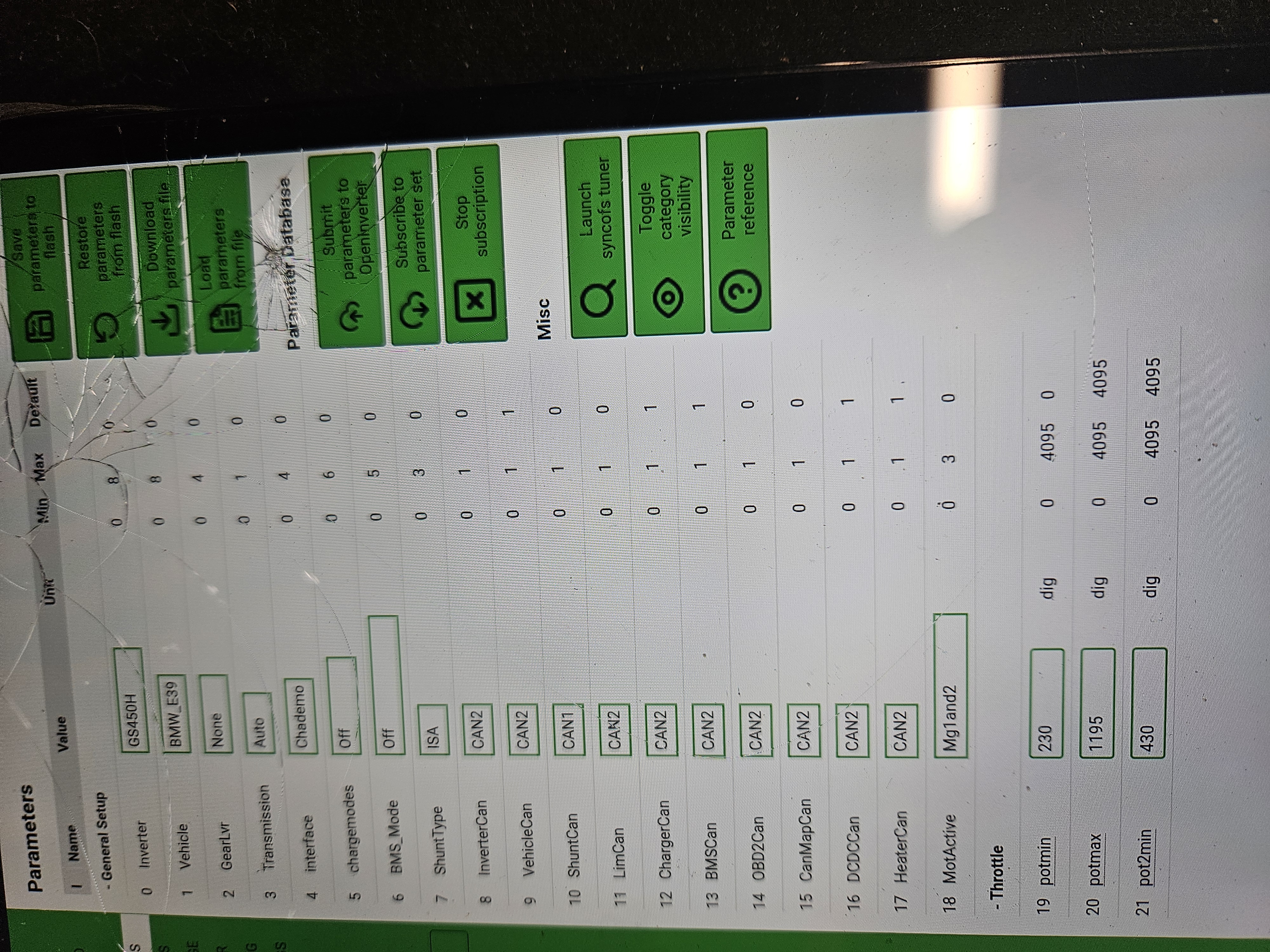

Spent today working on my HV Junction box with the ISA shunt.
The three contactors are working as required and ucd and ucd2 are reading 246volts from ten batteries , will add the remaining six batteries from the front battery box in the next week or so.
I seem to have an issue with the INVvdc value. It's at 50% of the udc most of the time.
When I power up the Zombie it's at 100% the same value as udc ,,,,, but when I spin the motor the value drops back down to 50%.
When i changed the inverter can from can1 to can2 the correct valve showed up on INVdcu,,,, but again when I spin the motor it drops back down to 50%.
The actual voltage measured with a multimeter never changes 100% 246v.
I have purchased a second inverter but the issue is the same with both inverters.
All advice/ Suggestions are very welcome.
Below I are my parameters and spot values.
Kevin
Kevin

InvUDC values are not to be trusted. I don't think it matters. Zombie uses ISA shunt as the source of truth. My inverter spits out garbage for InvUDC
- Posts: 1884
- Has thanked: 91 times
- Been thanked: 517 times
The invudc in the current release uses the wrong bytes.

Thanks Robertwa for your response. It's good to hear that other zombie/Gs450h users are having similar experiences.. Will try improved larger diameter standoffs (18mm) on the inverter but I will be surprised if it makes any difference
