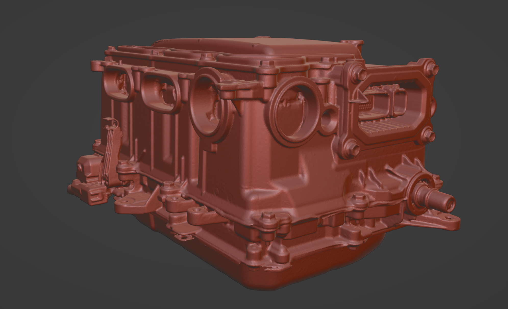

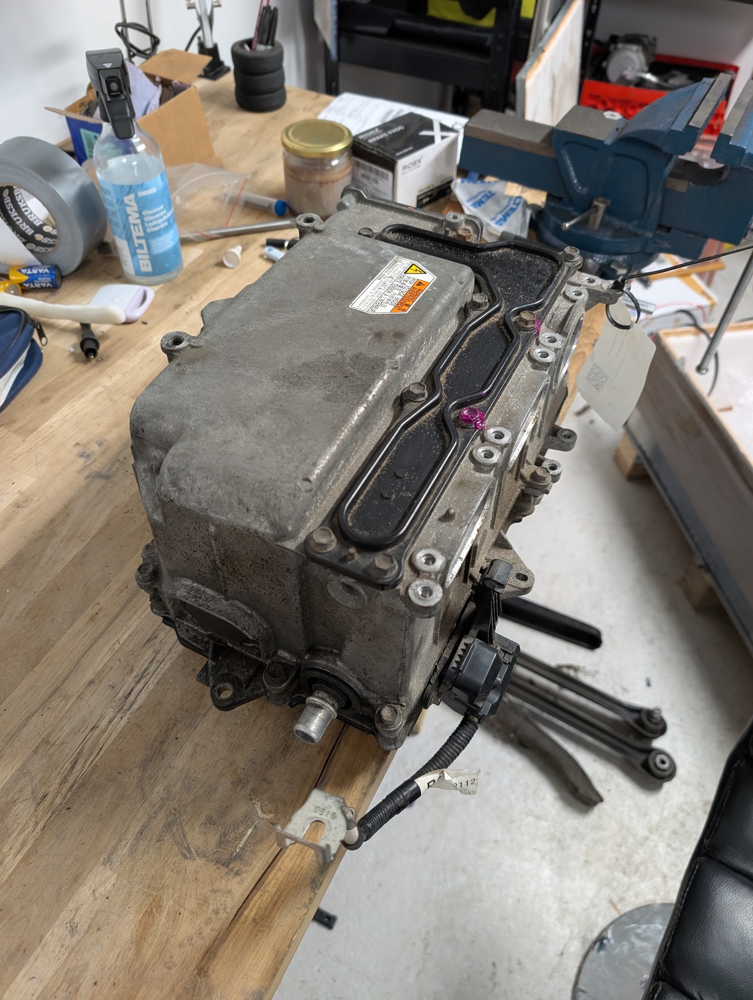

Built myself a working table and picked up some stuff for this project, got myself a Holset HX-35 Turbo, a laser scanner and a gen 3 prius gearbox. Will look into taking the MG1 out of the case and setting it up to run off a bike engine on the ICE input while keeping the MG2. Not entirely sure that's doable since the Prius engine spins at about half the rpm of a bike engine so might be more trouble than it's worth to try to redo the internal gearing etc. But there are limited slip diffs that fit the prius so if it does work it could work quite well. And it would be nice to skip the chaindrive.
I can try to do some half decent scans of the transmission case and throw up here in case people wants.
The electric supercharger/Turbo part isn't a critical part of the project, it'll work quite well with just a spicy bikemotor and a Prius MG2, but to me it's an interesting project. A bit of fun unnecessary complexity.
Prius gearbox cracked open
Playing with the scanner.

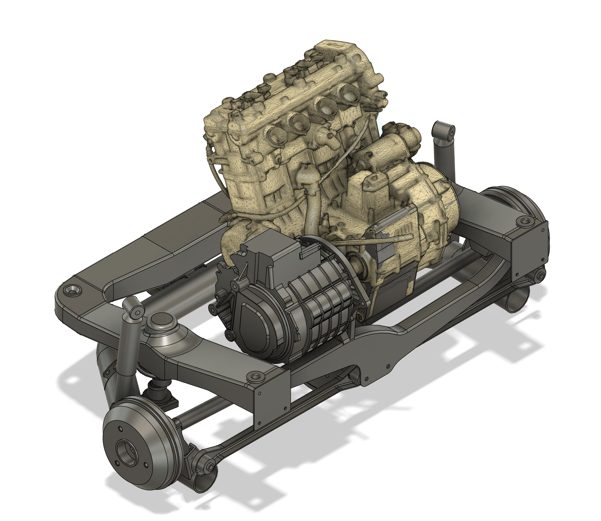

Picked up a Gen 1 Hayabusa, so that part is defined. Don't think I can fit the Hayabusa motor and the full Prius P410 gearbox in any reasonable way without designing a completely new suspension system.
So now I'm back to trying to find a good traction motor and compatible inverter, I'm quite fond of the Prius P410 MG1 motor for use in the turbo MGU-H project so ideally I'd find a good smallish traction motor I could run with the Gen 3 Prius inverter. I have a KIA HSG I could use but that seems a bit too small to add any meaningful torque.
Taking MG2 out of the case could work but that seems like a lot of work. Outlander motors are quite compact and nice sealed units so that would be an option but not sure how compatible they are with the Prius inverter.

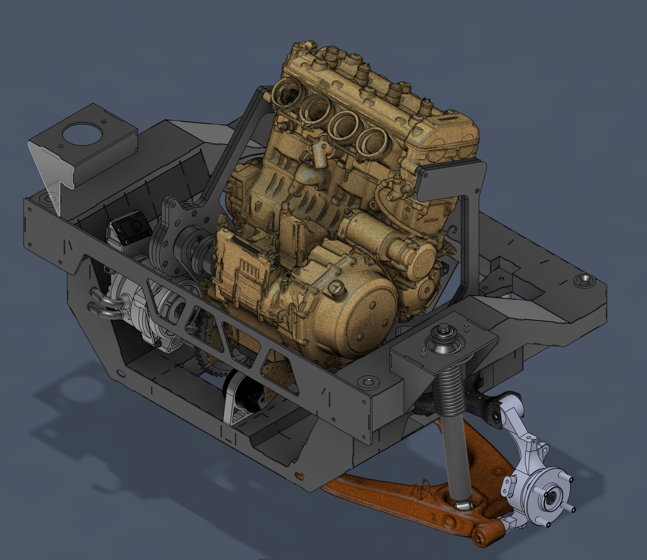

Somethings like that could work, decent amount of space for the inverter and turbo left. That's with the outlander rear motor, HSG is way smaller so could fit in the same config without issue. Would need to do a better scan of both the engine (this is crappy scan I found online) and the car to make sure. Batteries will have to go in the frunk or ideally under the seats.

That design is using Quaifes limited slip differential designed for motorcycle engine racecars.
https://www.demon-tweeks.com/se/quaife- ... q-eqdf7zr/
Hopefully I can integrate the tractionmotor well enough that it'll compensate both for the lack of reverse and the low torque of motorcycle motors at low rpm to make the car more drivable in traffic.

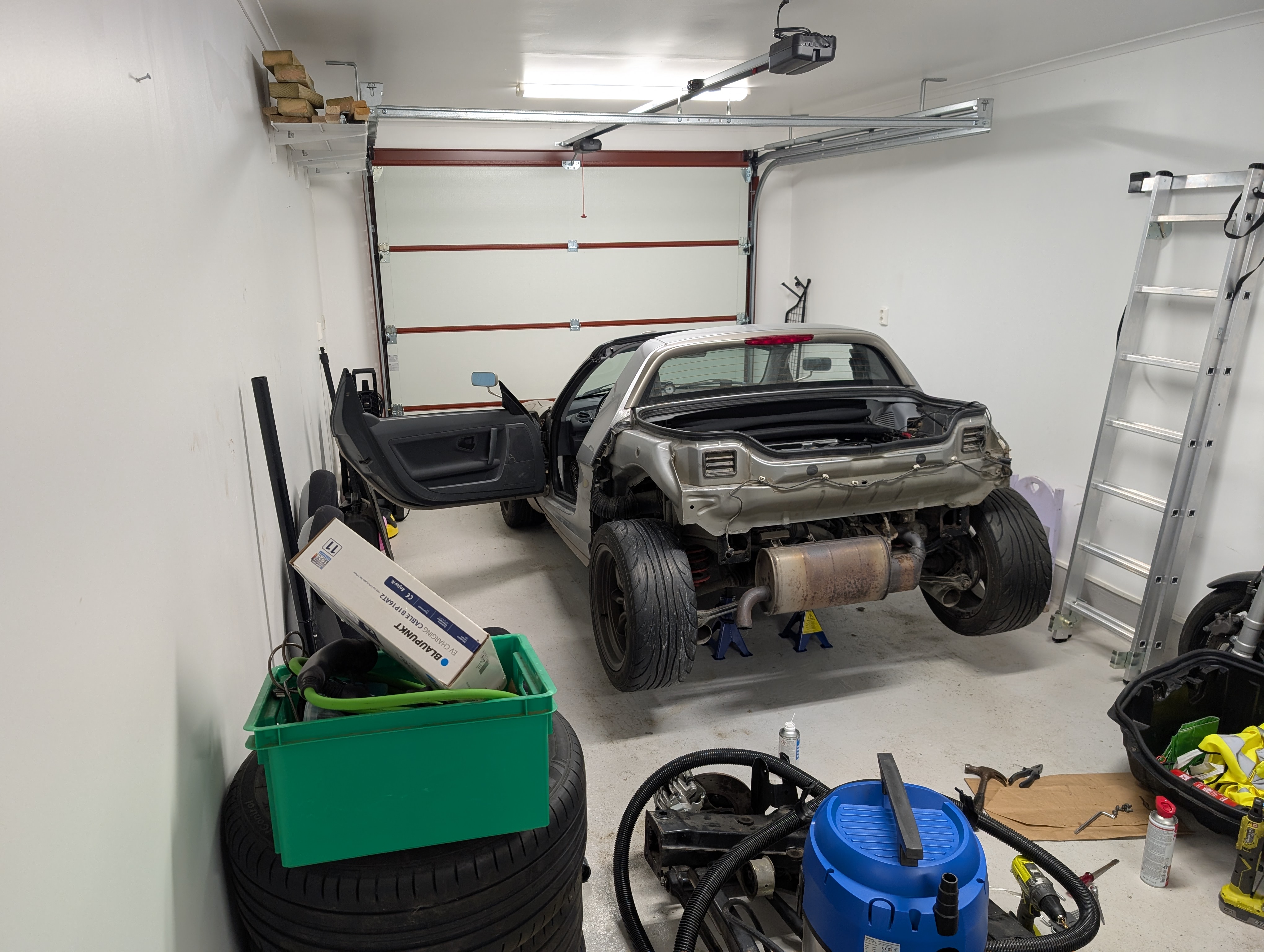

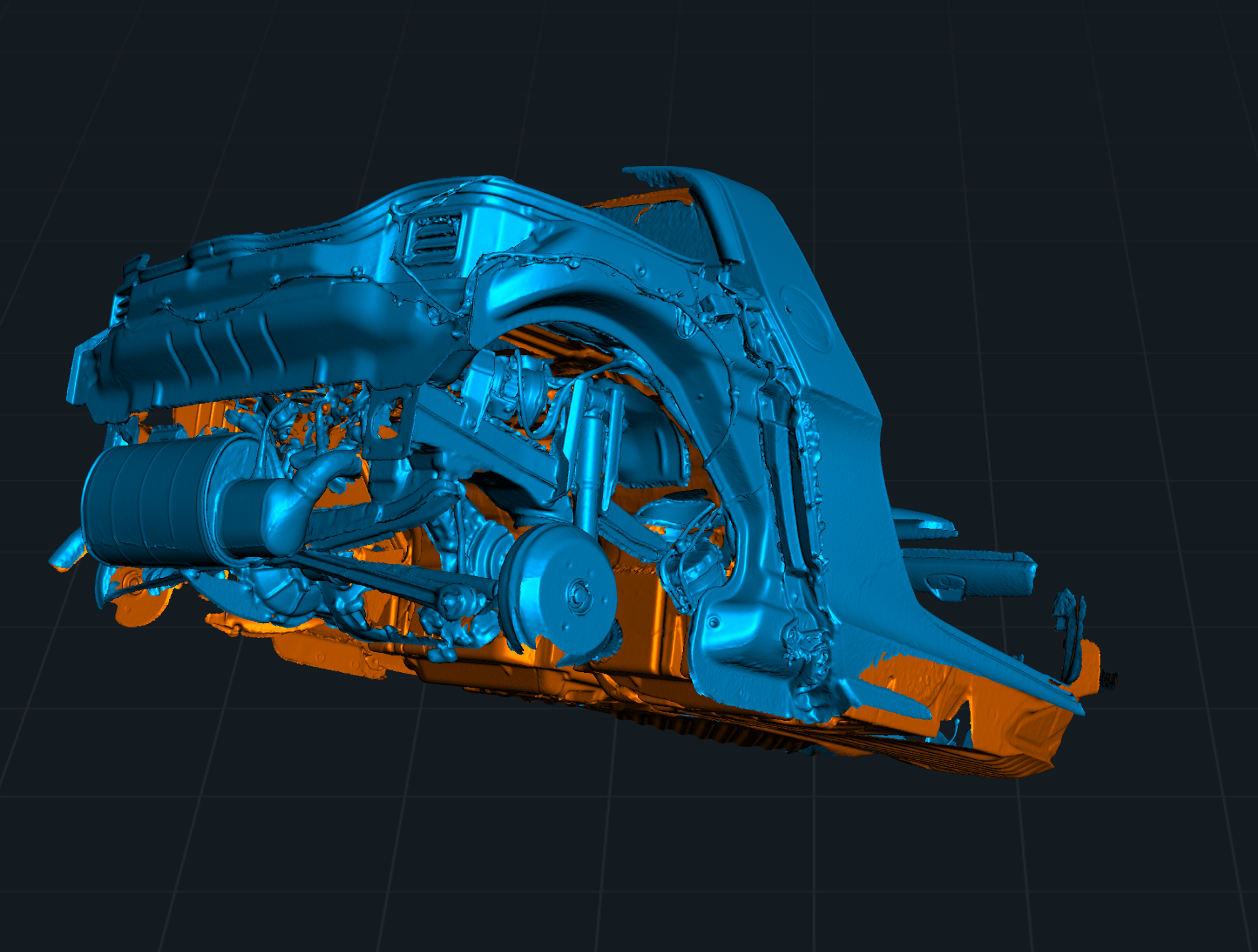

Got the engine out of the bike and started taking the car apart for more scanning. Leaning towards trying to run with the Kia HSG to start off with, if I manage to let the magic smoke out of it I'll pick up a beefier motor.
Car on sketchy stands without the rear bumper.
Hayabusa engine out of the bike, it looks way bigger now than it did in the bike.
Scans using the Creality otter with the wireless attachment and a phone, still need to get myself a garage computer to do proper scan work in there. It seems a lot worse than using it plugged in to a PC but at least it gives workable results.

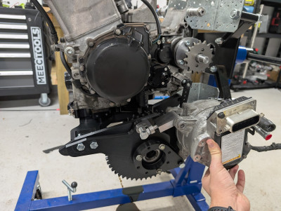

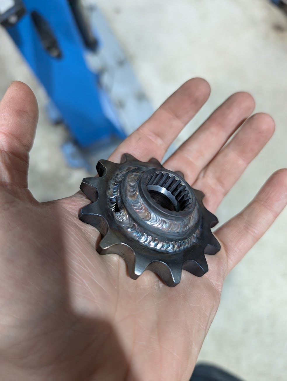

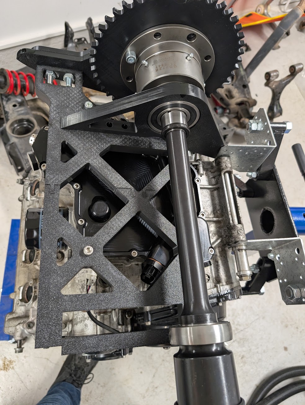

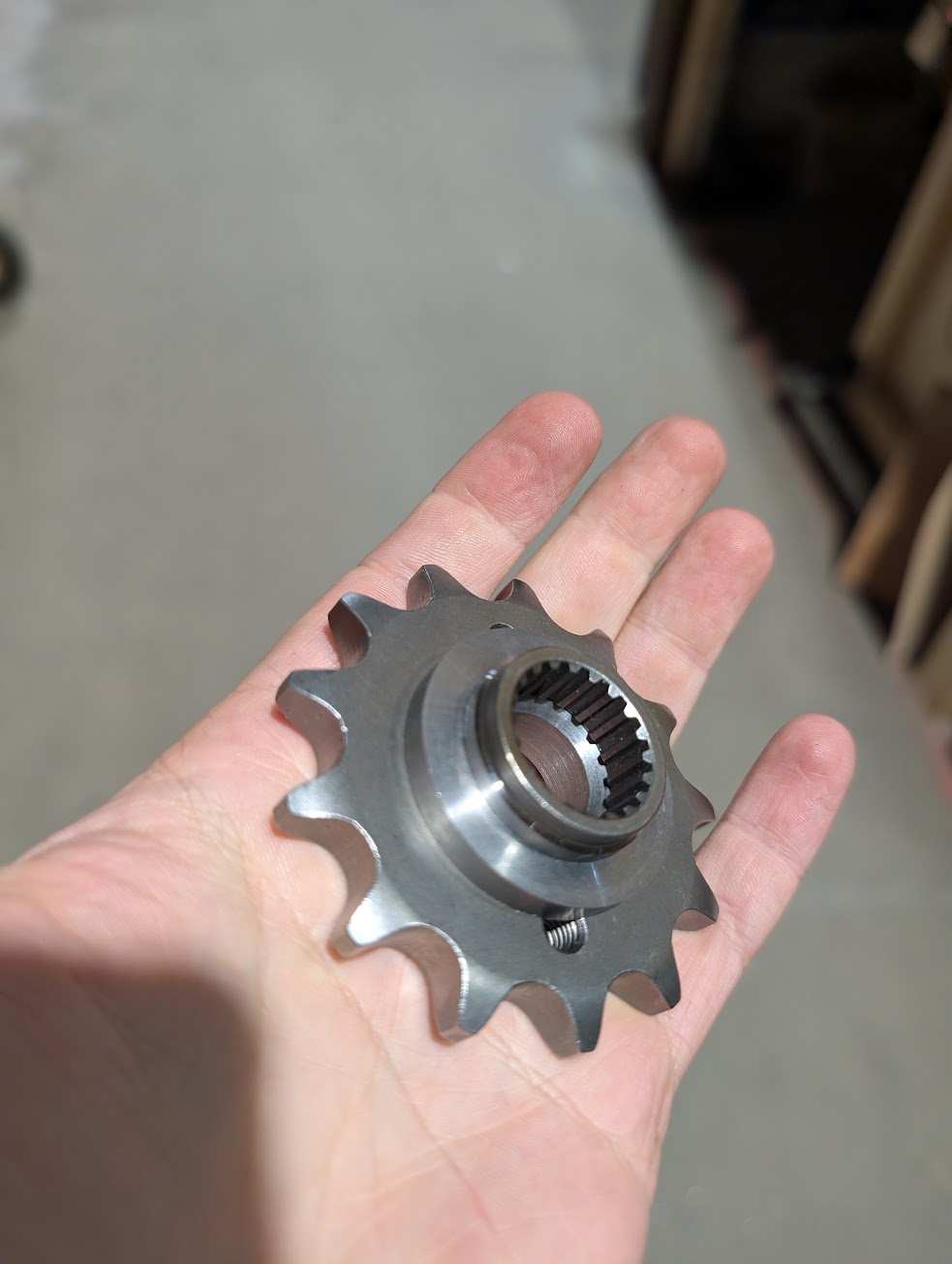

Not a lot of progress on the car, been using it a lot now that the weather is nice. But I've done some stuff. Car got a sparco bucket seat too.
Got a drysump kit on the ICE engine, so hopefully it won't explode it the first sweeping corner.

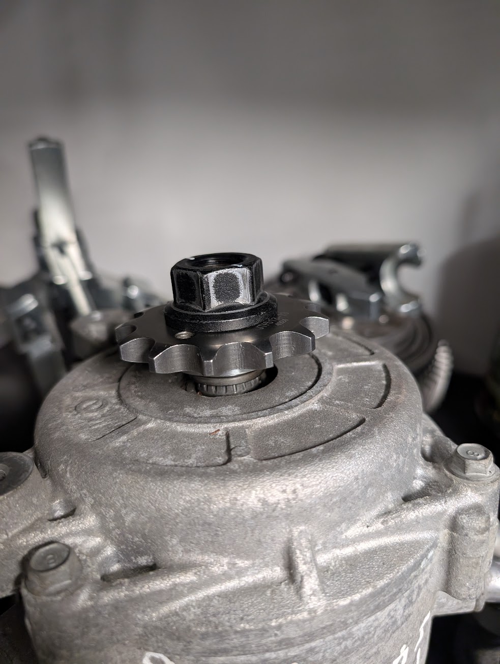

Made a little adapter piece to put 530 size motorcycle chain sprockets on the KIA HSG, ordered a few 3d printed stainless steel versions of those for surprisingly cheap from China, we'll see if they are strong enough.
Picked up some Mazda MX5 parts too, if I'm rebuilding basically the whole rear end anyway I might as well switch to proper to the proper independent rear suspension setup from the Mazda.
Soon I'll get to the open inverter part of the project.

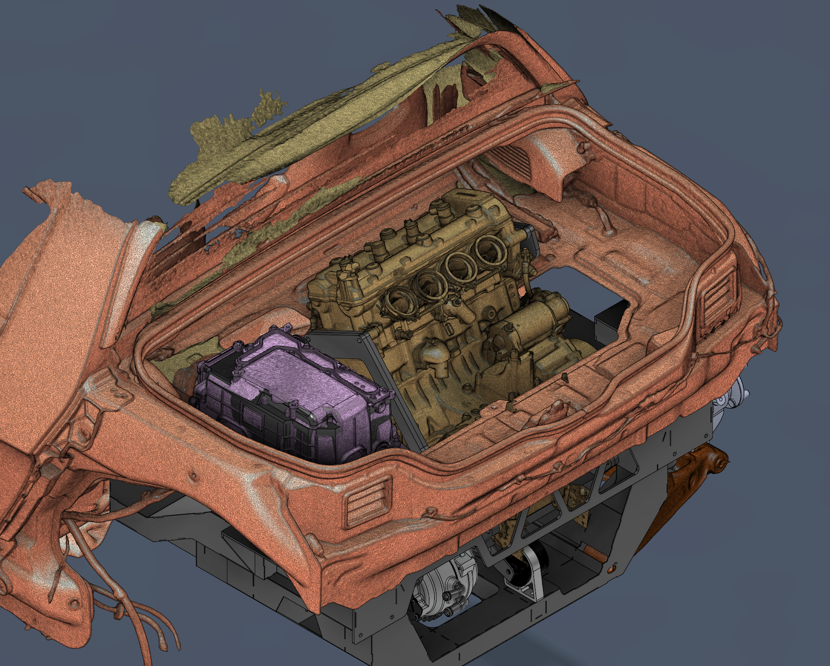

Picked up a rusty mx5 rear subframe. Need to wire brush off some more rust and then 3d scan it.

OEM ICE motor in the car sprung an oilleak and I'm pretty sure it's dead so now I have to speed up the progess on this project. Have spent a fair amount of time in CAD designing a KIA HSG/Suzuki Hayabusa hybrid package, started ordering some of the custom parts for it already. Right now I'm leaning towards skipping the supercharger part for now and focusing on getting the "basic" ICE+HSG contraption working. The supercharger I can always add later.

Re: [WIP] Smart Roadster Hybrid
The car split in half. Next step is to do some proper scans of the engineroom and finalize the subframe design.
The diff arrived today aswell.
Driveshaft mounted to a printed mockup. Still missing the support for the intermediate bearing.
HSG mount mockup.
Making slow progress on the mechanical side of the project. Will replace the printed parts with aluminium when I'm happy with the design.
HSG mount mockup.
Some more CAD work.
Got a cheap Prius inverter and ordered Damiens dual motor board, hopefully I can get that to work with the KIA HSG. Picked up another HSG with the spline instead of woodruff key, working on an adapter for that to run 530 chain sprockets. I've butchered the other one to try to make a custom enclose for it for use in the supercharger project.
Got a halfdecent scan of the G9200-47140 inverter, it's not perfect but should be good enough for most purposes. Really should sell the scans to recover the cost of the scanning spray at least. But since I haven't figure out how to do that yet, the link is below for those who are interested.
https://drive.google.com/file/d/1FQrjr ... sp=sharing
Turned down a KXF250 sprocket on the lathe and had JLCCNC whip up a press fit adapter piece to mount a proper 530 sprocket at a reasonable distance from the HSG. Just needs to get welded up now.
Decided to try to fix the OEM ICE motor to run for at least one more season so I've spent most of this months time and money on that piece of junk. Latest CAD update.
