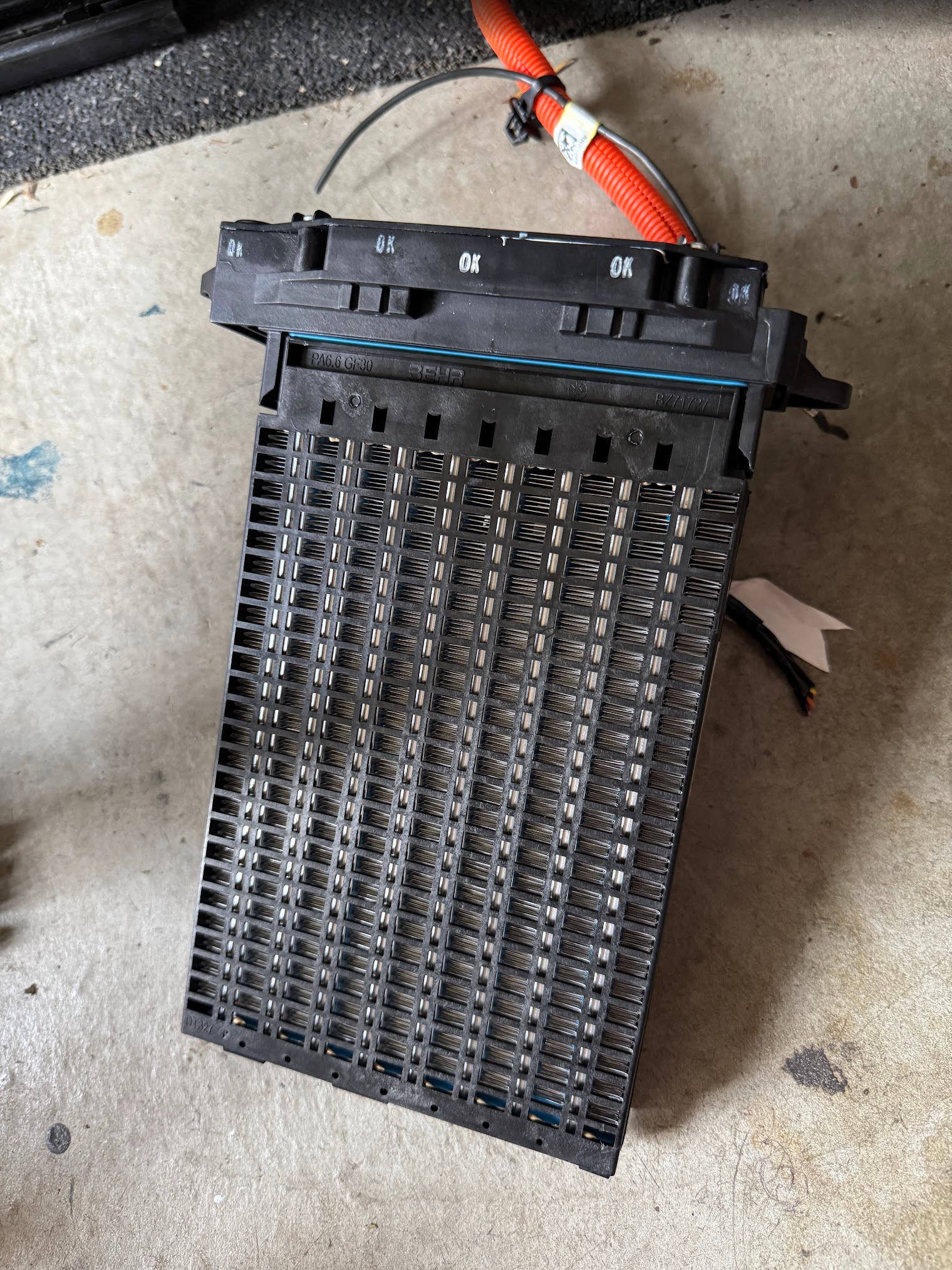

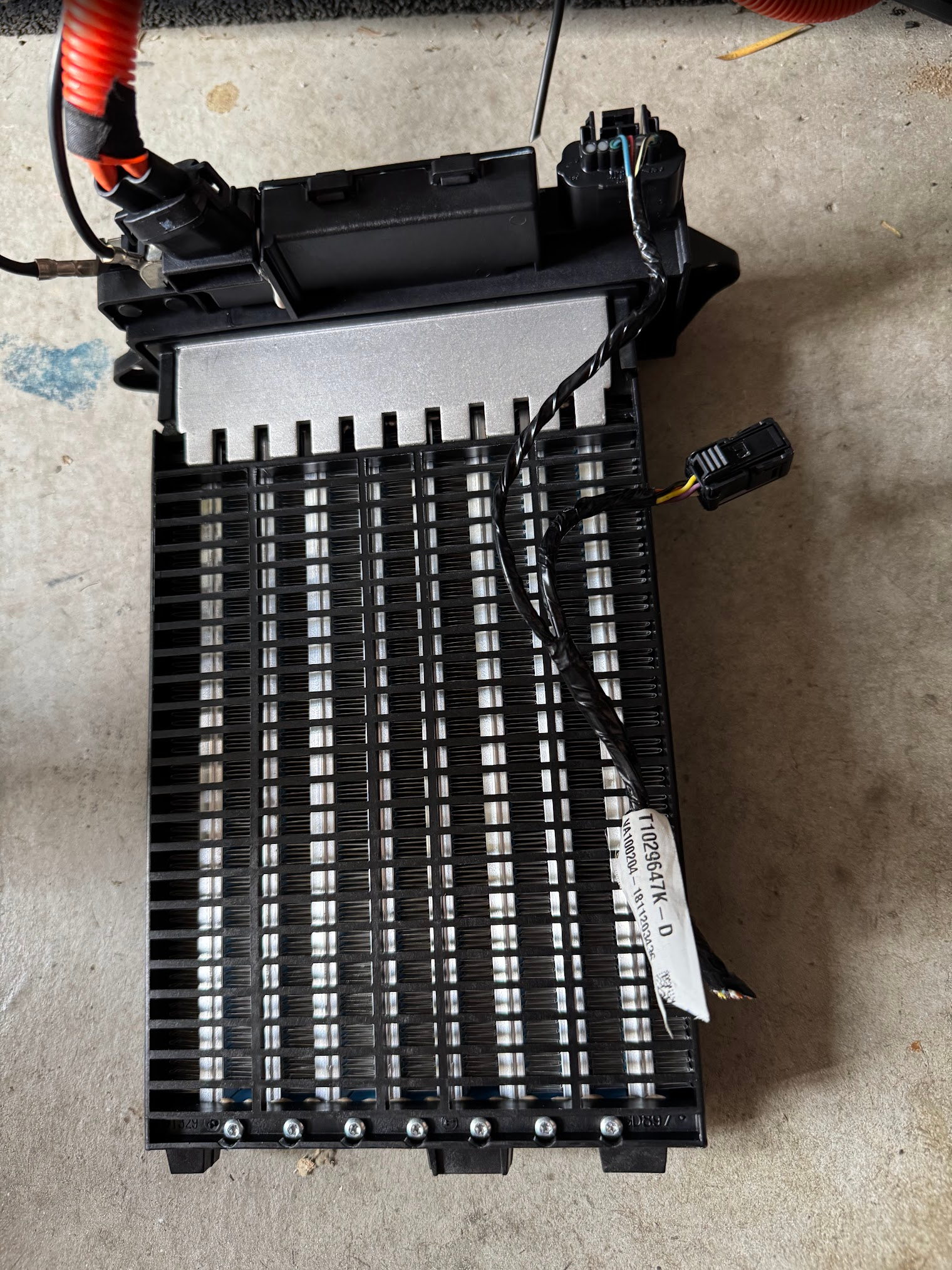

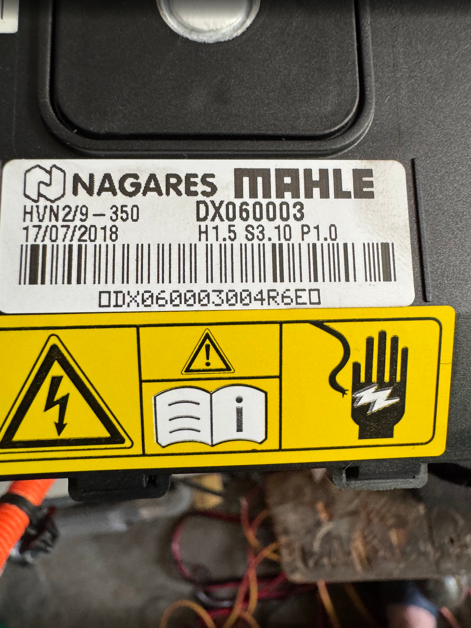

Is anyone using the leaf PTC cabin air heater? I have found info for the coolant heater but have been searching high and low for details to control the air heater with no luck. This one is out of a 2019 part number 27143-3NK1B

Could be this link? He is also refering to LIN protocol for "dry" heater...
https://ev-olution.yolasite.com/nissan- ... roller.php
Some more info in video...
Re: Leaf PTC Cabin Air Heater
Thanks arber333, looks like you're right, they do refer to a dry heater with separate ino file, thanks!
https://ev-olution.yolasite.com/resourc ... r_V1.1.rarUPDATE. I am also sharing controller code for "dry" PTC heater (from LEAF made after 2013). It was tested and reported as fully working. Please only use it if you using PTC in custom project and not in LEAF vehicle. As LEAF made after 2013 has two other slave modules connected to LIN bus.
Hello. I am new to this forum and seem to have hit a wall implementing control for the Leaf PTC Cabin Heater. Were you able to get this working? I get similar LIN bus messages from the heater and it doesn't heat up.
