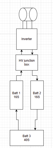

Hi Folks,
I am working on my EV conversion and I am thinking about a BMS solution.
For reasons of mechanical layout, I will have three battery packs.
I would like to have CAN output, integration with Zombieverter and low current drain when not in use as this car won't be a dialy driver.
I like the look of the Flying ADC 16 from the openinverter shop but I would need 5 and that's getting a bit spendy.
I would love to hear your suggestions. What does the panel think?
Thank you.
Andy.

tom91 wrote: Wed Jan 07, 2026 7:13 pm Batteries/Modules used?
Good point!
The modules are from an eGolf and are Lipos (AFAIK)

Why not use the OEM E-Golf BMS that is on the modules?
The cells are prismatics.

I have looked at the wiki for the VW modules and they need to be arranged in a particular way that doesn't suit the way I want to configure my packs. That's why I am not using them.
Cheers,
Andy.

Shame, as it will now cost you quite a bit to get another BMS on there. The Flying ADC 16 is very cheap for a BMS.
Any BMS that you can rely on is easily >600 gbp
