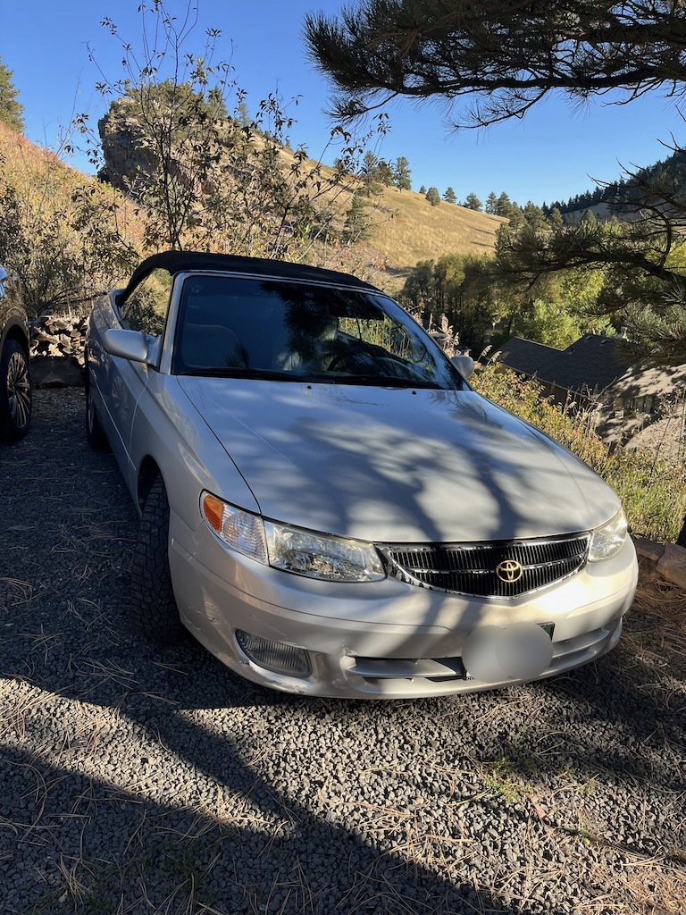

Hello, after buying my first new car in decades, a locked-down OEM EV, I caught the EV conversion bug. I've been doing the usual forum reading, github perusing, document downloading and youtube video watching and have started to convert another car I already own. I am an embedded systems designer (software + firmware + hardware) and a big supporter of open-source. I'm in awe of what you all have accomplished over the years and I hope that I will be able to contribute in some small way to the body of knowledge and designs you have created.

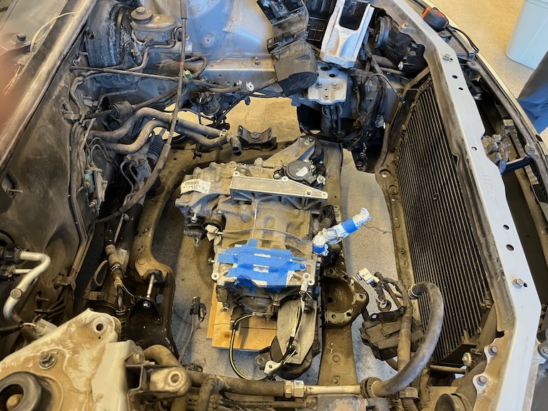

My big problem is that I live on the side of a hill without a garage or even level parking area so I am extremely challenged in the physical fabrication parts of conversions. Plus I'm not particularly experienced with wrenching or metal fabrication. But I'm an enthusiastic learner, have joined my local makerspace with a metal shop and am looking for cheap garage space. I have also been extremely fortunate to have met two wonderful people near me also doing conversions. I'm helping them out with electrical/software stuff and one of them has been able to help with the removal of the engine and we're going to get the gas tank out this coming weekend.

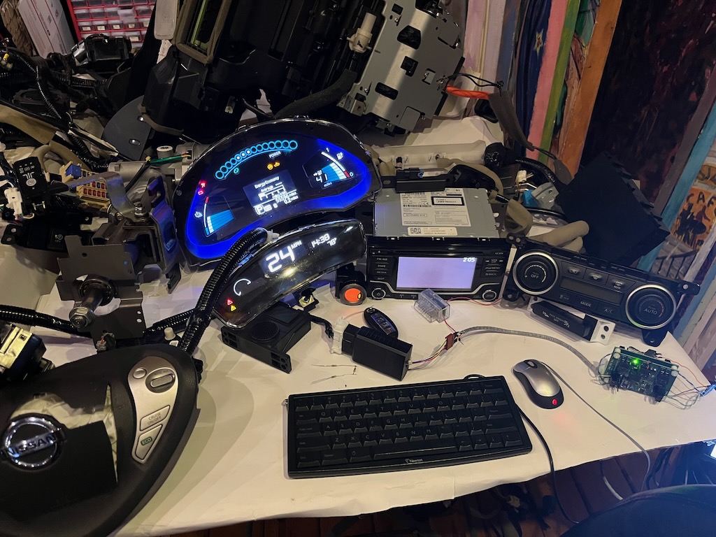

I was also lucky enough to get to part-out a 2017 Leaf S and ended up with the motor stack and complete set of electronics including the main wiring harnesses. One of my new friends got an Ioniq 5 battery pack and I bought half the modules from him for a ~38 kWh pack. I'm not sure yet which direction I will go for control of the car. I would like to see if I can make the EPS motor, brake booster and ABS module fit in the Solara but won't know that until I can get the dashboard removed. If I can fit those then I might try to re-use the Leaf VCM since it knows the dance between all those systems. I also want to re-use the HVAC controller with PTC and AC compressor fitted to the Solara's HVAC box. One thing I have learned so far is that reality often clashes with my ideas when I get into the details. So it could be that I will end up installing pumps for the existing brake system and hydraulic power steering. In that case I will use Zombieverter. I plan to design my own LCD based dashboard and re-use the Leaf's non-networked radio since it has bluetooth to connect with a phone.

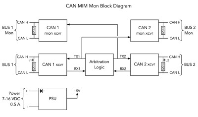

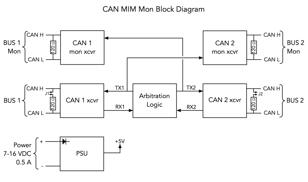

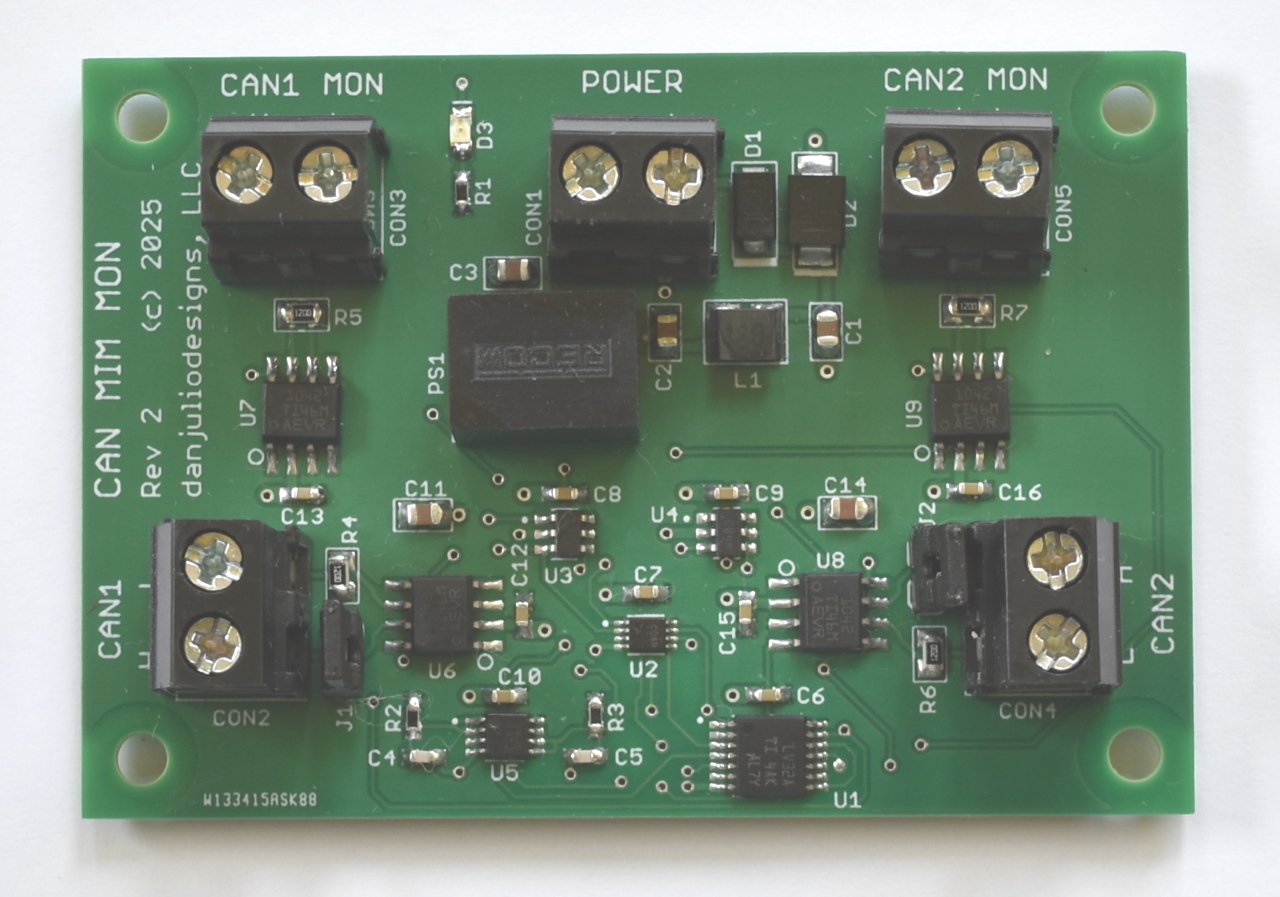

As I mentioned I want to re-use some Leaf components that haven't normally been used. This will take some CAN bus reverse-engineering (on top of the wonderful work that has already been done and documented). Originally I thought I would be re-using a 2019 Leaf that I bought. I thought I might have be able to identify where particular CAN Bus messages were coming from so I developed a PCB called CAN MIM MON (for CAN Man-in-the-middle monitor) based on a TI App Note for a CAN Bus repeater. I simply added another set of CAN Bus transceivers to be able to send the messages originating on each port. It can be found at https://github.com/danjulio/can_mim_mon.
Another use is to be able to extend monitoring CAN Busses far outside the vehicle without interfering with vehicle CAN Bus operation.
It works but I am still wanting to perform some real testing with error statistics gathering and the like.
