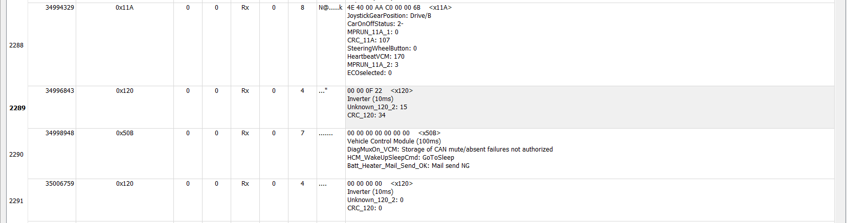

I have an 2022 110Kw leaf stack (gen 3?), the zombieverter runs on standard firmware, version 2.30A.
I added 3 can logs, during HV on, while turning the key off and from key off until 1 minute after. While HV is on there are about 800 frames per second and aboyt 20 seconds after key off it drops to about 80 frames per second (and this stays like this). Let me know if these logs are not usefull, than I will make others. But in the coming days I will remove the HV battery because I am working on the new HV battery.
The wiring will be checked completely (again) when the Volvo is added to the Zombie.
When the bms is added the drain will be about 0,16A (if the zombie and motor go to sleep and use about 70ma), so the battery will be empty in about 8-10 days with the current battery. That is still a bit fast.

I would recommend you use a latched pair of relays or one DPDT relay to provide power to zombie only when TWO conditions are fulfiled. One condition may be 12V supply from key lock and another signal could be 12V pulse from body control computer using brake pedal. BCM usually wakes up when you unlock the car to supply the brake pedal with power. You can take this supply to provide power from one side of relay. Now you need a signal from another side. This is normaly a signal that you can remove to switch relay off. Like ignition key lock or start button. This would put relay into latching mode and it will hold power until you remove 12V from key contact...JanJouke wrote: ↑Tue Dec 16, 2025 8:41 pm .....
The battery kept draining. This was caused by the leaf stack. The stack is connected as given in the wiring diagram, but it would not go to sleep I guess. So I made a system to power the Zombie and leafstack of when not in use and power on when the door is unlocked. The lead-acid battery was broken by the regular deep discharge. So I replaced it with an LTO battery. The BMS should protect it against deep discharge and LTO should be robust.
I would not just trust the body control module with 12V, hence latching relay...

What is on your CAN network with the Nissan PDM and Inverter?
Seems for some reason the Zombie sends CAN sleep but does not exactly do so itself. Will review this as I had it working on the bench and seen it work for others. Reviewed logs more closely Zombie does stop sending CAN after sending the stop CAN comms.
Have you wired it as per diagram with the Zombie controlling some of the 12V power via a relay? There is also a possibility there are errors with the PDM or Inverter and they are keeping each other awake. Not looked at how to tell them to ignore errors and sleep anyway.

Thanks for looking at it.
The only things on this CAN bus are the Zombieverter, leaf stack and the isa shunt.
When I disconnect the ISA shunt the draw drops from about 1 amp to 0,4-0,6A (on the 12V bms, don't know how accurate this is). I have the Zombieverter display on the other CAN bus, when I disconnect this one also the draw goes to 0,2-0,4A.
This was checked without activating the HV (battery is removed).
The wiring is connected conform the wiring diagram (including the relay). I saw in the current version that the ISA shunt is removed. I have one connector from the stack so I checked the pinouts with some info from the gen 3 crosschecked with the older version. The wiring will be checked again when the Volvo is added to the zombieverter.
I had sometimes (with the car days on a 12V battery charger) that the leaf stack was not reacting to the zombieverter (no faults on the Zombie). When I disconnected the the connector to the Leaf stack and reconnected it, it worked. This was before I powerd the systems down. It looked like there was a fault in the Leaf Stack.
I just checked the 12V to the PDM and inverter. The constant 12V is present on the PDM but on the inverter there is only 0,9V (maybe damage in the wiring loom?) and the 12V via the relay is not present (with ignition off or T15 on). Checked with the current schematics.
