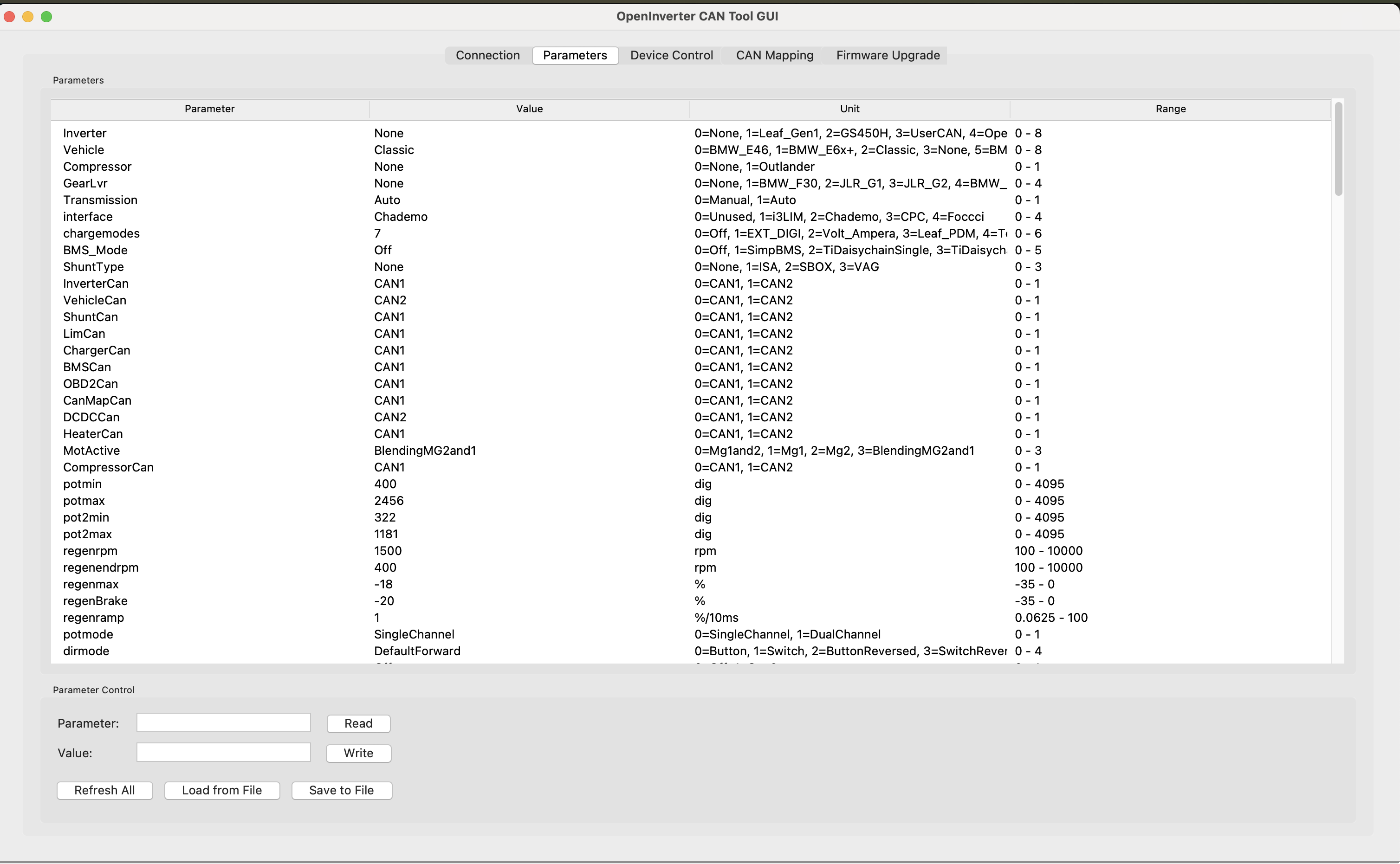

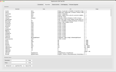

I've done a PR to add an initial GUI to the tool

I've just released v0.4.0 of the tool:
What's New
  • Experimental GUI allowing parameter viewing, modification, firmware upgrade and device control
  • Rebrand to OpenInverter CAN Tool
  • Document and recommend usage of pipx for installation
  • Document using canable-fw based CAN adapters on MacOS
  • Stop extraneous python stack back-trace information being displayed on common CAN bus errors
Thank you to @Bigpie for their contribution.

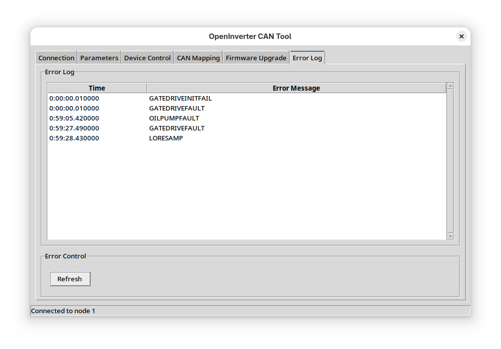

I've just released v0.5.0 of the tool:
What's New
  • Add the ability to display a device's error log in the CLI and GUI
  • Improve firmware upgrade to detect and reject attempts to upgrade with ELF (for debuggers) or Intel HEX (for serial upgrade) files.
  • Add documentation on how to automatically start socketcan interfaces on Linux (thanks @evMacGyver)
  • Expand the list of known working adapters to include PCAN-USB (thanks @Jack Bauer)
The error log display needs updated firmware support. So far Stm32-vcu Vehicle_Testing and M3_DU stm32-sine have this but @johu's Flying ADC BMS and ccs32clara both need updating.
To give a flavour this is what an inverter having bad hair day looks like:
