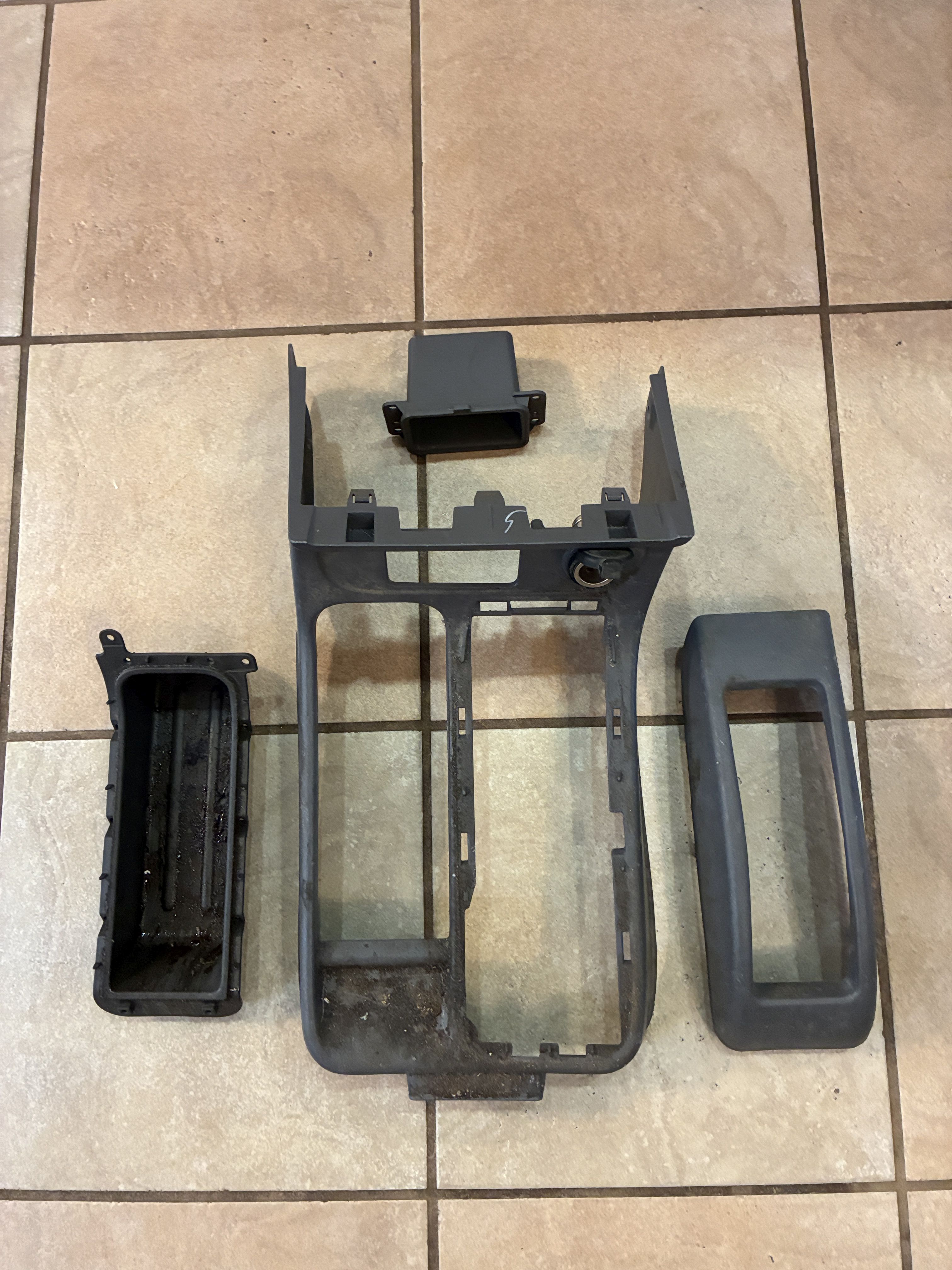

I am just loving the modularibility of this Nissan Xterra center console shifter combo, bless this Nissan engineers for using screws and not those god forsaken plastic clips that get brittle over time and snap right off

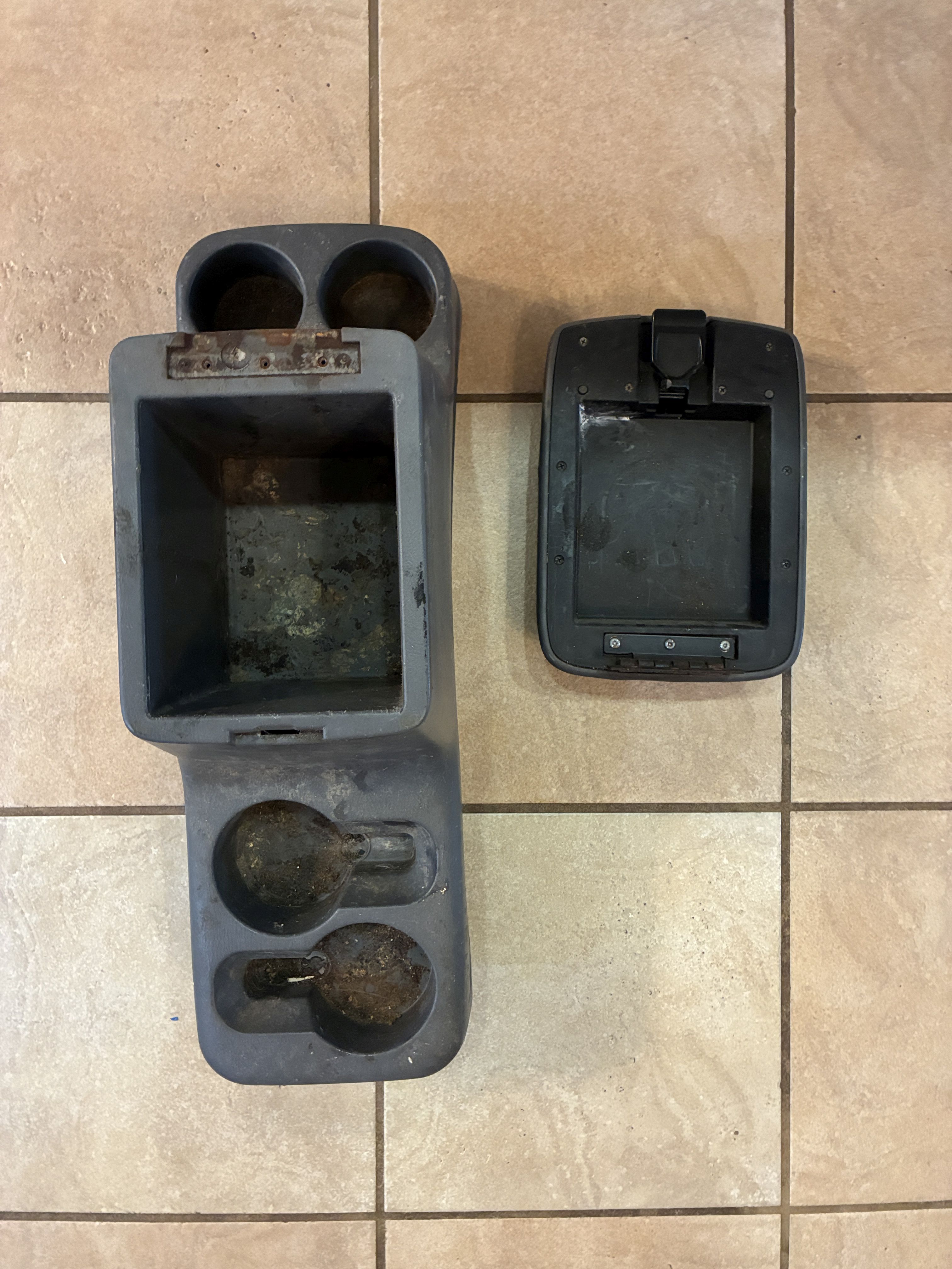

meanwhile in the Kitchen Adjacent Stand Alone None Integrated Center Console Refurbishing Facility - KASANICCRF

well this escalated quickly, I'm sure you've all been there
