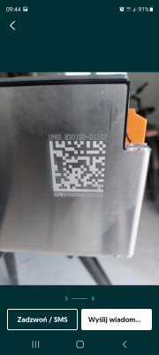

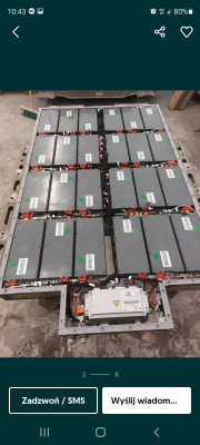

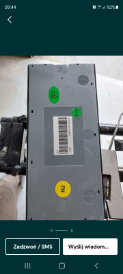

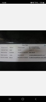

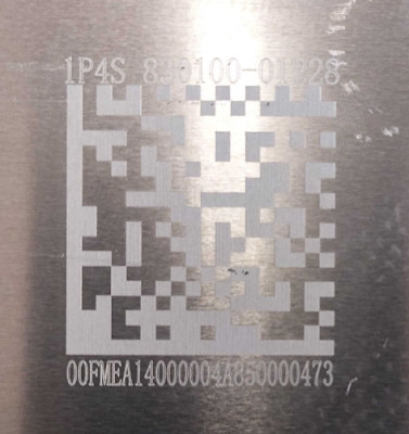

One more question that was asked. Modules from both cars have NMC chemistry. I've added some Pictures below:
Re: Hi. Is any one here knowledgeable about Catl modules and have experience with them in terms of battery pack/design?
My bad I dicribed it wrong. Last 3 are from Maxus. The rest is from MG
