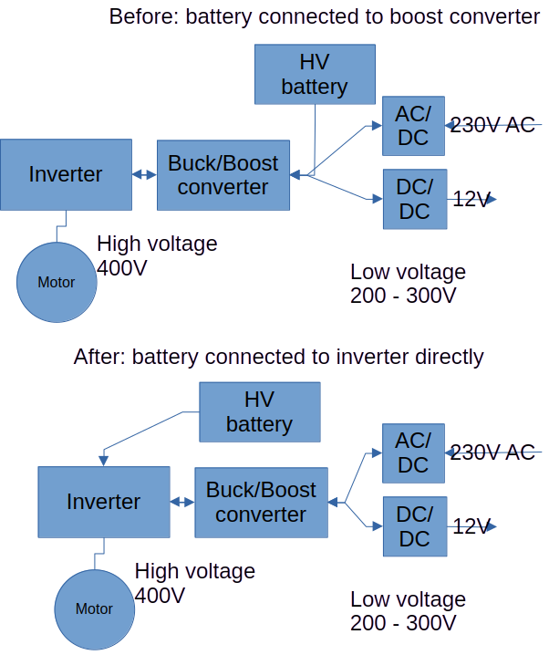

Many hybrid inverters feature a buck/boost converter. It can step down the voltage from the motor to the battery side to charge the battery with a fast spinning motor. And it can boost the voltage from the battery to the motor side to make the motor spin fast from the battery. Battery voltage in hybrids is typically about 200V.
In addition they feature a DC/DC converter from HV to 12V to run the "car" systems. It sits on the battery side of the converter.
The Prius Gen2 inverter features this and due to its not too integrated design we can faff around with it.
First of all, when using the Prius inverter to power an actual EV we will find that the converter is "in the way" as it sits between the battery and motor side and is a bit of a weak link, limiting battery current to about 100A.
Secondly we will find that when using a regular 400V style battery salvaged from a PHEV or EV the voltage exceeds the rated input voltage of the DC/DC converter.
With a simple mod we can fix both these problems We disconnect the positive battery cable from the boost converter input and reconnect it to the boost converter output i.e. the motor side of the converter. This has 2 consequences
1. The inverter bus is now straight connected to our HV battery and can draw as much power as it can handle
2. The DC/DC converter still sits on the buck converter output and by running the latter at, say, 50% duty cycle will feed it with the 200V it expects
With the Gen2 inverter this has a 3rd consequence: in parallel with the DC/DC converter there is an auxiliary inverter. If we replace its output IGBTs with a bridge rectifier and feed 120 or 230V AC to it we will have a rectified DC voltage of 150 to 300V on the boost converter input. So now when we run the boost converter it will feed current into out HV battery - we have created a simple mains charger.

Sorry, just found this. With the SMT version of the Prius controller this is integrated. In drive mode the "user PWM" pin runs the boost converter at a fixed rate. In charge mode the regular PWM runs it in current control mode.MattsAwesomeStuff wrote: ↑Wed Jan 31, 2024 4:50 am Also, does any of what you described require using new pins or telling the buck/boost what to do? Any code or software? Or does it just happen by being connected?
Here we do indeed need additional hardware: an extra current sensor that measures current delivered by the AC/DC.
There is no replacement logic board for Lexus inverters. I don't know if the buck/boost converter can be controlled with the Serial protocol? And I'm pretty sure it has no aux inverter.

The booster is limited to 100A, so this will get you 10 kW

Is it version 1.3? Early versions don't have the user PWM connection.MattsAwesomeStuff wrote: ↑Fri Apr 12, 2024 9:45 pm Good news, I also bought one of those 2nd hand from someone who went a different way. So I have both hardwares.
Because you explicitly command charge mode https://openinverter.org/wiki/Battery_ChargingMattsAwesomeStuff wrote: ↑Fri Apr 12, 2024 9:45 pm Stupid question, how does it know whether it's in charge mode, and is charge mode also what happens during regen?
Regen=Drive Mode
Yes. The board has 4 inputs. You use two inputs for ONE inverter power stage and one for the extra sensor. You need to juggle a bit to have the same current to voltage ratio as the built in ones. You could regard the latter as cosmetic. Say the extra sensor outputs 50 mV/A and the built-in ones 25 mv/A it just means you need to command double the charge current.MattsAwesomeStuff wrote: ↑Fri Apr 12, 2024 9:45 pm Do I need to install an extra current sensor, or does the SMT board come with a way to interface with one built into the inverter?

Via the A/C inverter it will just boost
Via MG1 it will just buck. You need an additional relay to connect the battery to the buck side while charging. At least then you don't need the extra current sensor because it will use the MG1 ones

Yes and yes. Of course that will loose the DCDC converter because that doesn't run at 48V.
MPP tracking won't be possible as you can measure input or output current.

With the original plan MG1/MG2 or GIWA/MIWA current sensor would have been sensed by the same analog input because one is only active when charging and one when driving.
Now ideally you want a current sensor that acts like the MG2 sensor. +-/15V and the same current to voltage ratio. I happened to have such a sensor lying around that I tuned to be Prius-like with the burden resistor. But this only works with a current mode sensor (I call it that, the actual name might differ) i.e. say, for 1A primary current it creates 1mA secondary current.
I wonder if you could extract an MG1 sensor and route your charging current through it?

I’ve got a junk (water damaged) inverter that I had previously tried to pull oen of the current sensors from, and it was a bit of a dead end for me. It would be tough to get it out without destroying the inverter, it has 5 pins on it and the only one I can identify is the ground. The only markings on it are “KOHSHIN” and what looks like a Toyota part number (g9247-47050 and g9247-4740…different numbers on mg1 and mg2, interesting). Searching that go me nowhere.
But….I’ve got the current sensor, it’s already wired up, so my current plan is to try to use it in situ. The way the Busbar connects to the igbts doesn’t really give enough clearance to disconnect it from the igbts and connect a cable, but I think I can pull the Busbar out entirely and run multiple stands of 16awg (~1.3mm) wire though the current sensor. (I just need one sensor, correct?)
I’ll report back.
I’ll report back.
