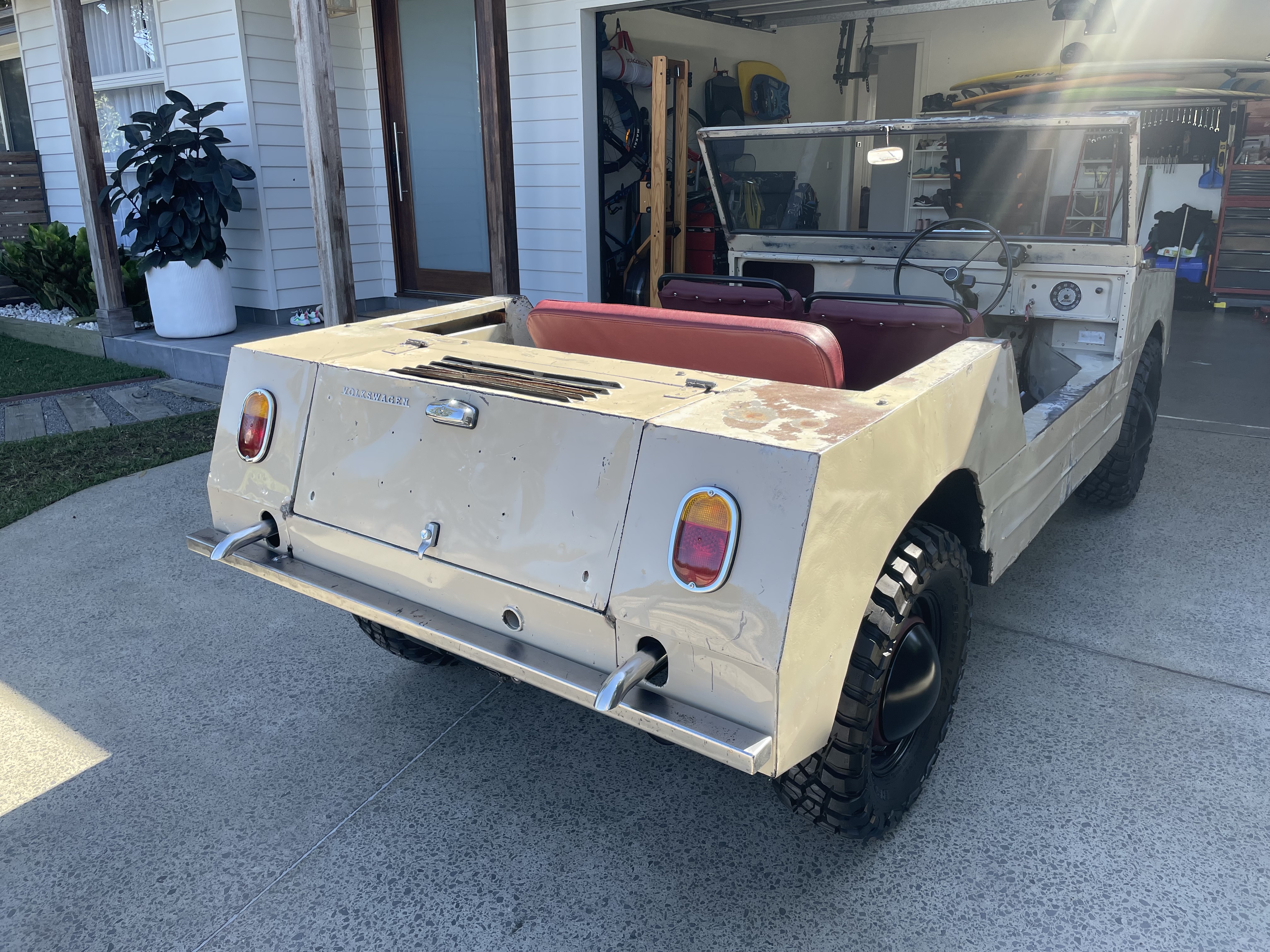

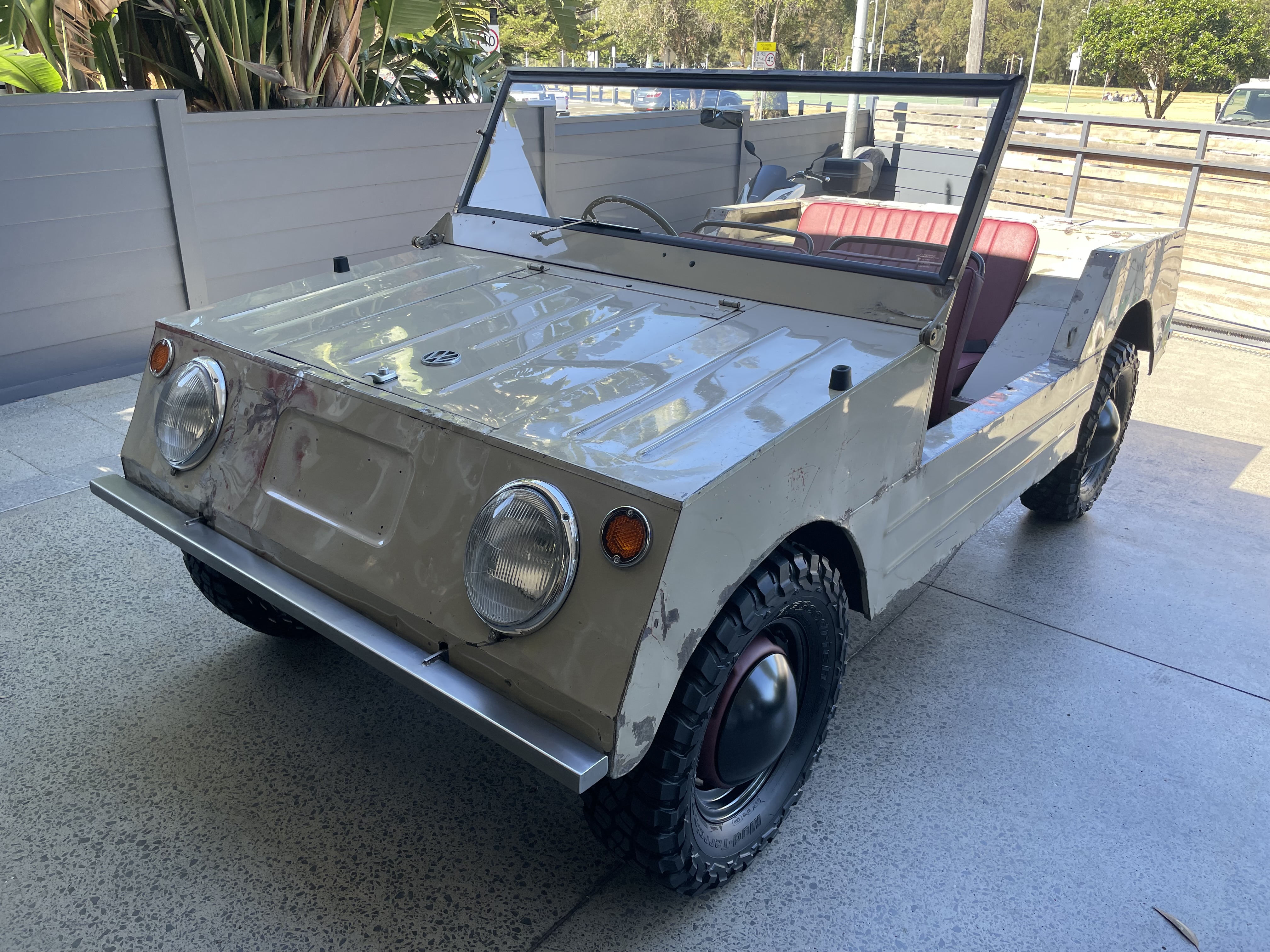

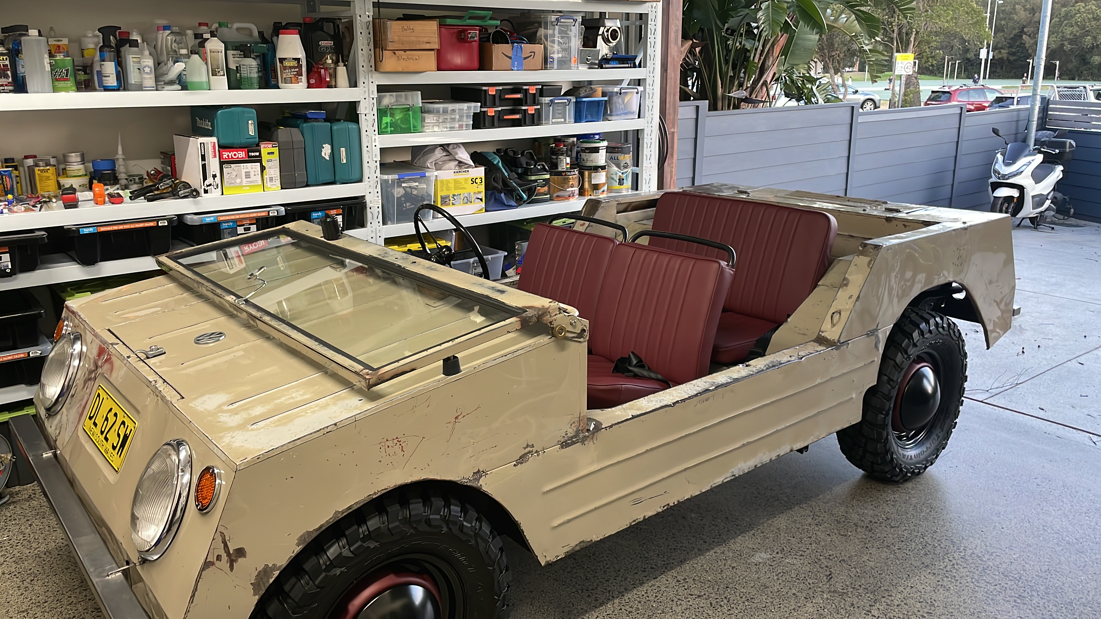

Hi All,

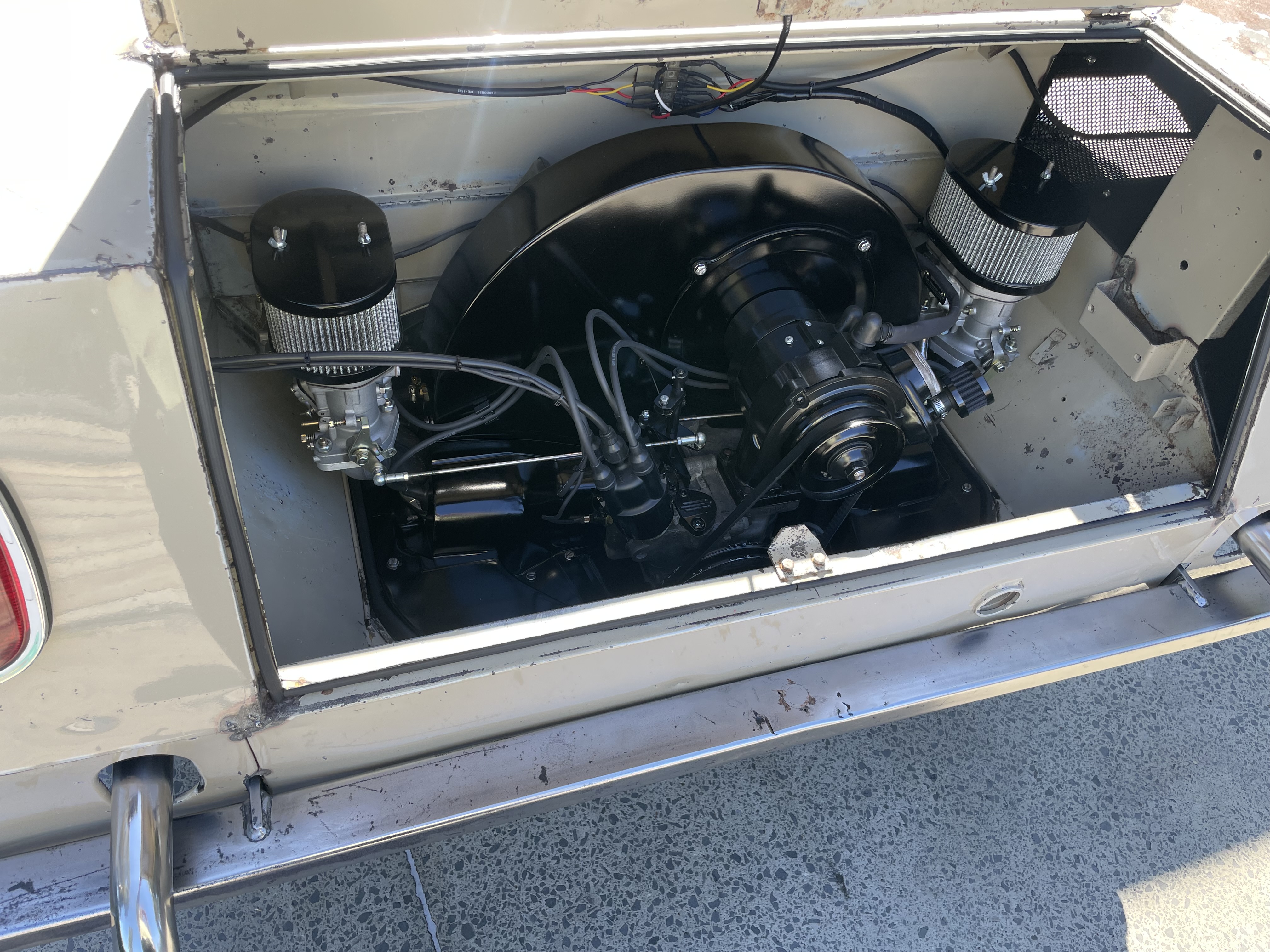

This is my first EV conversion project. The car is a Australian designed and manufactured 1968 Country Buggy.
The running gear is a beetle pan and swing axel gearbox, it has reduction hubs on the rear wheels from a VW Kombi (this was original and added for ground clearance).
About a year ago I did a full restoration on pan and suspension, and have kept the original patina.
I have a 2013 Nissan leaf with EM57 motor as a donor car.
Would love to get the forums guide on how to go about this conversion.
