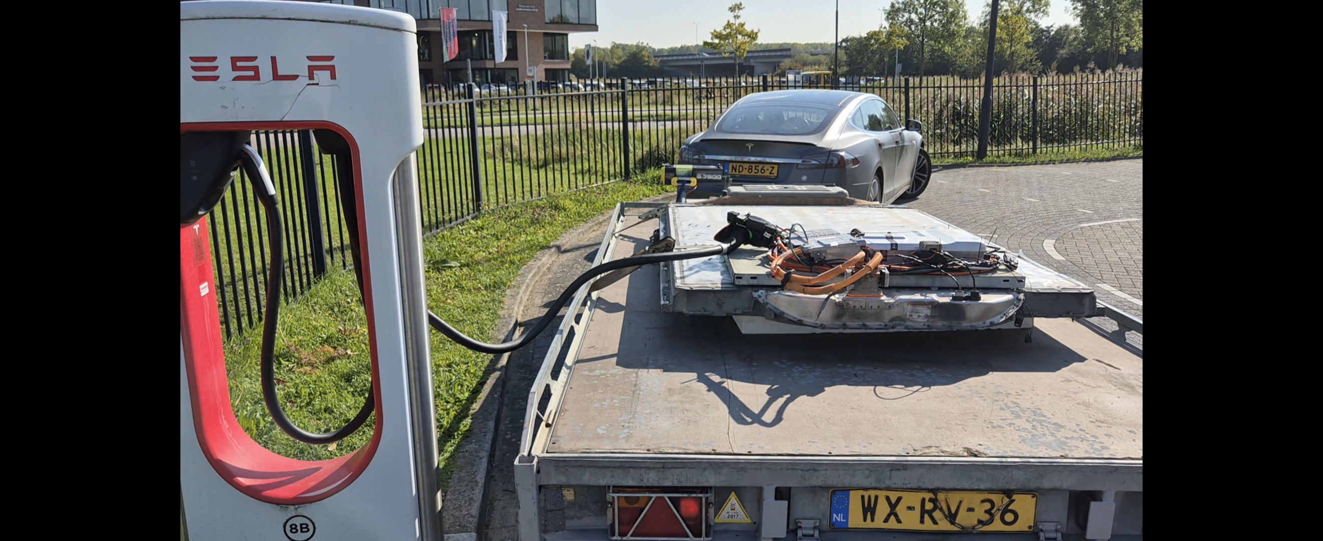

Supercharging a Tesla standalone battery pack

Re: Supercharging a Tesla standalone battery pack
It can also work with gen3 obc's.
No need for can-redeploy. Can also work with v2 v3 superchargers with ccs adapter.
Info during fastcharging
Its a 14 modules 75 kWh battery with 83 bricks.
1 module, module 7 has 5 bricks.

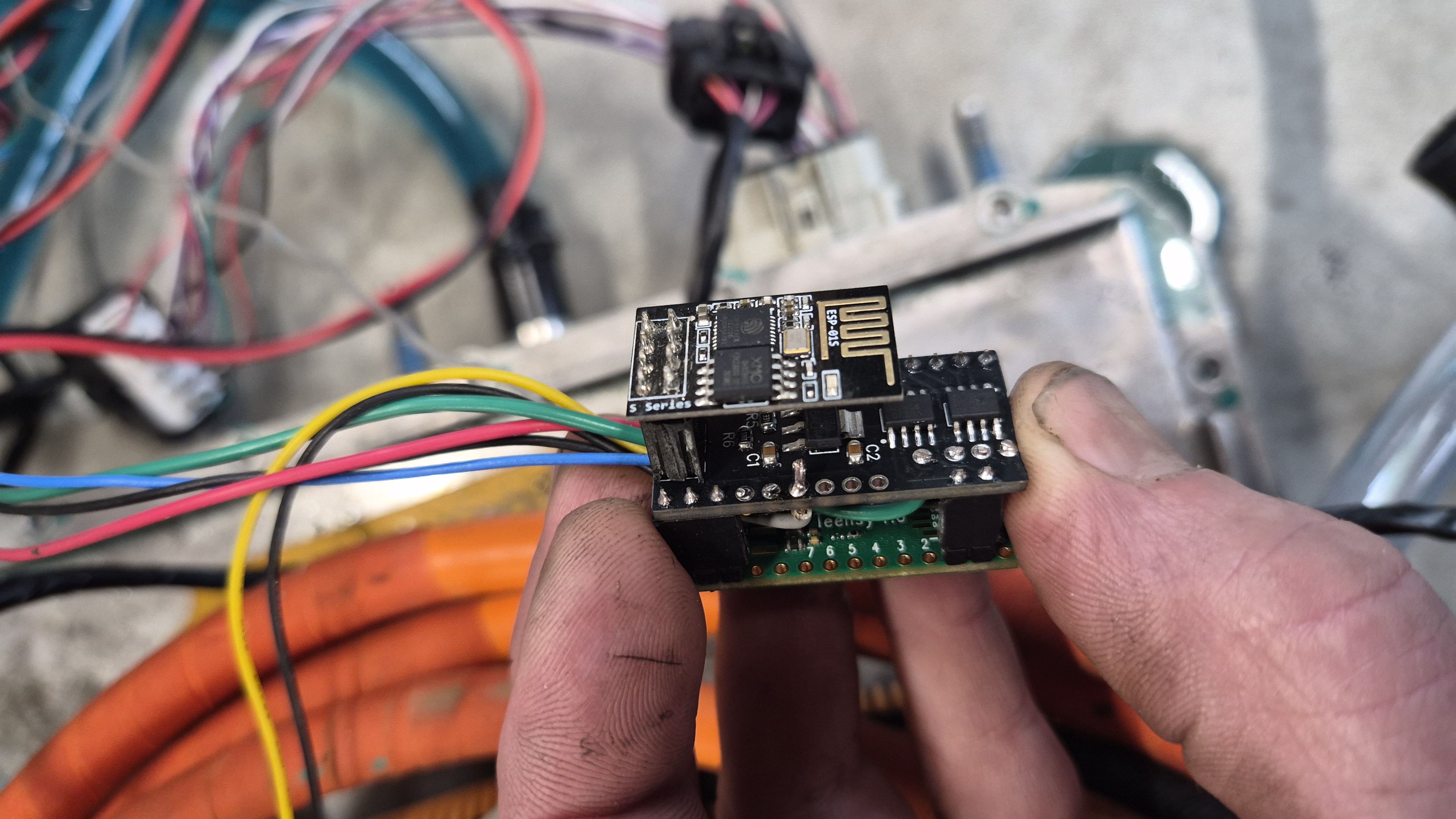

Cool.
So parts needed battery, charger, hv junction box and charge port?
What does the controller do exactly?

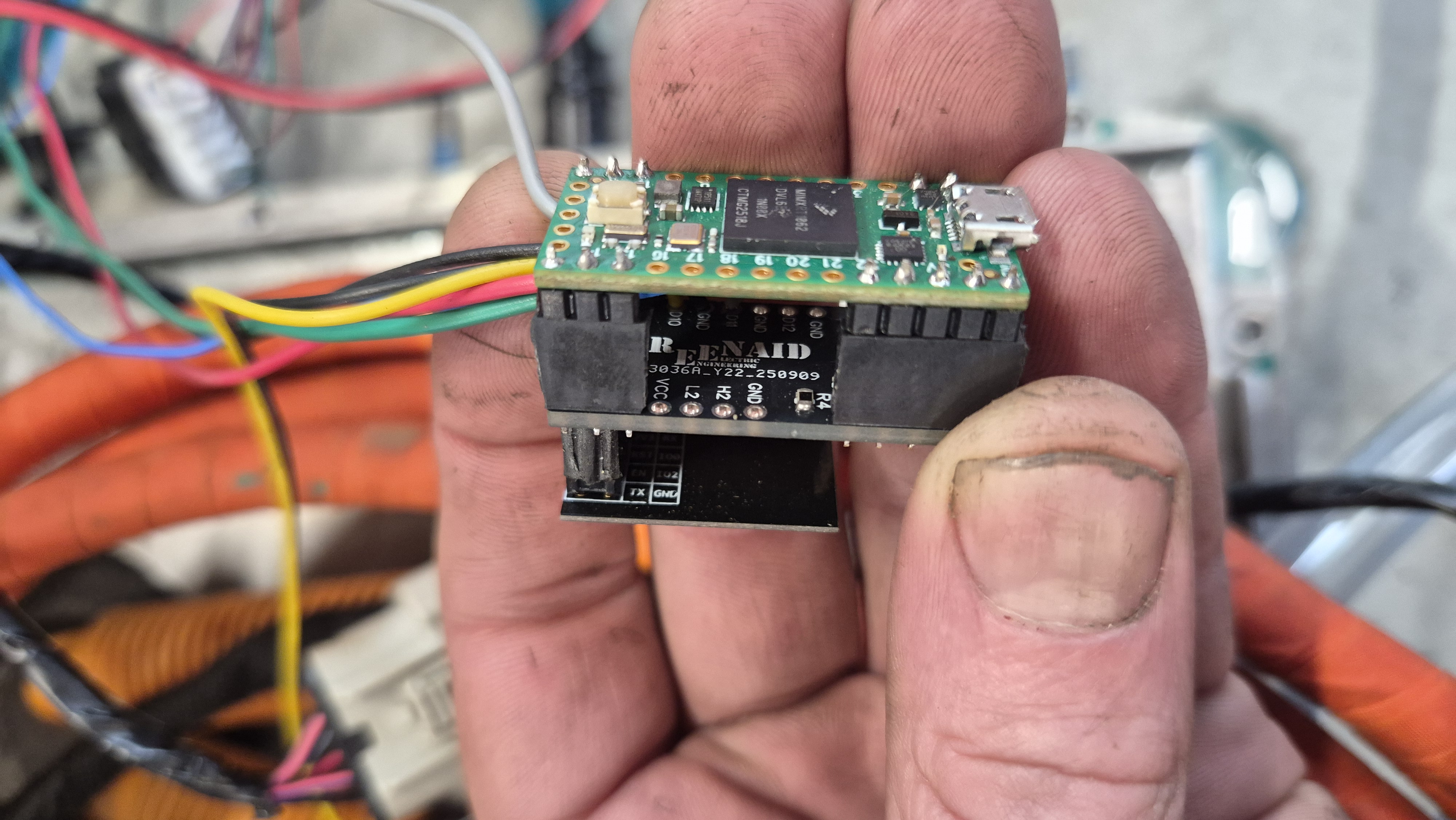

The controller sends the missing can data from some (HV) components.
And the VIN number for the payment.
Cool project.
Right now I’m trying to make something similar, but I’m stuck with the CAN BUS communication. I have outdated Model S .dbc file and trying to figure out necessary HV components frame IDs. Maybe you can share .dbc file You are using?
