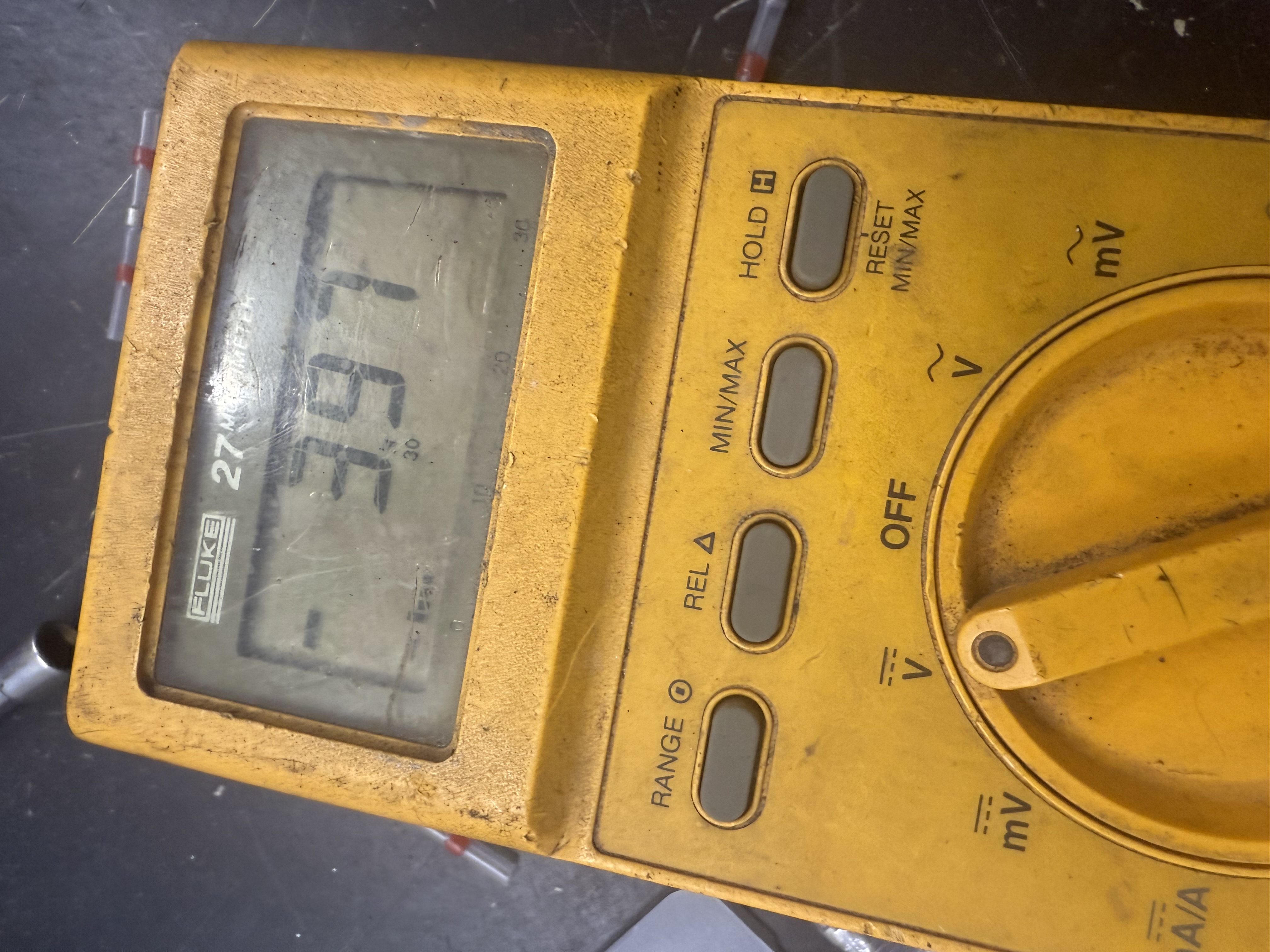

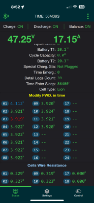

If I take my multimeter and check the cells they are all 3.97 but this reading is not the same in the jk app note cell 1 resistance and voltage. Any thoughts as to why?

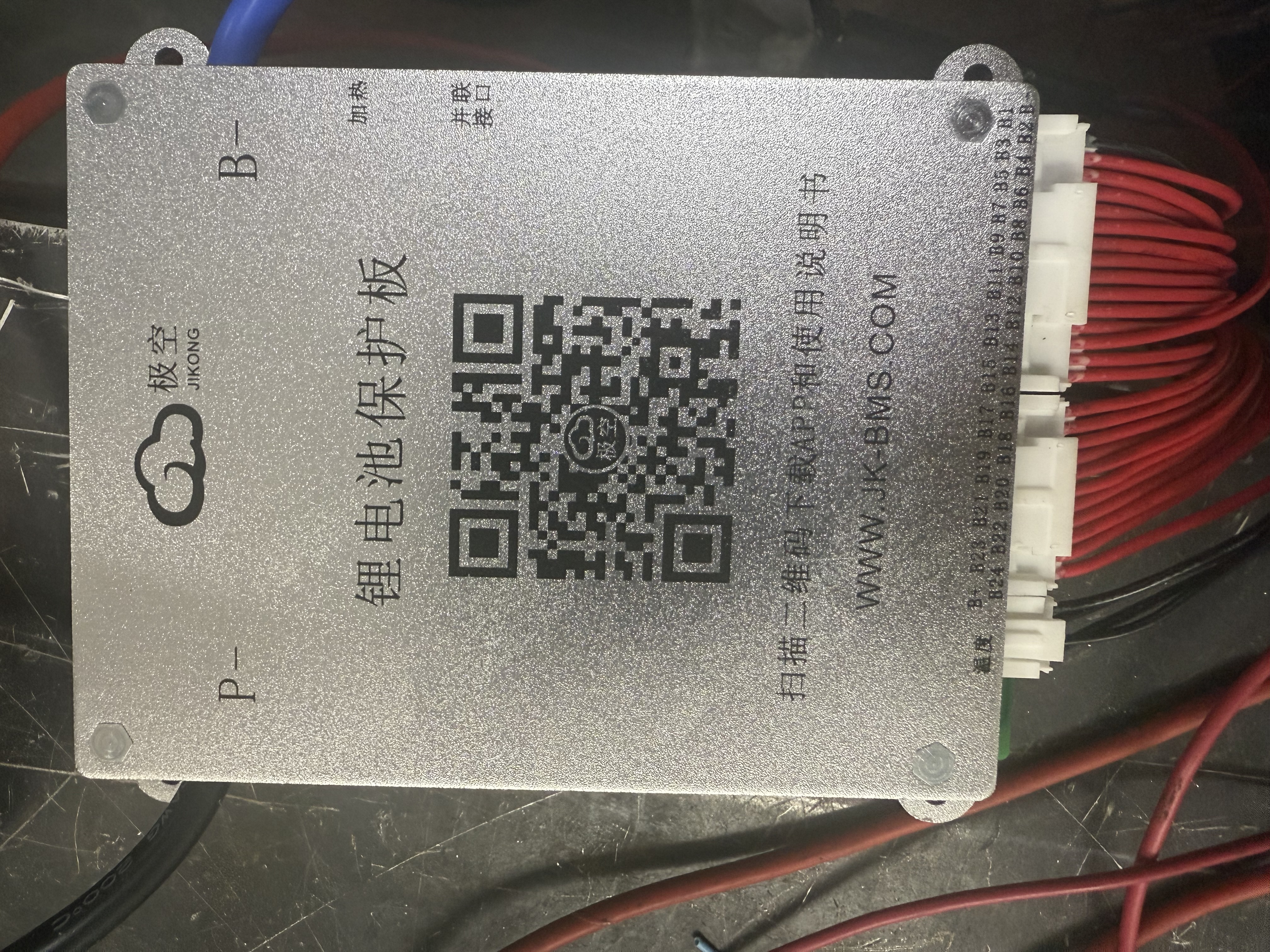

Jk-BMS
Jk-BMS
I’m testing battery packs from a Honda Clarity.

Re: Jk-BMS
Bad cell taps.. Chinese junk.. etc
Re: Jk-BMS
Delete the chinese spyware app and try "overkill solar" app, there were some calibration offsets available there afaik, maybe those help
