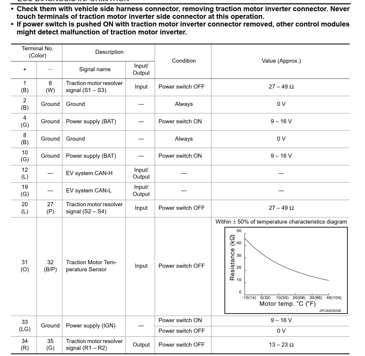

I have been using this image I posted below as reference. Also as I noted above, I measured these pins and got what I felt was appropriate "~40ohms for sin/cos, 20 ohms for exciter, and temp sense was 15k-ish. No shorts to case. Seem about right?"
As I understand it, here is the correct wiring I've conjured up from the sources I could find. Maybe I got the connector backwards, as the pin numbering on the connector is reverse the manual. Note: when I disconnect HV and spin the motor by hand, I can see speed go up to a positive number, and when i spin it opposite direction, it goes to a negative value (on the gui) - spot values.
PDM Pin / Resolver Pin & ID / color
1 / 1 Sin + / Black
6 / 8 Sin - / Green
20 / 7 Cos + / Pink
27 / 6 Cos - / Blue
31 / 4 Temp gnd / Orange
32 / 3 Temp / BLK&PNK
34 / 5 EX / Red
35 / 2 ! EX / Green

Well, thanks to you driving me to rewire it again (thank you!), I've discovered an issue with the wiring, and for the life of me, I can't make heads or tails of this. Is the exciter single-ended? I guess I expected differential
I have it wired correctly per the 2011 Service Manual. But the pins don't match the circuit. I can't see any other way for the pins to line up, so I can't imagine they're transposed...
Referring to the green external PDM connector, Pin 35 (exciter R2) is connected to motor temp sense ground on the PDM (pin 31) .
Please see my photos, and if you have any idea what the hell I've done to mix all the pins up . Is this some half year revision or something?

Looks to me that you're on the wrong row for the motor controller board. Looks to be labeled 1-20, then the next row is 21-40, right? I see it as you have 17 and 15. Unless you're labeling another connector number at the PC board..
deleteduser1
Re: Gen1 Leaf and ZV spin up issues
Post by deleteduser1 »
jrbe wrote: Fri Sep 05, 2025 1:47 am Looks to me that you're on the wrong row for the motor controller board. Looks to be labeled 1-20, then the next row is 21-40, right? I see it as you have 17 and 15. Unless you're labeling another connector number at the PC board..
I guess that wasn't too clear, and I'll update my post. Thanks for your feedback.
The numbers are pertaining to the green 36 pin external connector on the PDM from a 2011.

I'll also restate, the resolver pairs match the impedances listen in the service manual, whether I test them on the connector, or all the way up the wiring loom. The temp sensor changes with climate conditions and appears to be functional and accurate. I have swapped pairs to see if there is a difference, no difference is observed in operations or UI numbers.
1 / 1 Sin + / Black
6 / 8 Sin - / Green
20 / 7 Cos + / Pink
27 / 6 Cos - / Blue
34 / 5 EX / Red
35 / 2 ! EX / Green

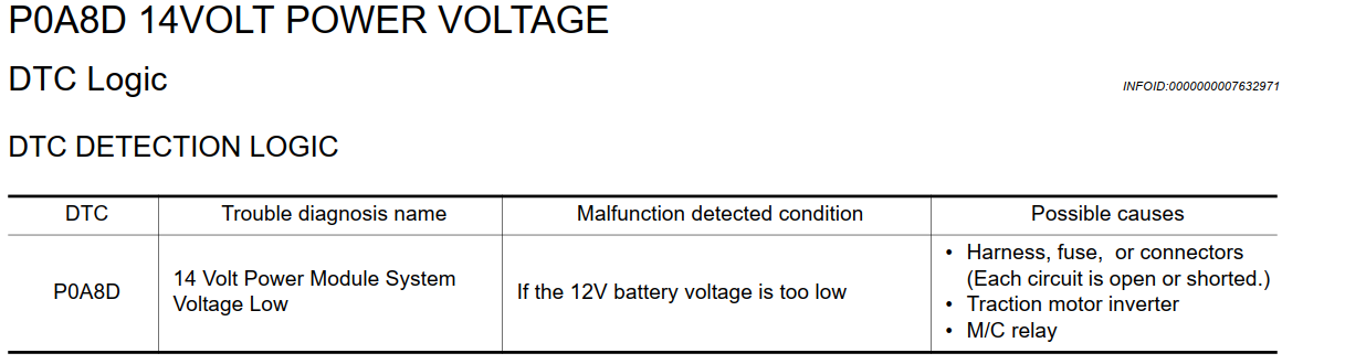

Wired up the OBD to the CAN Bus:
Leafspy says there are errors with the Leaf Battery (which I knew about), P3180-00-C0/EVC-249 HV Battery System, and P334D4-00-0E/EVB-130 Bat internal resistance. I wasn't planning on using this pack anyway, but its easier to test with this whole thing for now. I have BMW cells Im planning on using when I get this thing running.
Unfortunately, these are the errors that already existed when I bought the car :(

Looked these up for y'all
Nissan FSM lists these on a priority in which they should be checked
1.
  • P0A8D 14VOLT POWER VOLTAGE
    P0C79 DRIVE MOTOR A INVERTER VOLTAGE
    P318E CAN ERROR
    P3193 CAN ERROR
    P3197 CAN ERROR
    U1000 CAN COMM CIRCUIT
2.
  • P0A1B DRIVE MOTOR A CONTROL MODULE
3.
  • P324F DRIVE MOTOR A INVERTER IGBT
beeetown wrote: Sat Sep 13, 2025 12:43 am This is still screaming bad wiring, but I just cannot find where that could be.
Why you don't want to share your full wiring with few images?
Have you checked that you supply the inverter enough +12V power and that your lab power supply? Are you supplying a high enough voltage (9-16V as per TMS-32)?

If this DTC is detected simultaneously with P0A8D, inspect the 12V battery first, as it is suspected to
be dead.
