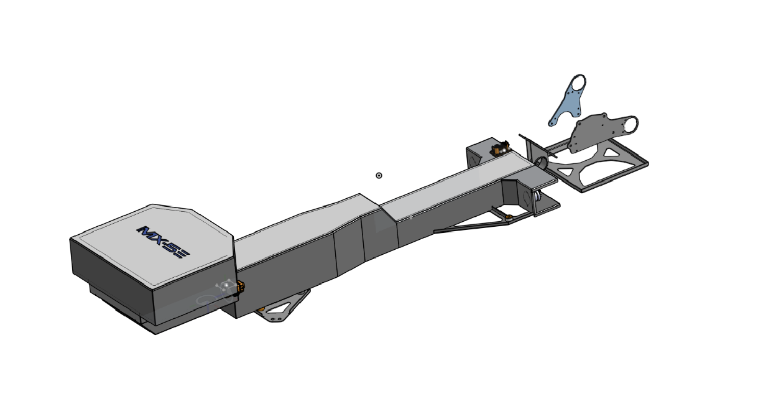

The plan:
Model S front drive unit mounted in the rear subframe. This gets rid of the entire original driveline. This is a must have for me. I don't want to deal with any driveline issues or weak points that will break with all that torque
The added bonus: Lots of room in the engine bay and transmission tunnel to put all the batteries. I have bought a Corsa-E pack and will probably be using 16 modules to get a 96s pack and save some weight as opposed to using all 18 modules. I have not taken all the modules out yet but I assume every module has a cooling plate under it. Not sure if I will be using these. Some are very easy to handle, others not so much. I probably don't need the cooling anyway as I will have just one 3.3kW charger and I don't live in the desert. I might use electric heating pads instead for the colder days.

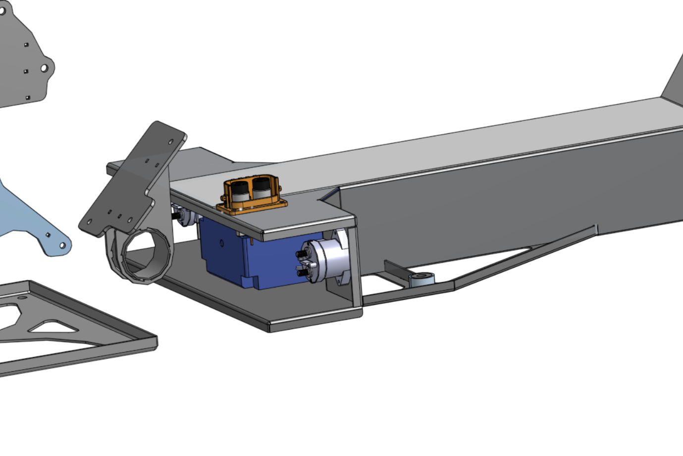

I have already removed the motor and most of the other ICE bits and dropped the subframe from the car.
I'm now designing the motor mounts so I can start building
