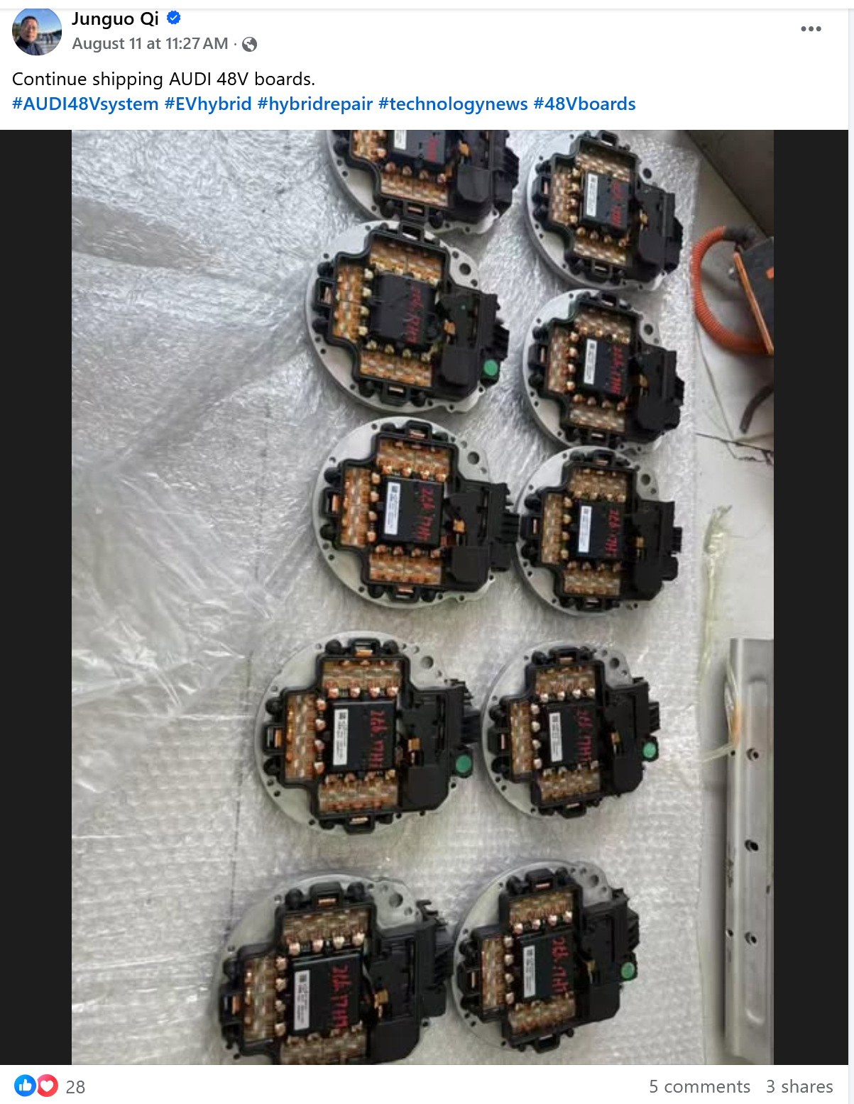

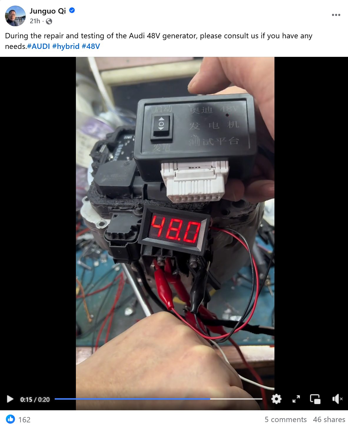

Just came across this guy on fb, thought maybe worth a share ( https://www.facebook.com/profile.php?id=61561233521299 ):

skr wrote: Wed Aug 20, 2025 12:28 am Just came across this guy on fb, thought maybe worth a share ( https://www.facebook.com/profile.php?id=61561233521299 ):
Seems to be more on the repair/testing side, but maybe it's easy to pay him to get some logs from the car.

im tempted to buy one of the following and reverse engineering it.
https://www.onlyda.com/product-p26807141.html
or
https://www.botongautoelectronics.com/p ... alternator
or
http://ebay.co.uk/itm/405899320374
might be abit quicker. from one of the videos iv seen is you can connect the alternator to VCDS to read data so will try that hopefully this week
