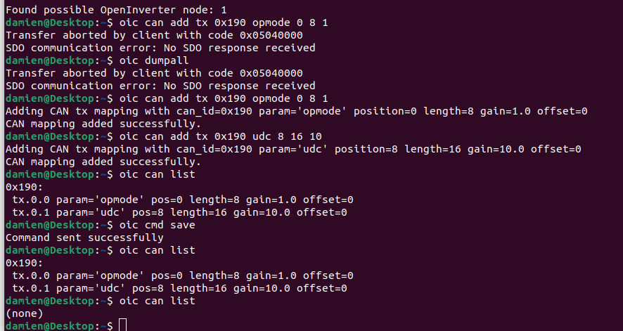

Well , yeah that solved that lol. Only thing is now we are not saving the can mappings.
Been thanked: 1913 times
So sendBuffer is 11 bytes long and any len over 8 is rejected. So len can at most be 8, hence writing to sendBuffer[i+2] is sendBuffer[7+2] is sendBuffer[9]. That looks fine.
Also sendBuffer[len+2] is sendBuffer[10], the last byte. So that is fine also. What about your data[] object?
EDIT: found the problem:
   if (hwRev == HW_TESLAM3)
   DigIo::gate_ps_en.Set();
   uDelay(200000);
   TeslaModel3::Initialize();
   LinBus l(UART4, 19200);
   lin=&l;
   linM3.SetLinInterface(lin);
Besides the naughty indentation the "l" object is destroyed after the final "}" and the Stm32Can object reuses its memory. So any calls to LinBus will operate on Can memory. Instantiate LinBus l on main() scope and you're fine

Jack Bauer wrote: Mon Aug 25, 2025 2:38 pm Well , yeah that solved that lol. Only thing is now we are not saving the can mappings.
Do you want saveable CAN mappings on both CAN1 and CAN2?
If only CAN1 it should work if you leave everything in vanilla state

Just CAN1. Sadly no luck so far even on latest libopeninv. Same on the webinterface. I can map fine now and data is sent correctly but on power cycle all mapping is lost.

CAN1_BLKNUM back at 2 and FLASH_PAGE_SIZE back at 1024?

Yep as far as I can tell am back to "standard".

So I am very very frustrated right now tbh. Five years of struggle is now coming down to this. I'm gonna walk away before I say or do something stupid. The core OI FOC runs that tesla motor so friggin sweet it sounds oem.....

1. Start openocd so that is connects to target
2. In Makefile CPPFLAGS change -Os to -Og and rebuild
3. Start debugging in CodeBlocks with F8
4. Set break point in parm_save() and check whether flash_erase_page() is called (it shouldn't)
Also check which address the parameters are saved to (return value of GetFlashAddress()
Likewise in canmap.cpp
You can dump said address by telnetting into openocd
telnet localhost 4444
and then dumping
flash read_bank 0 can_and_parameters.bin 0x1F800
Of course you need to use the address obtained when debugging canmap.cpp minus 0x08000000
Attach it here

I've been making progress of sorts with the CAN mapping issue (thanks for the STM32 board loan Damien).
The good news is that the M3_DU_experimental branch has working CAN mapping and param/map saving. This works via the ESP8266 serial web interface or openinverter_can_tool.
The bad news is I have not been able to replicate the failures as described above with any branch of the MG_DU or M3_DU code. The only fix the M3_DU_experimental branch required was to the LIN initialisation.
My M3_DU_experimental branch has binaries available which can be upgraded via CAN or serial. I have tested these thoroughly with opmode in "Off".
Some notes:
  • OpenInverter CAN Tool needs to be upgraded to v0.4.1 to have "can clear" and "can import" work properly. I released that version this morning.
  • I spent much of last week chasing down a horrible LIN checksum bug that causes random data loss. The code has been tested with a LIN oil pump simulator that verifies correct operation of the integration. So much work to change a ">" to ">=".
  • Please use the v1.3 CAN bootloader if you plan on using more than one OI board on the same CAN bus. You'll thank me later.
