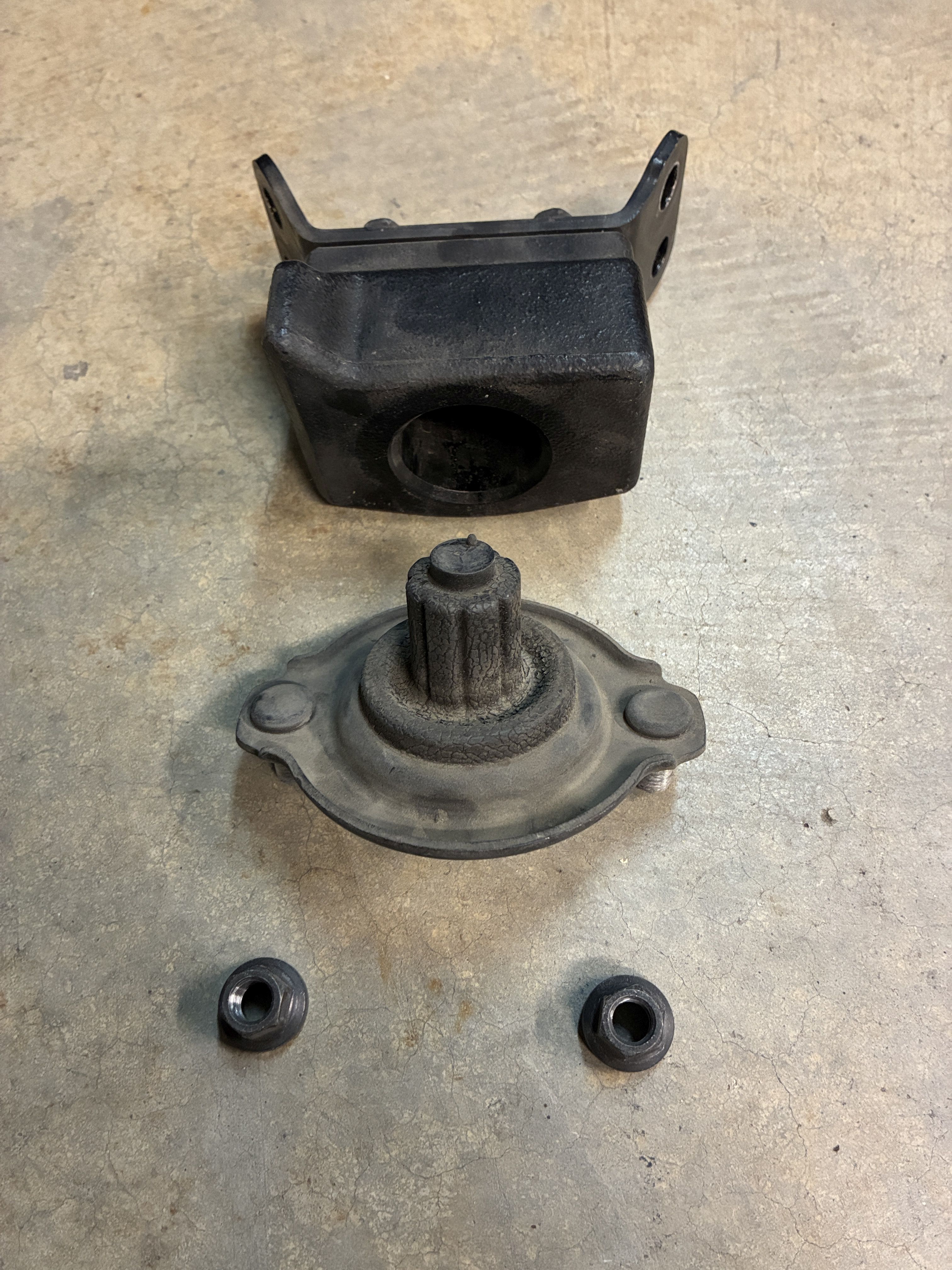

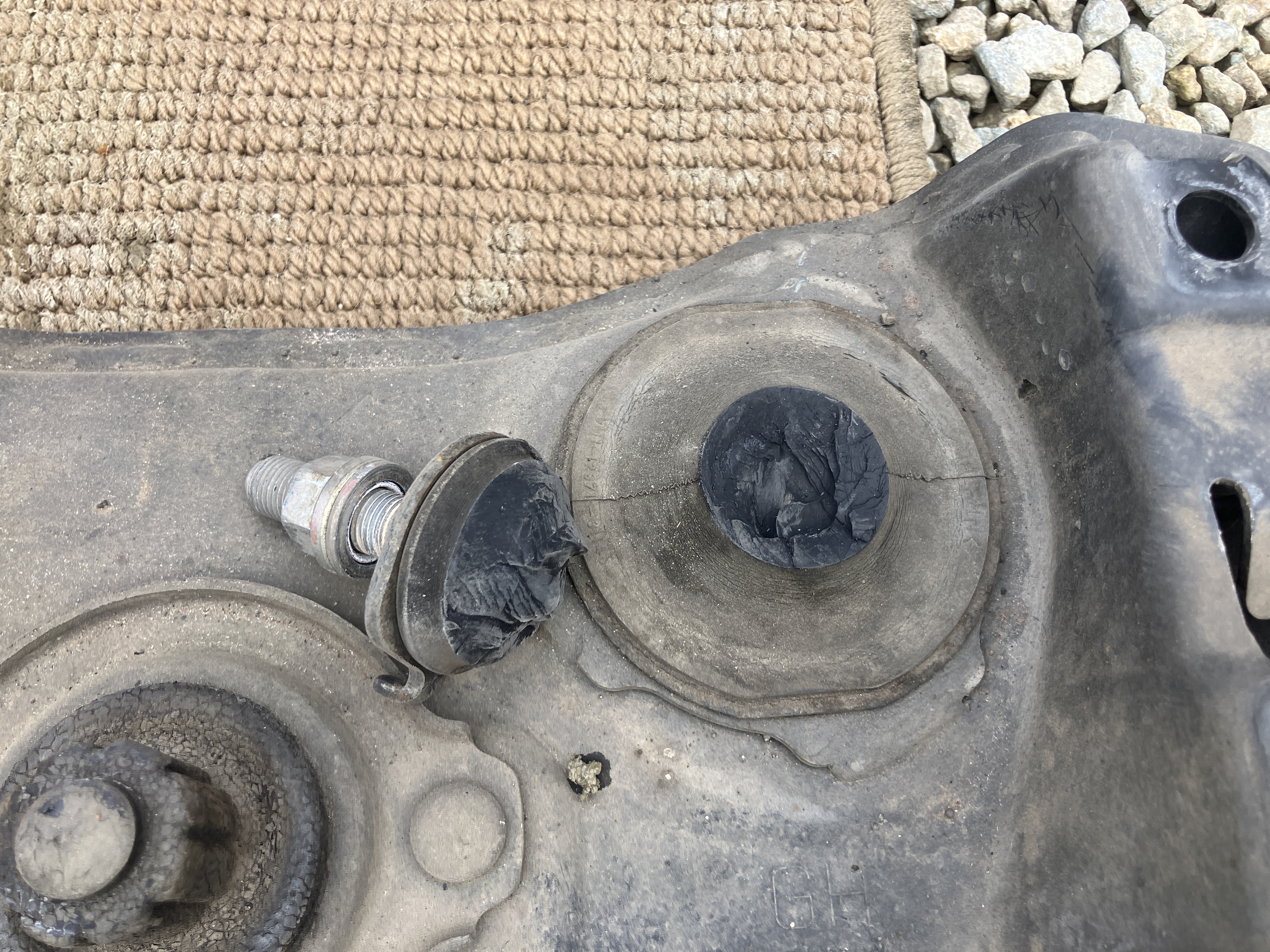

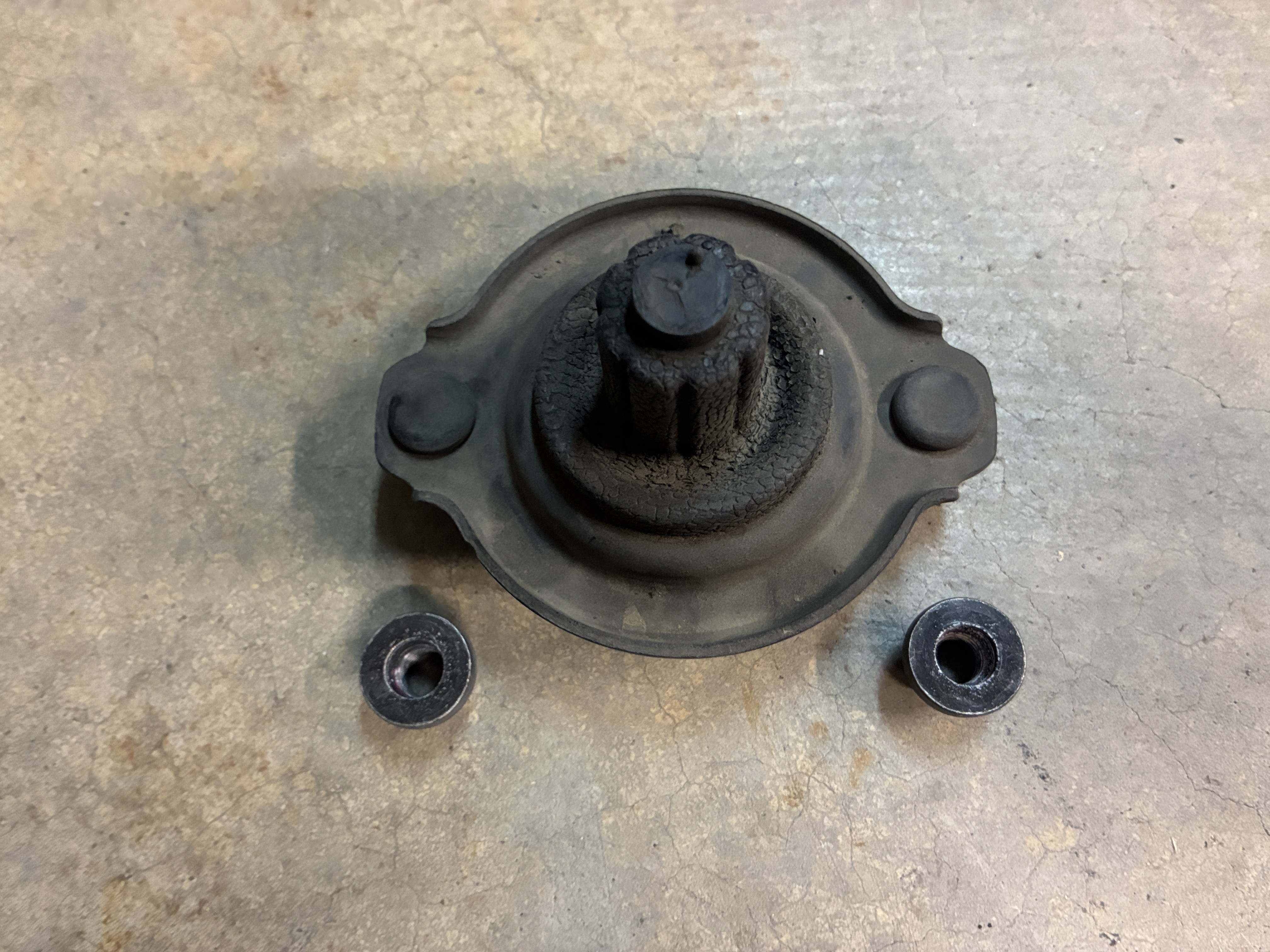

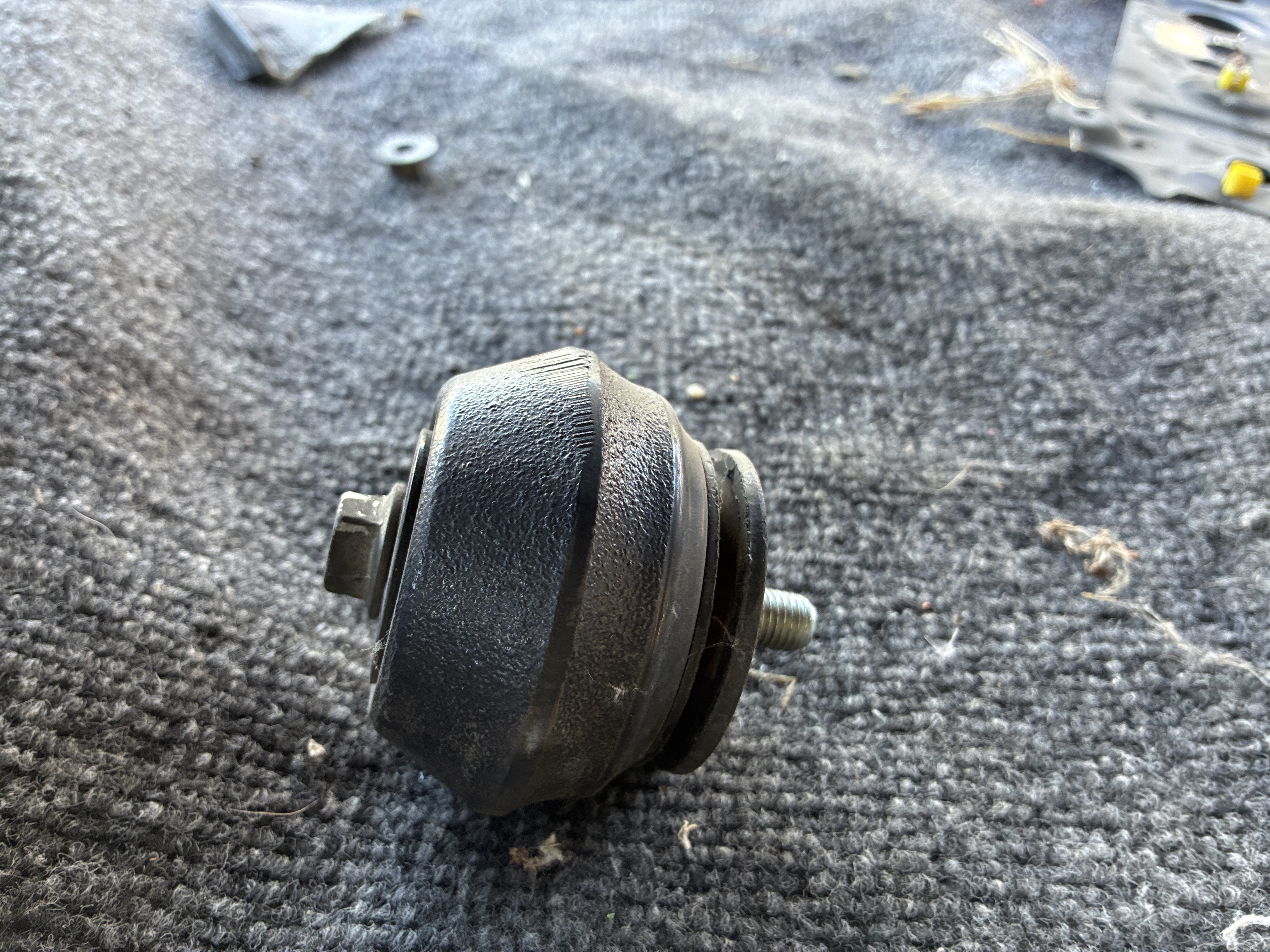

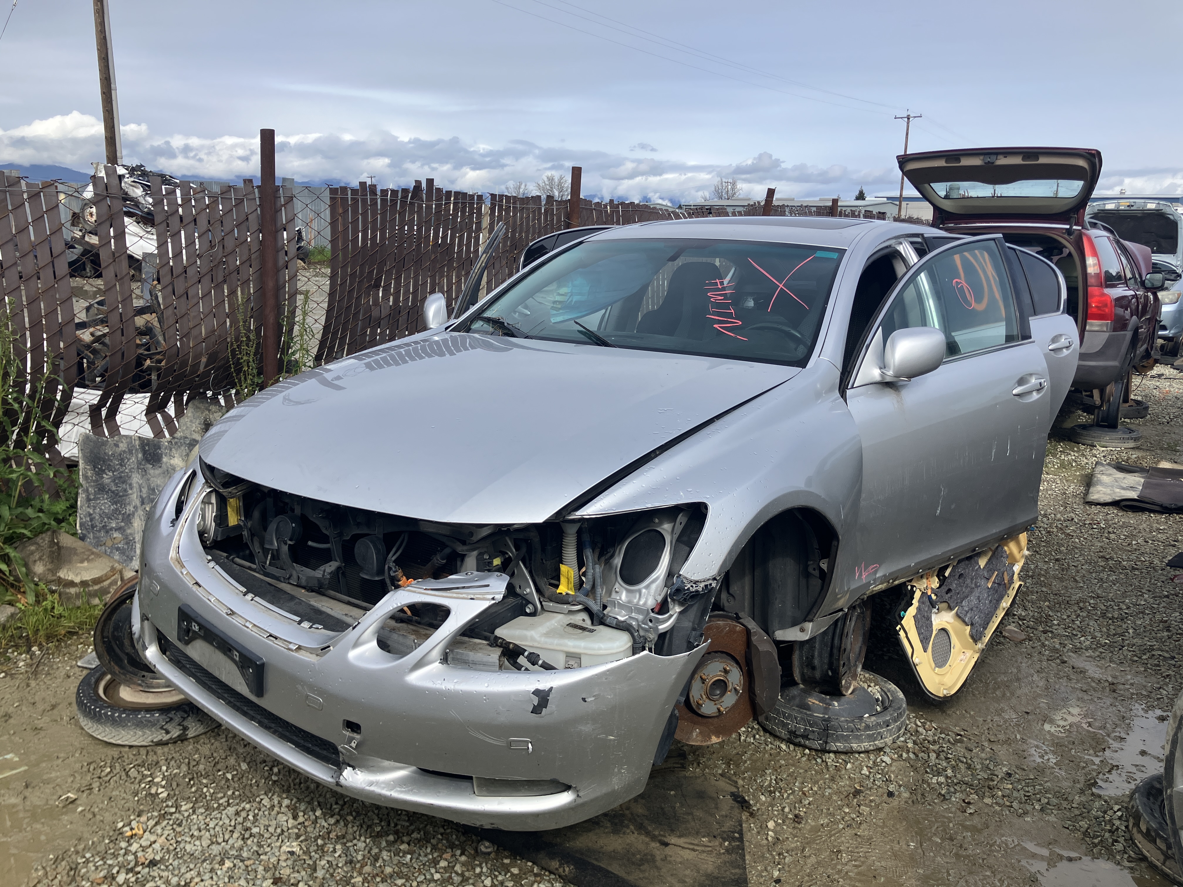

I believe this was my first attempt at sourcing the crossmember, I drove 3 hours to find this car in a junkyard that allows you to pull your own parts, and at first I thought I damaged the rubber bushings on this transmission crossmember during the uninstallation process, but as you will find out in later posts these happen to be common failure points for this part

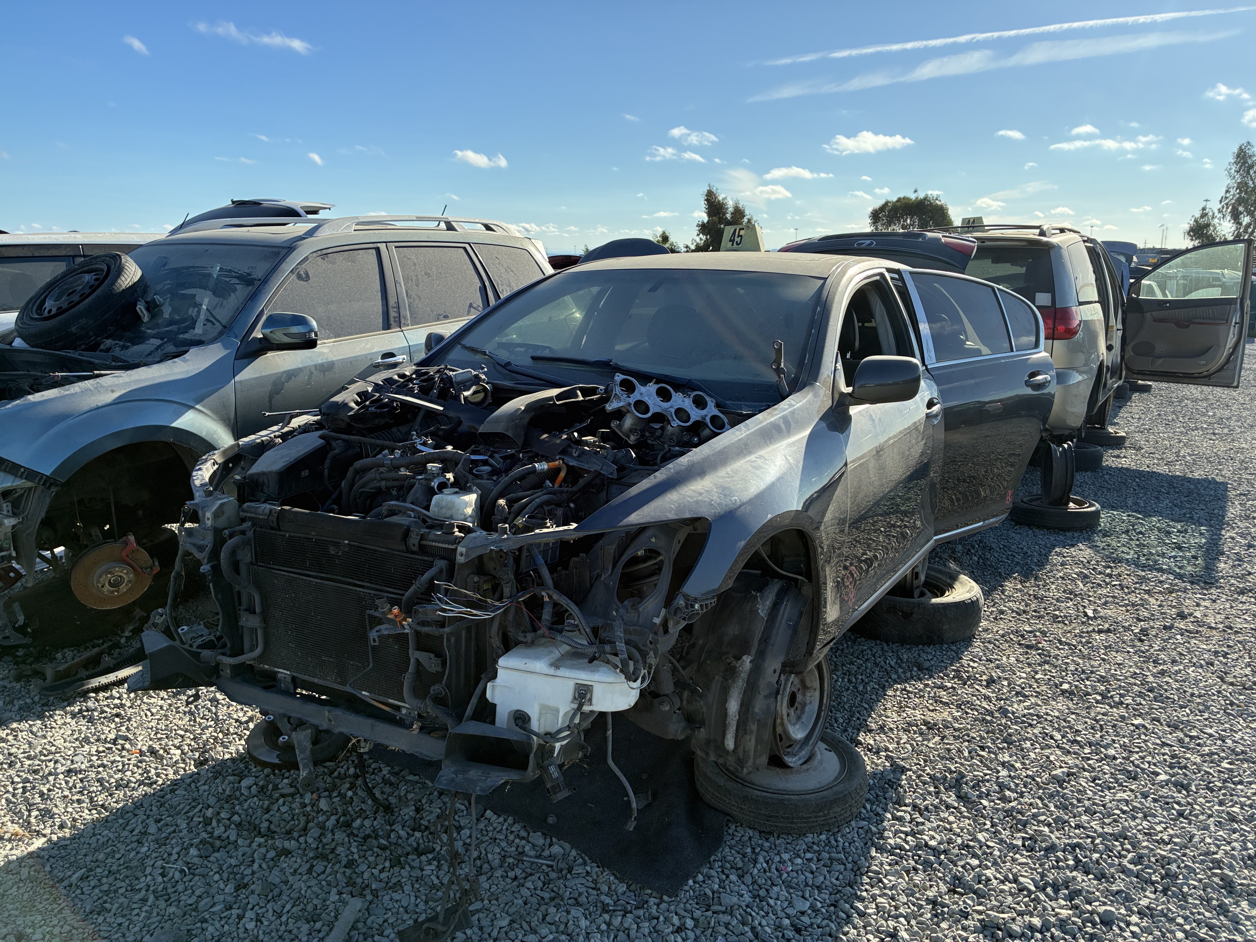

Re: Junkyard Report: 2007 Lexus GS450h - OEM Transmission Crossmember

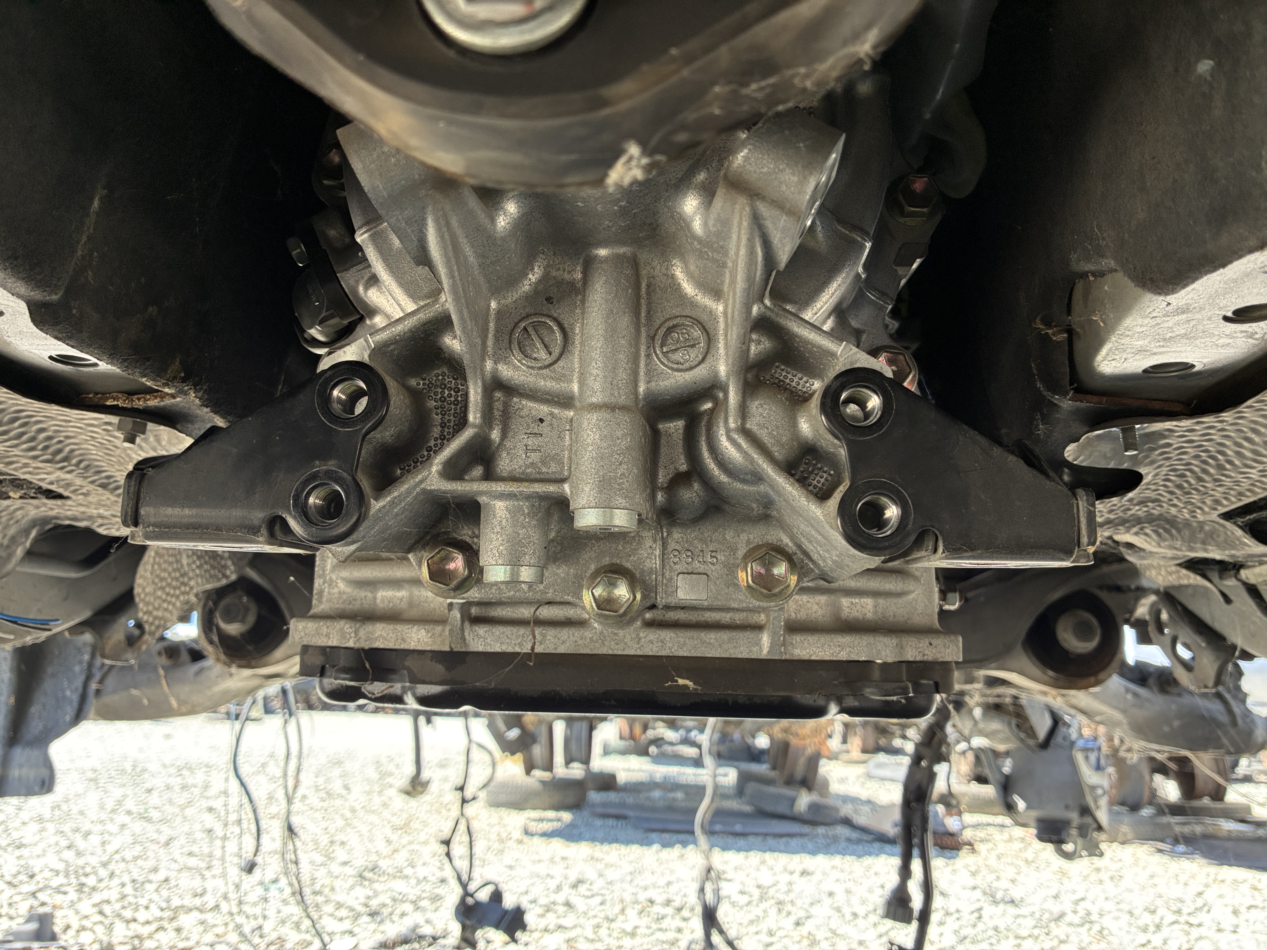

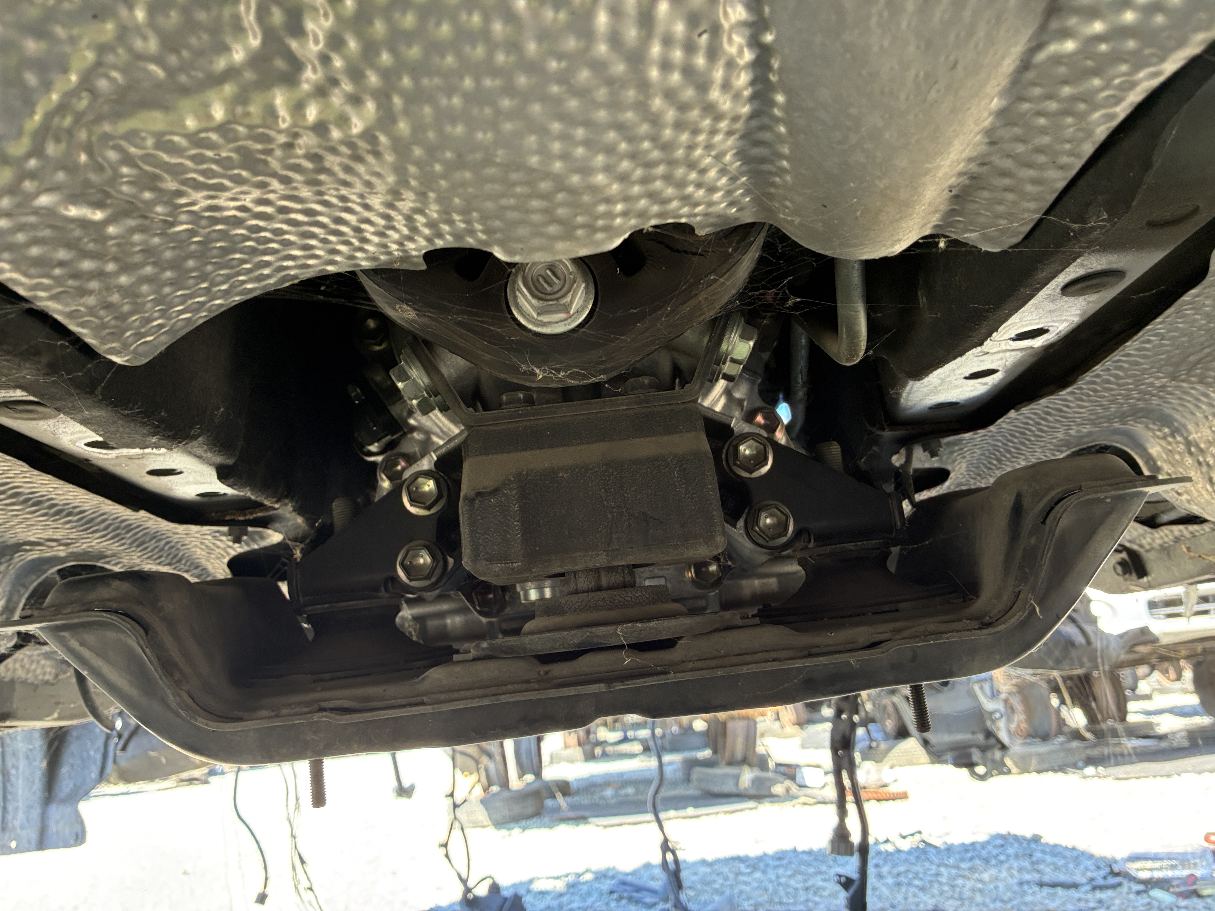

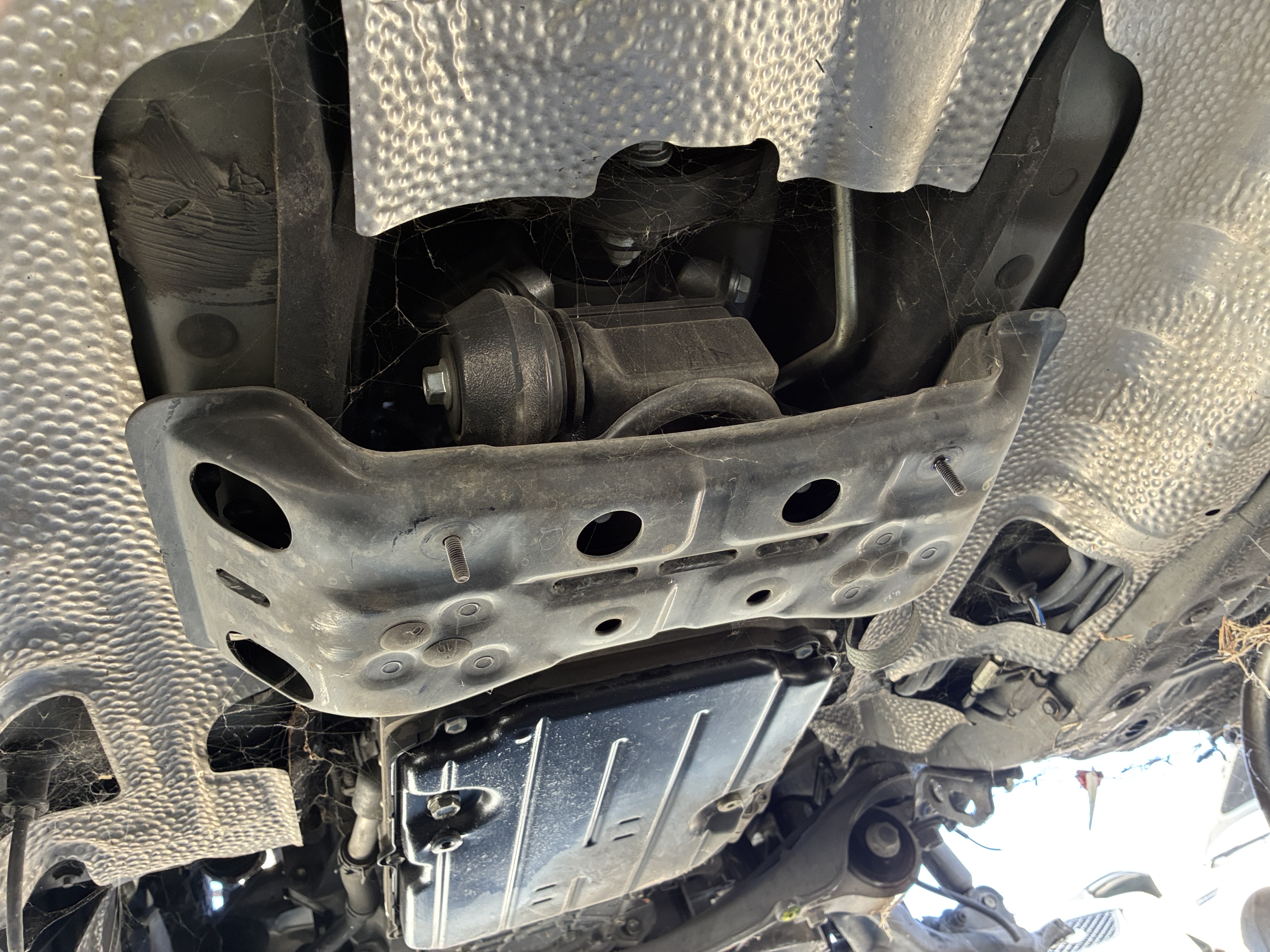

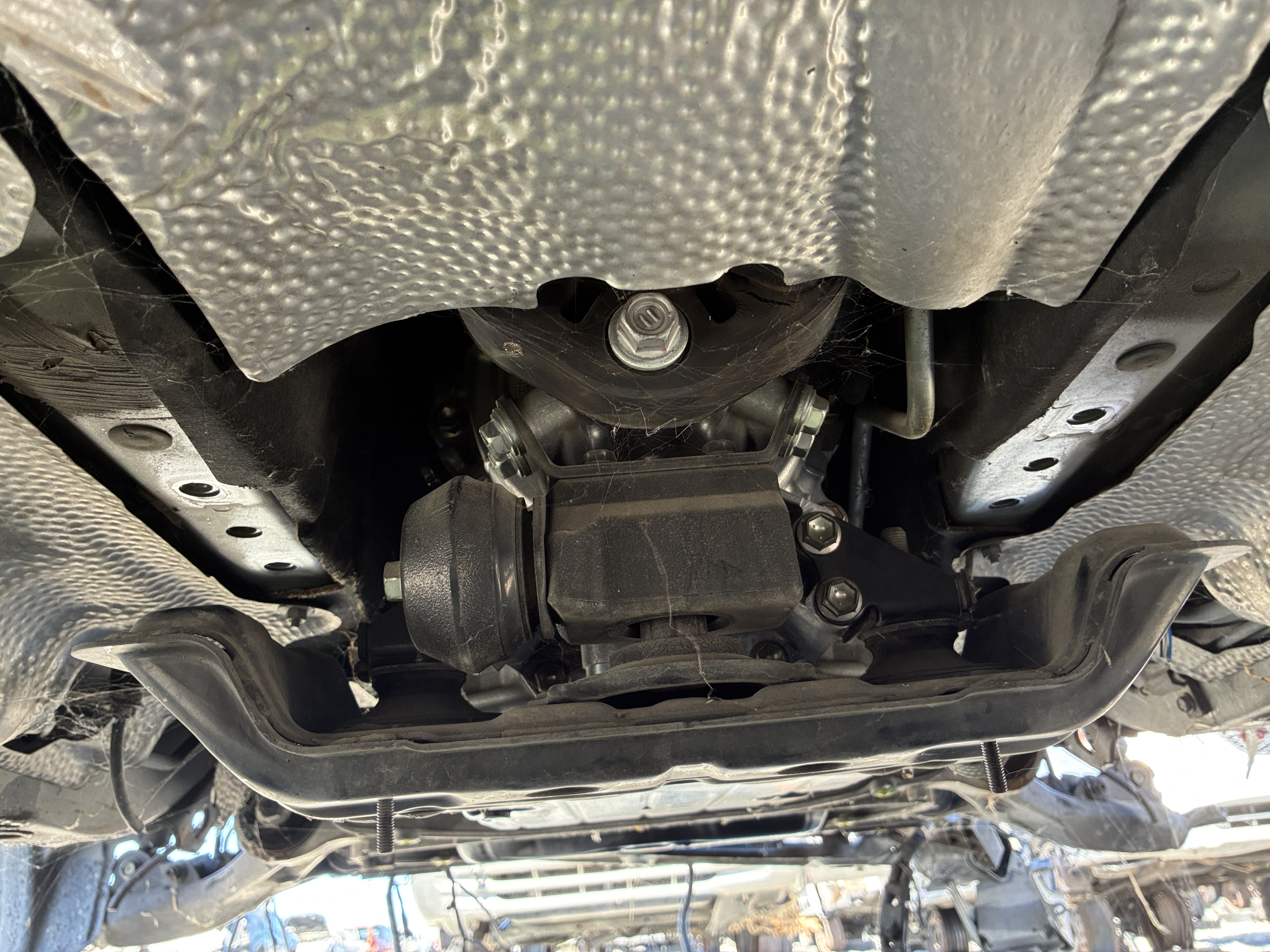

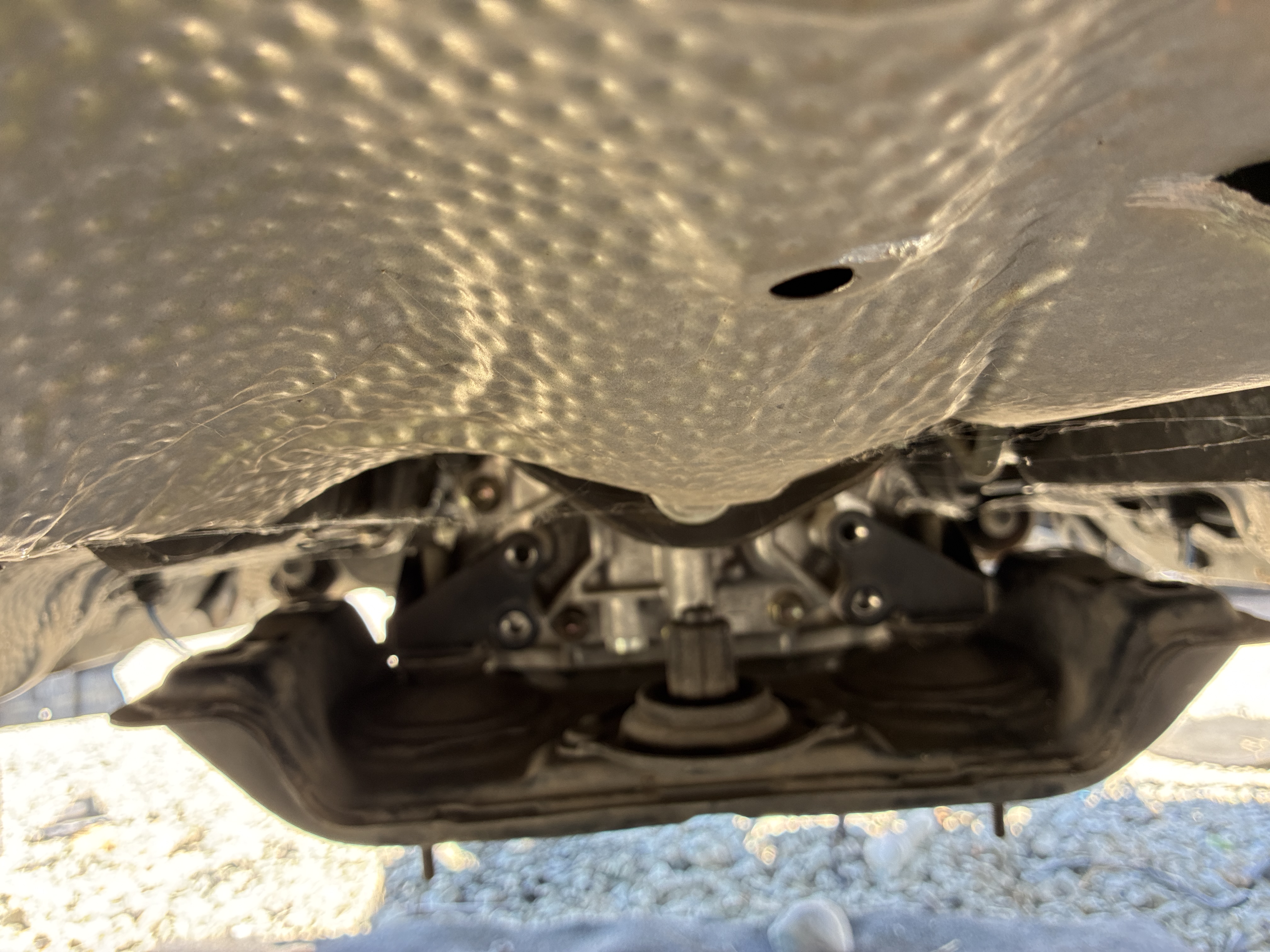

so first just a general observation all of the GS450h's I have seen in the yard as of this writing have been the first year 2007 models, well at least it's good to see them finally hitting the yards so we can harvest them for parts

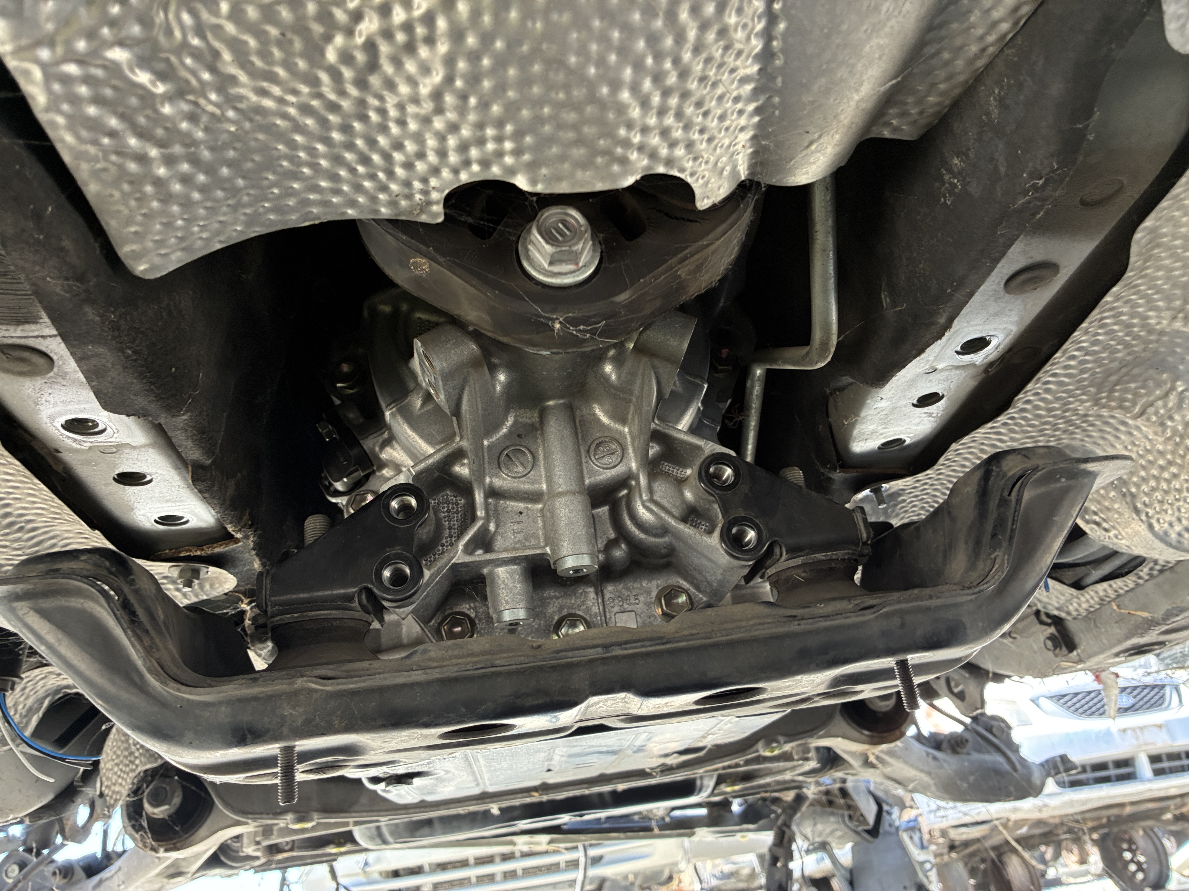

here is the 4th one I came across that finally had a good crossmember
sorry, it is rather difficult to take pics whilst crawled under the belly of the beast
- Gregski
- Posts: 3158
- Has thanked: 630 times
- Been thanked: 1607 times

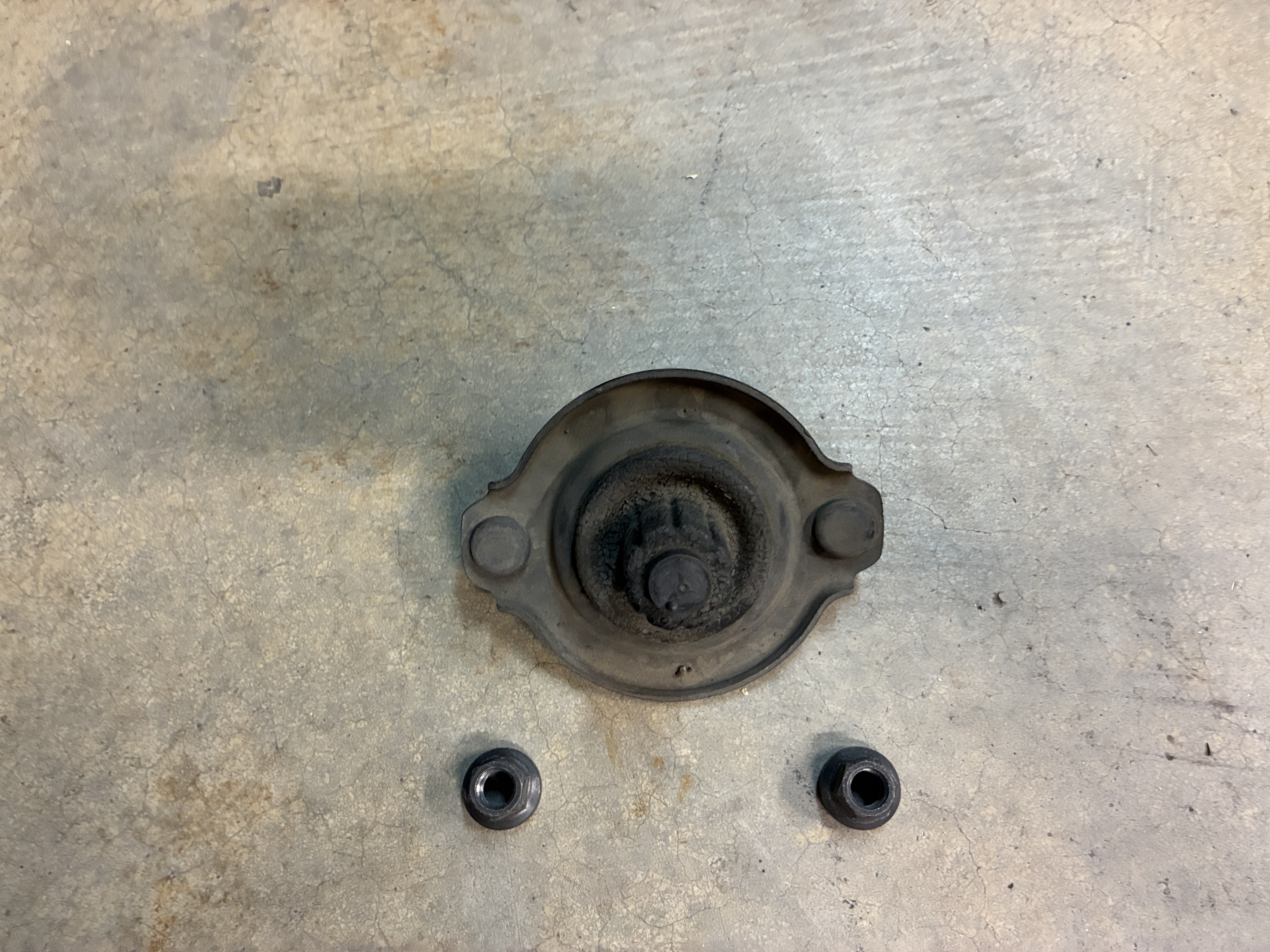

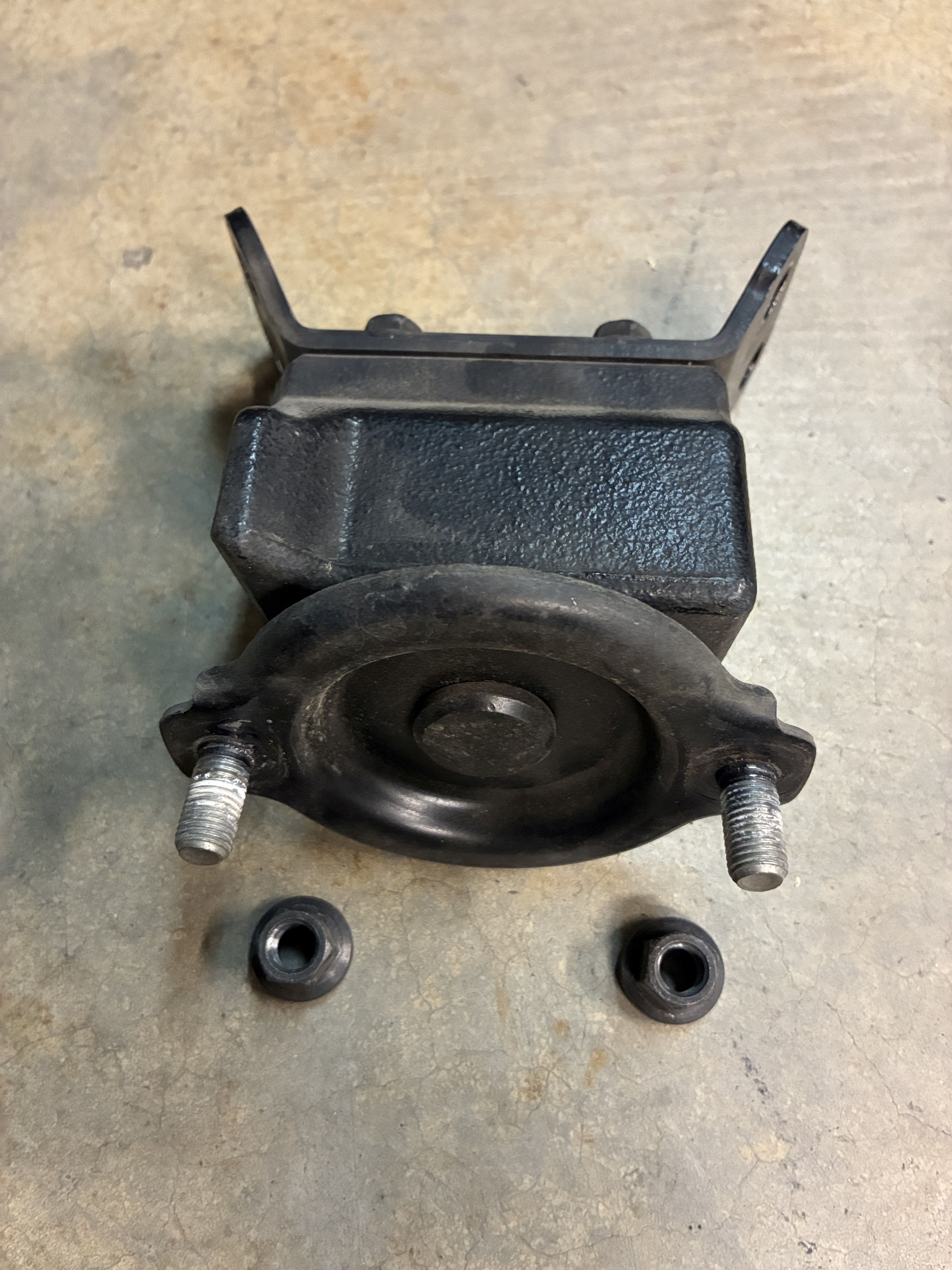

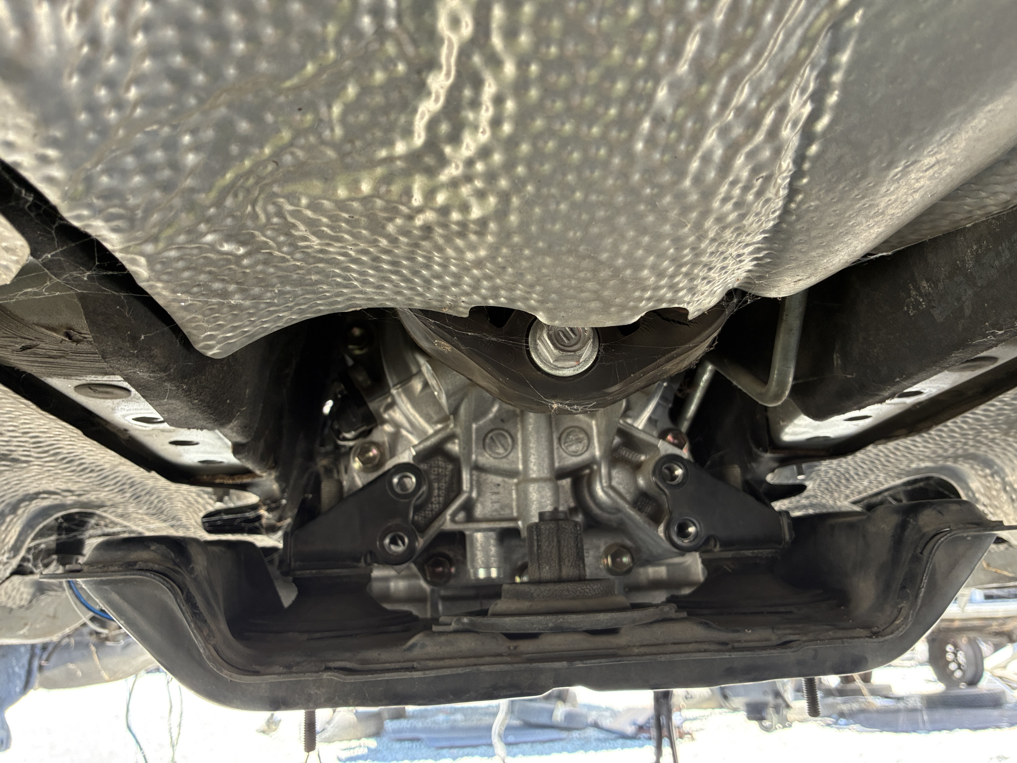

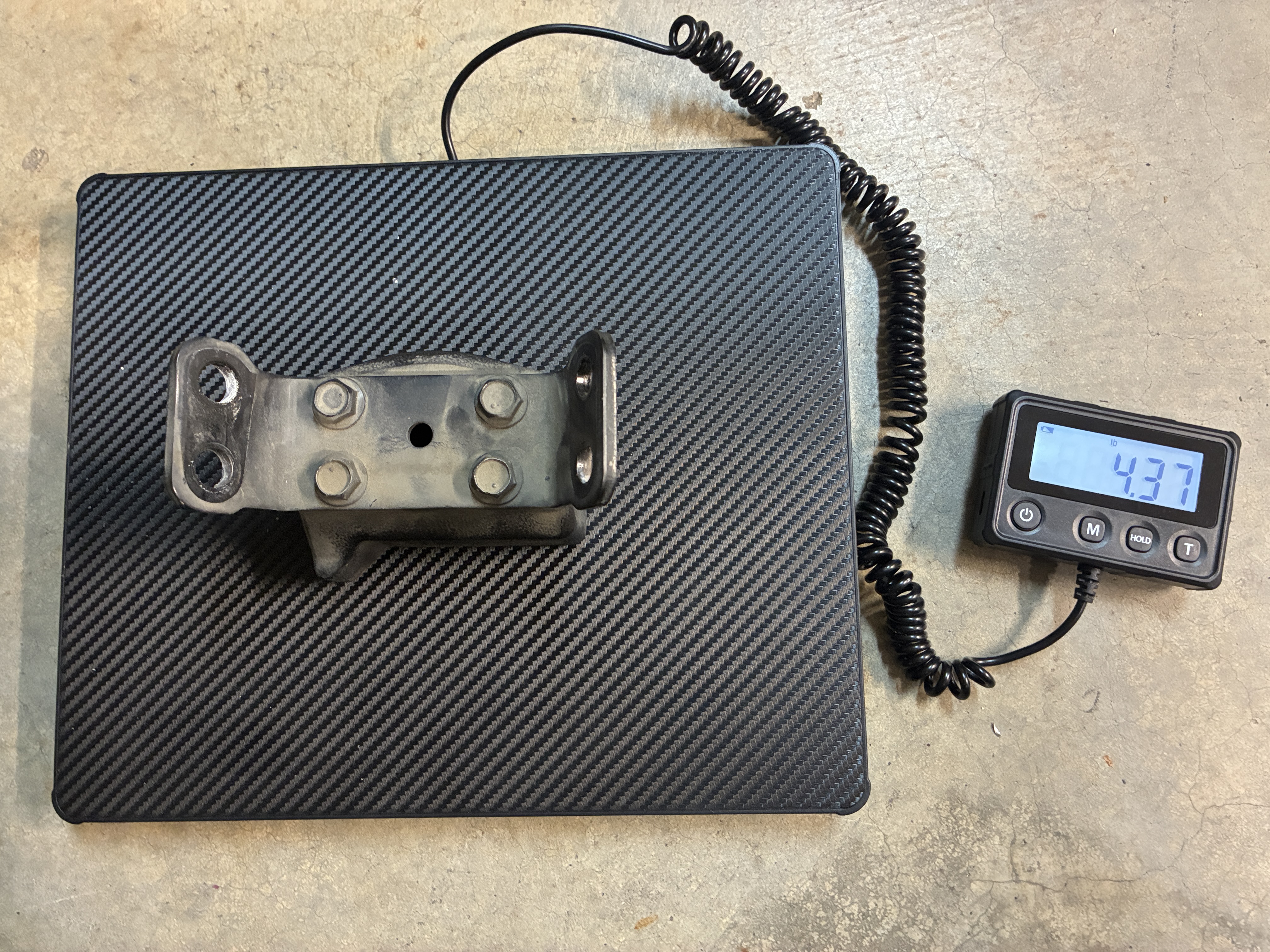

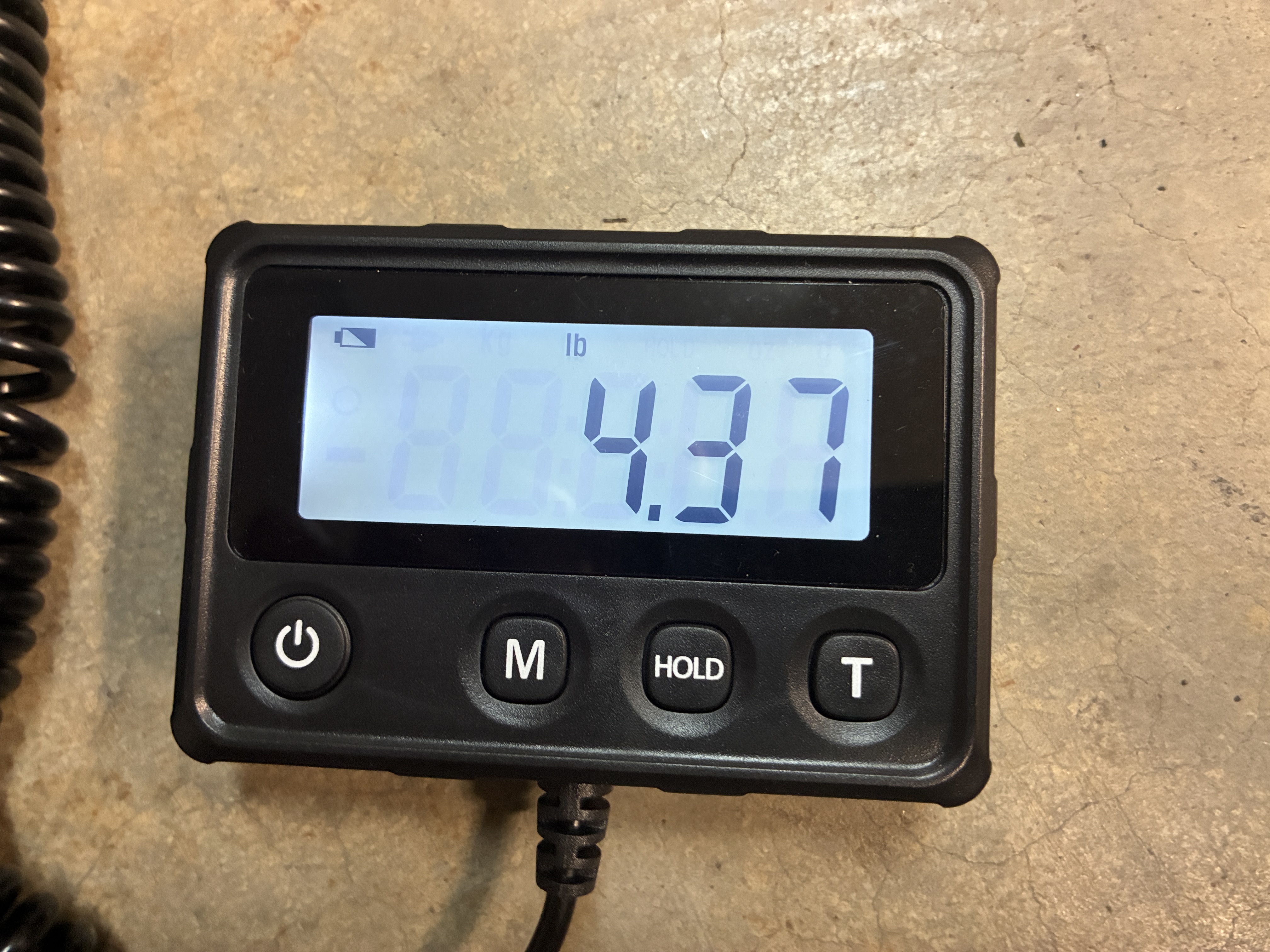

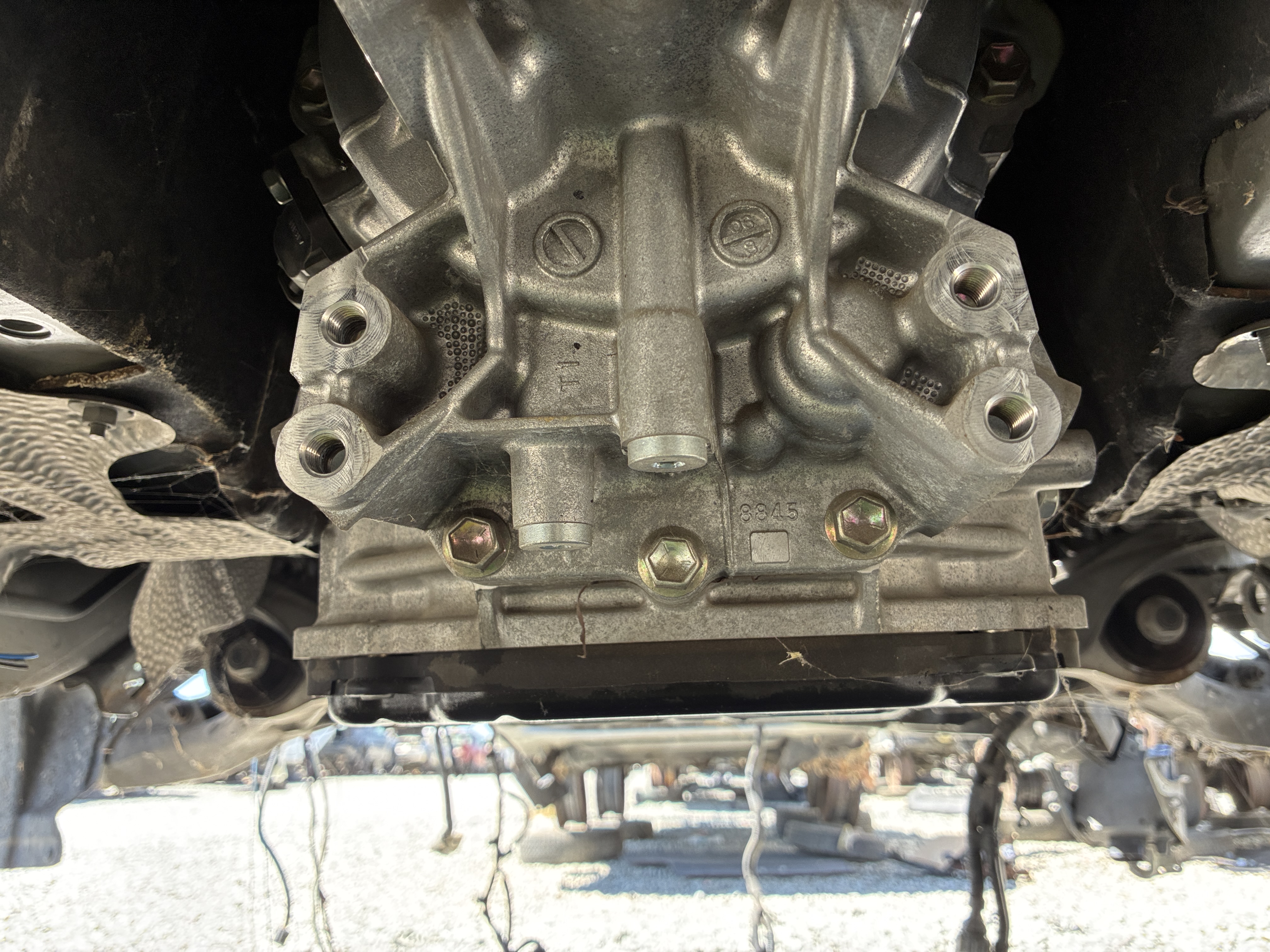

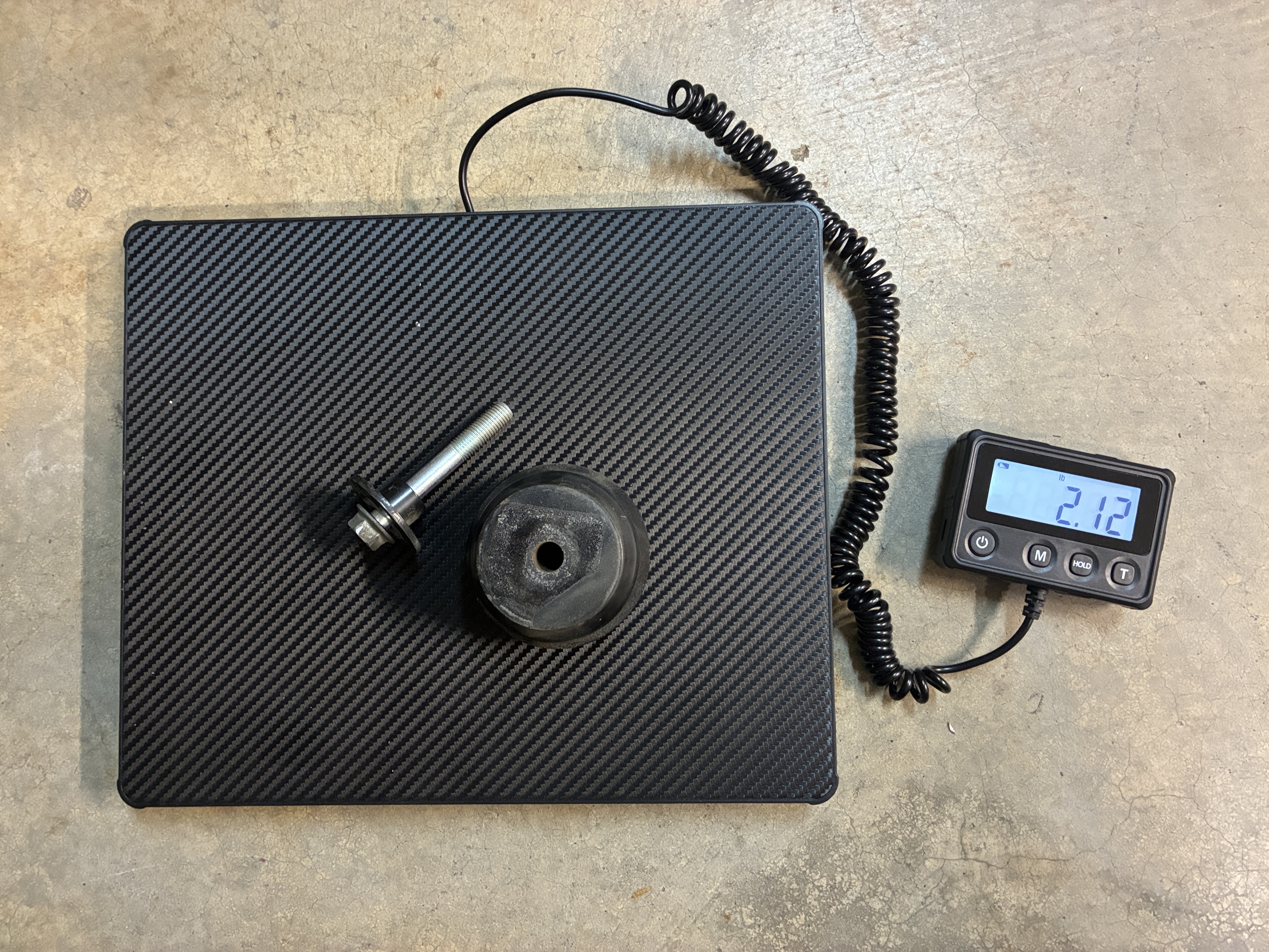

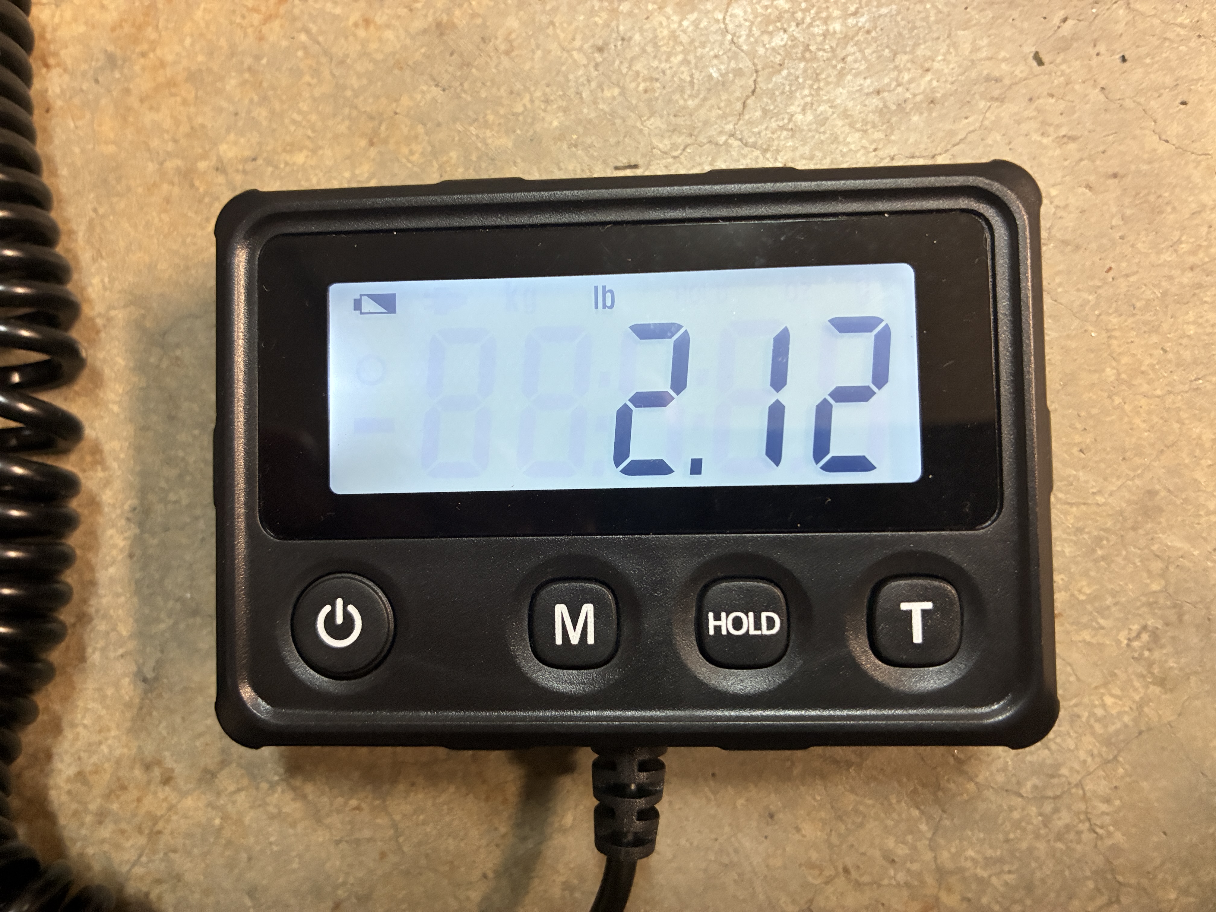

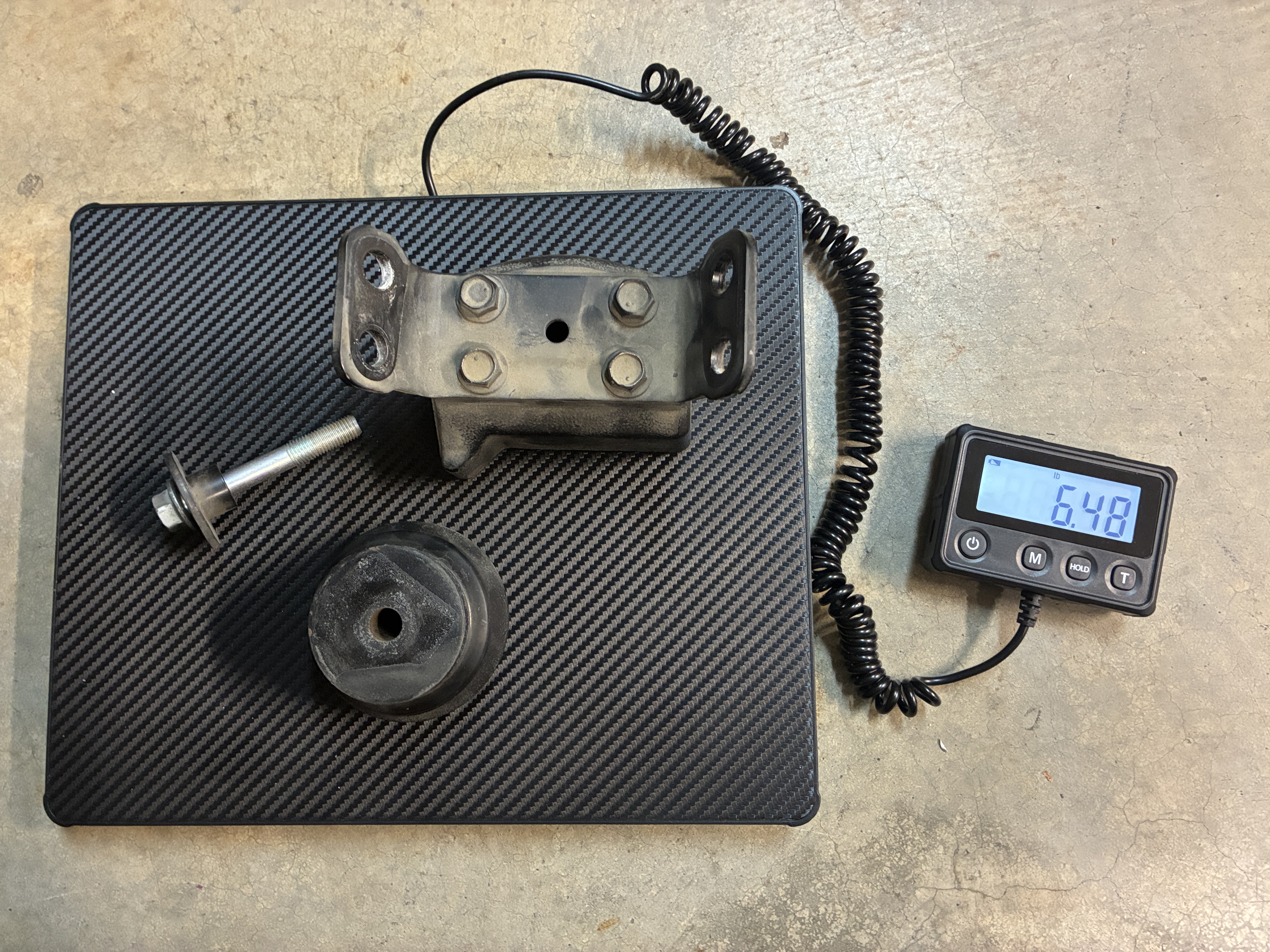

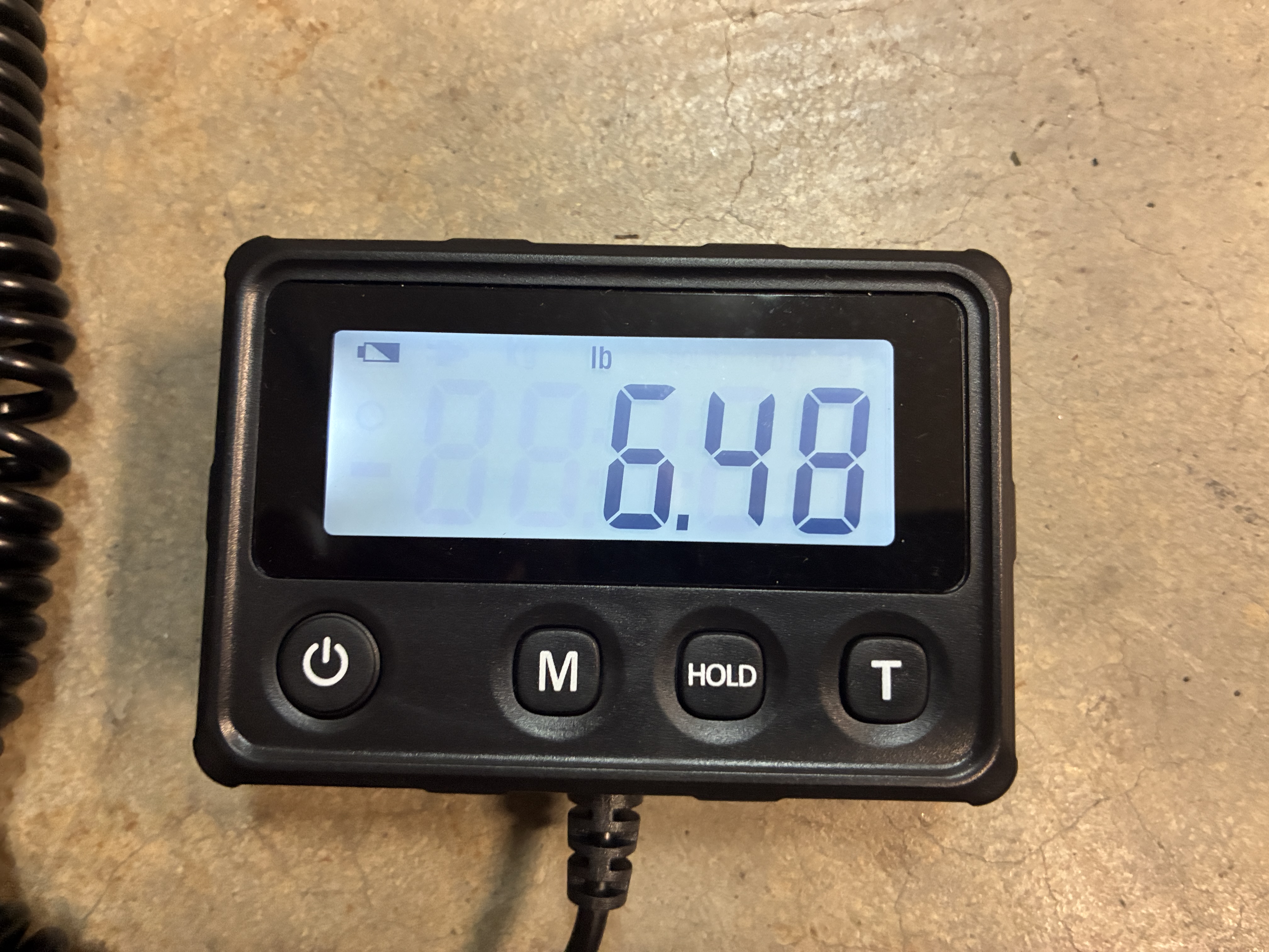

so she's held on to the gearbox with quite a few 14mm bolts, and you'll notice on the left hand side here I had to first remove this 2 pound weight in order to expose two of them
which brings us to the first question: She we be running this bracket with the stock weights? I am not doing so in my truck as I am of the mindset that it is the engine that's responsible for majority of the vibrations and now that we eliminated that violent component in our EV conversions I do not see a reason for keeping the extra weight. What say you?

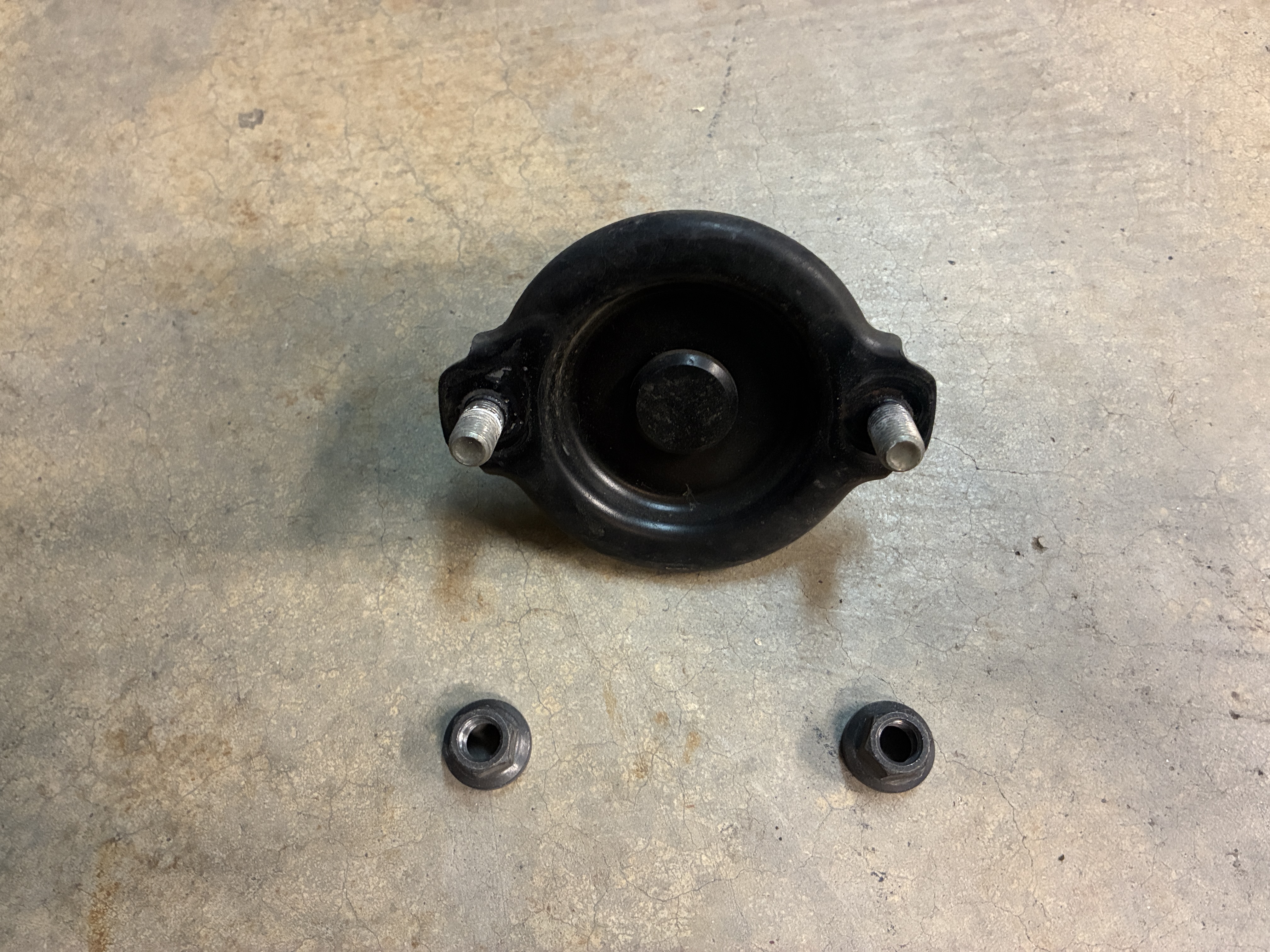

so lets Science:
this part as you will see later is more than just a ballast it is hallow underneath and accepts yet another rubbarized peg like piece which is then attached to the crossmember
so lets Science:

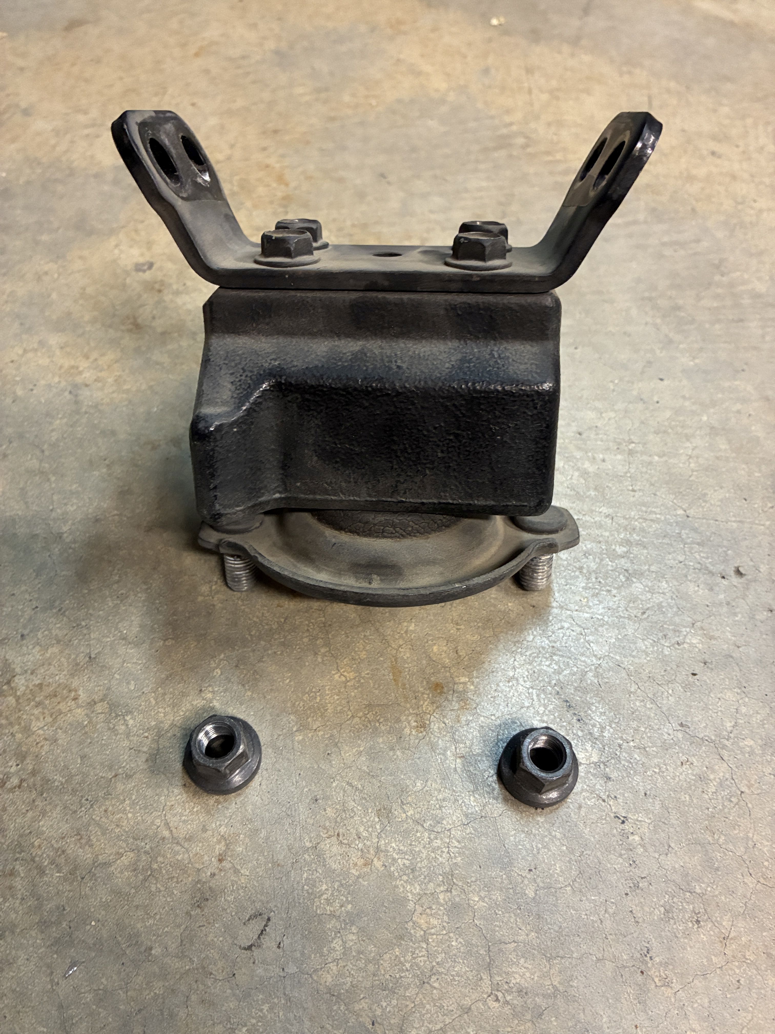

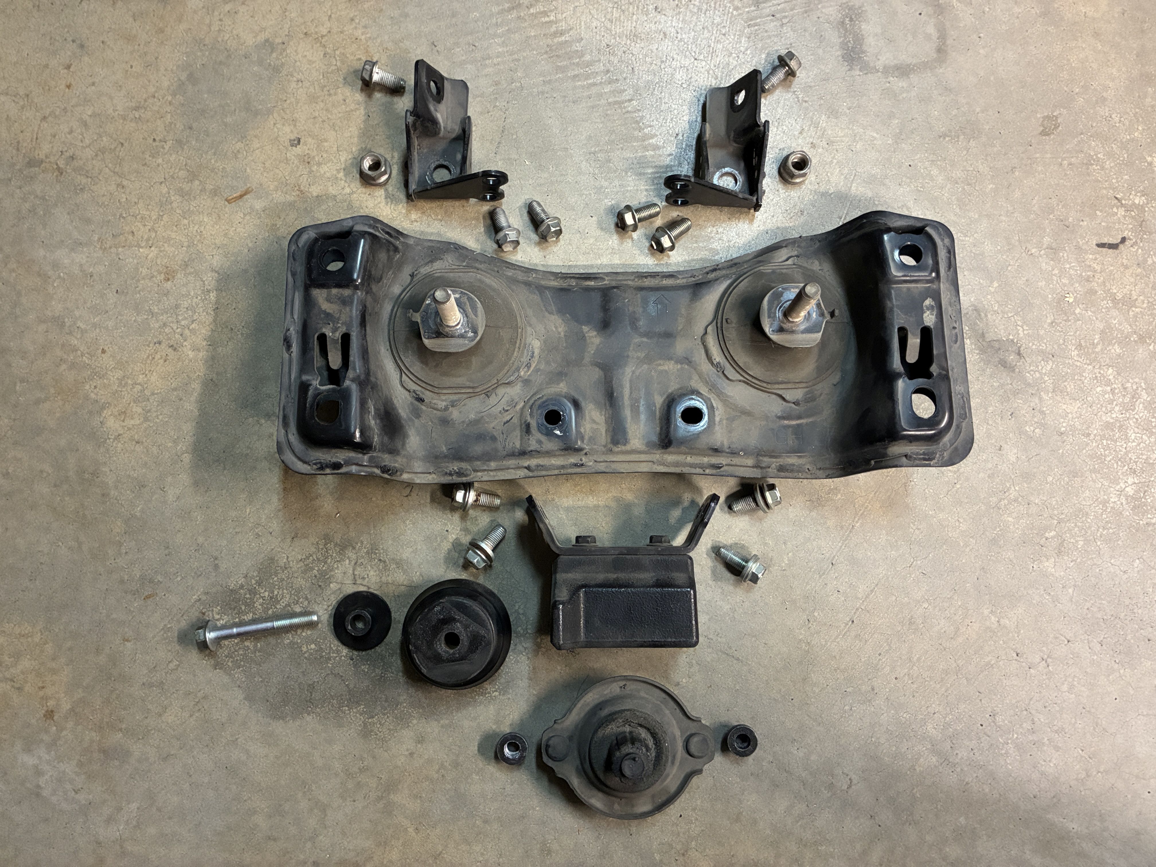

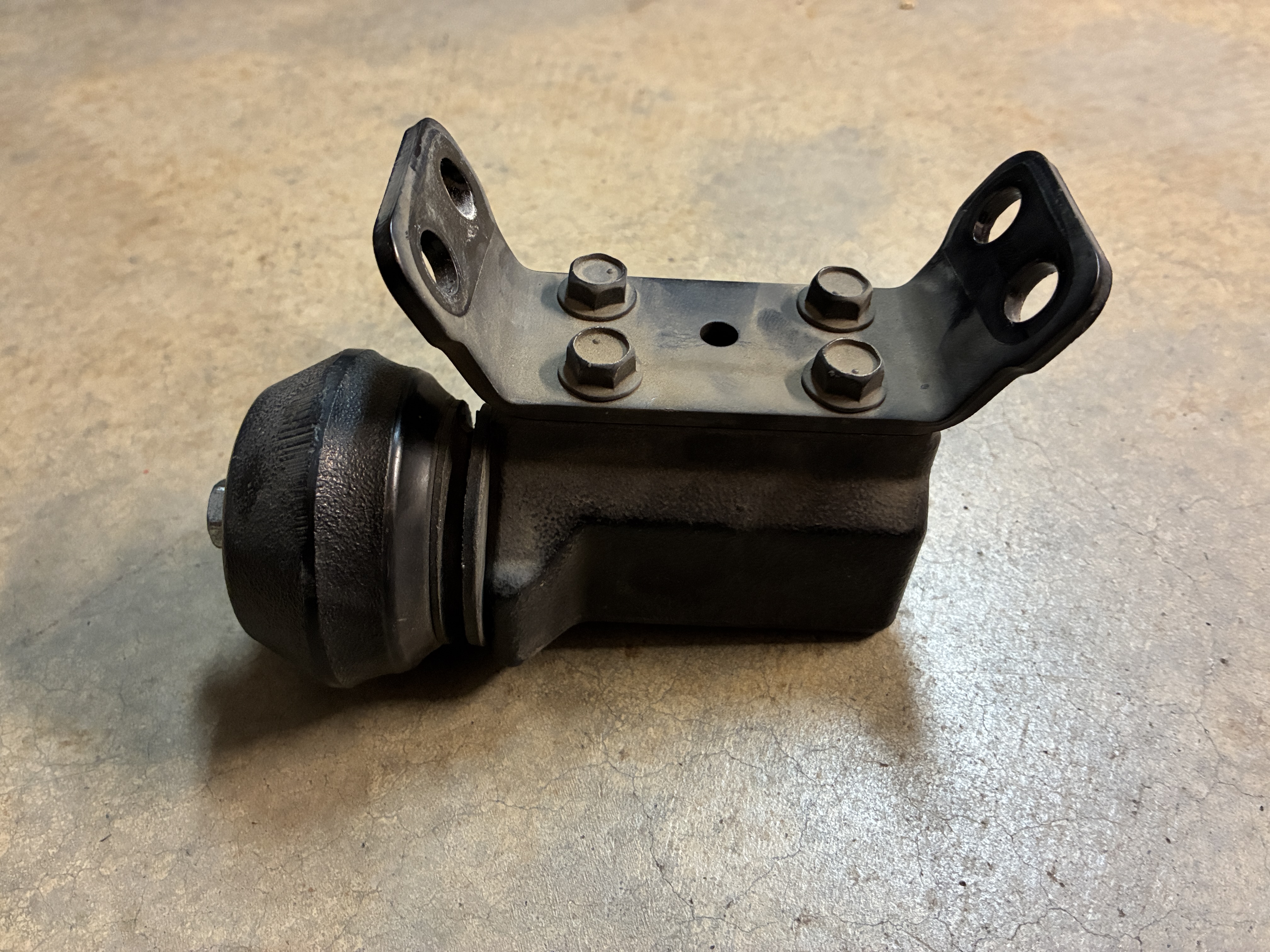

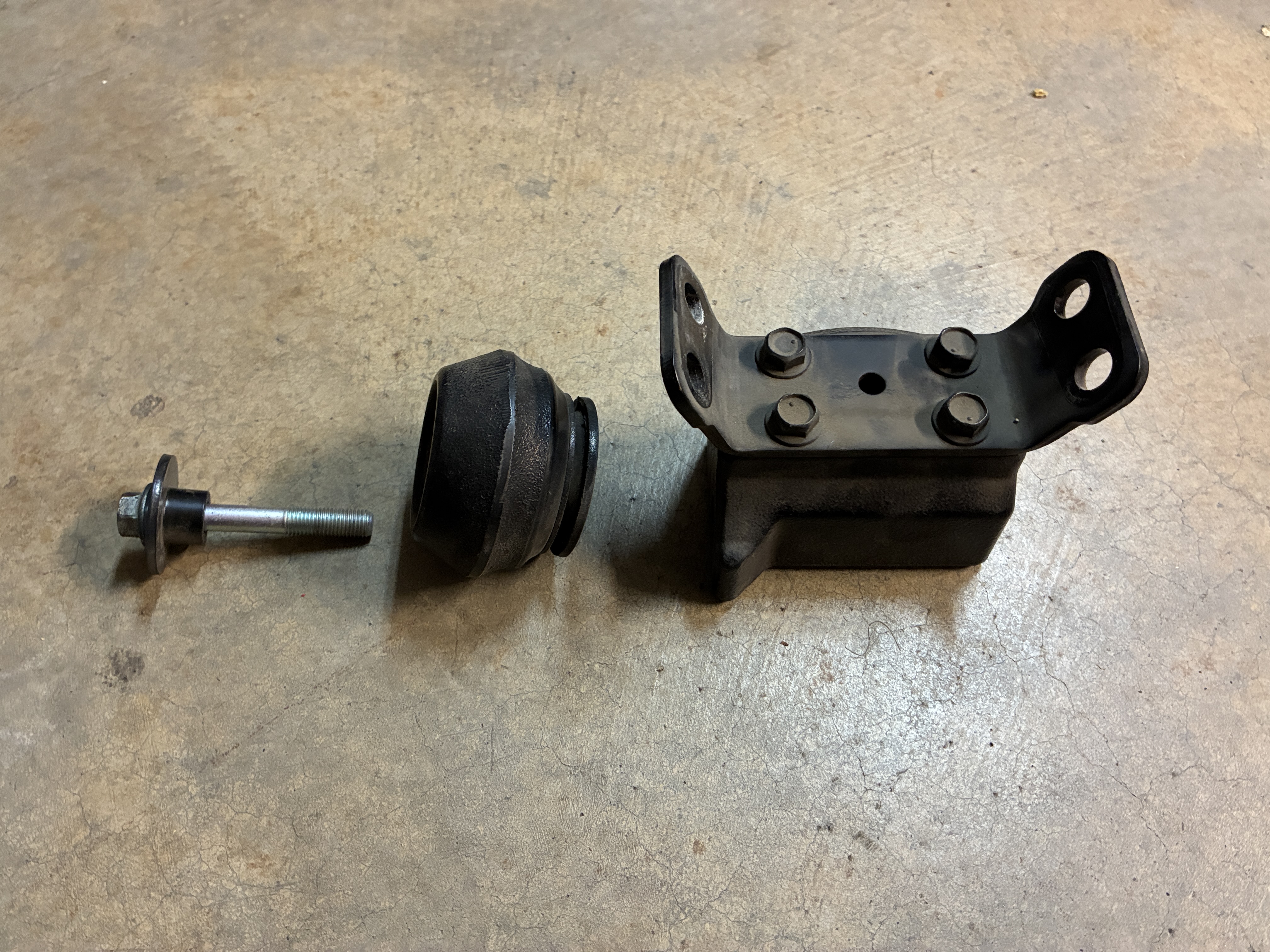

so with that dude out of the way we press on, and yes you will find out this contraption is made up of half a dozen separate pieces, doodads, and thingmajigs

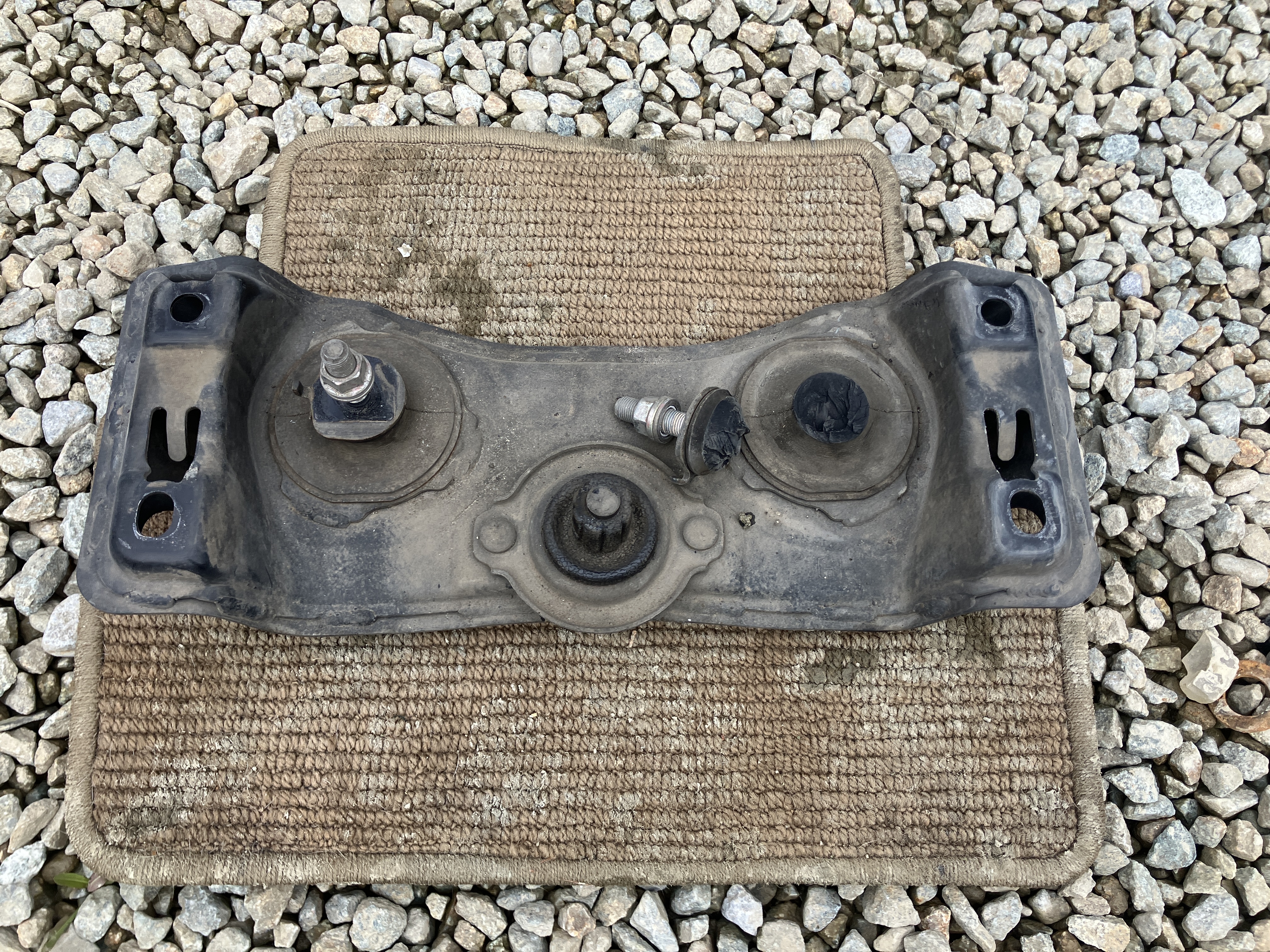

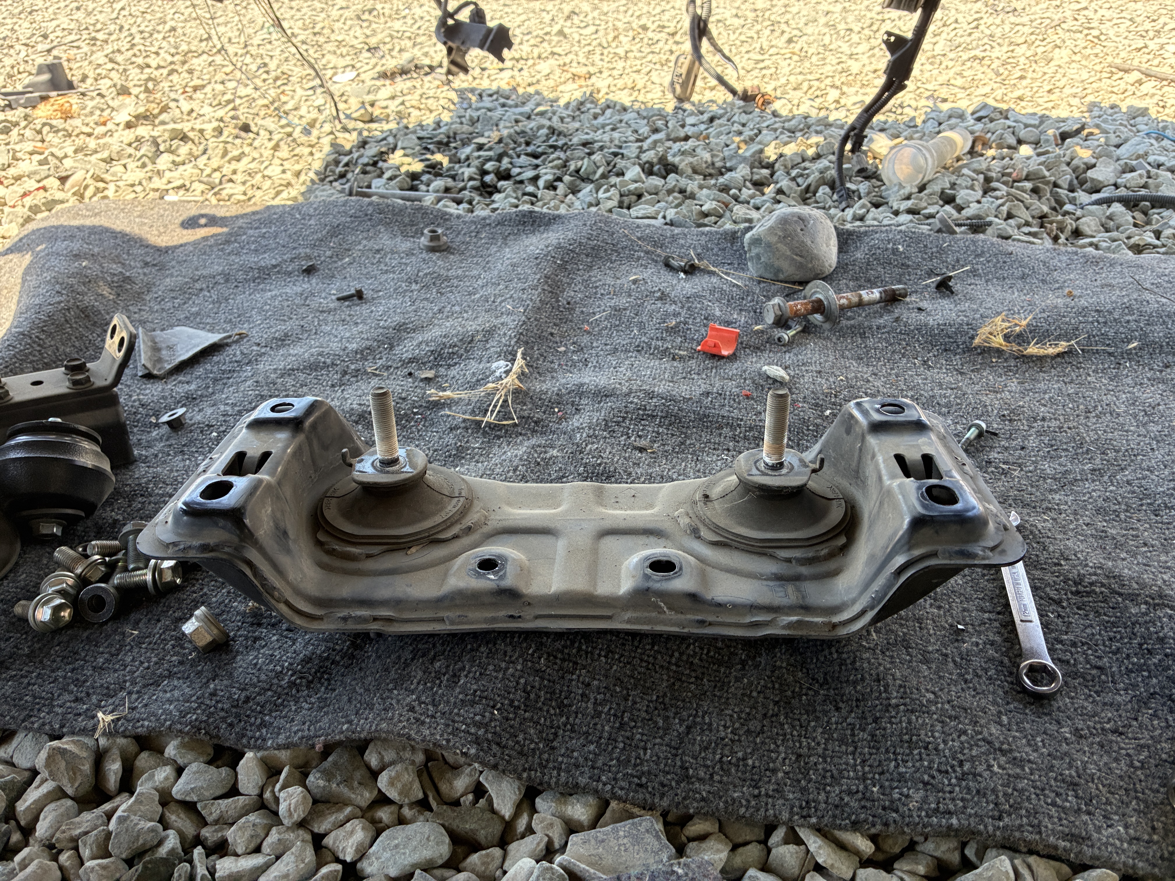

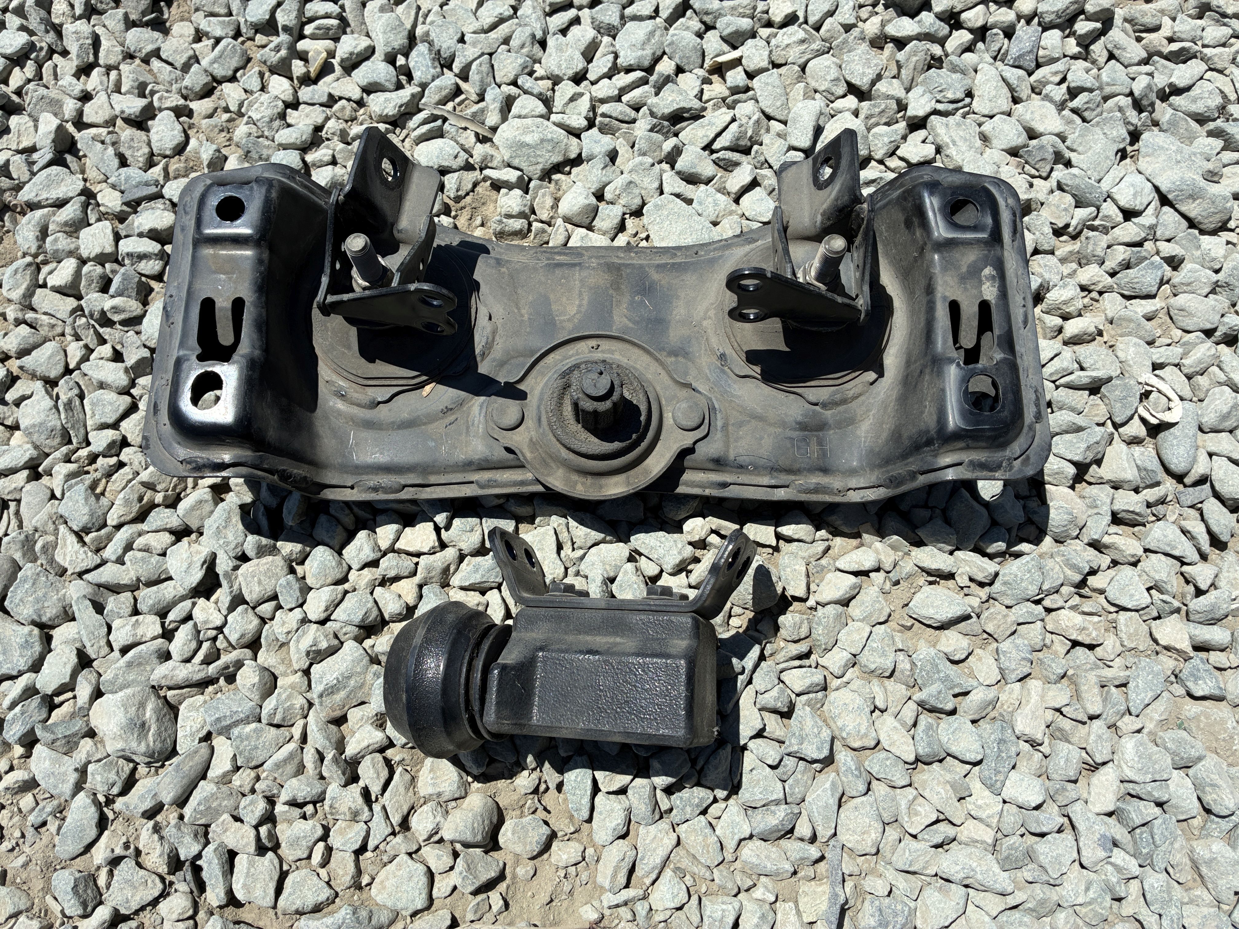

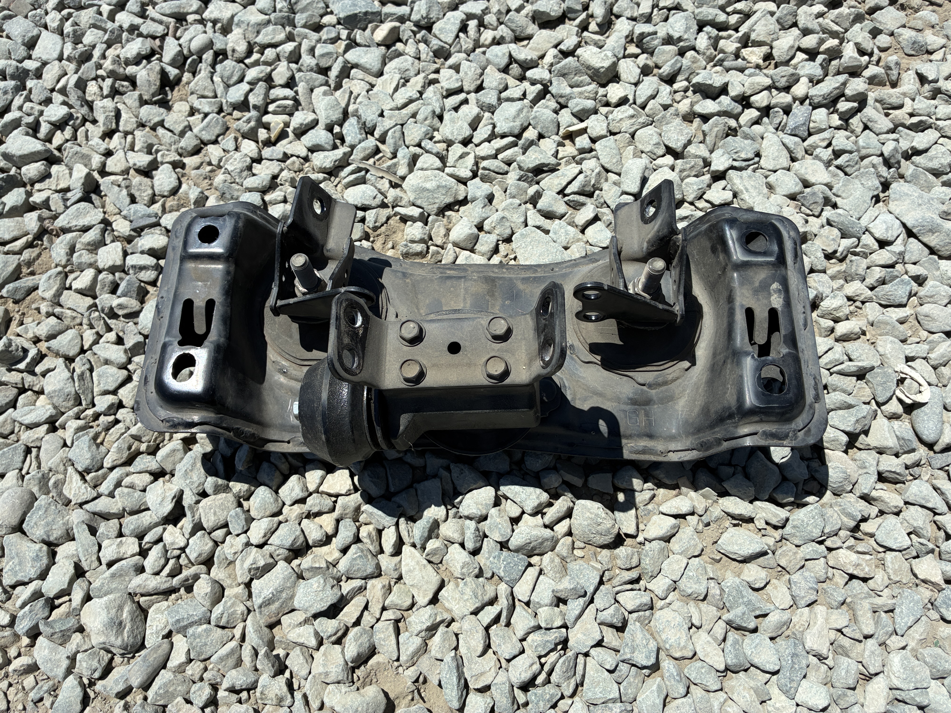

and here it is liberated
I plan to give it a proper bath and then post more pics of each of the individual brackets as well as specs/measurements
