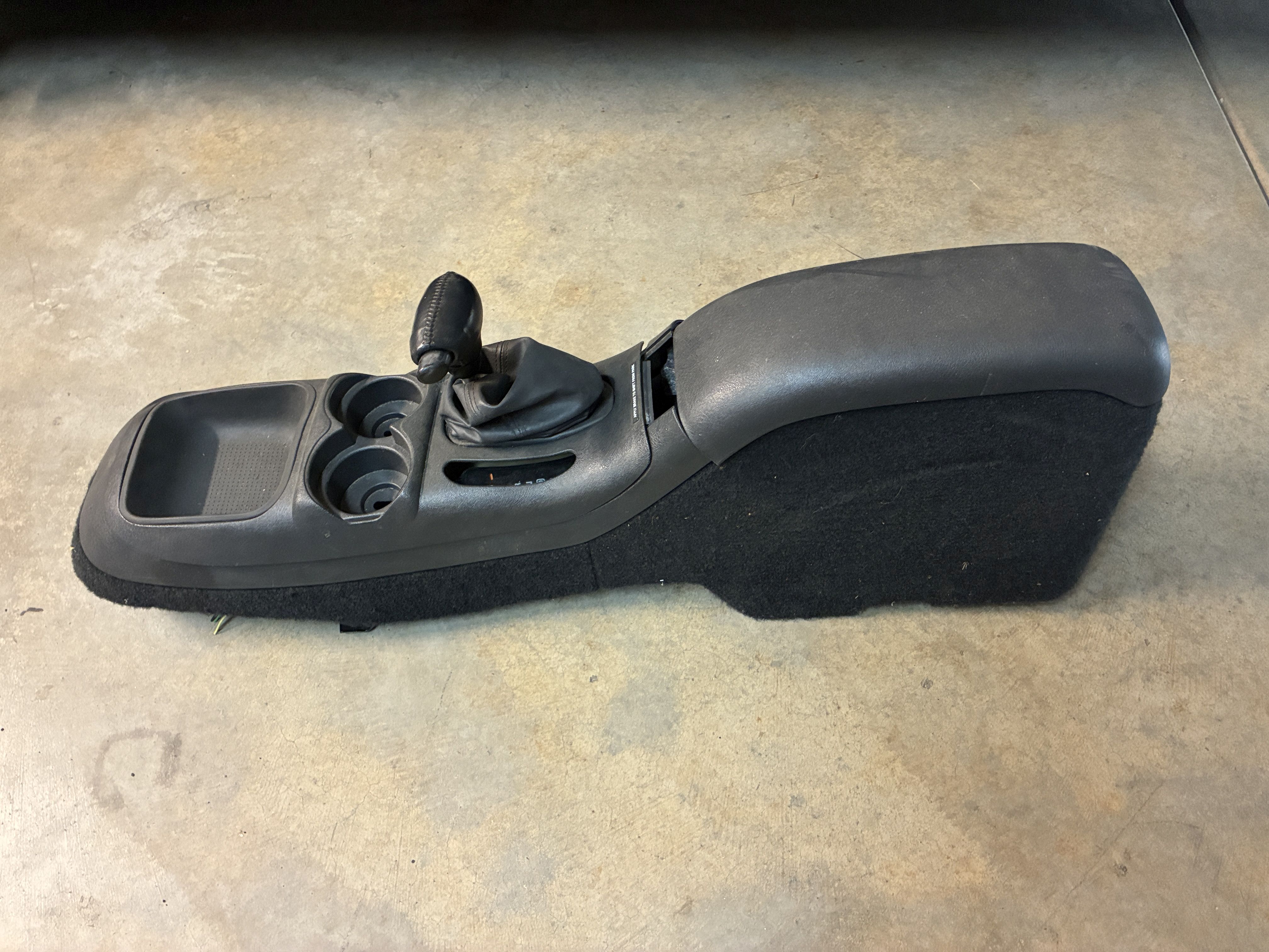

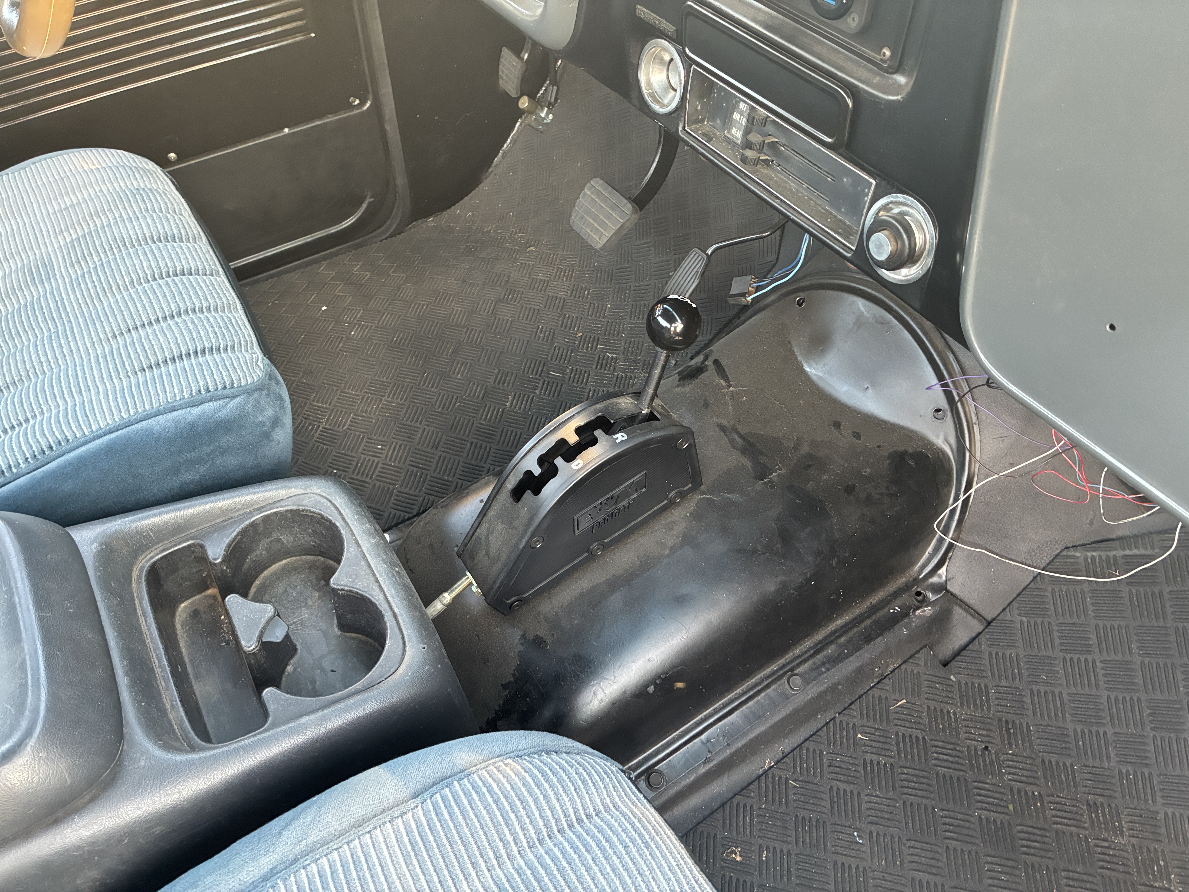

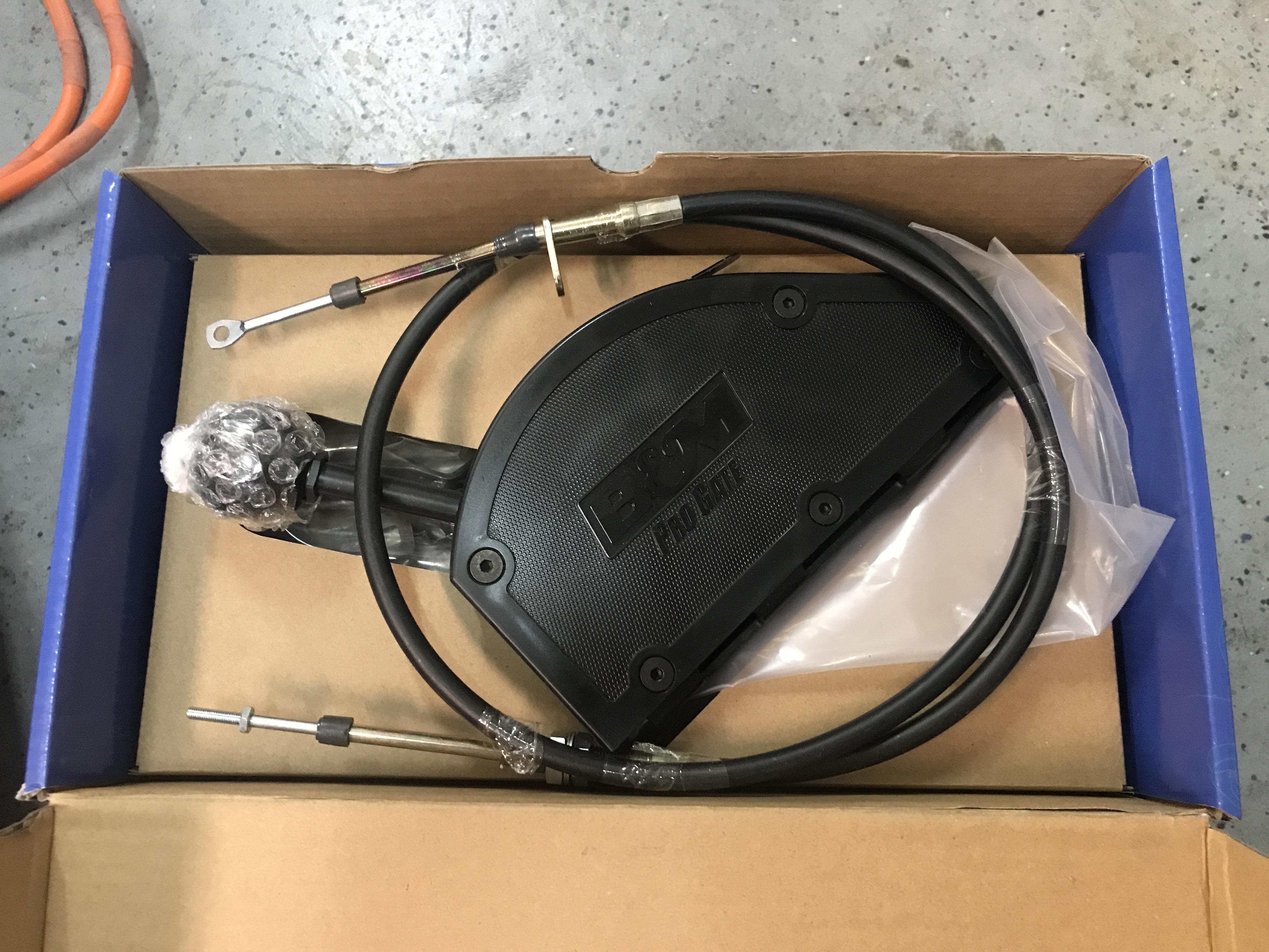

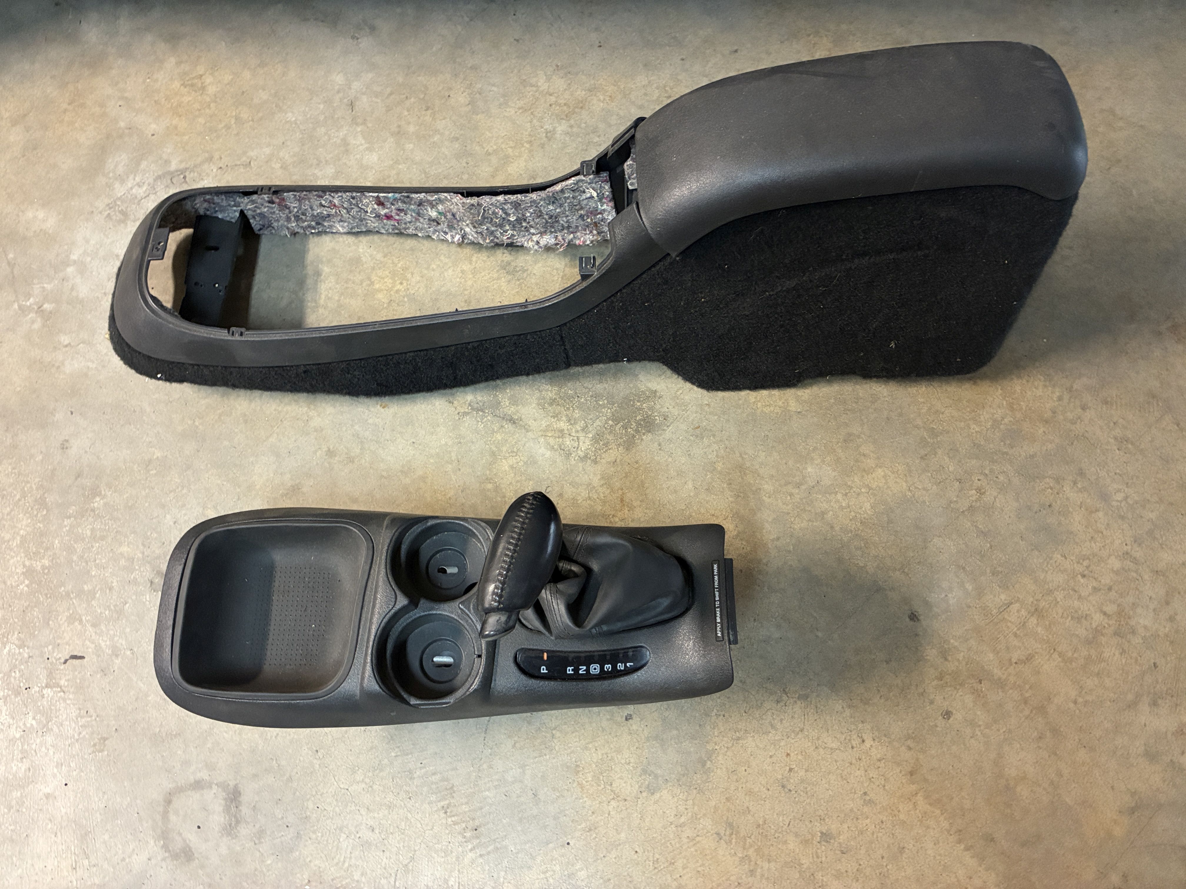

ha ha, yes I hate that "tractor" B&M shifter, Racing & Performance my @ss
planning on replacing it with this handsome 1997 Chevy Blazer OEM unit

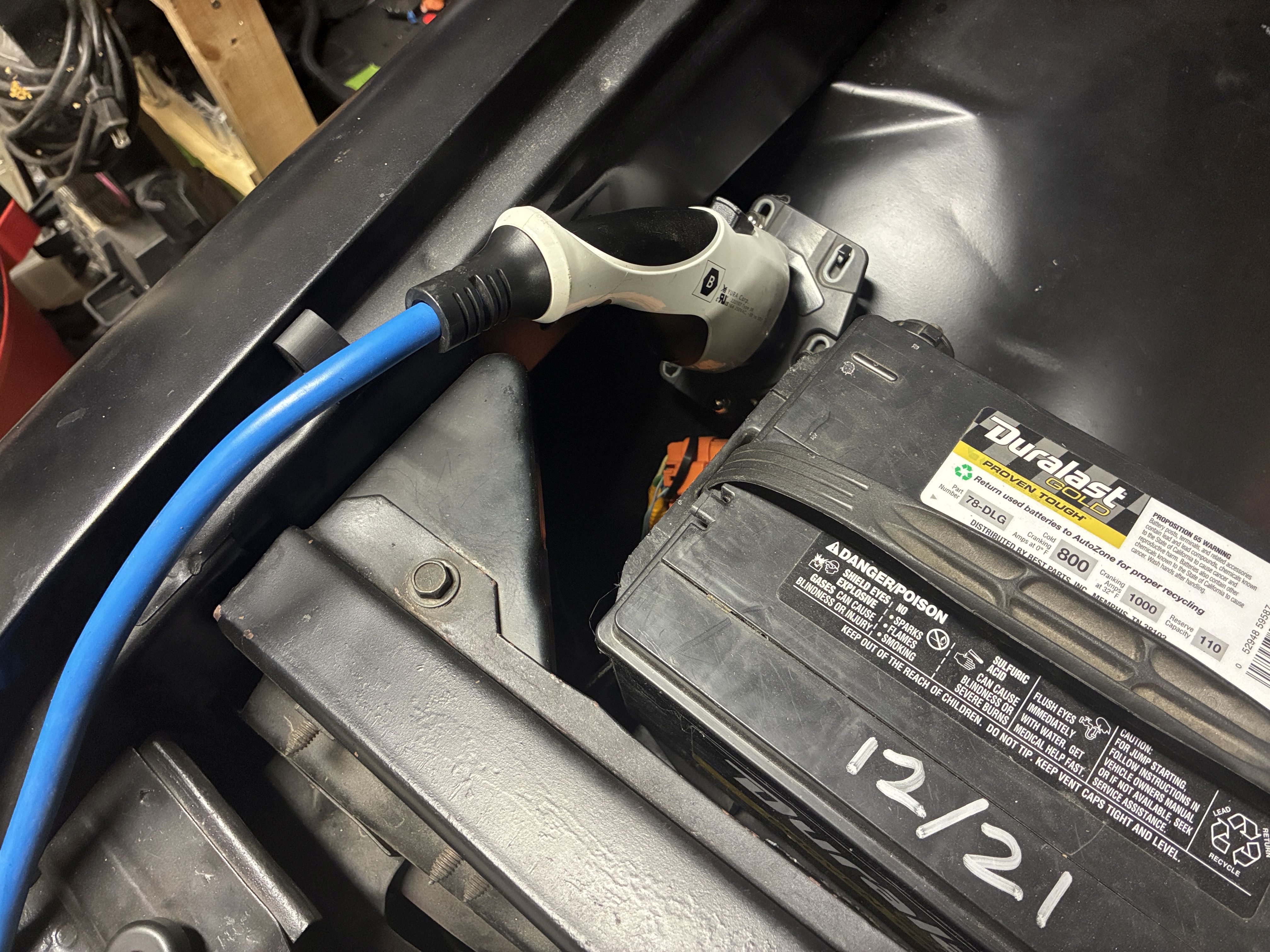

well this Never Ceases To Amaze Me, Can You Relate - NCTAM,CYR
so out of everything I tweaked, tooked apart, disassembled during Phase II, the battery charging system was not one of them ! I simply unplugged the little fellar aka 1st Gen Chevy Volt onboard battery charger and moved it to the bed of the truck
So can you guess what is now NOT working ?
[I'll give you a second minute (as my 4 year old son used to say)]

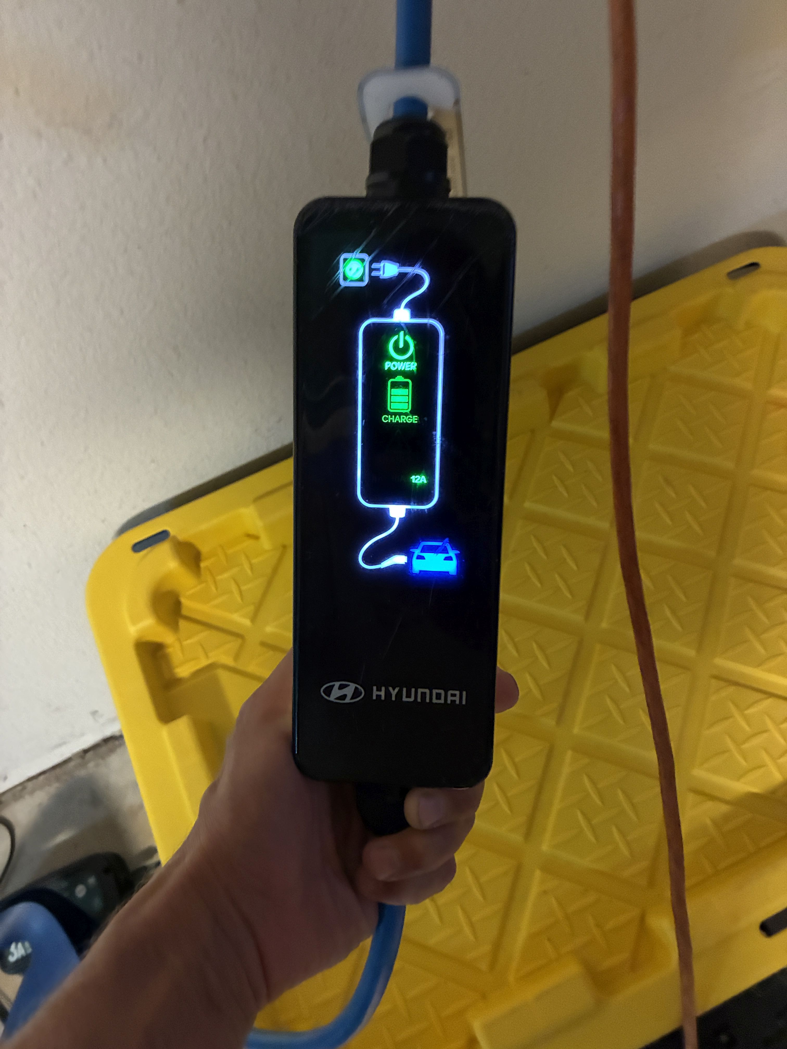

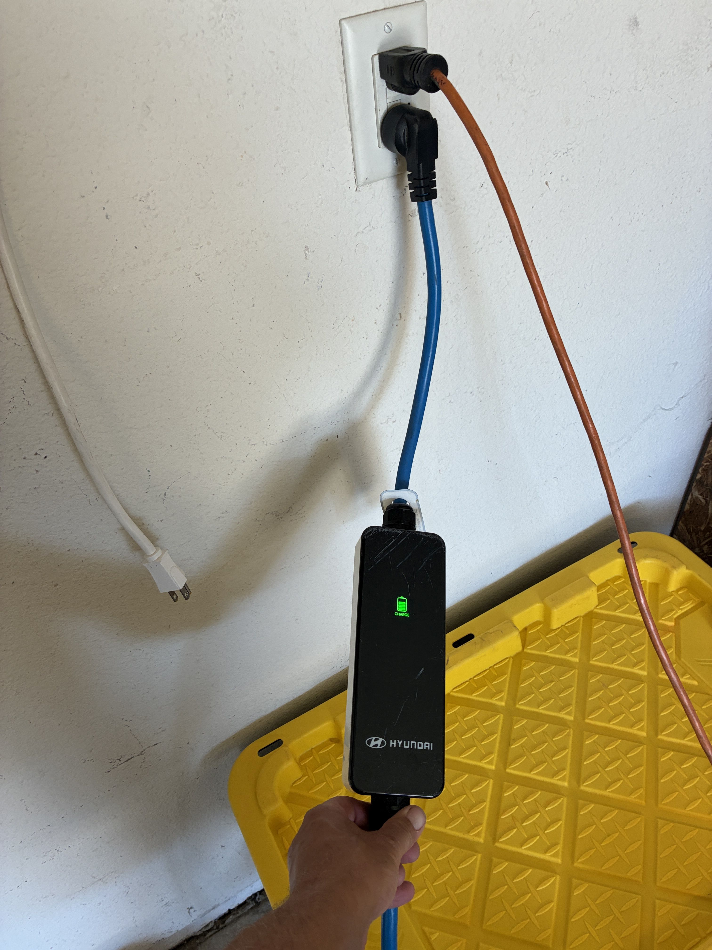

that's right the charging does not work, well it sorta works sometimes if I wiggle the key in the [brand new aftermarket] ignition or lift the tiny AVC2 gizmotron and set it back down right where I found it
here I am attempting to granny charge it using my 120 volt 15 amp standard US household circuit using my Hyundai Ironic 5 granny charger cord cause no way in hell was the truck willing to even consider charging using my beloved Vevor cord on the 240 volt 30 am clothes dryer circuit

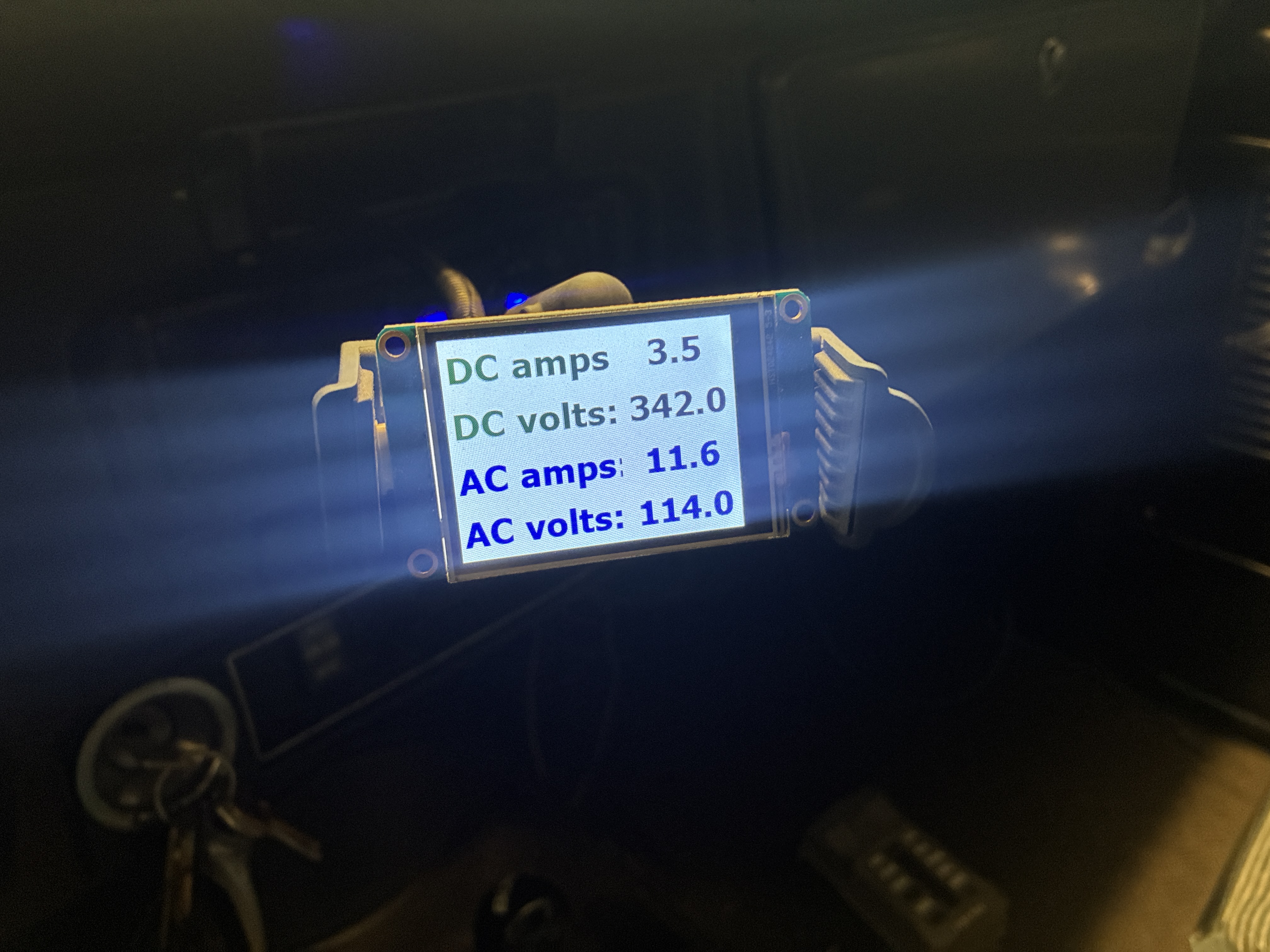

I use this Nextion display to monitor the charging process, I rolled it myself

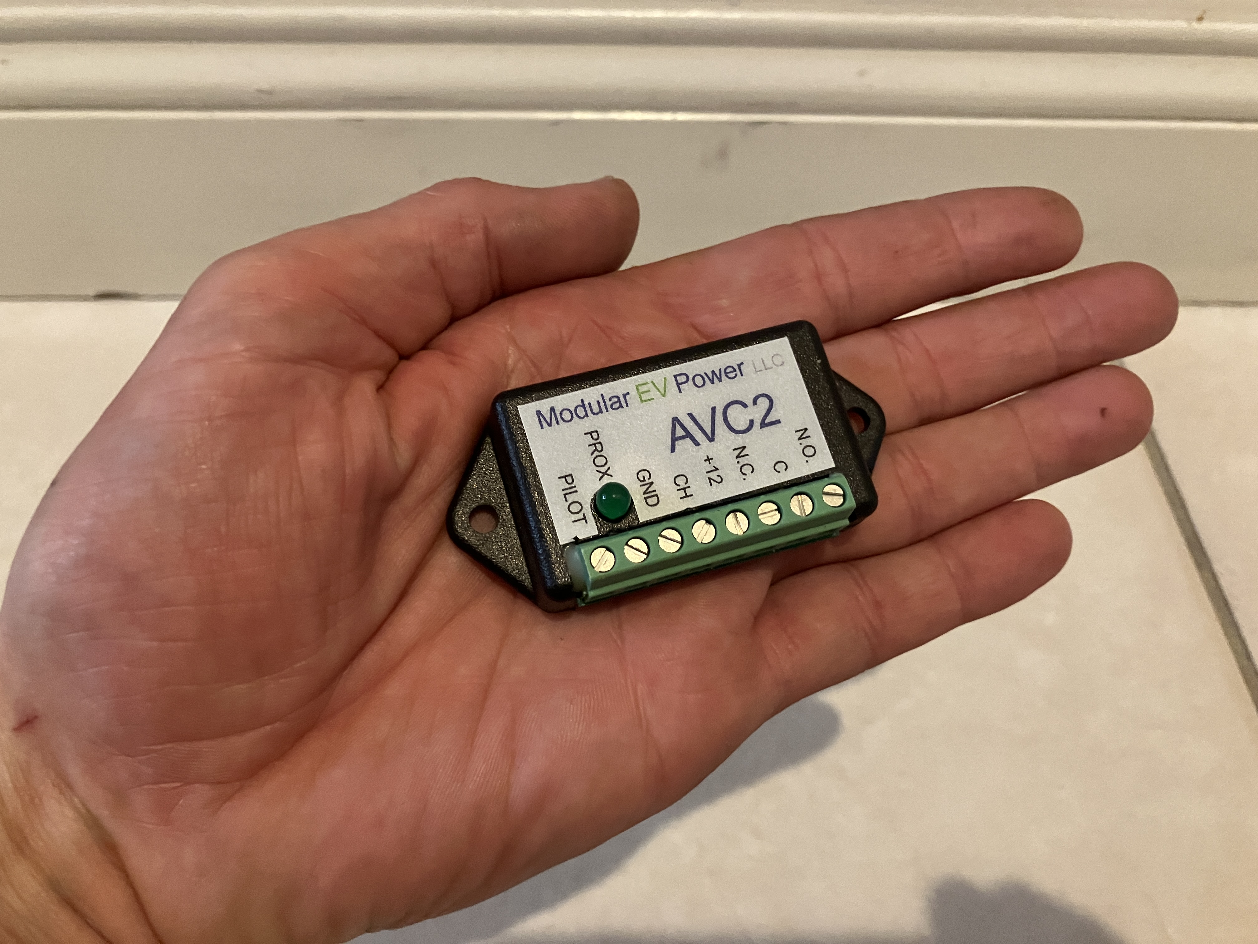

So bad wiring + shitty ignition barrel?
What is all involved in your charging setup? Since you are not using the ZombieVerter or a BMS I believe.

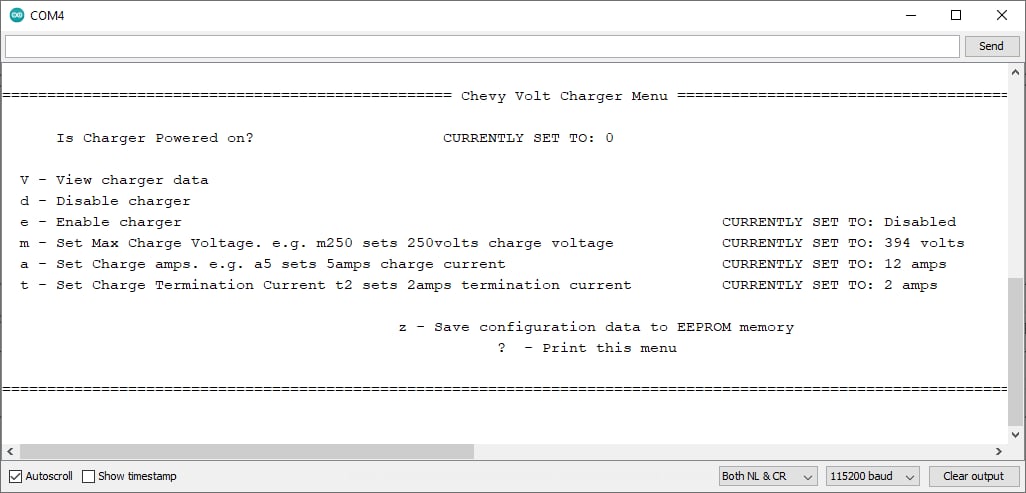

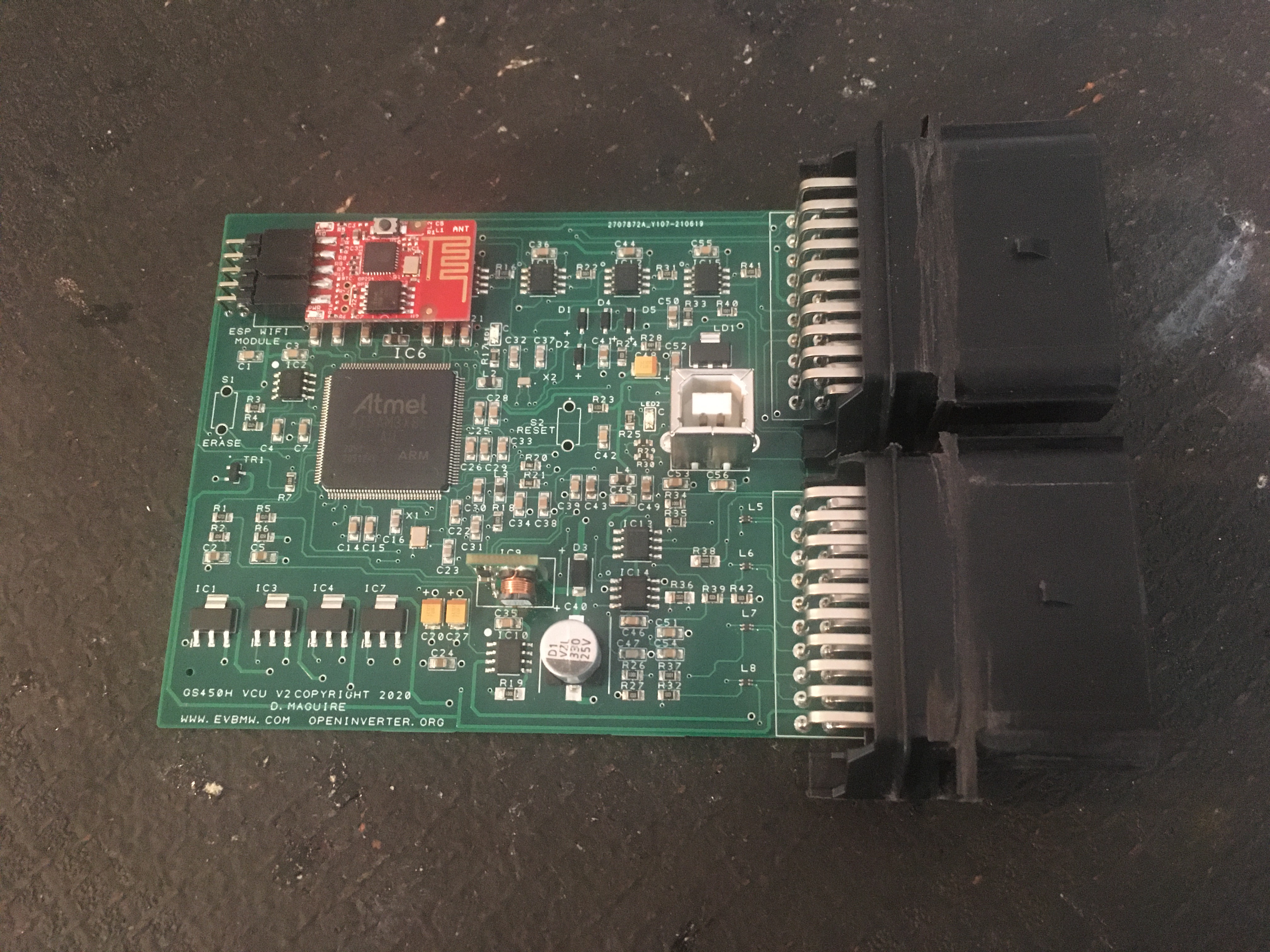

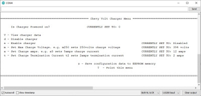

just running Damien's AmperaCharger code
and this is my little serial menu for it
now I'm wondering if it's actually working, but the Nextion display is not updating, time to tinker

On what is the question.
Also so many items in the chain best to start from basics and run through all the signals.

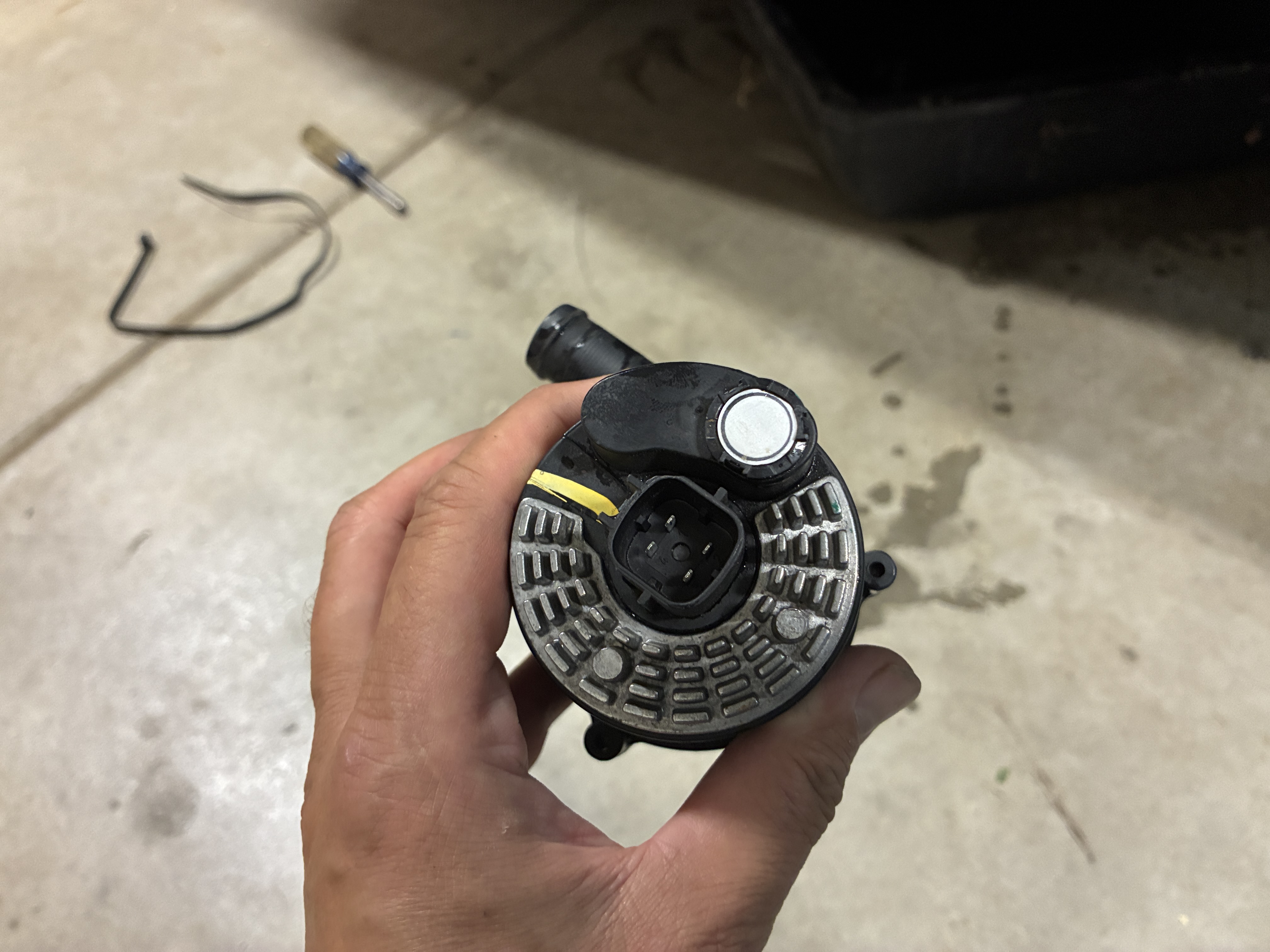

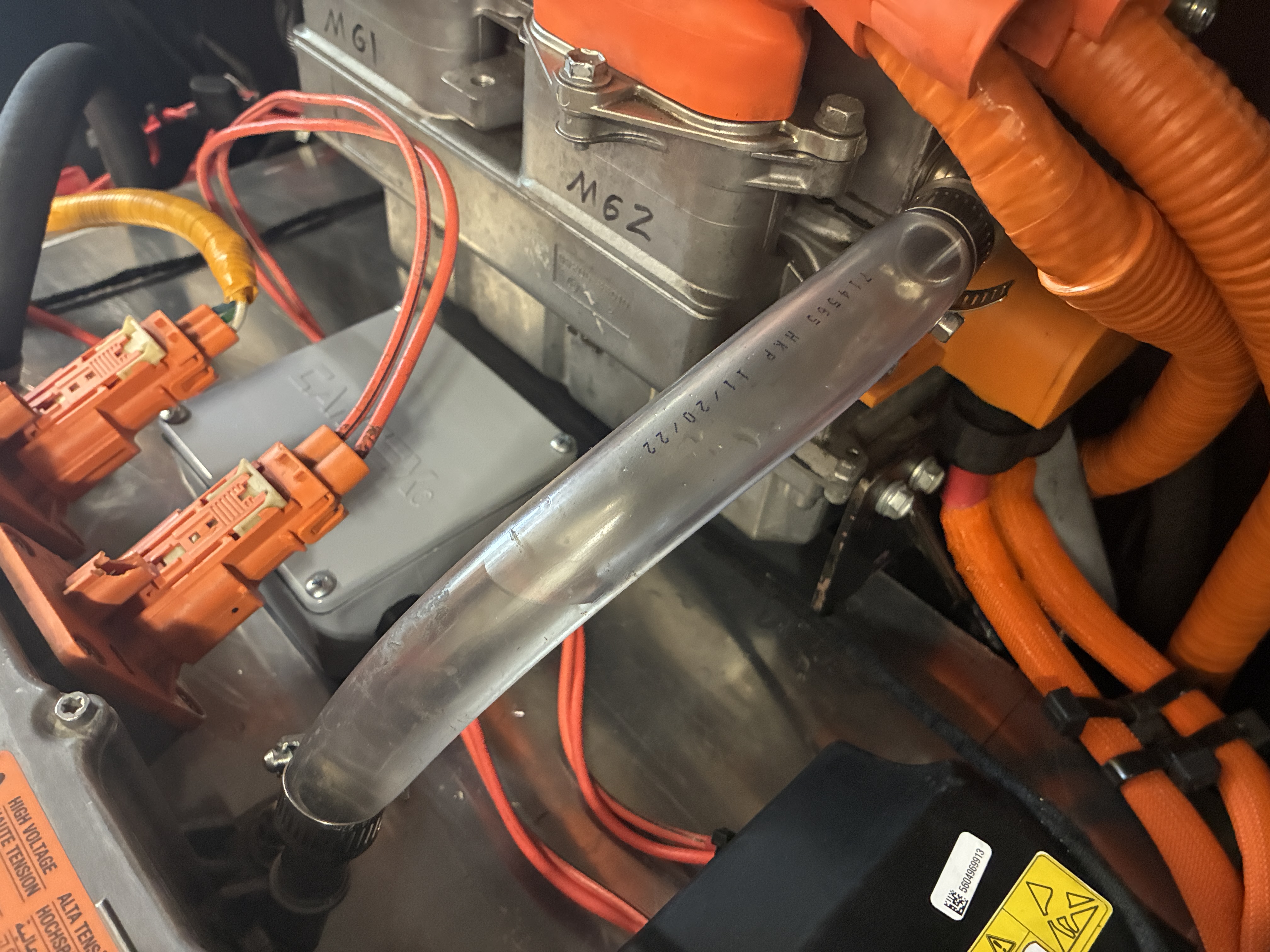

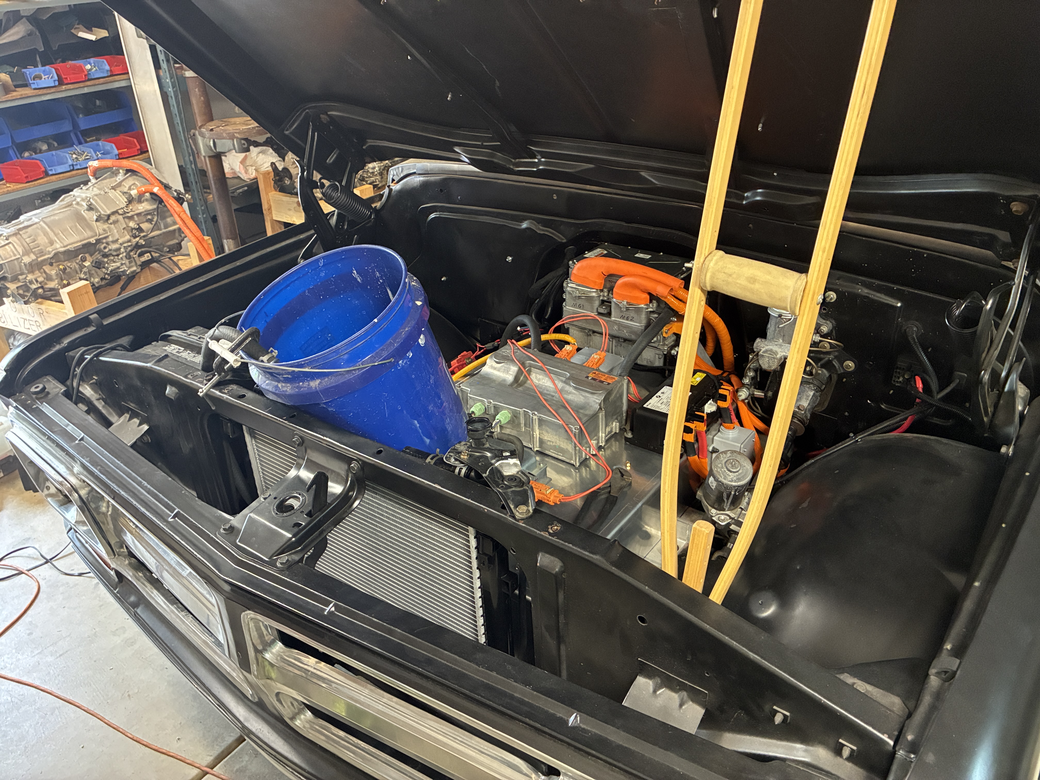

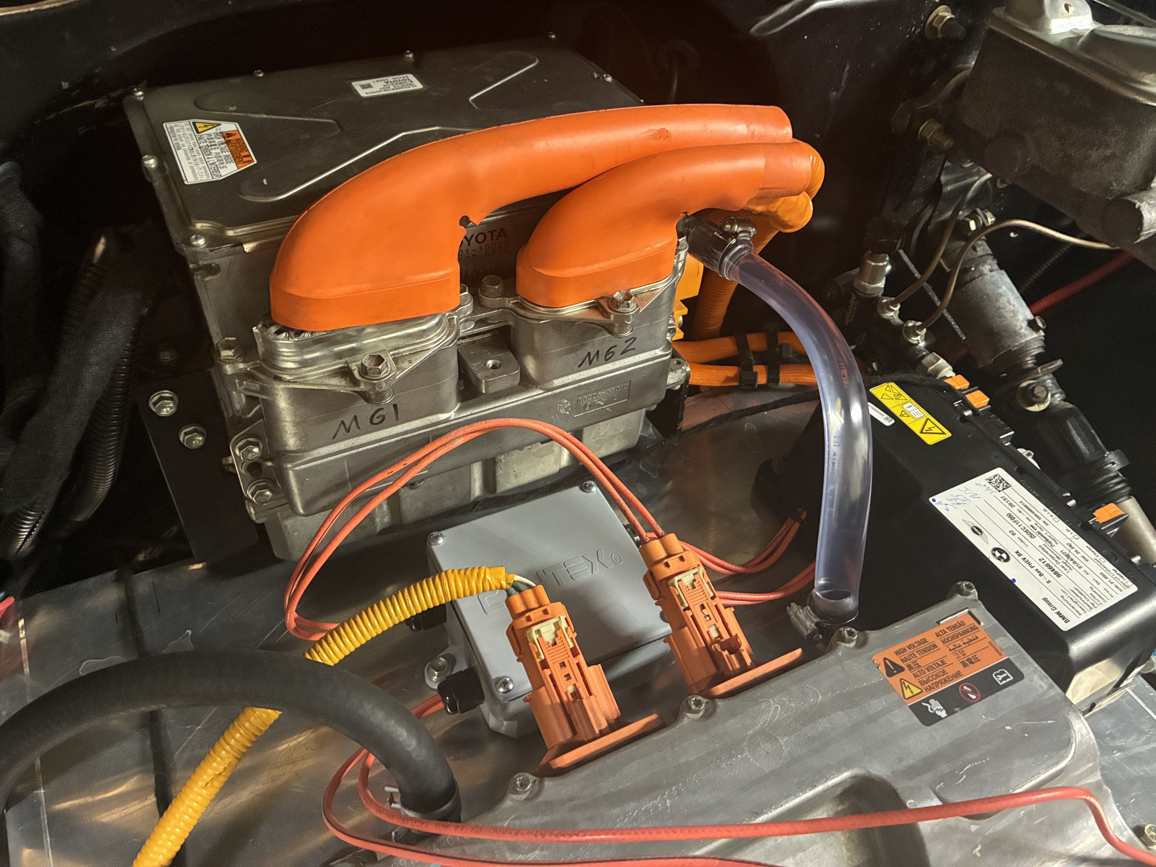

so don't want to drive the truck, cause I can't charge it, and I can't charge it cause it ain't cooling, so today I did the bucket test and it appears that the recently relocated Tesla Model S H2O pump aint pumpin'
I checked all the fuses, tightened all the hoses, and then I decided to yank the thing to test it off the truck, anyone remember the pin out
Gregski
Posts: 2873
Has thanked: 530 times
Been thanked: 1190 times
Re: [DRIVING] 1971 GMCe Lexus GS450H BMW 530e Tesla Model S Electruck
Post by Gregski »

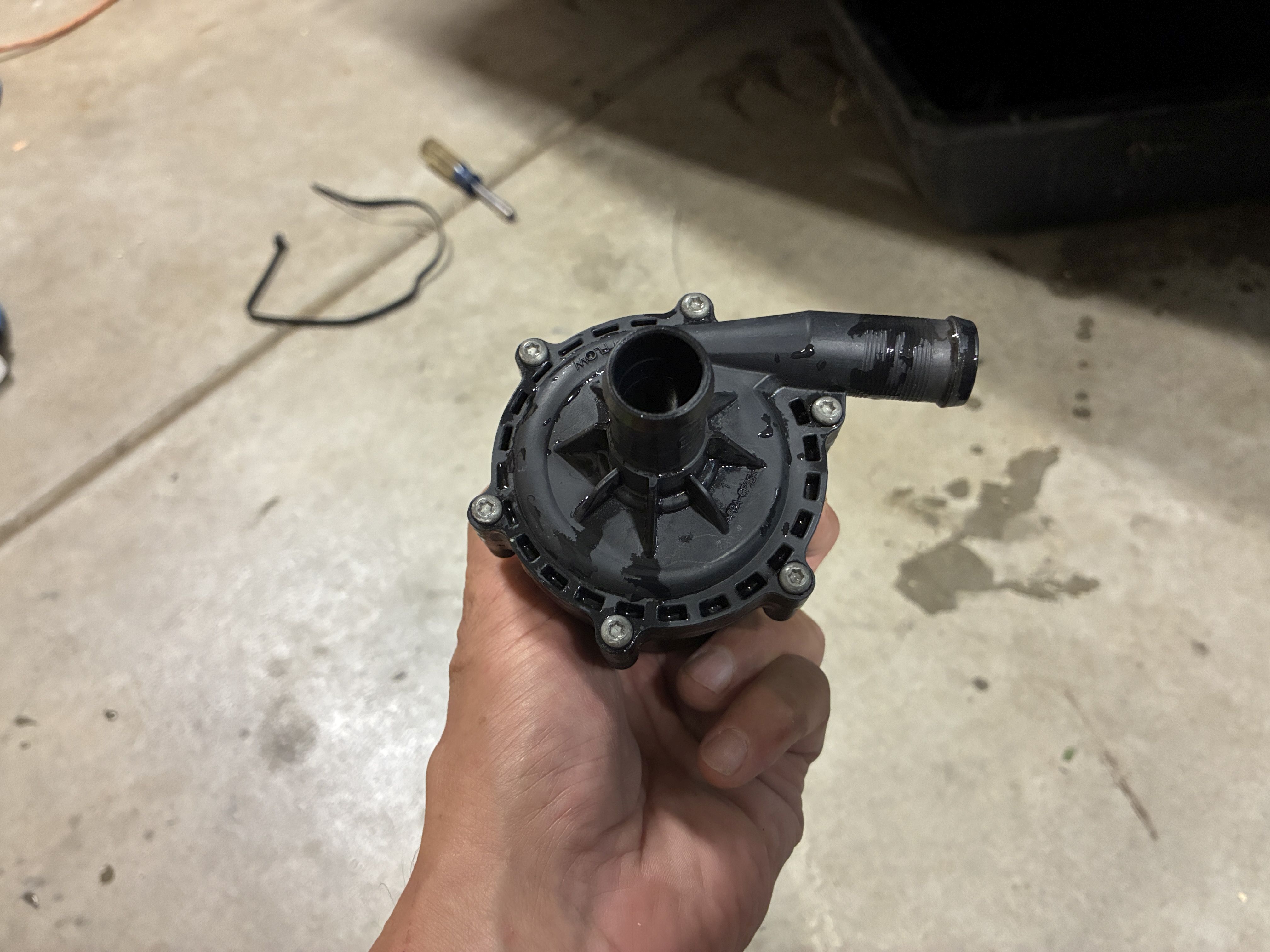

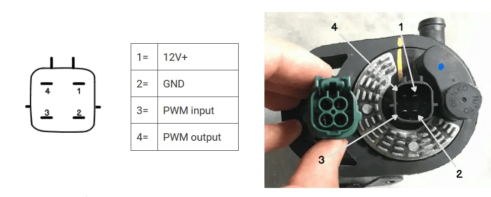

thank the EV Gods for the Open Inverter Wiki
armed with this knowledge I decided to send the pump to a Specialist, where it tested A OK !
Note: these pumps will pompulate at full umph absent the PWM signal

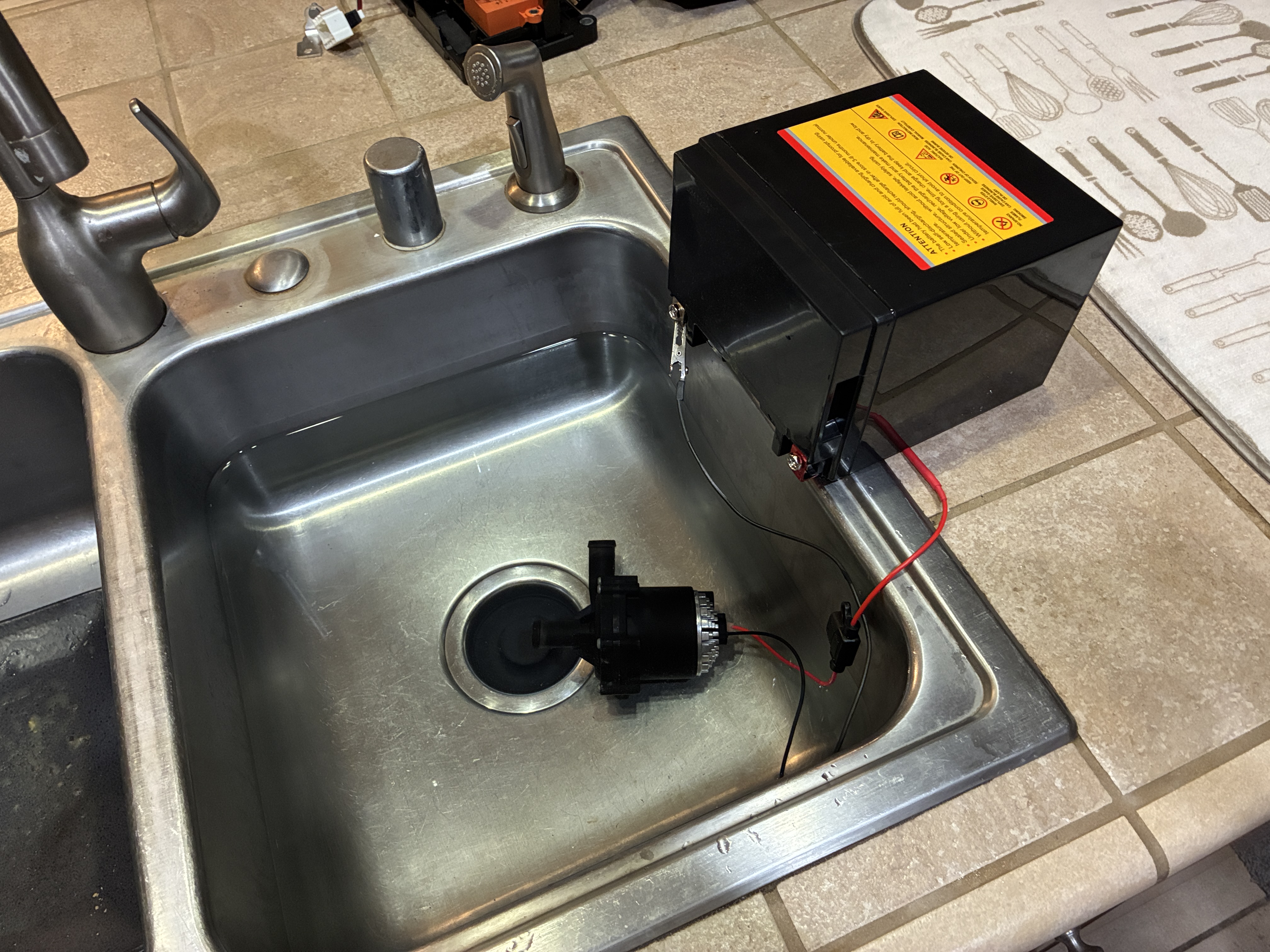

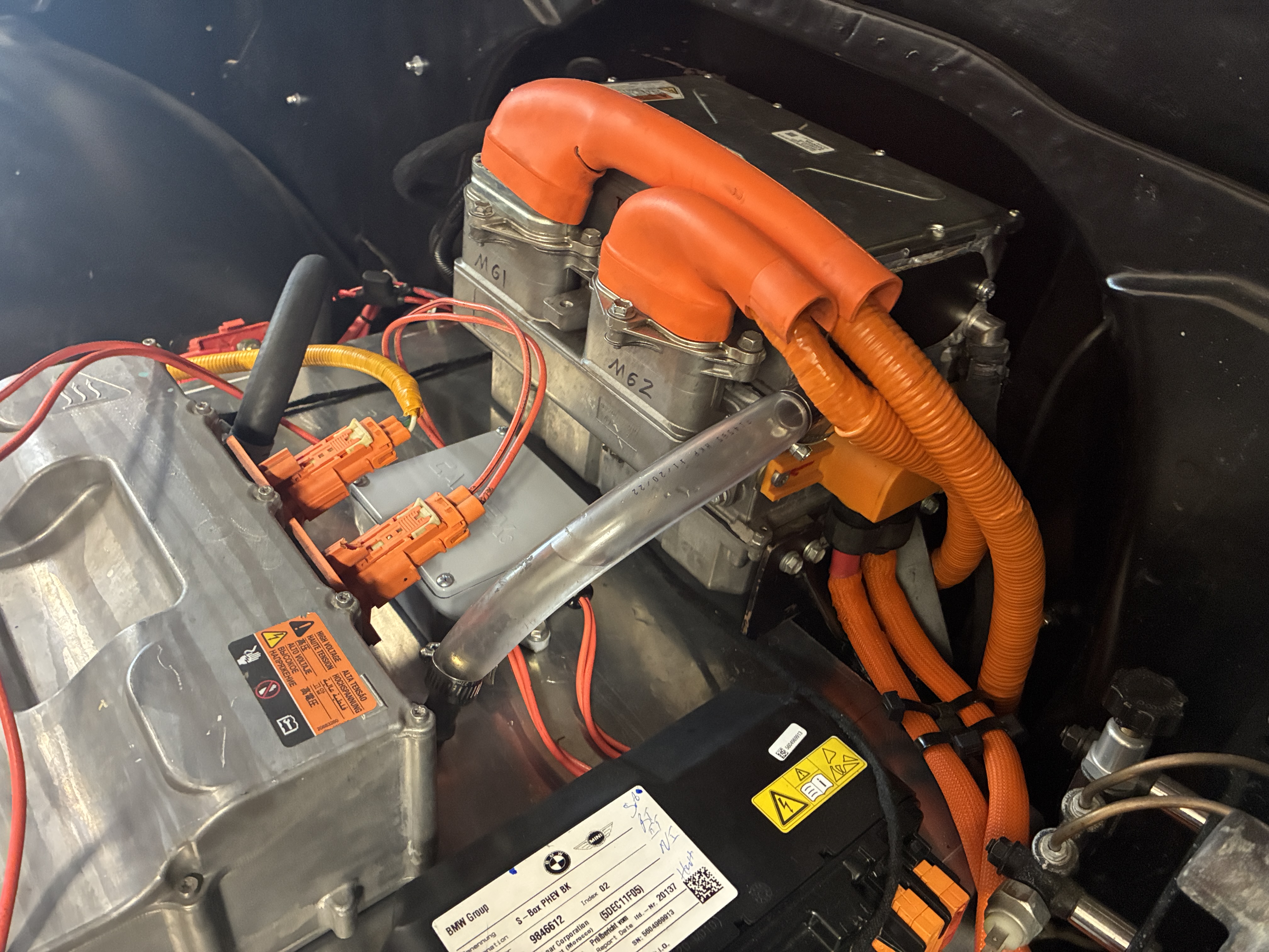

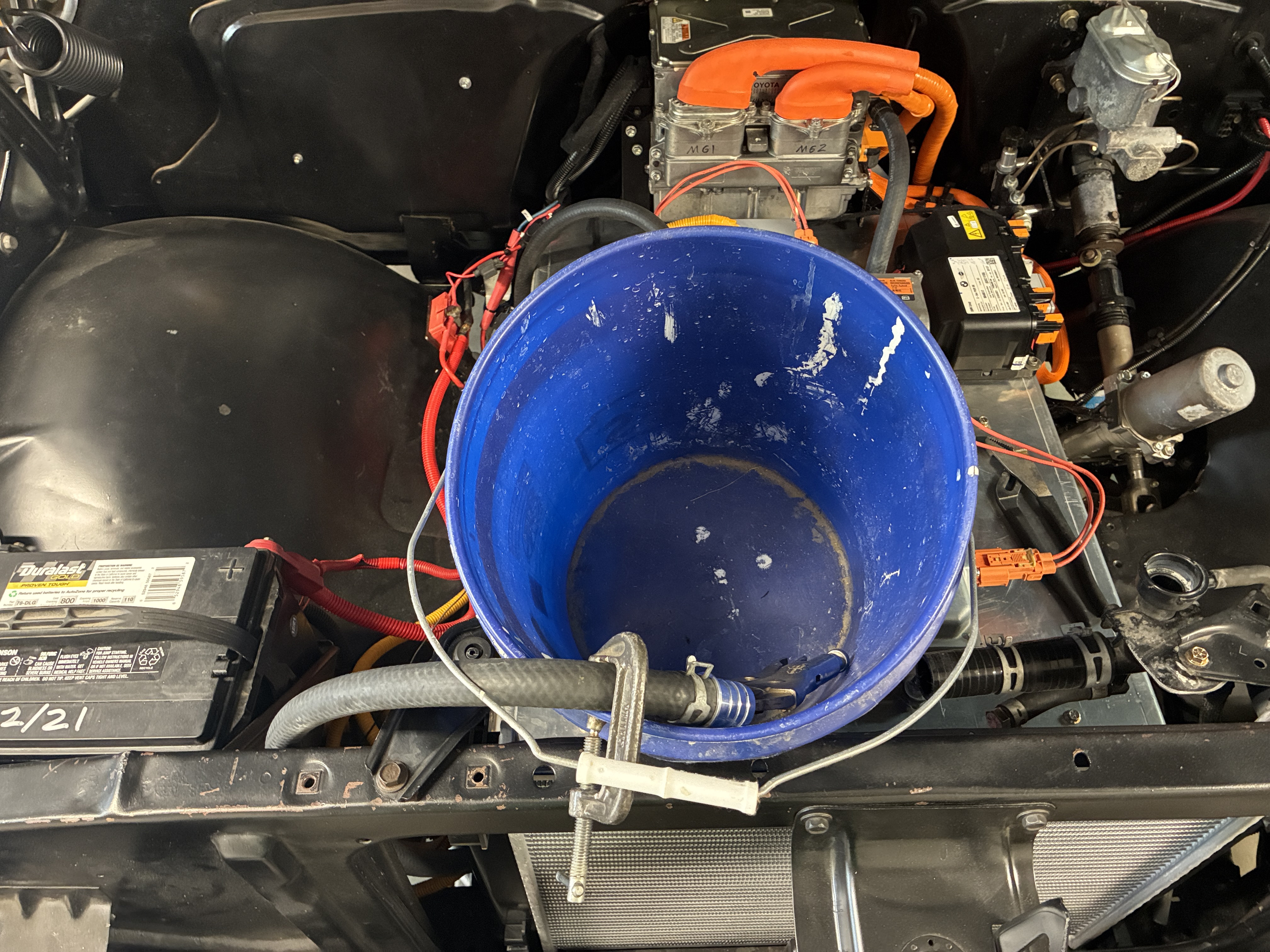

so I tested the water pump wire harness plug, I got 12 volts on Pin 1 and a good ground on Pin 2 and when I submerge the Tesla water pump in a bucket of water whilst plugged in to it's harness it's pumping, so it must be a circulation issue
so I tried my clear hose trick for optimum visability, now before you go screamin' air bubble, burp the system, that air bumble settled there after I turned off the pump and that clear hose leaked a bit as it's a bit too big for them outlets

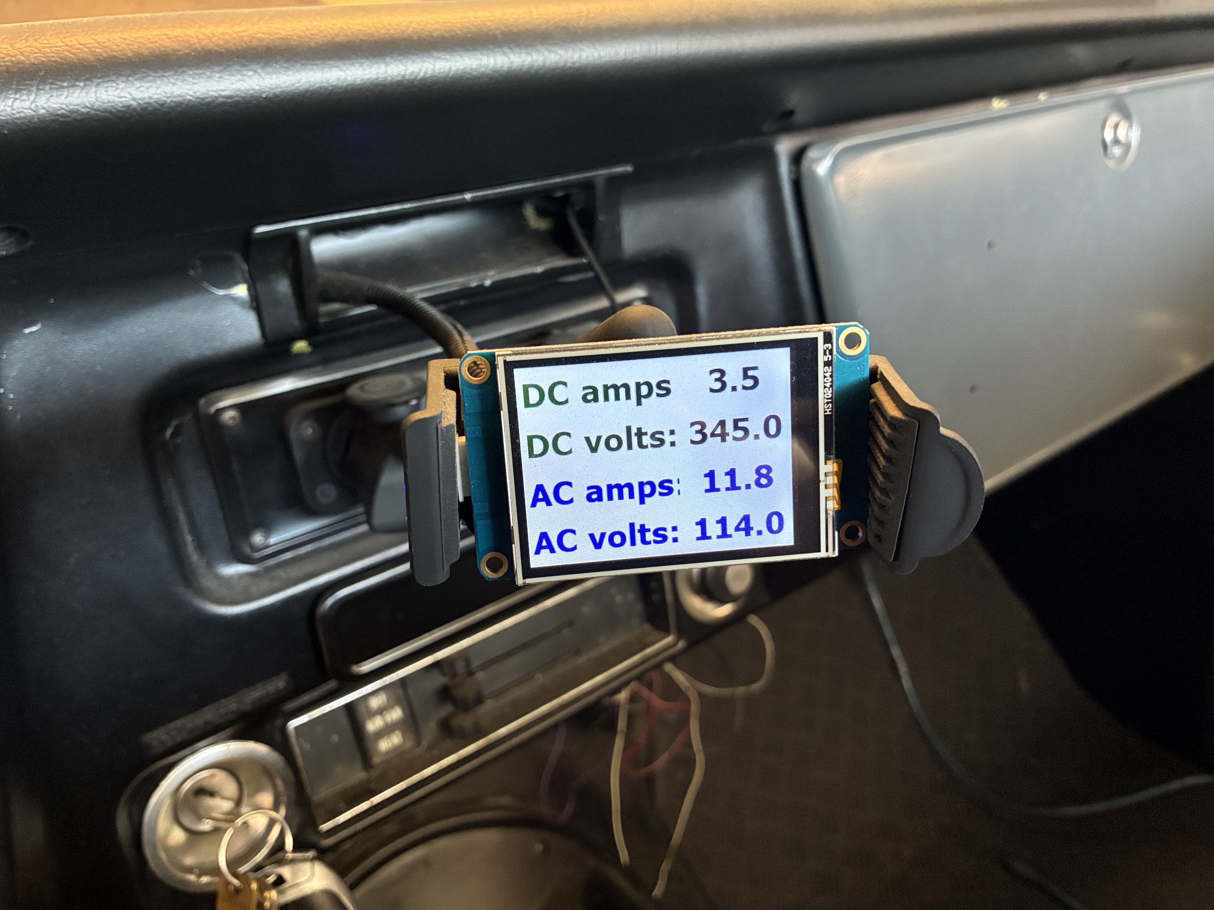

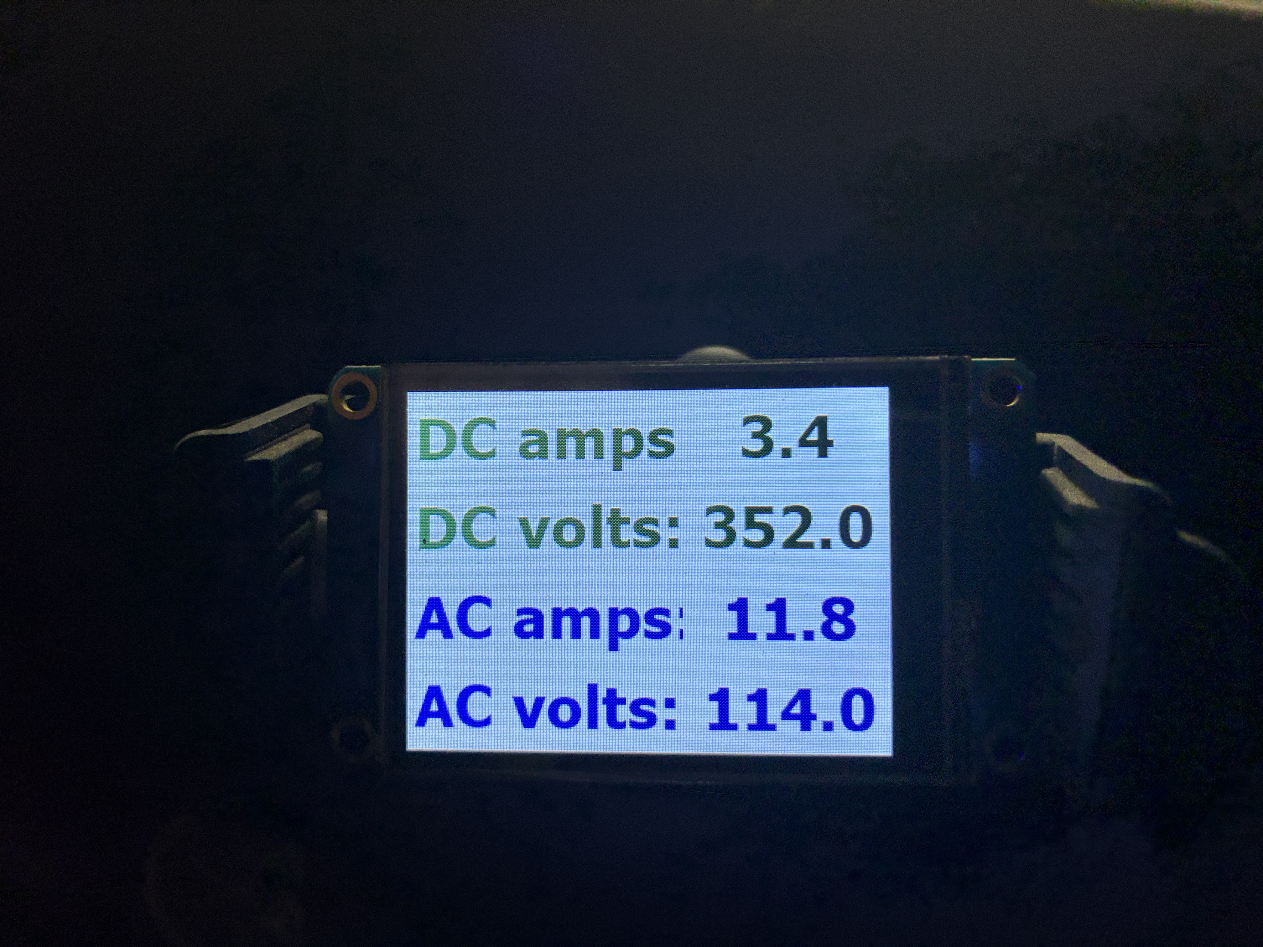

so a quick update on the truck, to be honest with you all I had to step away from it for a minute, hey all you working on your projects out there, there's no shame in that, I needed a moment, then I though I best get her on the road so we can dyno test both MGs before my hibernation kicks in
so this evening I thought what if I run that Tesla Model S water pump at full speed, will that get all the air bubbles out or whatever is causing it not to cool the charger properly
well I think that might have worked as now it's been granny charging at 120 volts and 15 amps for over 3 hours and the charger is warm but not too hot to the touch by any means, and the water pump is PWMing at a reduced speed as it always had before
took this pic at about 5:00 PM note the 342 volts
and here it is about 3.5 hours later around 8:30 pm and the volts climbed to 352
(no I won't be charging this slow eventually this is all part of baby steps after the battery pack upgrade)
