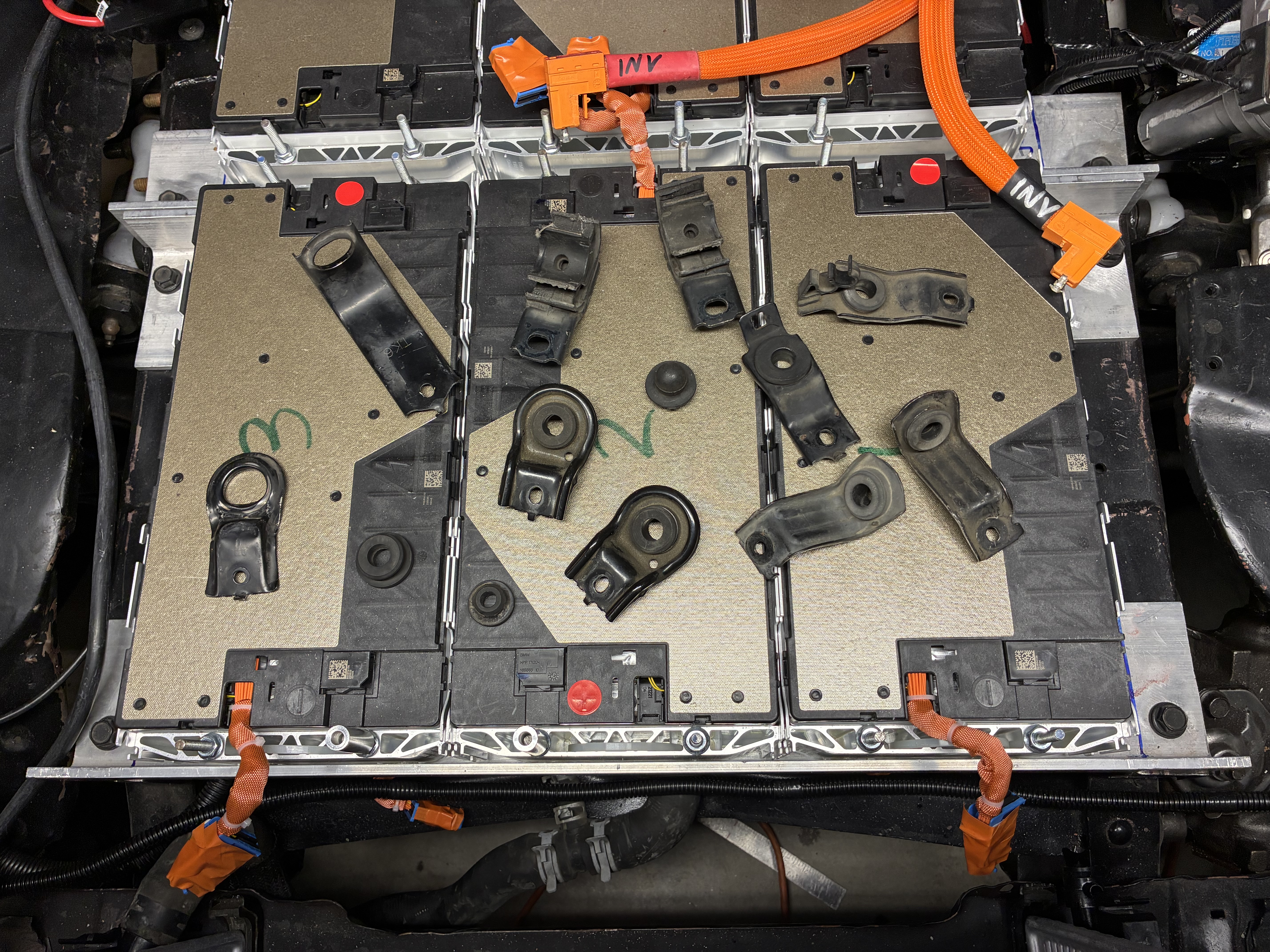

spent the last couple weeks [pronounced: "months"] bangin' my head against a brick wall trying to figure out how to mount that Nissan Versa radiator in the truck with the least amount of fabin' and fandangling, came up with all sorts of excuses not to work on the truck in the process, and amassed a potpourri of random and not so random OEM radiator brackets in the process
[feel free to suspend my Man Card for the use of the word "potpourri" I should know better]
Gregski
Posts: 3158
Has thanked: 630 times
Been thanked: 1607 times
Re: 1971 GMCe Lexus GS450H BMW 530e Tesla Model S Electruck [Upgrade]
Post by Gregski »
finally after scouring the wrecking yards I came across this super rare car called the Honda Accord
and four 10 M&M bolts later we were back in business

so happy with these brackets they bolted right up to the original holes in the rad support (so self tappers will have to wait!)
I may even trim them some day, who knows !?

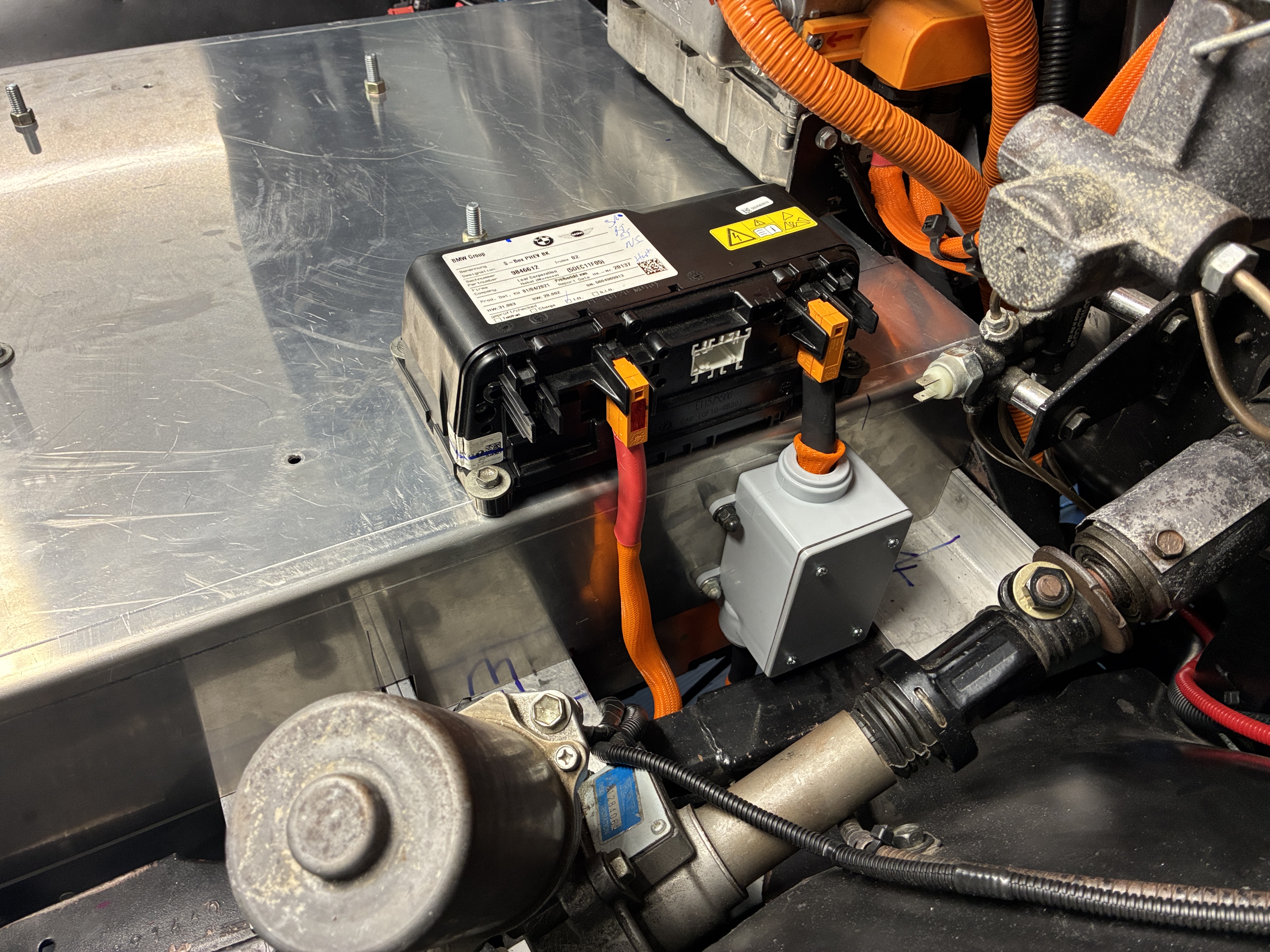

anywho, I managed to chimichanga the high voltage connection via a Cantex junction box to the BMW sBox, this box joins the two negative leads from the two BMW 530e packs into one, simple is the name of the game
[ why do I want a burrito all of a sudden ? ]
Gregski
Posts: 3158
Post by Gregski »

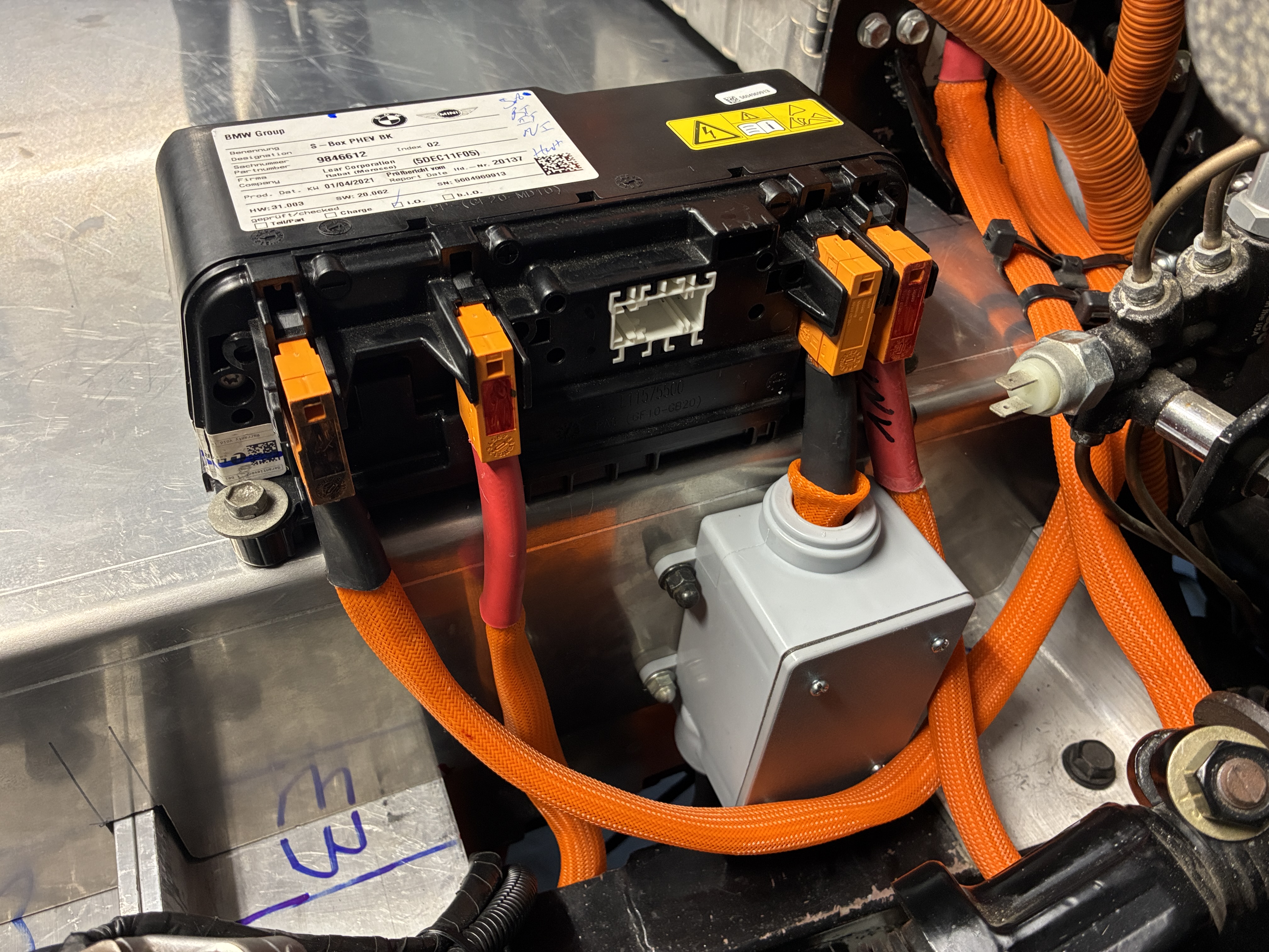

OK, and then I moved on to the glass is half full side...
and here are all four hook em ups, Top Tip if I May (TTiIM) one way to remember where the connections go is to think the two Inside ones are Input of energy into that black box, and the two Outside ones are Output out of it, if that makes sense
and here's how I mounted the positive lead high voltage junction box under the belly of the beast
Posts: 1156
Has thanked: 246 times
Been thanked: 469 times
Why do you have the sbox outside the battery enclosure?
The battery box is always “live” now
Gregski
Posts: 3158
Post by Gregski »
Bratitude wrote: Mon Jul 28, 2025 4:07 pm Why do you have the sbox outside the battery enclosure?
the truck is a prototype and a test mule, and for easy access to troubleshoot, not proud of it and do not recommend it

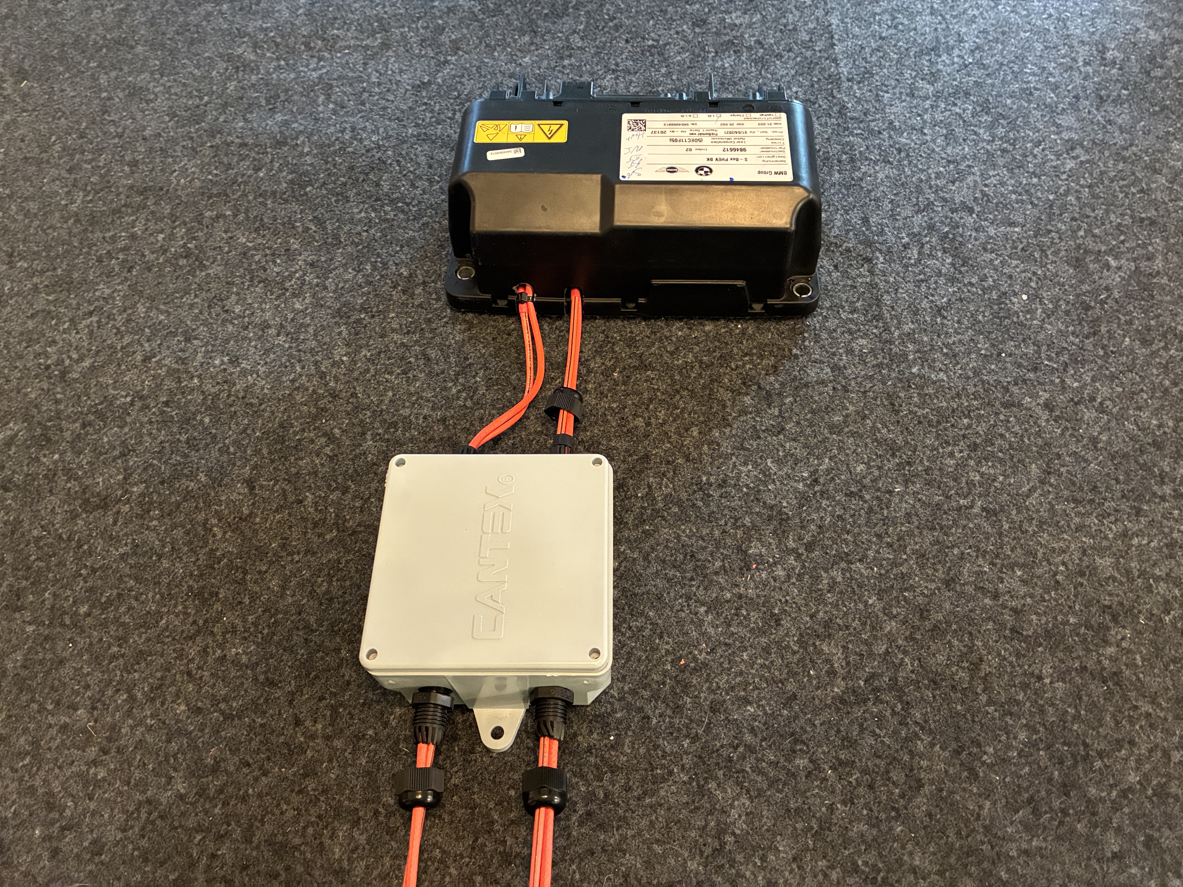

next it was time to think outside the sBox
so our Mission should we choose to accept it, is to take 'em four free range Bussmann BMM603-xSQ 600V 30A fuse holders and shove them in a CANTEX box, now you don't have to fuse both sides, ie the negative and positive leads of say the onboard battery charger and or the DC-DC converter, I happen to done did that just to use the fuse blocks as junction blocks to allow me to extend the cables
don't be skierd labelize stuff, and just remind yourself you are not doing this for your Present Self but your Future Self, think 7 kid birthday parties from now, 4 bar mitzvahs and 6 kids piano recitals later when you return back to work on this project
Another Top Tip No One Ever Asked For (ATTNOEAF) - when ever possible, do not destroy, cannibolize, or repurpose what you already done did for the new project or component, instead if possible use new bits for that, you may need to old stuff to fall back on, trust me on this one

and here's what we're going for as far as the big picture, I will loom these wires eventually and probably reroute them more better, but at least now I know they reach

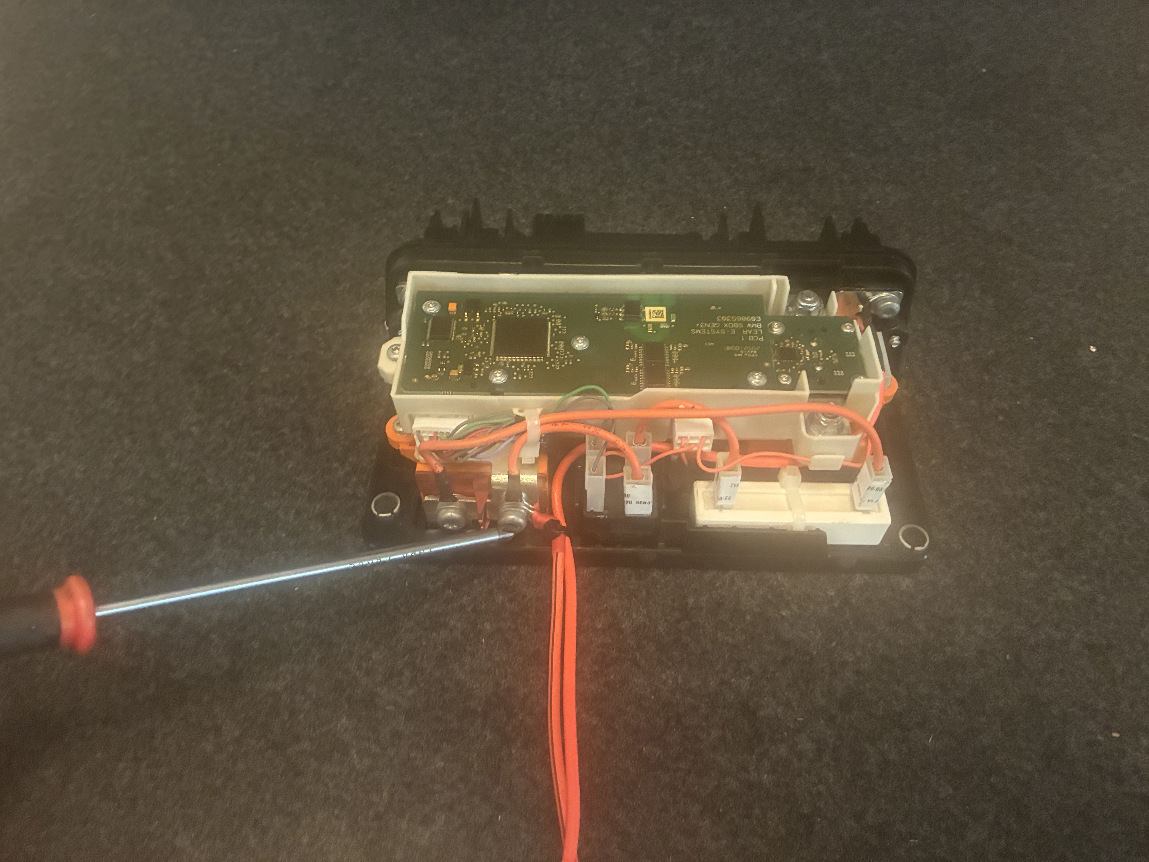

so then it was time to tether this sexy CANTEX junction box to the BMW sBox, so first we do the DC-DC converter leads, these are properly wired to the output of the box, meaning both contactors need to be closed for current to make it's way to the junction box
forgive me my Lords for I know not where this mystery glare was coming from
we tap into the output of the positive contactor for the positive lead here
and we use the negative output post of the sBox for the negative lead here
made a notch in the plastic housing case thingie for easy access and full removability

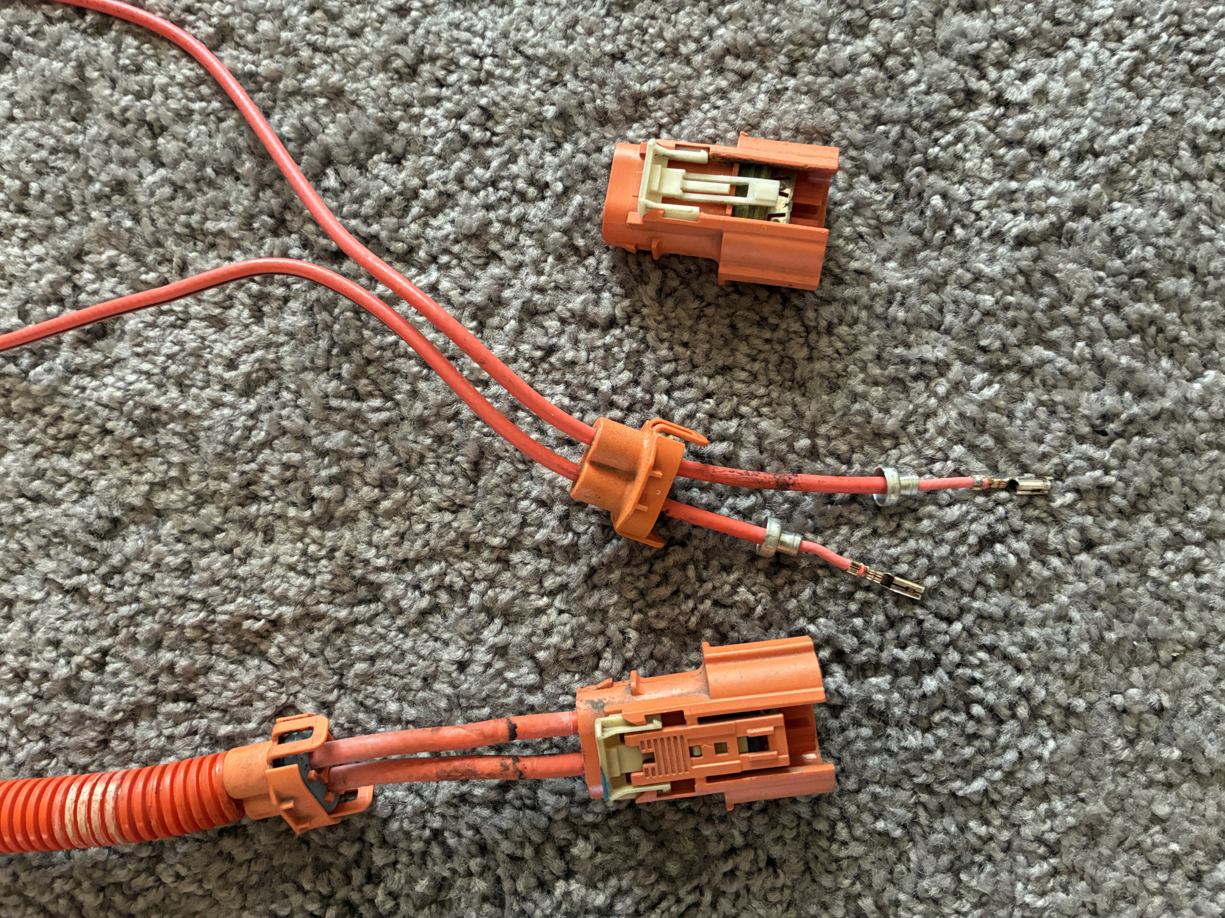

and finally we did the 1st Gen Chevy Volt onboard battery charger connection, and oh boy did we screw up, can you tell what The Greg forgot ?
Hint: think flaring your own brake lines
one of these four leads is not like the others !
Hell, I won't tell if you don't tell.
