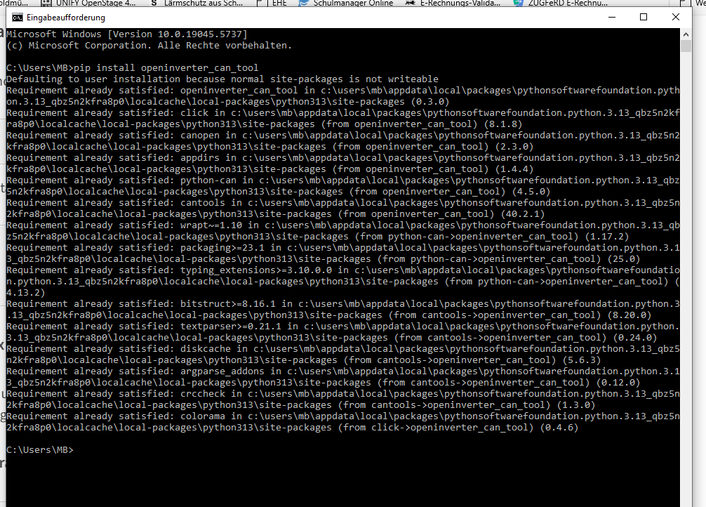

muehlpower
Posts: 698
Has thanked: 14 times
Been thanked: 143 times
Re: Tool to manage openinverter via CAN
Post by muehlpower »
I still haven't managed to get this tool to work. What am I doing wrong? I have installed python. When I enter 'Python' in the comandline something happens. When I enter 'pip' I get a help text. When I type 'pip install openinverter_can_tool' something seems to be installed. And now? If I enter 'oic' it is unknown.
davefiddes
Posts: 295
Has thanked: 79 times
Been thanked: 96 times
Post by davefiddes »
If the "oic" command isn't available that sounds like where it is installed to is not on the path. To help out it would be useful to know the platform you are using and the output of the install command. It would also be helpful to know the CAN adapter you would like to use with it.

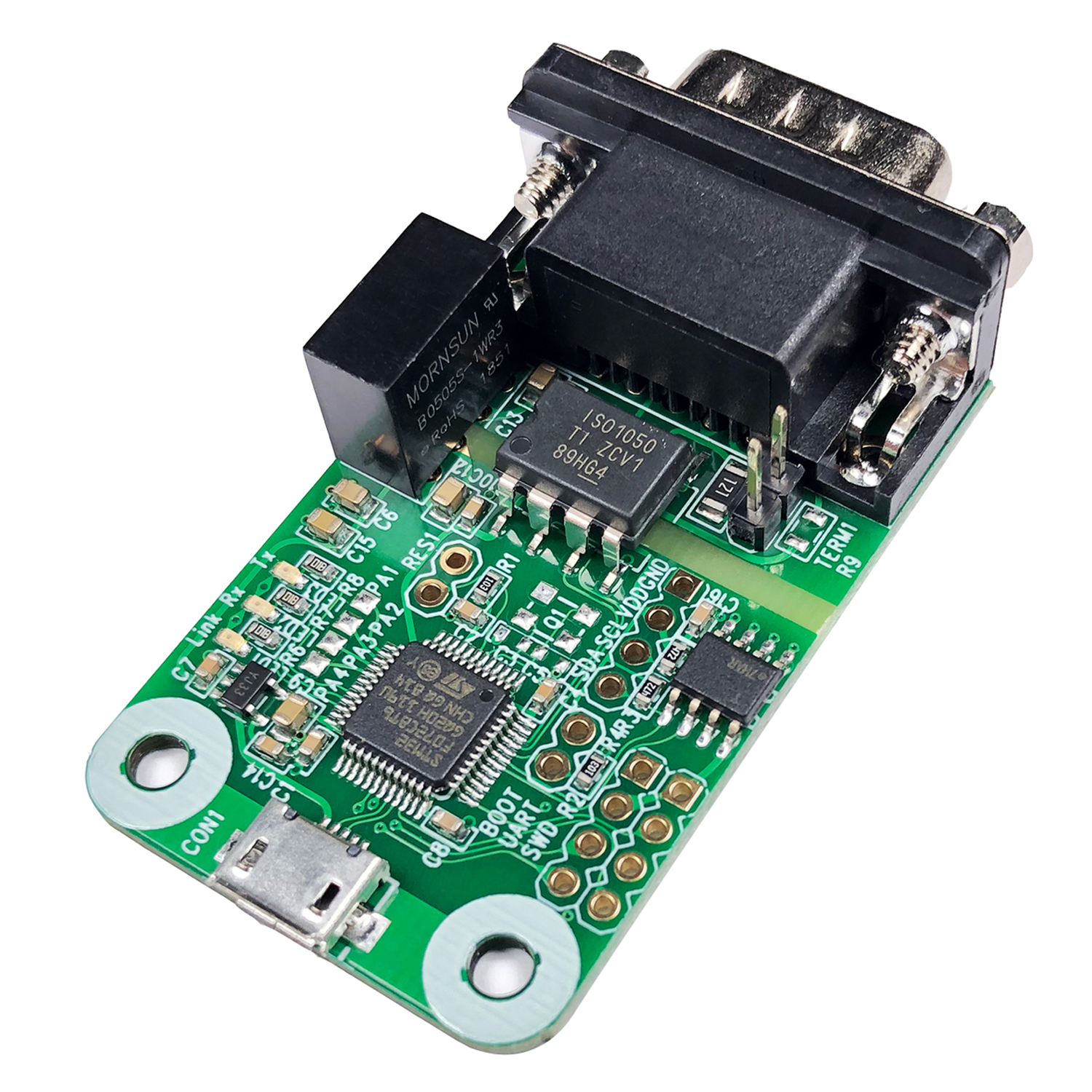

muehlpower
Posts: 698
this is the adapter I have and want to use
https://www.inno-maker.com/product/usb-can/

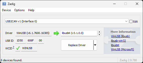

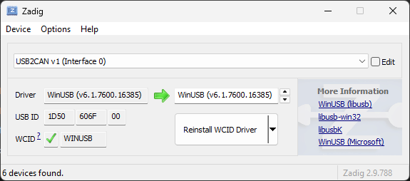

Had a very frustrating day trying to get this to work on Windows 11 (10 should be the same). The TLDR version is that it doesn't at the moment. For the time being I'd recommend using a Linux virtual machine and pass-through the USB CAN adapter to the VM. VirtualBox is your best bet on Windows 10 though I believe WSL can do this on Windows 11. You could also use a raspberry pi or any other Linux box.
What follows is how to set up openinverter_can_tool on Windows with an Innomaker USB2CAN or any other CAN adapter using the Geschwister Schneider protocol.
The problem with being unable to find the "oic" command is because of a missing path. You need to update it using the System Properties | Environment Variables. It should contain
C:\Users\mb\AppData\Local\Programs\Python\Python313
C:\Users\mb\AppData\Local\Programs\Python\Python313\Scripts
If you look in C:\Users\mb\AppData\Local\Programs\Python\Python313\Scripts you should see an "oic.exe". When you log-out and log back in again it should run from a Command Prompt.
Once this is done you need to install the USB driver for the USB2CAN adapter. To do this you need to download a utility called Zadig. This program assigns a device driver to a specific USB device. When you run the utility pick the "Options | List All Devices" option. Then you pick the "USB2CAN v1 (Interface 0)" in the drop-down:
Change the spin-control next to the green arrow to read "libusbK (v3.1.0.0)" and press the Replace Driver option:
With this done you need to install an additional python driver:
pip install python-can[gs_usb]
