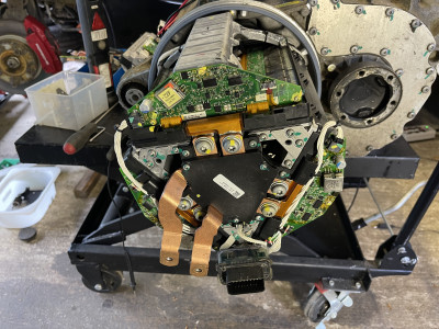

The car became more and more horrible to drive this week so I pulled the motor out. Whilst the inverter was completely dry, looks like I have some remnants of a previous leak from (3 years ago).

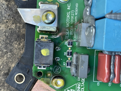

To conclude this thread, I found the issue to be on the Tesla PCB that attaches to the main busbars. I think it manages the capacitors for the voltage sense aspect.
Having inspected this, I found that the board had burned out:

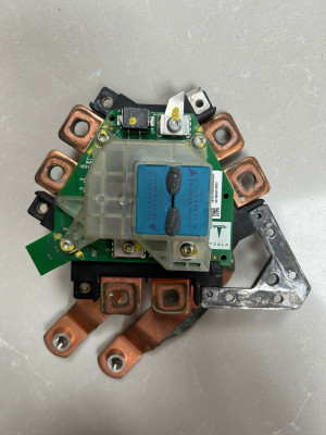

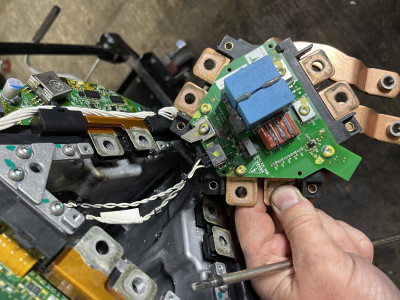

I managed to source a replacement from Ukraine part number 6009072-00-A for just £70. Interestingly Tesla seem to have updated the design and placed a plastic housing over the blue components. Anyway, I fitted it and put everything back in the car and it’s working perfectly again.

This is one part I have seen very clear revisions on across the 3 LDUs I've taken apart now. On one of them, the board was remote - attached on top of a gate driver, with just two wires feeding off the back of the bus bars.Boxster EV wrote: ↑Thu Jun 26, 2025 4:12 pm Interestingly Tesla seem to have updated the design and placed a plastic housing over the blue components.
