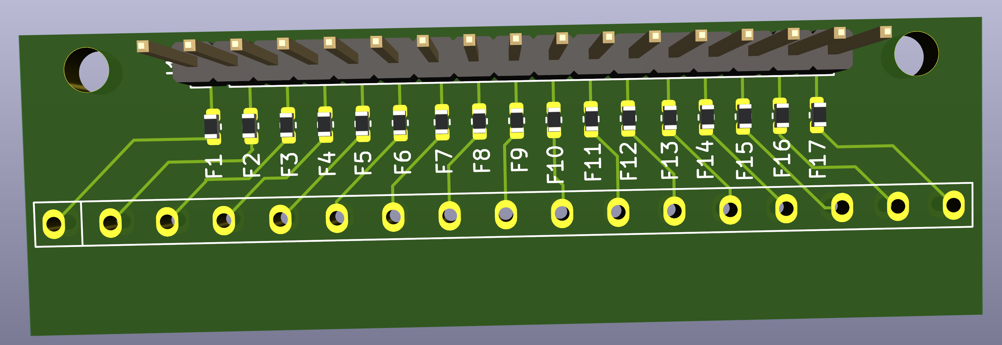

Here is the kicad source + production files for a tiny adapter board to fit at the end of your BMS design to accomodate a 17 pin phoenix pluggable terminal + has 0603 footprints for extra inline fuses or 0R. Maybe someone finds it useful. Edited to update borked silkscreen order
- battery-fuse-adapter.zip
- (413.72 KiB) Downloaded 173 times

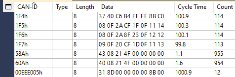

Re: Switched ADC BMS
I am thinking more of larger storage systems, 1MW solar park with some, say LTO/LFP, ESS probably outsells all currently sold BMSes. There's plethora of 48V pretty nice BMSes out there, but not too many options when you want to have say 600V LTO pack.
Probably need to take a list of currently certified inverters for such cases and start with lowest hanging fruits. Most integrators probably choose a box from China, some want more flexibility once they realize the chinese box is half working and shipped with fw 0 with no later improvements.
For that probably much higher balancing currents are needed and rs485/modbus, but that would probably be a problem for esp32 to solve (can>whatever translation). A friend is setting up solar parks and told me it's painful with current BMS/BMU options out there, imo a big market opportunity for you, if you have the energy to go after it.
Here is approx 10s without web tool: Here with web tool: With web tool it gets a bit more spammy on the bus.
I did try rate limiting the bms messages down to 1 second updates and it wasn't bad.
For ESS you would probably also want to send cell voltages (either 3 messages packing all cells or just delta update on any changes), now the esp web tool reinits the driver on node switch to interrogate each bms in an inefficient manner, packing cell data in a, say 1s PDO update rate cycle would probably be cool, as everyone wants graphs and whatnot.
Was it with Web tool connected or not?johu wrote: ↑Fri Jun 27, 2025 5:57 pm One thing I noticed with the Sungrow is that it doesn't really like the additional "internal" BMS CAN traffic. It doesn't fault out and it does sort of work but drops power from time to time. I've tried higher CAN ids but that didn't help. Maybe a slower cycle time would help. Will play with that.
